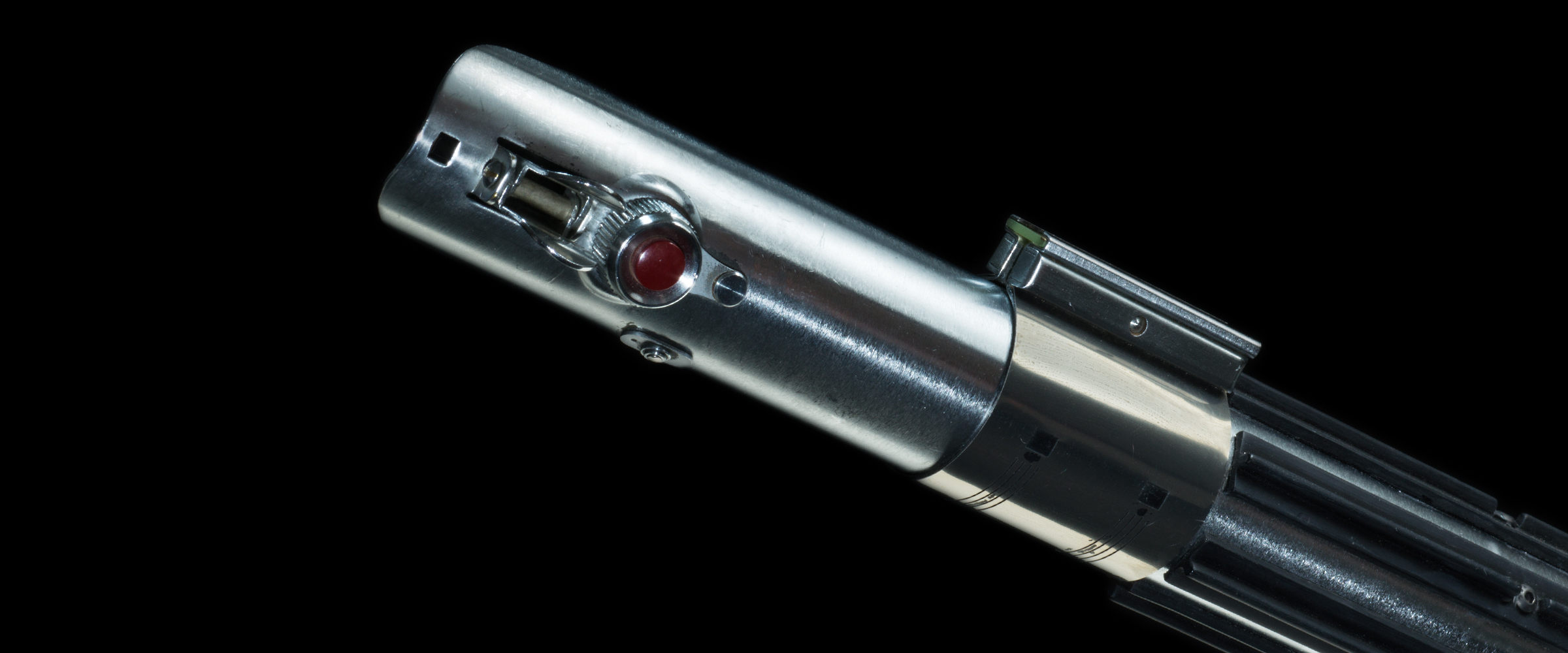

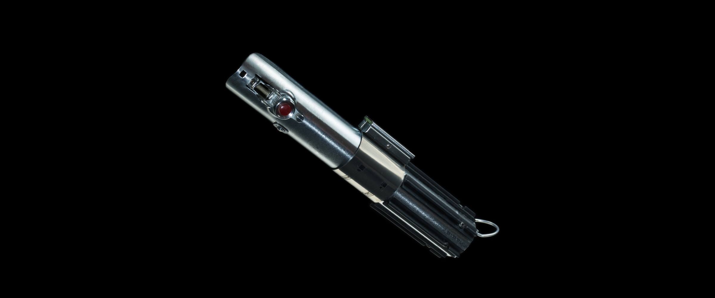

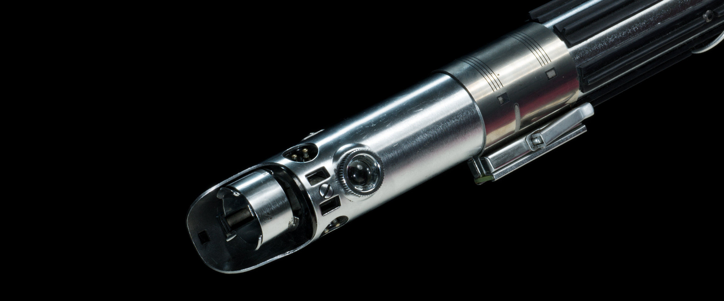

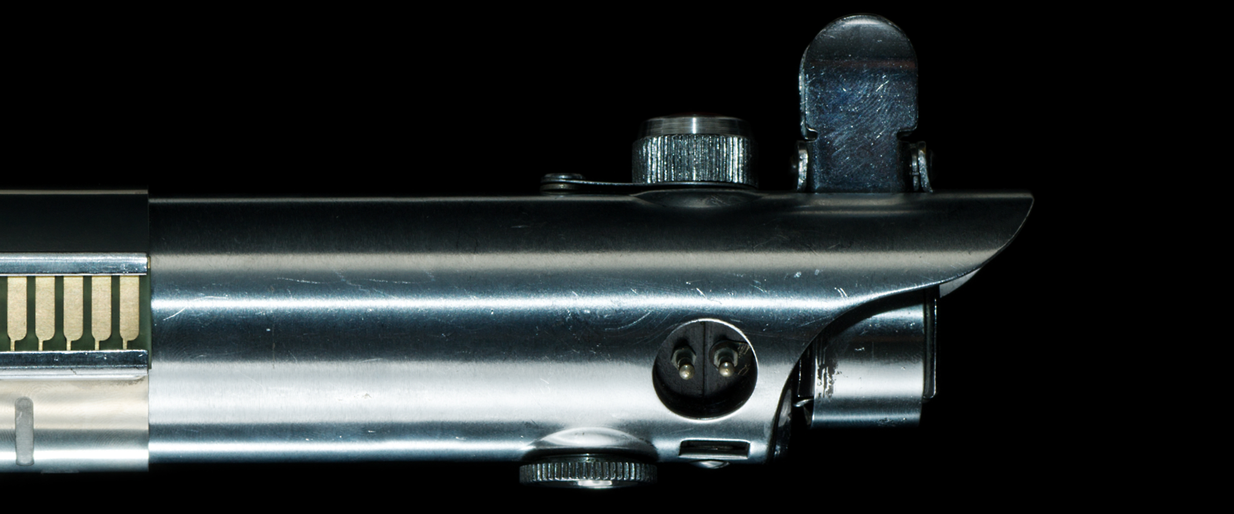

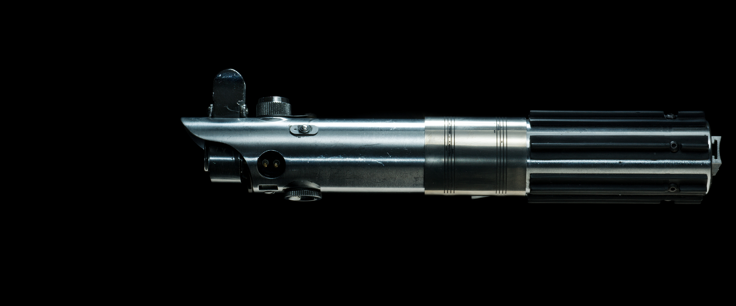

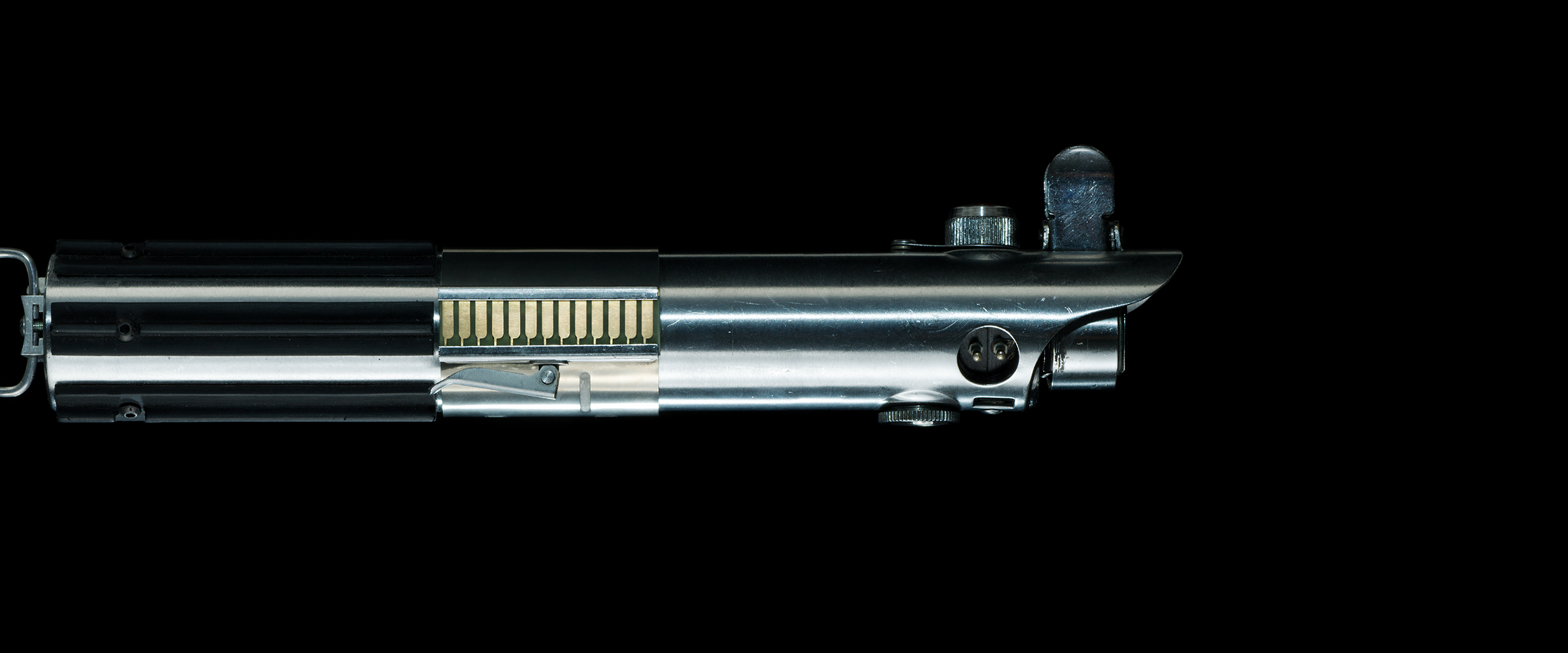

The clamp on the Propshop replica definitely has a cover/wrap. Interesting to see they engraved "holes" and lines about half way into it instead of just punching them out or debossing them. Also, instead of rivets on the grips it has dark hex screws with text on them. As others have mentioned the Kobold clip is flipped and the glass eye is unaltered. Also note there appears to be a gold strip on the clamp card on the side with the thicker traces.
Pics below. Treat these as a variant and not screen used even though they are made by the company that made the screen used props.
