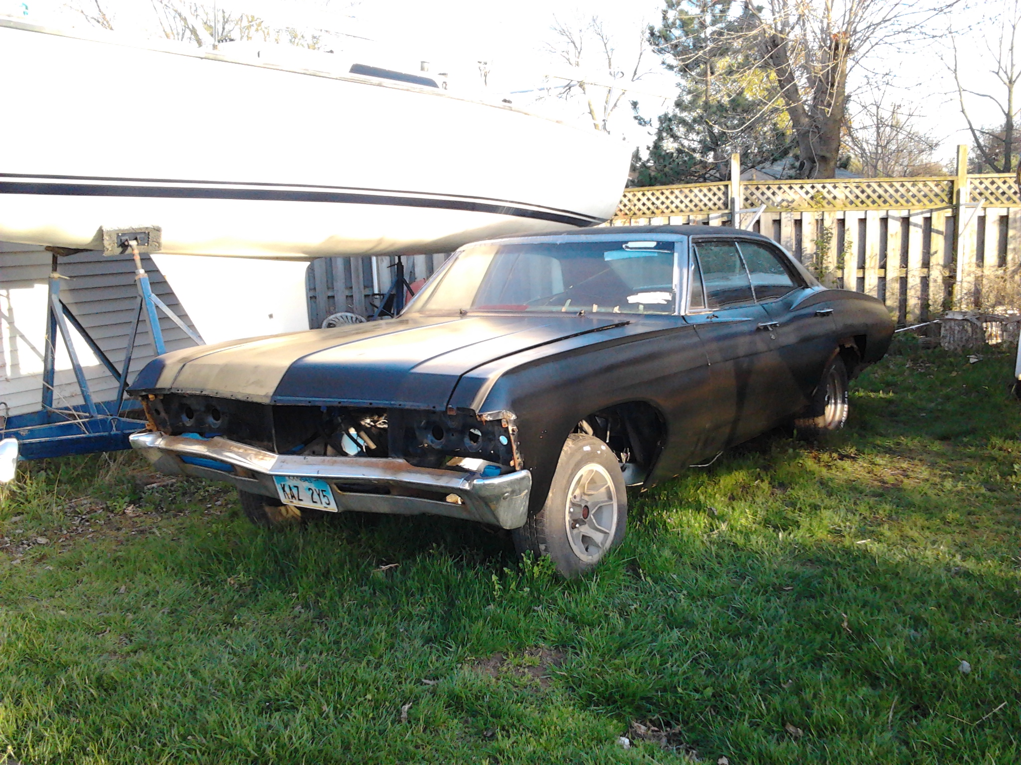

Here is the one I just picked up from GA
24,000 original miles, 327, going to work on the weather stripping first, then fixing the few rust spots.
Rims, tires, engine, suspension then breaks.
Then interior which my seats are already done.
Still have a a lot to do but I just want to make it a perfect driving machine first then make it Deans.

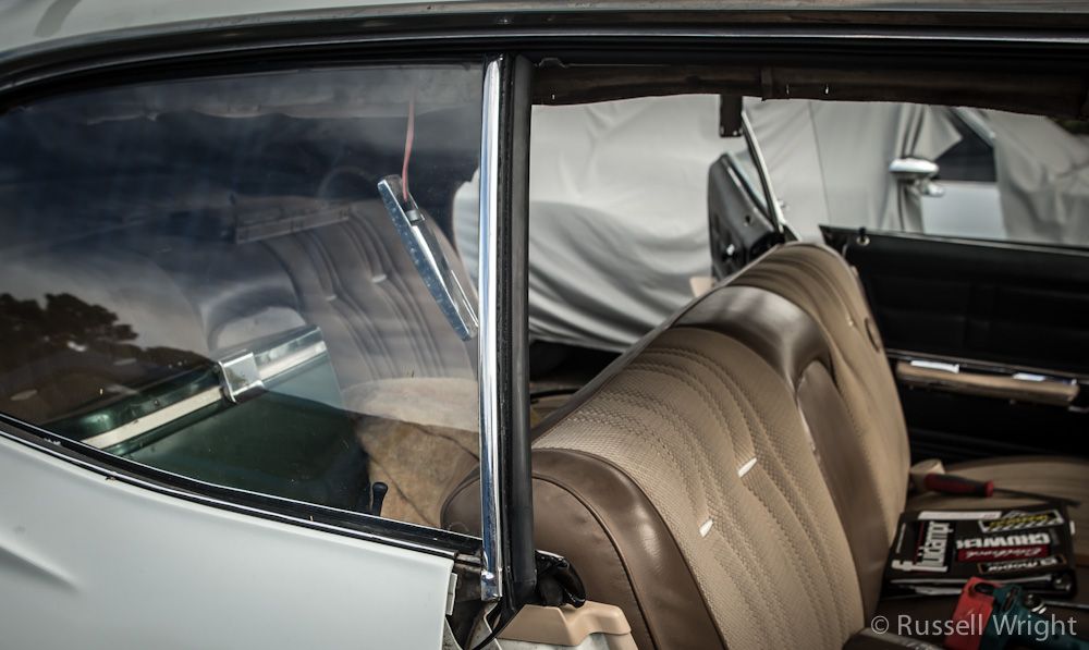

G'day Larry ... is this the glass trim you're talking about?
impala-verticalseal4.jpg~original
Unfortunately, these are not reproduced. You will have to find them used (salvage yard, eBay, Craigslist etc).

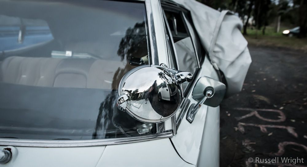

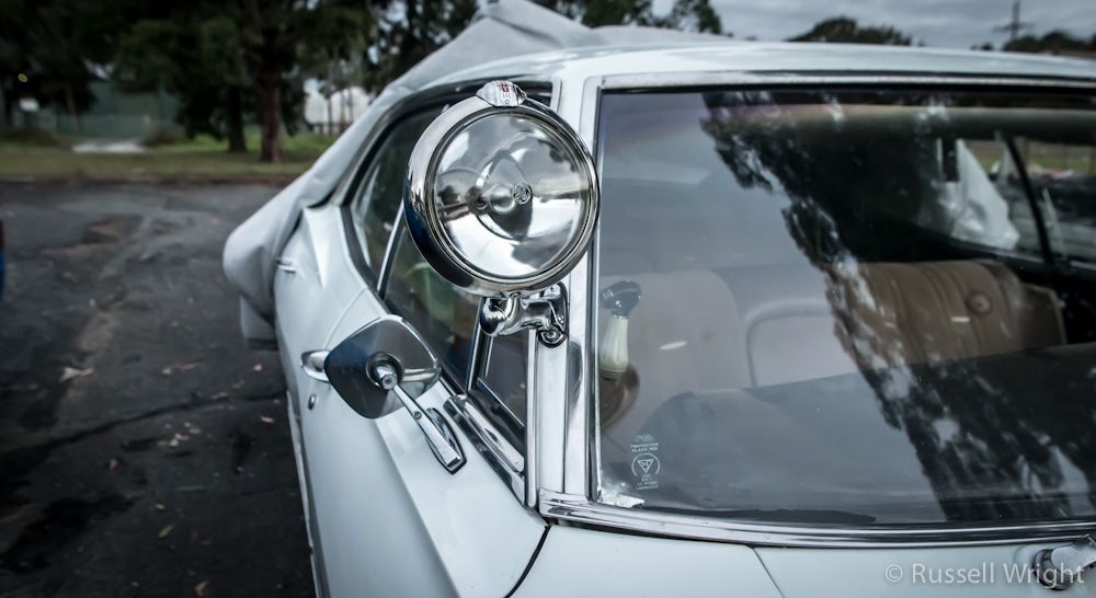

impala-spotlights5.jpg~original
impala-spotlights3.jpg~original
When I do it again though (and a will when I buy a second one for a wedding car business), I'll mount them an inch lower. :thumbsup

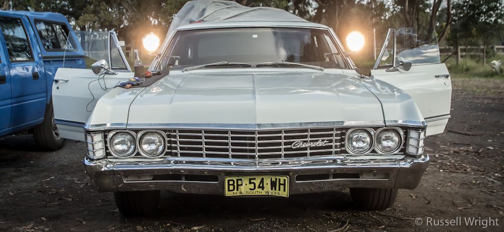

impala-spotlights2.jpg~original
impala-spotlights4.jpg~original

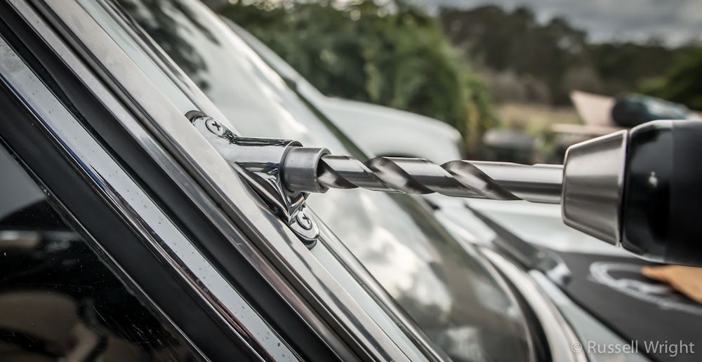

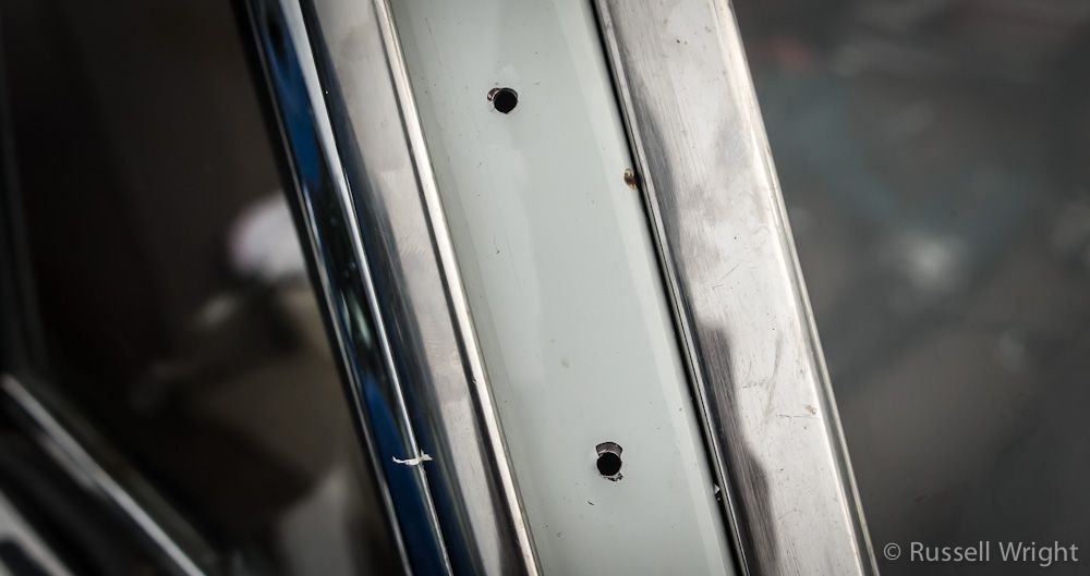

Hoooow do you install them? did you have to drill a hole in the pillar?
Yeah you do. It's pretty easy.
Align the brackets, centre punch and drill for the mounting screws.
impala-spotlights7.jpg~original
Mount the brackets and insert drill bushing.
impala-spotlights9.jpg~original
Remove the interior pillar trim and check for wiring, then drill.

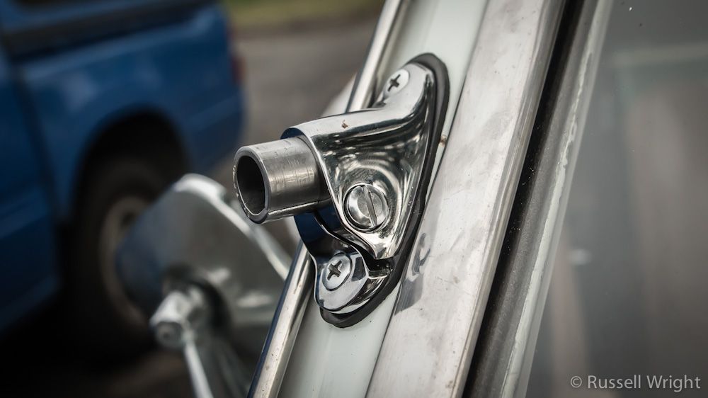

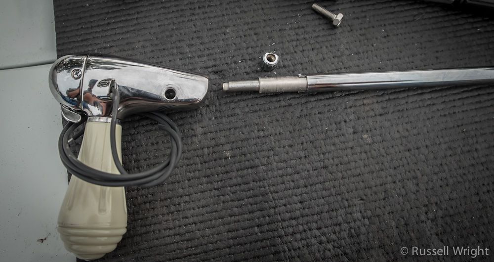

impala-spotlights10a.jpg~original
Remove the handle and insert the shaft through the hole Re-attach the handle. It has alignment notches so it's hard to get it wrong :)

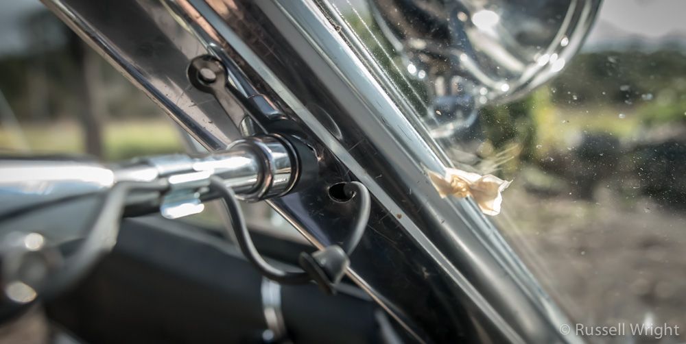

impala-spotlights12.jpg~original
impala-spotlights1.jpg~original
Drill a hole in the trim for the wire, and secure with included grommet.
impala-spotlights14.jpg~original
Wiring them up is simple. Took me 20 minutes. There's no ground wire (the ground themselves through the post). Just a single wire. I wired each to a single fusible link, which runs direct to the battery. Easy peasy.
