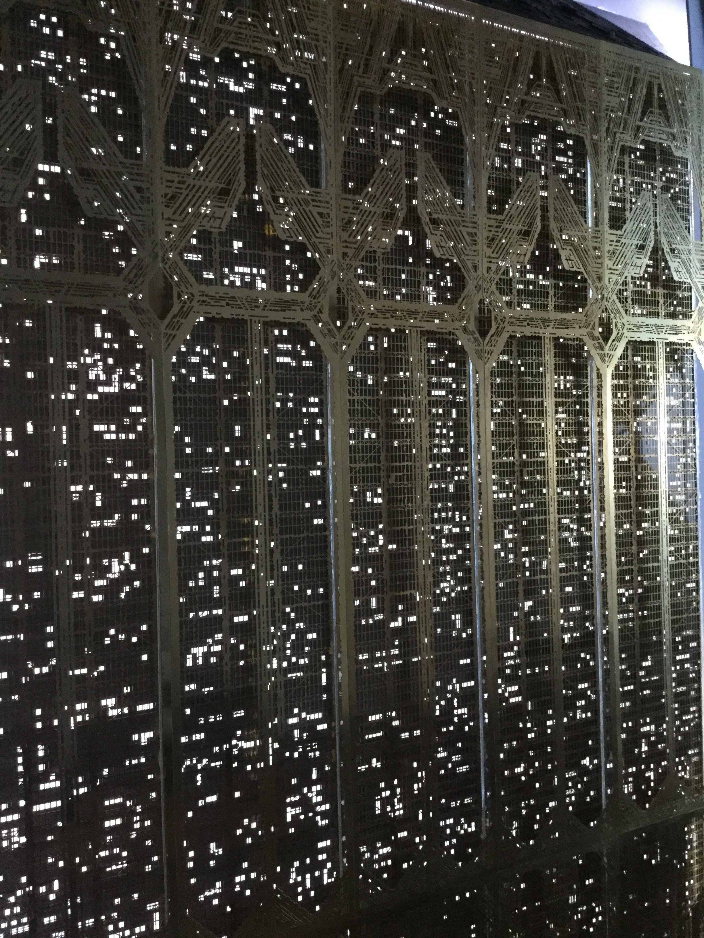

Did you ever consider color differential in the "Office" lighting?
I know what you are referring to here - office lights in buildings are not “ monochromatic” when viewed at night. Yes, I did look carefully at that and contemplated printing some of the lights with a frame of colours on their edge.
There is a difference in some of the lighting patterns in some photographs (image below). Did they use a different pattern to simulate different times of night in the movie?. Thats unknown at the moment.
The black and white pattern comes from reference to the use of high contrast film to create the patterned lighting. There is a reference to this in a book on Close Encounters of the Third Kind. Basicly it’s uses hand painted/ drawn artwork pattern photographed and printed ( multiple times) on enlarged film acetate. The high contrast is because it is just black and white . The colours in Close encounters came from the use of different coloured filters when filmed. They didn’t do this for the Pyramid and my solution didn’t follow this exactly but used what tools I have to create something of similar effect.
The buttress’ ( prototype) is undergoing a few more changes to its build to make it a little more robust because the etch is very delicate. I also have a lot more work to do on it, paintwork, lighting of the roof antennae, the strobe lights to the edge etc.........

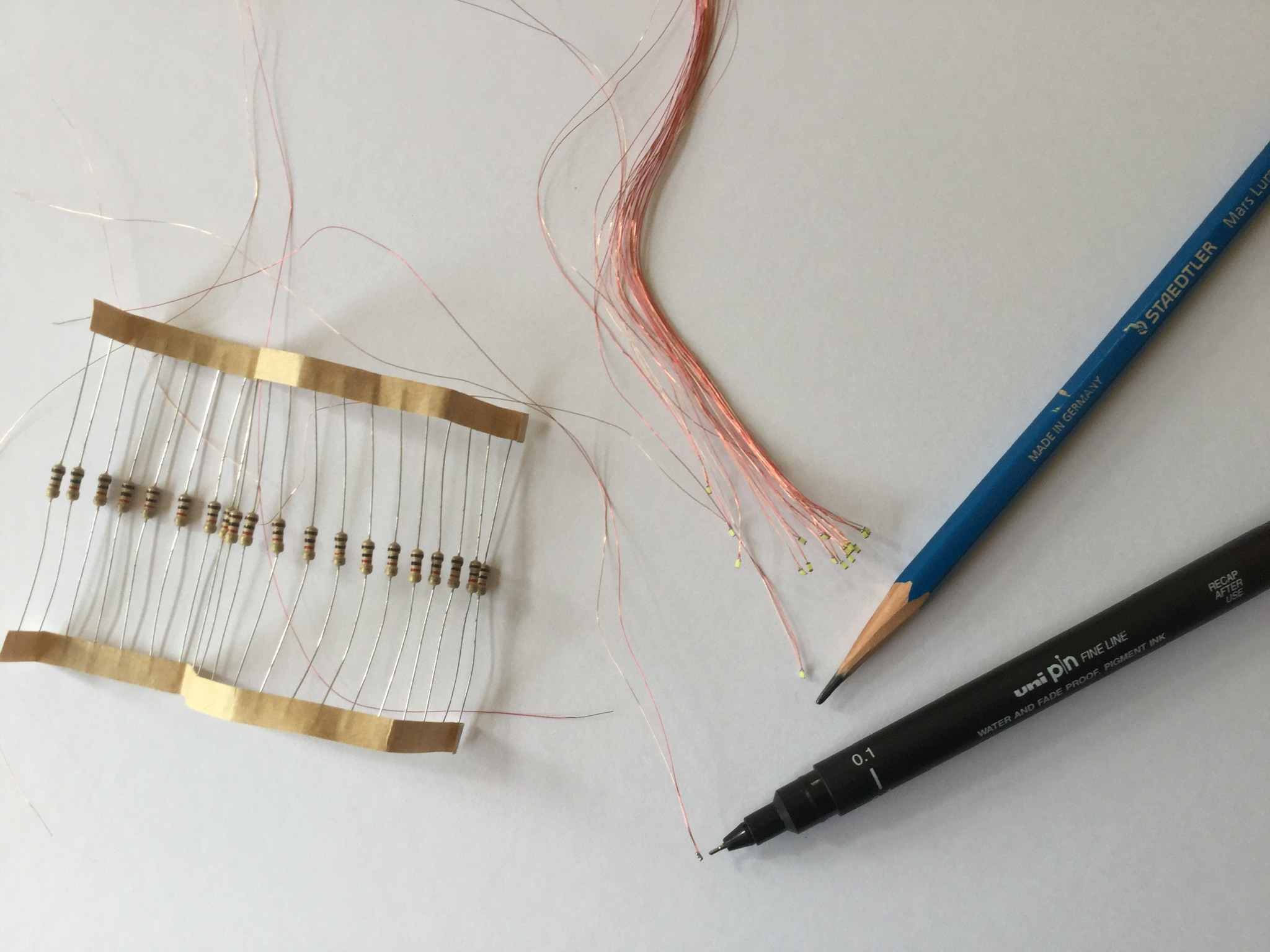

Yep. I had a learning crash course over the weekend into LED wiring & lighting - resistors, capacitors, optocouplers, transistors. After experimenting with various fibre optics to light those antennae ( which didn’t quite work), I got these nano leds last week. Light is 1.6x0.8mm, wire is 0.1mm. Extremely fragile but perfect.

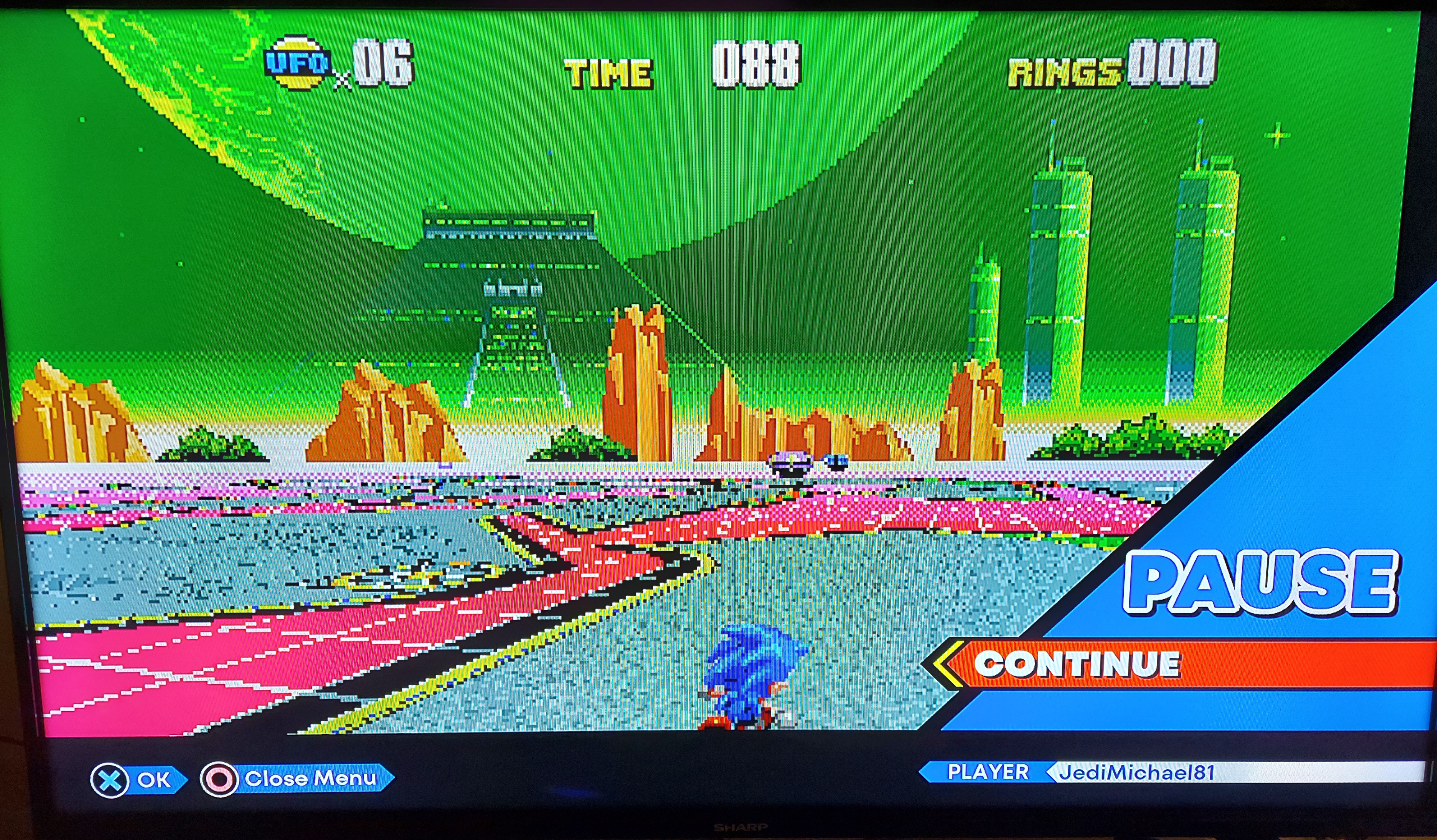

Was playing Sonic CD from this new Sonic Origins collection that just came out.
The very last special stage looks like this. I immediately notice the building in the background is similar to the tyrell pyramid.
Not exact, but still made me think of this whole thread.
