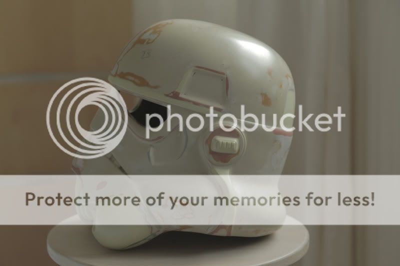

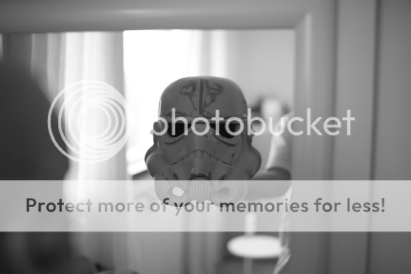

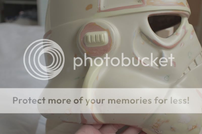

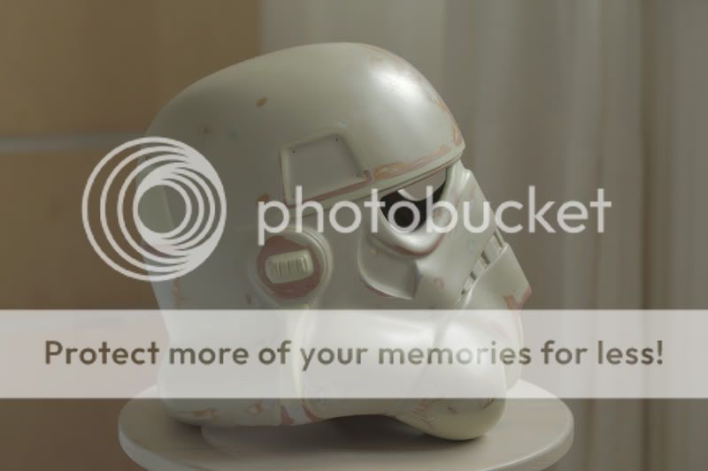

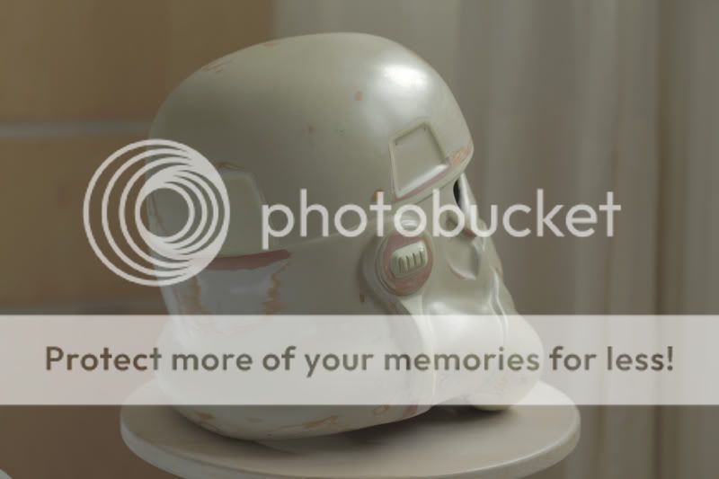

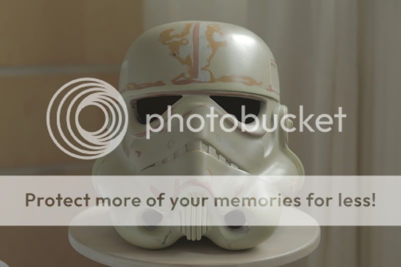

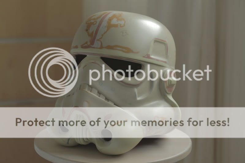

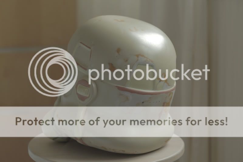

its been a while since my last post, mainly spent my time cleaning up areas and refining.
i've lowered the brow a little bit, bulked up the wings more and cleaned the area around the the vocoder.
i think its looking pretty clean and sharp and i'm really happy i've managed to get this far on my first build, should be on track for finishing next week :)
i'd nearly lost sight of the reason i started... when this is complete i'l be a proud owner of my very own TK bucket! i've only wanted one since i first saw star wars :)

excellent mate, all that work has paid off!! looks pretty much finished to me!
are you still planning on doing a mold next?

Looking great -- very nice!
How heavy do you think it is?
