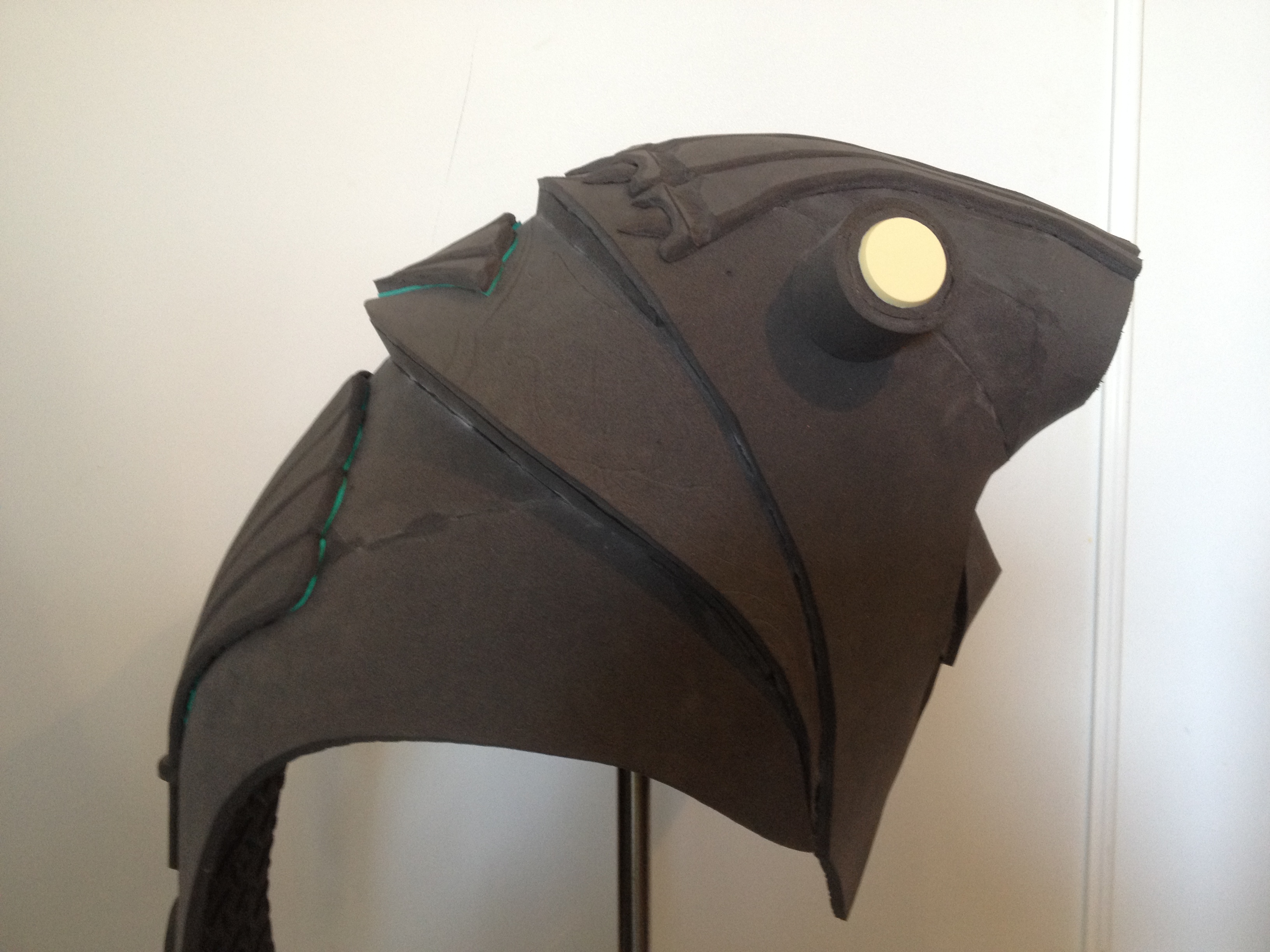

So with files downloaded and printed, turned into templates and marked out on foam, I set to building myself a cool display.
Went with Horus..

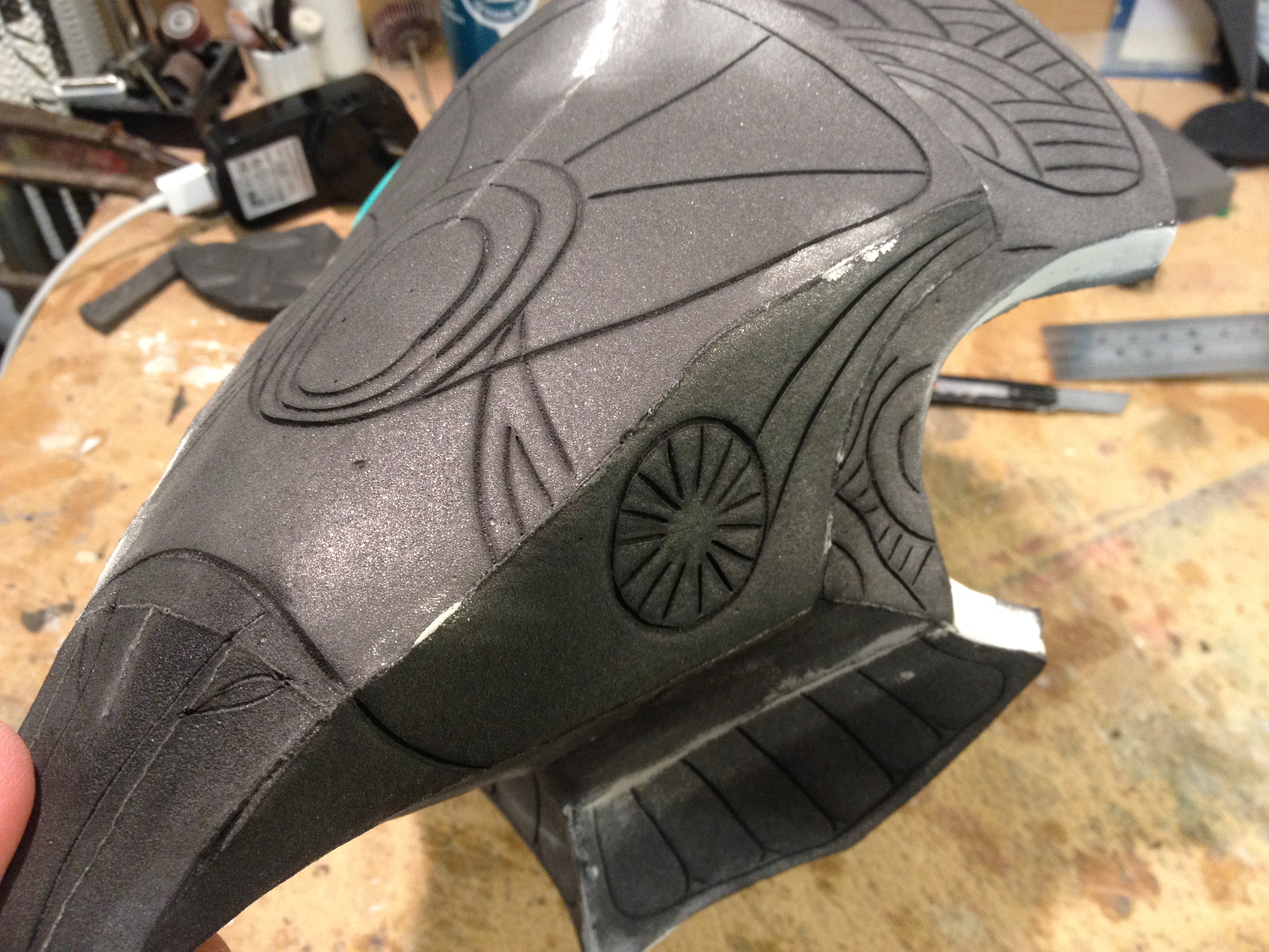

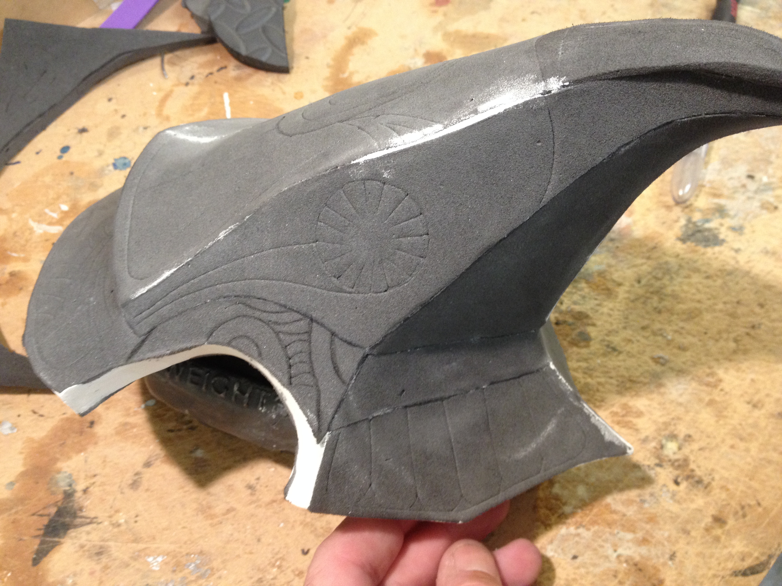

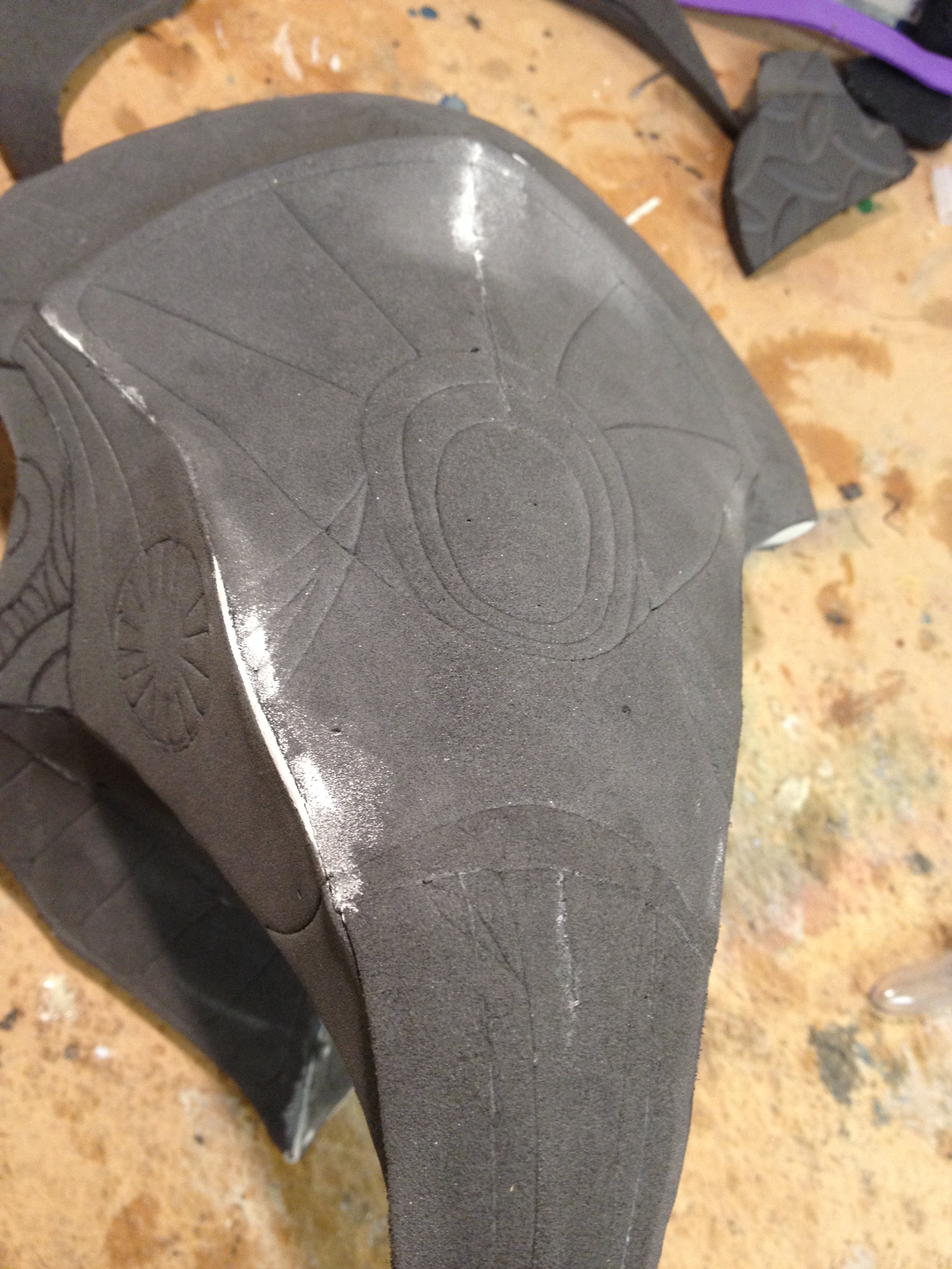

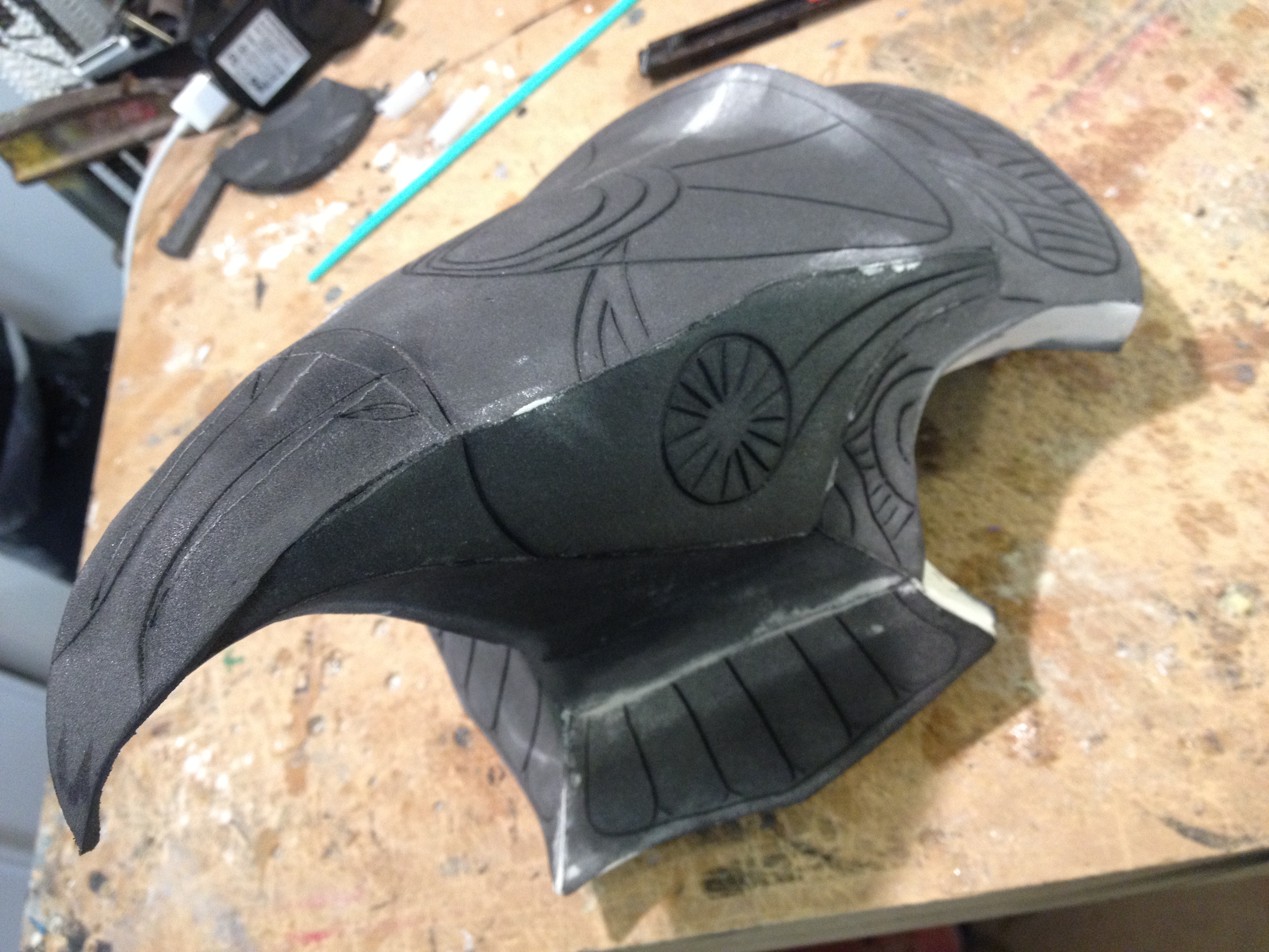

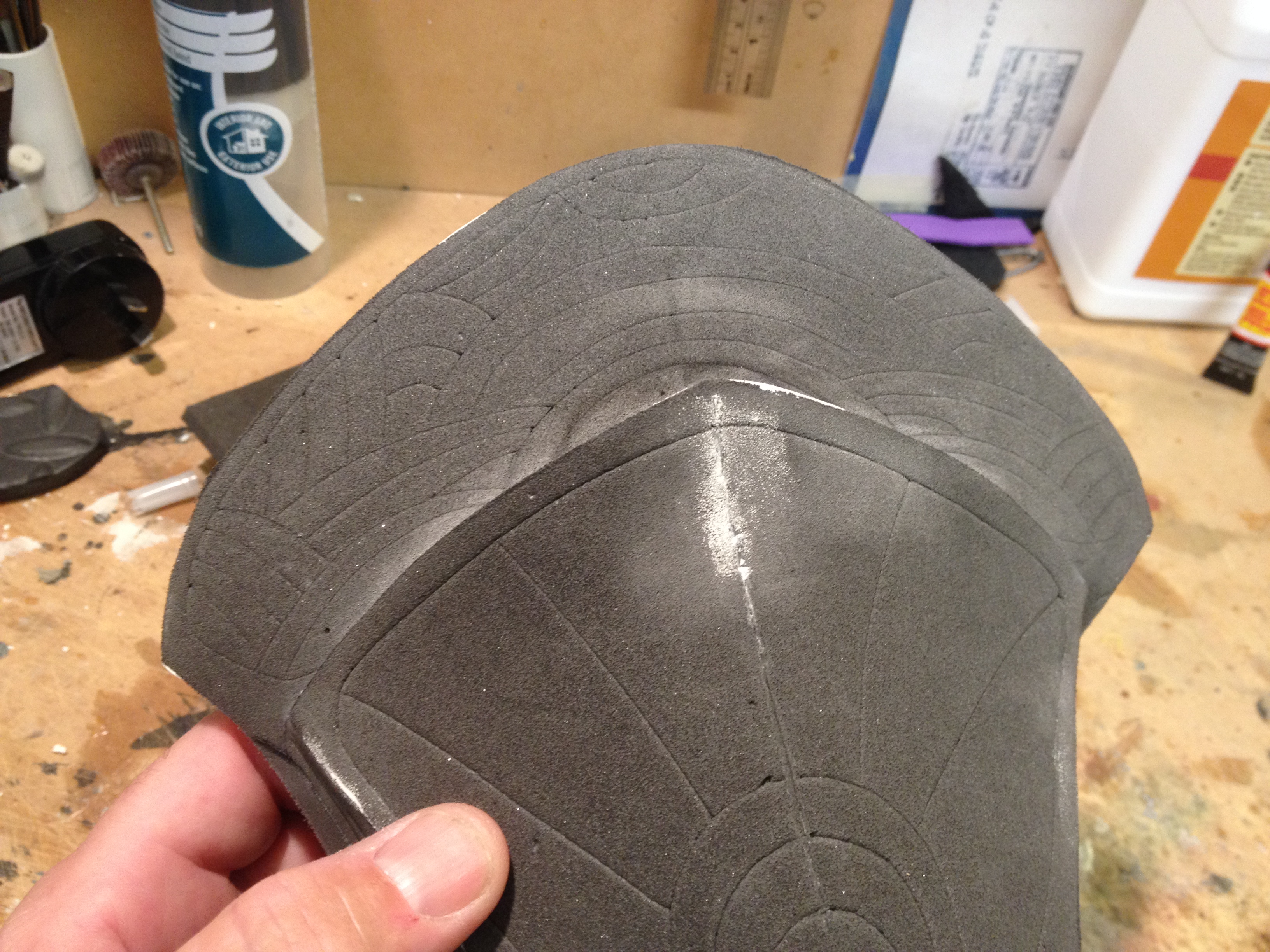

Detail work with a sharp blade...
A little heat gun treatment and PRESTO ! .... Nice clean line work...
Some 2mm foam strips were added later for raised detail.

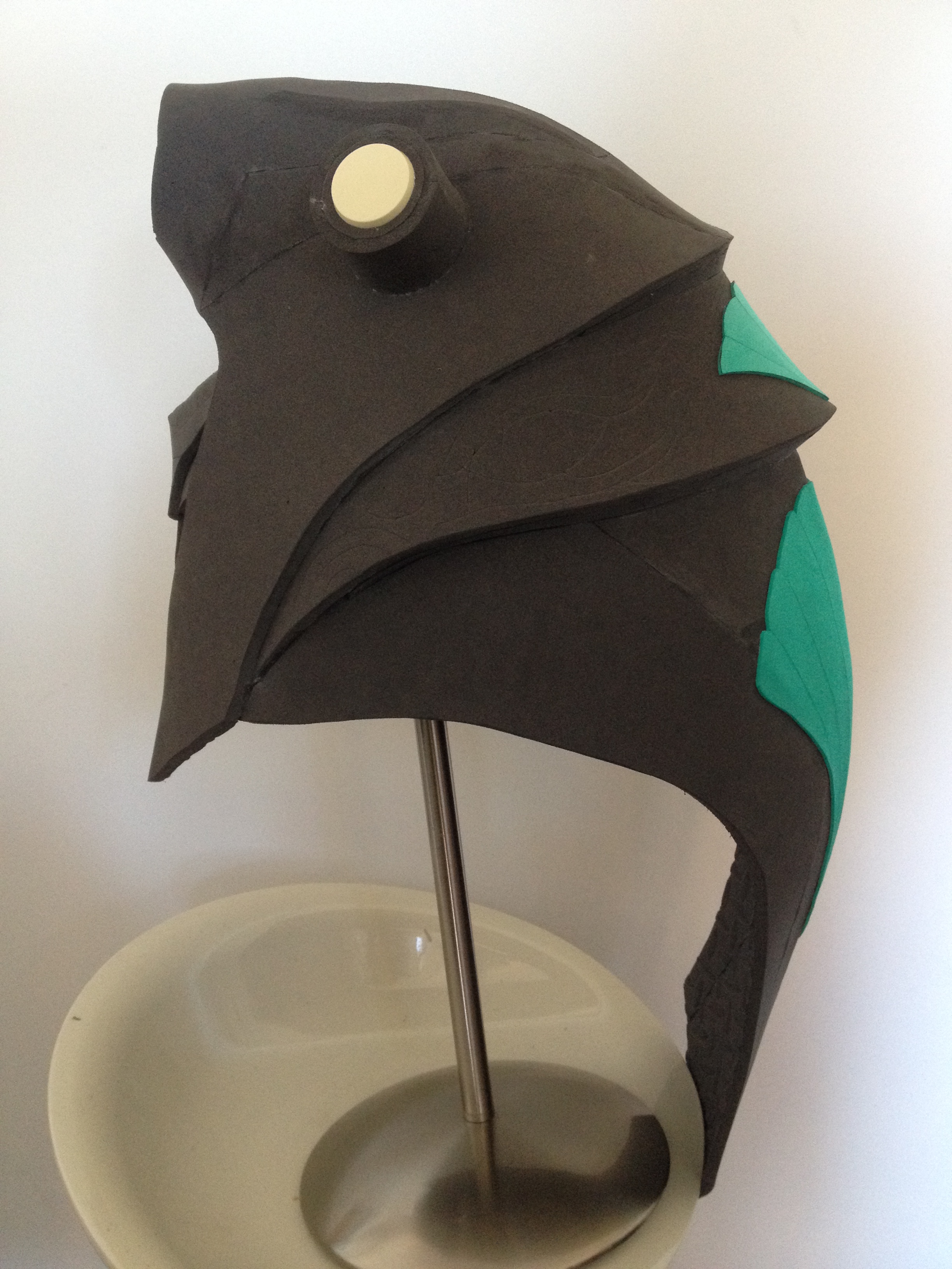

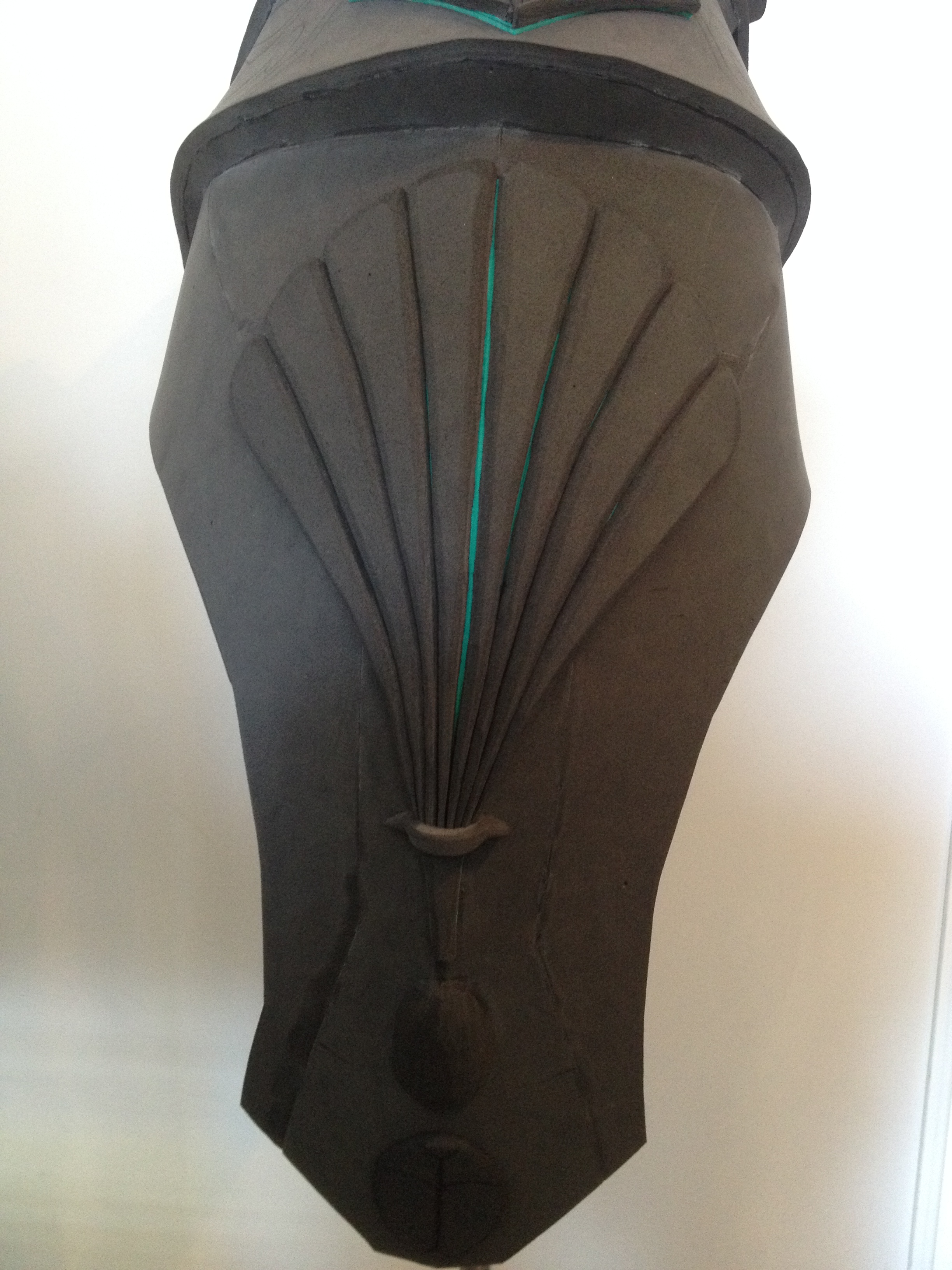

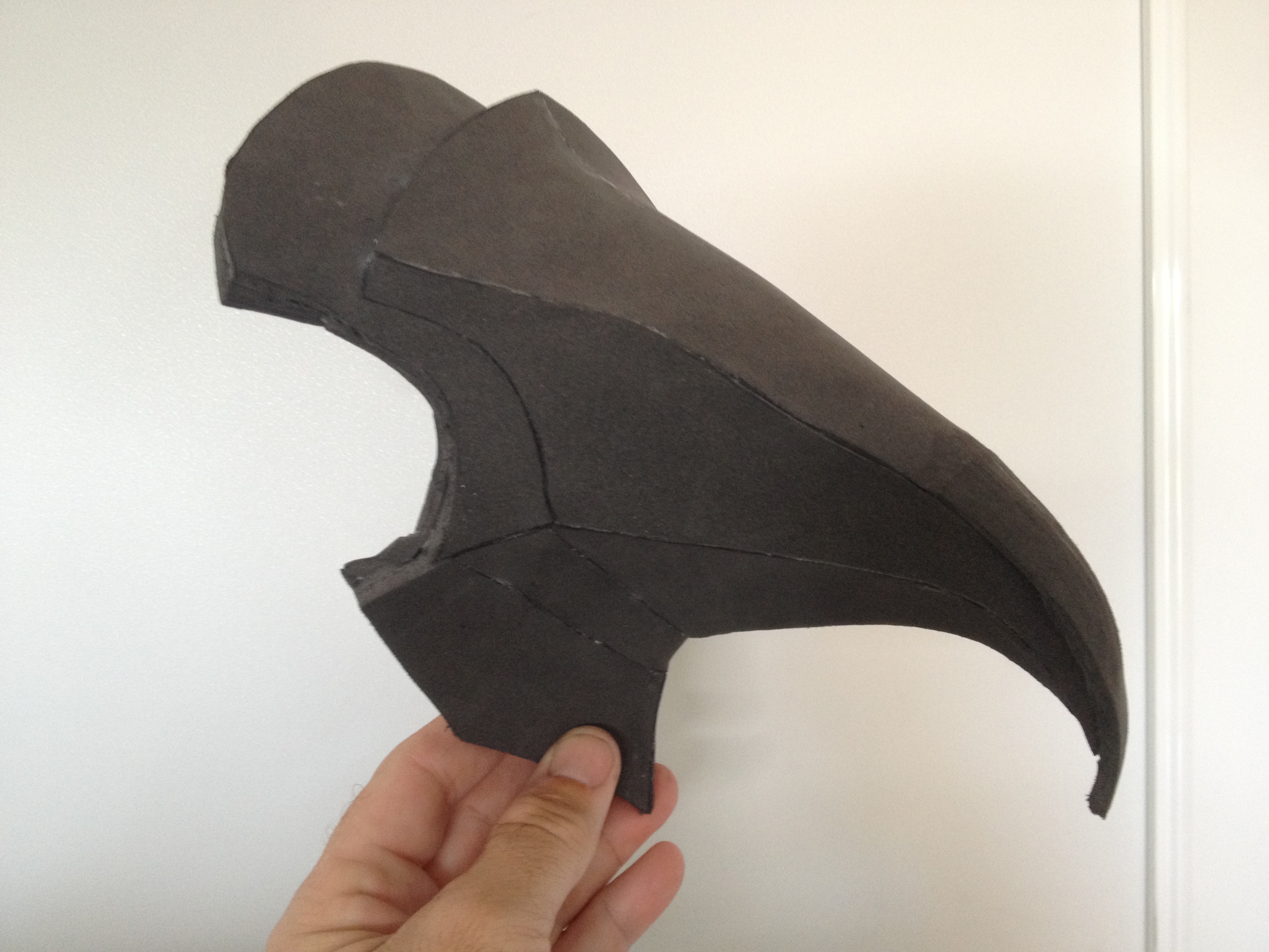

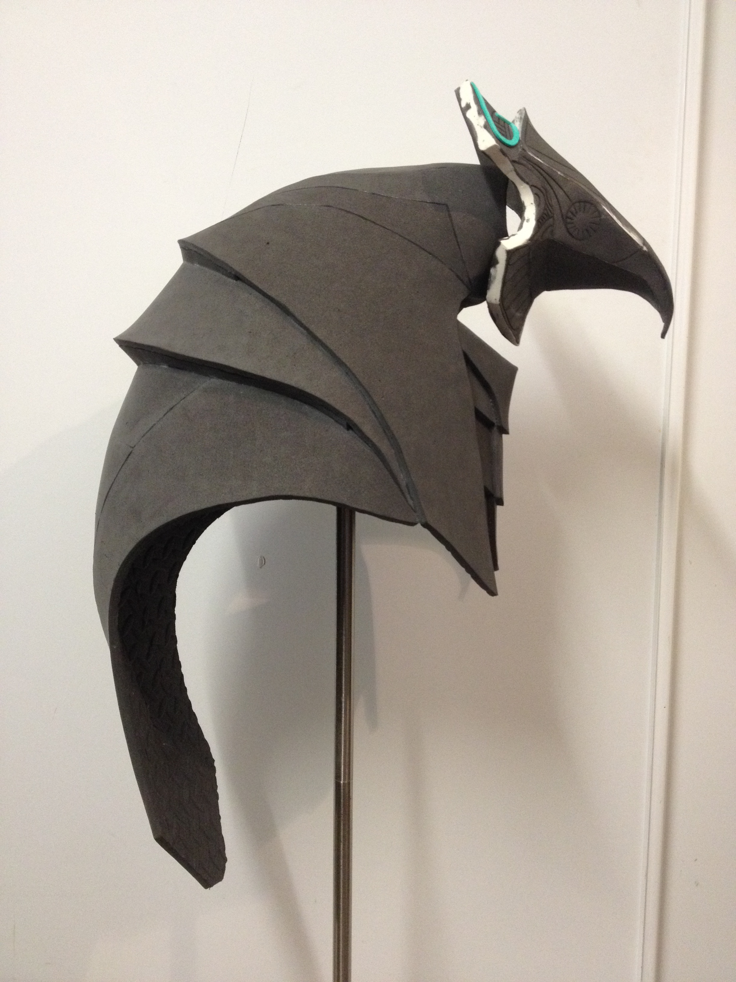

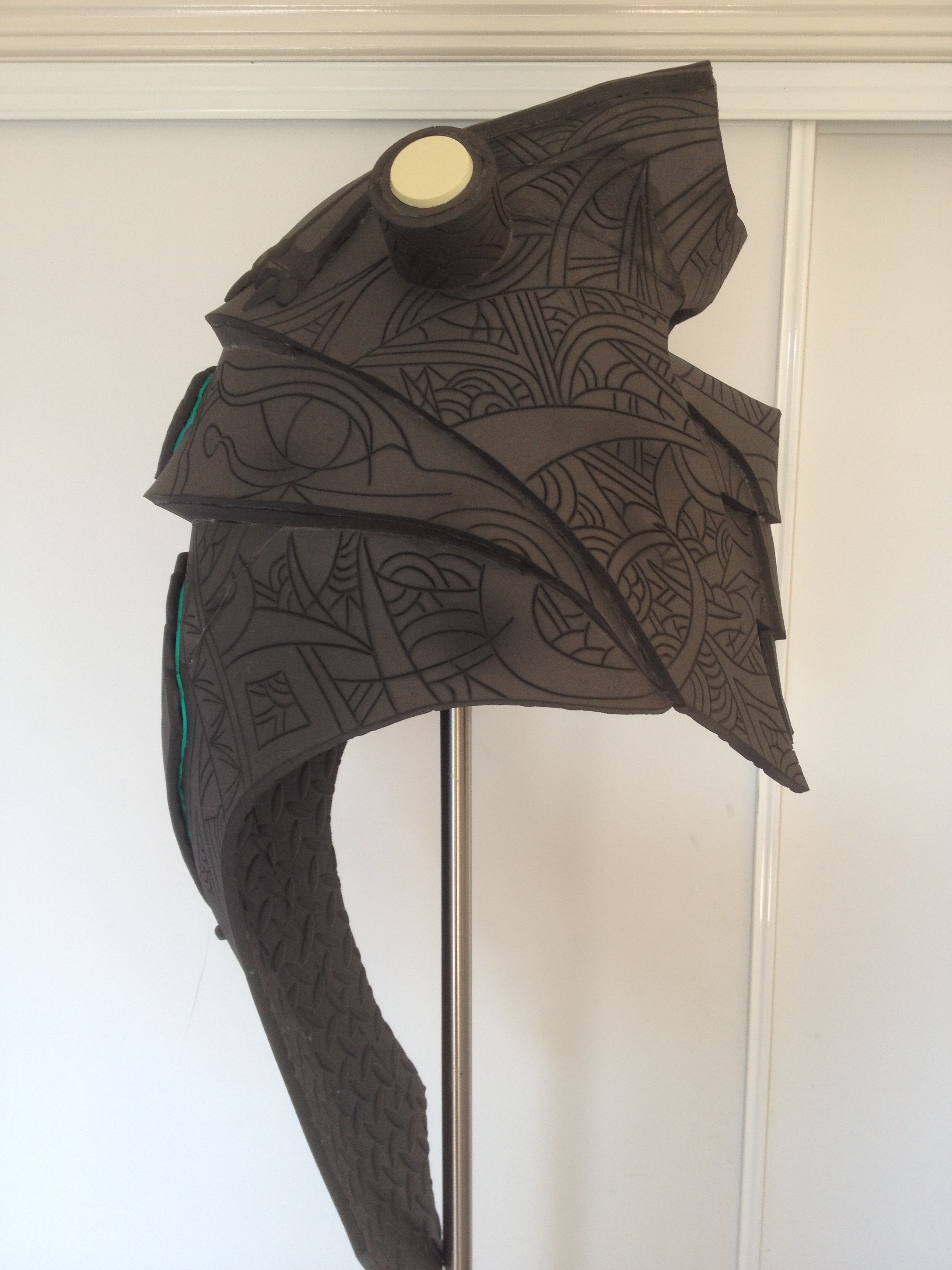

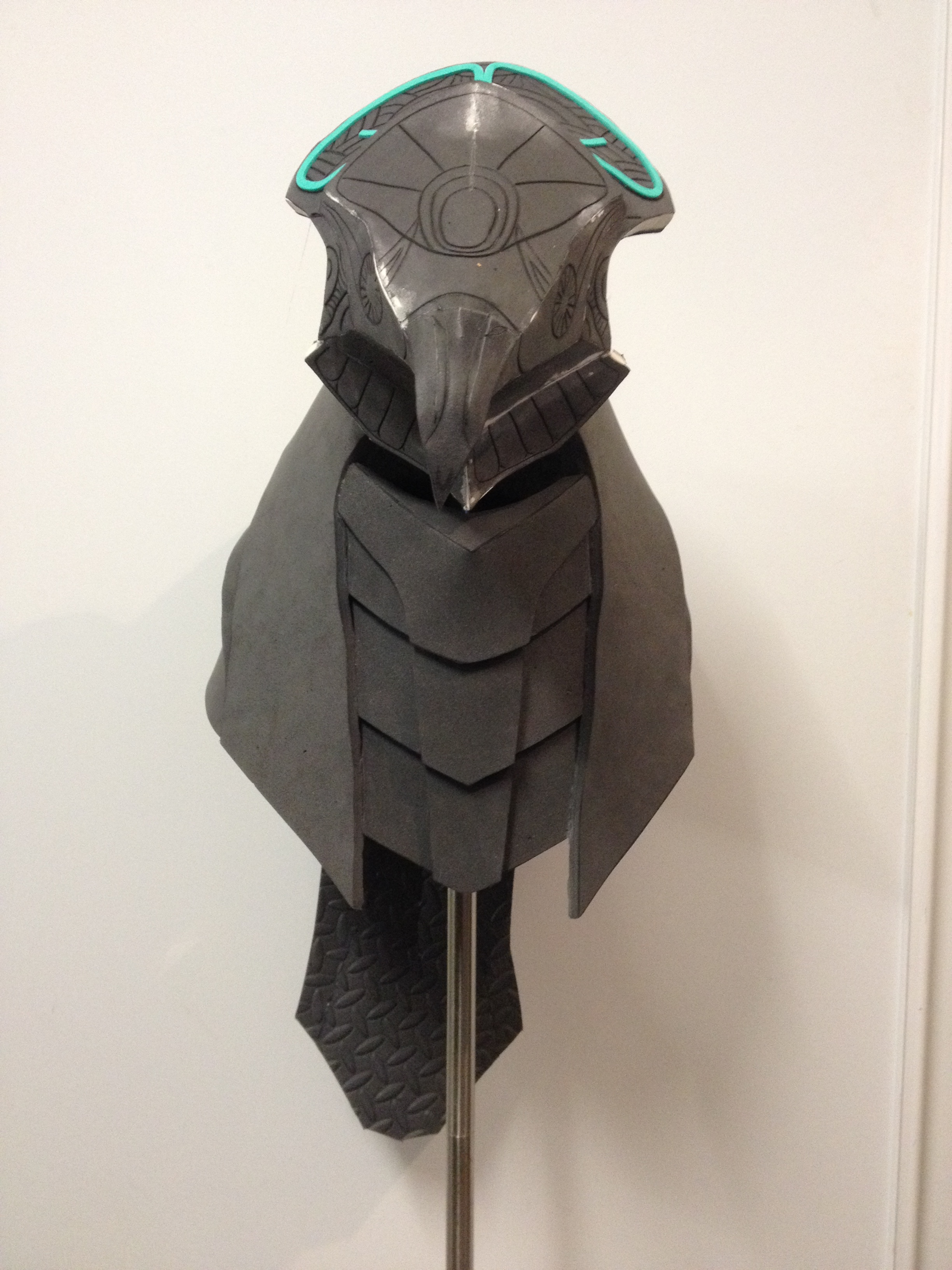

Made a start on the "lobster tail" .
Head and lobster tail together ..... looks good.

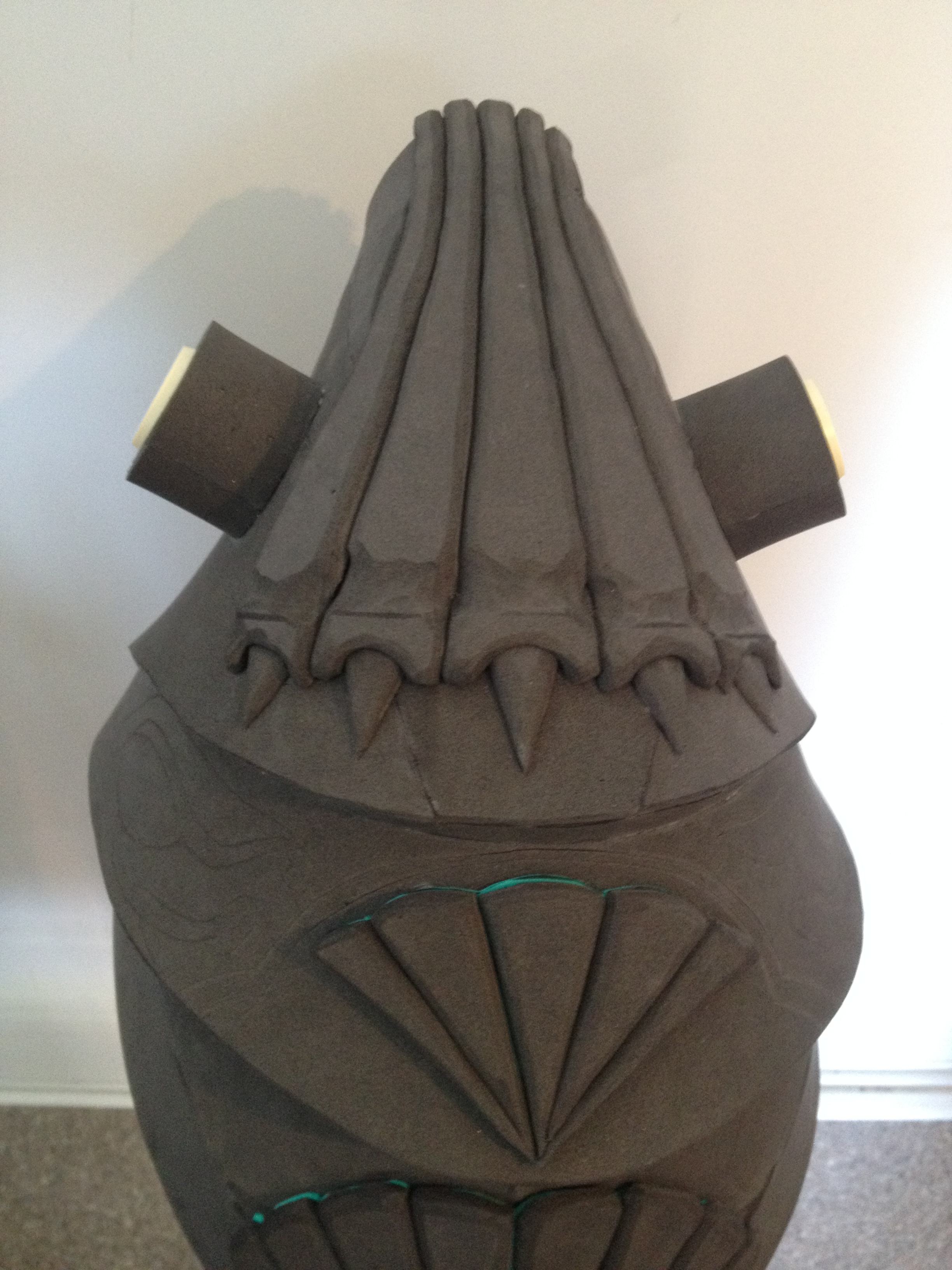

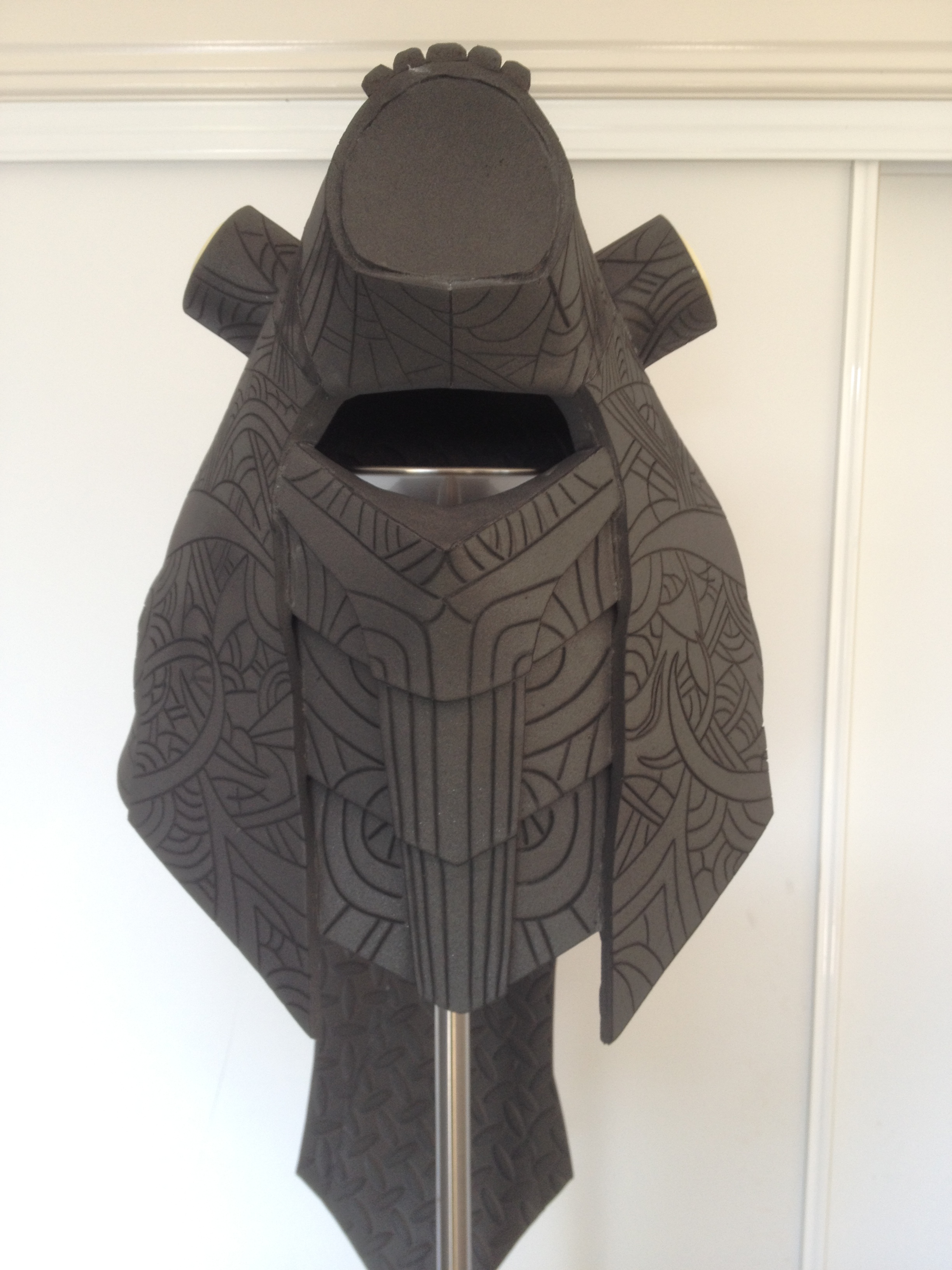

Detail work.

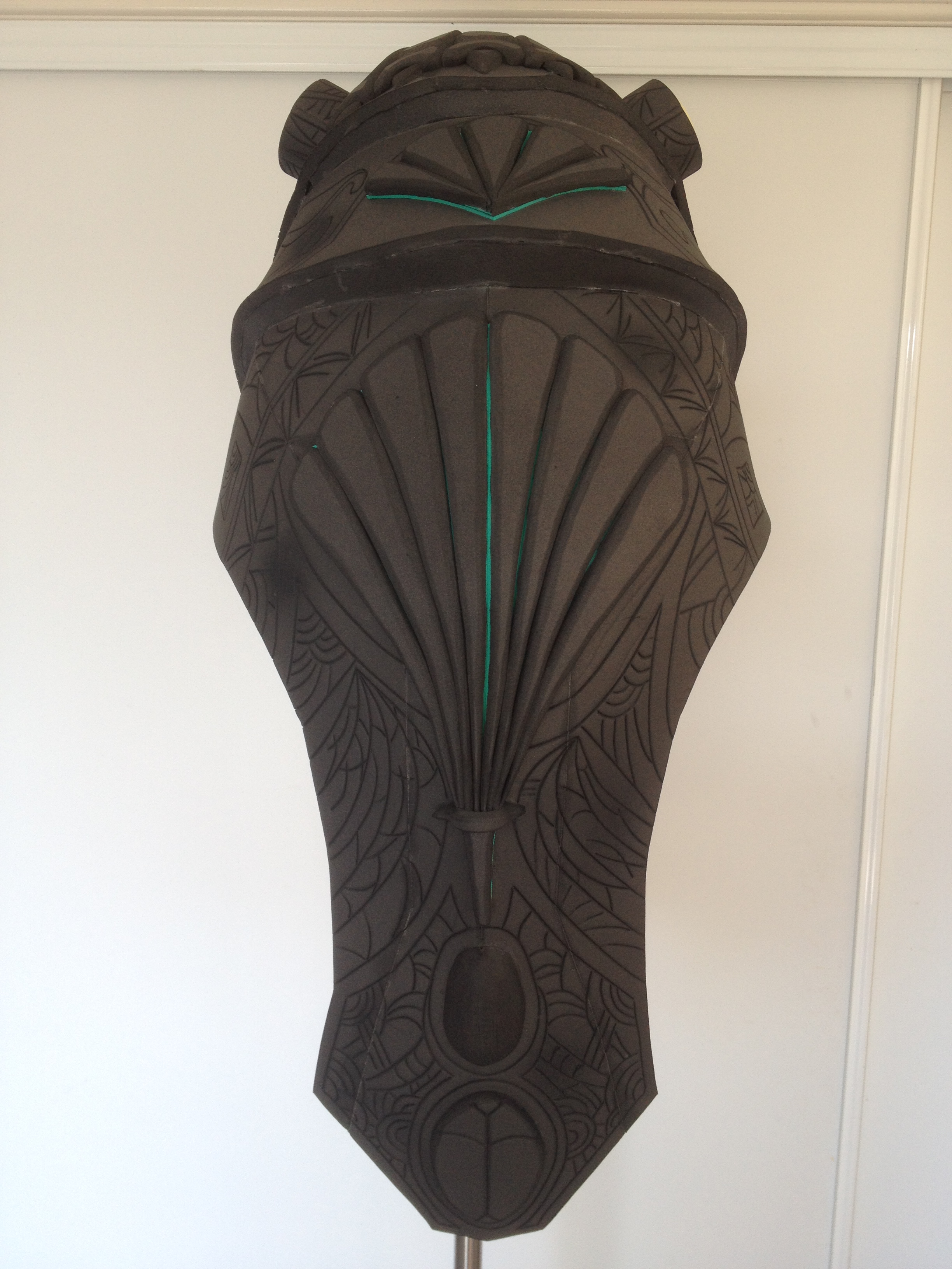

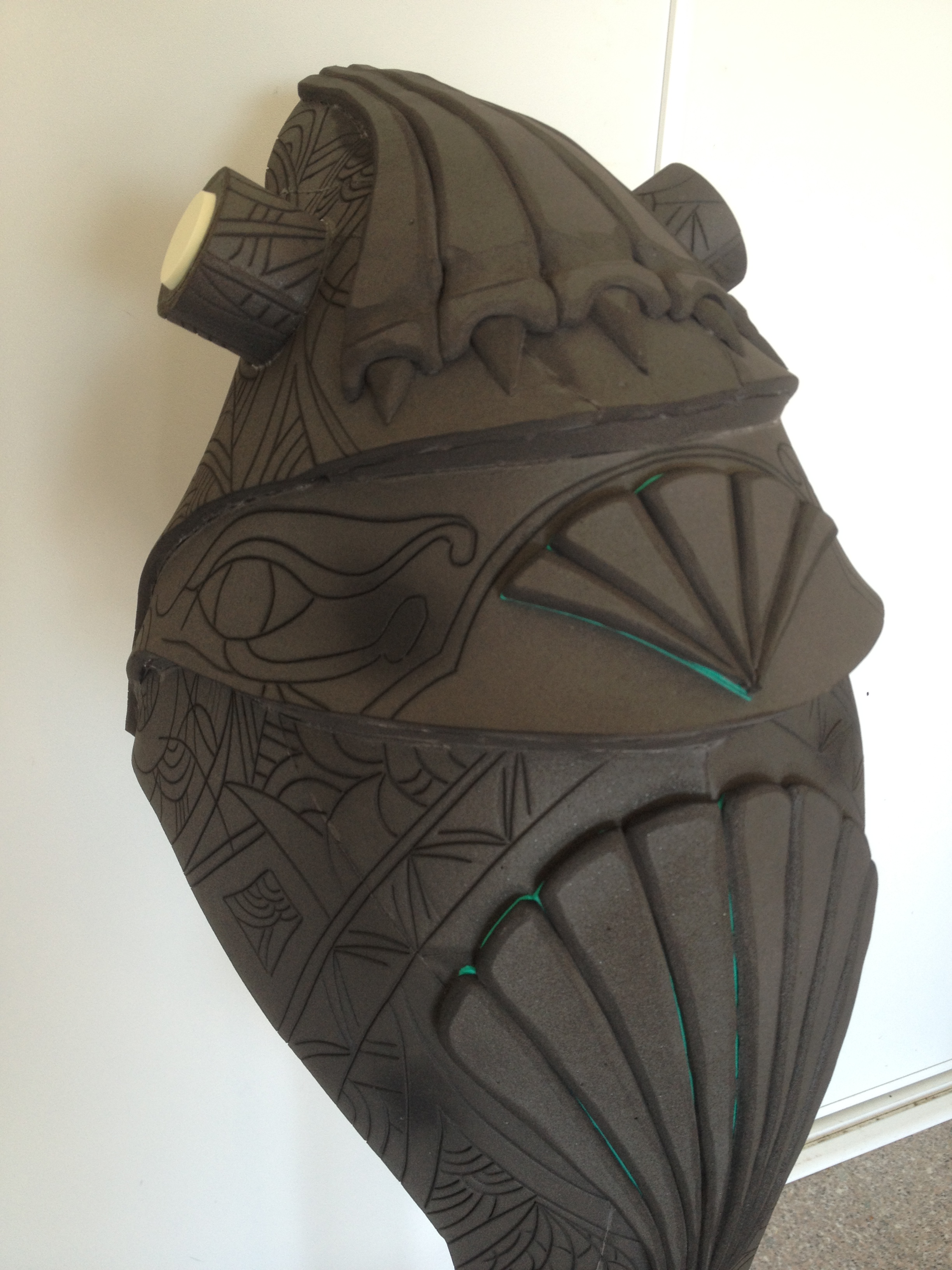

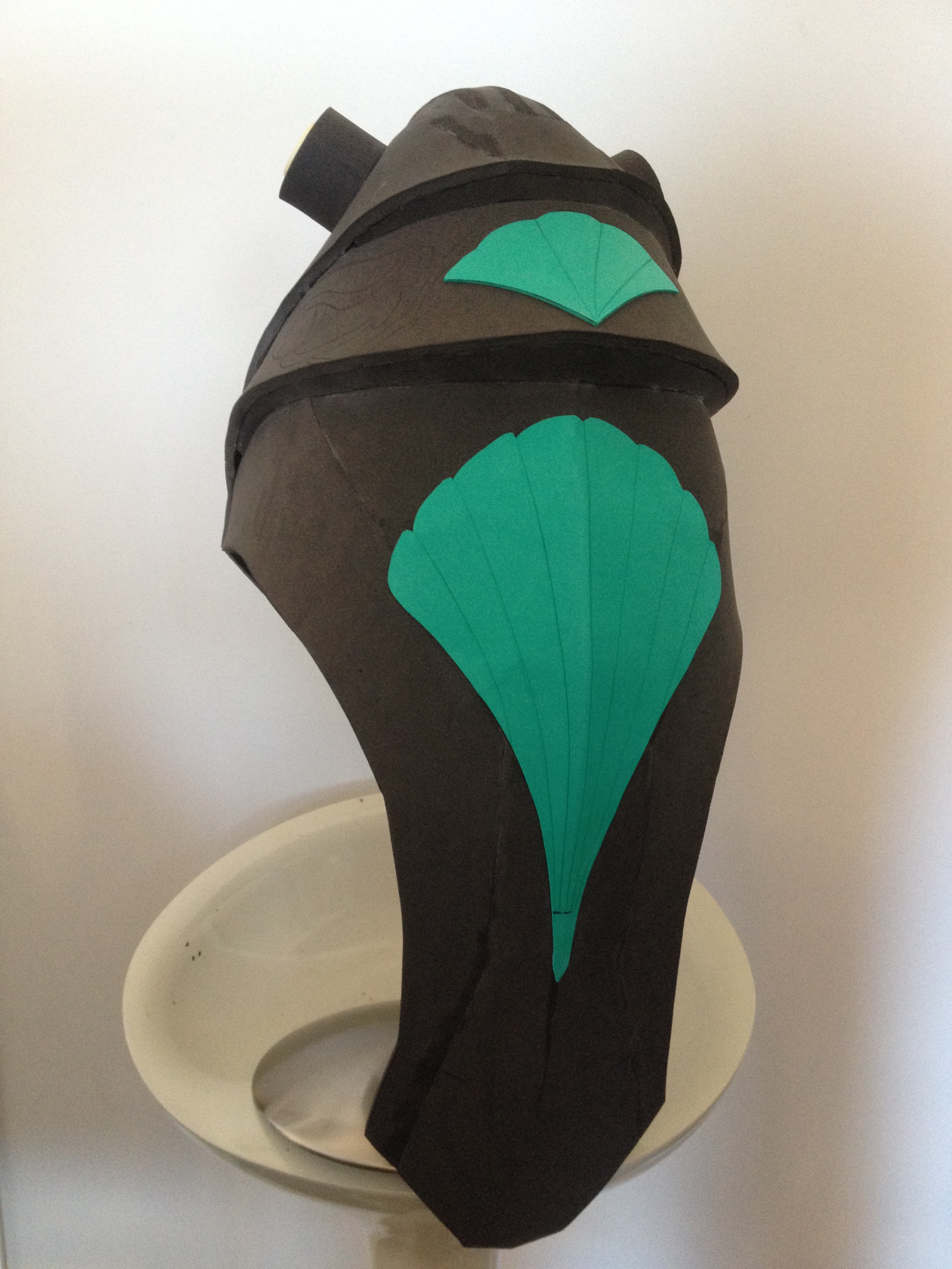

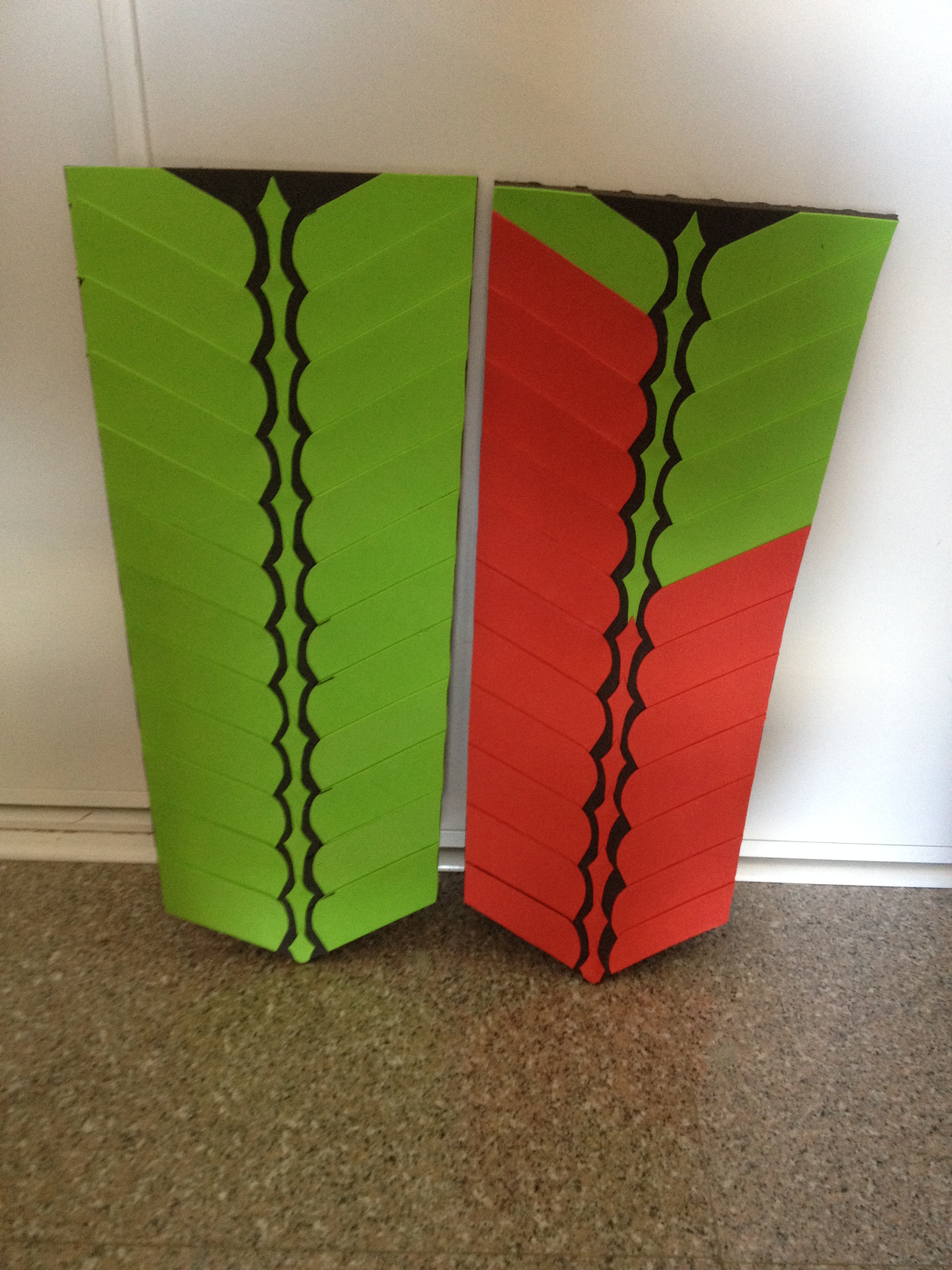

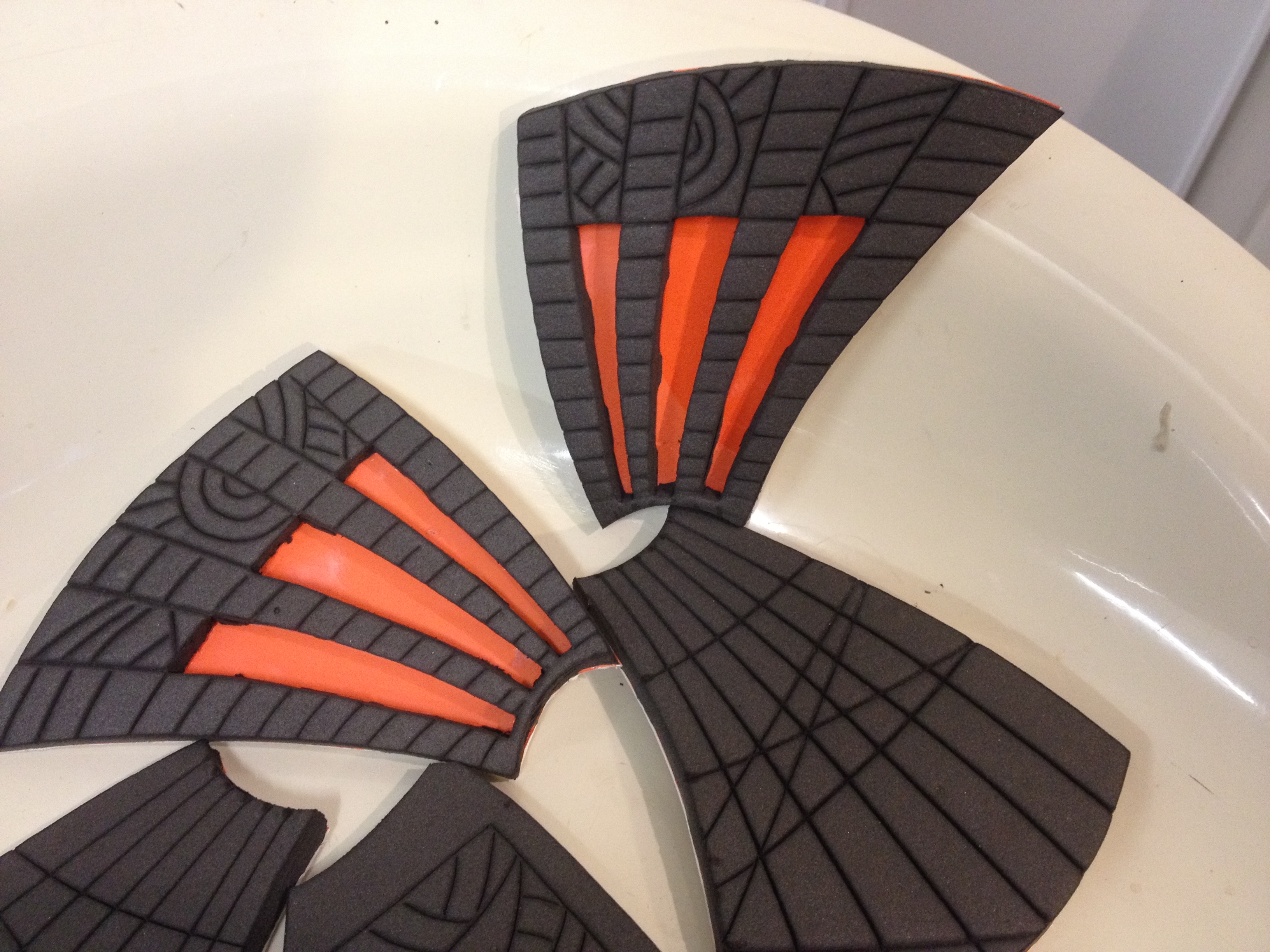

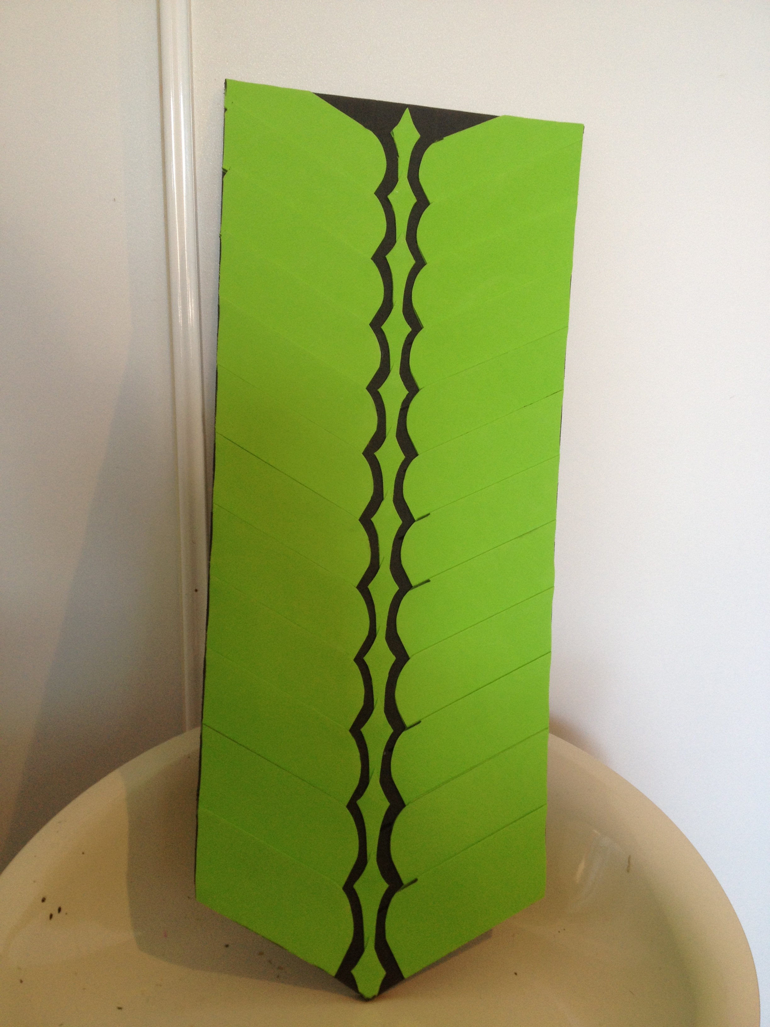

I wasn't happy with the green foam detail, it looked far too flat. Thicker foam was used and I think it looks far better.
More details......

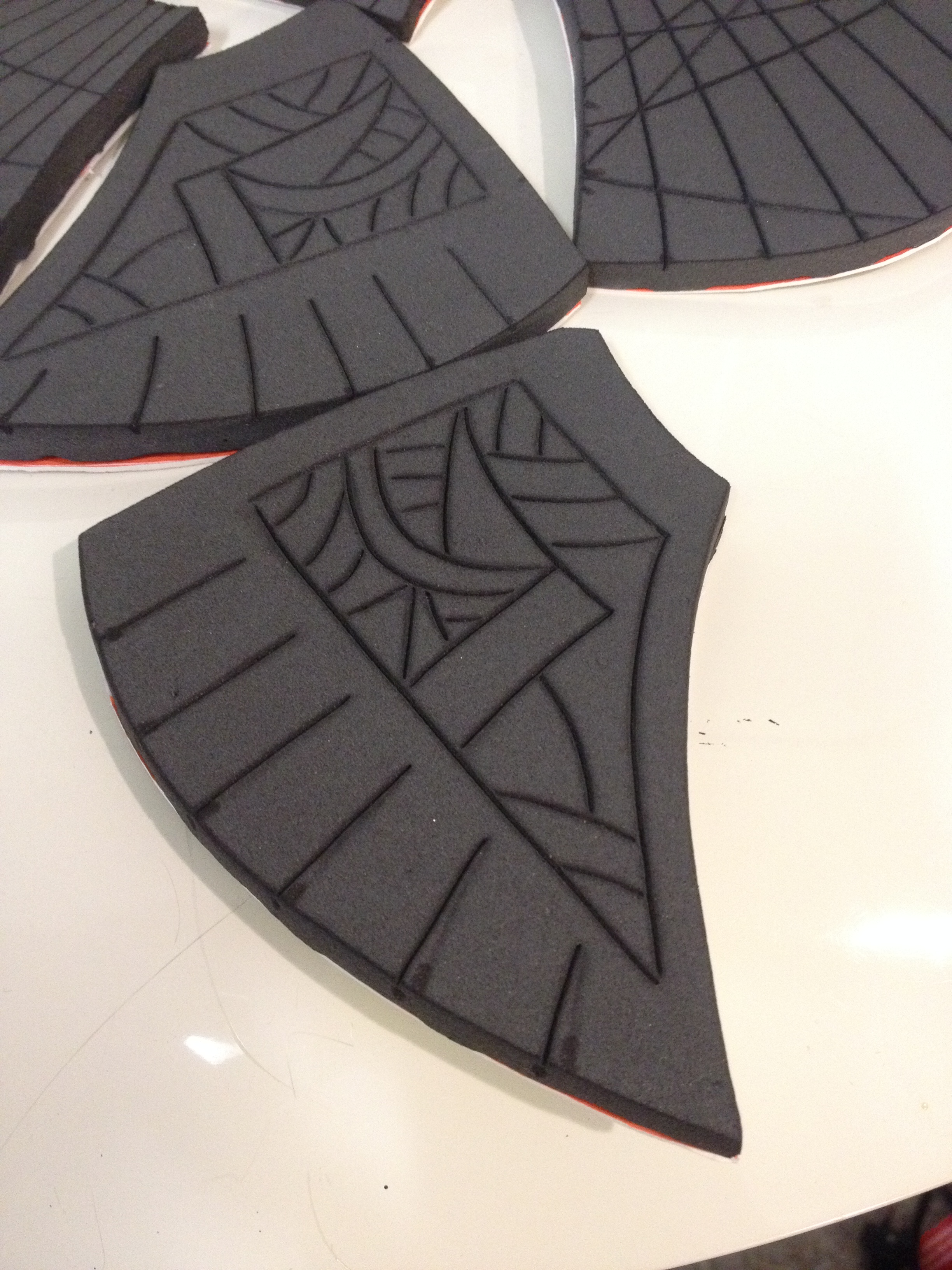

Line work cut in and hit with the heat gun.

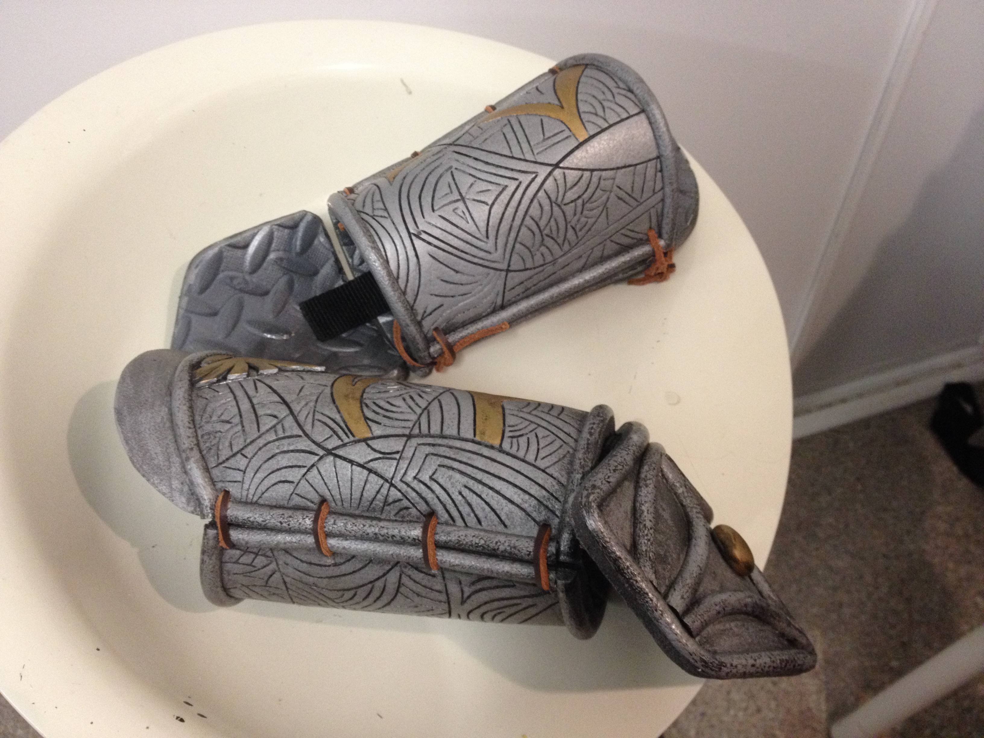

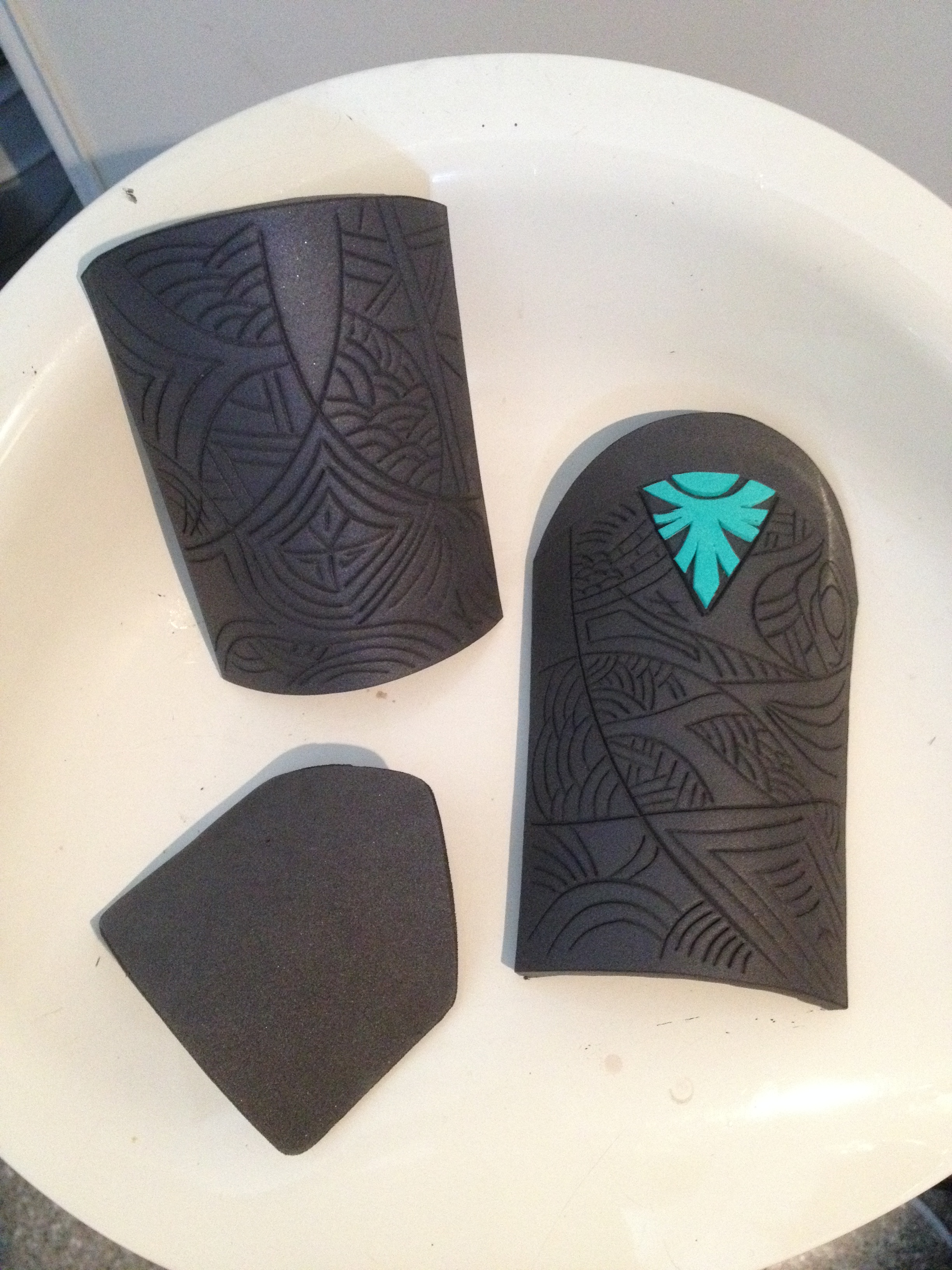

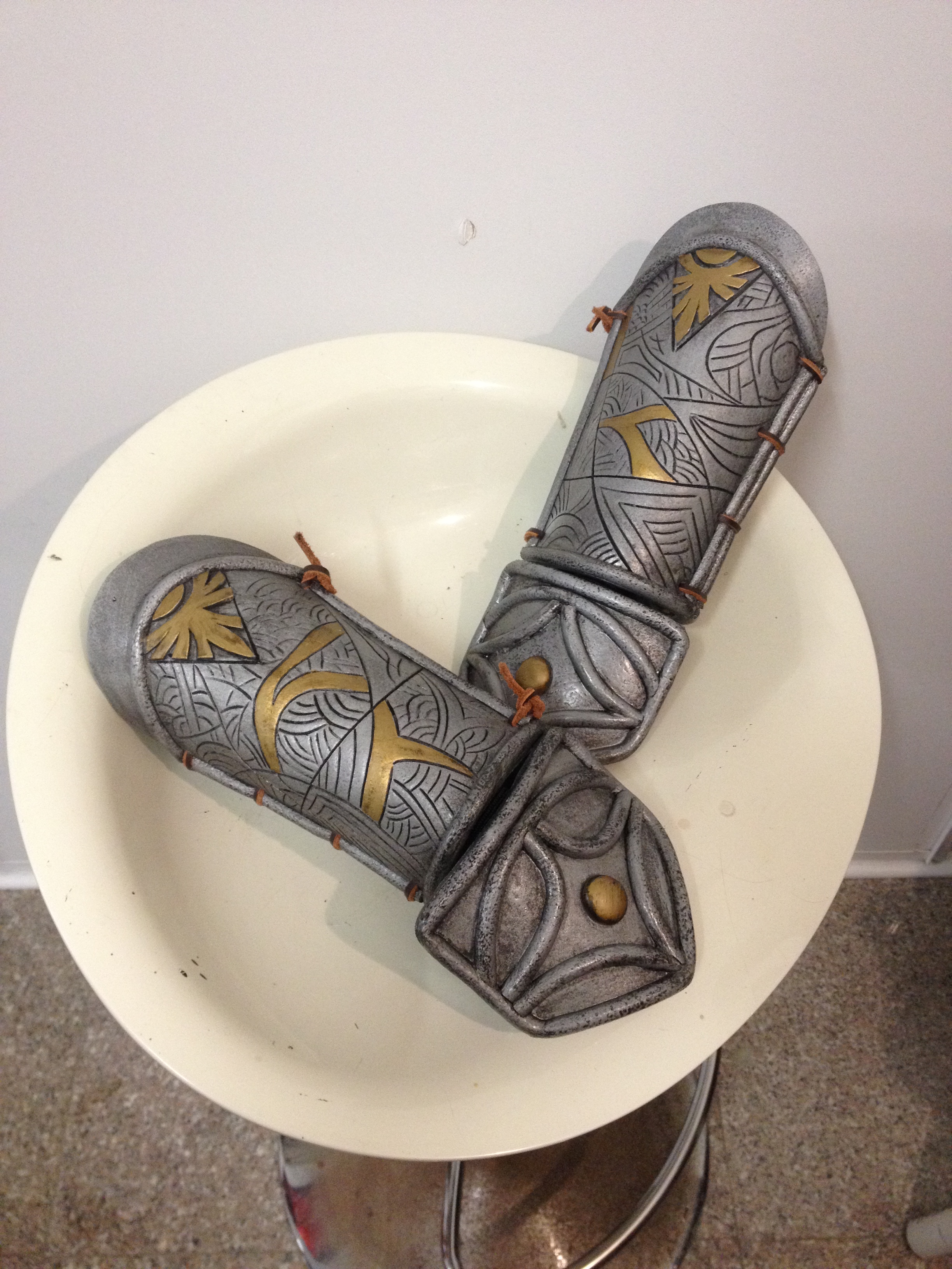

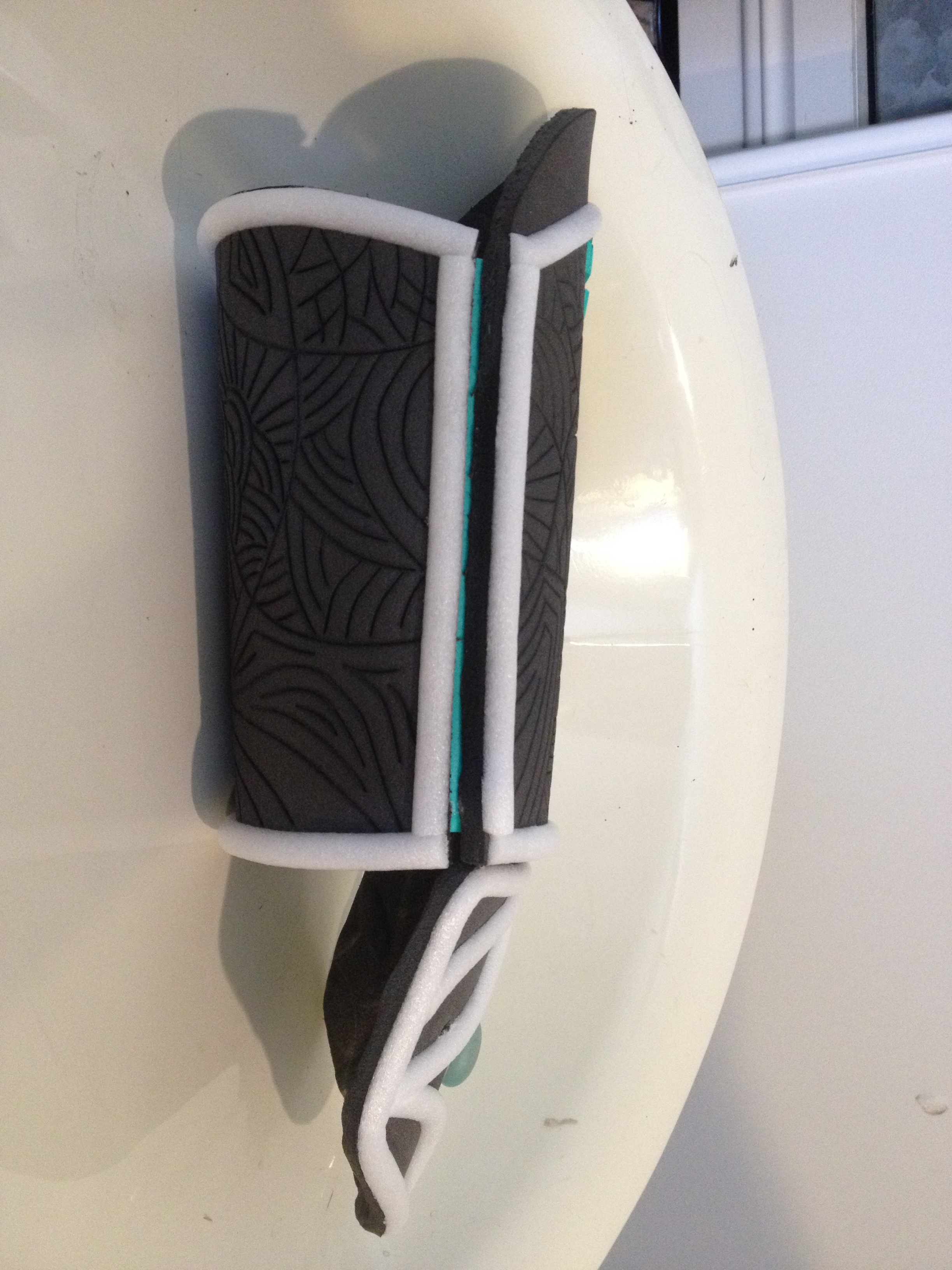

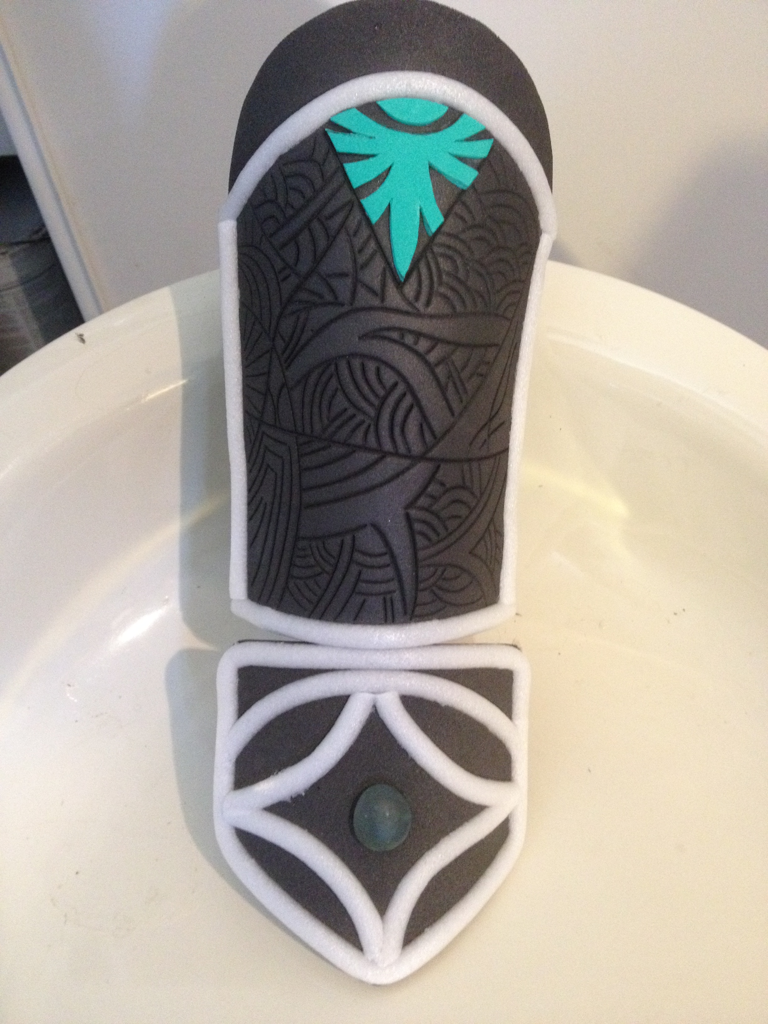

Started work on the gauntlets.

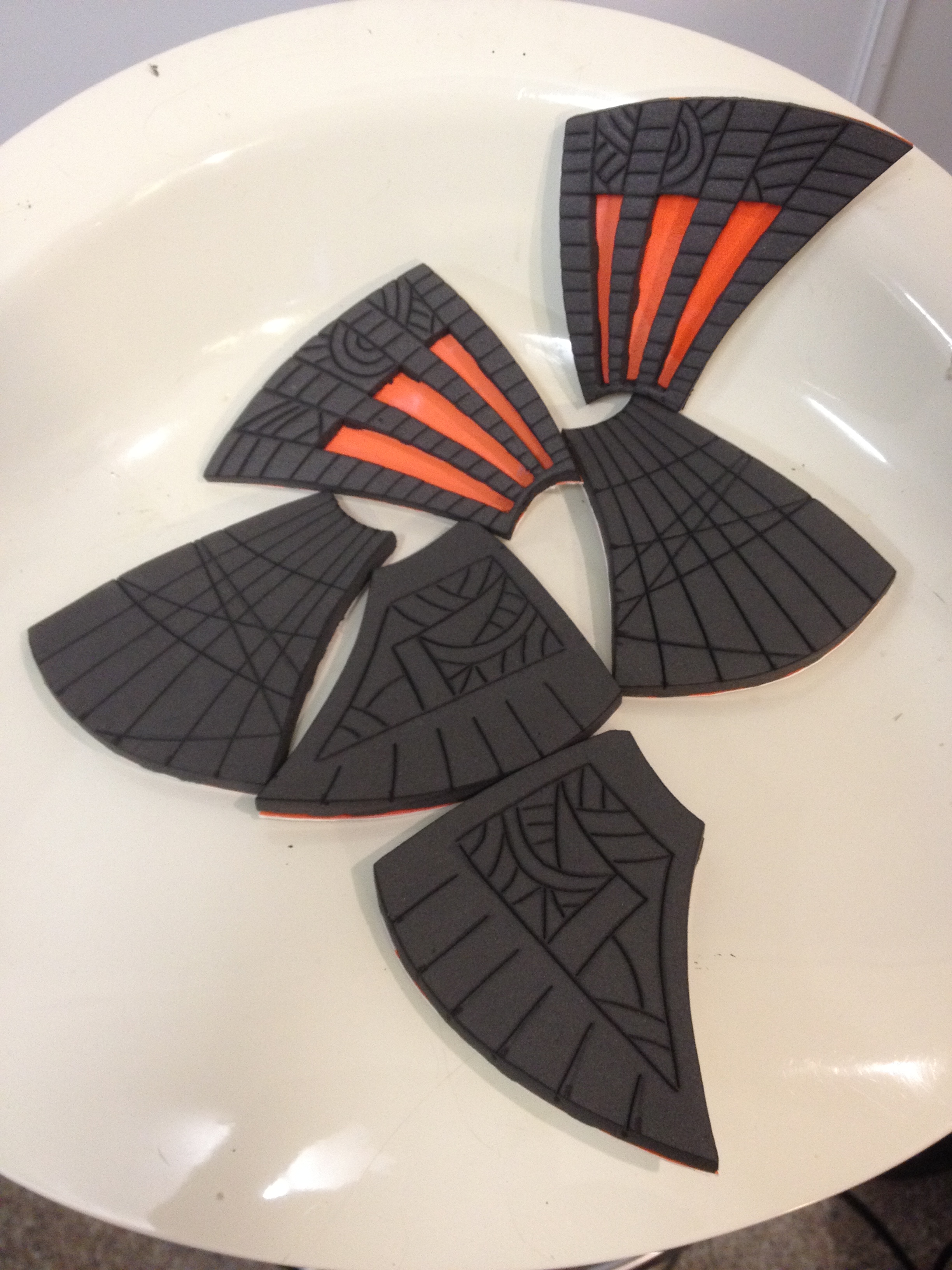

Next on the "to do" list .... chest and back plates.

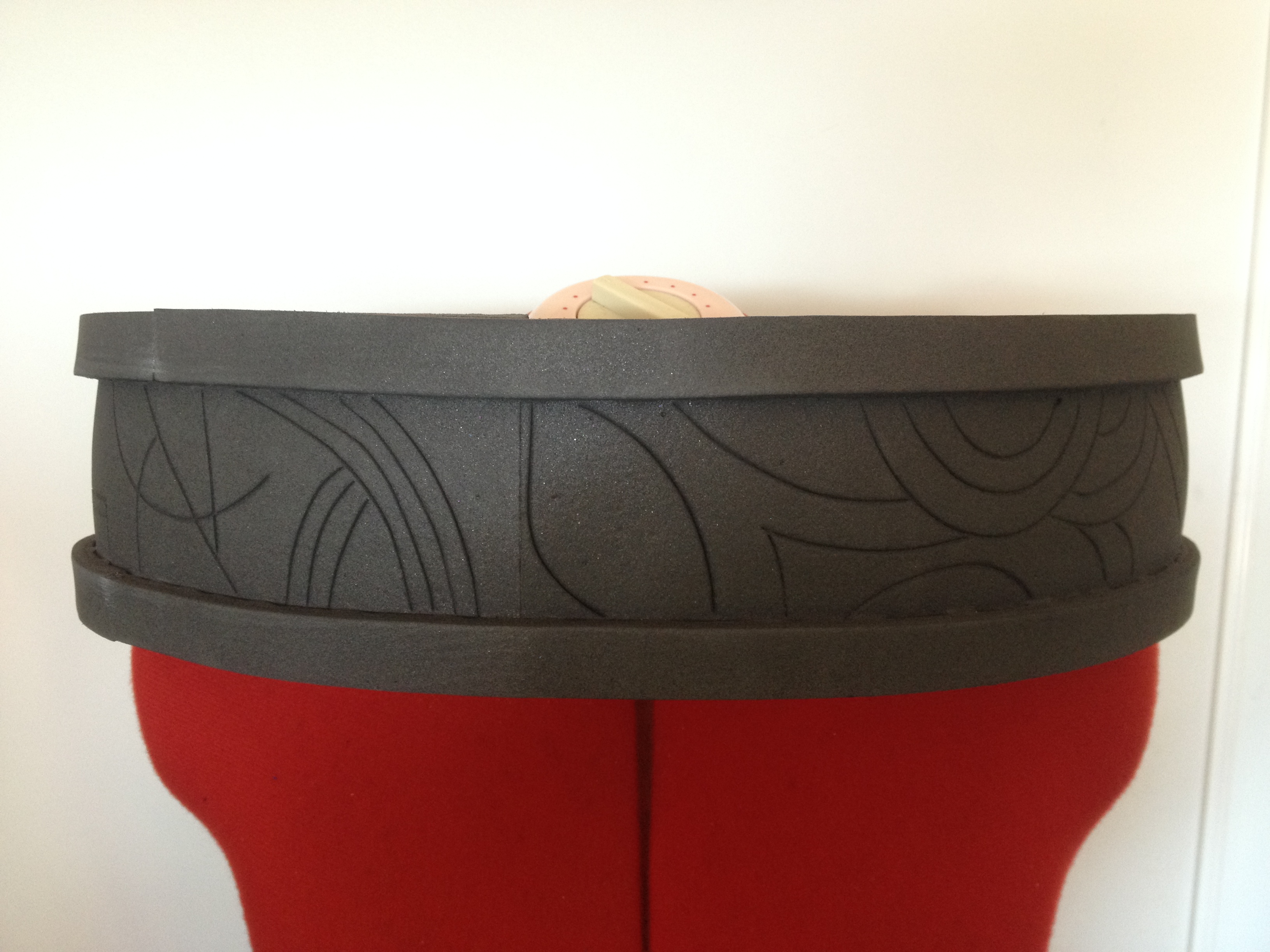

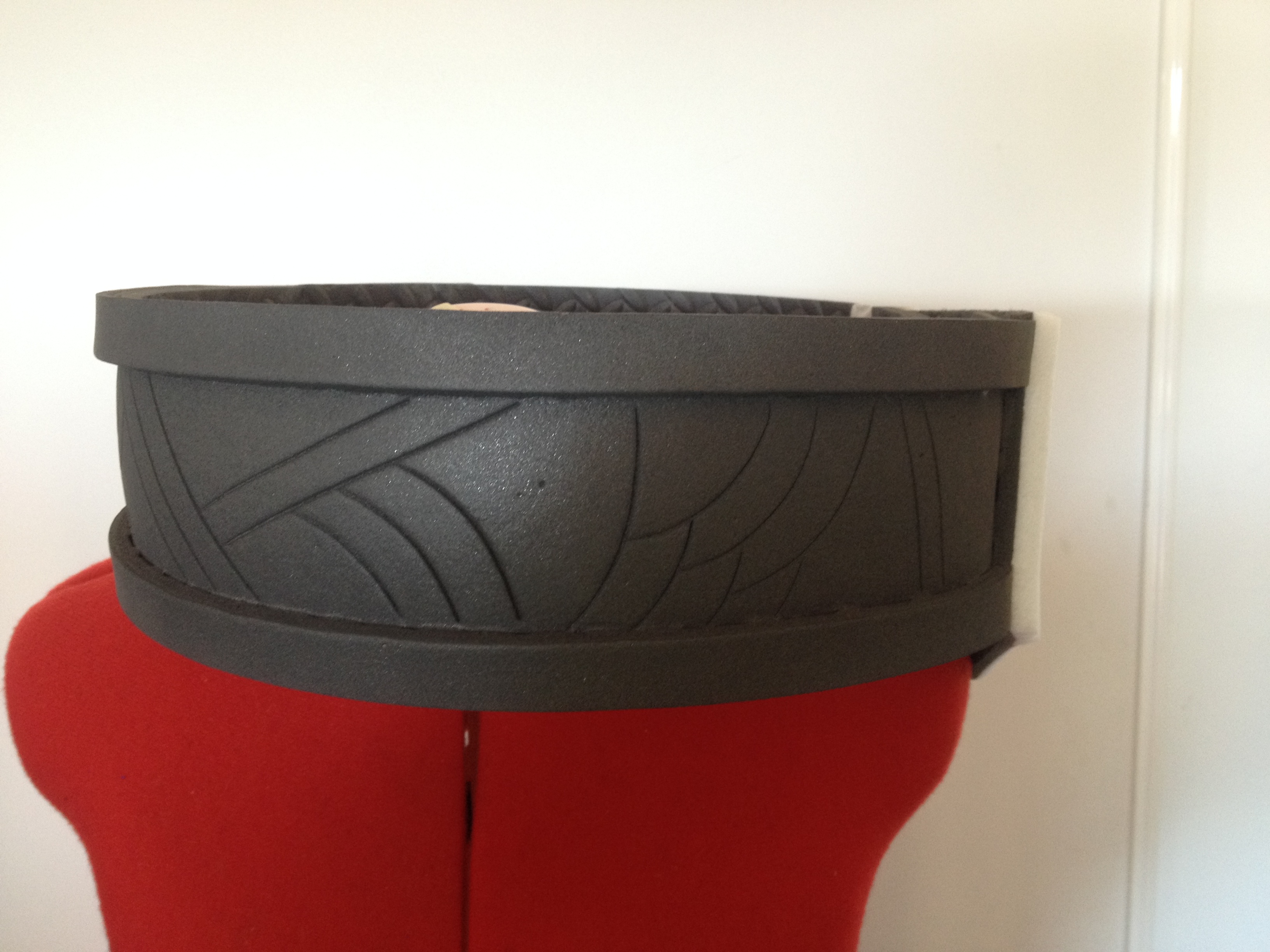

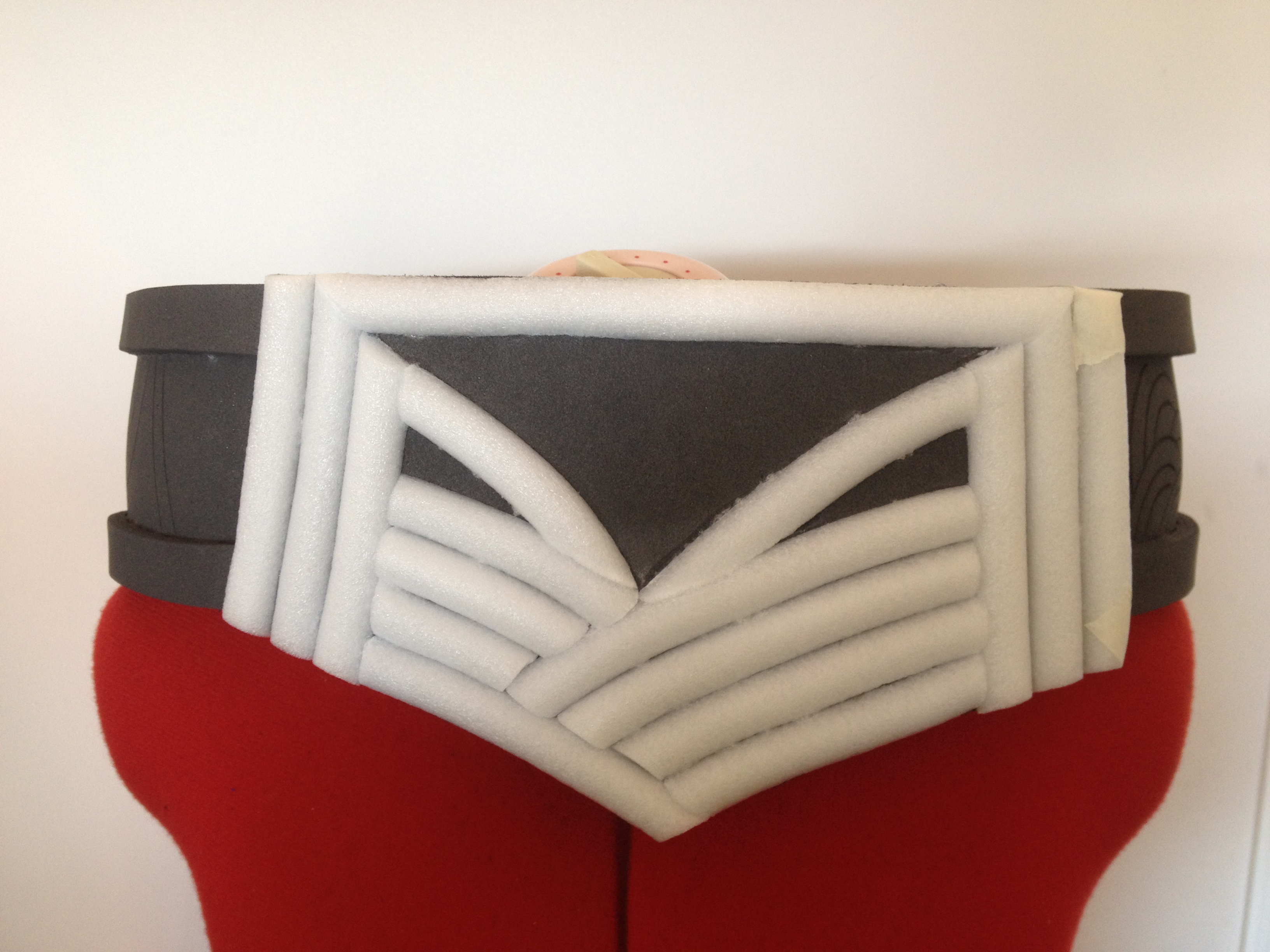

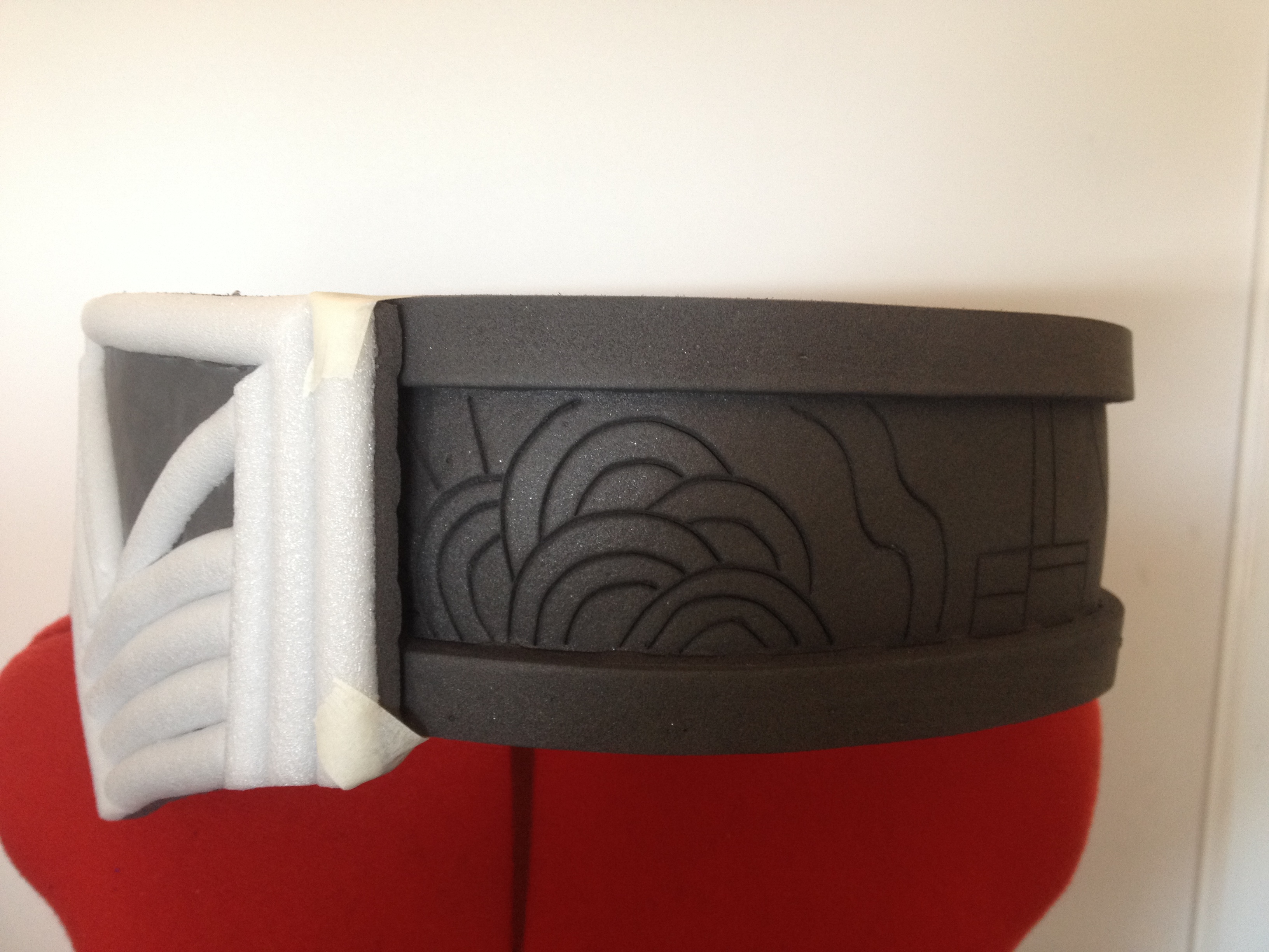

Made the belt and buckle.
Stay tuned ......................................................................

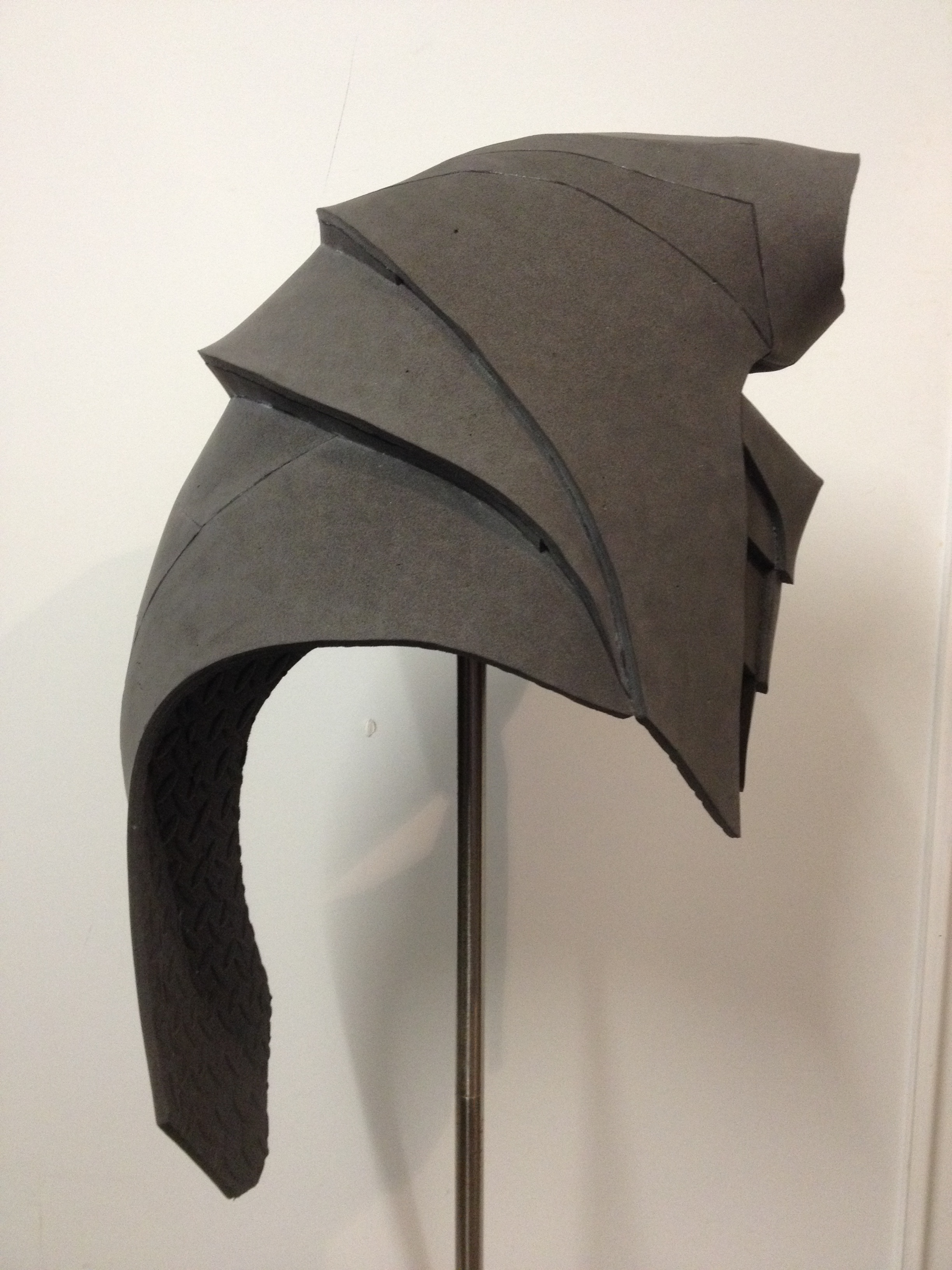

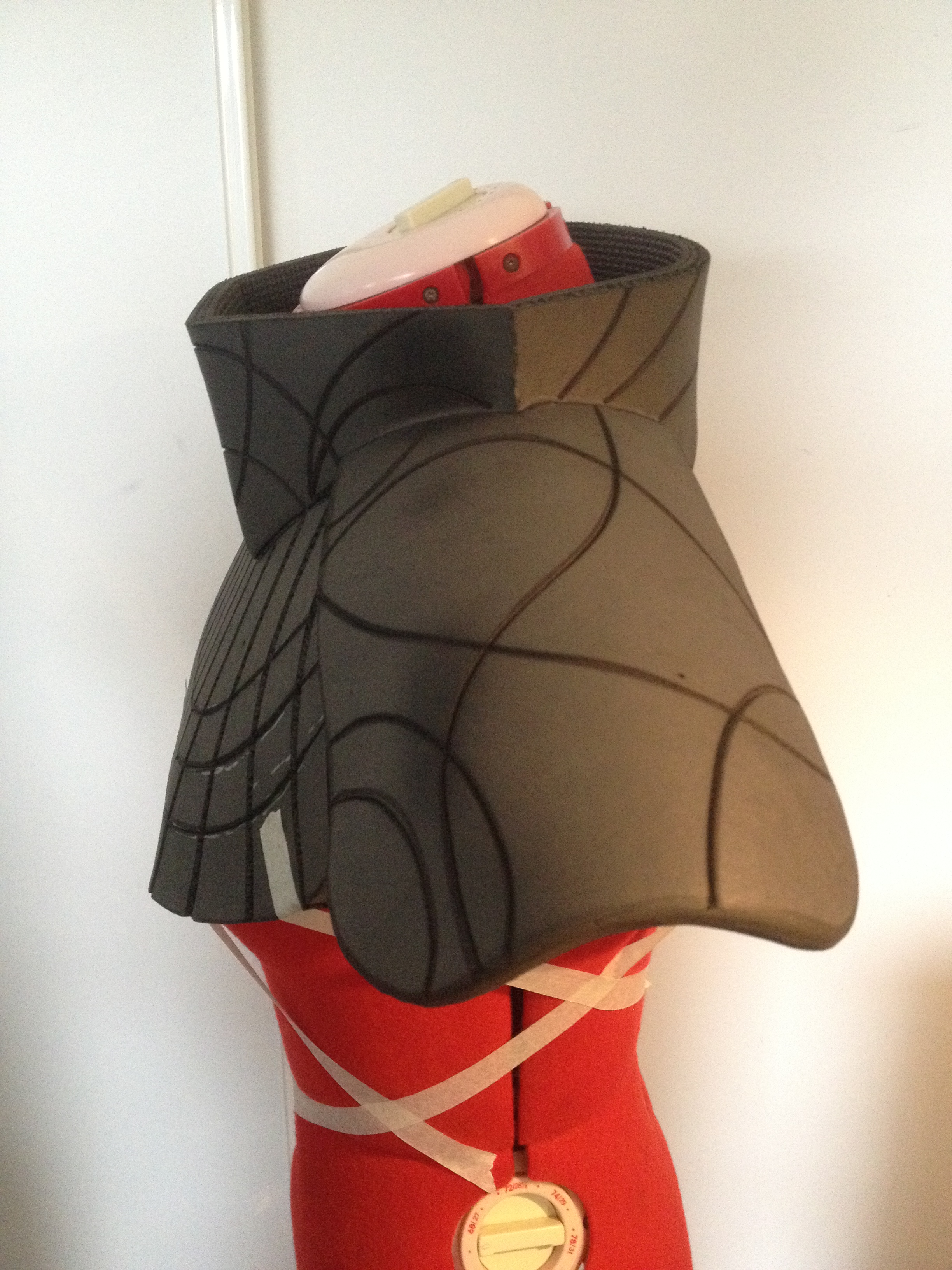

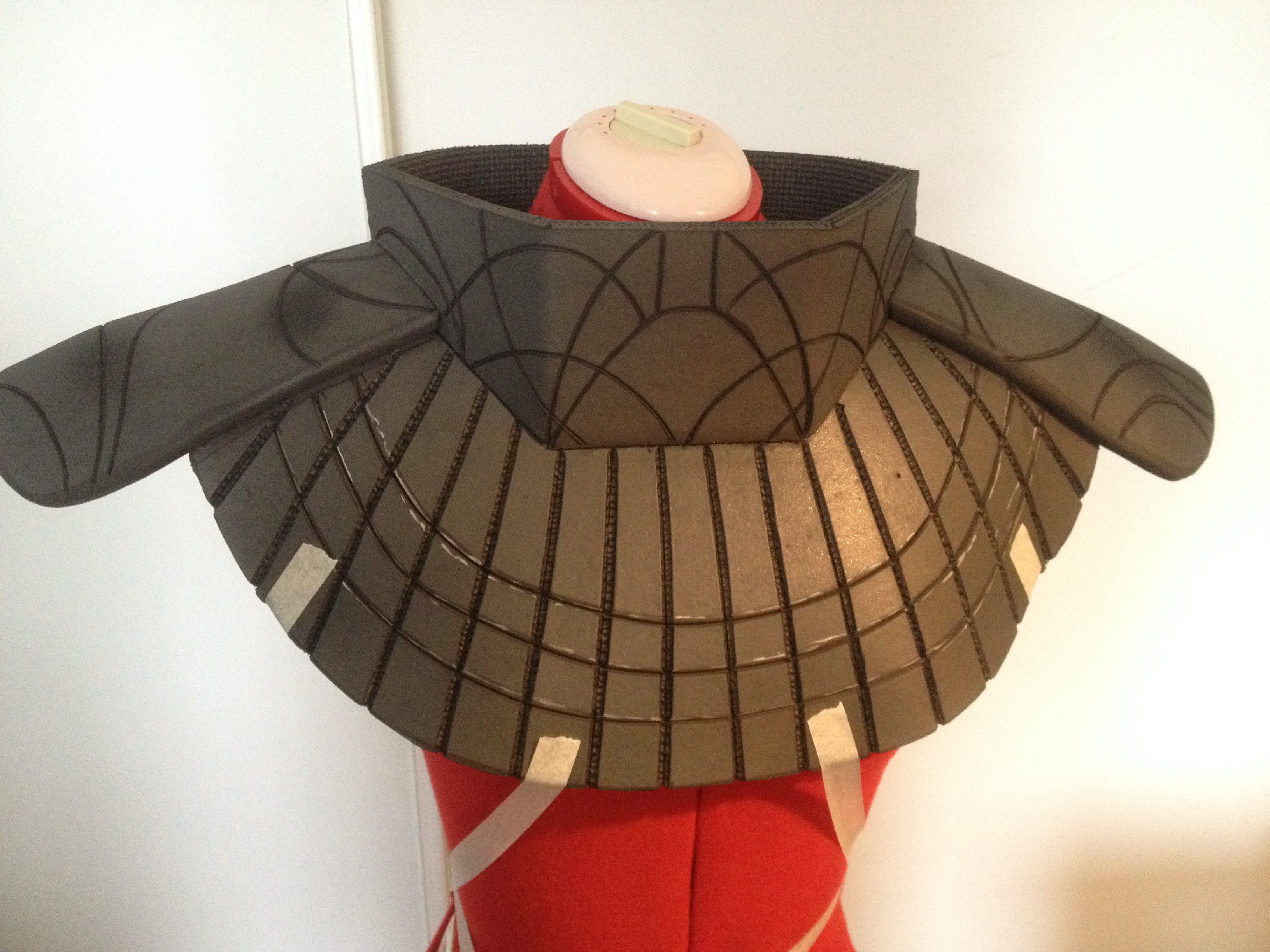

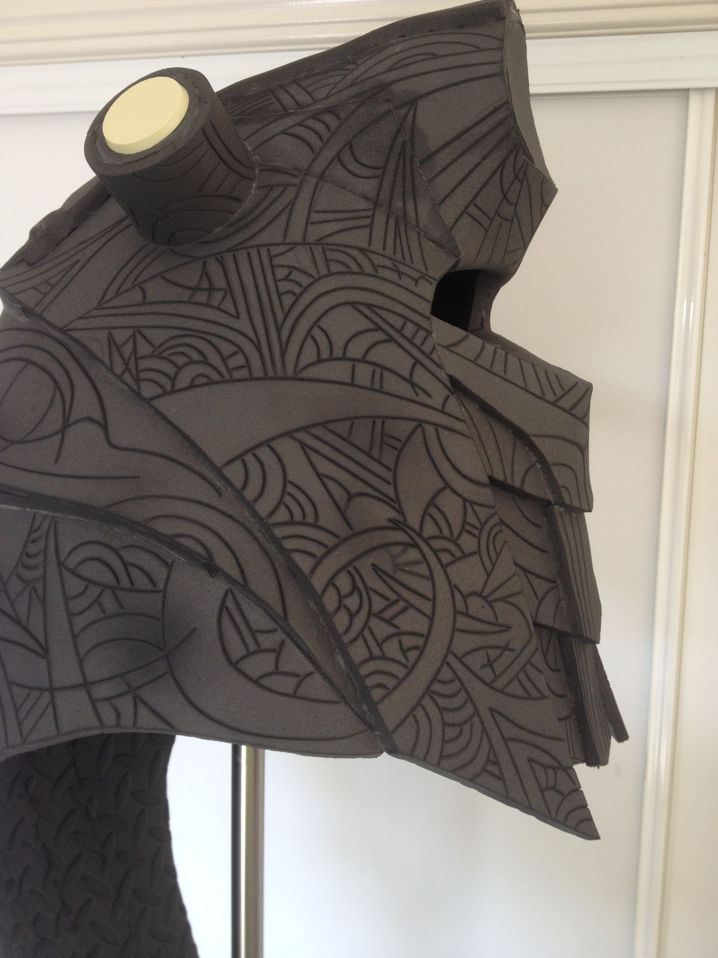

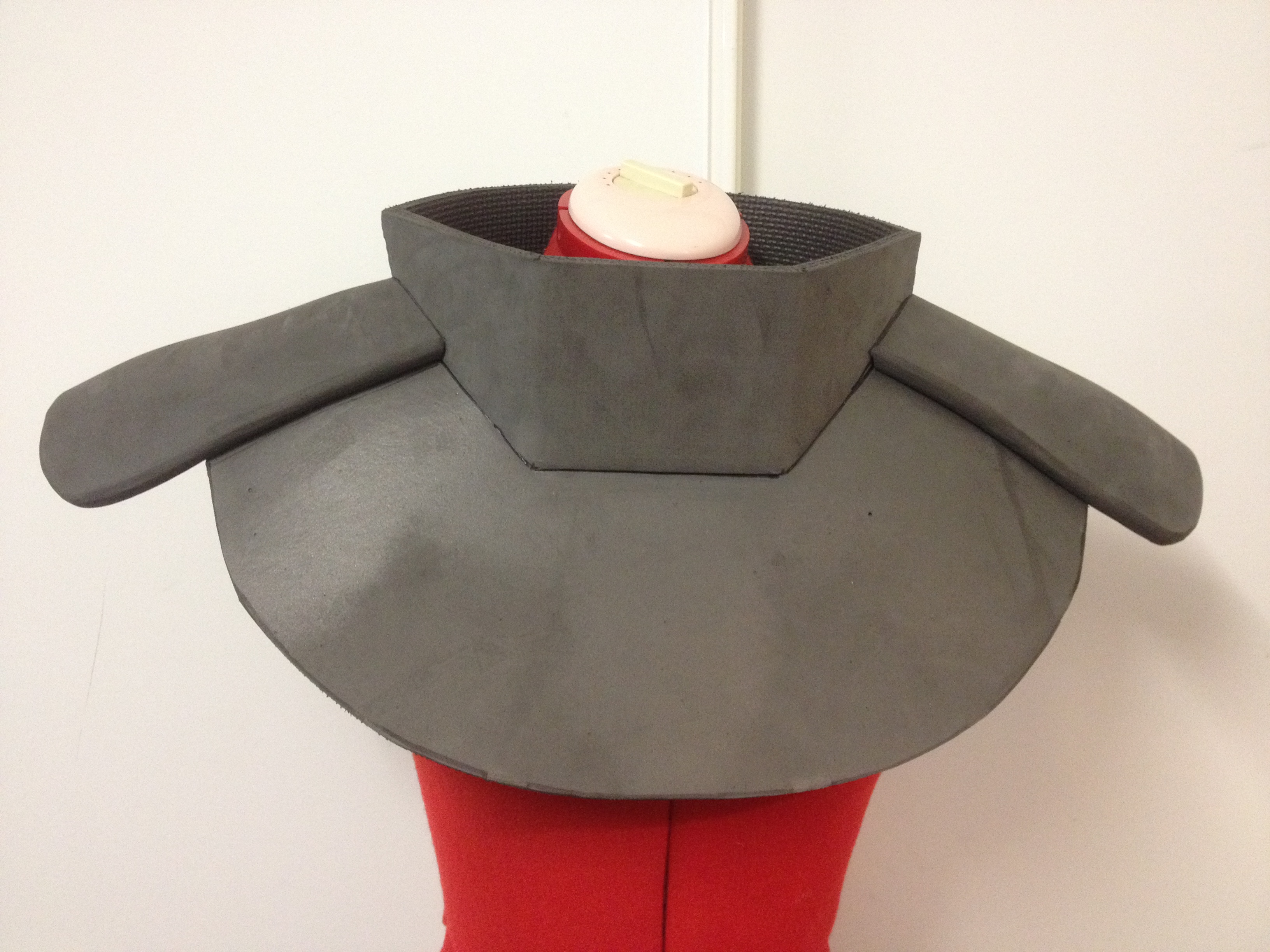

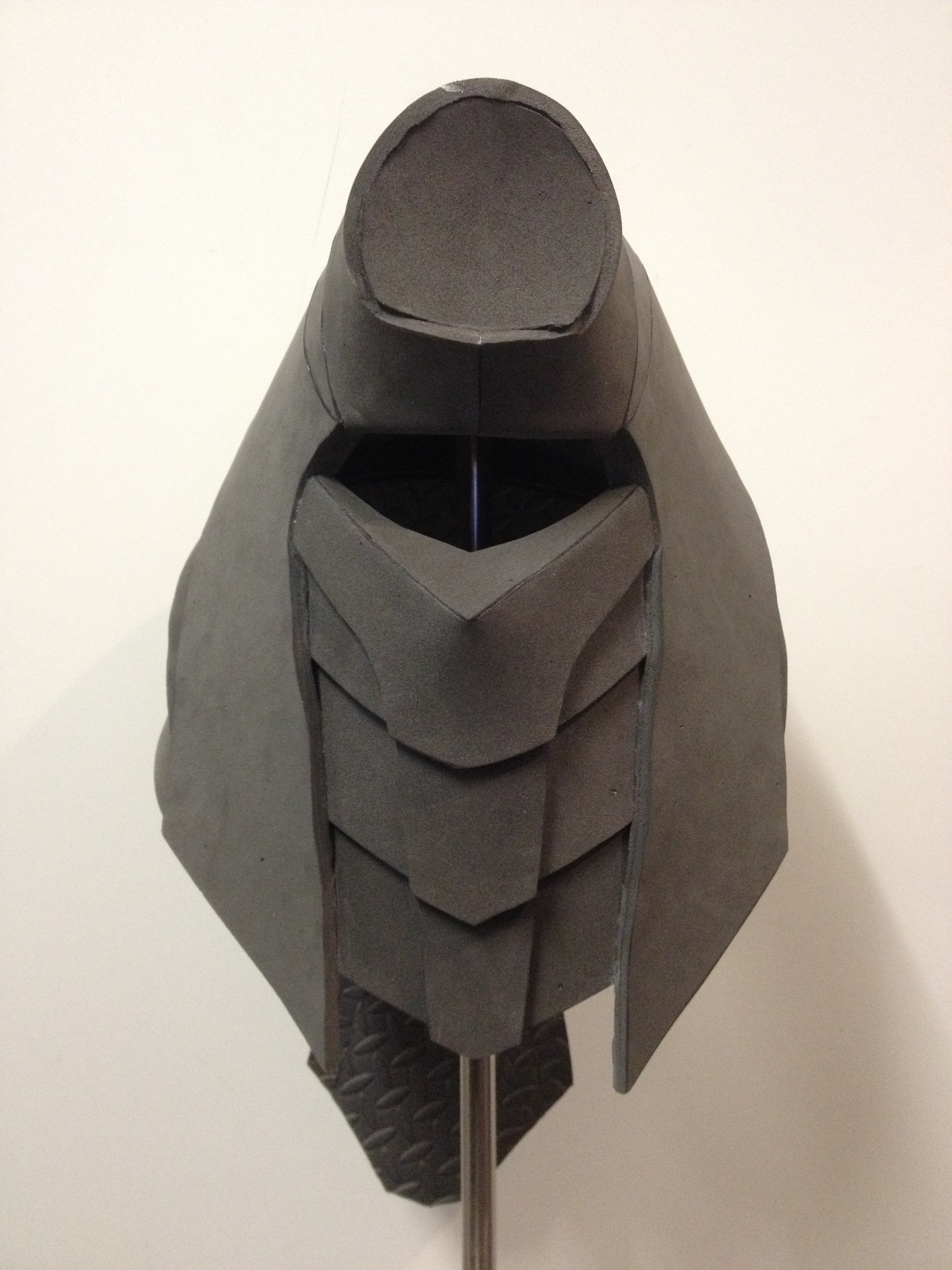

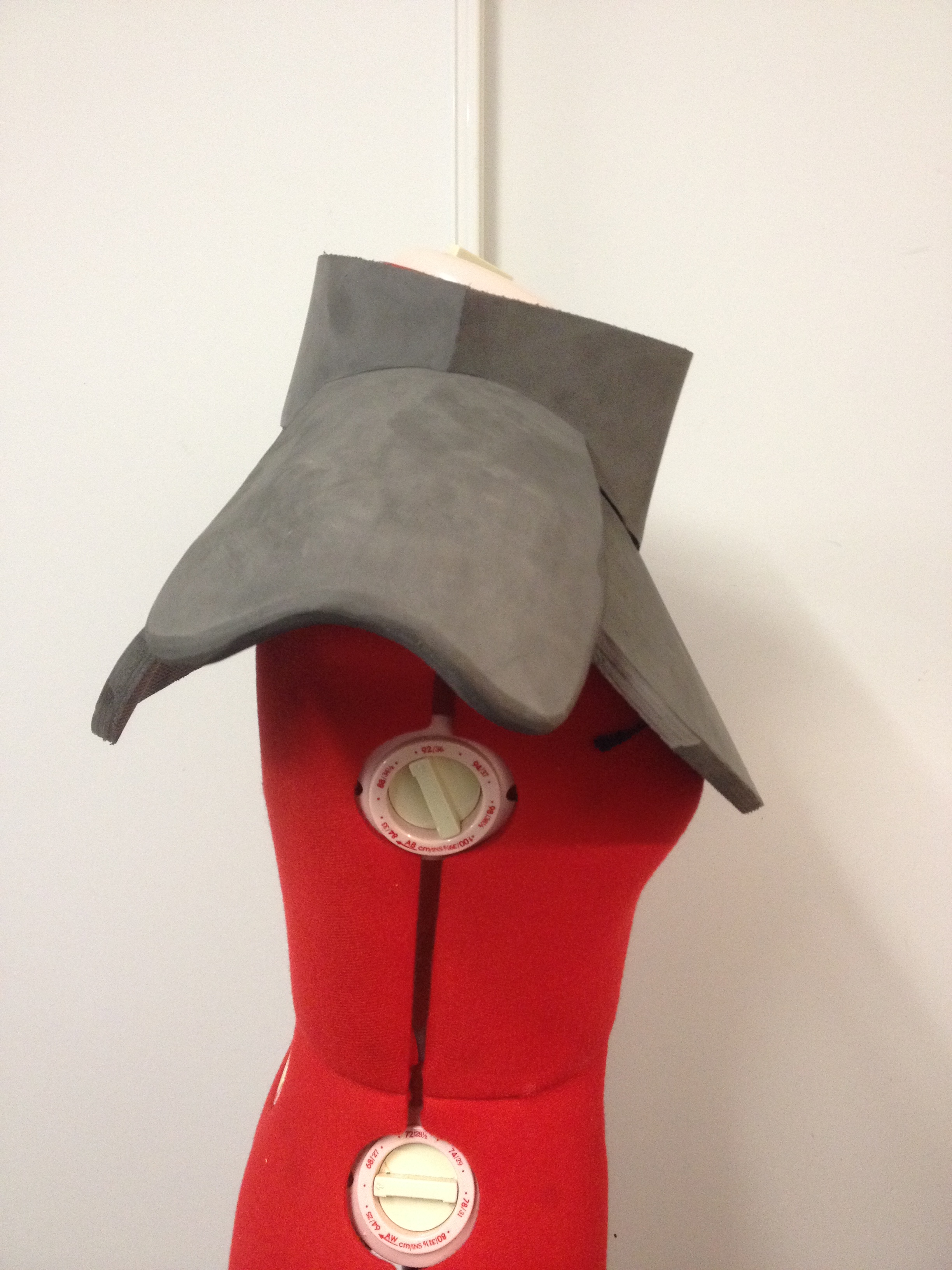

The neck/shoulder armour was next on the list.
I had to employ the help of my wife's dressmakers form to help hold it in shape.

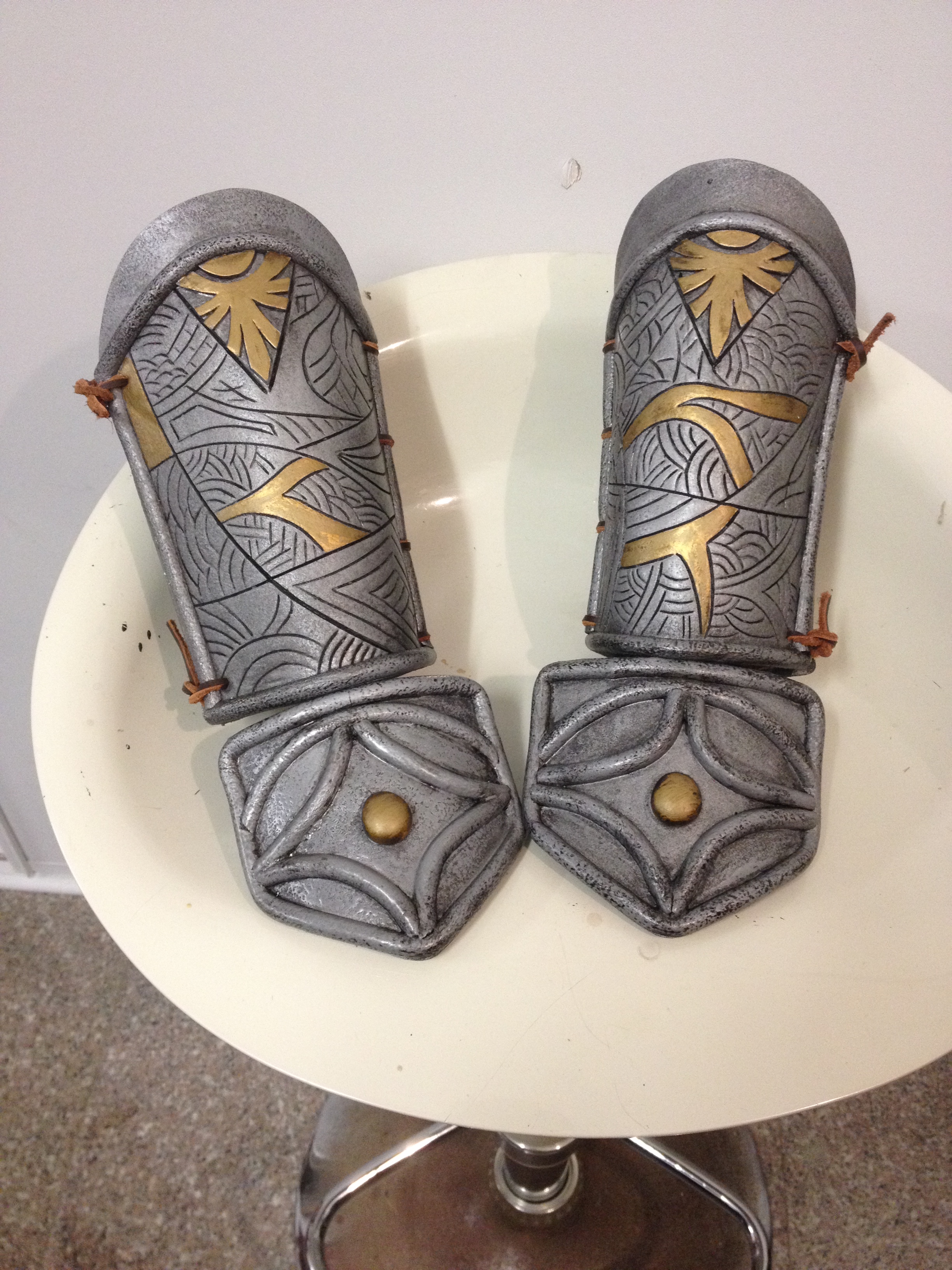

Gauntlets .... painted and leather laces attached.

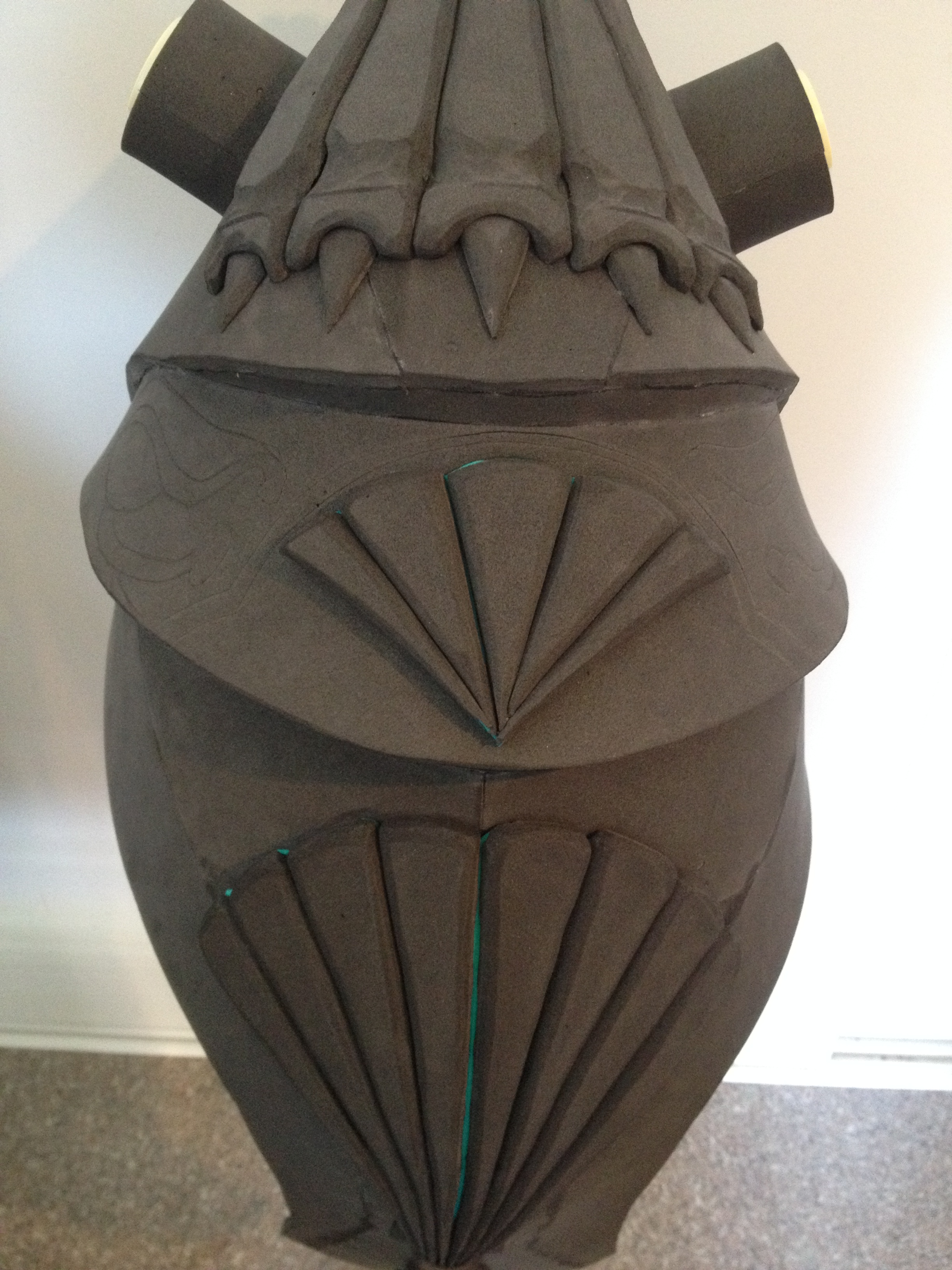

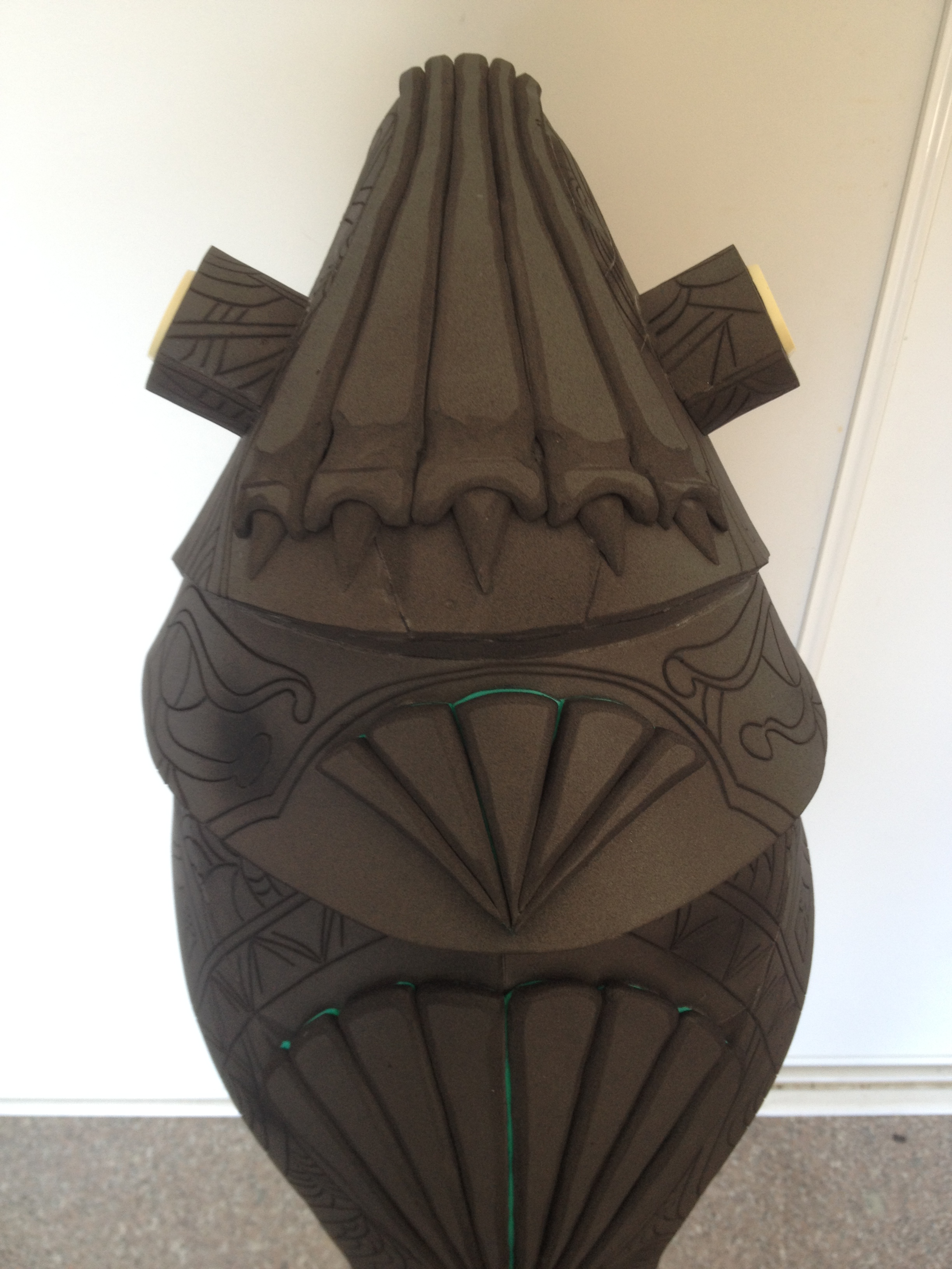

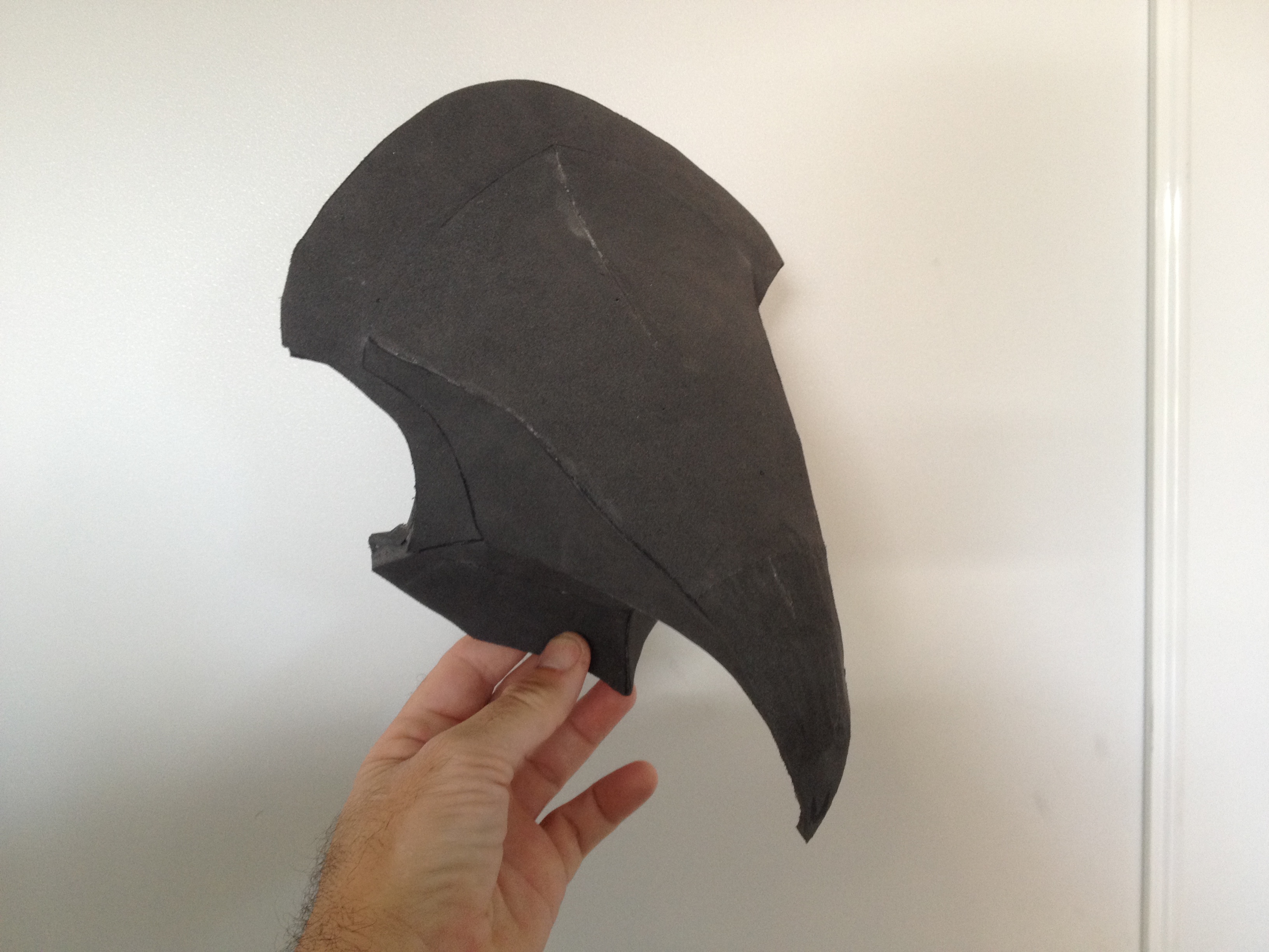

This is looking great. The detail work must take ages cutting it all in. How did you get the detail on the top of the head/neck on the back (in the pictures I've copied)? Did you carve into the foam to get the shapes?

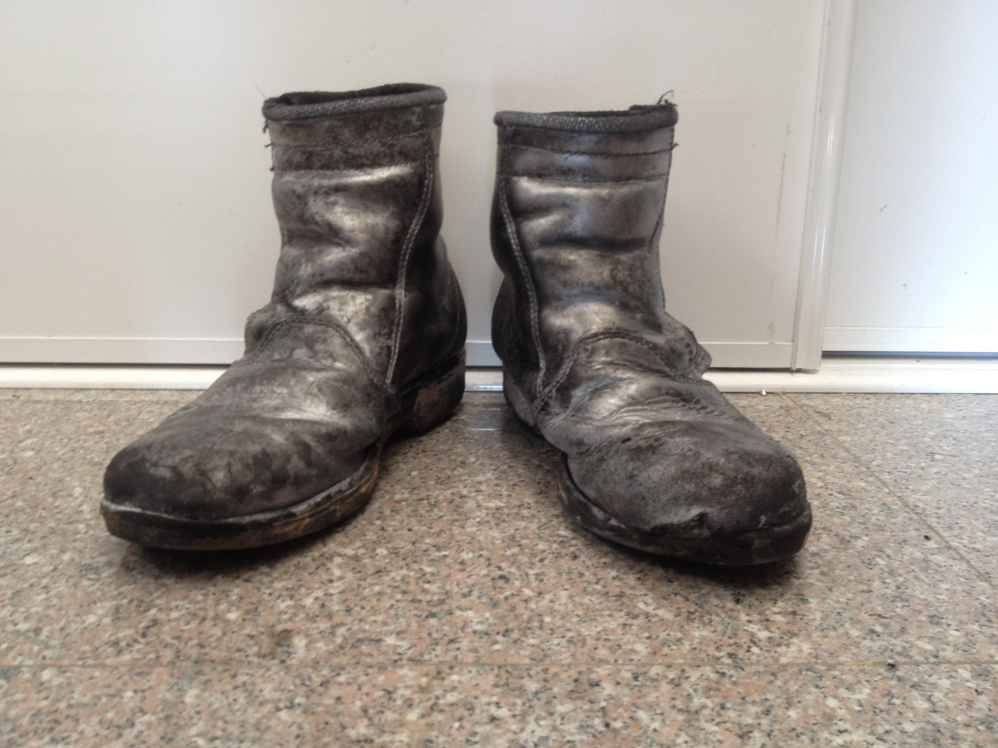

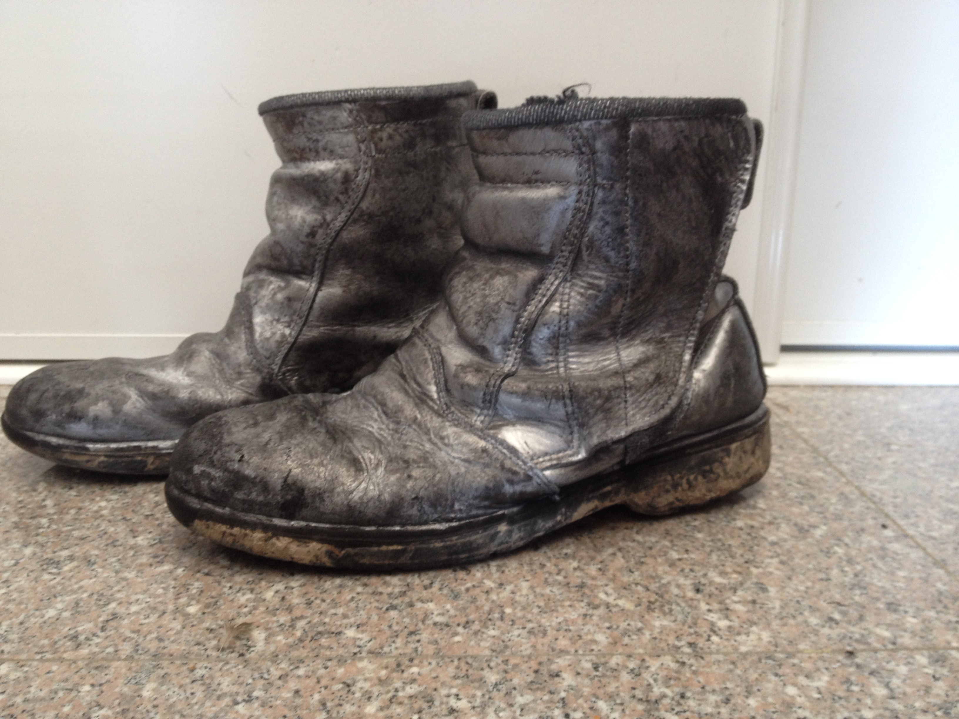

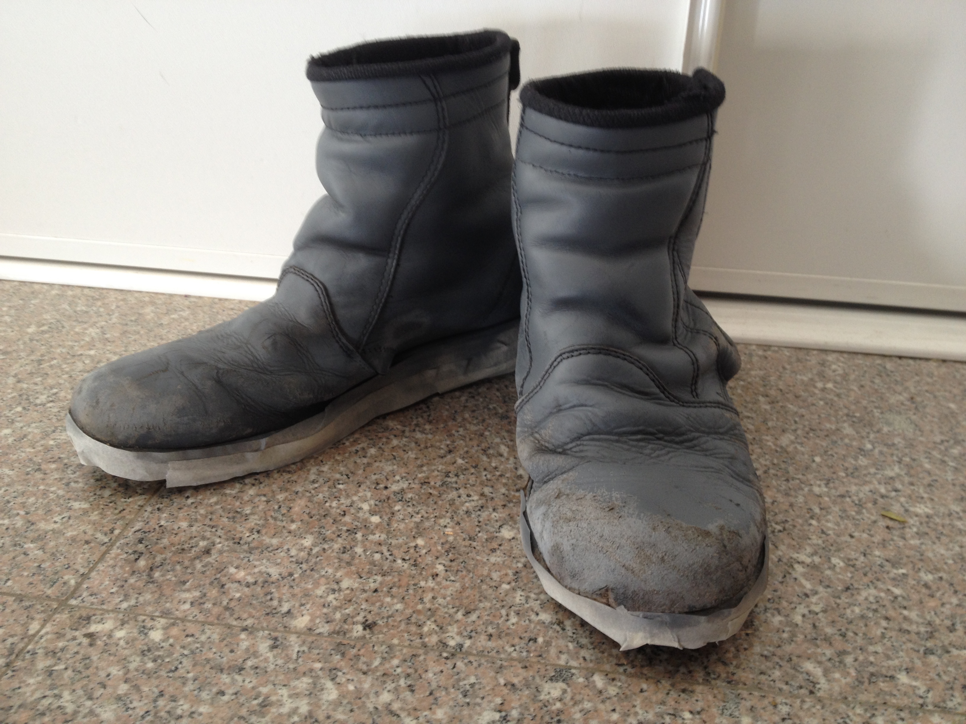

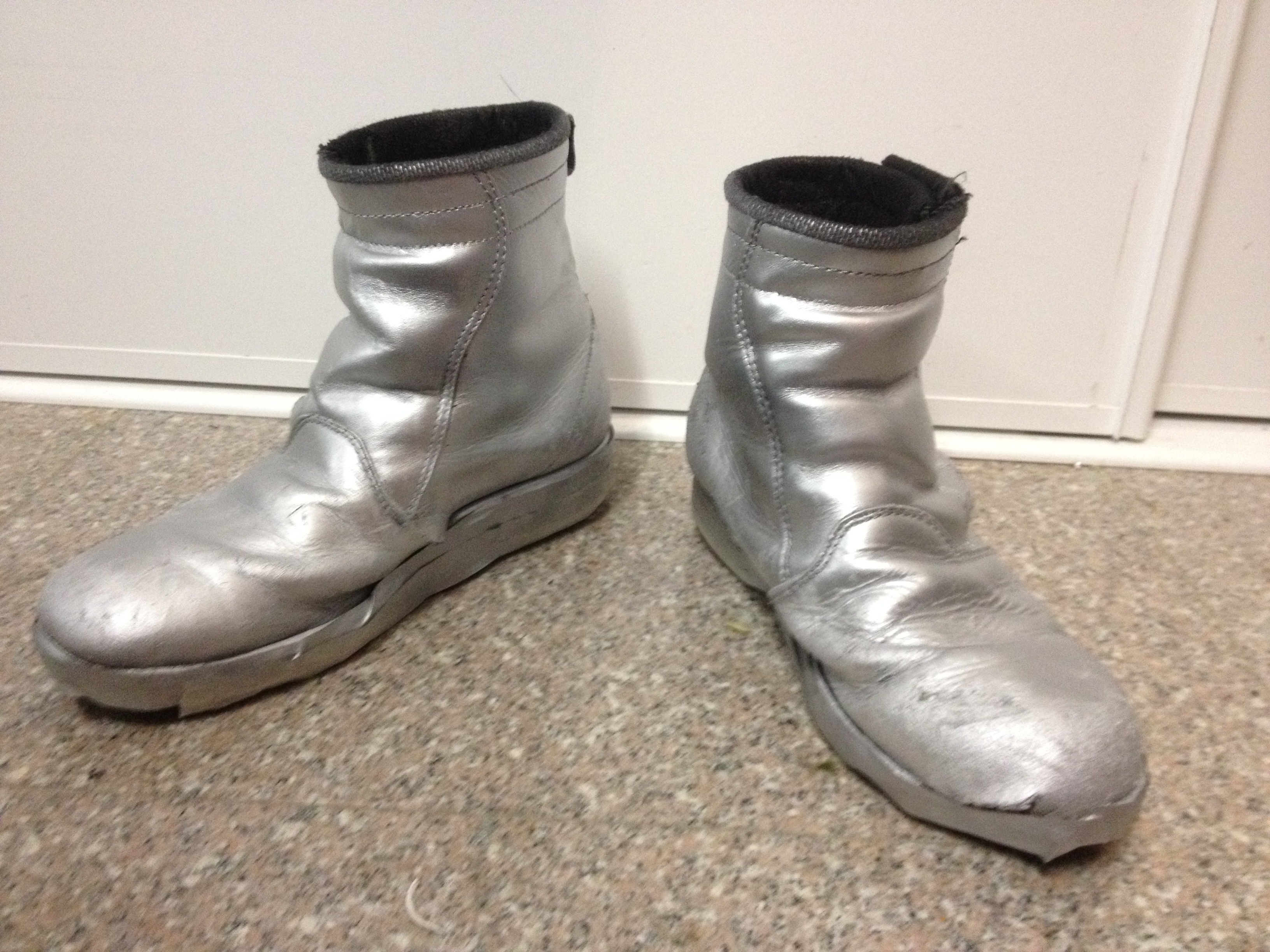

Boots.........
I just used a pair of old motorbike boots I had. Lol...even had old, dry mud on them...perfect weathering ;)
A bit of paint and bam ! Battle worn boots.
Stay tuned ......................................................................................

The raised detail are individual foam pieces cut and carved with a dremel sanding bit and then glued to the main piece.
Even authentic mud. You're going all out there.
Detail is looking great on the shoulders. Must take a while to cut all that in.

Details don't take that long to do..... I use a sharp blade to slice in a line, 2-3mm in depth and then run a heat gun over the slices. The heat "shrinks" the foam and gives you nice, clean lines.
