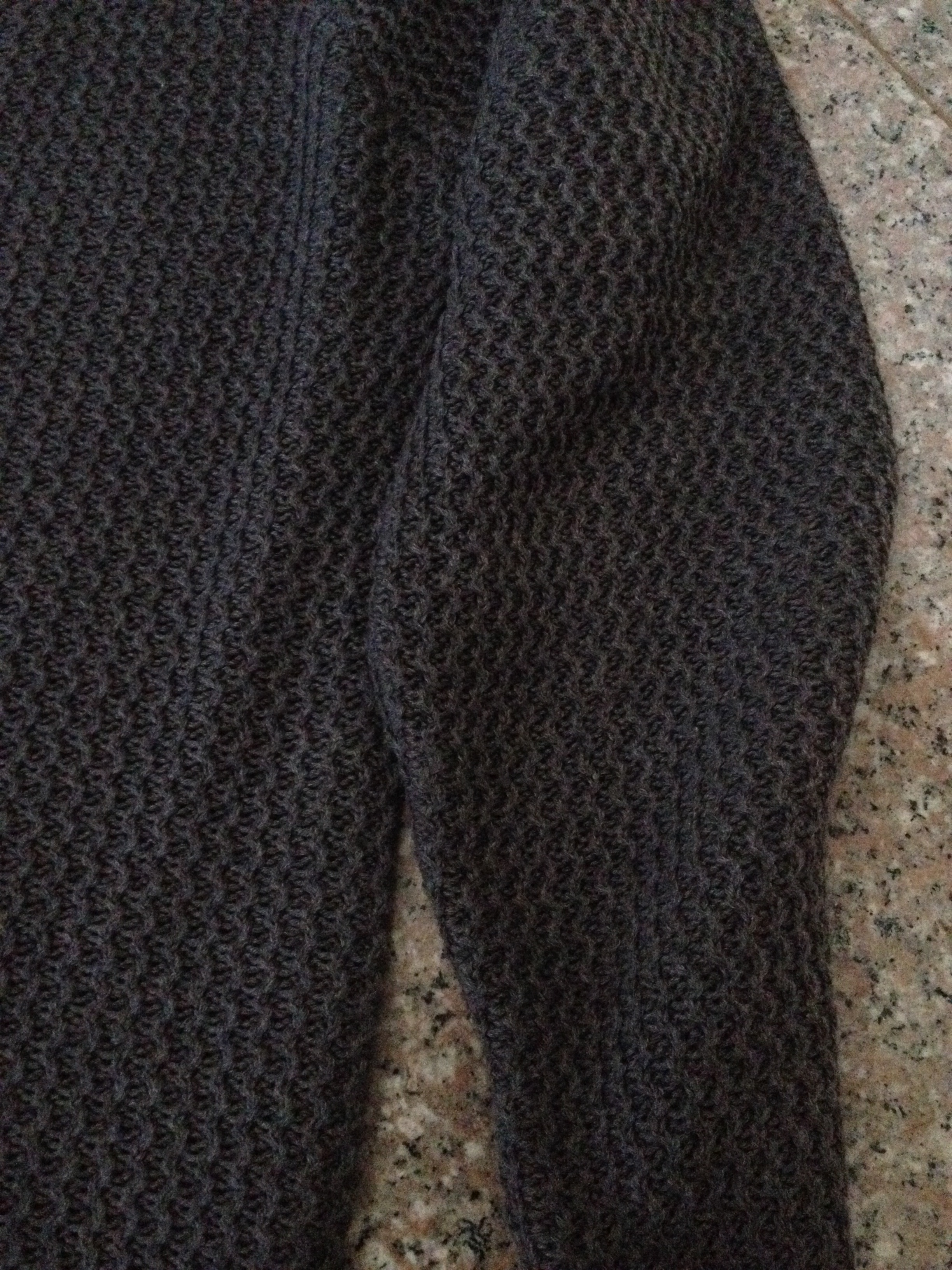

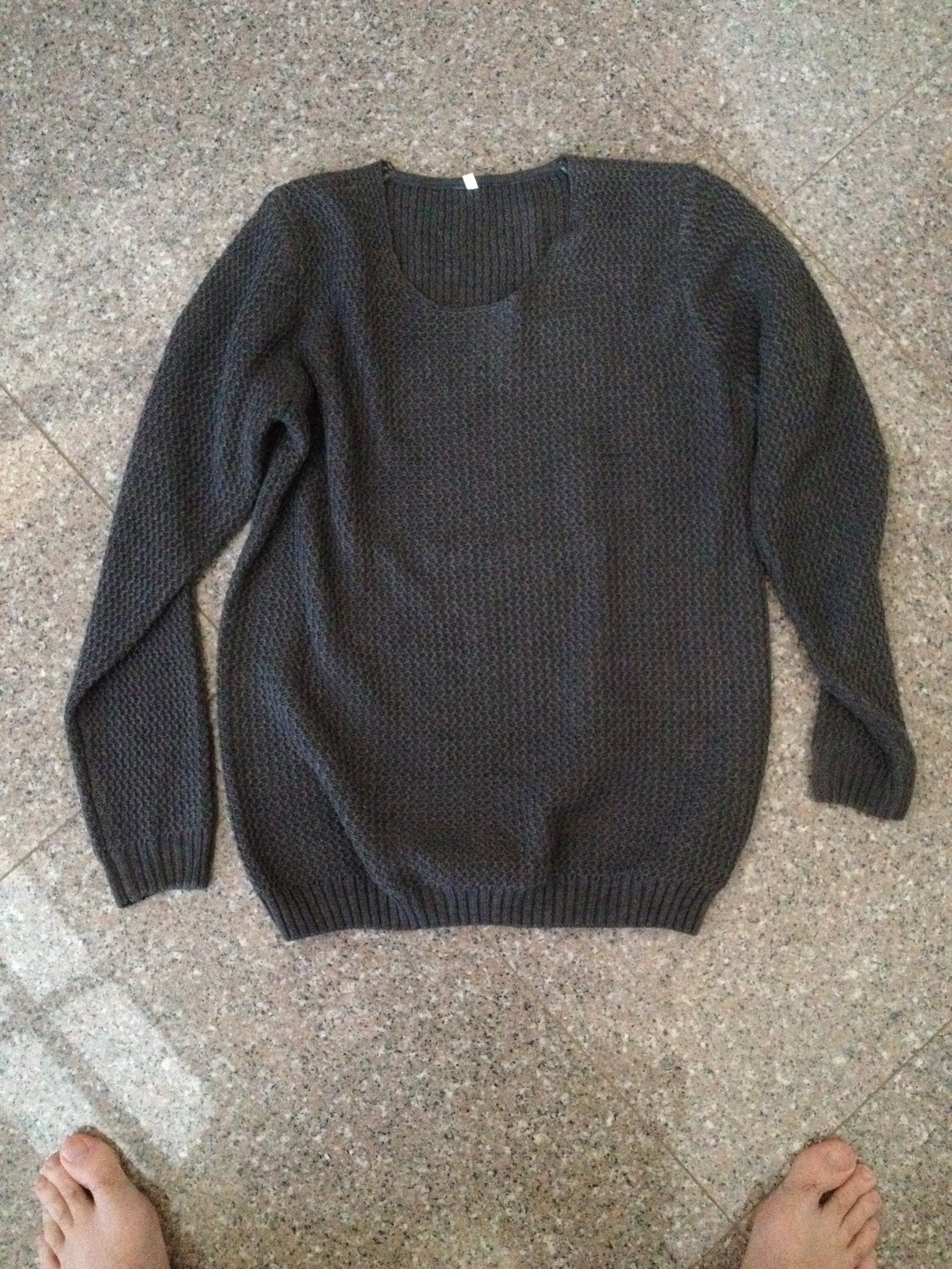

I read that the chainmail suits used in the show were actually knitted wool jumpers and pants, thinking this would be a easy and light alternative to real chainmail I started a hunt for a decent jumper ( I couldn't knit to save my life, nor no I have the time).
Found a decent jumper with a "chainmail" look to it.... ordered 2 ... One for the top and one to be cut up and made intochausses (leg mail).

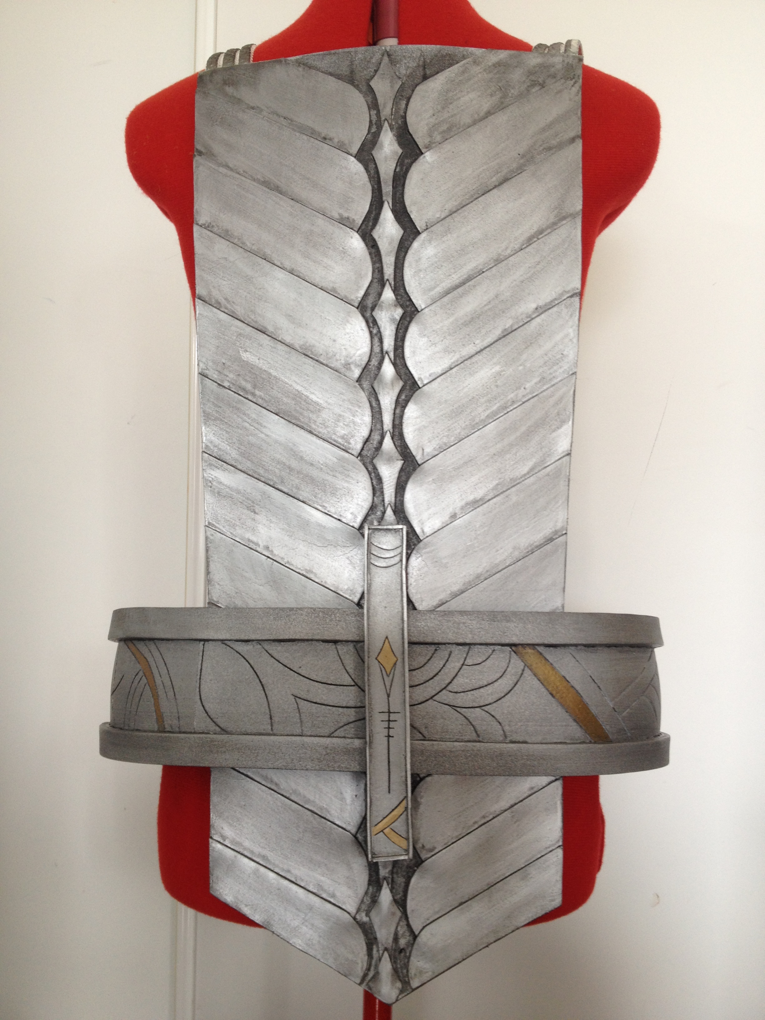

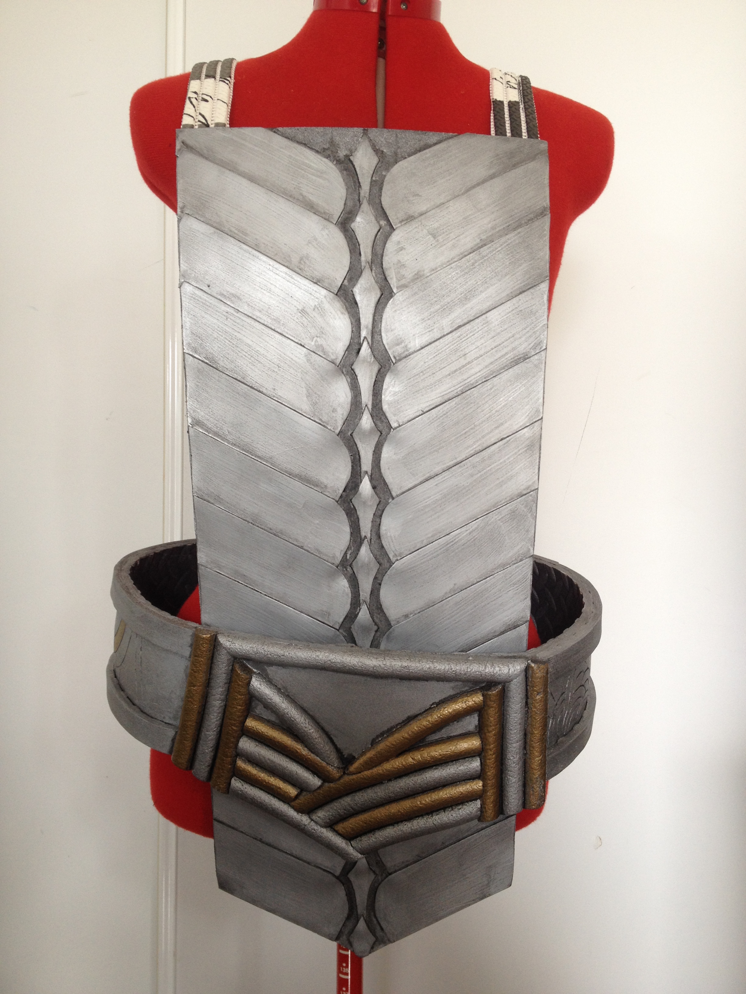

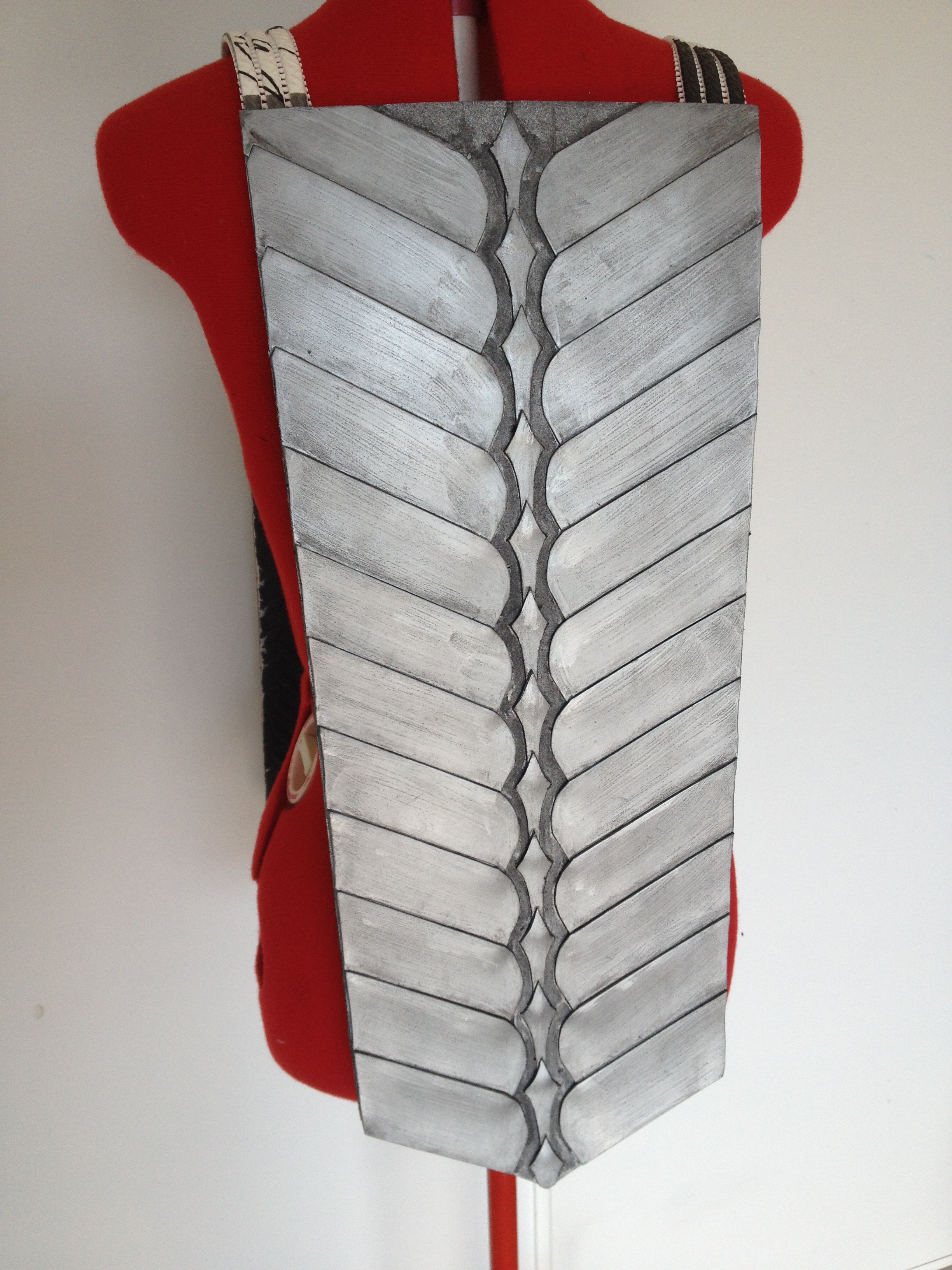

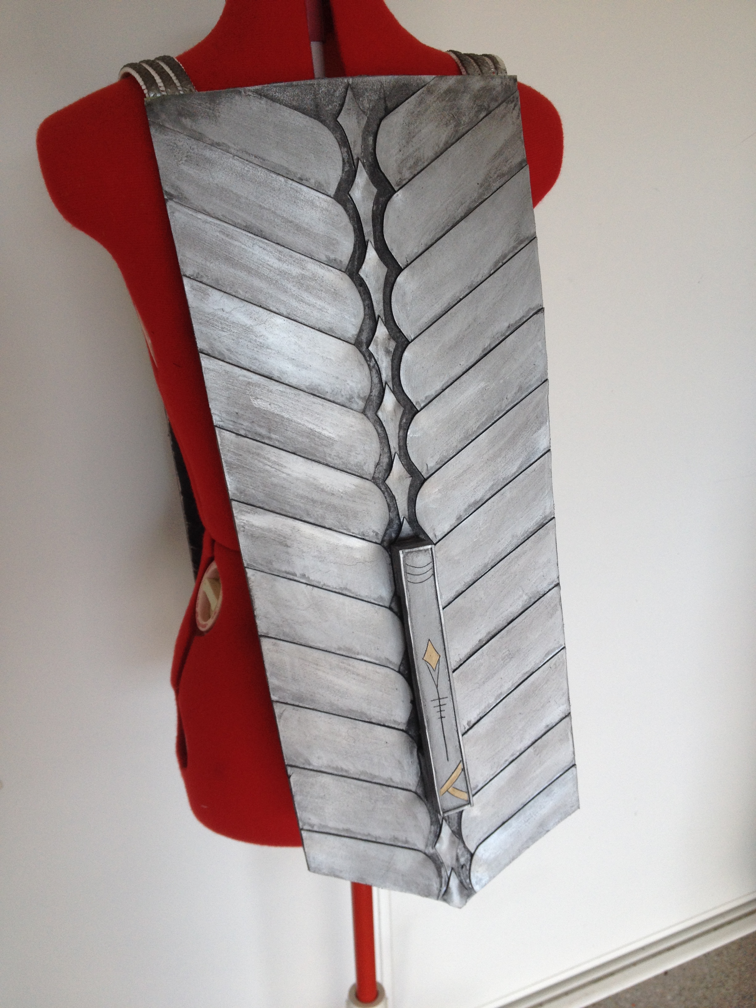

Chest and back plates all done and ready to go .
And together with the belt.

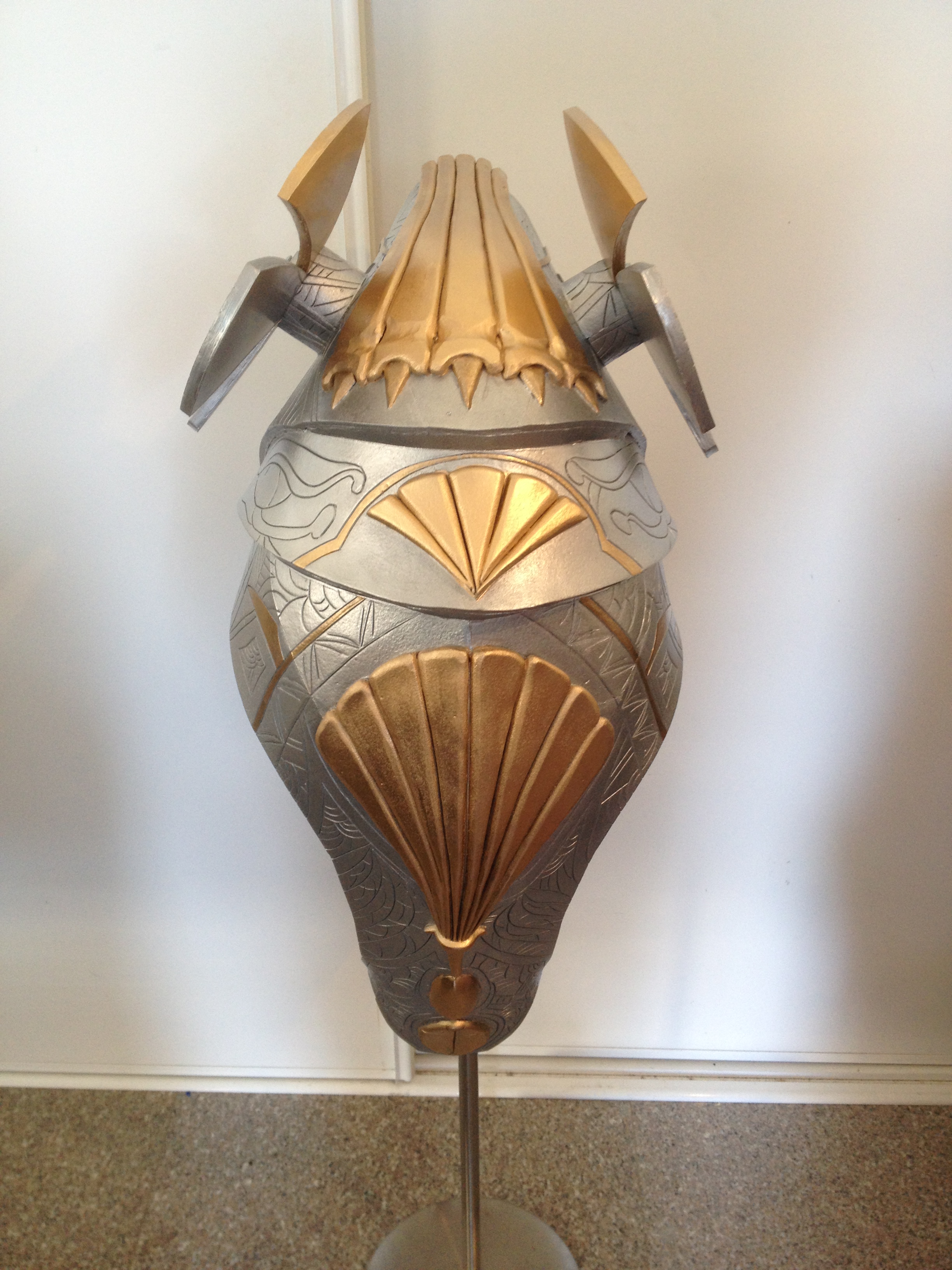

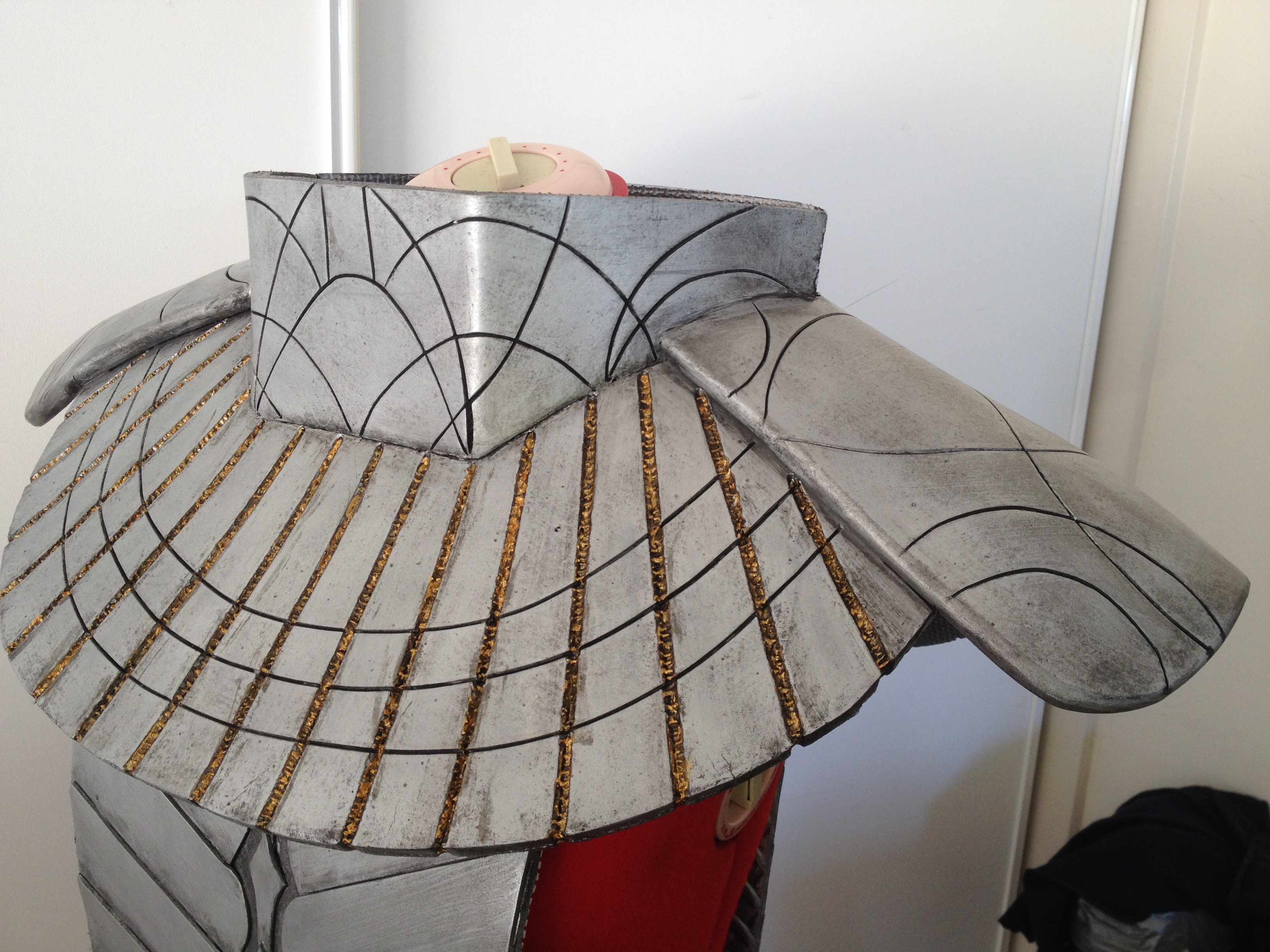

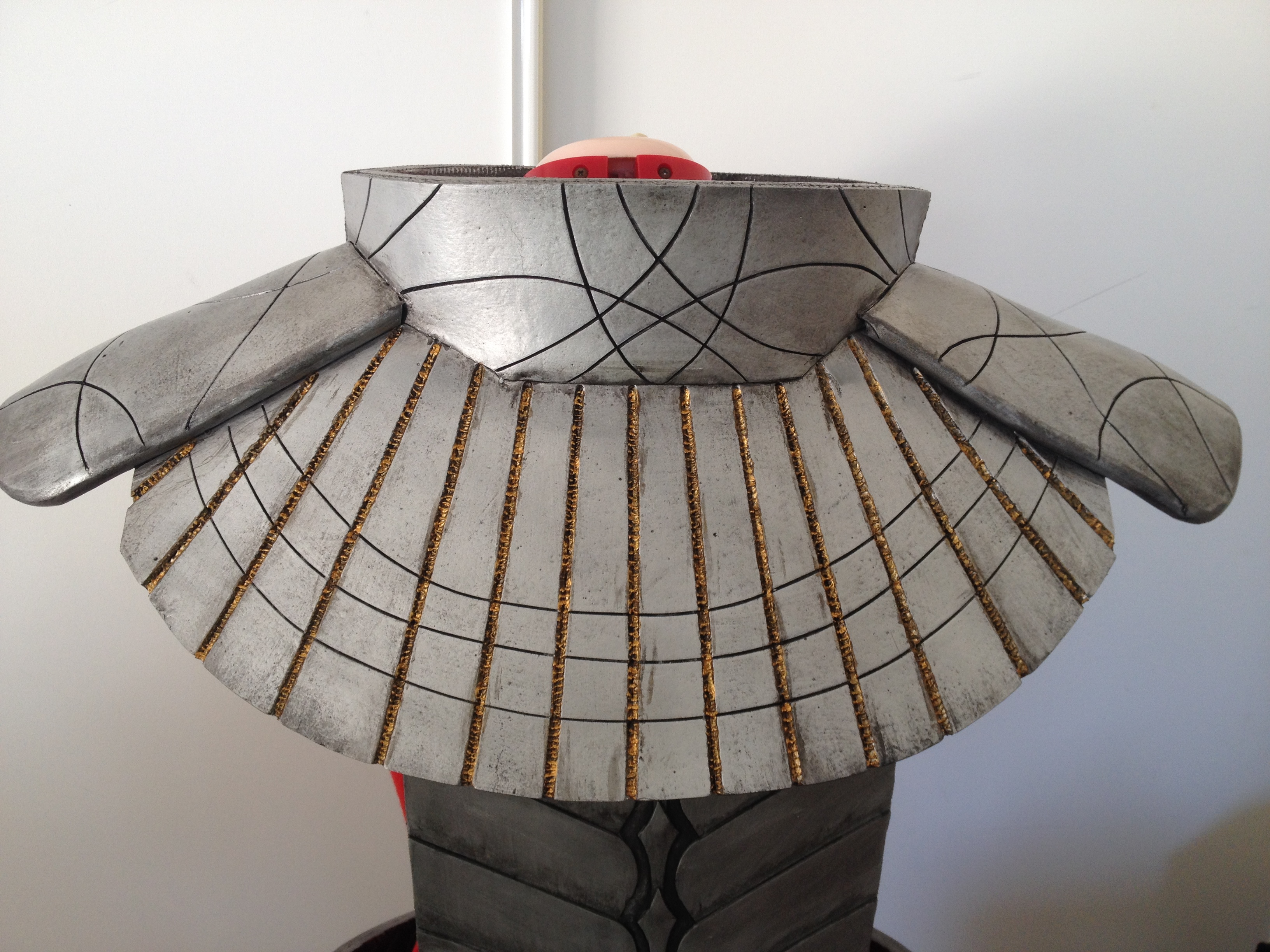

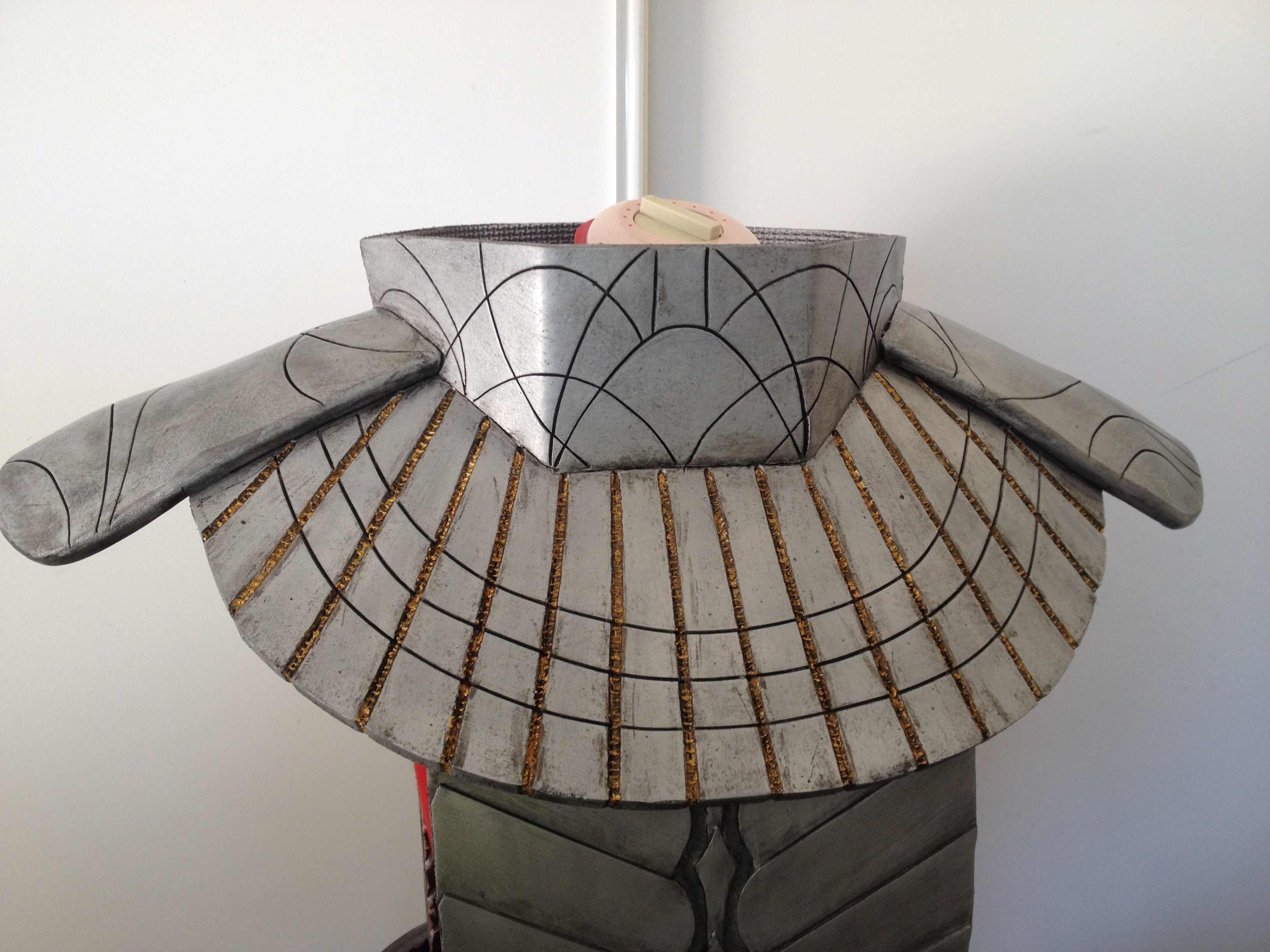

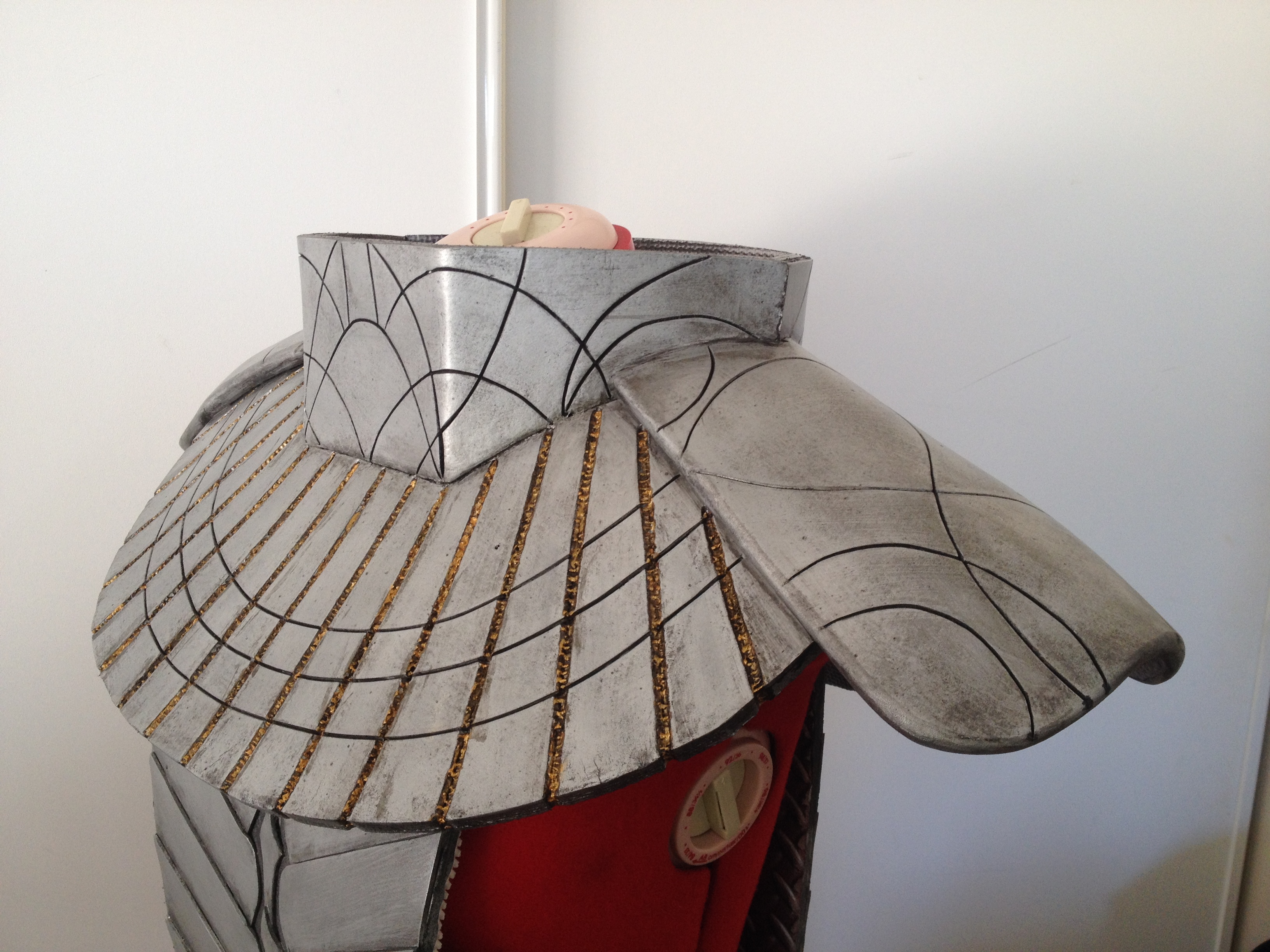

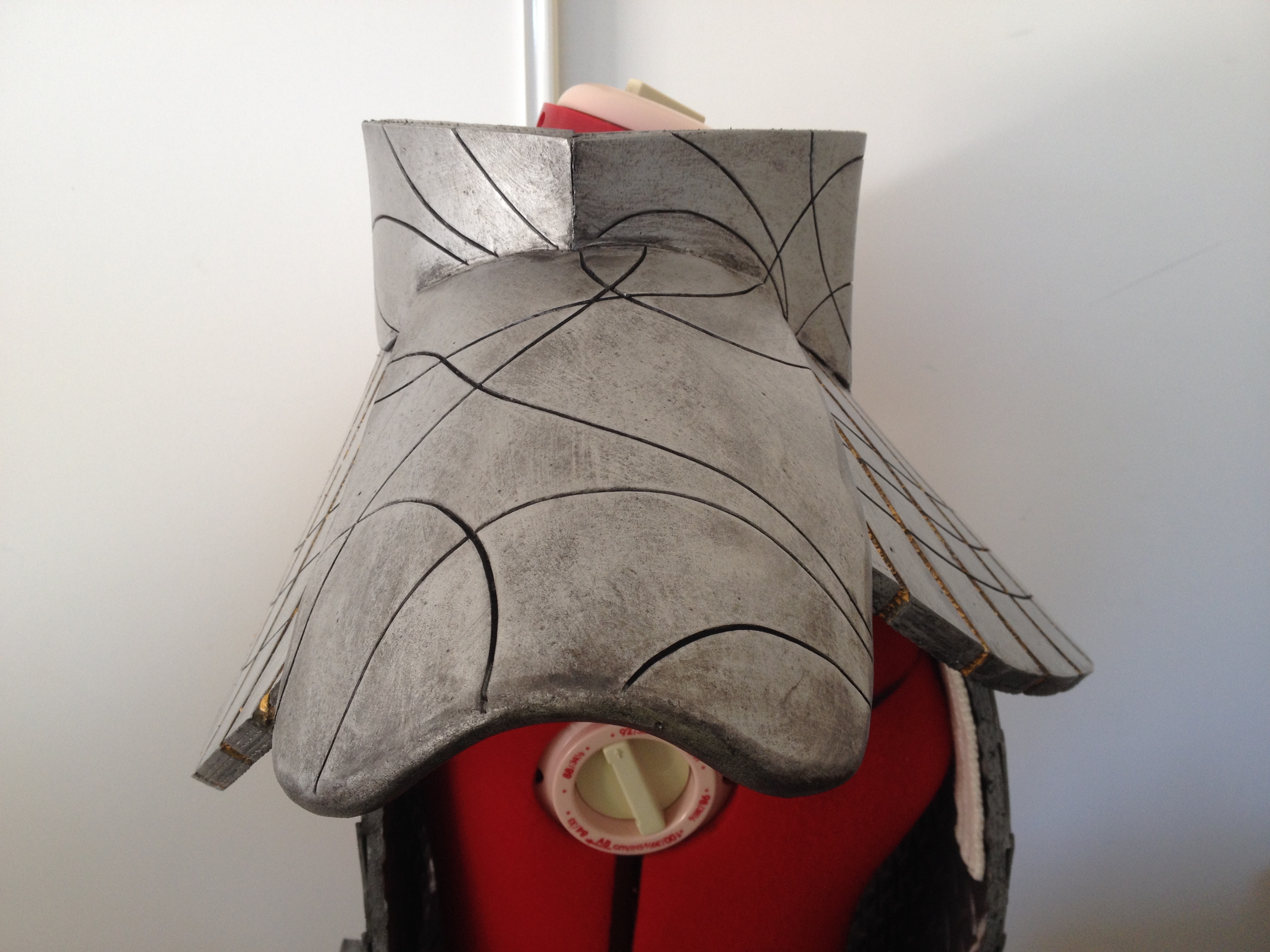

Neck and shoulder piece all painted up and done.
The bigger lines were done with a soldering iron , at first I wasn't to thrilled with the "melted" look of each line but once paint and weathering was added I changed my mind .

For big deep lines I used rotary tool with cylindrical grinding stone

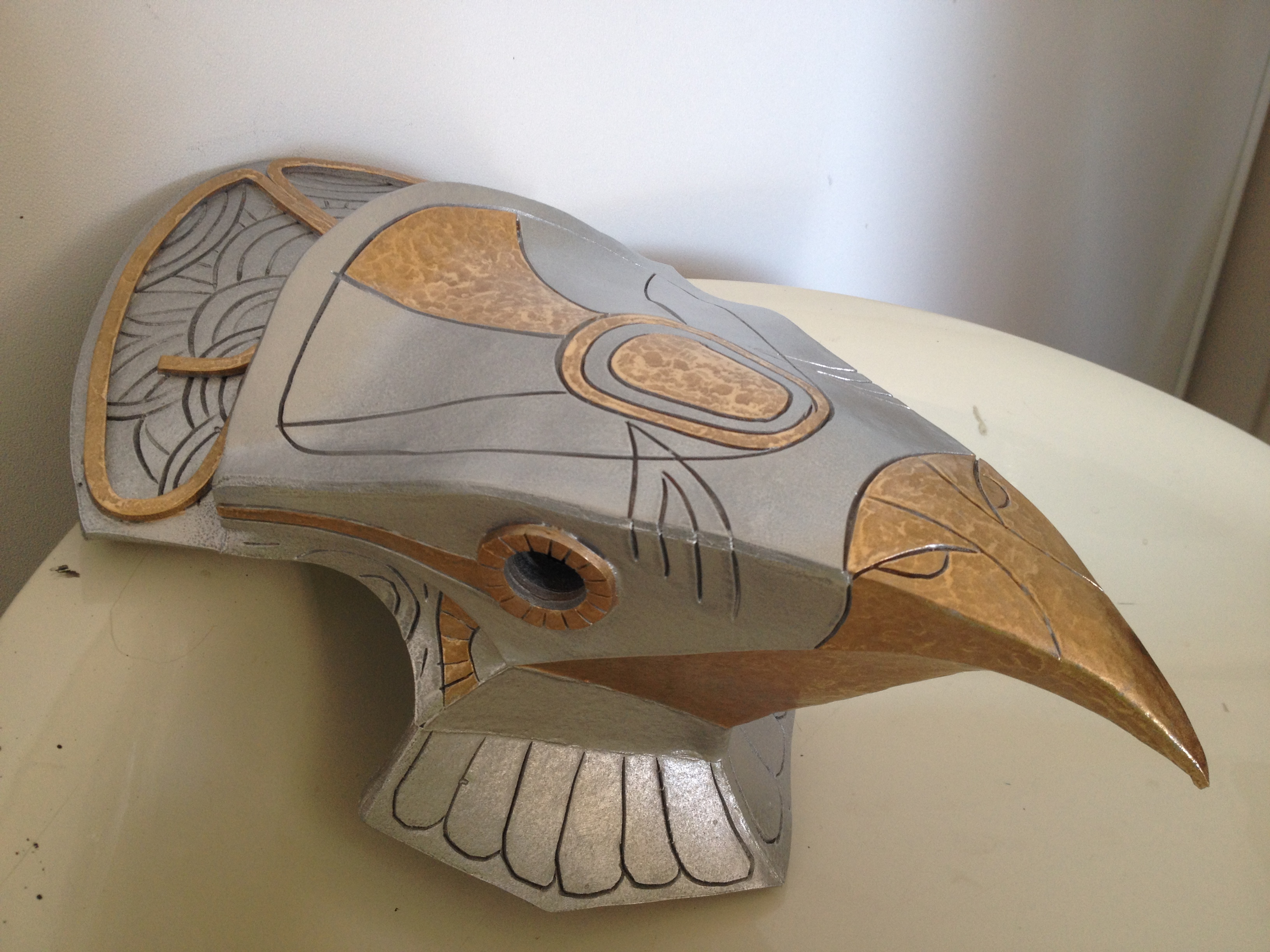

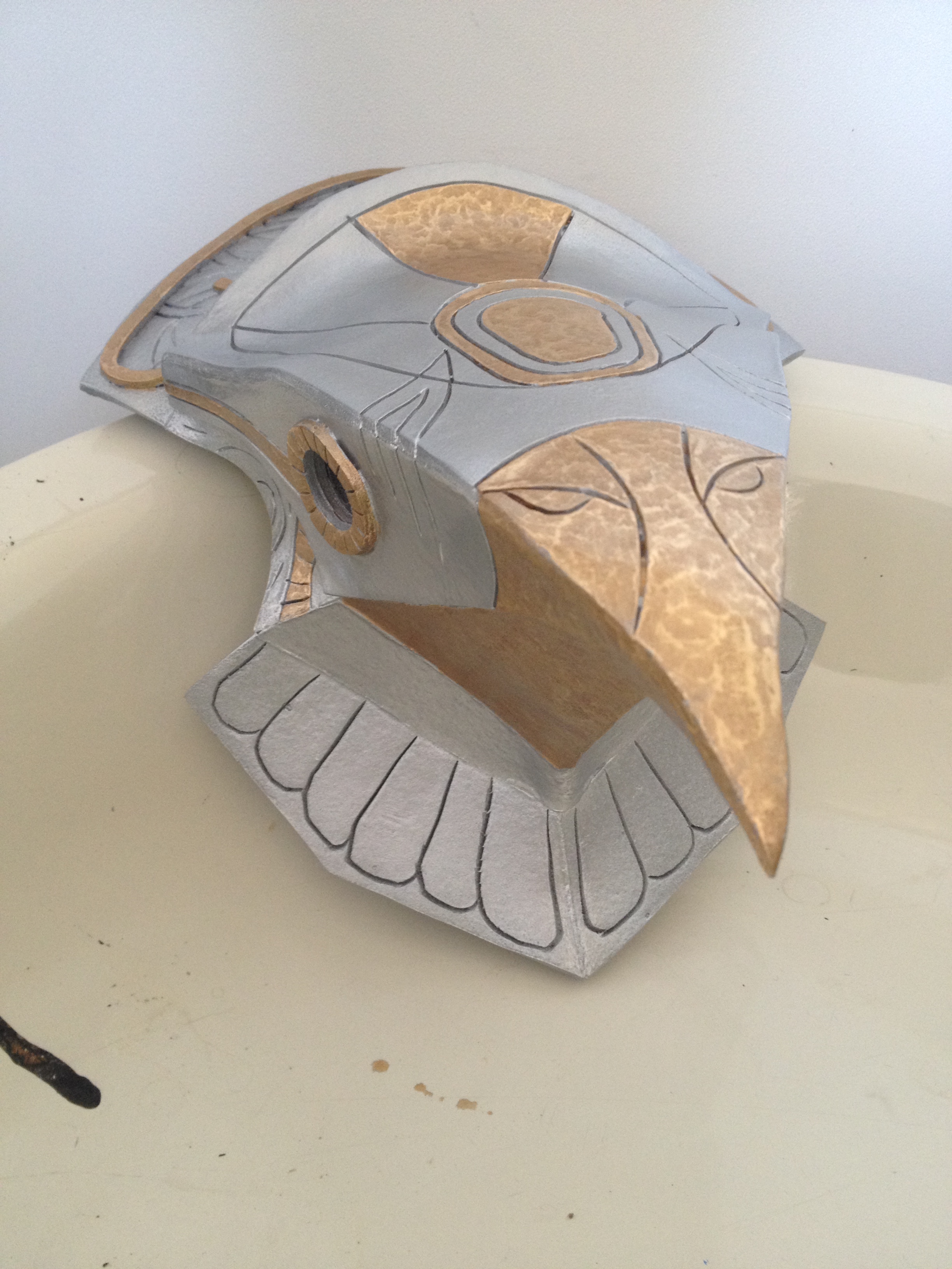

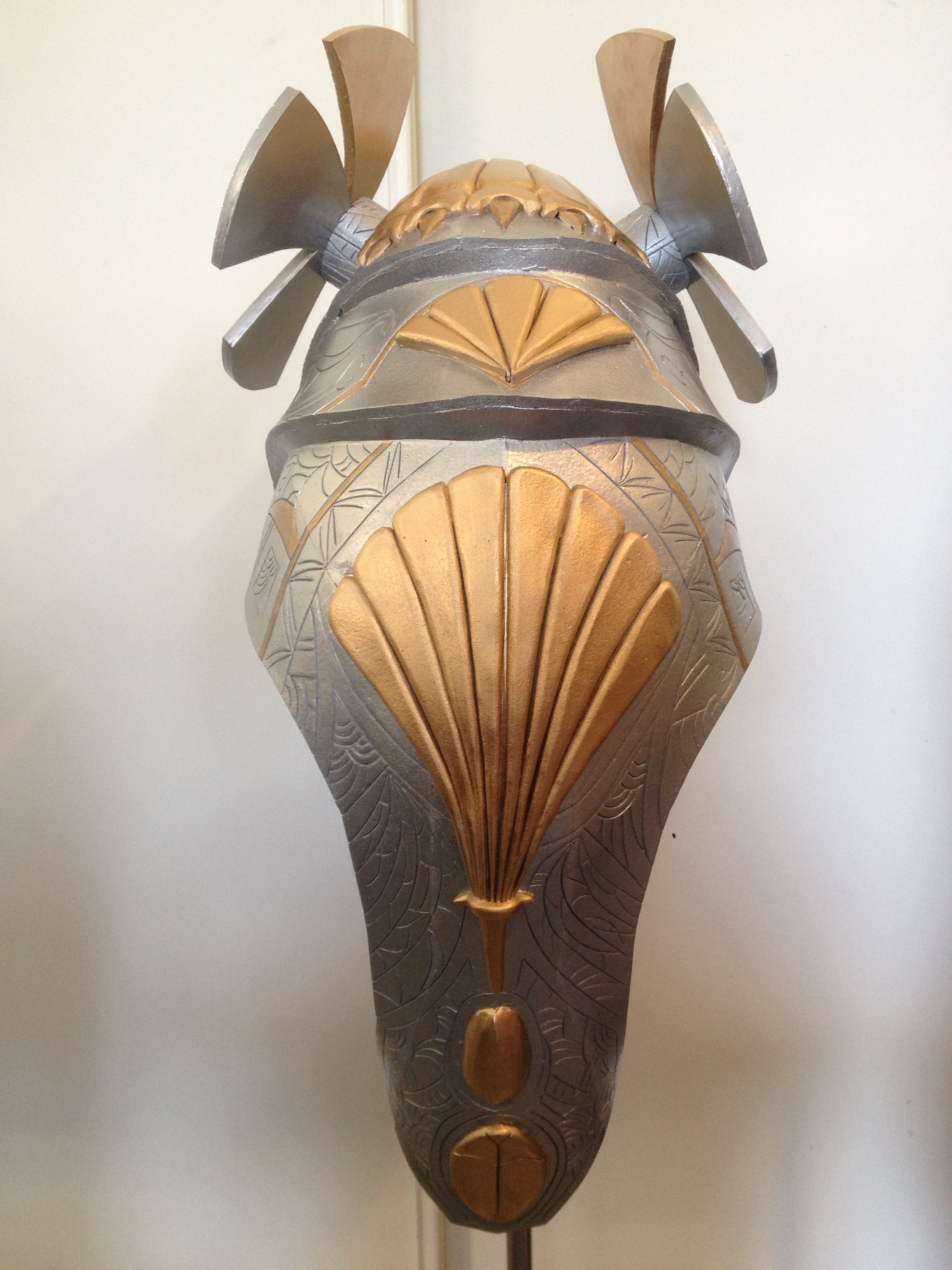

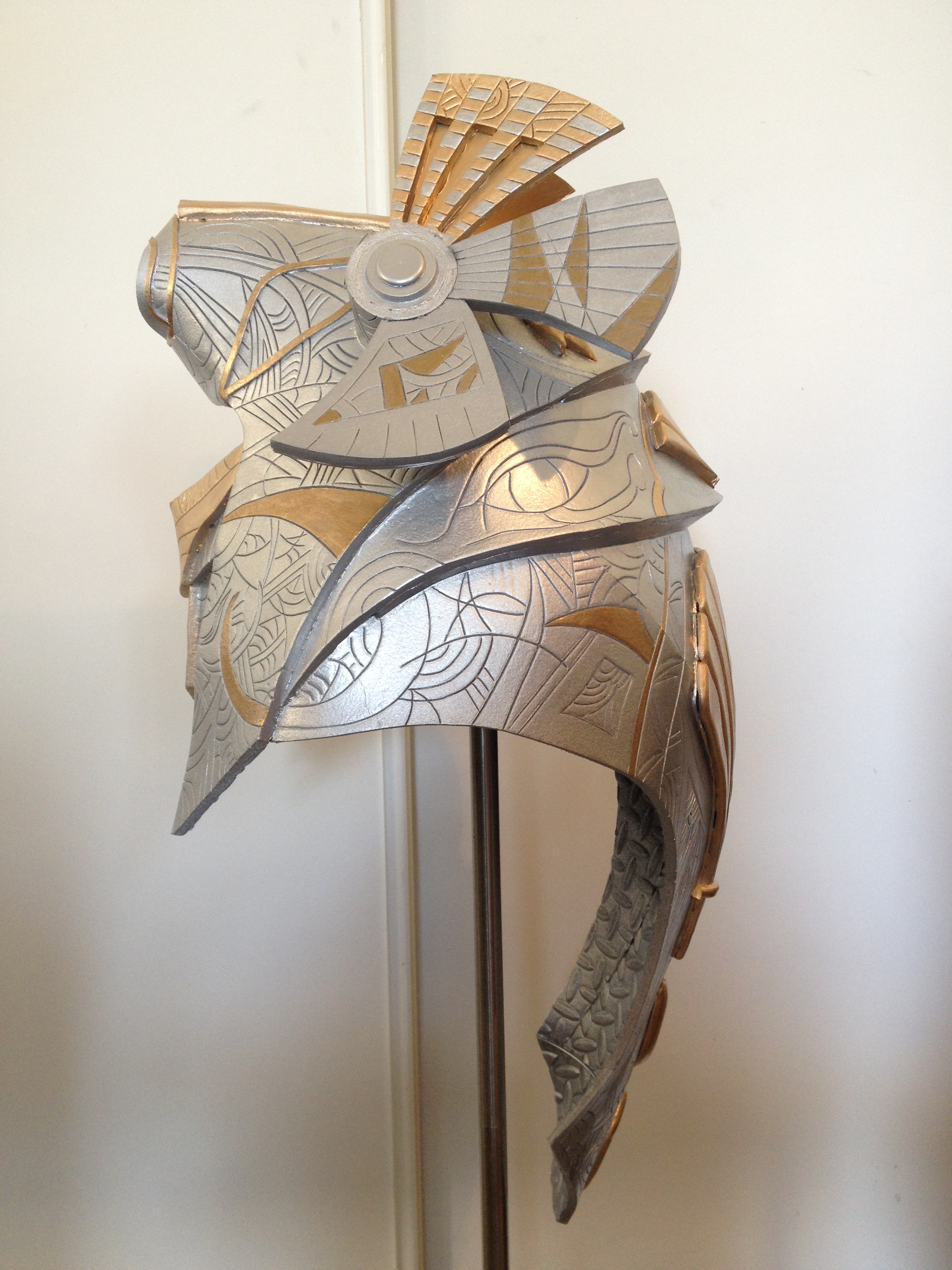

I realized I had forgotten the side panels on the chest armour .. so back to the workbench with those pieces.

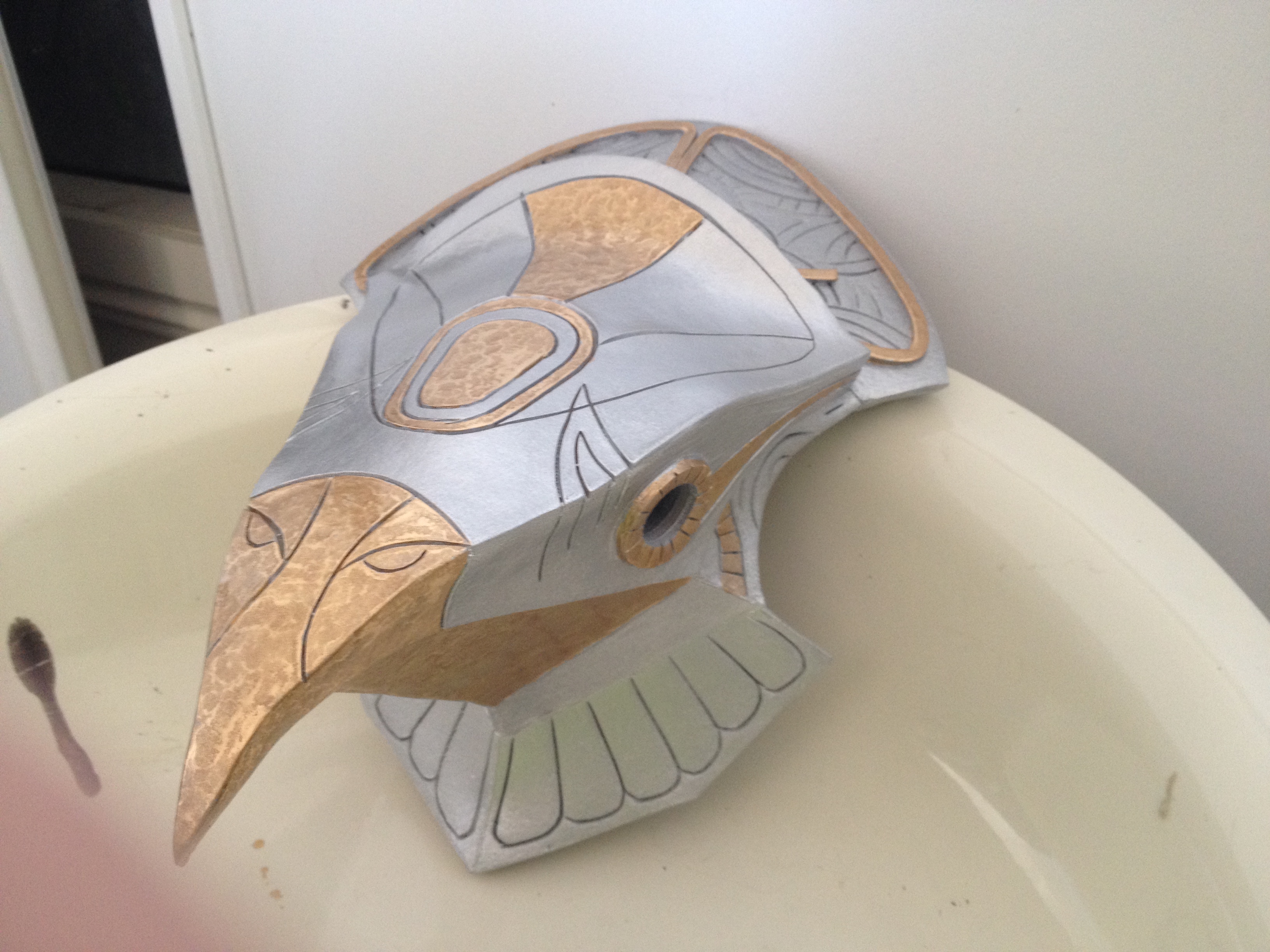

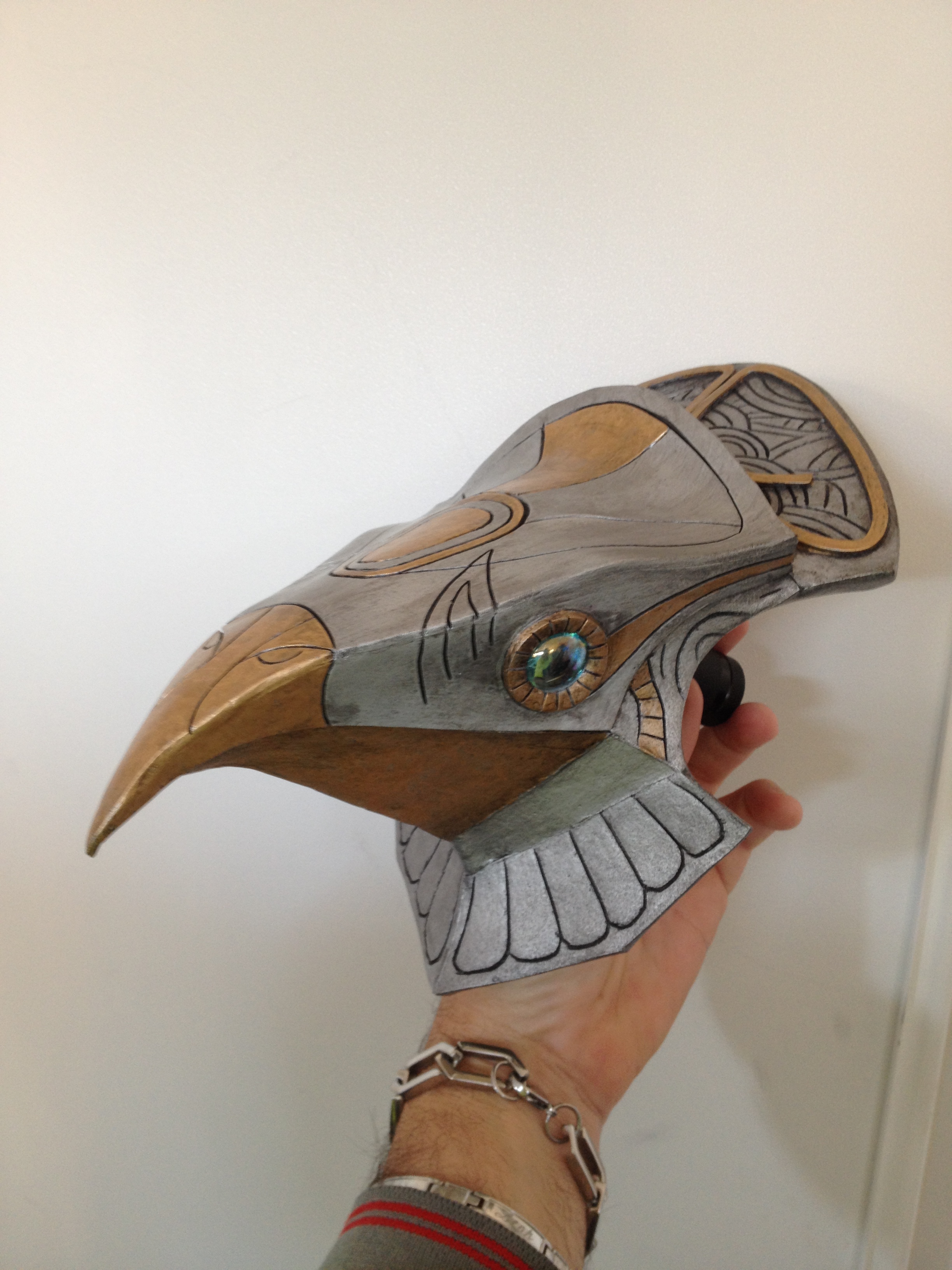

I had some issues with the 1st face I made so I made a 2nd and got it painted up ready for weathering.
Stay tuned ..............................................................................................

did you use a template for the lines or just freehand them

Superhorus - no template used for the lines mate . I picked a couple of pictures that showed the lines and just free handed them .

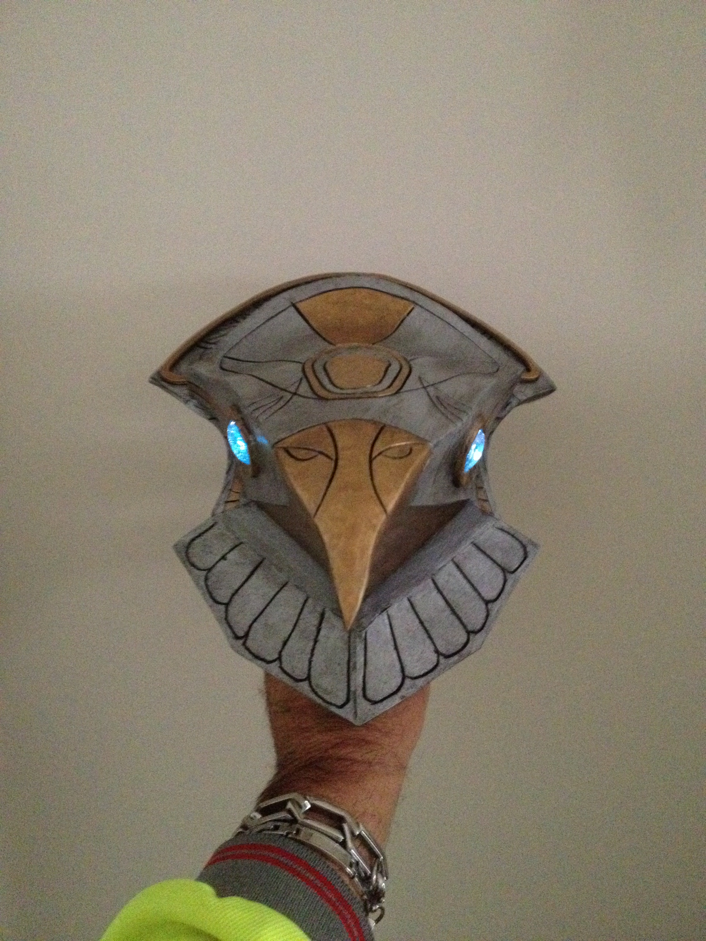

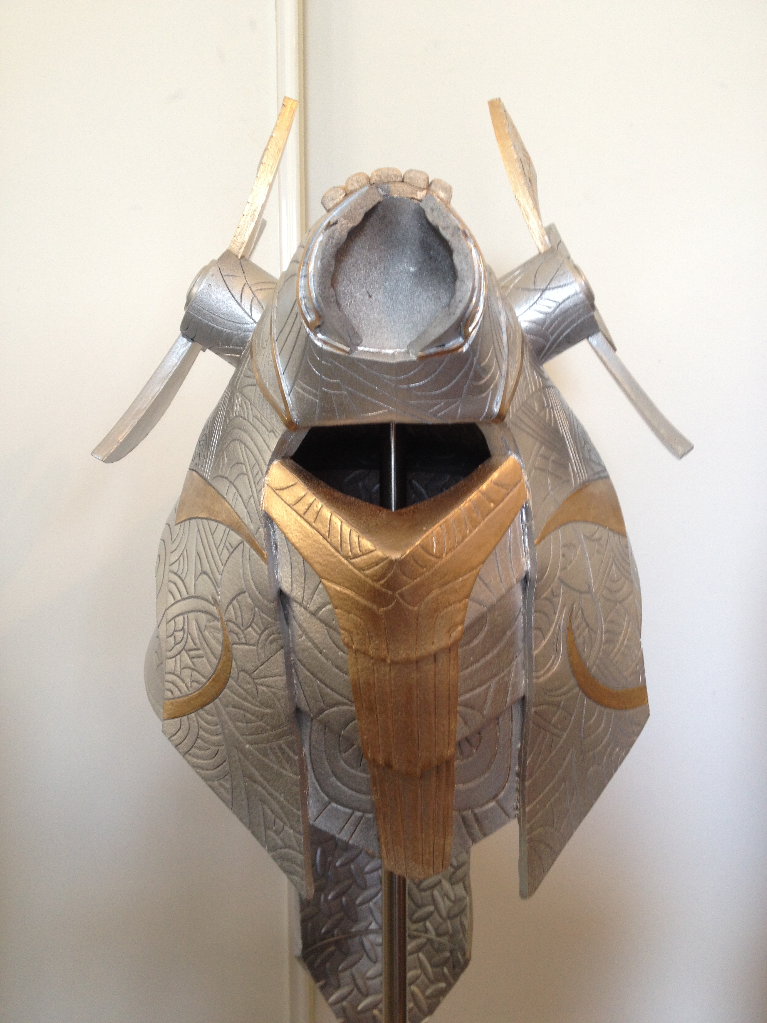

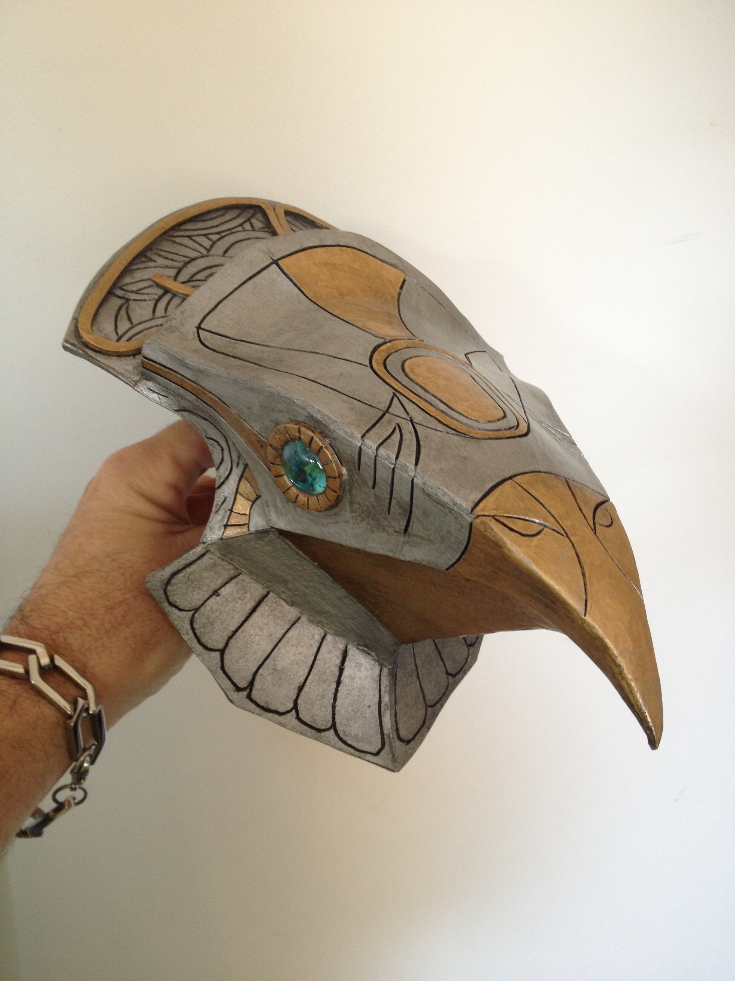

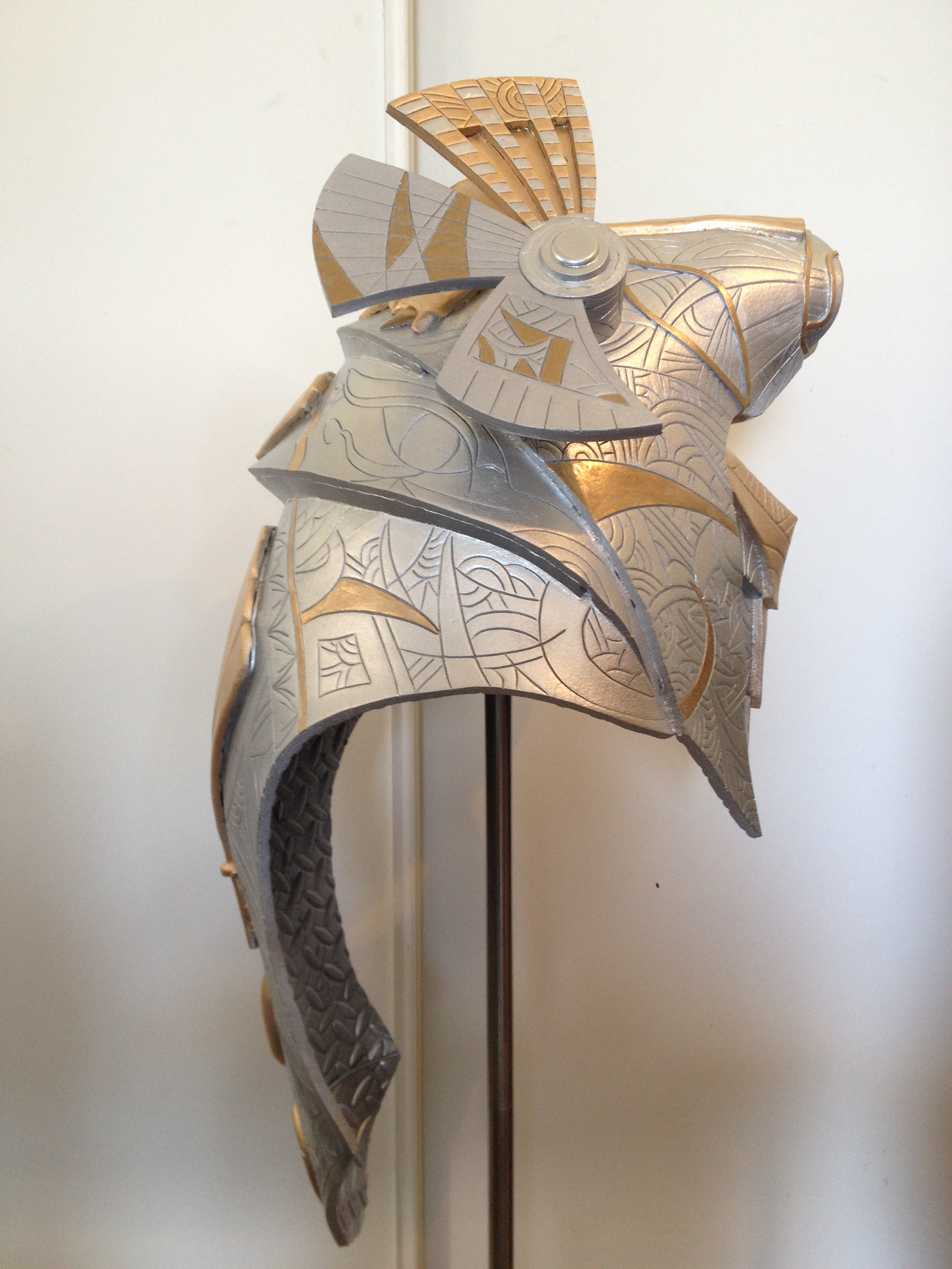

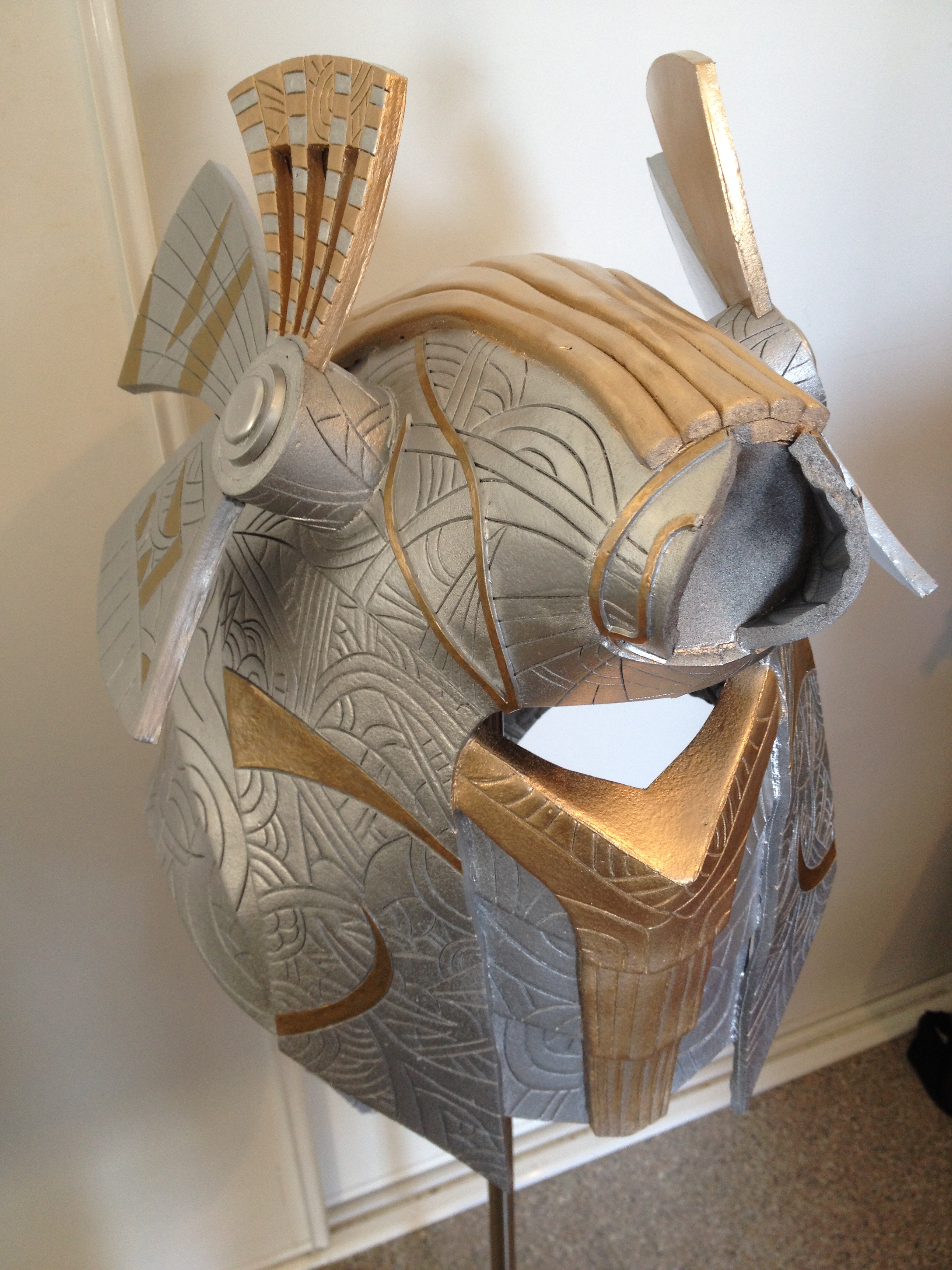

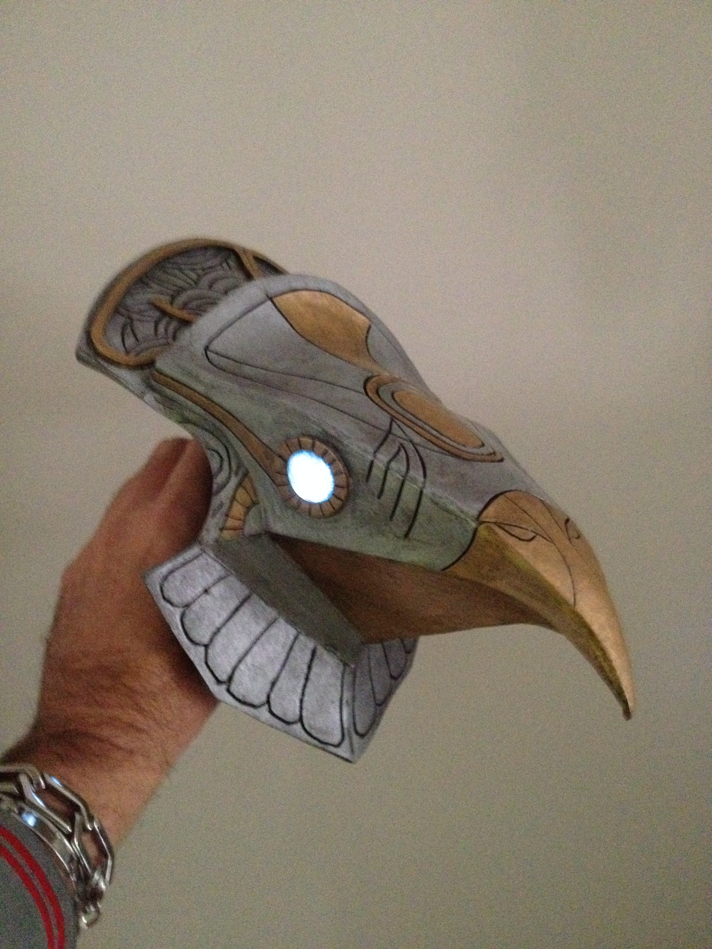

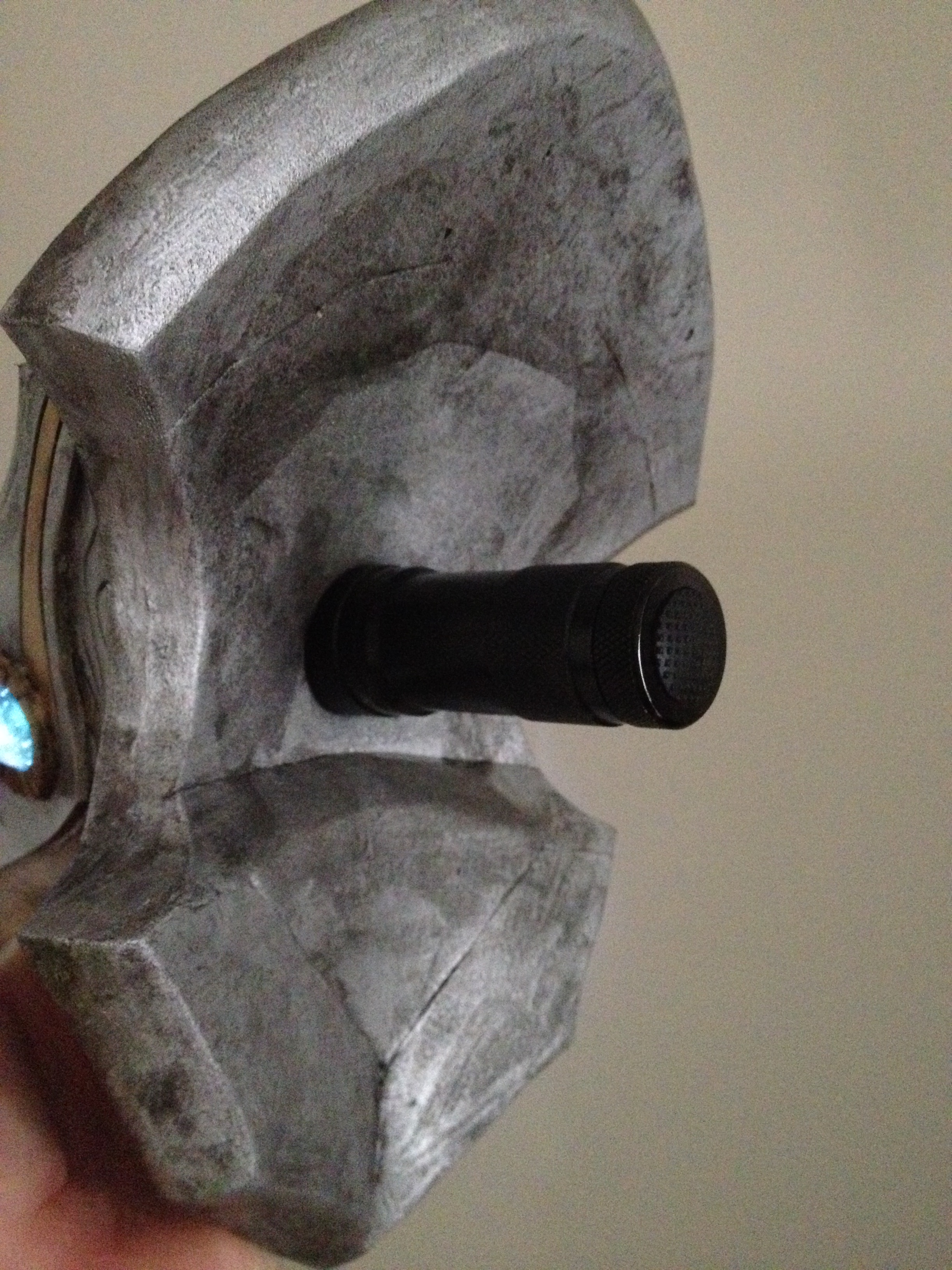

Ok .. well the helmet is all finished.. face glued on and a black mesh screen glued in so no-one can see me in it.

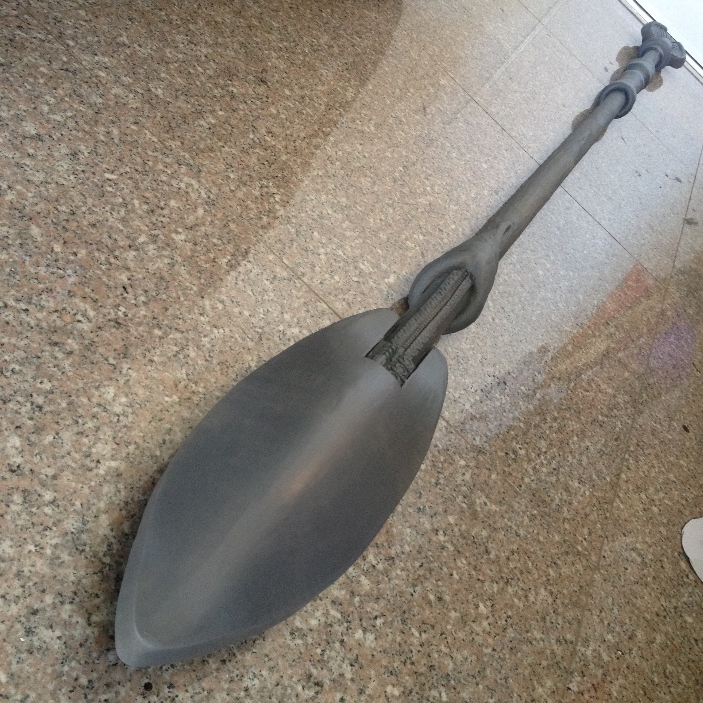

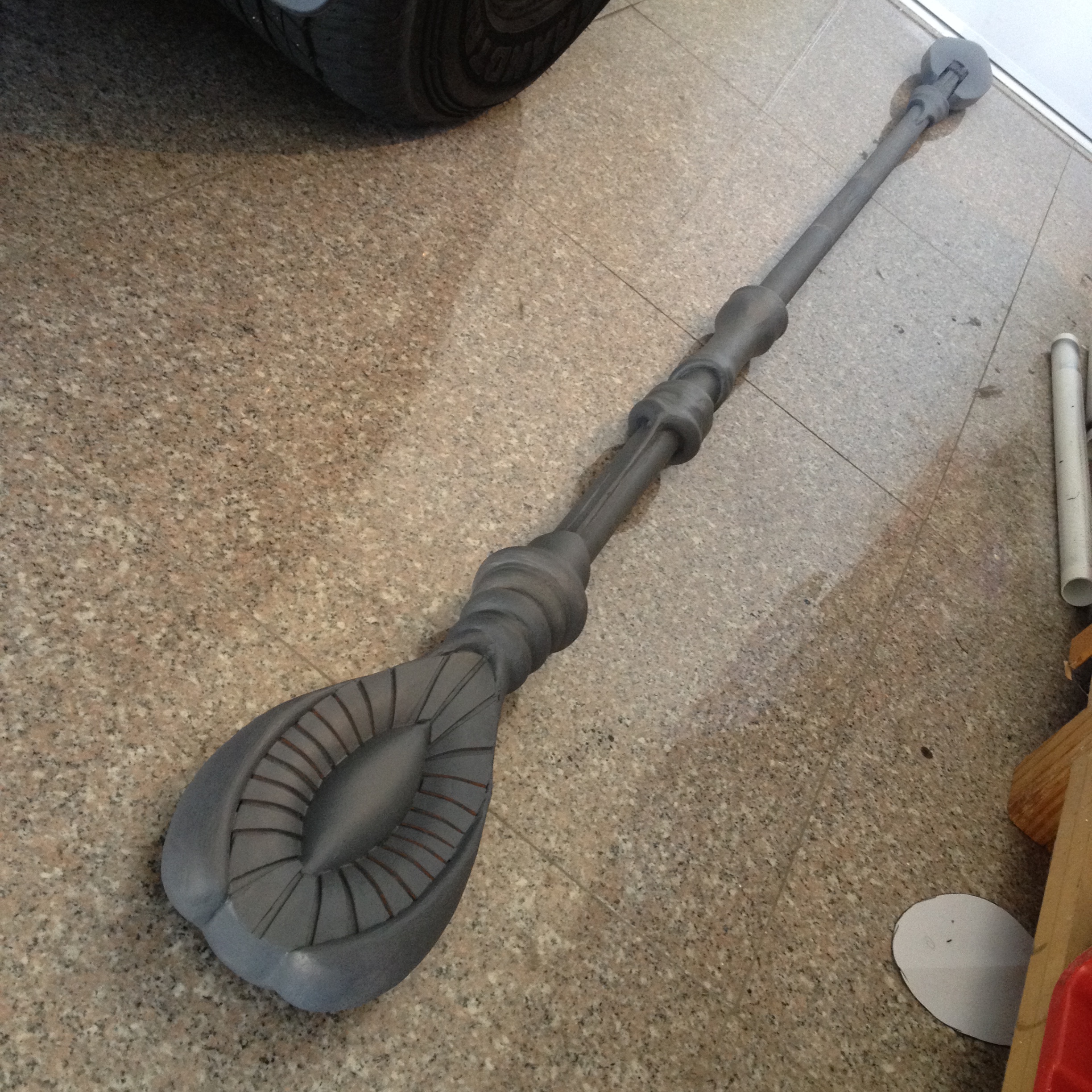

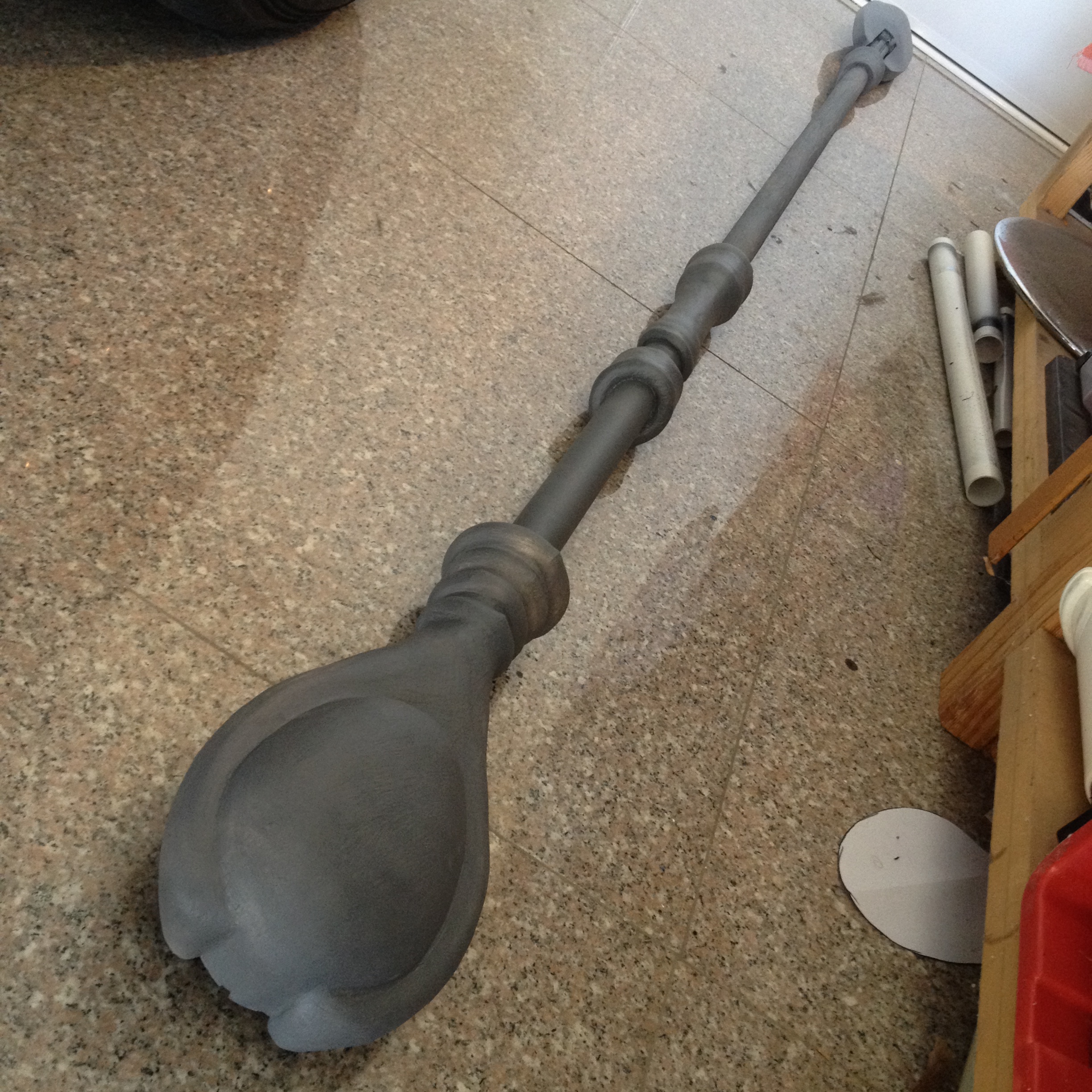

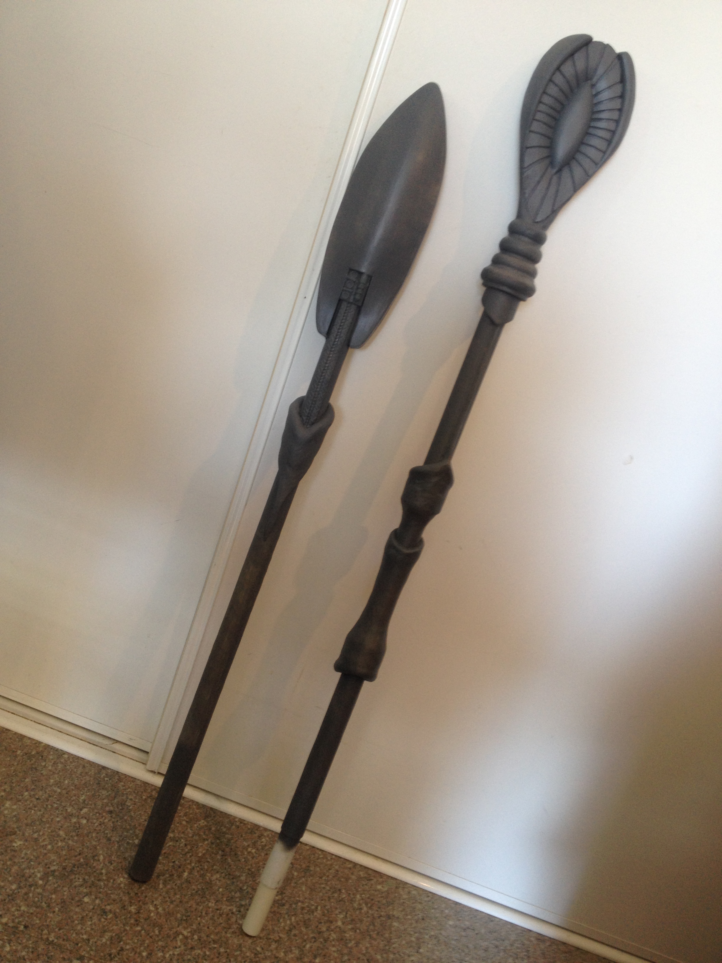

Time to make a start on the staff weapon ....... pvc pipe and foam used.
Plaster was applied to the foam to give some texture... it's a water based plaster so a paint brush and water can be used to smooth it out.
Details added with 2mm foam and I used alfoil to bulk out the detail .
Primer sprayed on and ready for final coats.

Staff weapon is all finished and ready to go !
