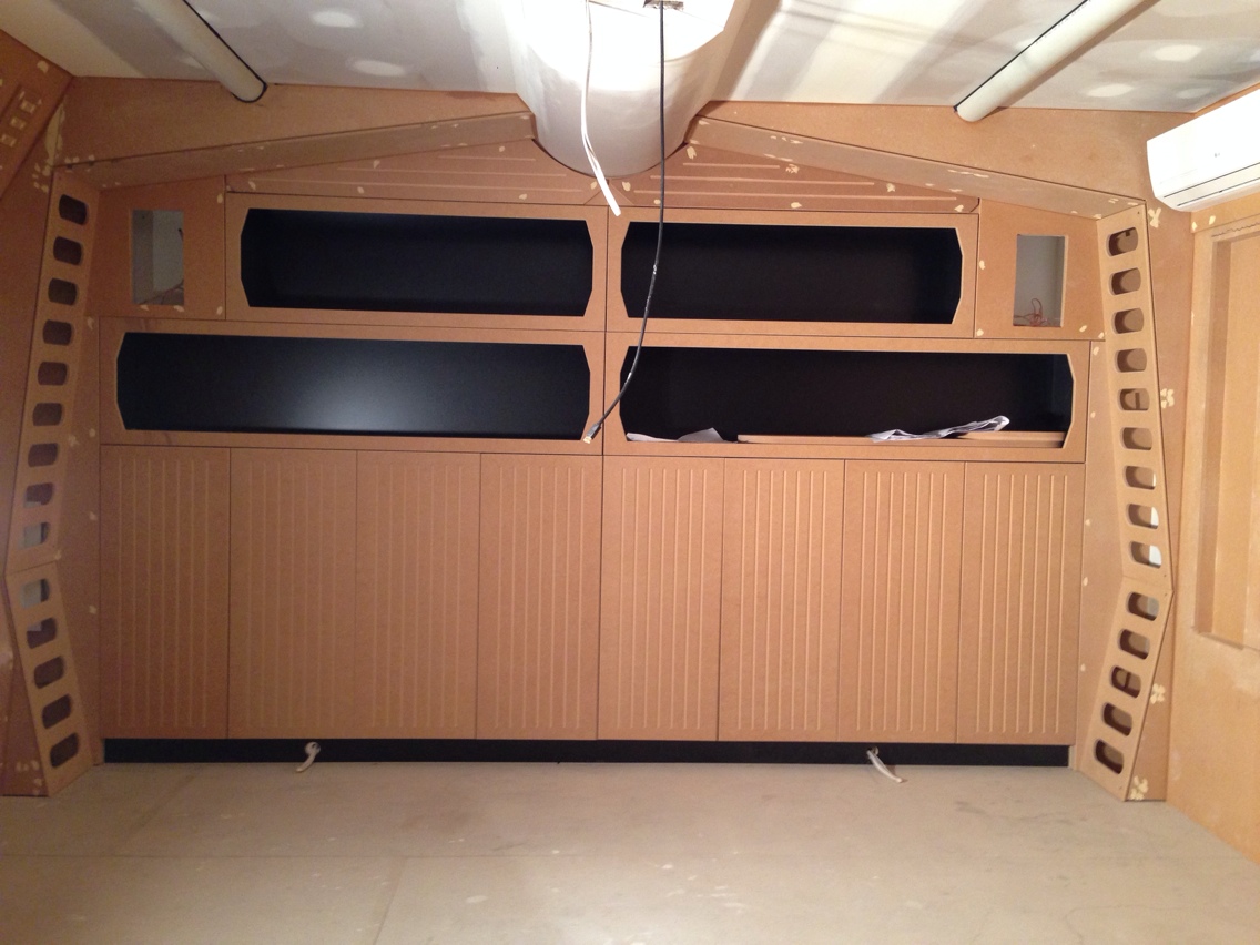

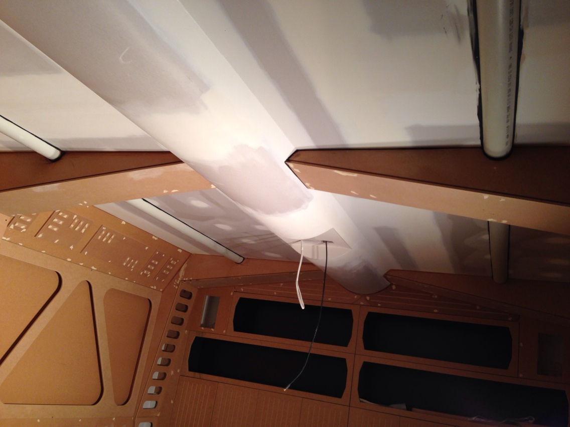

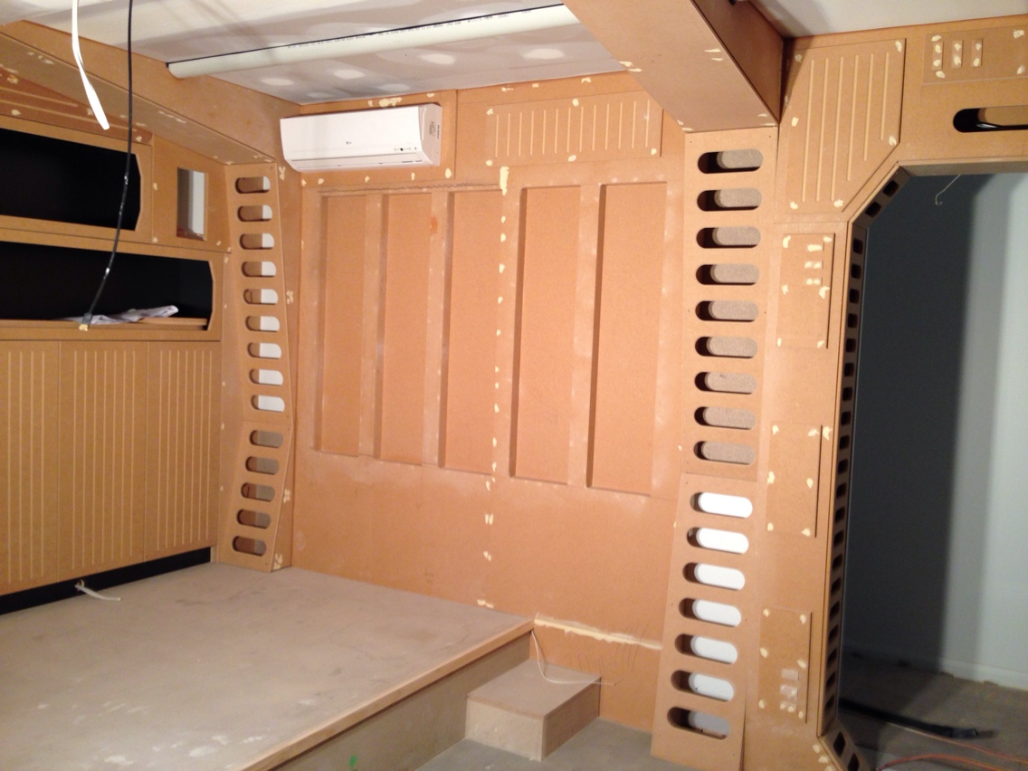

Some pics, I took the other day, I've finished sanding now, hopefully first coat of paint on Friday.

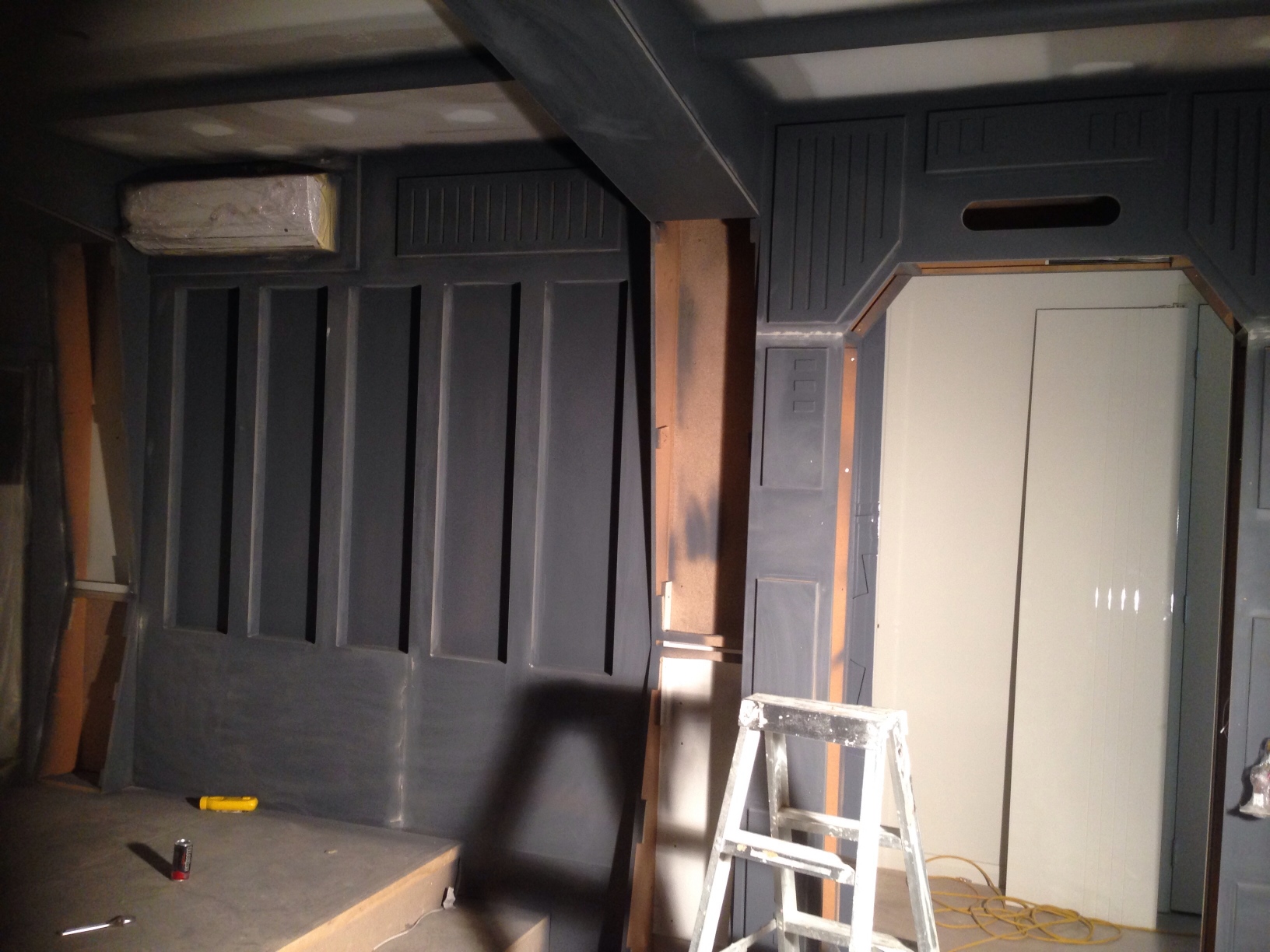

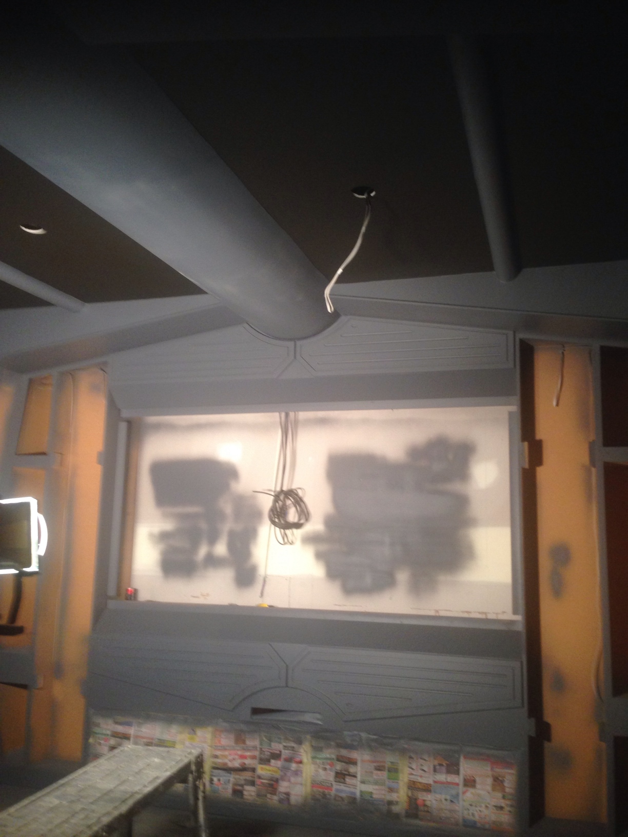

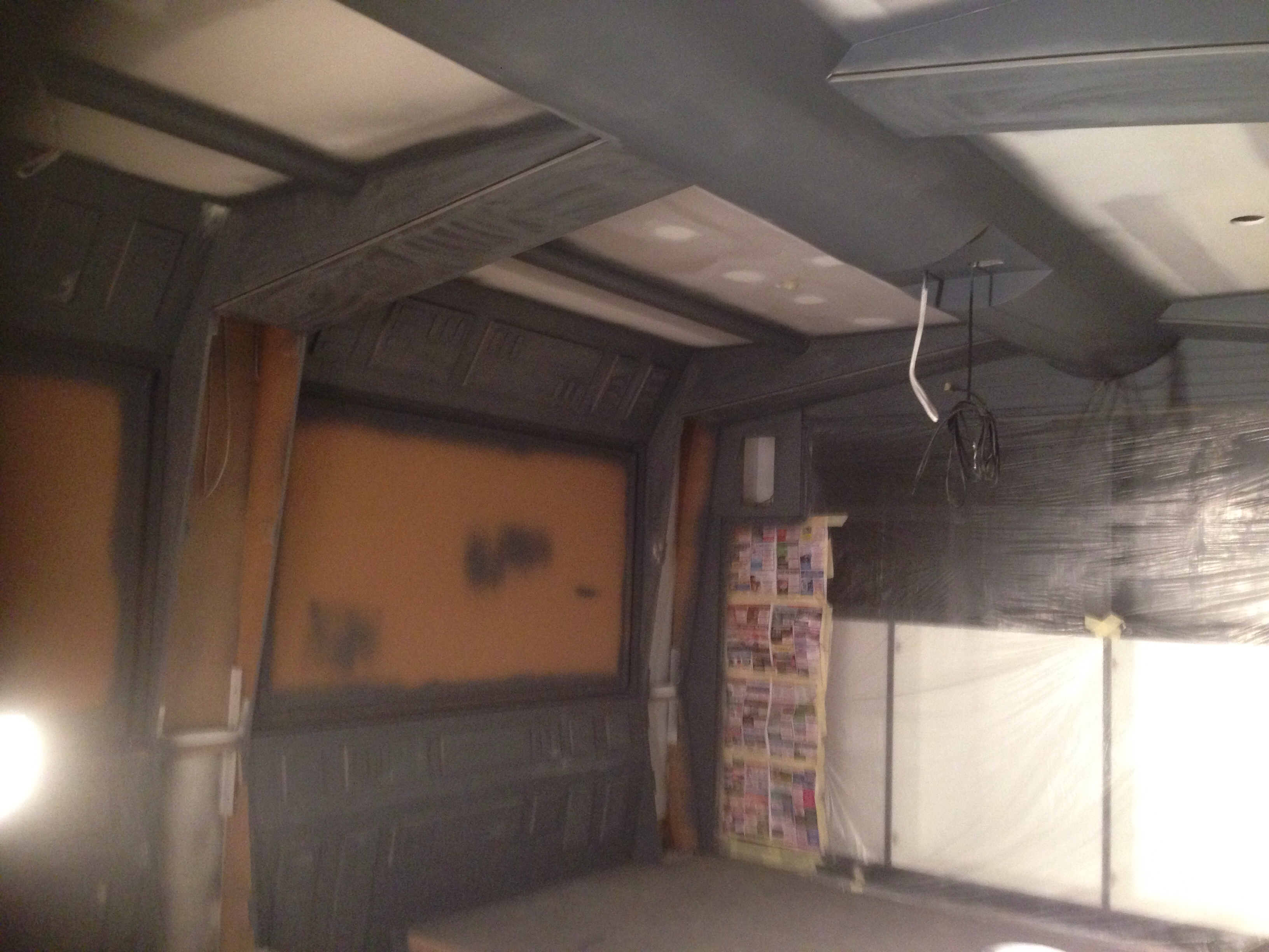

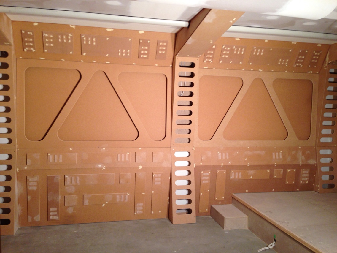

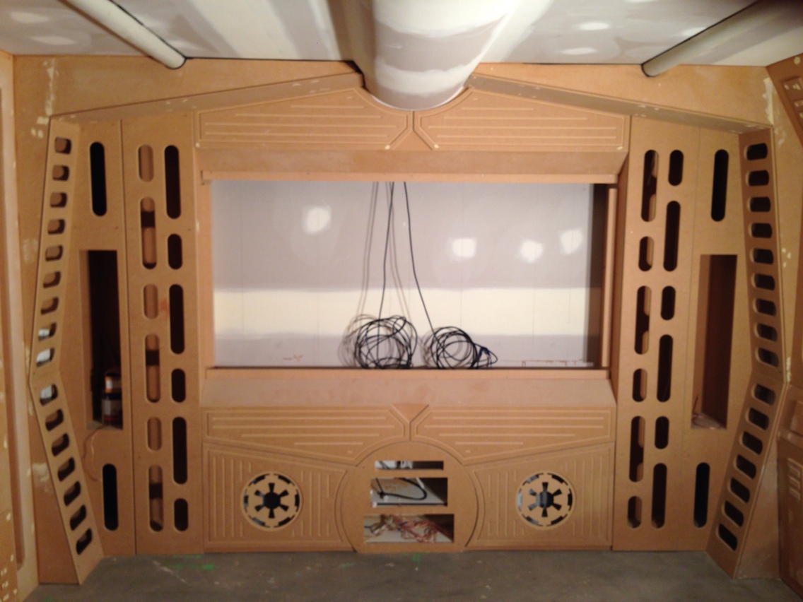

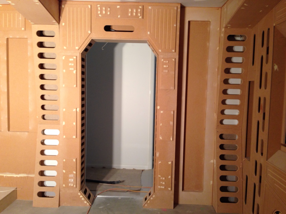

Hi Everyoine, Ive managed to get some more work done, in between the move in. Sorry for crappy Iphone pics.
This is second coat down and sanded
This Is Thrid coat down and two coats to black ceiling, The centre bulhead now also has a second coat of suede finish paint.

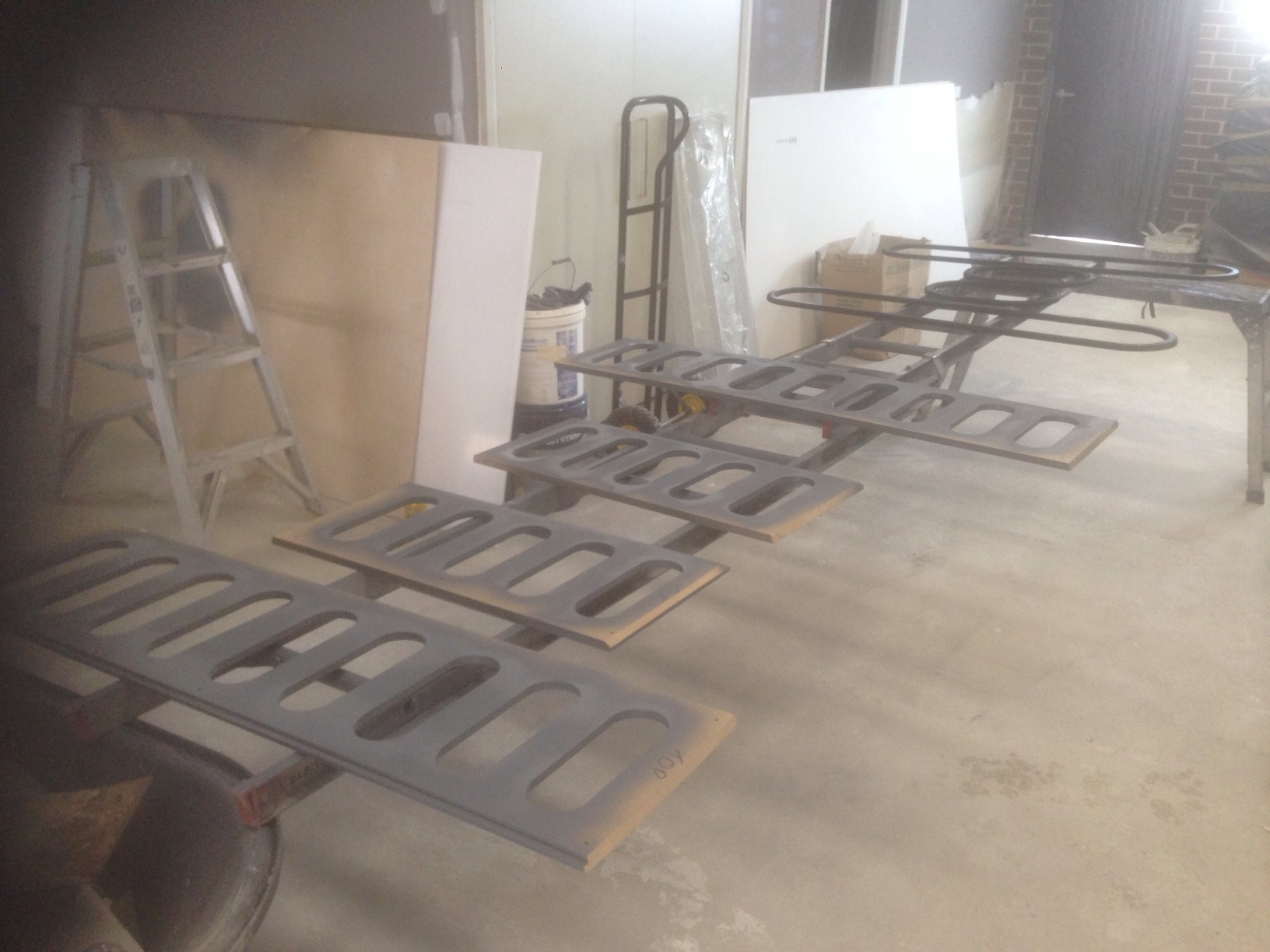

Main Room since is complete, Carpets are in, Entrance doors are in and operational. Ive set up the rear display cabinets with my movie pieces. Ive wired most of the room with LEDs in the wall columns etc. Now all I have is the front panels with the cutouts, they are a nightmare to sand and being MDF, extremely difficult to get smooth. Last night finished the rear two panels with the white perspex, i think looks great, hopefully will finish the full rear part tonight and post some pics tomorrow.

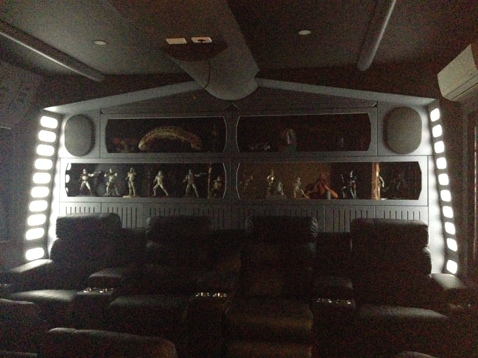

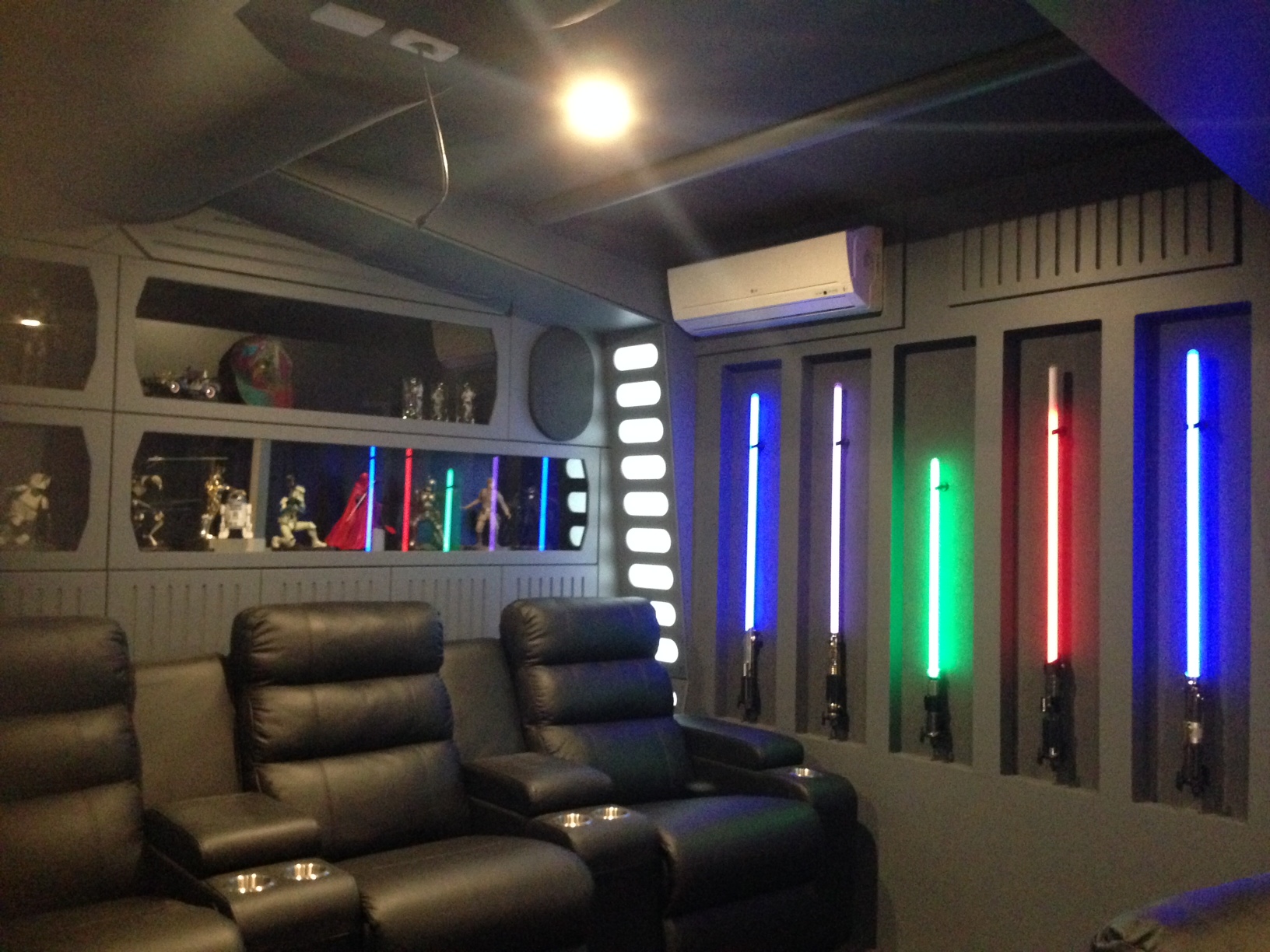

Heres a quick crappy Iphone pic of the rear of the theatre finished off. I think the LED in wall columns turned up great, were very bright, but once perspex panels went on diffused a bit, and perfect amount of light. Ive Got the rear seats all setup too. They are full leather, fully motorised recliners. Have 4 seats at back on the 2 step up and 3 at front on main floor to allow for access from both sides.

Ive got the printouts for the windows, they came up pretty good, bit boxy when you're up real close however at 4 feet back looks fine. So my next thing is to complete the two window details, sand paint and install perspex then do Centre light columns.

Last night managed to get all chairs hooked together and wired up. Love them they work awesome, they are full electric and recline to practically a flat bed. Also installed the Led Strip light to under step up, wont stick with the standard rear 3M adhesive, thought of stapling but worried about damaging the strip. Any Suggestions how to attach the strip to the underside of a carpeted surface? Hopefully tonight will manage to sand and paint the windows which will be one major part complete.
If you attach the Led's to a thin strip of aluminium you can screw it to the carpeted surface.
