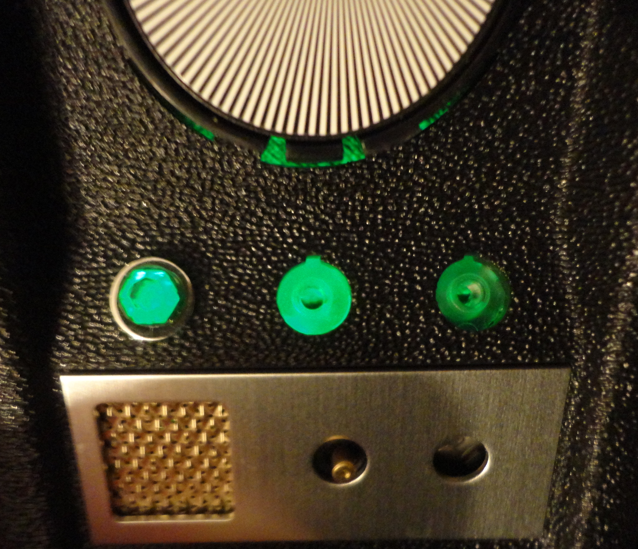

Here is the Swarovski emerald rhinestone with the light off.
And here it is with the light on and the silver backing removed so the light will shine through it.
The light is reduced compared to that of the plastic rhinestone but it is still visible.
That doesn't look too bad. I've never been one for super bright lights, you could just about read with the MR lights.
I'll keep watching this and see what you come up with for the moire. It looks like you are going to have to tackle a lot of little problems to get this done.

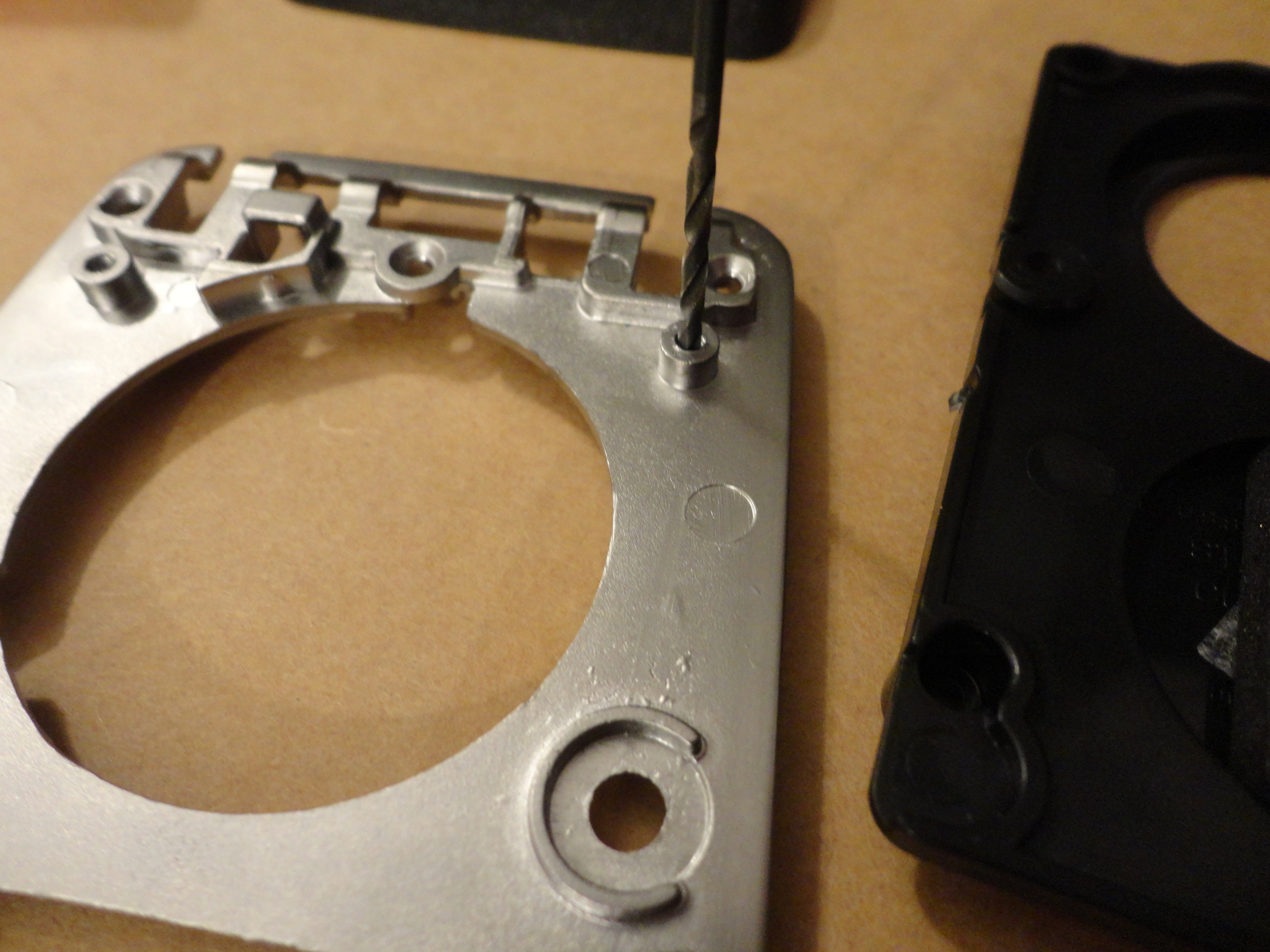

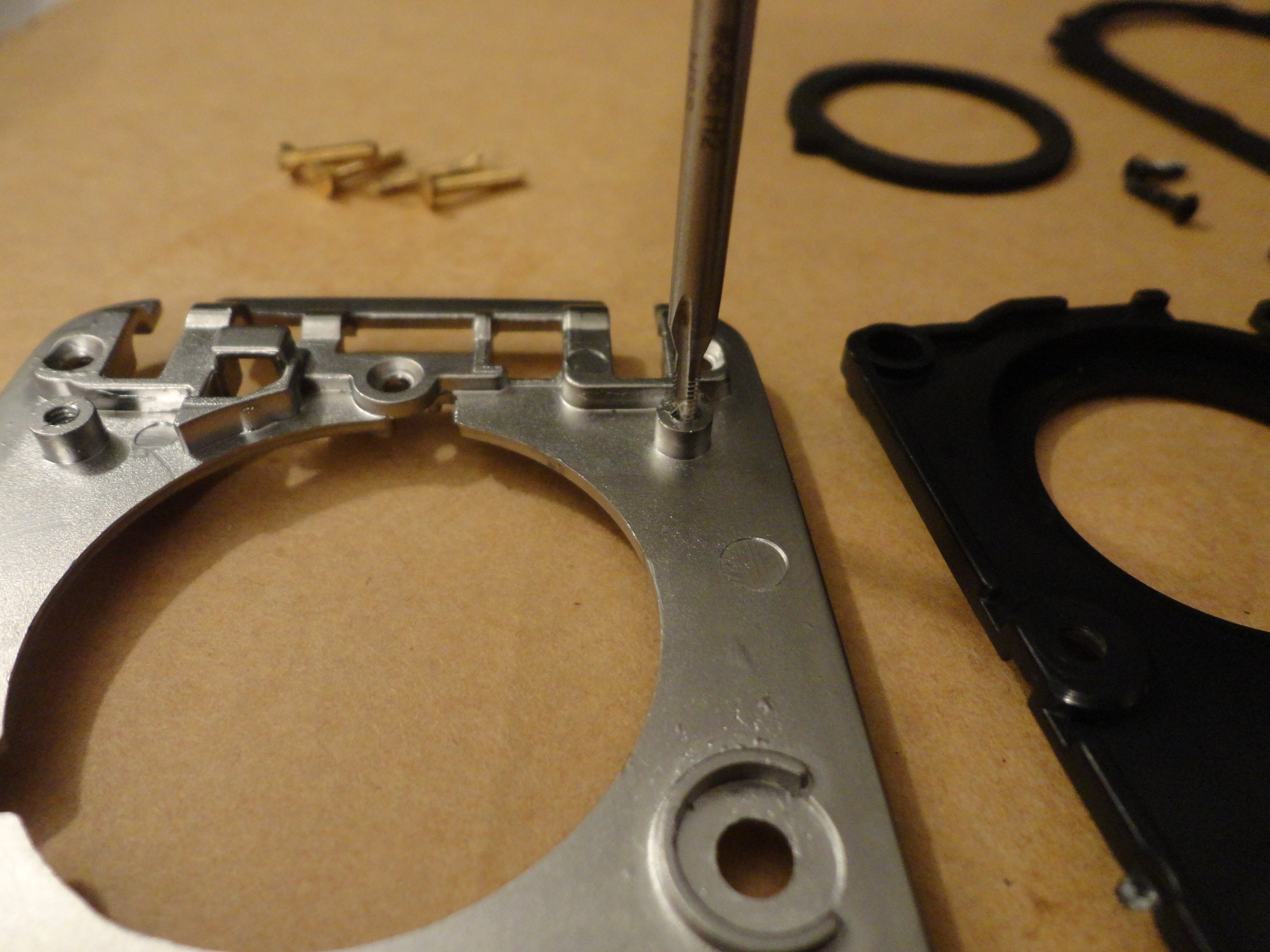

The drilling is done on the mid plate.
Now I need to adjust the threads so those new brass screws will fit.:p

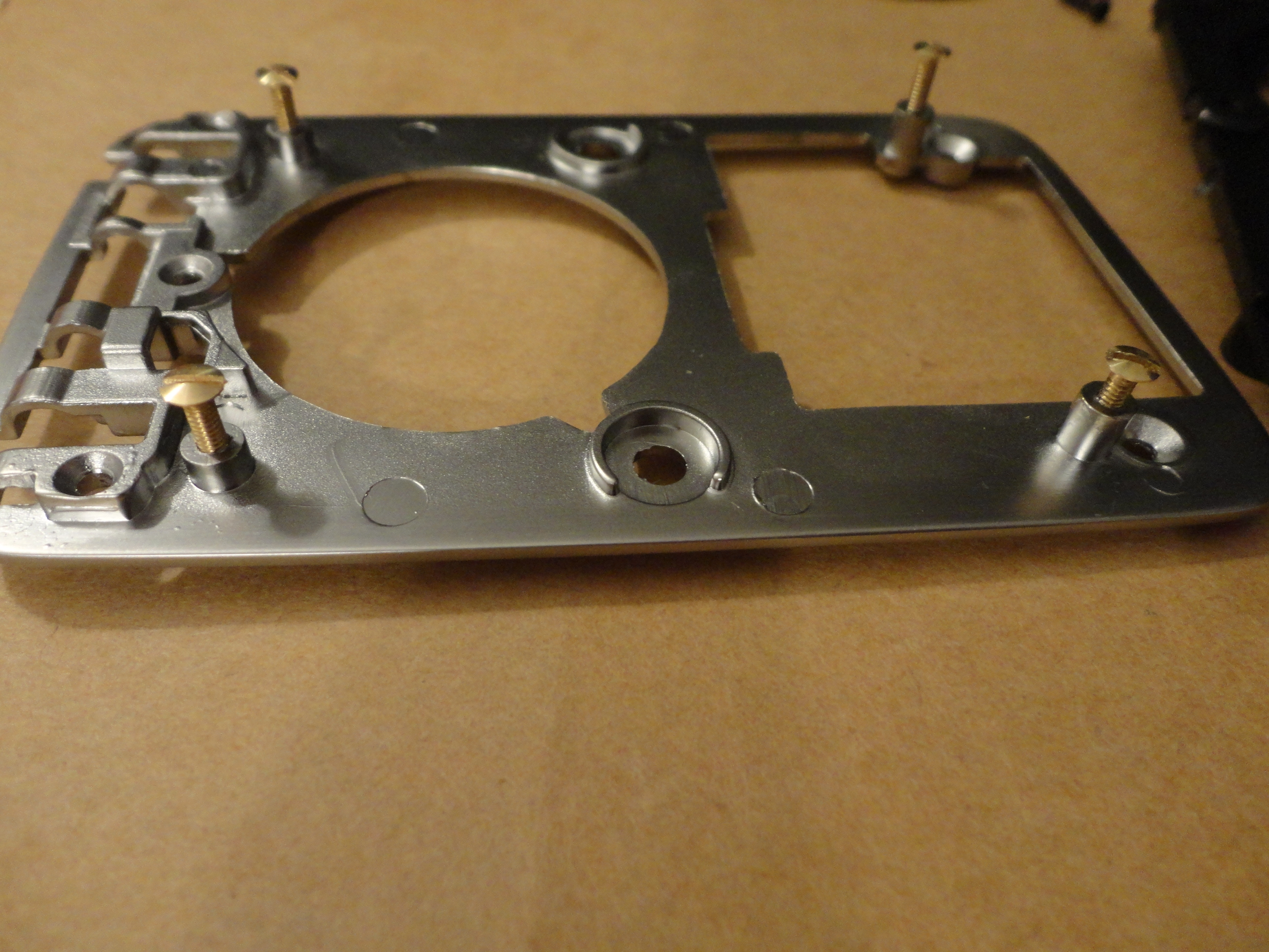

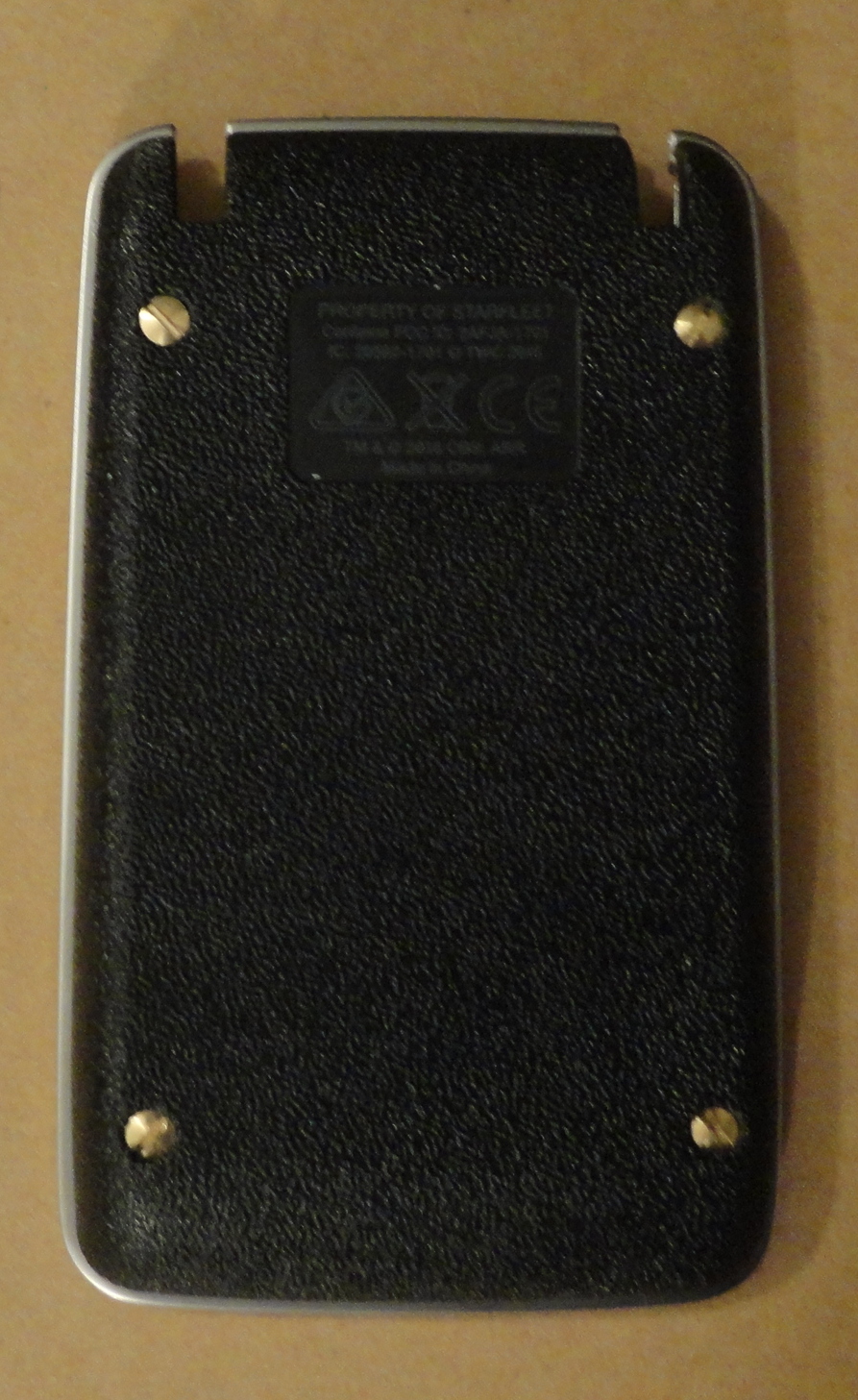

The new screws fit perfectly onto the mid plate now.:)
Need to put the back cover on and see how it looks.
Keep your fingers crossed! ;)
Re: Star Trek TOS Wand Company Communicator Modification Project! Alpha To Beta Vers
That looks really nice.
Is there any way to simply unscrew the black original screws, than screw a brass flathead like yours ? I don't want to have to unscrew and drill out mine ( When I get one, or if……), also what is the diameter of the threads on the original. maybe I can just buy some brass flatheads with the same diameter
Thanks
Cole
Thanks
Cole

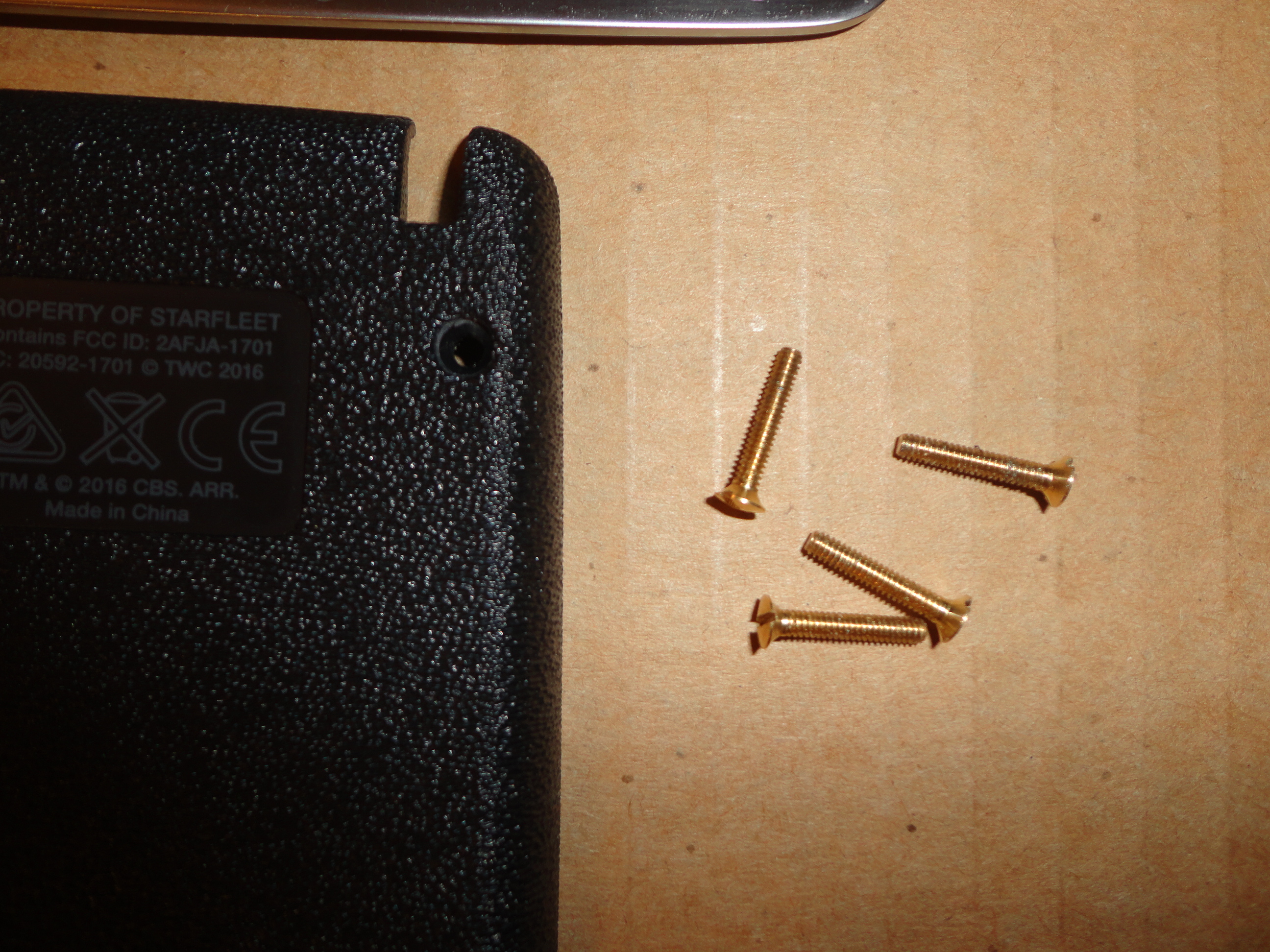

Cole you should be able to remove the screws and use a replacement. You will just need to find some brass screws that have the same size thread as black screws. I don't know it's exact size but the black original screws are smaller in diameter when compared to the brass oval head ones I just put on.
I'm using brass oval head 2-56 thread size which is the same size as on the original prop.
I got them here at the sci-fi-props place.
http://scifiprops.ecrater.com/p/23607642/star-trek-communicator-style-screws

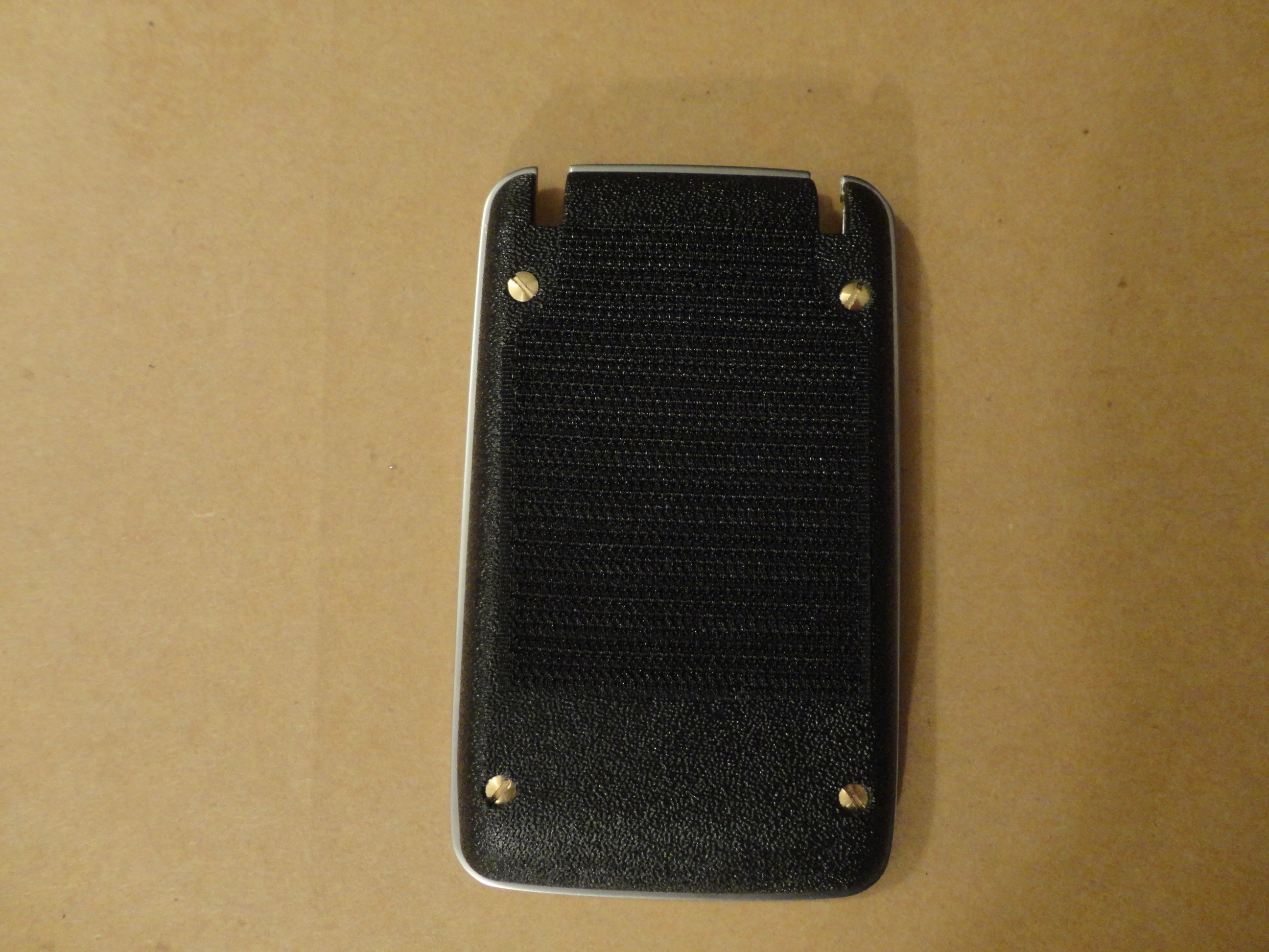

I think this will work nicely to cover up the markings on the back cover.;)
I need to find some glue that will hold it on permanently though first.:unsure
Will you still be able to charge it with the velcro, if so which brand did you use ?, Keep up the good work, Your doing a fine job :)
