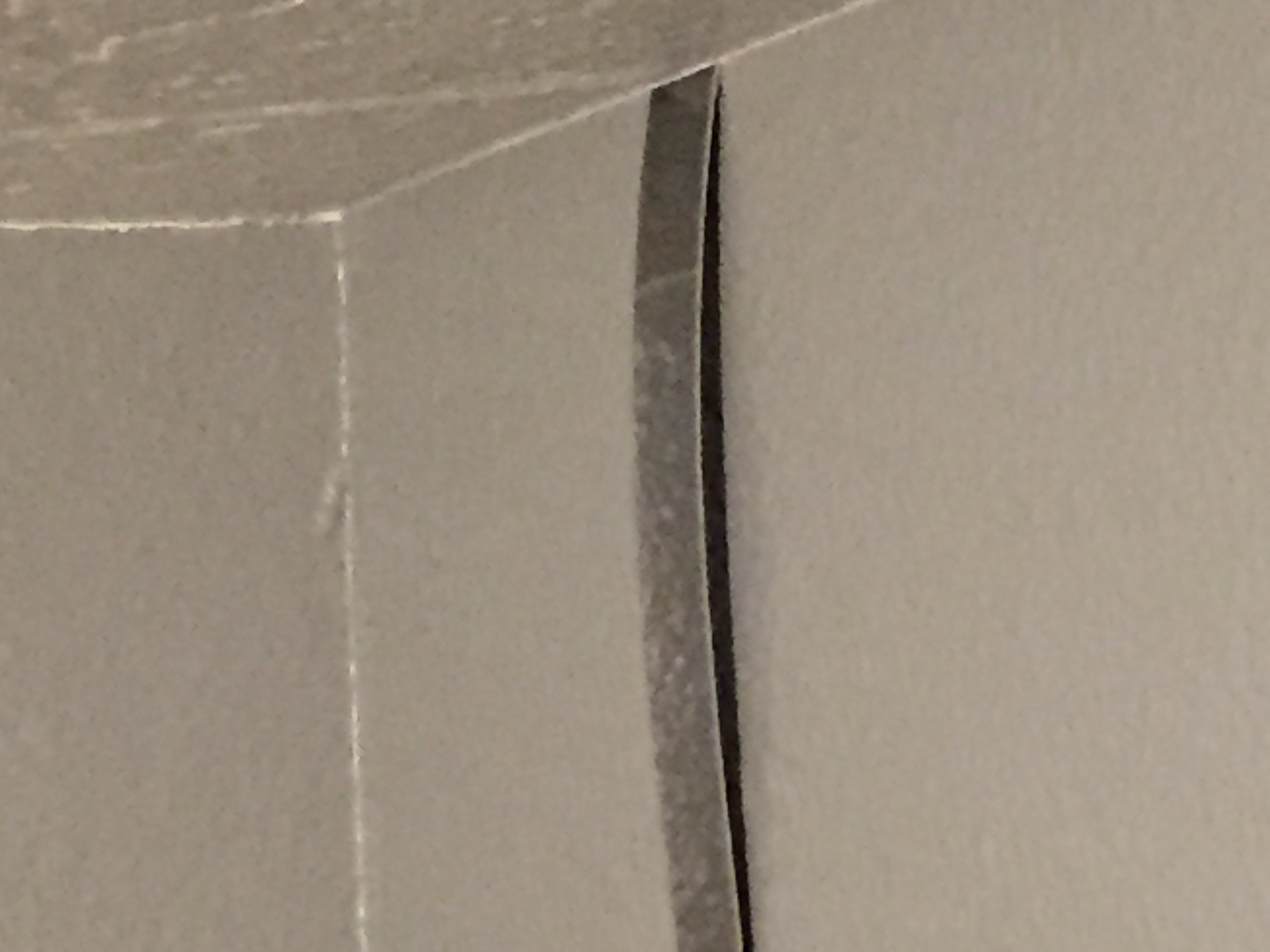

I re-applied the first stripe using the "permanent" tape, and I'll tell ya not much likes to adhere to latex wall paint. (Unless you don't want it to, then that's another story.) The good news is there were no "popping" sounds as I burnished the tape down, but it still separates easily when pulling on it. (I know, then don't pull on it. But I wanted to test how well it "sticks".) So for now, it's a wait and see how she looks in the morning.
I won't be buffing the surface to dull it. With 0000-grade fine wool it looks "scratchy" and I really don't want to spend the amount of time it would take to process 60-feet and end up looking worse than having light reflections from the tape, so shiny chrome it will be.
Starbase101
Nope, already pulling away from the wall:
Next contender to try will be Loctite Clear Power Grab construction adhesive....

Yay - it looks like the construction adhesive is holding the silver tape down. Again, the-morning-after will show for sure, but the tape hasn't lifted during the adhesive set time so it's unlikely to occur past that. If it still looks good in the morning I'll have a path forward for the remaining stripes.

Thanks, isn't that the truth - some people make things look so easy, their projects practically build themselves. Yes it's frustrating now, but later when this is all done it will be worth the time spent. The first silver stripe is as pretty this morning as she was last night, so I can now finally apply the rest of the stripes and then start getting furniture set up. It's too bad I didn't know a week ago what I know now or I could have had all the tape up by now.
Starbase101
Have you tried heating it with a blow-dryer?
It looks like it wants to curl back into a rolled up state.
I agree it's wanting to revert back to its coiled state, but even flat (in the middle of long lengths rather than just at the ends) there is little adhesion to the wall paint. Having an ABS base I think it would need to get pretty warm for it to "relax" and I don't want to risk damaging the chrome finish. Besides, it bonds well to the wall using the Loctite glue so there's no longer any issue with the tape. I have learned to uncoil a long segment and let it relax flat for about an hour which helps remove the curl from the tape.
