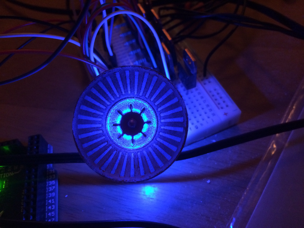

I've been working on the Bussard rotors from the ParaGrafix set, and thinking about how to mount them to motors. The brass parts are quite complicated to build, and I mounted them on 2mm OD brass tube so that I can motorise them later. That meant that I had to drill out the 1.6mm holes in the centre of each part and to fit the 2mm tube, and unfortunately the drill caught a few times which made a bit of a mess. I think I got away with it though. One painted black, and one in its raw brass form below:
Photo 03-08-2014 19 58 20 (Medium).jpgPhoto 03-08-2014 19 59 04 (Medium).jpg
Unfortunately, the motors I ordered were too low powered, with a much too high nominal speed to handle PWM control down to the speeds I need for the Bussards. I have some new motors with miniature gearboxes on the way.

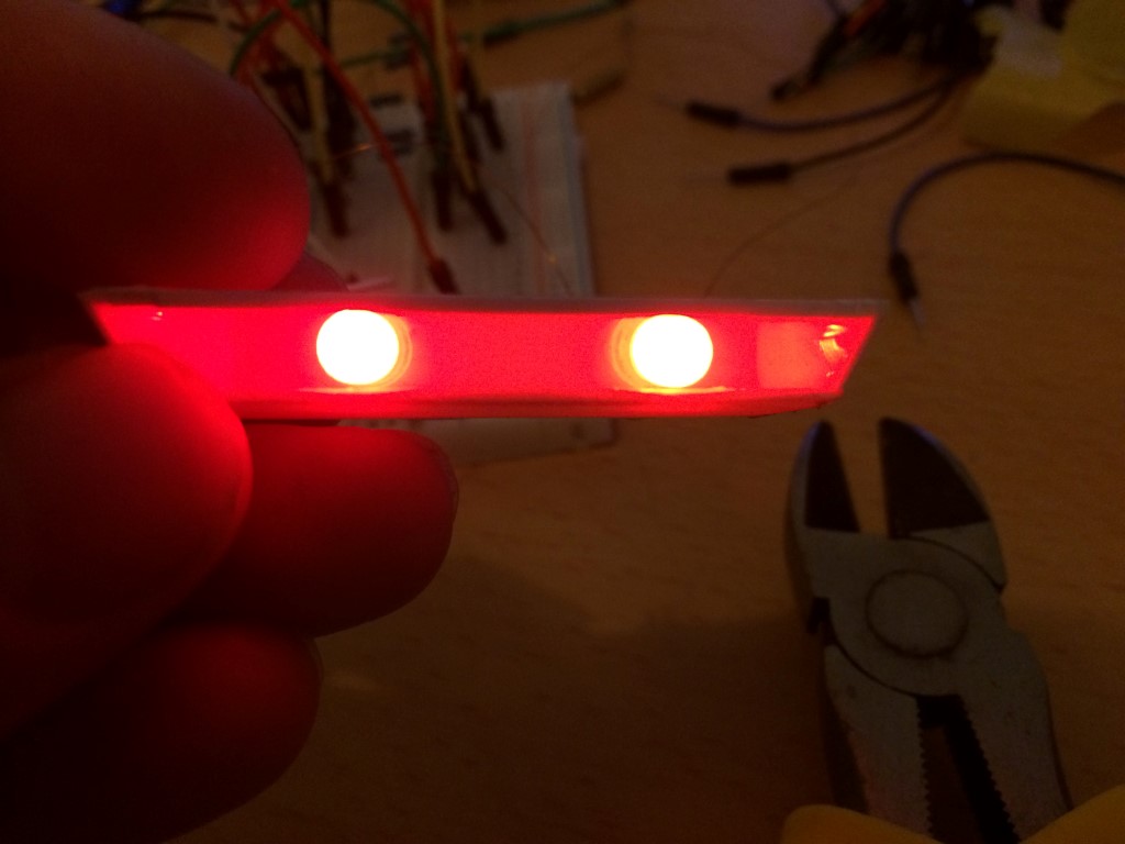

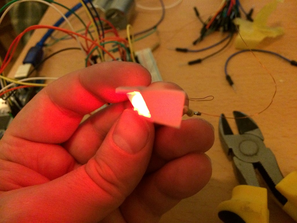

In other news, back to electronics! I built a small light box from styrene for the LEDs behind the impulse engines. The idea was to both isolate the red light from polluting the rest of the internal lighting, and to bounce it around in a nice white reflective surface to get a more uniform glow. The 5mm red LEDs have also been scuffed up with sandpaper to diffuse the light more - they were the very focussed clear package type:
Photo 05-08-2014 23 42 25 (Medium).jpgPhoto 05-08-2014 23 42 10 (Medium).jpgPhoto 05-08-2014 23 41 59 (Medium).jpg
A quick coat of black paint for light-blocking:

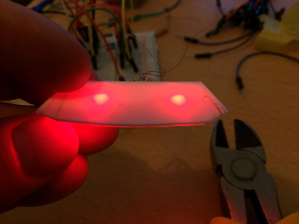

and a piece of clear plastic sanded with 400 grit to make it diffuse between the light-box and the impulse grills, and we get this:
I do love that ParaGrafix grill...
I've programmed the impulse lights to pulse along a sine curve, and can set the maximum and minimum brightnesses of the pulse in the code, so it can look quite subtle. Possibly a bit too subtle for this (terrible) video, but see what you think...

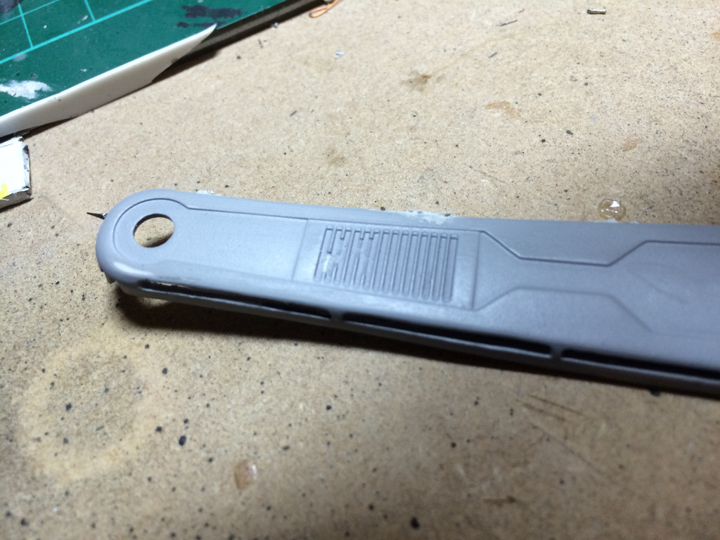

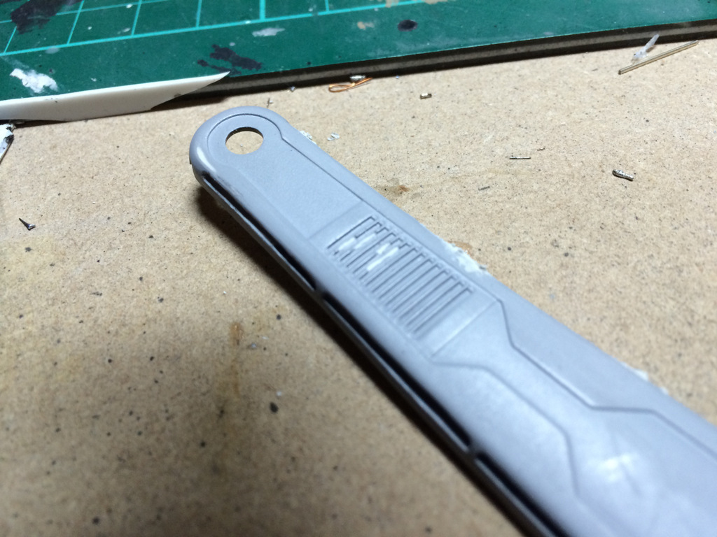

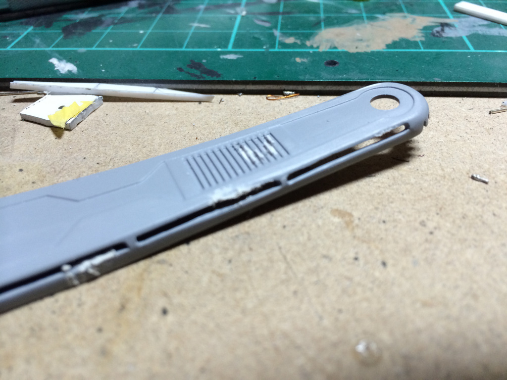

The rest of my work has really been on the spine piece. Once I got some primer on it I noticed that the grill on this part in my kit is damaged. I've already done quite a lot of work to this piece and I didn't fancy doing it again, so I'm attempting a repair with some 0.25mm strip styrene stuck into the holes side-on:
1-Photo 07-08-2014 22 43 10.jpg3-Photo 07-08-2014 23 00 37.jpg2-Photo 07-08-2014 22 46 33.jpg
There's a bit more refinement needed here but I think it'll be OK.

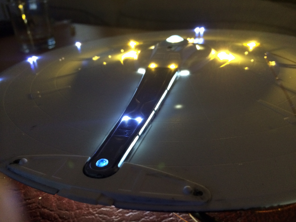

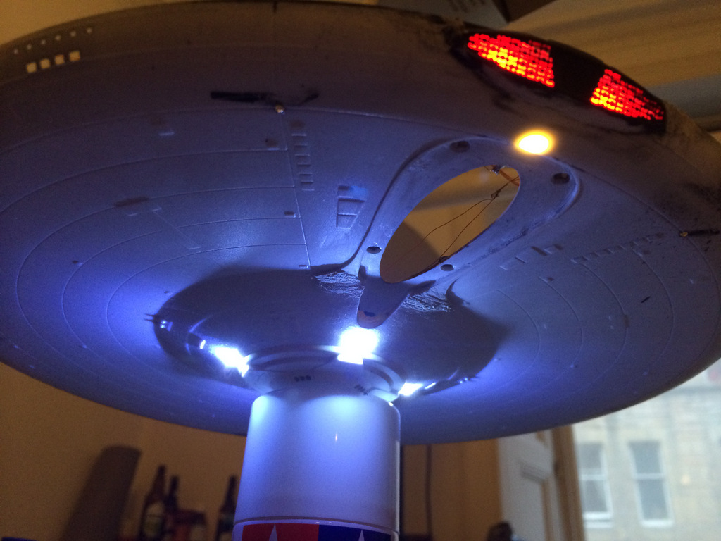

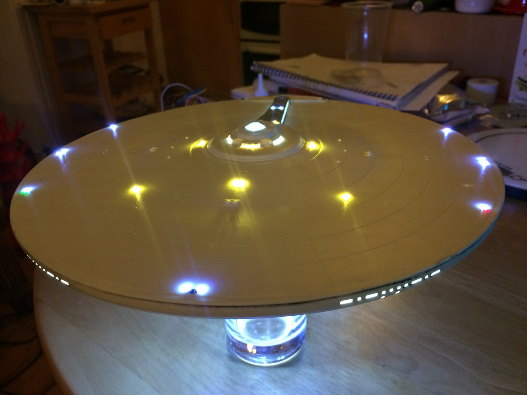

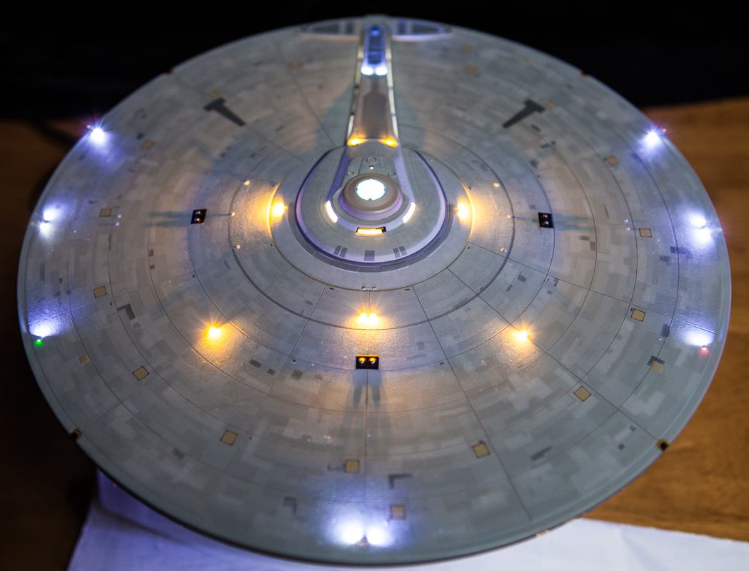

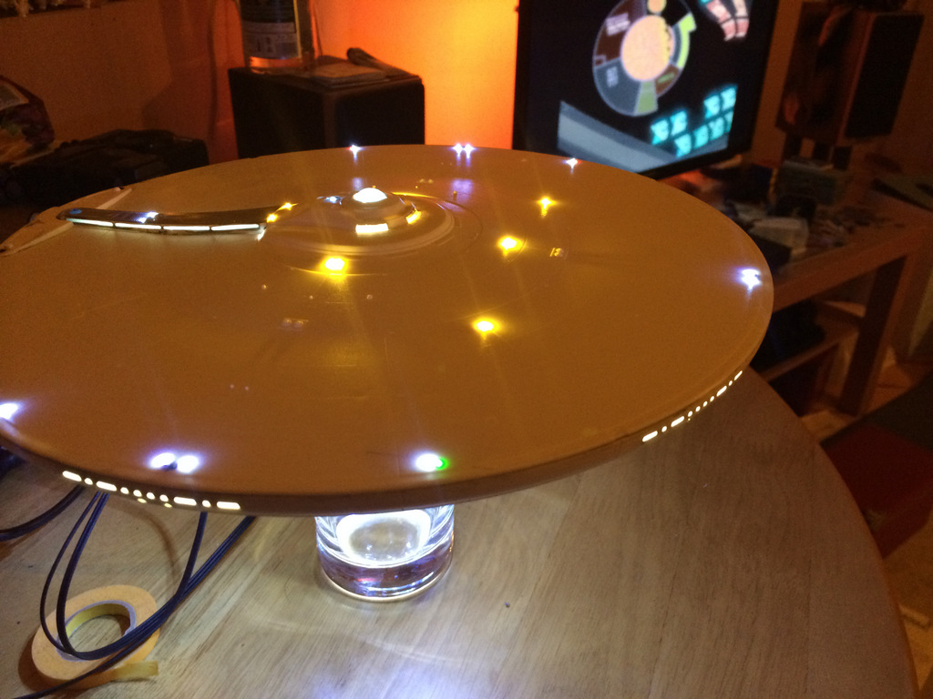

Finally, more lighting. I think, by this stage, I only have 4 more SMD LEDs to solder (for the pylon floodlights). If I never have to do another one again it'll be too soon (said he, whilst planning to use the leftovers on a Boeing 747 model).

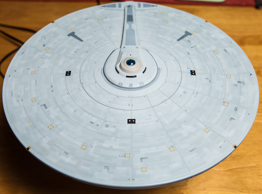

Saucer underside balancing on industry standard Tin Of Primer (tm):
The warm white spotlight you can see there is actually embedded in a 1mm hole, and is there to provide the floodlight down the dorsal of the ship. On the CG model, the source for this light is not visible. It's flaring into the camera here, but is actually a very tiny point source and should disappear once I've got paint on there.

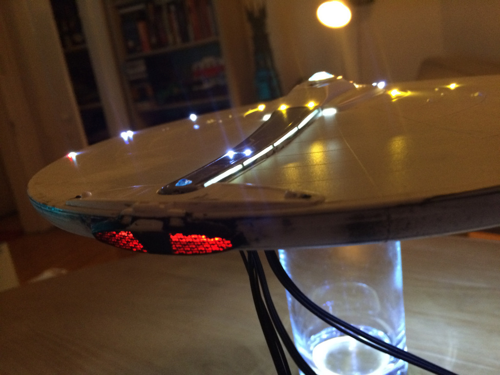

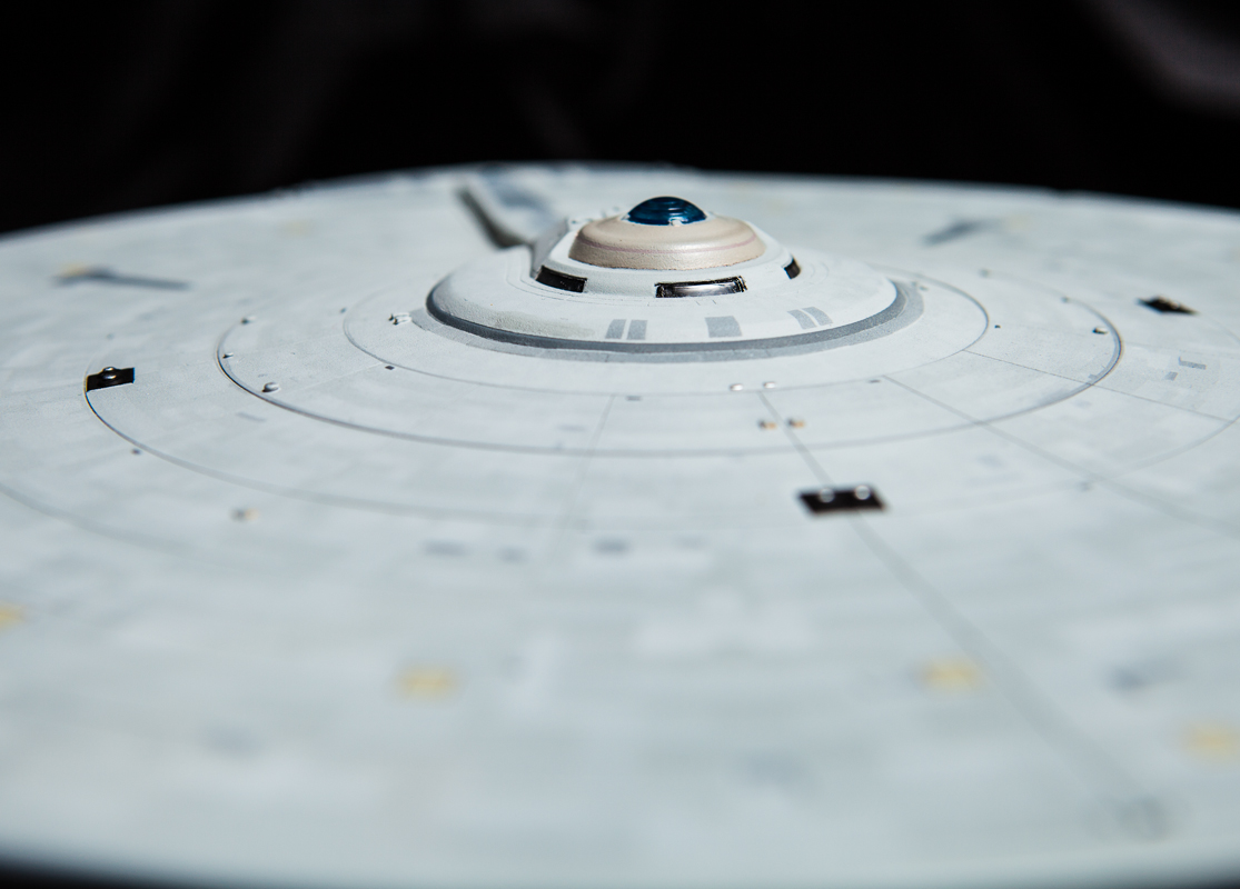

Finally, one final full-frontal saucer shot...
One frustration that I have is that the warm white SMDs are significantly warmer than the warm white strip I'm using for the interior, and really have too much of a contrast. It wouldn't be too much of a problem but I've mounted one inside to light the Paragrafix brass etch bridge, which otherwise would be much darker than the left and right bridge windows. I might experiment with more photographic gels to colour correct that a bit, but the ones on the saucer top will have to stay that warm, because frankly I am not cutting 10 SMDs off, resoldering onto cooler ones, redrilling all the holes, cleaning up the CA glue I've anchored them with on the underside, etc etc etc.

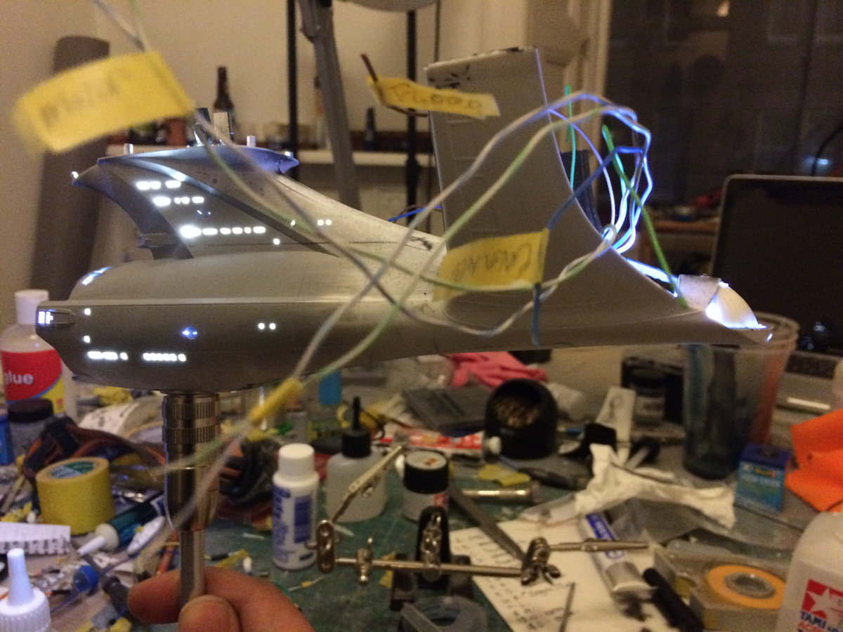

Brief update: I've tied all the internal wiring for the saucer together to a central point at the connection to the neck, using 3-pin computer fan connectors so that I can hook it up when I come to final assembly (I'm planning to paint the saucer and the e-hull separately):
This has been epoxied to the sheet styrene support I fitted to mount the internal LED strip for the sensor dome, spine and bridge lights.

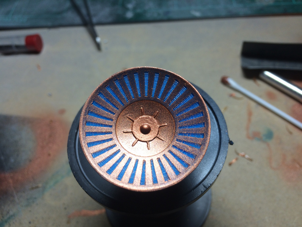

To take a bit of a break from that, I decided to paint the deflector dish. It appears to be copper coloured with blue "spokes", but when powered up entirely glows blue, apart from the central boss and mini-spokes.
In a mostly failed attempt to recreate this, I scuffed up the dish with a light sanding, gave a coat of Tamiya clear blue, and then light-blocked the boss and the back of the dish with white primer (to bounce light around the inside), followed by grey and then a coat of Tamiya copper. After this, I used Orbital Drydock's pre-cut kabuki tape masks to mask the spoke, and gave a light airbrushing of Tamiya copper over the main face of the dish.
I think the over-all effect is there, but it looks quite scrappy. It's OK when the lights are off, but the particulates in the copper paint are very visible when the dish is lit, and I'm not particularly happy about that. I'm not sure there's a lot I can do about it now though. Let me know what you think!
It's fine if I take my glasses off and look at it from the other side of the room though...

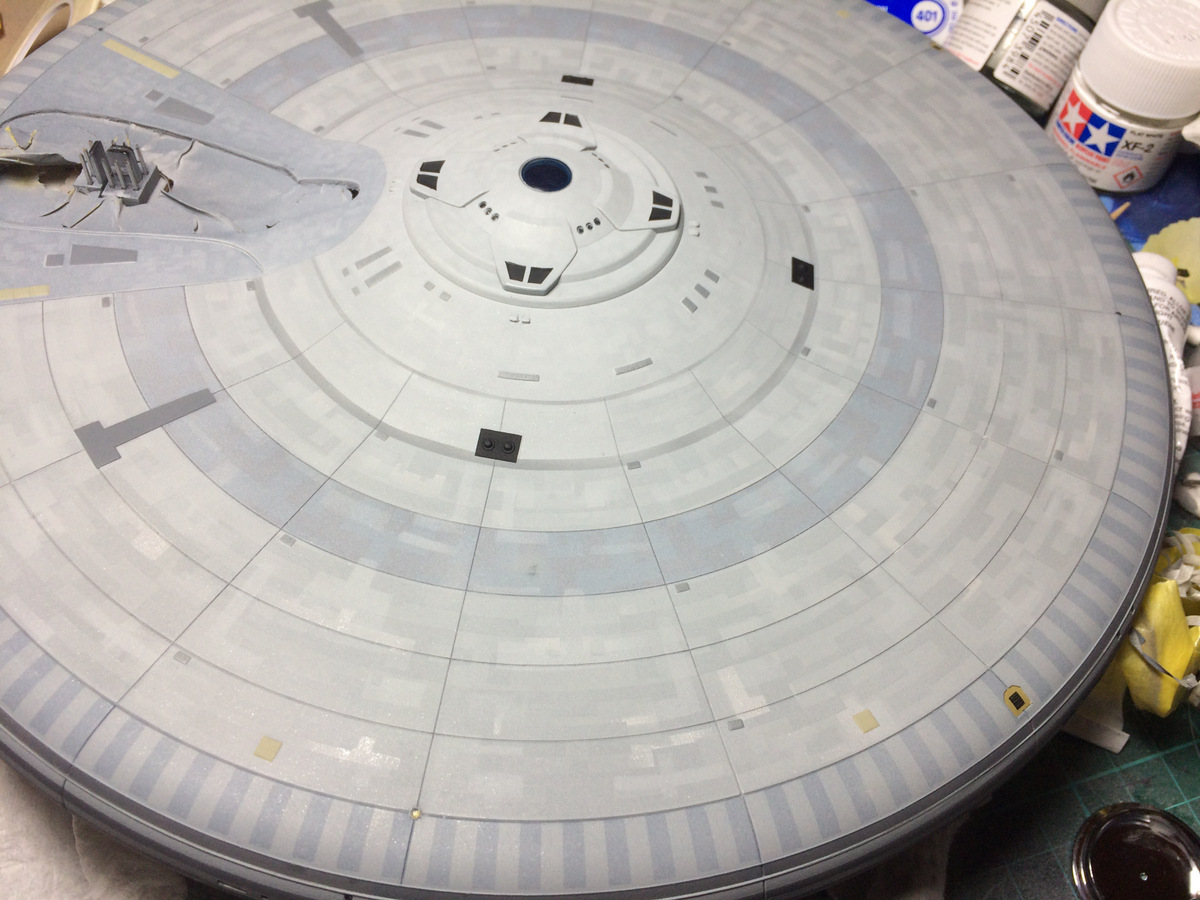

Apologies for the radio silence, progress has been slow, with lots of things cropping up that have had to take priority. I've been painting the saucer, using Orbital Drydock's excellent masking set, with a bit of extra texturing over the top for more hull plating. It's the first time I've ever attempted a paint job like this, so I started on the bottom of the saucer before doing the top! A shiny new Iwata airbrush helped - I went back and forth over whether I could justify it for a while but I'm very glad I did.
The layers are progressively lightened by going from the base grey, to a 25:75 grey:white mix, to a 50:50 mix, to a 75:25 mix, which was also used as a final blending coat. I may do a final 90% white blending coat, but from the blu-ray inspection I think it's actually greyer than a lot of people seem to paint it. I'm not at home so I can't remember exactly what paints I'm using, but I think it's the Tamiya medium ocean grey 2 (RAF). I can check when I get back if anyone's interested.
Here she is:

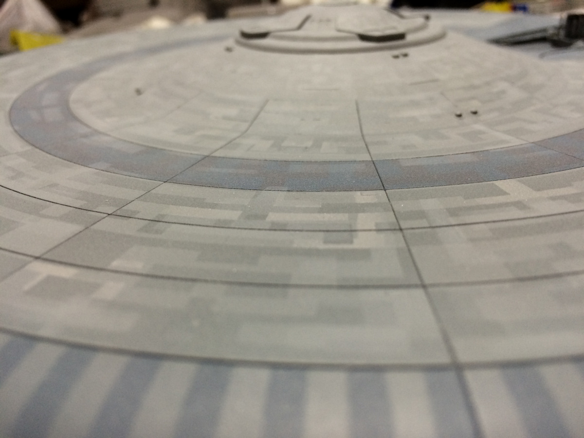

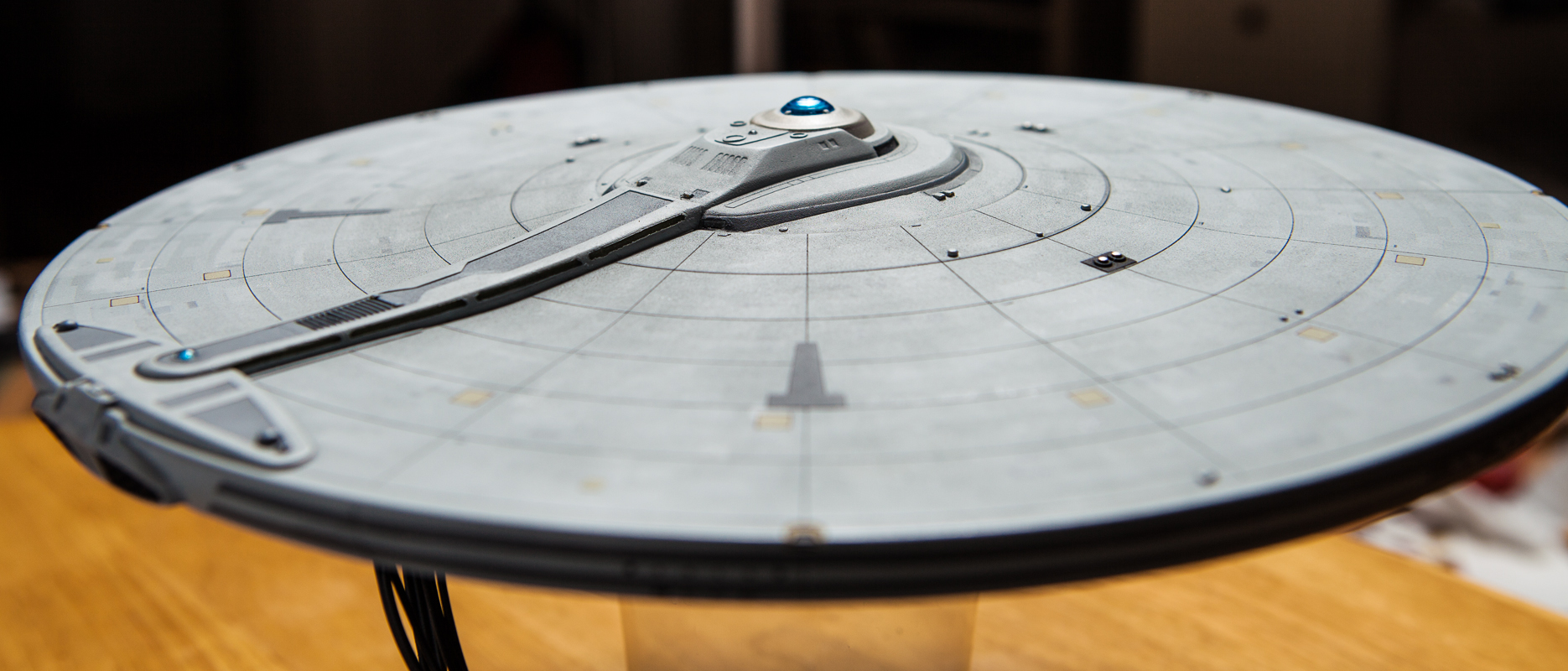

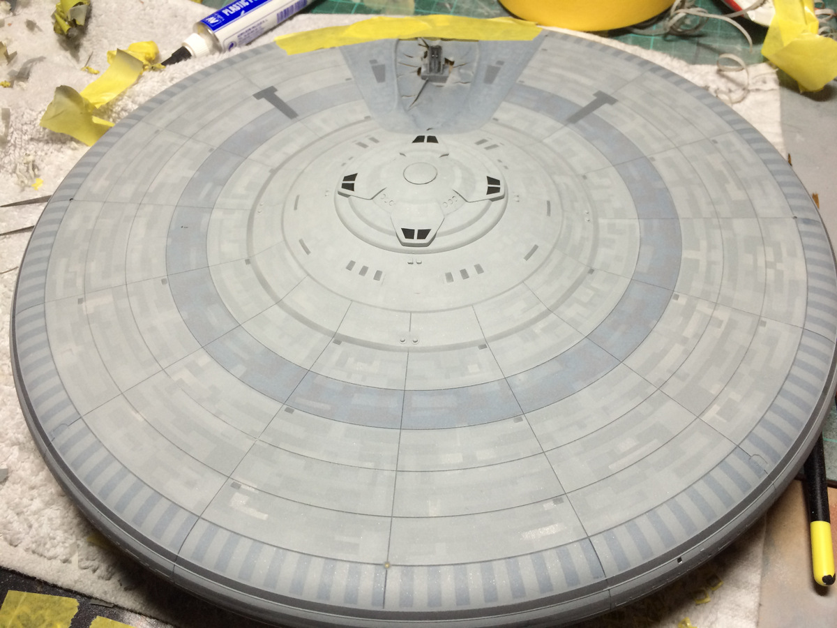

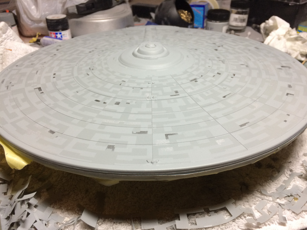

Weekend update: Paint!
Nearly finished painting the saucer this week. There is some detail work to do on the RCS thrusters, lifeboats, phasers, and some tidying up to do on the Impulse deck and sensor bands, but I think I'm pretty close. Can't wait to get the window and LED masks off and light her up now that she's painted.
Next up, paint saucer details, coat of Klear, and registry decals!

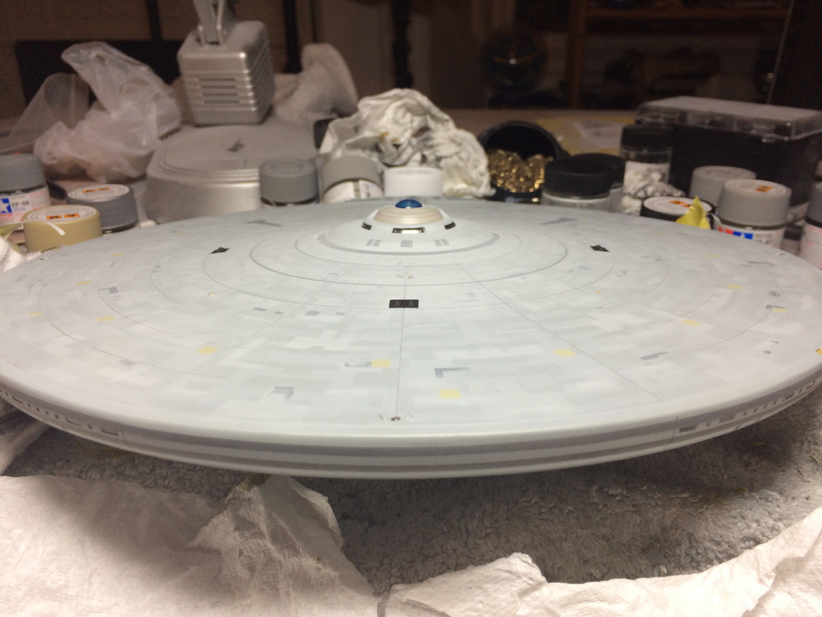

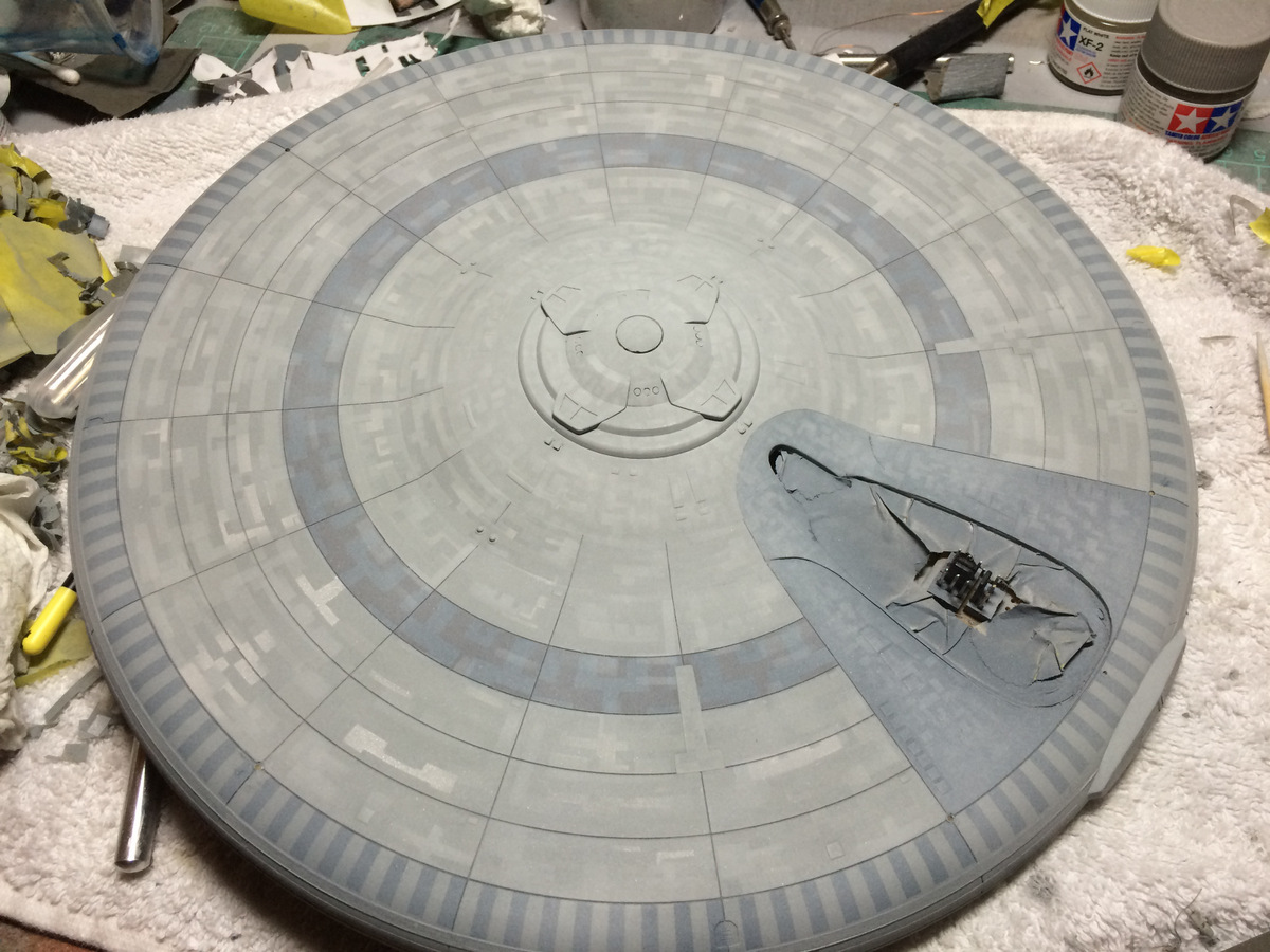

Post aztec, pre texturing:
After texturing, blending coat, and some detailing:

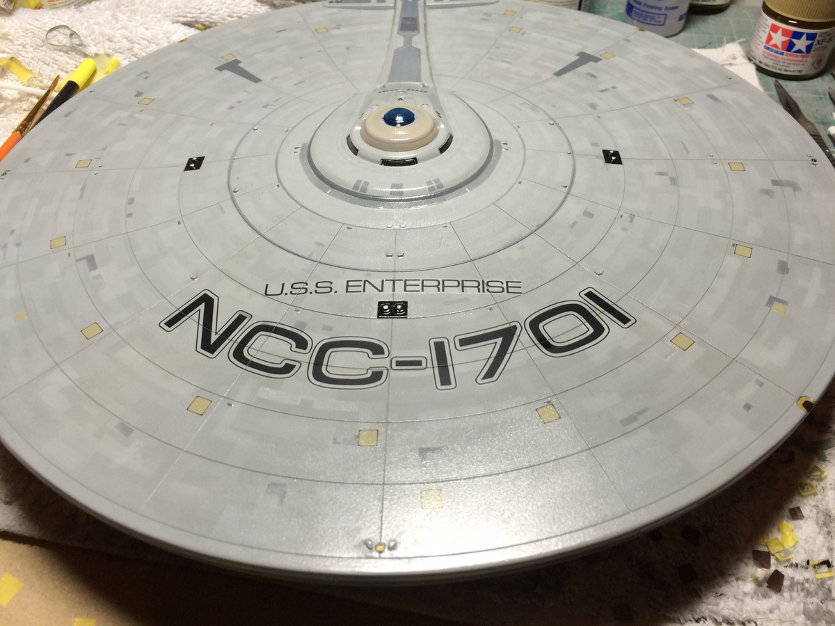

Thanks Jim, I really appreciate it. Like I said, this project has been a big learning curve for me, so it's really good to get feedback.
Well, no decals applied yet, and the unlit windows behind the bridge need to be painted with some gloss black, I think the saucer is finally close to being finished. It also needs a rub-down (I didn't notice how dusty it was until I shot these pictures), and then I'll give it a coat of Klear ready for decals. Final finish will be satin. I painted the dark red outline around the lifeboats by masking the interior using the left-over negatives from the Orbital Drydock set, and then masked around the outside leaving a small gap. Quite please with how it's worked out.
Pictures!
Pictures with lights on!
Incompetently shot cell-phone video for blinking strobes (featuring my finger in a starring role)!
Final work on the saucer should be done tomorrow (although I'm still waiting on aftermarket decals), and then it's back to lighting the engineering section and starting on the nacelles.
Cheers,
Hugh

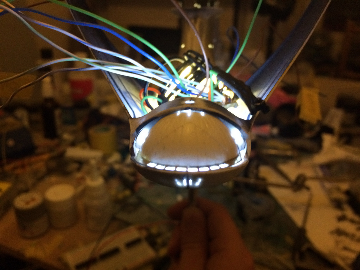

- engineering hull sealed up (apart from the final pylon piece, so I can still fiddle about inside)
- Shuttlebay doors fitted with 1mm optical fibre on the sides, and 0.25mm for the top spotlights. Clear styrene (scuffed up with 320 sandpaper) fitted under the photoetch part to diffuse light. 0.25mm optical fibres bent at 90 degrees with a bit of gentle heat (very gentle, or else they just melt!) and inserted into holes drilled in the stern, for the rear registry floodlights. The bends will be covered with styrene or putty and the idea is to have small points of light flooding up the back. I'm not sure how well this will work, but we'll have a go. All the lighting around the shuttle bay area is running off one LED:
Finally, last night I got the stand connector wired up. You can sort of see the airlock lighting in this pic (the fibre optics need trimming). I really need to tidy up my workbench:
