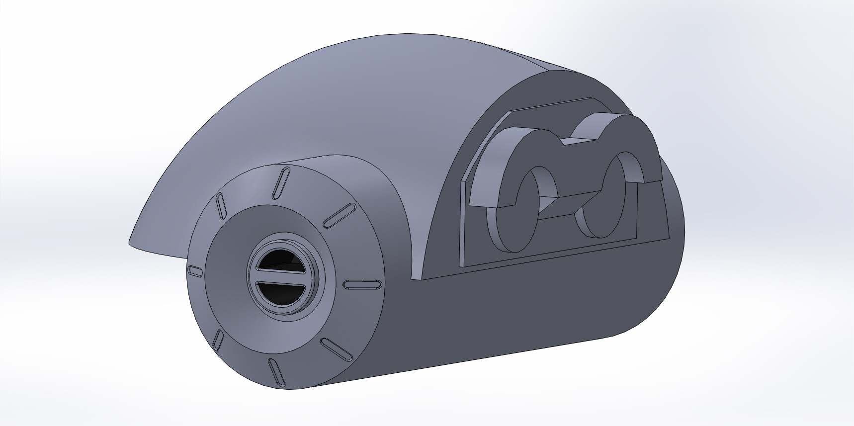

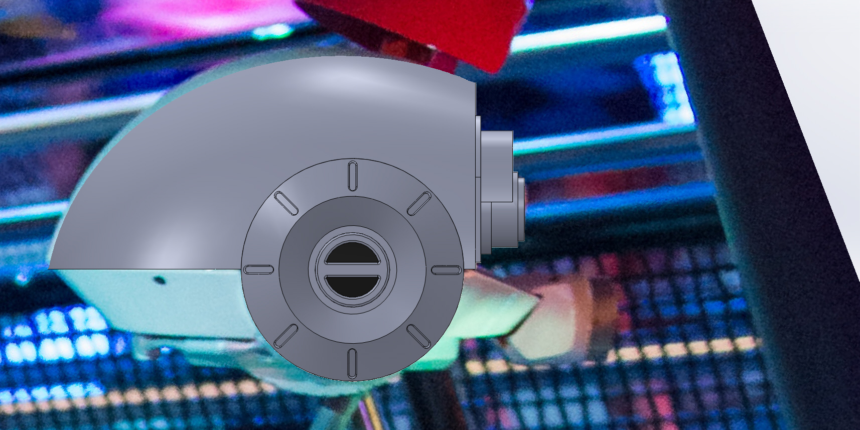

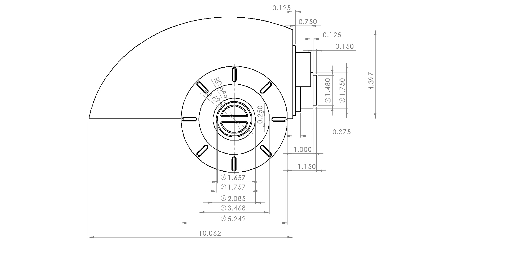

Awesome, Thank you friend! I got a small start today on the head, though there were some liberties taken. The top of the head isn't quite right (too tall) and the "ears" are continuous cylinders instead of ~5" deep slugs but you get the idea. My current best profile shot is right on the edge of frame and is subject to a lot of parallax so I'm going to keep looking for another profile shot.
Looks great haakesack! Is this in Solidworks?

Thanks! Yeah Solidworks (thanks, place of employment!). I would LOVE any reference shots you are willing to give me would be great. I'm completely missing top down or bottom up views, and all orthogonal views of the body. Try to use a long lens zoomed in if you can to minimize parallax and lens warp.

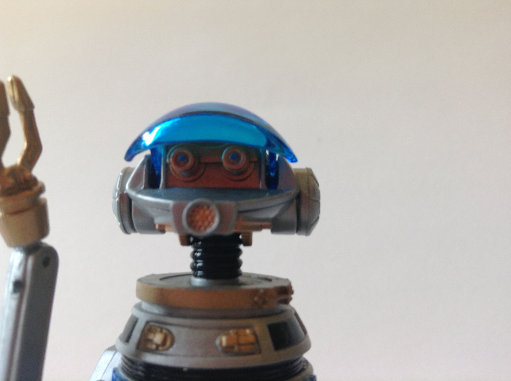

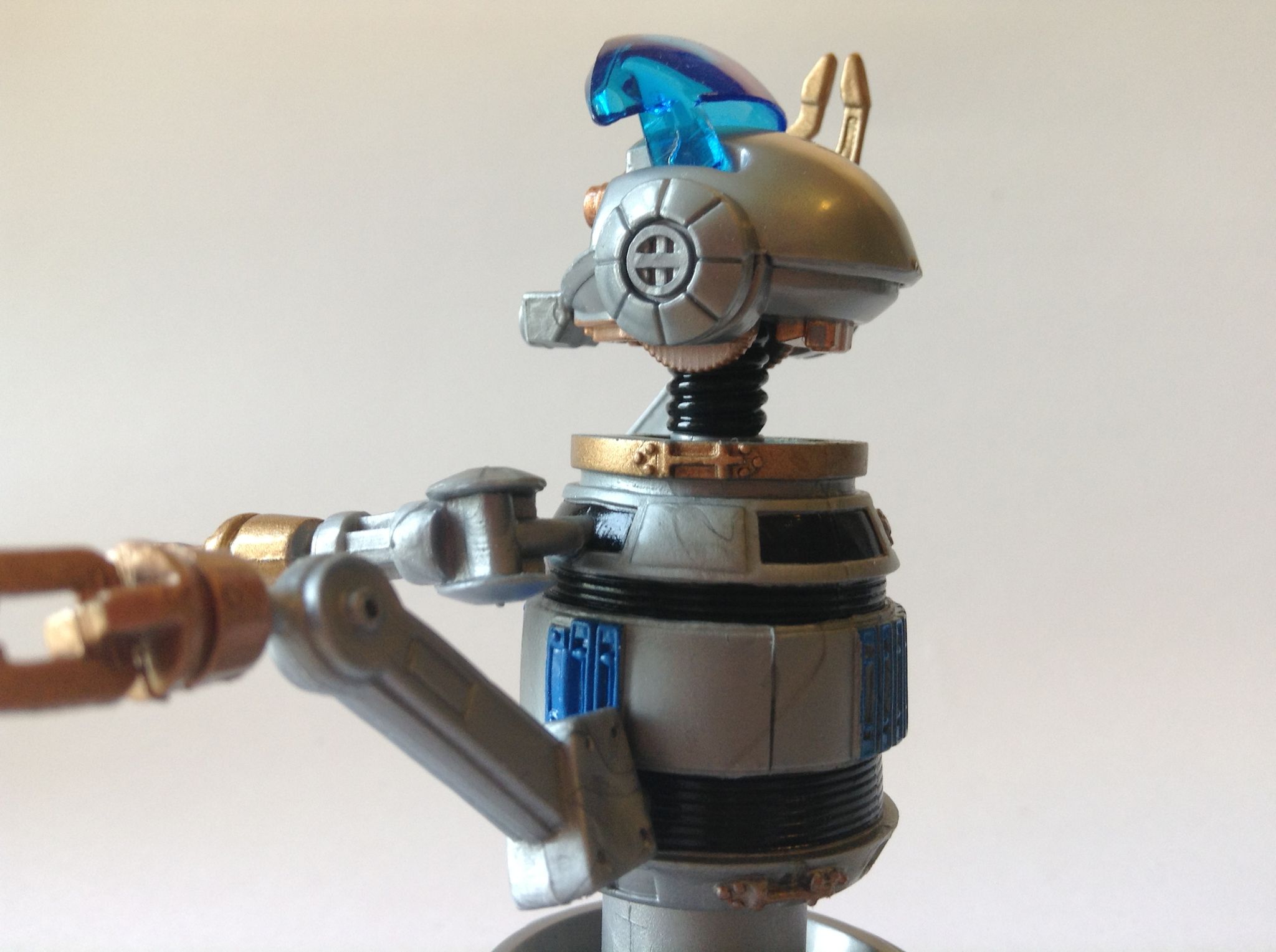

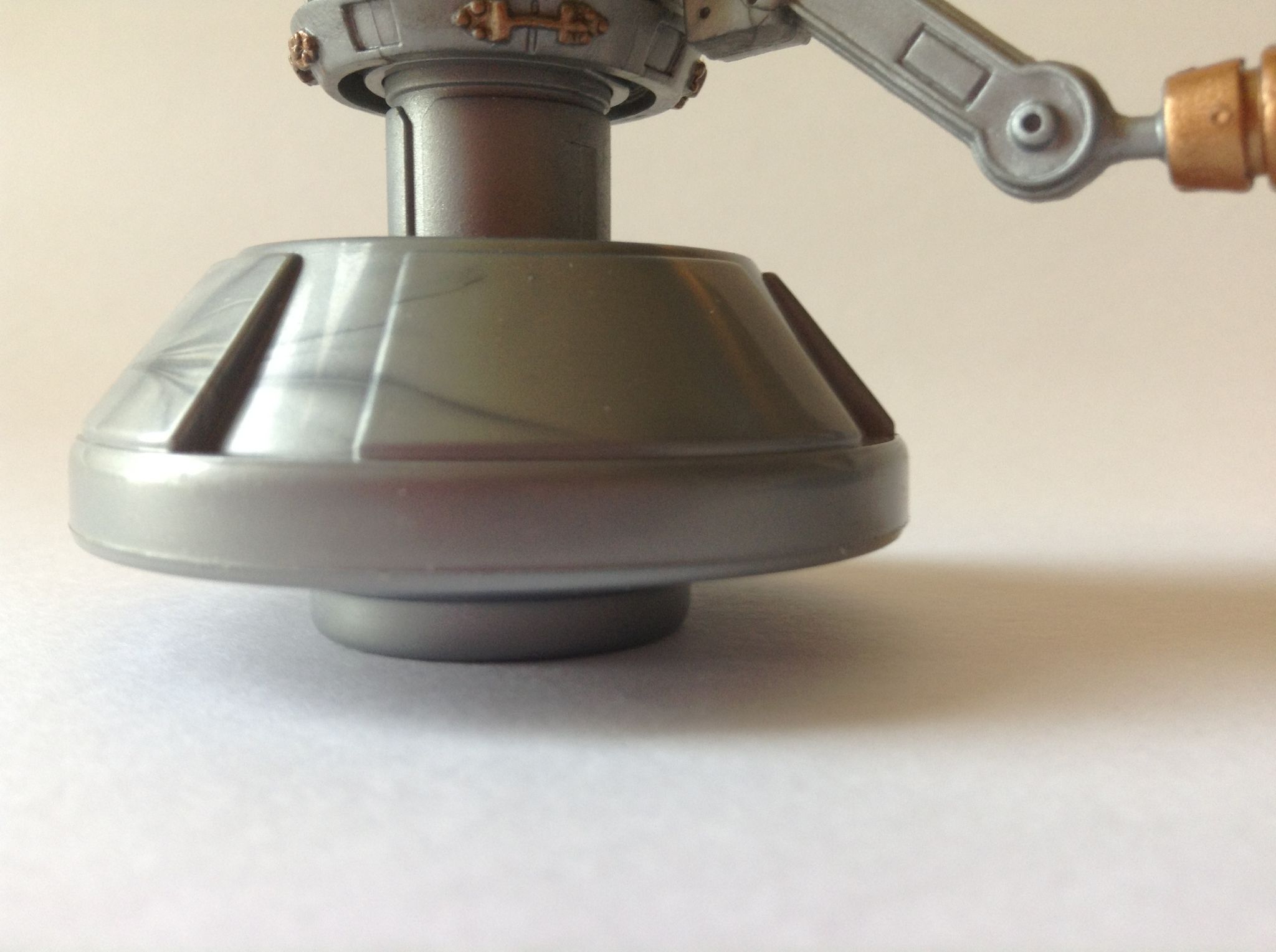

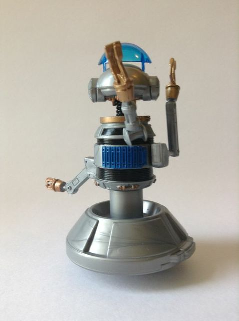

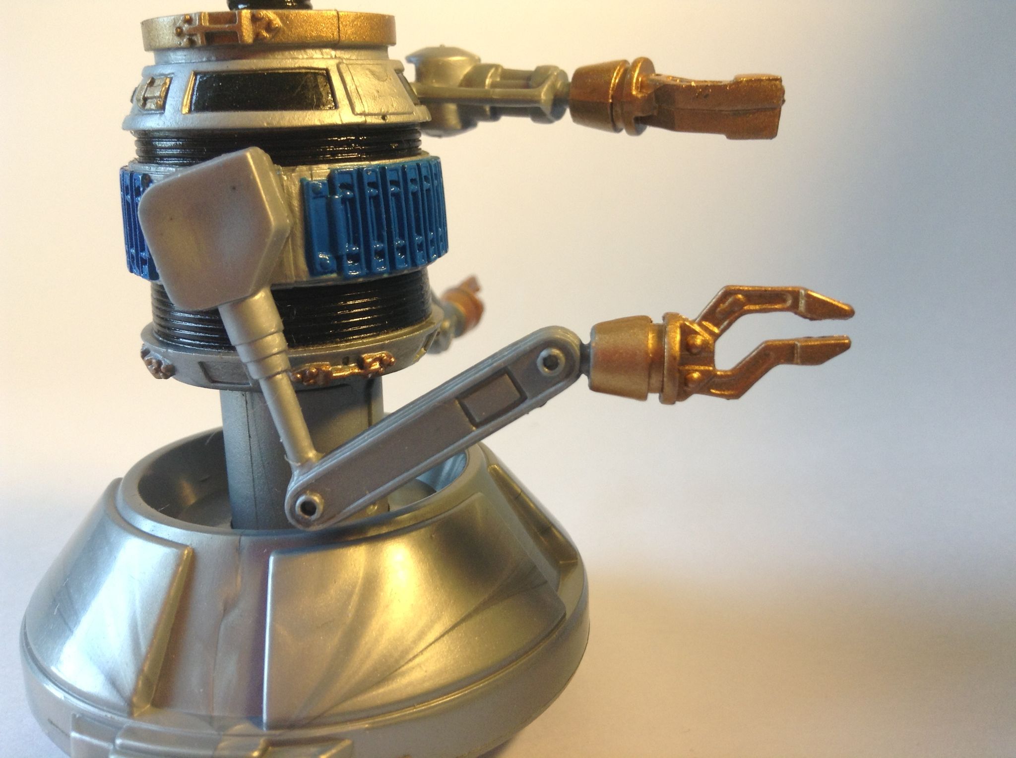

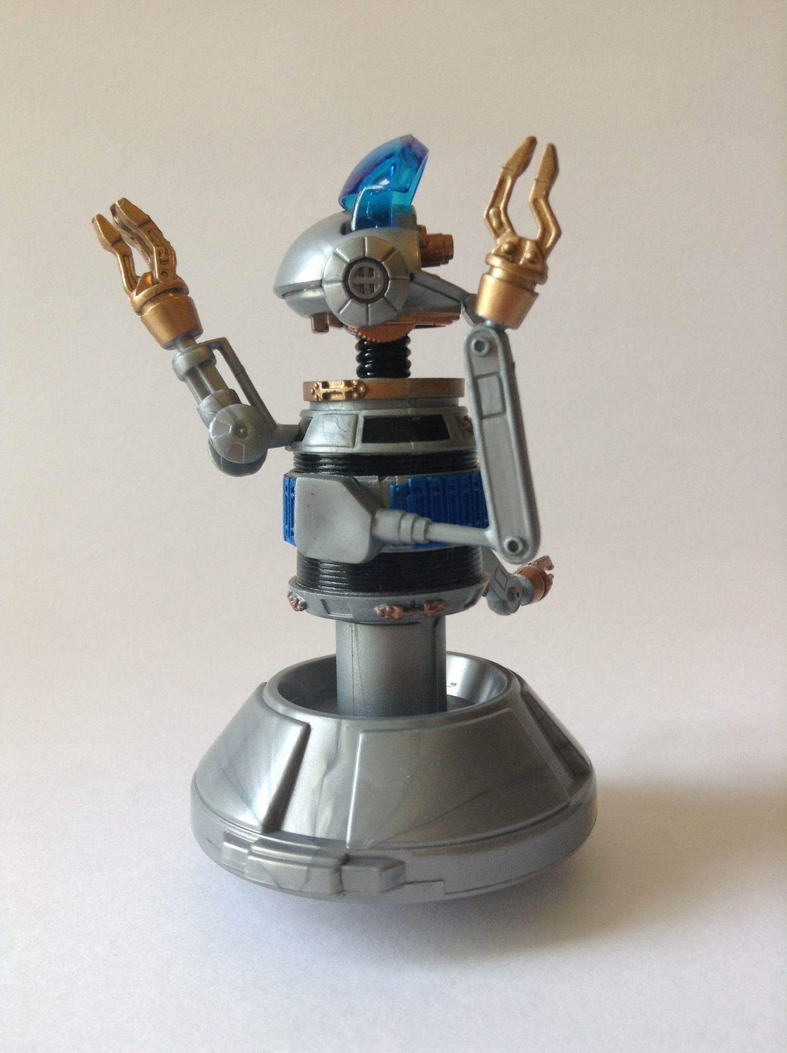

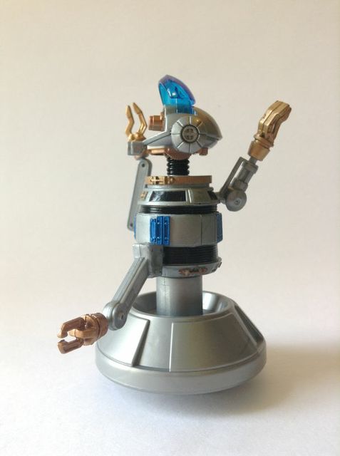

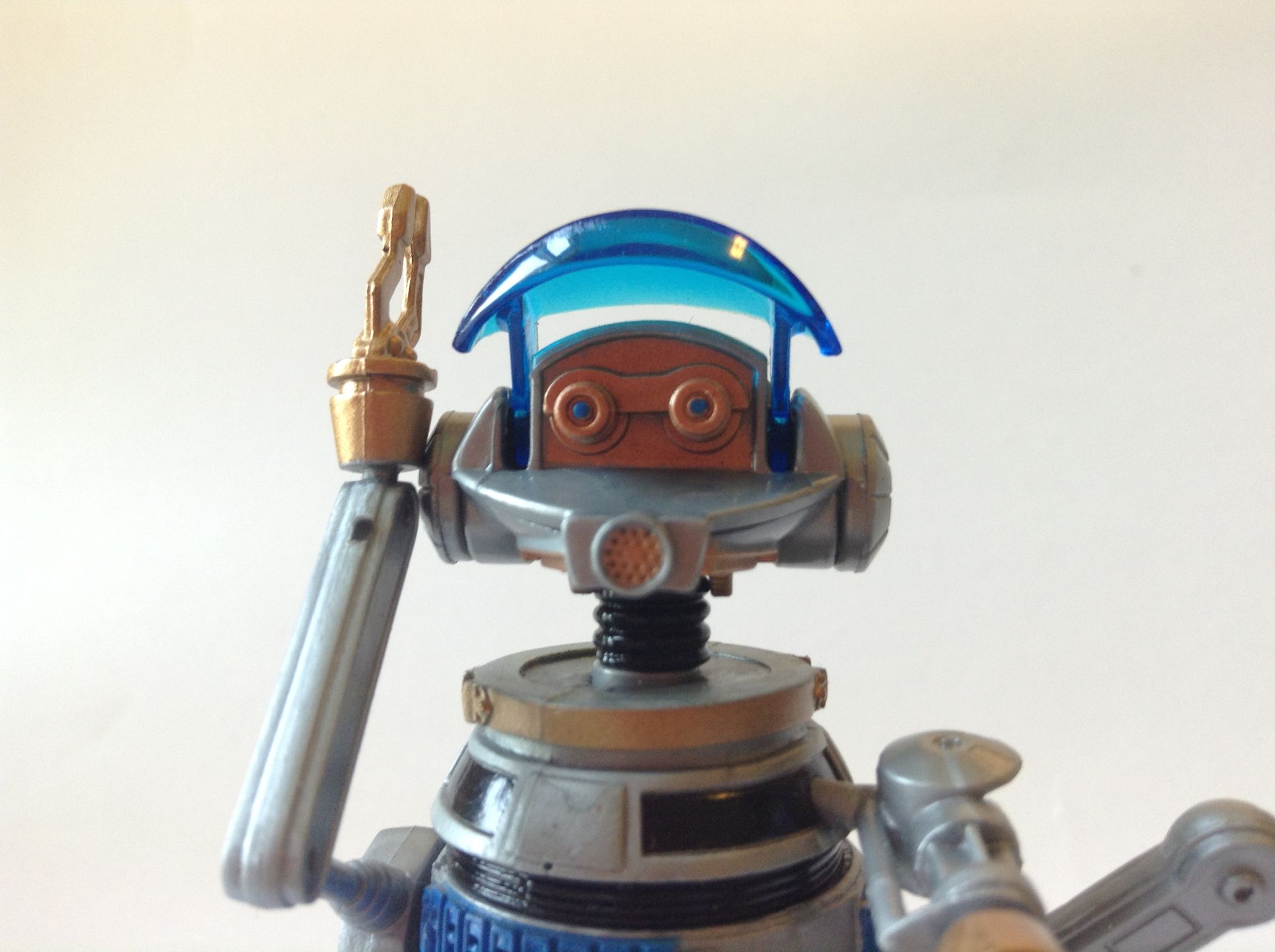

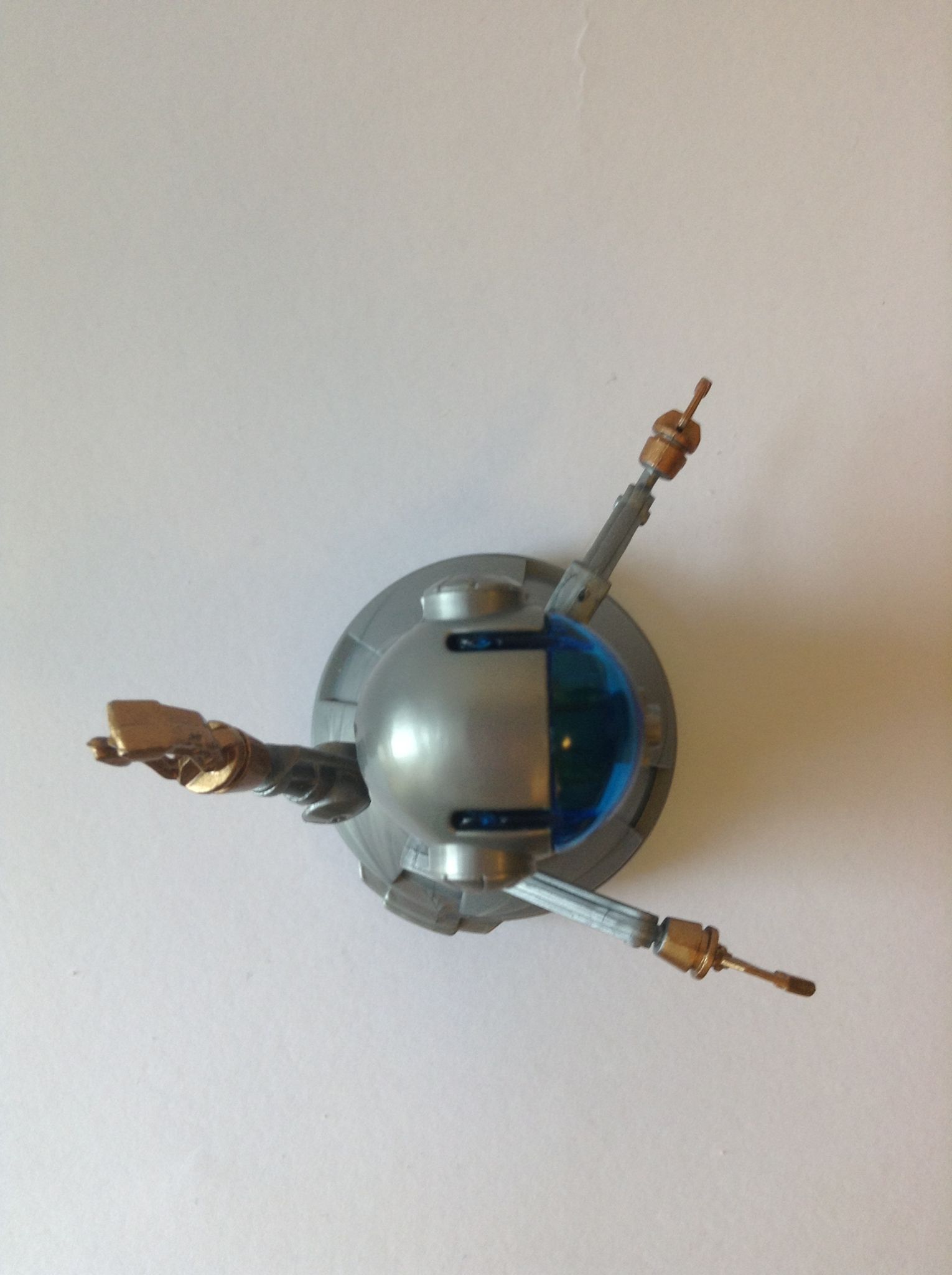

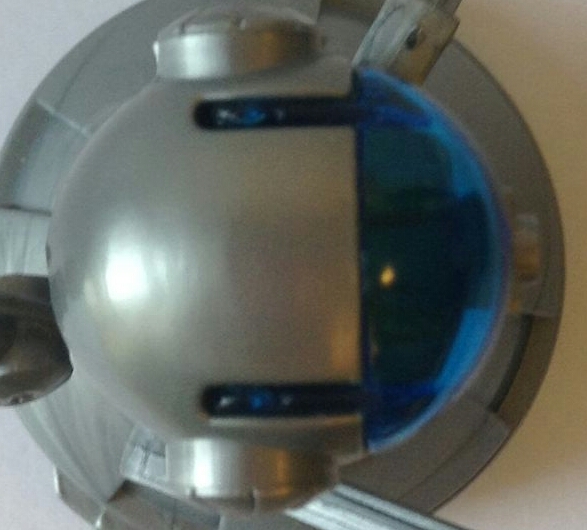

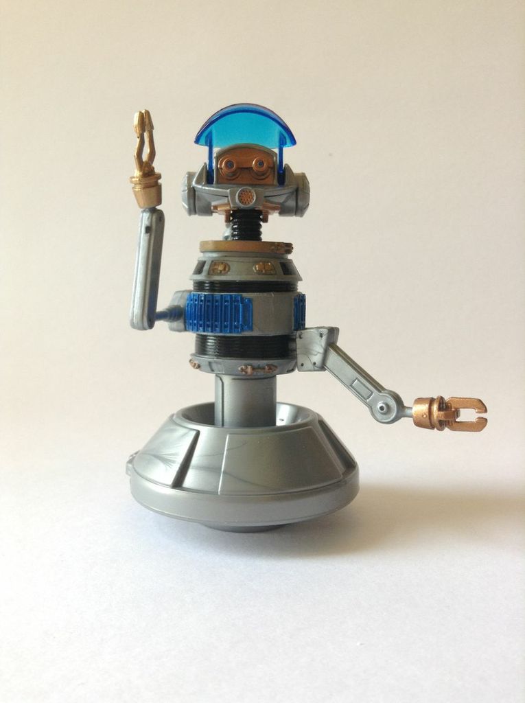

Here's some of the images I've taken of my new 10+ RX-24 Star Tours figure. I tried to take as many different angled shots as possible, so let me know if you want others. There's more on my dropbox.

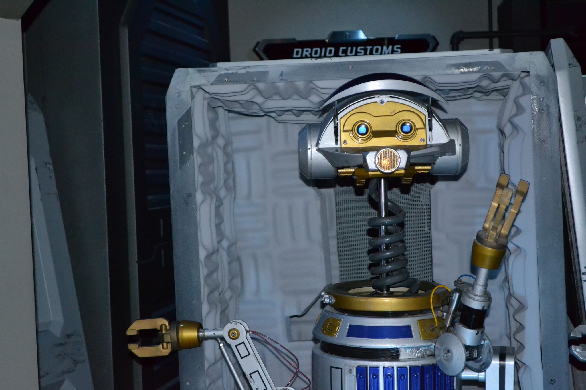

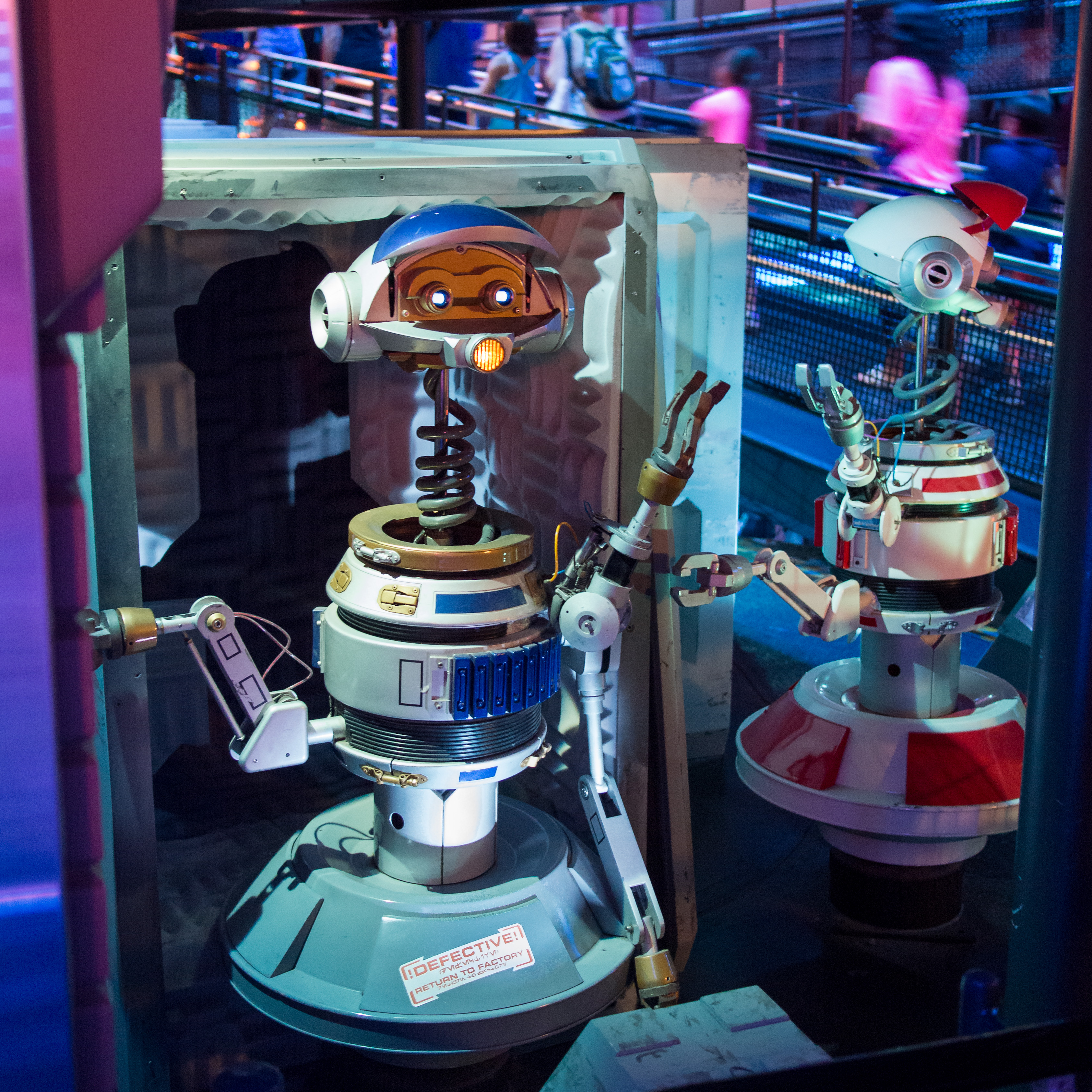

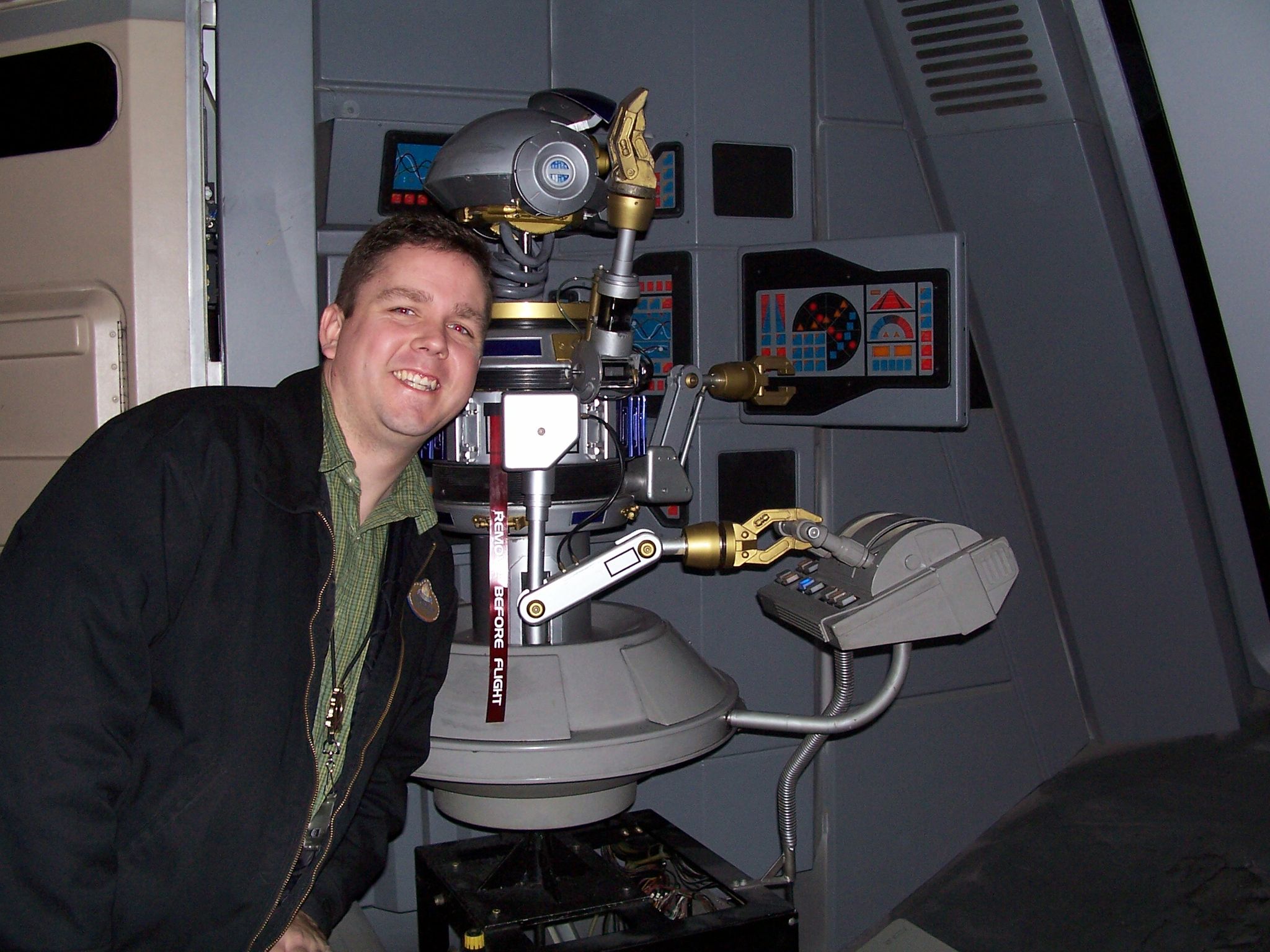

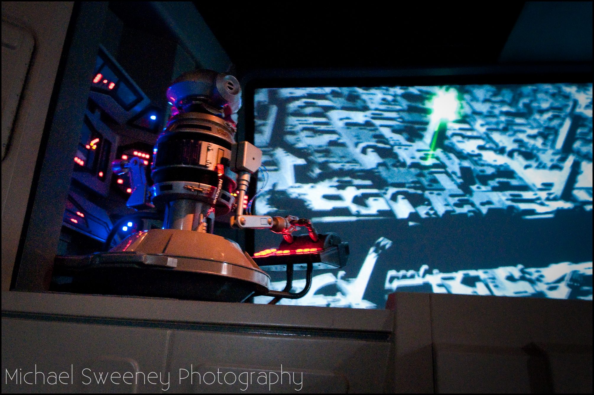

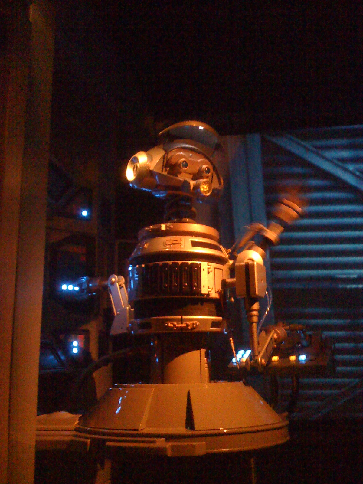

Also, here's a few of my own Disneyland images of the droid

I was a little unoccupied this morning, so I decided to try and get some ballpark measurements using the scale from the eye, hope it helps.
Vertical= 10.472
Horizontal=12.594. (Inches)

So I've tried and tried to get good measurements off of the views that I have but I just don't have clean enough side on views to get anything accurate. I'll give you some more detailed measurements from the head portion. It'll get you close but don't take it as gospel just yet. This was based off of a 2" mouth OD so it's probably oversized by 5-10mm. Also, I know the crown of the head is wrong so don't try to follow that curve. Also I'm getting a pivot pipe size of .78"-.85". I hope to narrow that down soon. Headdimensions.JPGside shot.JPG

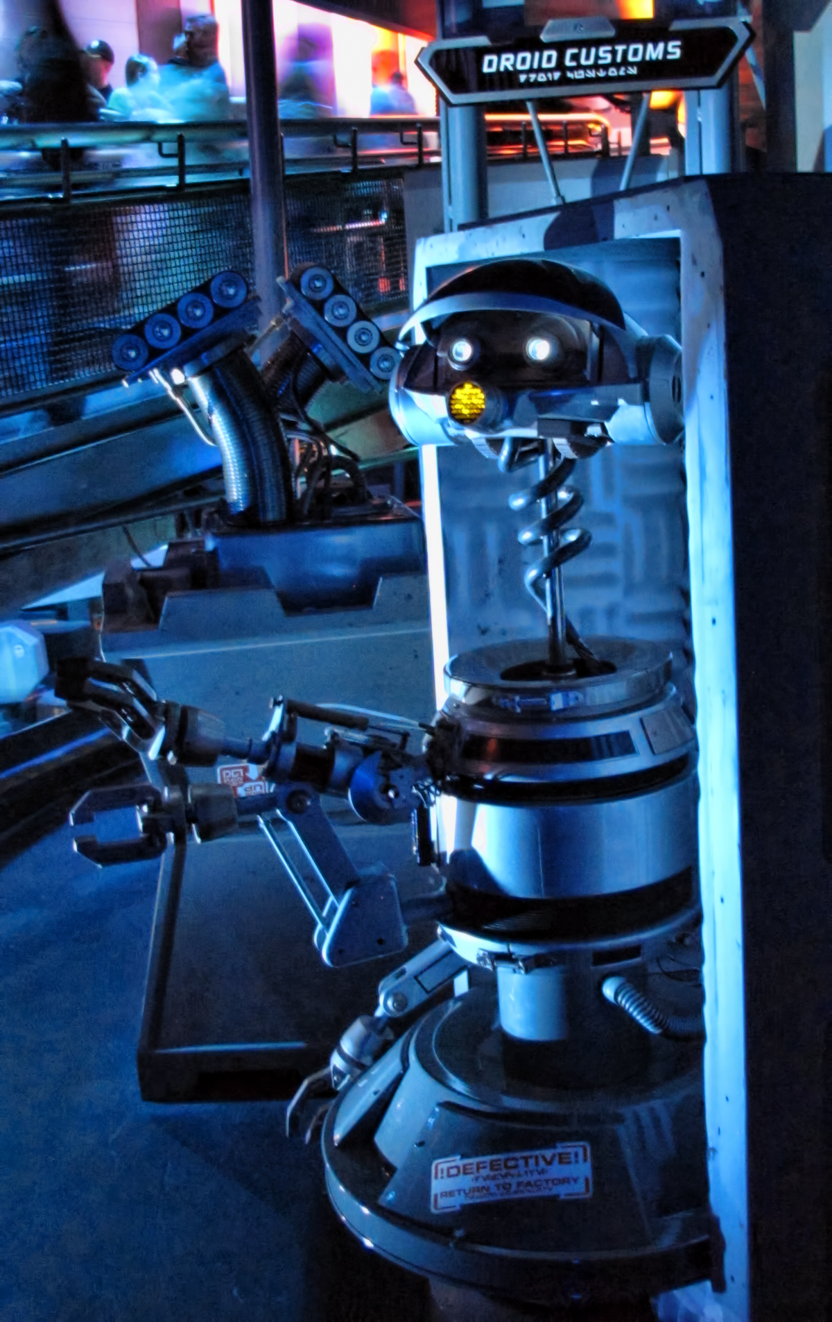

Good Reference:
http://farm7.staticflickr.com/6127/6017034510_92498c9698_o.jpg
DisneyWorld version (different mouth etc):http://farm7.staticflickr.com/6073/6047809192_d2994534d0_o.jpg
http://farm3.staticflickr.com/2631/4139196417_222d87b730_b.jpg

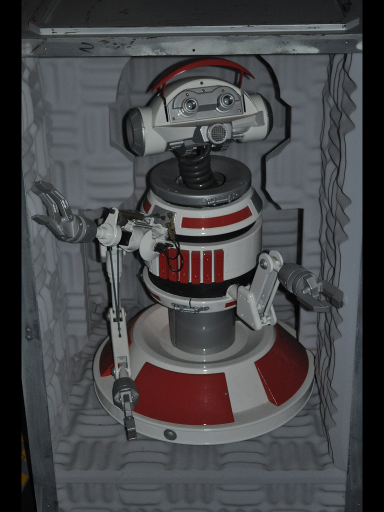

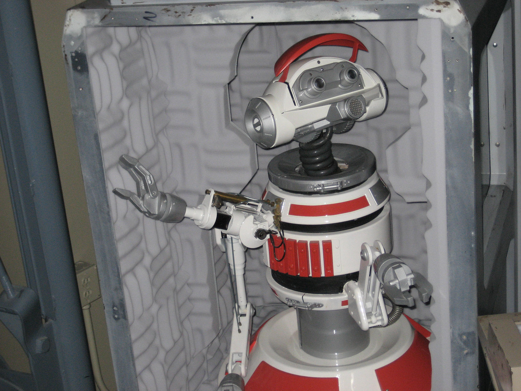

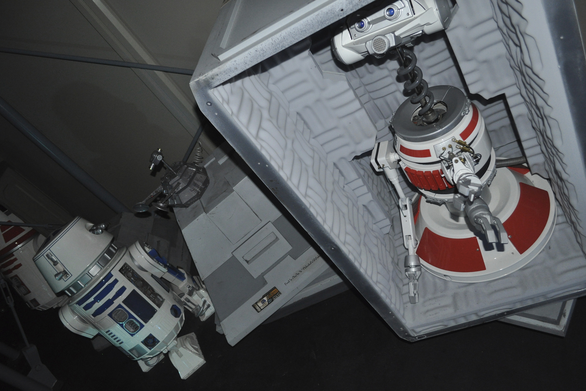

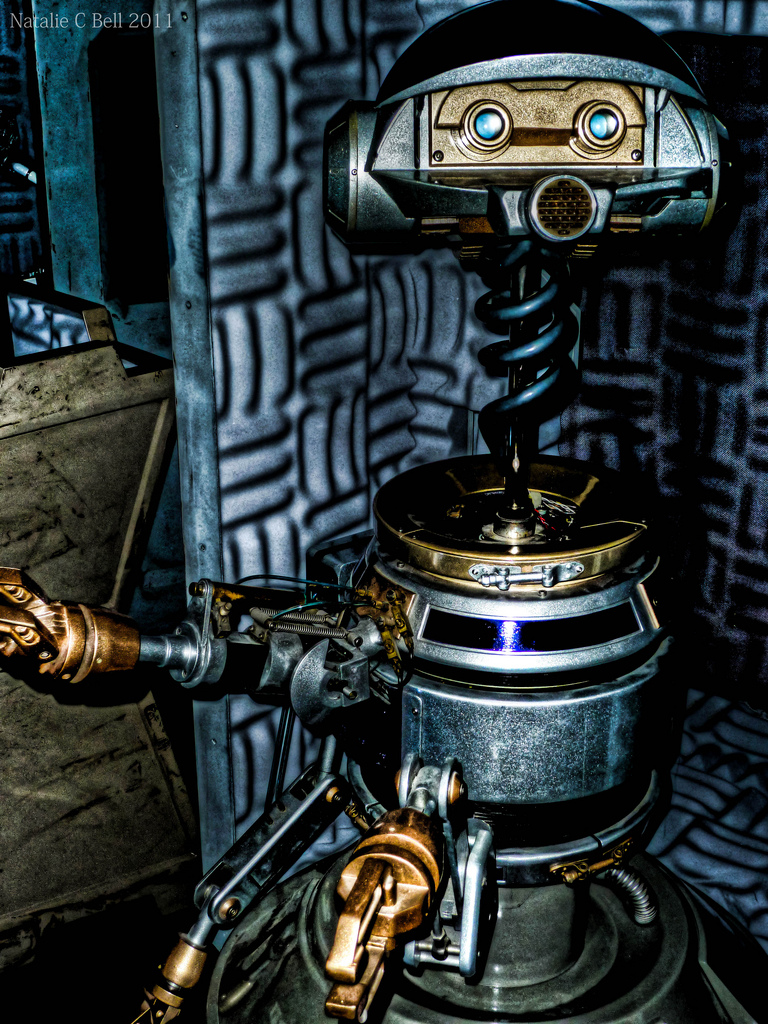

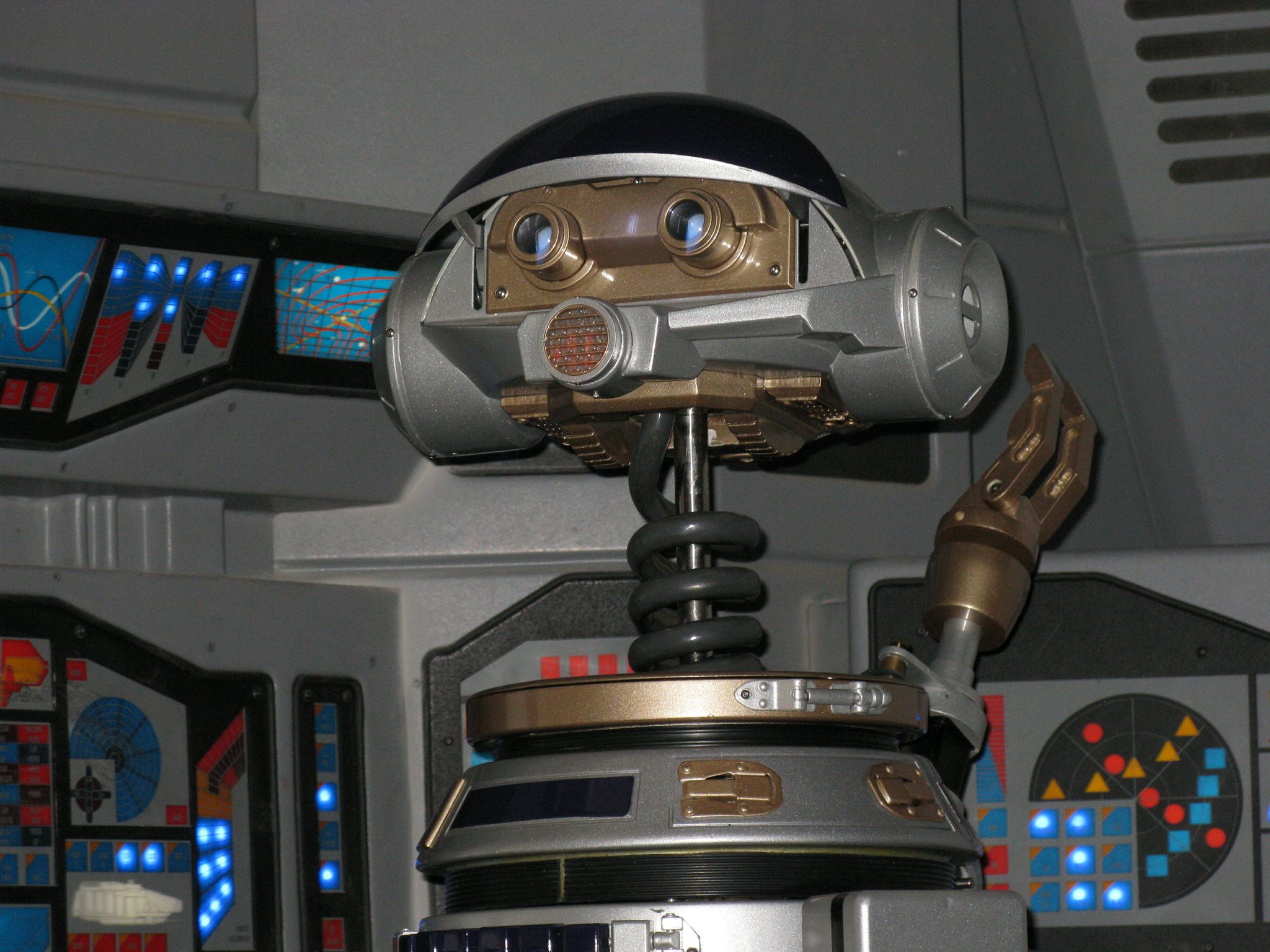

I figured it out here are some pictures I took.
Re: Star Tours: RX-24 Captain "Rex" build
Wow these are great! The straight on view is particularly helpful. Love the view of under the head too. That's the clearest I've seen it. I have a feeling here's going to be a trip to dland soon where the only thingy I do is ride star tours all day.
Keep them coming if you've got more, side of the head is still needed (if I get a good side profile, I can pull dimensions much more accurately).
