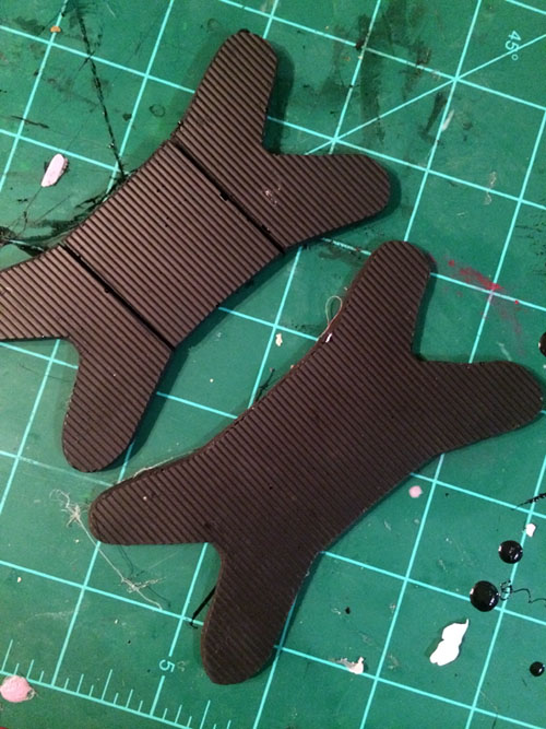

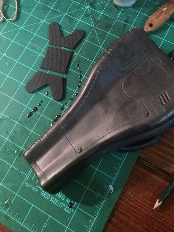

The map projectors ship as three parts. The body piece and two optional replacement faces. One projector face breaks into three pieces and the middle can be omitted for a projection port. The other can be cut to the desired layout. Otherwise, you can just cut the existing face, which contains a hole for the pour sprue, to your desired shape. You can of course use your own material for the face if you have something else in mind.

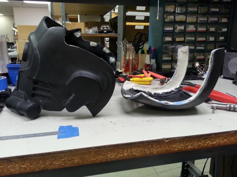

Well ****, I guess I must have an abnormally large head, I trimmed down the helmet I got and cleaning it up alittle and its at east an inch to small to fit my 'huge' head
Re: Star Lord Helmet and Map Projector **UPDATE 12-3 RUN #2 TAKING DEPOSITS**
You have to cut the back apart to be able to put it on. It's a lot of work, but totally worth it since that's the only way to scale this helmet so it doesn't make your head look enormous.

so, once cut how do you attach it so it doesn't fall off once youre wearing it?

Where did you make the cuts?

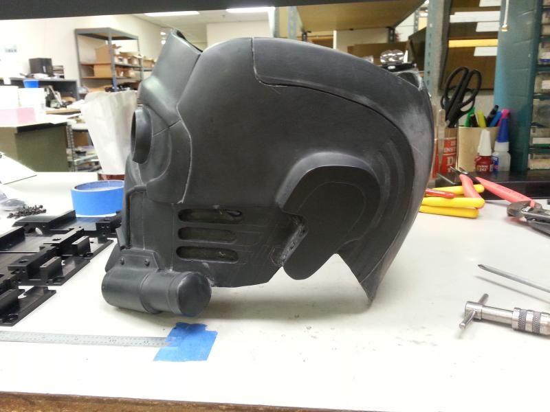

Same place as on the original, on the seamline that runs down behind the temples, then back over the ears and curves down behind them. When the recessed area curves back at the bottom, you just keep going down. Then slap a bunch of rare earth magnets in there and you've got yourself a helmet.

Hey MDuckett... Any chance you could please post just a close up of the side where the back part of the helmet attaches to the front half. It would be a big help just so I get mine axactly right. No rush though just if you had a spare minute sometime :D Thanks

I was about to ask the same thing, but look at the first post...you can see where it is cut.

yer i saw that but if its possible to get just another pic it would still help me out

Hopefully Matt won't mind me posting this. This is how I did mine, same as the screen used.

I assume the lighter stuff on the inside edge is how you've attached magnets - what did you use for it? I just got my helmet a couple of days ago, and definitely want a magnetic closure.
It's a slow cure epoxy. It's reinforcing all of the magnets that are individually glued on with 5 minute epoxy. I've since added it to the front as well. This way if one magnet wants to pop off, they all have to.
