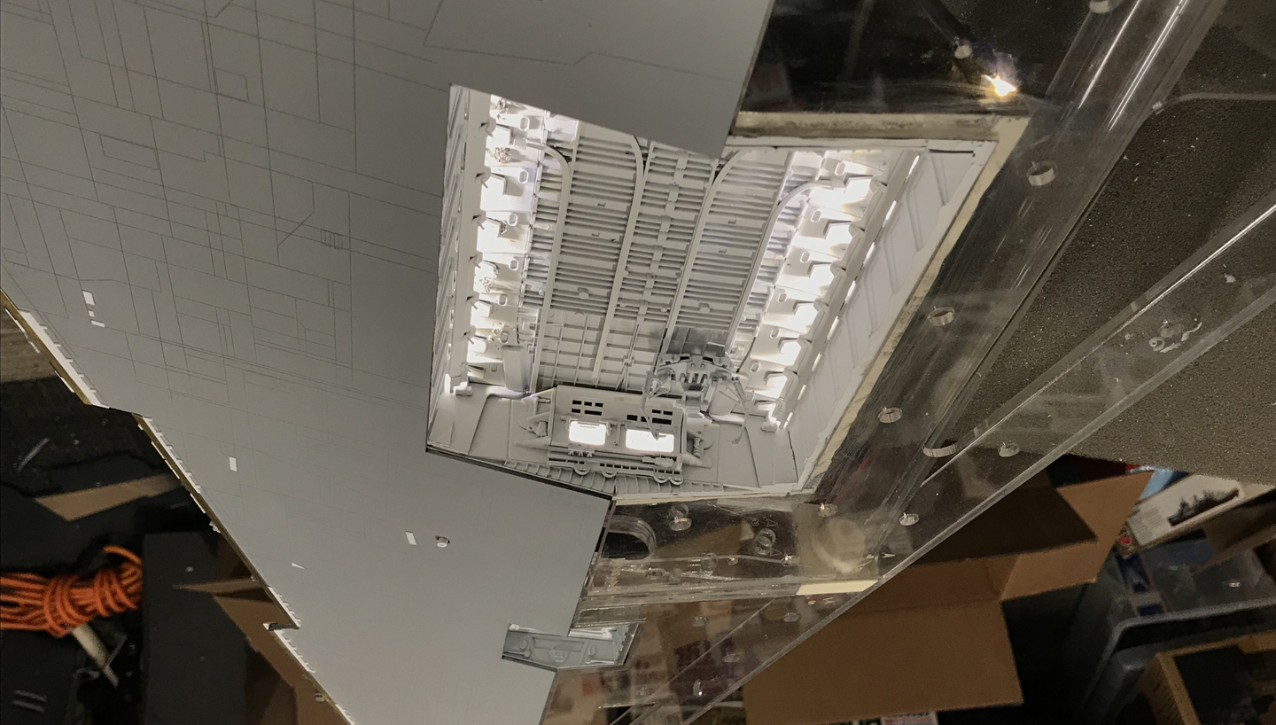

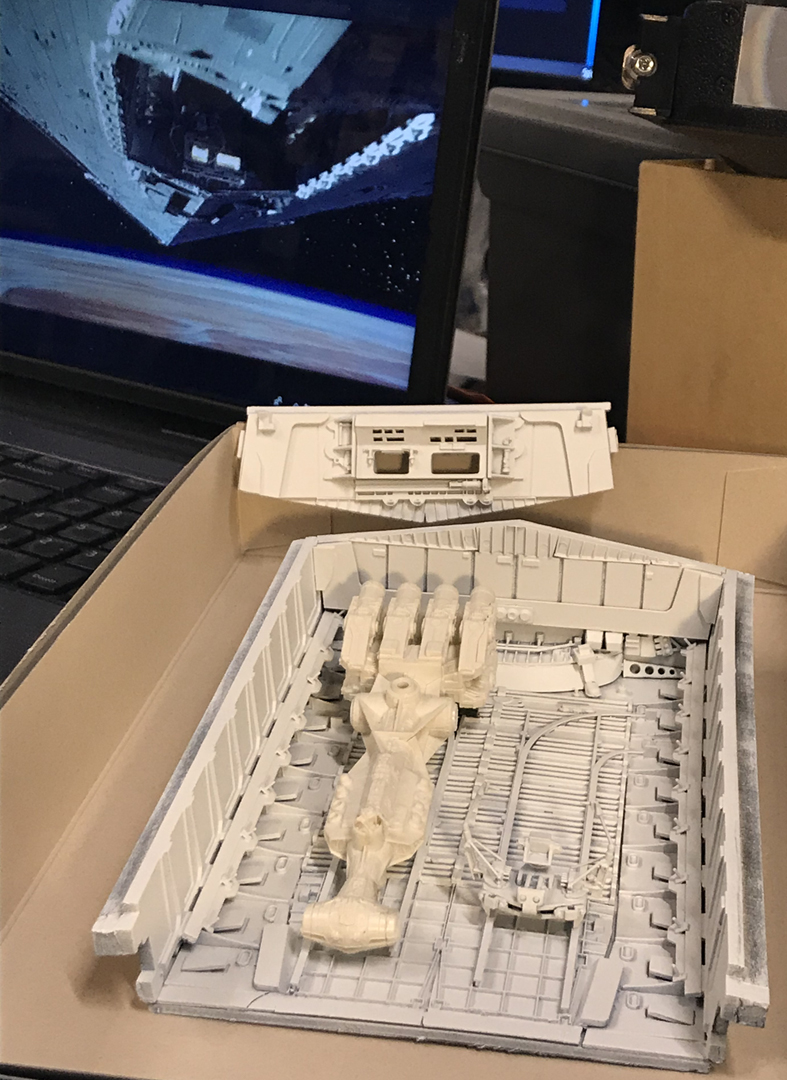

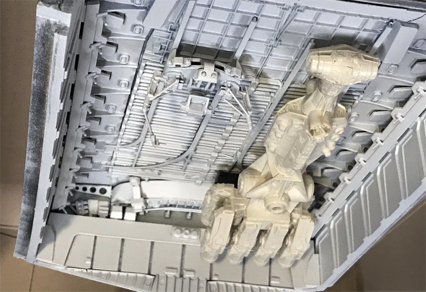

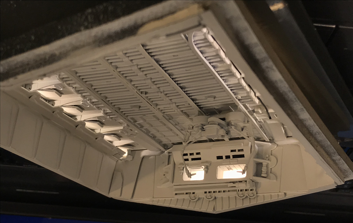

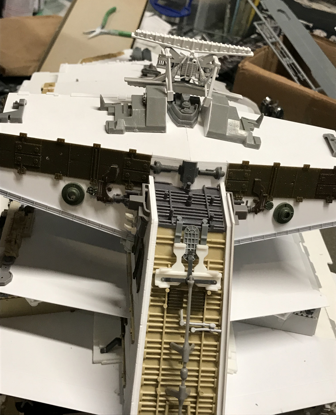

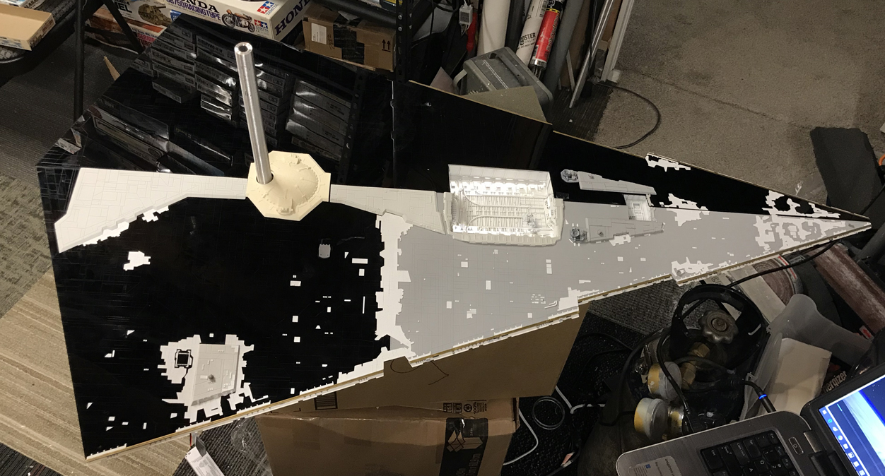

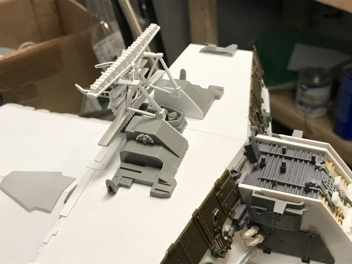

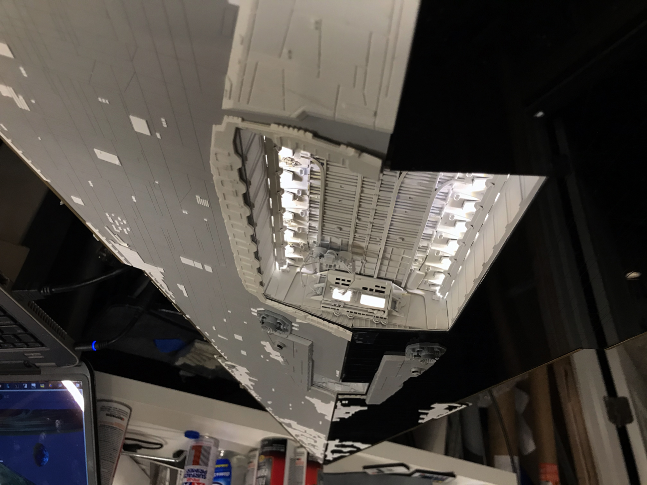

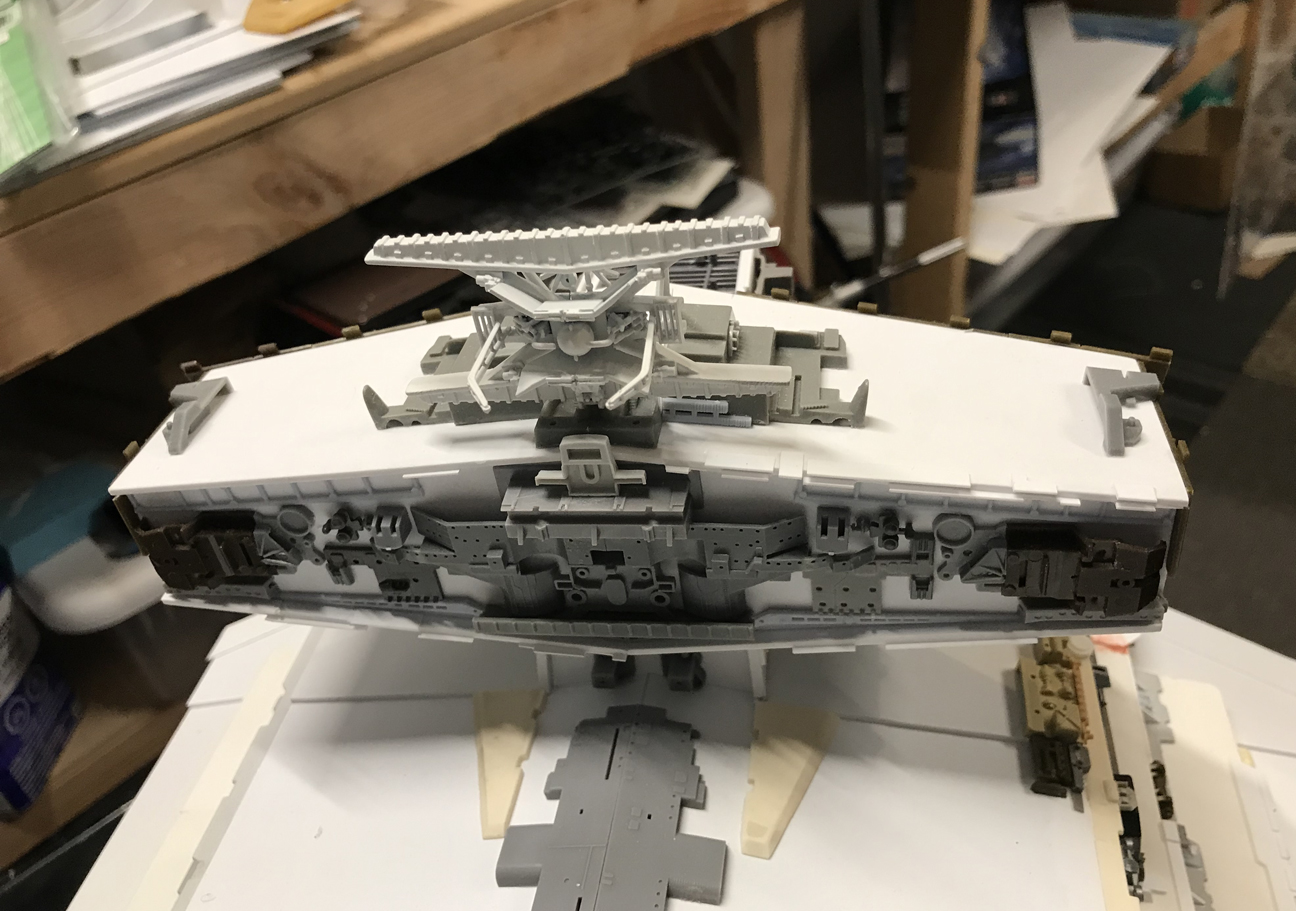

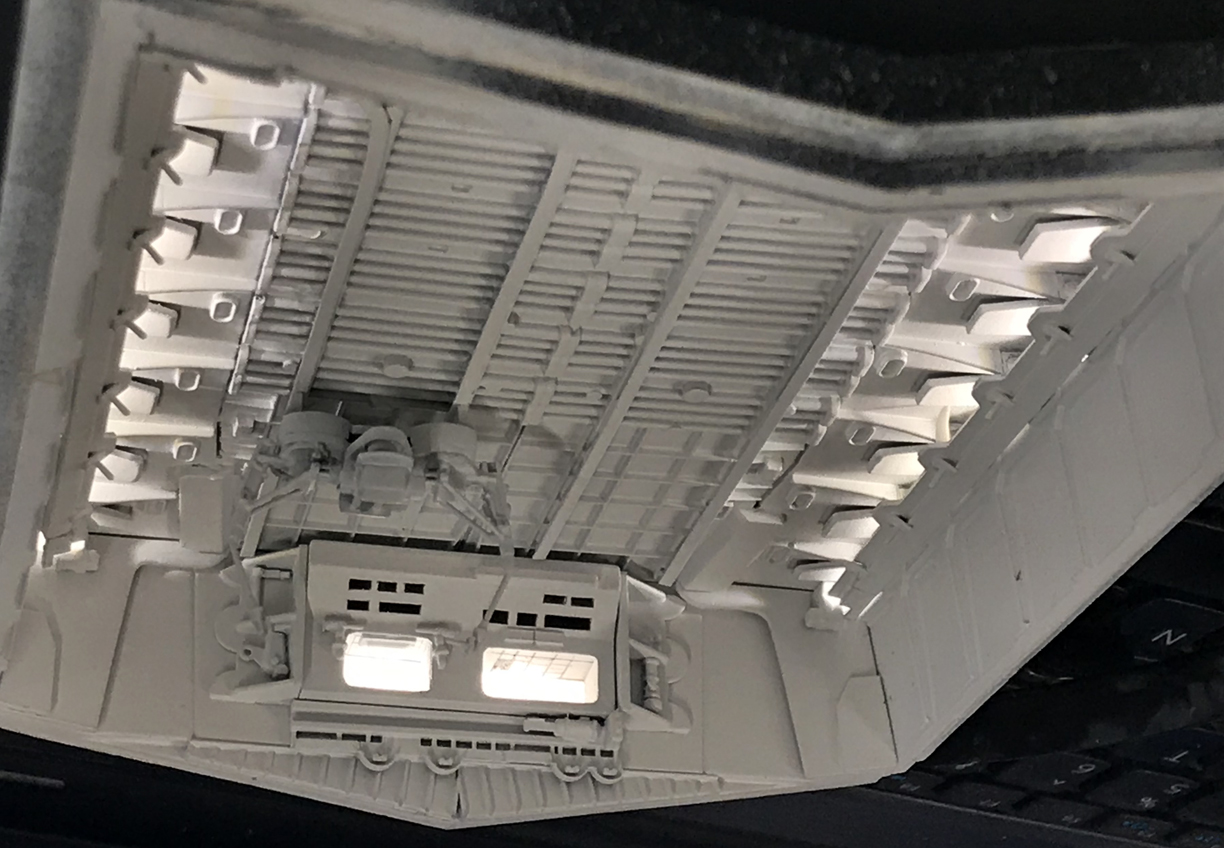

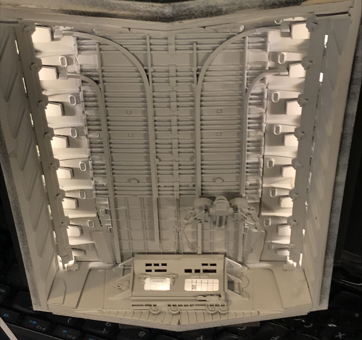

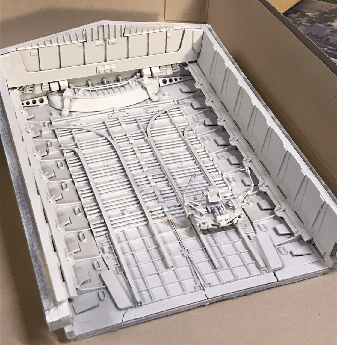

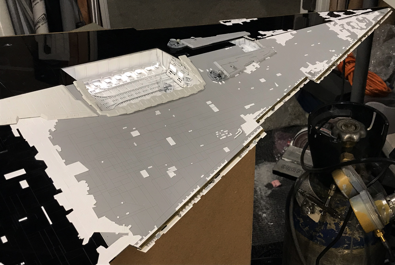

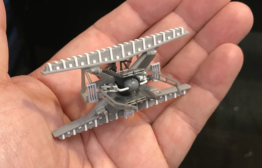

Here's a quick update on a couple areas. I scratch built the 'X Antenna' again, there were a few minor details like the ribs were too thick (.020 as opposed to .015 now), and I realized there are no ribs on the 'bottom/rear' of the antenna on the original, and I corrected a few more parts. So this should now pretty accurately reflect the original Antenna array. Also, I pretty much completed the hangar bay with lighting. It is set to a remote dimmer, so I can change the brightness quite a bit to adjust to room lighting. Funny thing, the Bandai Blockade Runner kit fits almost perfectly in the bay - so I'll be making some way to add/remove it in there.
Most of the hangar is cast resin (from parts I designed in 3D that were based on an initial pattern put together by John Currila and revised by me). Sean did an excellent job of building things like the crane which is one part I did not include when I made the final patterns for this subject.

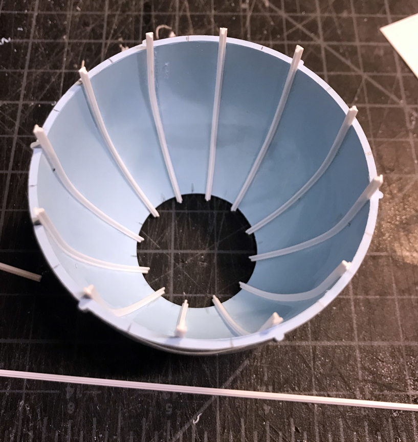

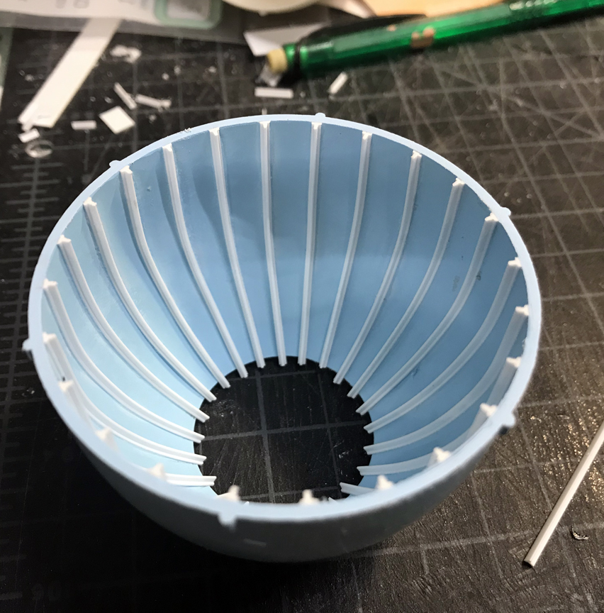

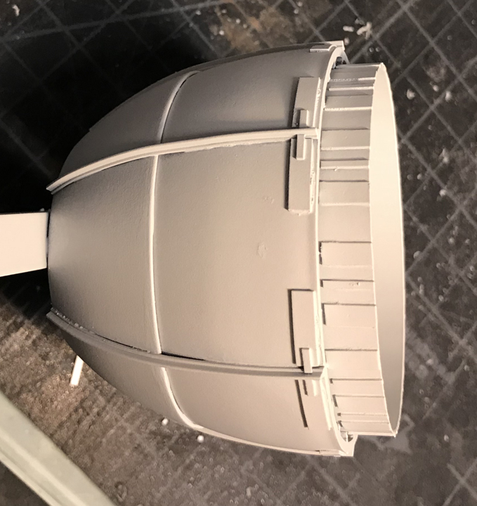

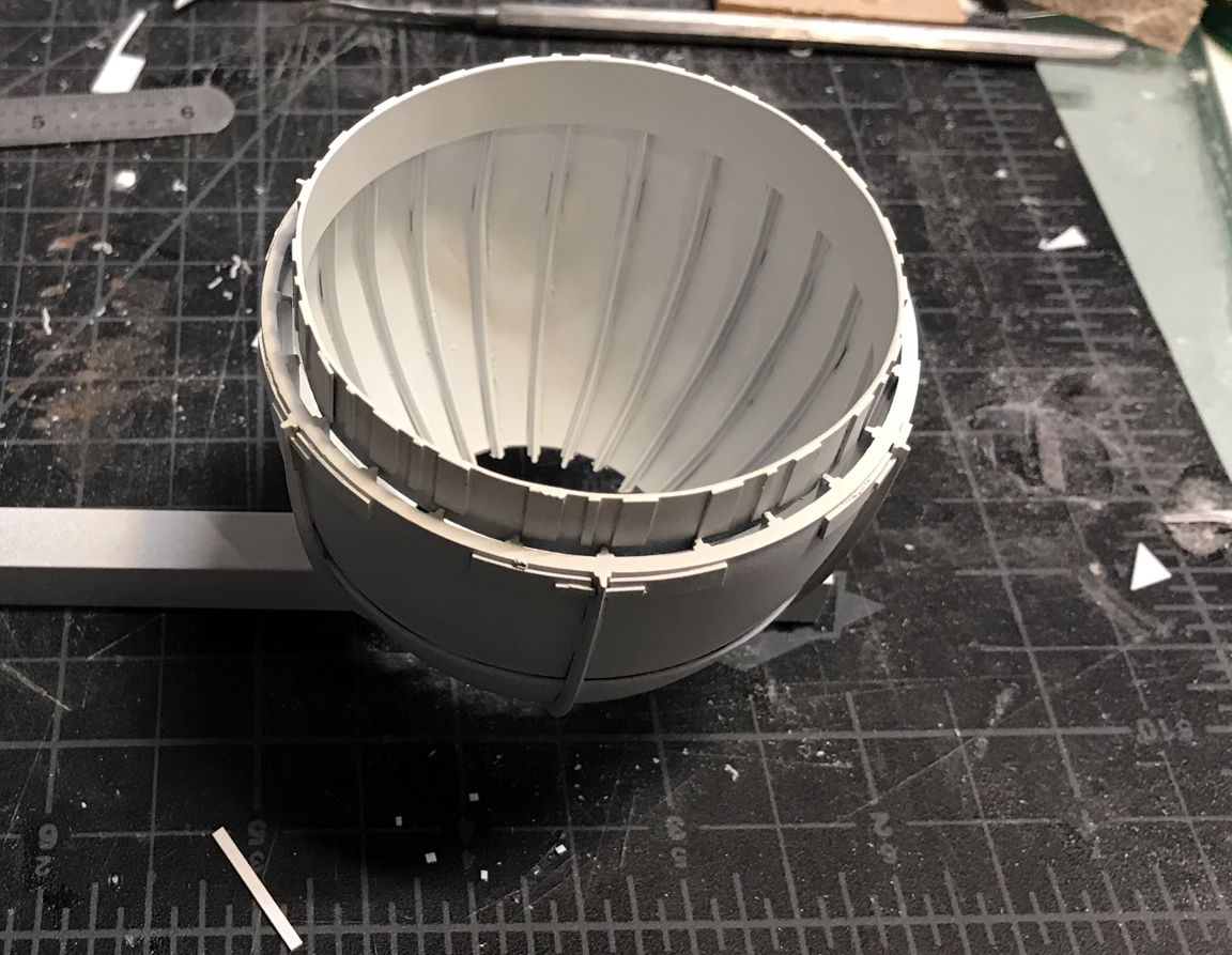

Been a little slow going, but progress continues. Scratch built up the engine bells with the L'Eggs Eggs and T channel - that was actually a lot of fun. Especially making the really thin outer 'ring'. Pretty ingenious the way the original model builders made this super thin styrene strip with little styrene rectangles, then glued it in just the right diameter to the T channels, leaving that really iconic gap between the egss and the ring.

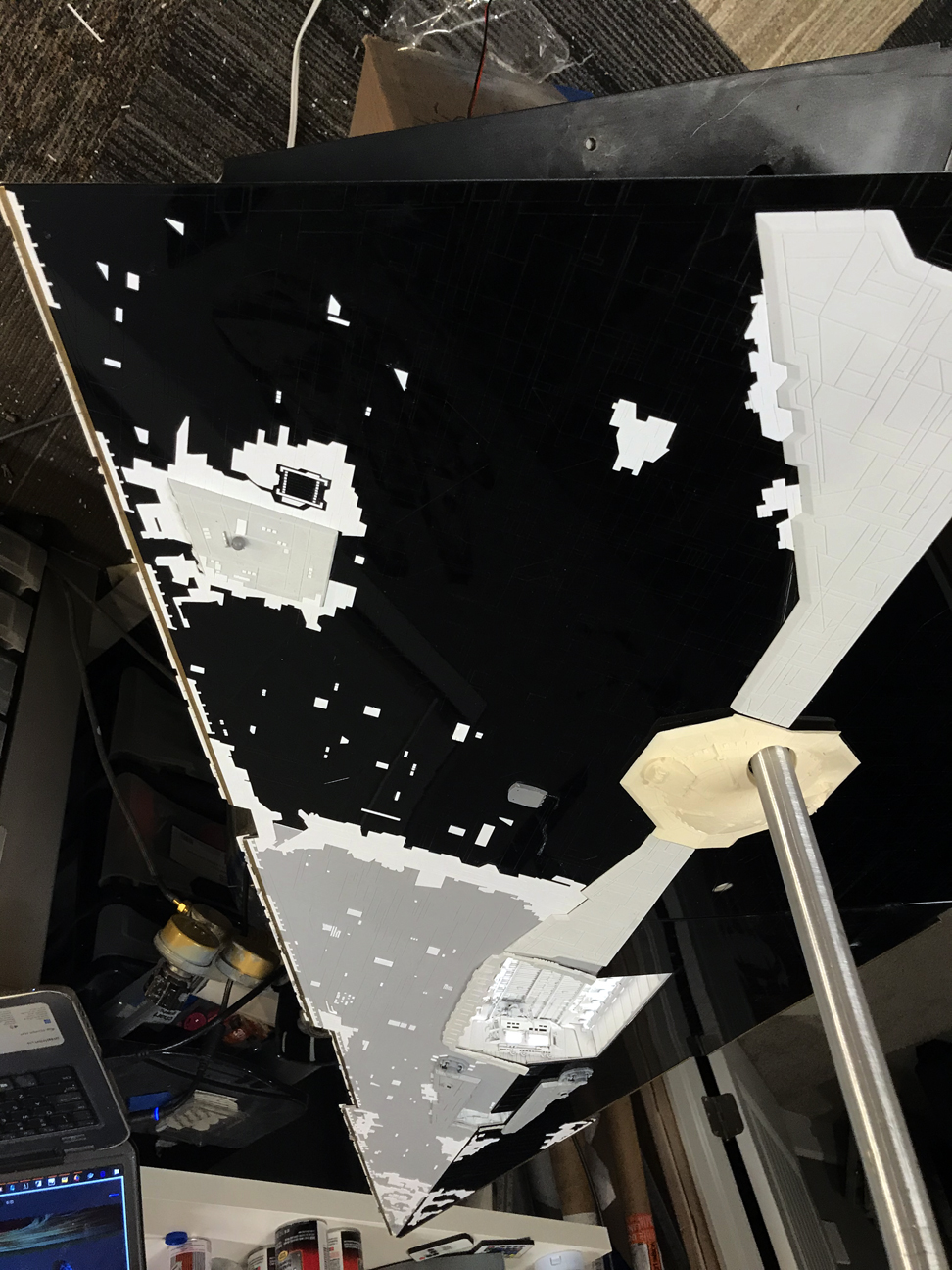

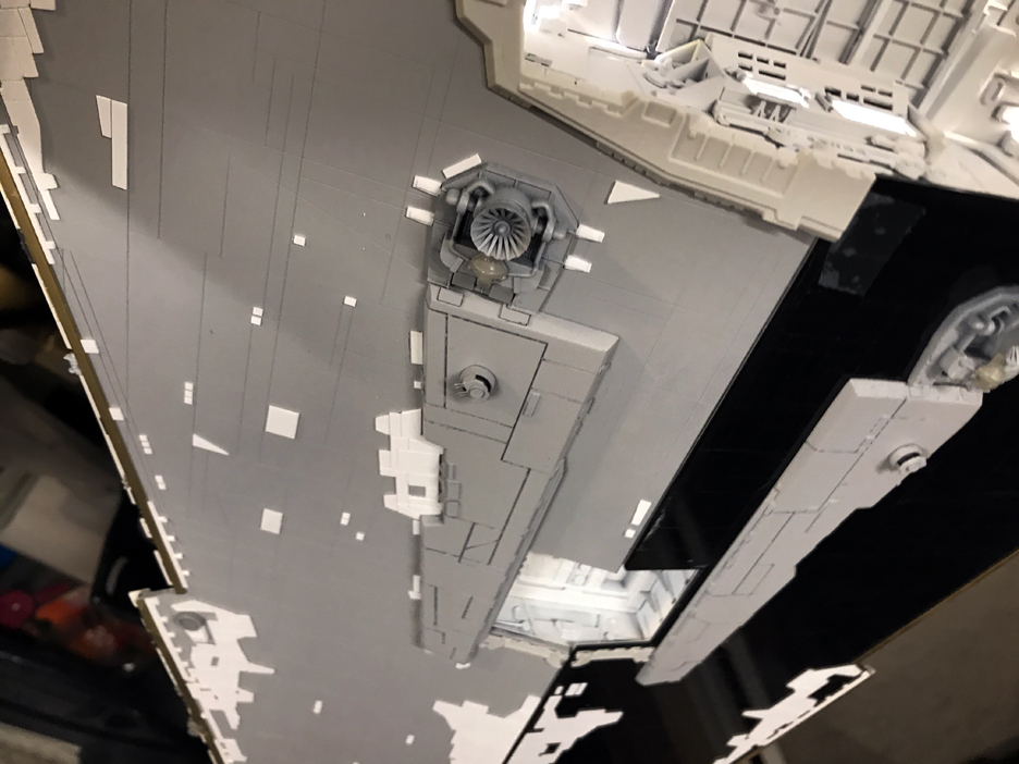

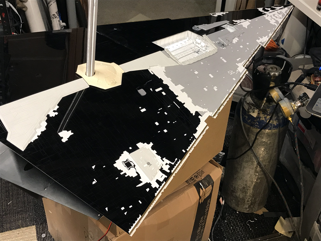

With those now done, moved back to the port body underside adding all the little chips, panels and such. A few parts are just placed on in these pics for size checking. It's really a Zen like effort hand cutting all those little chips. Should be moving onto the starboard side soon, then things will finish up pretty quick under here.
Engine Bells:
First set of 'T-Channel'

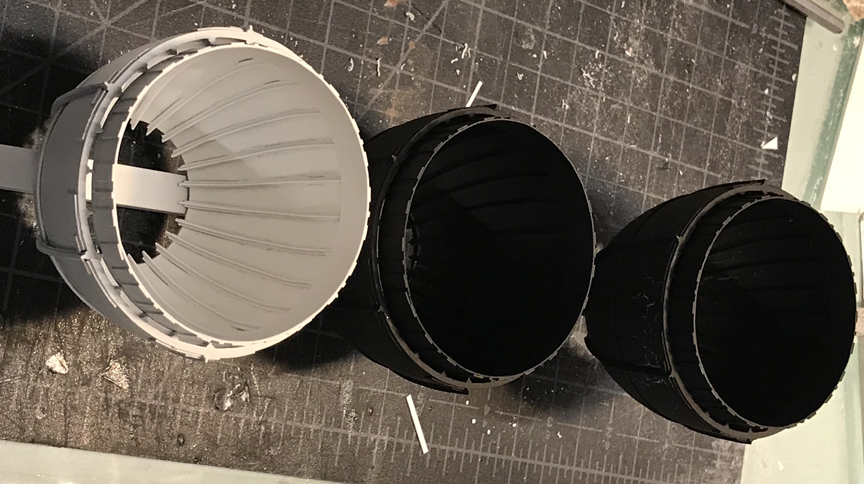

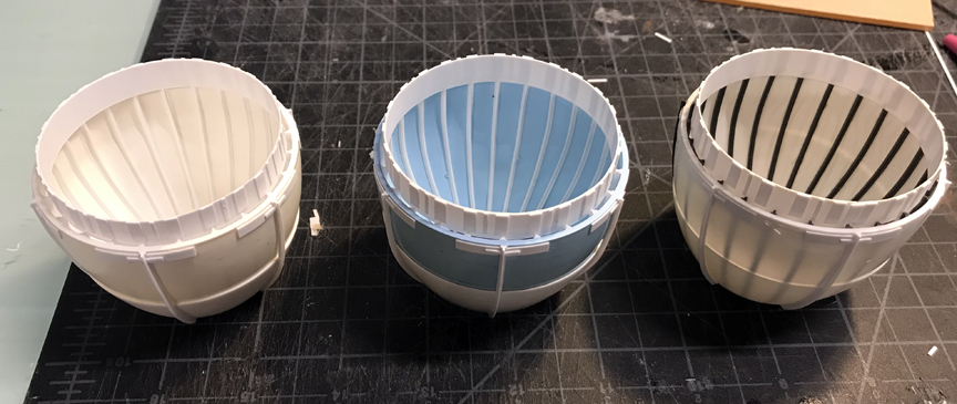

Second rows of T-Channels
All 3 'bells' with the thin styrene ring
Two primered in black, and one painted in final white.
Painted Bell
Jeepers Sean. I’m surprised ILM haven’t offered you a job yet. You do the work of six people...
Probably because ILM barely make any model at all nowadays (and the few they make are mostly 3d prints)
But indeed, that's very impressive work, making those three bells with all the t-track evenly spaced must have taken forever
