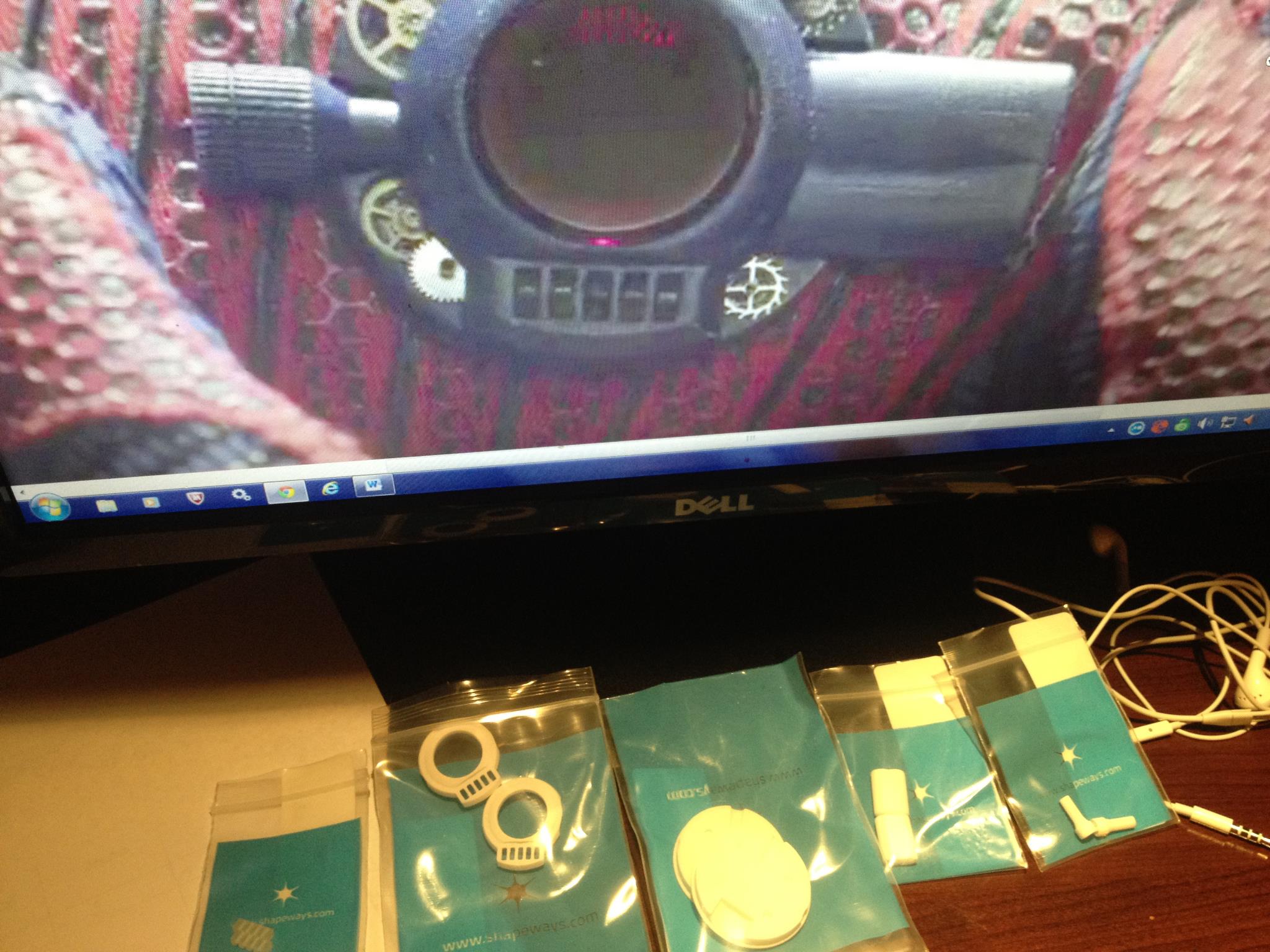

Hey Epilepticsquirl, just got the shapeways parts in the mail and i just have to say i love them! the size is great, the pieces are spot on, and the material is so smooth and strong. I will paint and detail them in the coming weeks. 919919_540647392641274_1698965533_o.jpg
