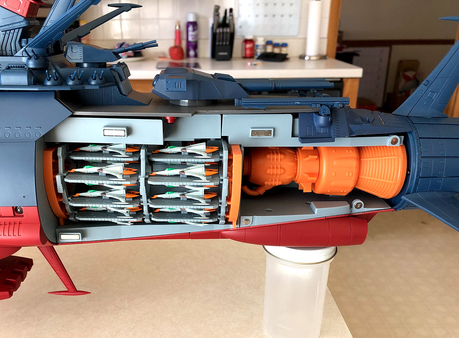

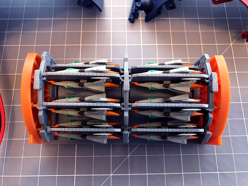

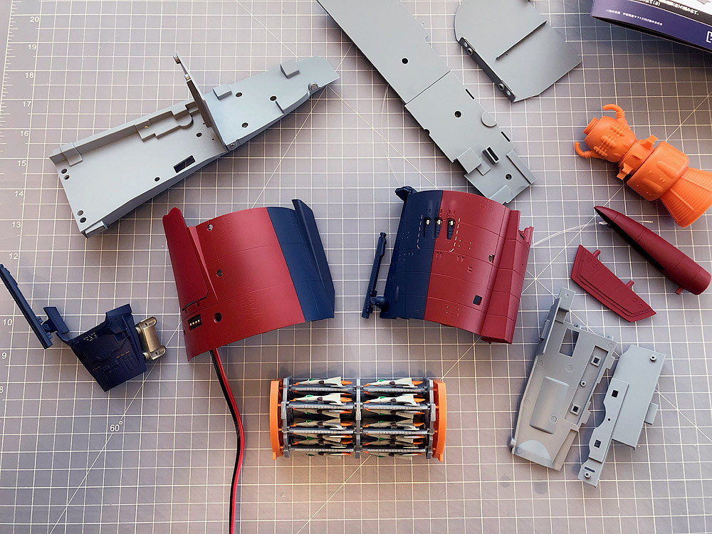

Lots of interior parts for the cut-away section, the racks for the fighters are finished but it’s a bit of a cheat, only half a rack, where the back half would have been is motors and wiring. Looks like the base will not plug in but the Yamato will rest on the base on spring-loaded contacts.
Some more of the hull built and that leaves just 8 more issues to go with a lot of parts to go, still wondering if they will really wrap up on issue 110.

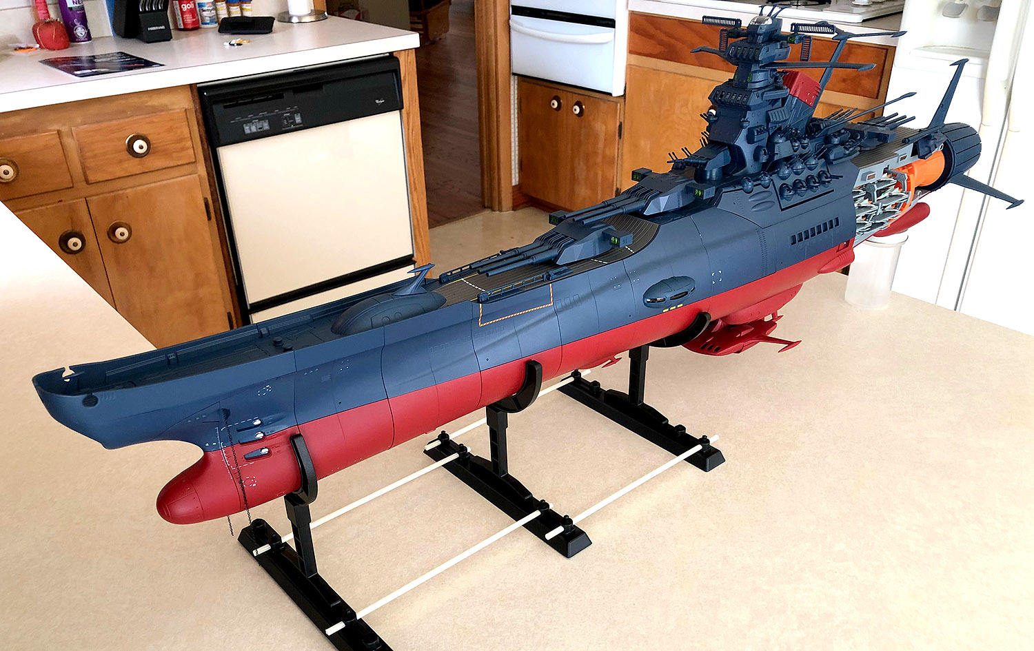

A two-issue update with big results, issues 103 and 104 complete, which pulled all the stray parts together. Issue 103 felt like five issues thrown into one box so the push is on to wrap this up at issue 110, which looks like it could happen if they keep the parts coming like these issues. Total length tip to tail, 37 inches.

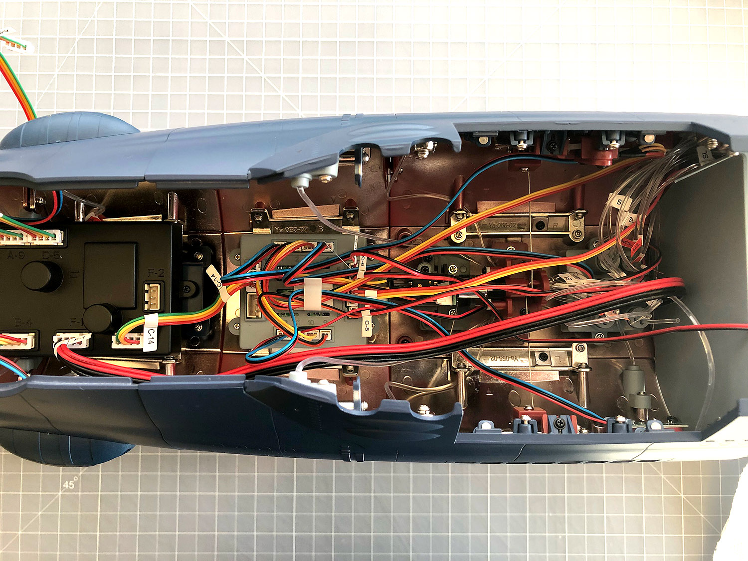

At this point all the electronic features have been tested and work, there still seems to be a board missing that ties everything together and likely talks to the remote. I already know that issue 105 is the entire removable panel for the cutaway feature so 106 through 110 should be the stand, controller and any stray electronic components to finish this up.

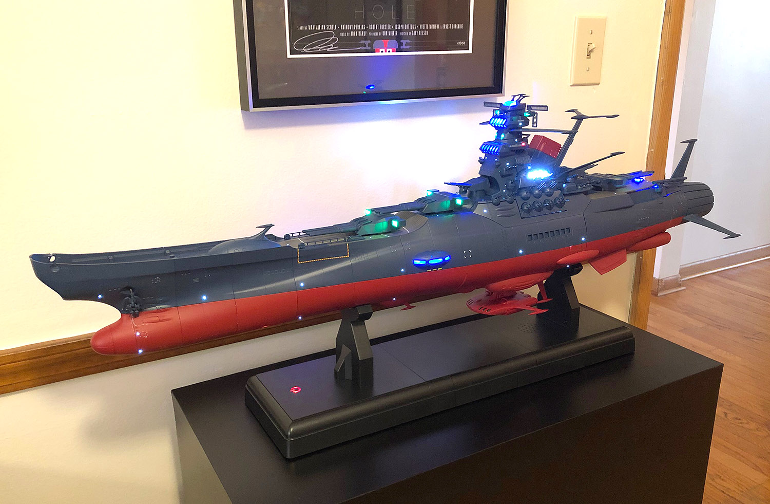

It really is coming together fast now. The engine lights flicker and there is a slow start up to full glow, I'm sure once the sound board is installed the sound will match up with what the lights are doing.

All good things come to an end, the final 6 issues, 105 thru 110. Every thing is wired, connected, master control board installed, the display base with the main power switch, speaker and sound board assembled.
The control panel is finished and after a deep breath, Yamato powered up, controller switched on and everything works! There is a volume knob and it can be turned up pretty loud. The controller has great range; I can run the Yamato from two rooms away.
