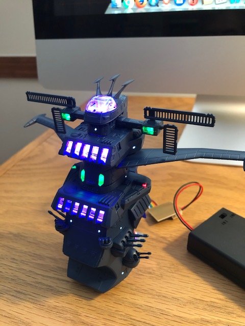

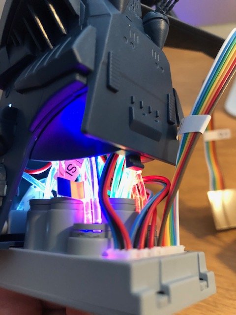

Just a small update to the build, I'll post more this weekend but I'm past the half way mark at issue 52. This is just a test of the bridge tower lighting, both the blue and red lights in the bridge windows and captains cabin are on at the same time.

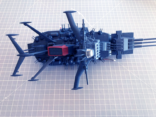

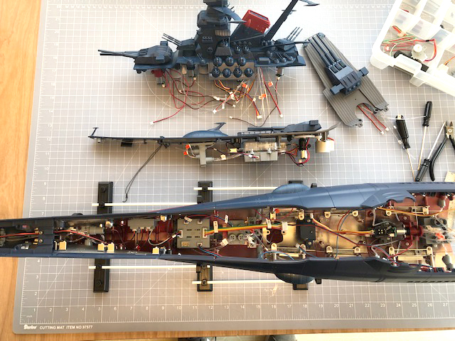

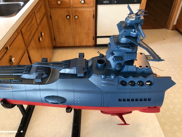

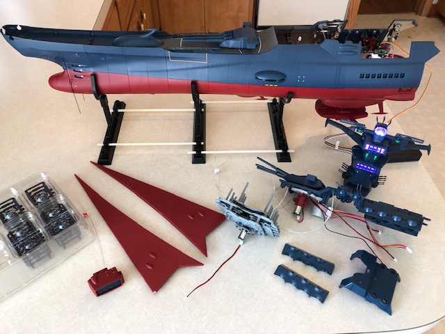

It’s been a while since I posted an update so I figured I figured I better get on it. I’m up to issue 83 of 110 issues, originally it was supposed to be 100 issues. I’ve started to build the AA guns, stack and mounts for the bridge tower, I’ve tested fitted some of these parts in the photos. The wings are done and attach magnetically.

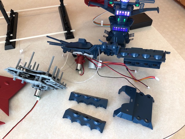

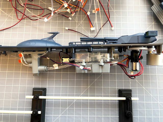

At this point there are a lot of motor connections with nowhere to plug into so there will be another board for all those connections. There are two motors per turret, a motor for the side missile doors which are controlled on a steel cable, a motor for the lower gangway and a motor for the AA gun turrets.
There should only be four more motors left to install in this build for the two rear turrets. It’s worth noting that there is no place for batteries, a speaker or speakers, no main control board and no clue where they will go. Since the rest of the ship is a cut-a-way I’m starting to suspect that all those things will be housed in the permanent display base, which has yet to be seen.
Total build length at this point is 26 inches with about another 14 inches to go.

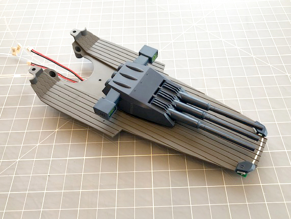

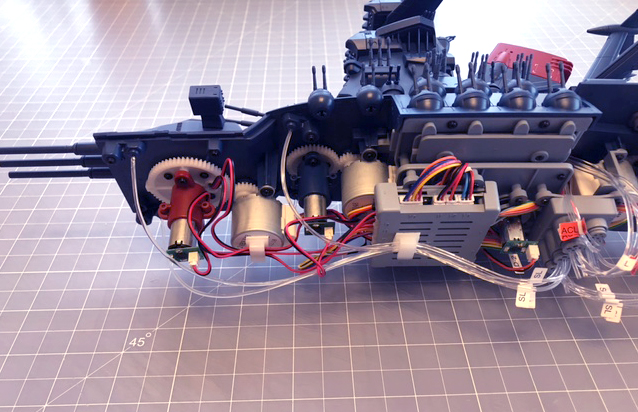

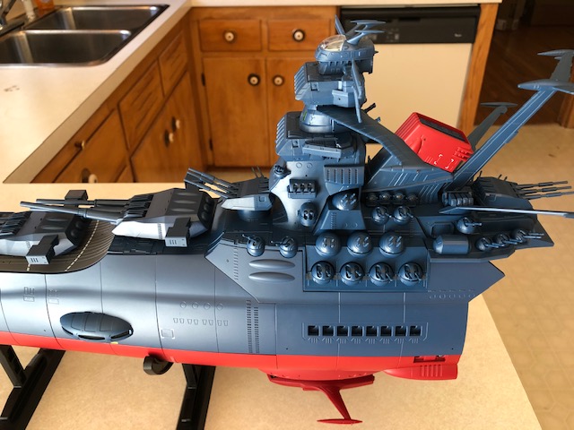

This will my last update for a bit until I receive some more parts. This takes me up to issue 86 and tied up a lot of loose ends. As you move into issue 84 you’ll find that you had a good amount of parts on your tray with no homes, motors, gears, turrets, gears for the AA guns and a few other bits and pieces.
When you finish issue 86 all those parts will be used. These three issues have taken the longest to date, just a little over 4 hours of building to complete, just four more motors and the rest of the build is lighting.
Lots of optics and wires with nothing to plug into, should be interesting. Total build length is now 28 inches.

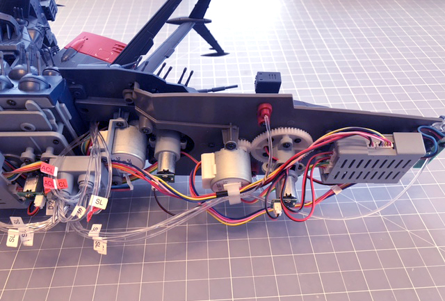

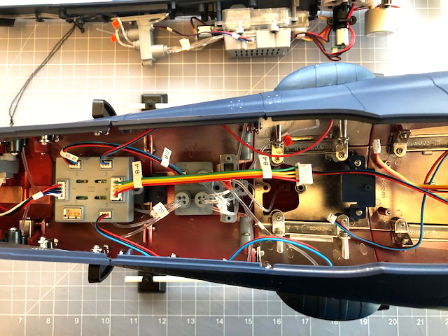

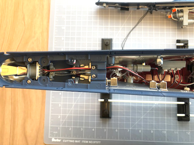

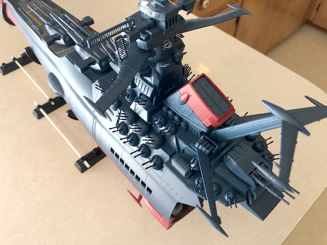

Small update, issues 87 through 91 complete, which amounted to a couple of motors, a main turret and the last section of upper deck. That leaves 19 issues to go and I have to say I’m very skeptical to this build wrapping up at 110 issues which the website states.
There are a number of boards still missing including the main controller board along with the rest of the hull, which is a cut-a-way and brings up questions like where is the power supply? The build shown on the site obviously does not have working rear turrets, as there is nowhere to hide the motors so it will be interesting to see how they work that out. I’m starting to suspect that the power supply (batteries?) will be in the base.
I thought I would take a few shots of the ship to show what’s stuffed inside of the hull so far, it is getting crowded.

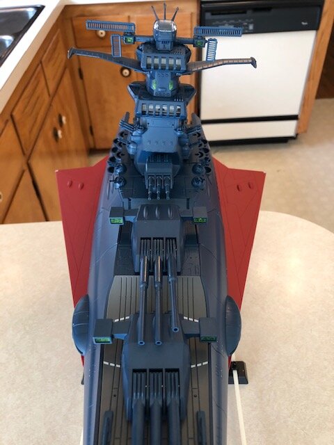

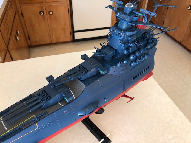

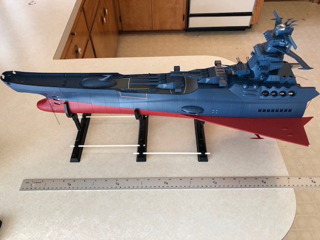

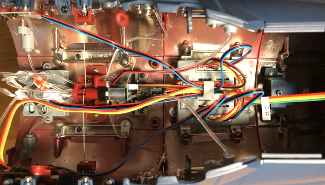

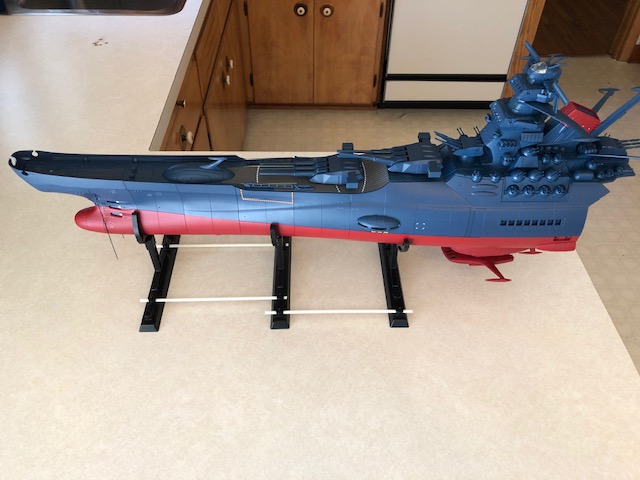

While it doesn’t look like much has happened, a lot has. I’m finished through to issue 97 now, the wiring and light fibers are all cleaned up and connected, everything has been tested and everything worked perfectly, all major wiring and motor work is done. These past issues have contained the controller boards and answered more than a few questions as to how everything will work in the end.

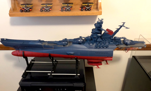

Looking ahead to issues that are yet to come you can see that the power will be supplied from the base, still no idea where the speaker will be. I have issues 98 through 102 shipping this week, which will get back to building the rest of the ship. It’s worth noting that these upcoming issues are loaded with parts so it’s the race to issue 110, which is still listed as the final issue.
Hachette has also announced the next build which is the Andromeda in the same 1/350 scale, not sure if I’ll take the plunge on that one or not, still not sure where I’m putting this 40” long Yamato when it done.
