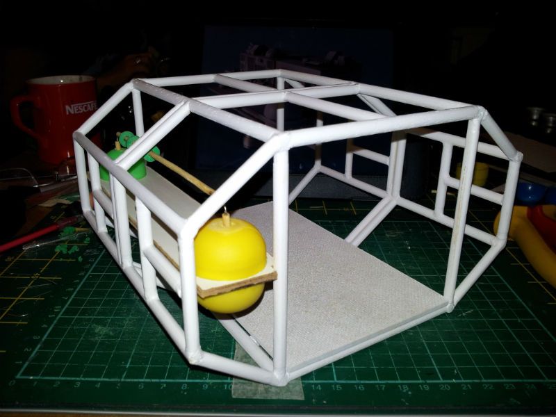

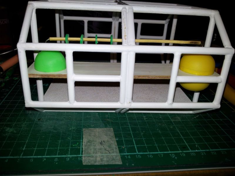

I have finally sourced the material with which I will be constructing the fore and aft walkways. It is a 3mm (1/8 inch) thick fibreboard that is used on the back of flat packed wardrobes and for the bottoms of drawers in kitchens etc...when it is cut into small squares/rectangles for a project like this, it becomes immensely strong. I shall be gluing each walkway floor and wall panel to each other AND to the cage itself, which will probably make the cages strong enough to take my weight. The advantage is that they will still be incredibly light.
So, firstly, I had to sand/prepare the cage for spraying and then, I applied 5 solid coats, before again wet sanding to remove any dust or grit from the finish.
I will, of course, be adding more coats, but this was to ensure good coverage in areas that will be difficult to paint later after installation of the walkway walls and the cage shelves.
Talking of which, I started the first shelf today and have commenced the construction of the greeblies to fix to it. I cannot kit bash due to my budget and my chosen scale so, everything has to be made from other things. Long and painful process, this, as each separate part has to be completely built from scratch. Anyway, here are a few pictures of today's work; two without a flash and two with. I hope you like how it is shaping up:)

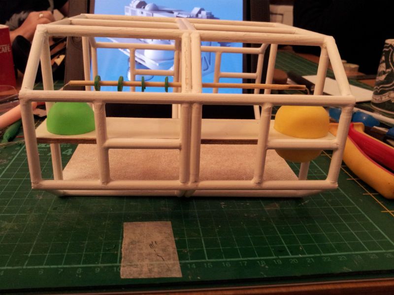

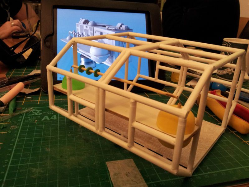

But my shelf greeblies will be as screen accurate as I can get them to Eagle 2. I have sourced some really good reference pics of the originals as you can see on the iPad behind the cage, so I am frantically searching for bits and bobs to chop up and glue together that will make a passable likeness.
Once the shelves are constructed, sprayed and test fitted, I can then add the the 'X' bars that are still missing from my cages. I left them out until the last minute to give me more access for positioning and gluing etc...

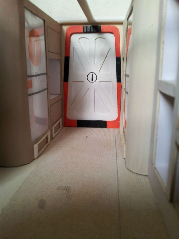

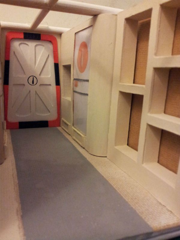

Well Here is today's update! :)

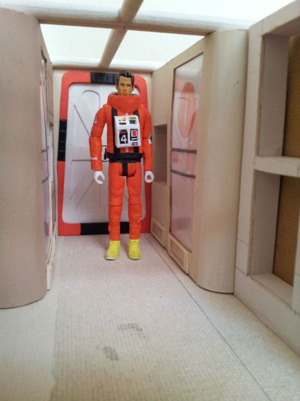

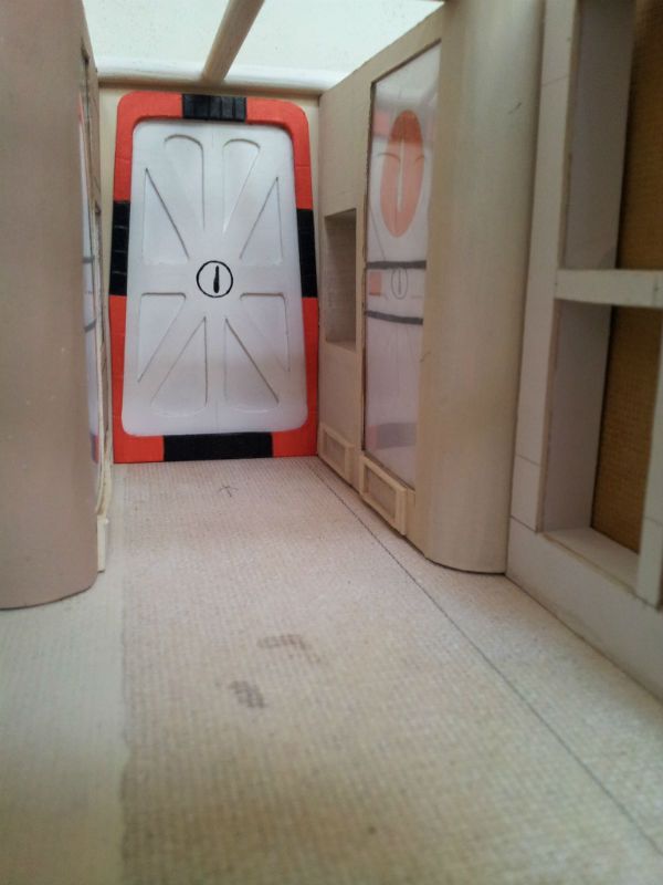

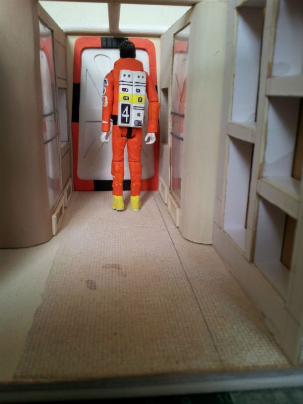

I have been concentrating on pushing the front walkway along towards completion and I have made some progress to that effect. I have cut and glued the walls in place and they are solid and strong.
I also made a start on the shelving units that take up the rest of the wall space in this compartment. As always, the T.V. Set is nowhere near as long as the the Eagle Dimensions, so I have had to stretch the shelves by about 10 mm to take up the gap. I will construct a mirror image of this unit tomorrow, for the other side.
At the moment, the internal units and shelves are just placed for test fitting.
I have also decided on the colour I shall be using to paint the interior. It's a sort of sand/beige colour which is way more accurate than the cocoa colour that you can see on the left hand unit. Suffice to say that I shall be repainting it to match the other.
I also marked out the floor markings and put a coat of paint down, as you can see.
What a difference a coat of paint makes! :) I am happy that it is at least recognisable as the compartment that it represents. I will endeavour to push this section on further tomorrow and hopefully, I can do a little more work on the cage shelves that sit just outside the walkway.
Thank you for looking in and I hope you enjoyed seeing the progress.
All comments/critiques are, as always, very welcome :)
Darren

I have found it hard going today, Bob. Bunged up full of a new cold, right on the back of the Flu! What has taken the time today has been the measuring and calculating, to ensure that the passenger pod will indeed sit snugly between the two cages, leaving no discernible gaps where the sliding airlock doors meet.
Because my two walkway doors that connect to either end of the pod have to sit beyond the edge of the cage, I have had to slide the front cage forward by 2.5 mm and the rear cage back by 2.5mm. That's quite a lot, even on a 50 inch model. I had to make enough room to allow for a door sandwiched by its walls, which is exactly 5mm.
These cages are a nightmare! :lol
