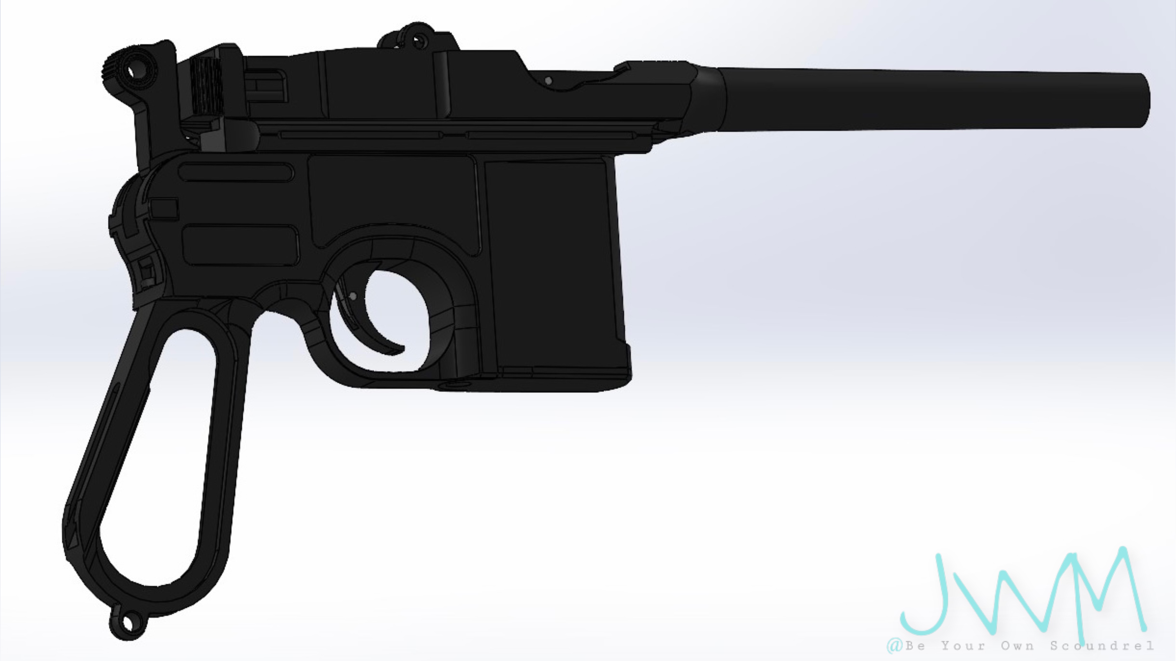

MGC replica progress..

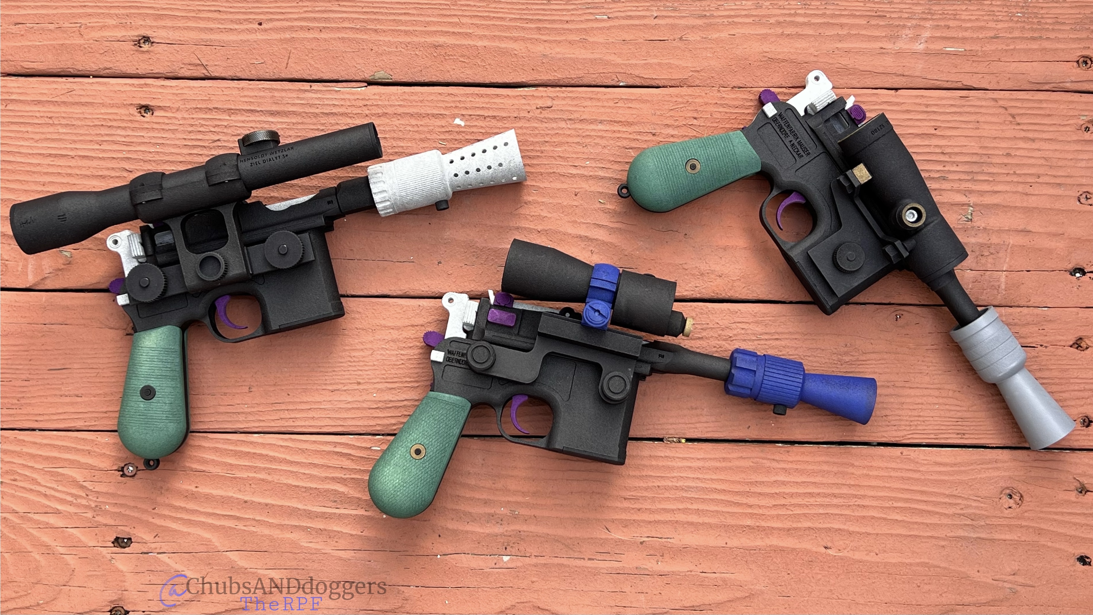

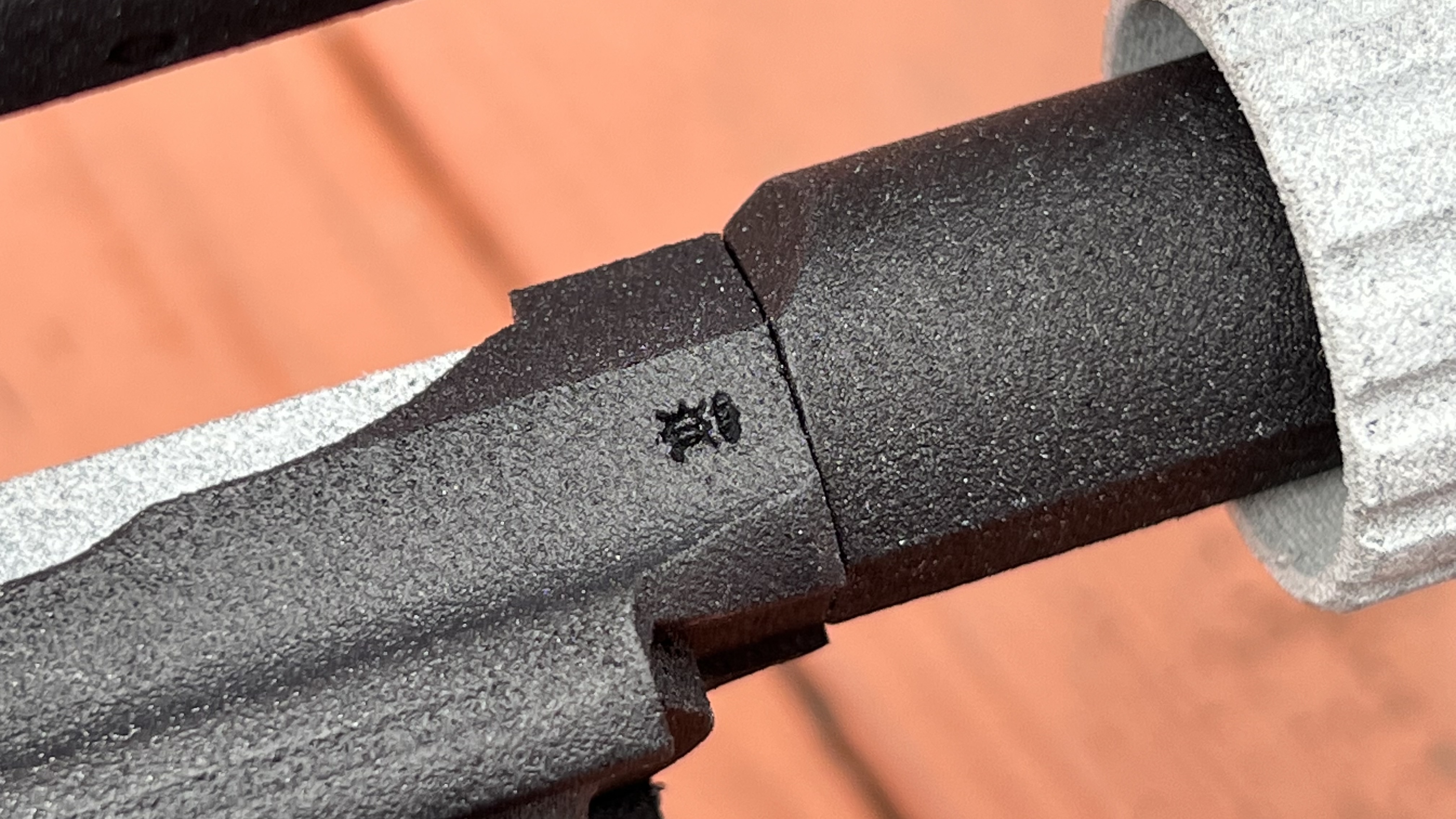

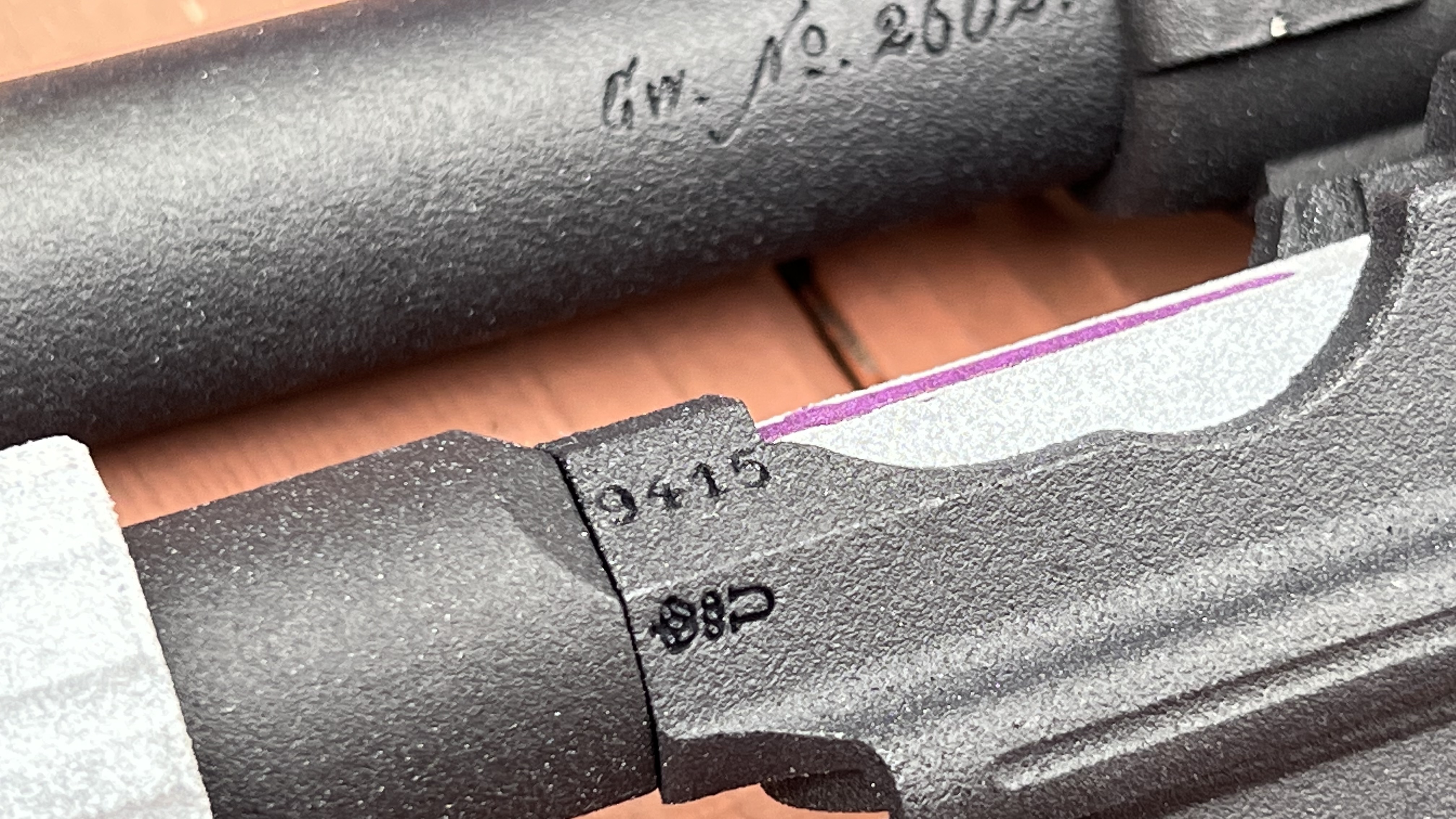

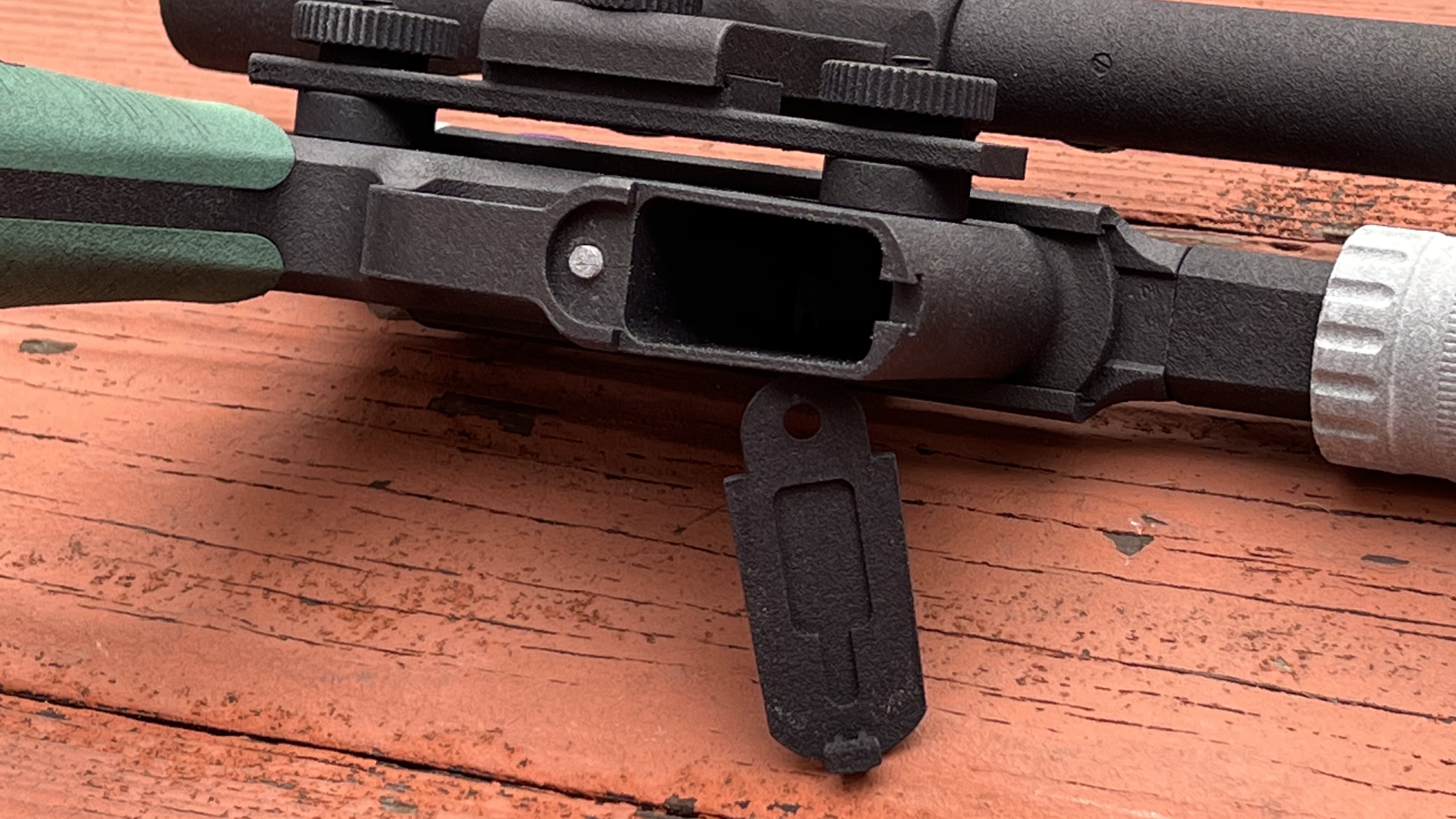

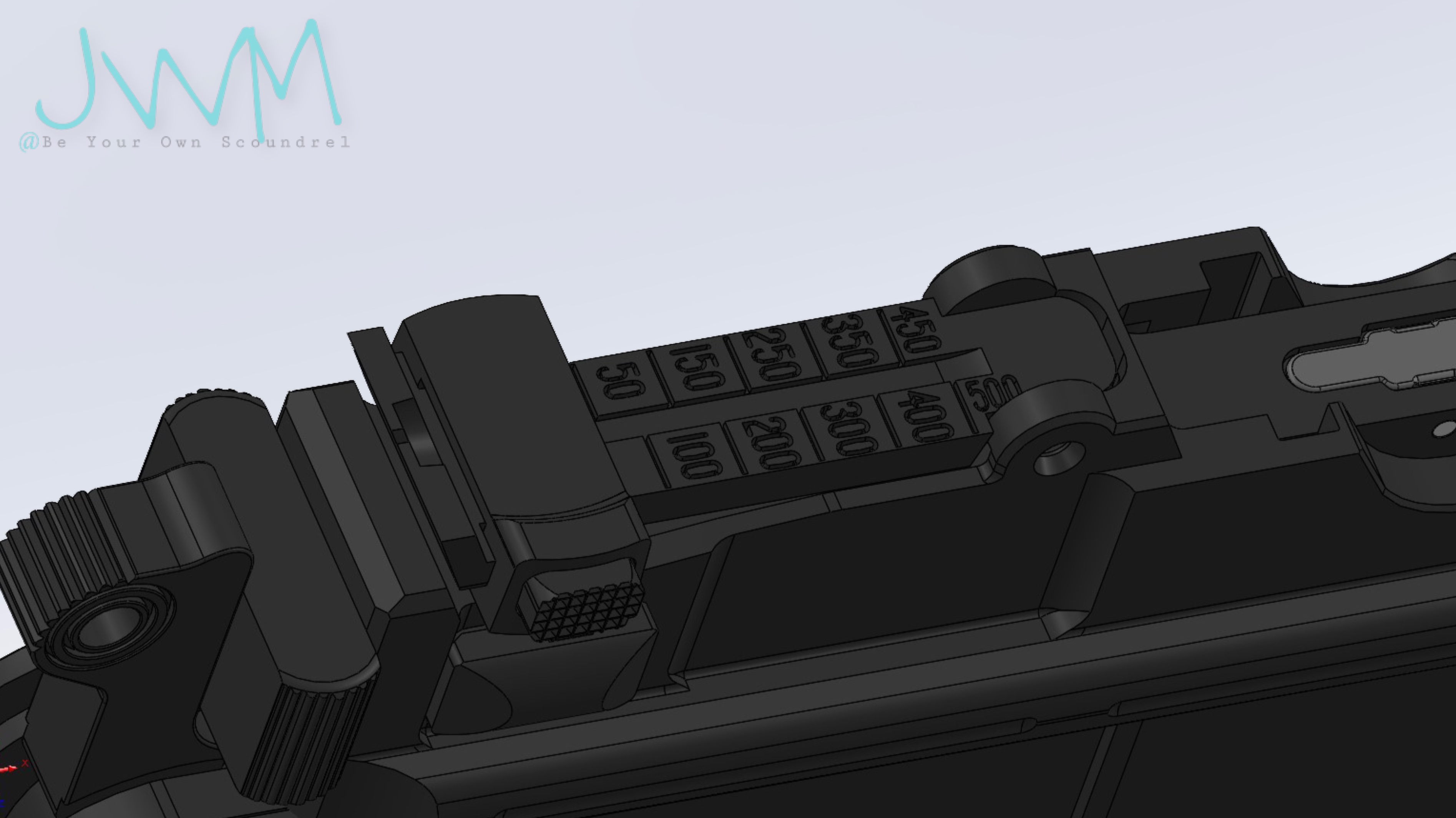

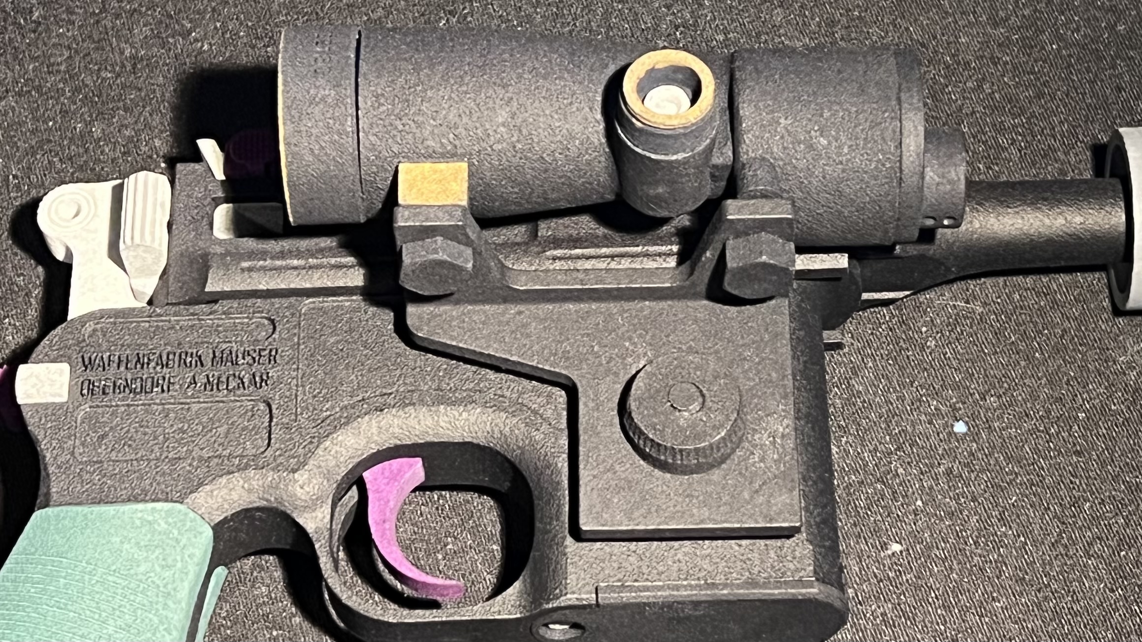

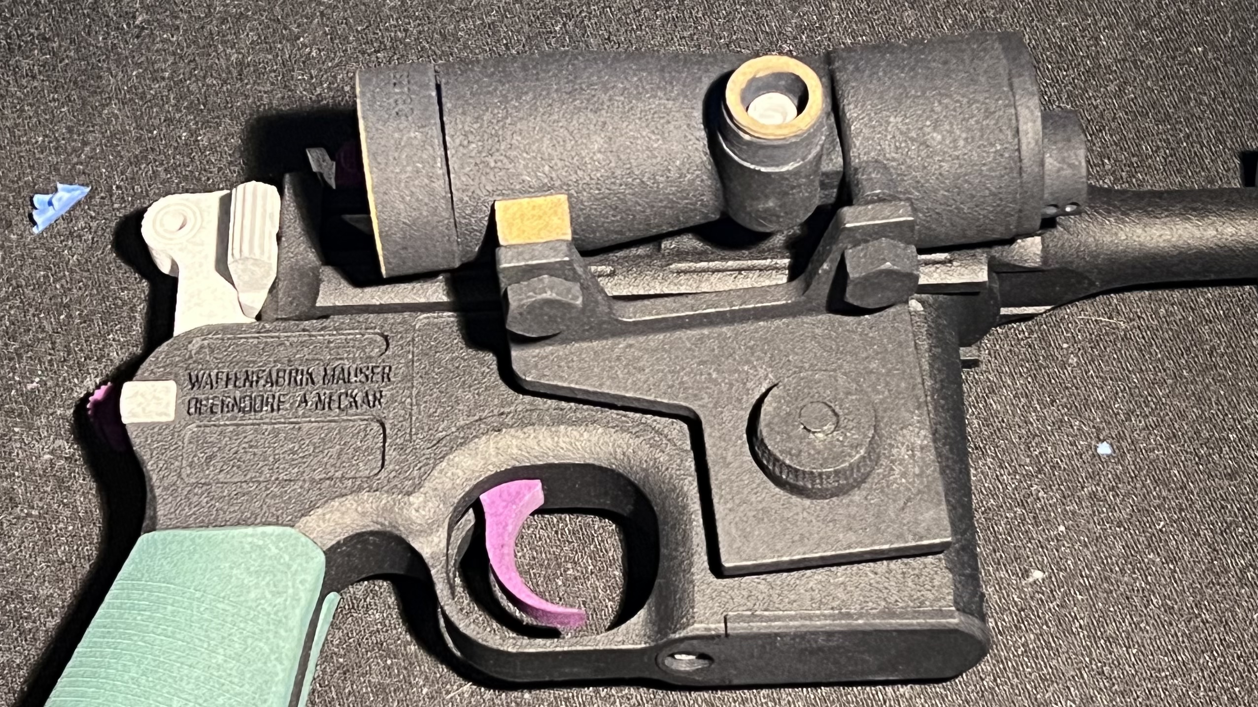

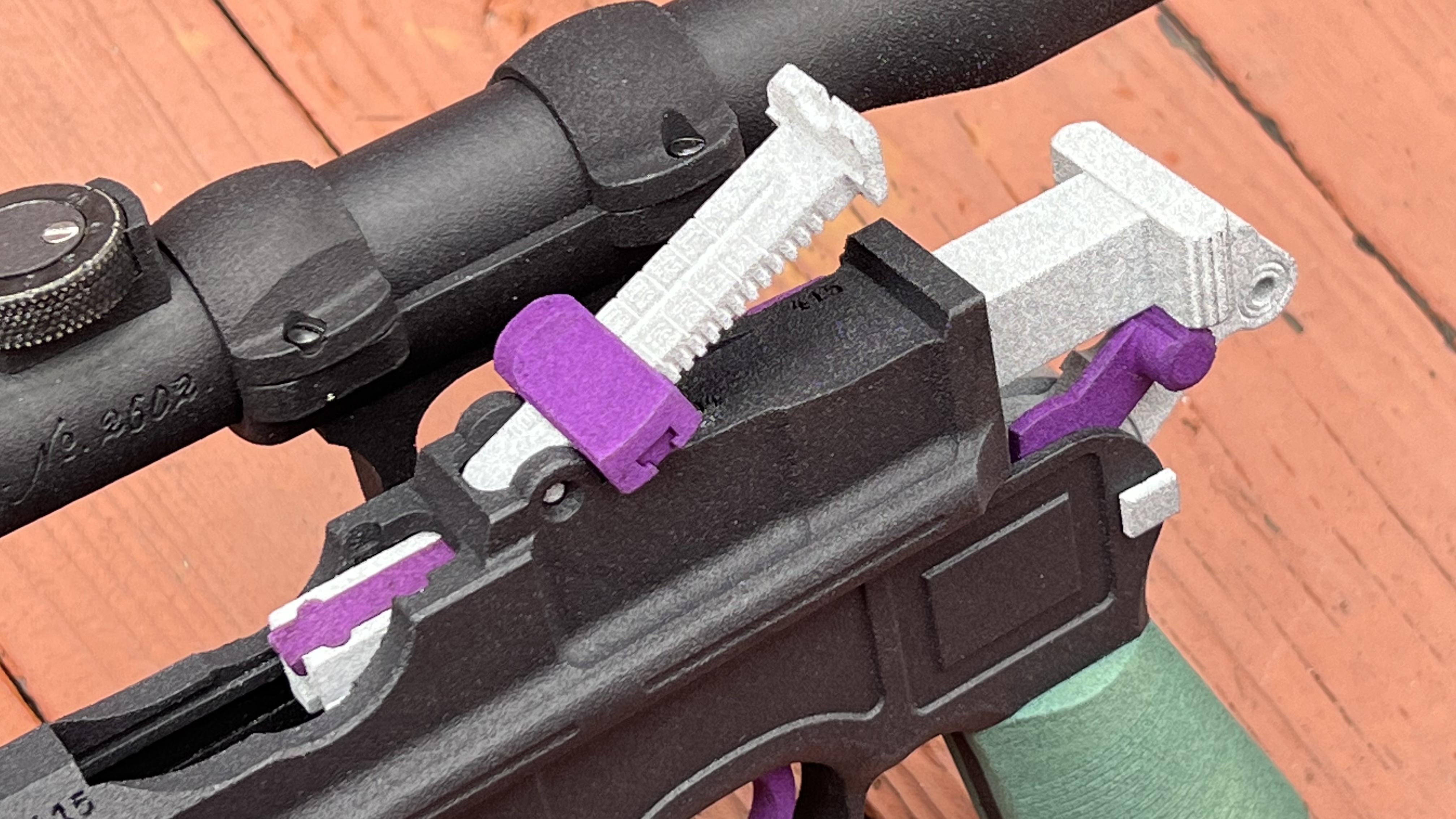

Here’s another fun scratch recreation from using pictures alone. The esoteric crowd should appreciate this but that crowd is also understandably hard crowd please.
The weavers most predominantly featured in ROTJ on the e11’s and more importantly Solo’s two screen used (and unused) DL-44’s have become pretty much extinct these days. So instead of using inaccurate ones that sort of, kind of fit bill.. why not simply recreate them!
As Oscar Goldman once said.. “Gentlemen, we can rebuild him. We have the technology.”

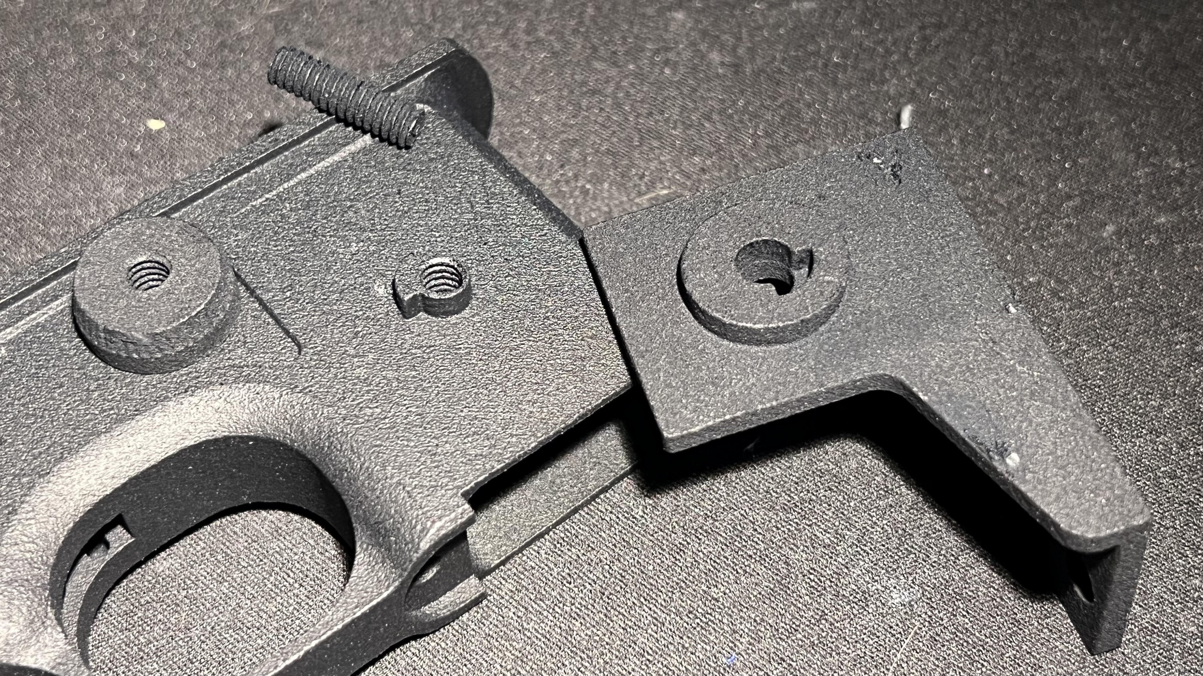

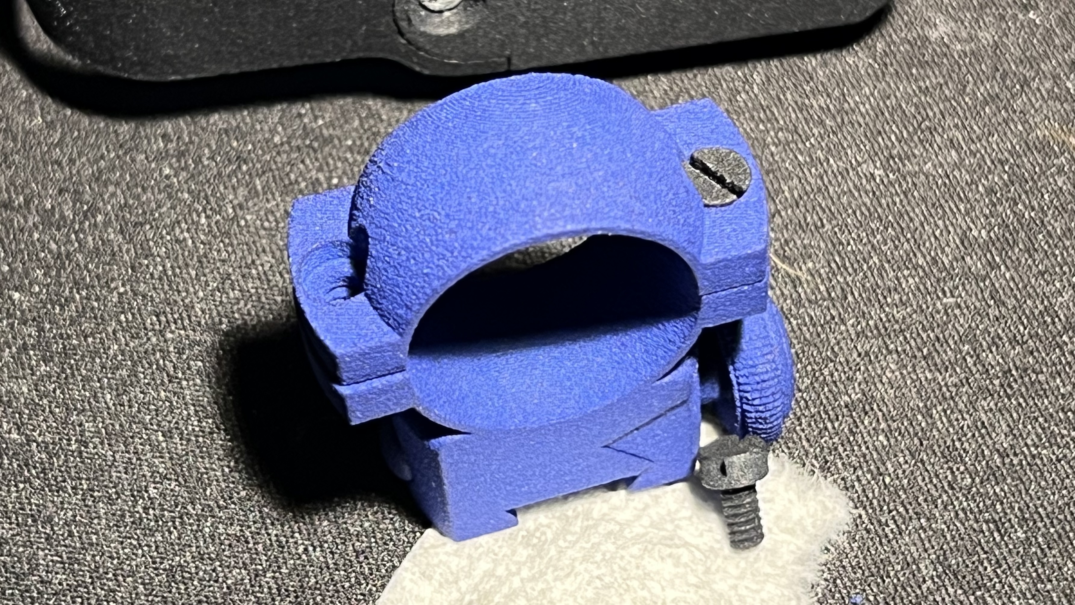

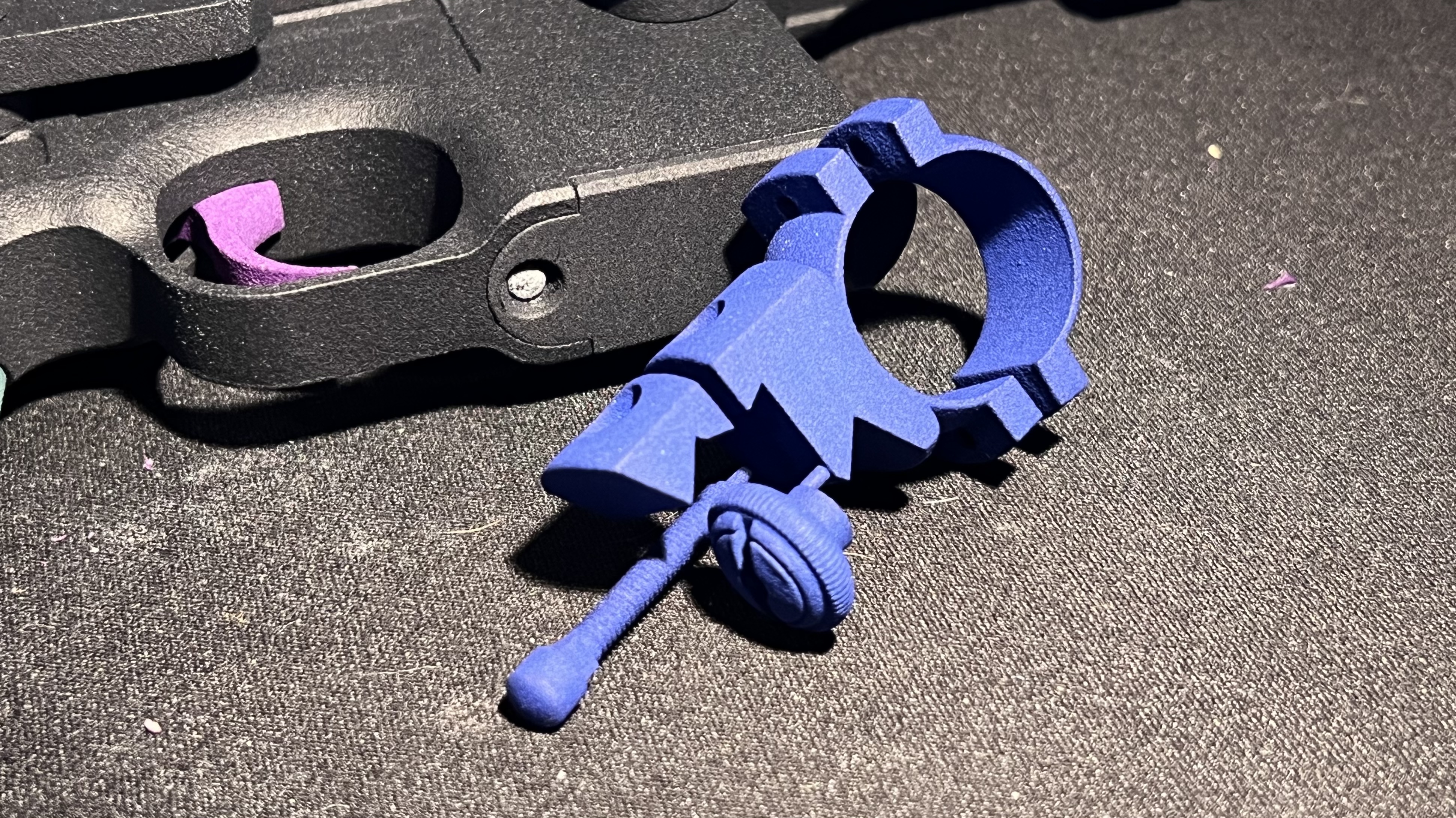

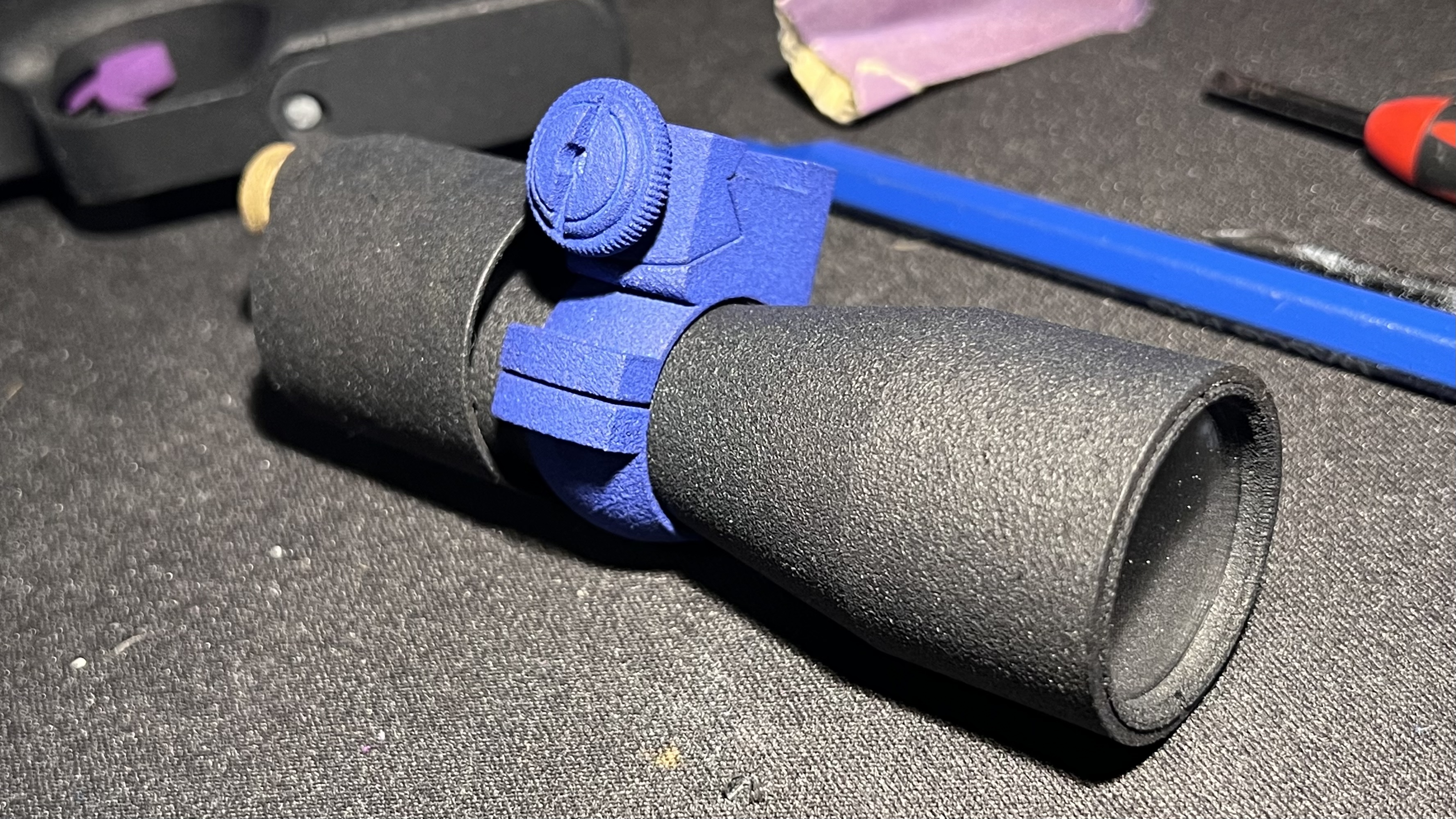

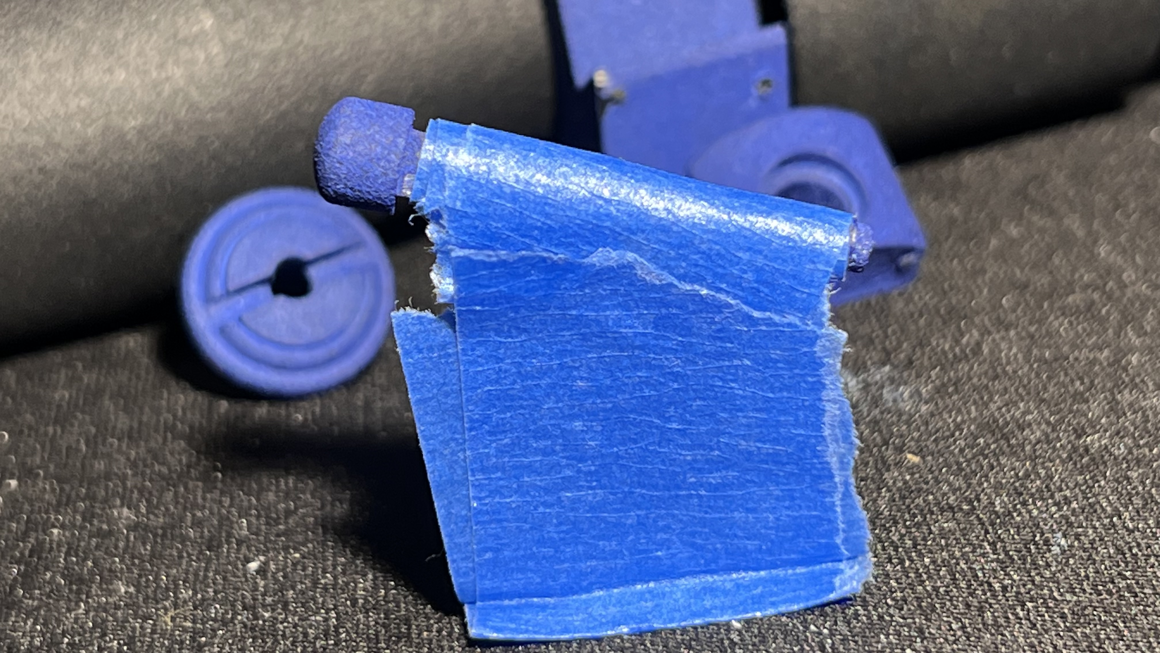

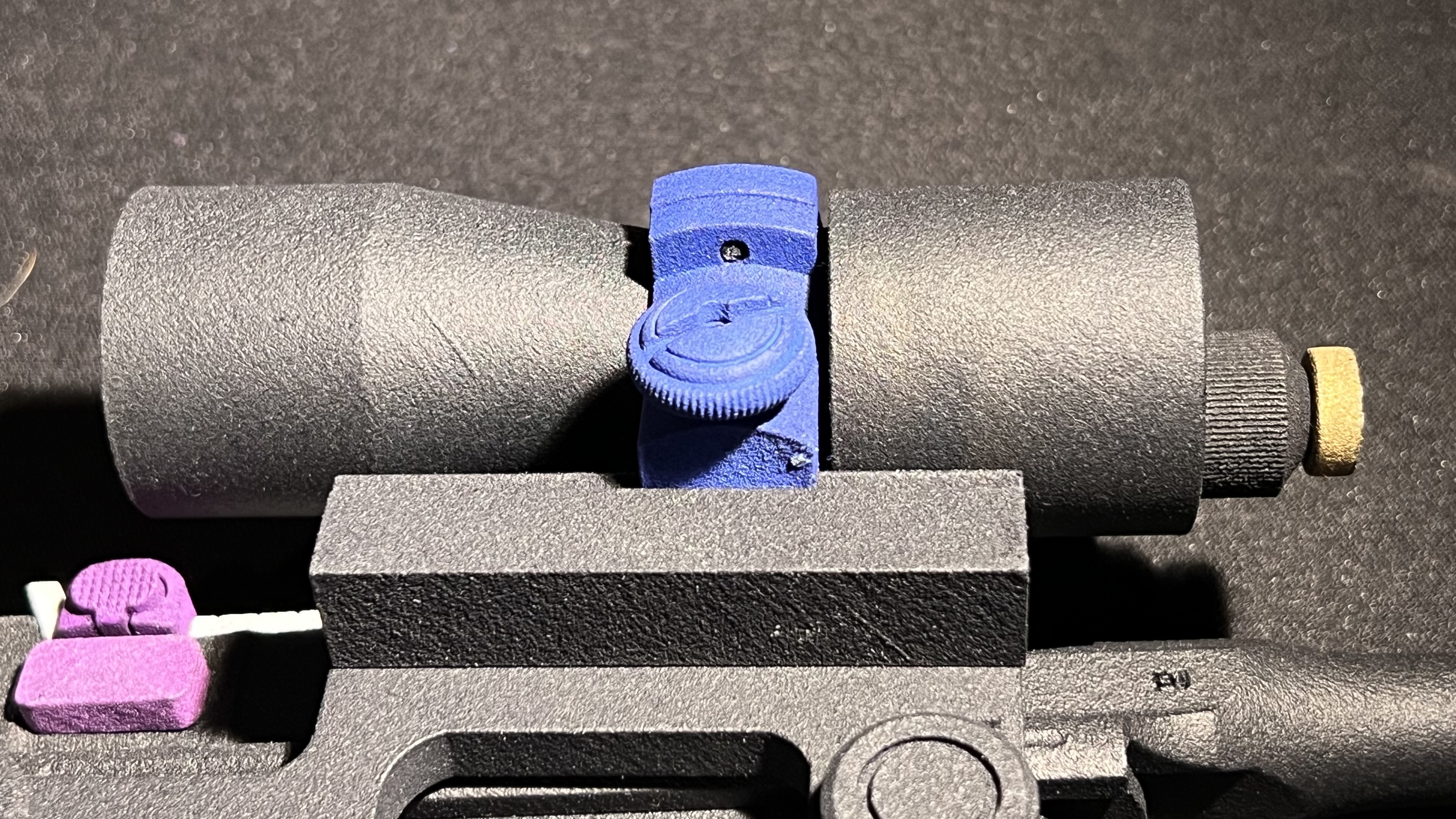

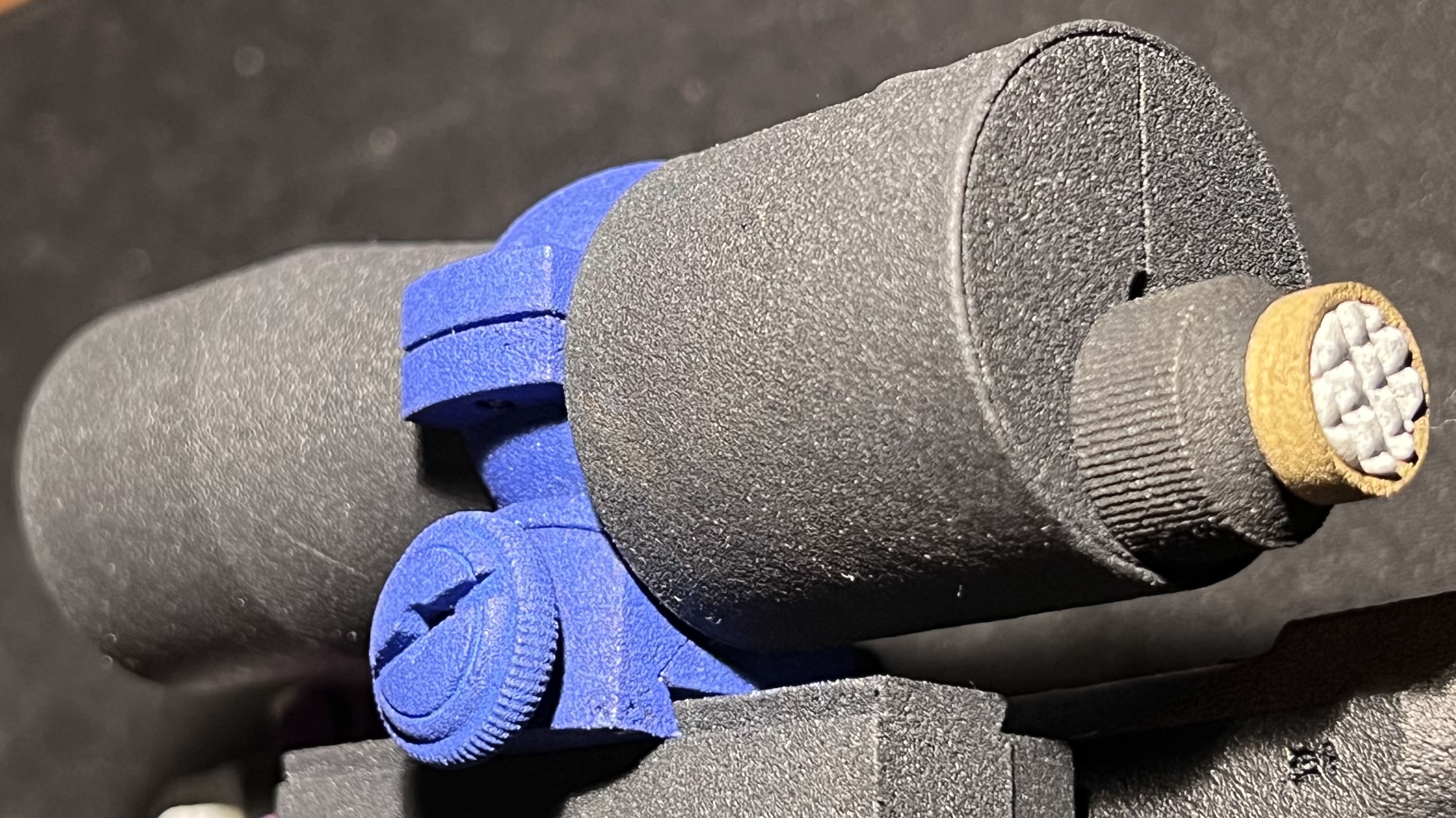

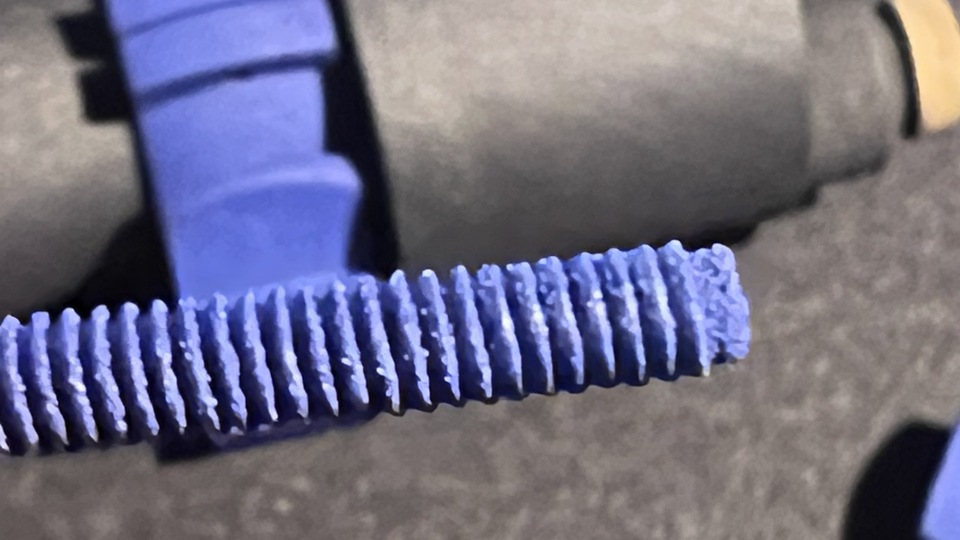

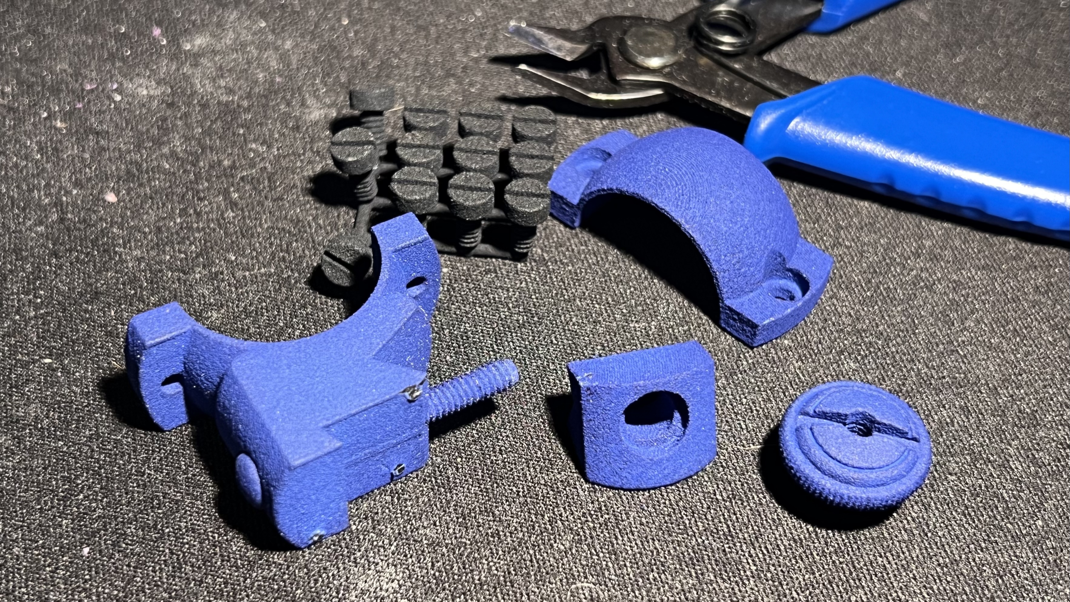

I designed up everything you see here including the screws. The threading is designed into the part as well and it’s great to see it all come together without any hiccups (well.. except for the color). I’ll end up using a resin print for knob as the details will come out better but for strength and durability this MJF nylon print is more than up for the task. Again don’t mind the color as that’s simply a mistake on the service providers part and they will be painted regardless..
The scope mount is awesome!
Thanks bud!
I'm very curious to see if the tolerances are enough to let it keep working after you've painted it. Fingers crossed!
For the Stembridge scope mount? What do u mean by “keep it working” if you don’t mind? Might be able answer ur concern now to be honest. Any male/female part I don’t paint in order to keep them working properly but you won’t see those parts anyhow. For example on this I weaver won’t be painting any of the threaded parts themselves. The rest of course will be painted though. That way everything works as designed.
Edit: oh wait u probably mean Bespin mount sorry. That I’ll simply cover when painting. It shouldn’t be an issue either.
Thanks bud!
I meant whatever version it is that you referred to when you said this:
My takeaway was that you had printed a functional screw in MJF Nylon and intended to keep it as a functional screw. I also assumed that part of that screw would emerge from the far end of the mount. So I thus assumed that you'd need to paint at least part of the screw since leaving it bright blue was probably not ideal.
Vagabond Elf gotchya! I’ve being printing “screws” for a while now but originally tapping and threading them in hand but now as I mentioned I’m doing all the threading in the design itself. The concerns you mentioned honestly have already been taken into account. For example with this Stembridge weaver I made the tip smaller so when painted it won’t conflict with the attachment. Simply tape it up and paint. There’s enough room for it to come out the other side..

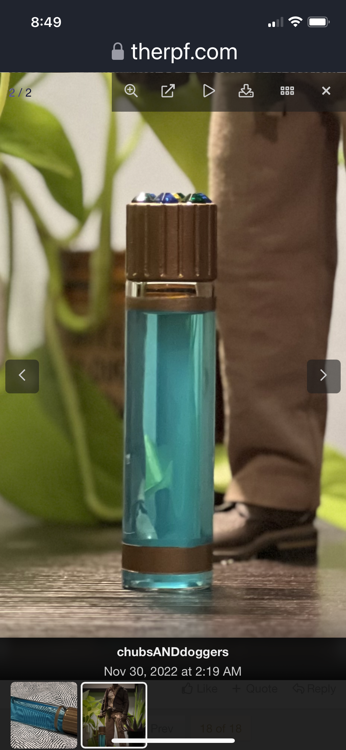

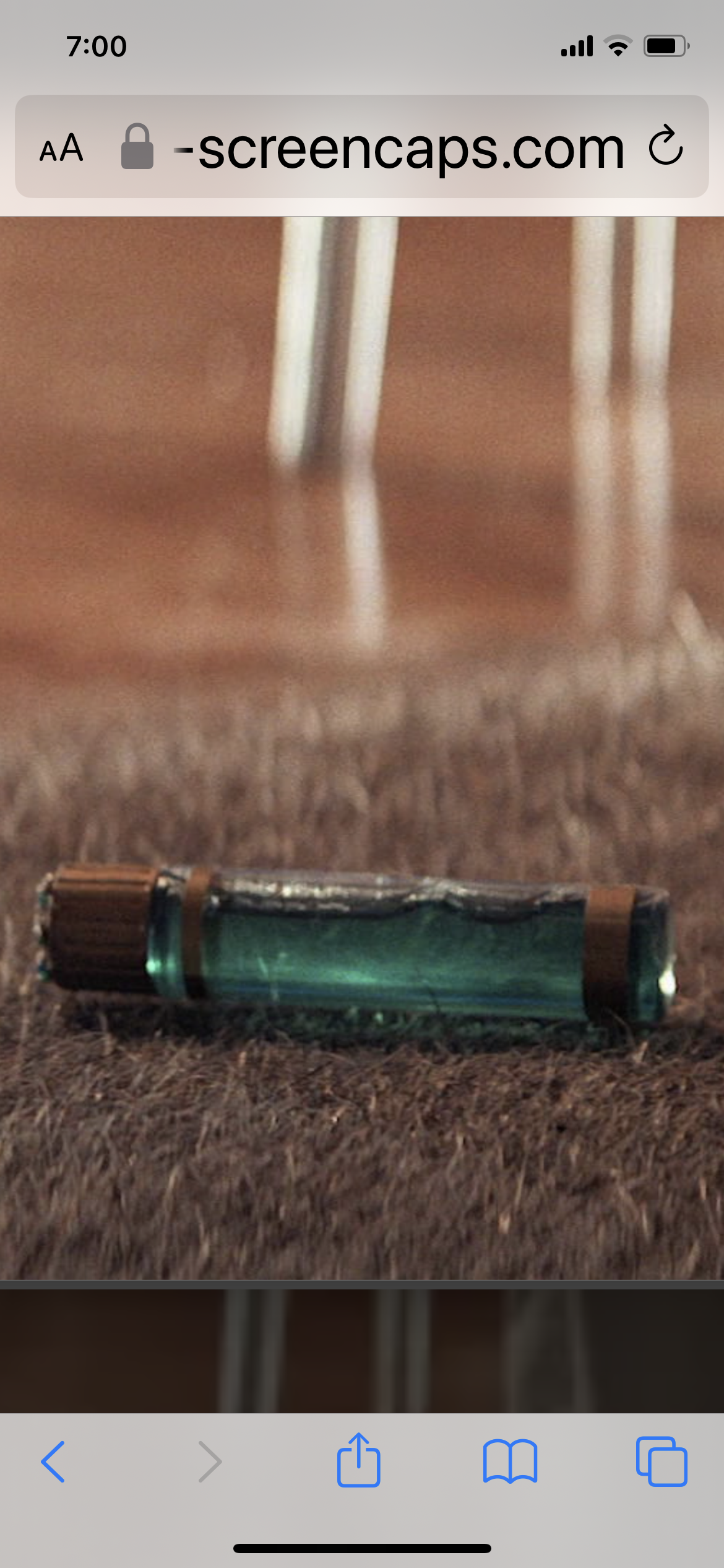

Just reworked the TOD vial lid with some new rhinestones provided by cjunco1937. It’s also created for him as well as he is one of the most passionate Indy’s fan I’ve had the pleasure of chatting with. His Indy collection is 2nd to none so having this on display within it will be an honor..
As always, John knocks it out of the park. Here are some comps against the the screen version, albeit this was with an earlier set of rhinestones— the ones eventually used were less pointy and closer in color, but these pics show how close to the prop chubsANDdoggers got with this replica.
