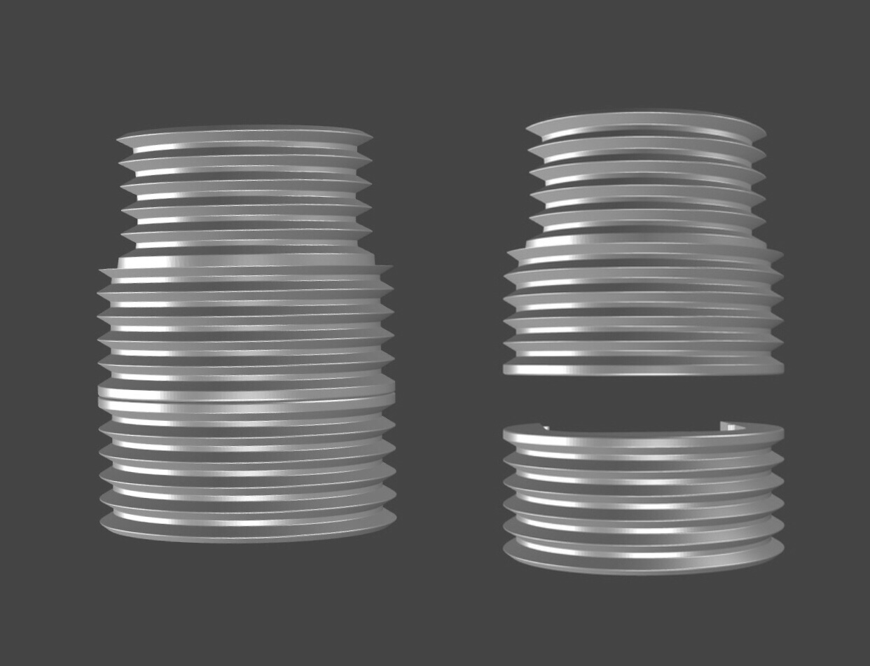

thanks brother! what is the differnece between the one part grill and the 2 part grill?
Only different is this below. The two part grille I designed so it will have a more predominate divide line in the bottom 3rd of the grille. Otherwise they are identical (you will have to use glue or tape to hold the two part grille together)..
The build in the thread is using the one part grille in “smoothest fine detailed plastic”. Using that material it captures all the details you really need honestly.
