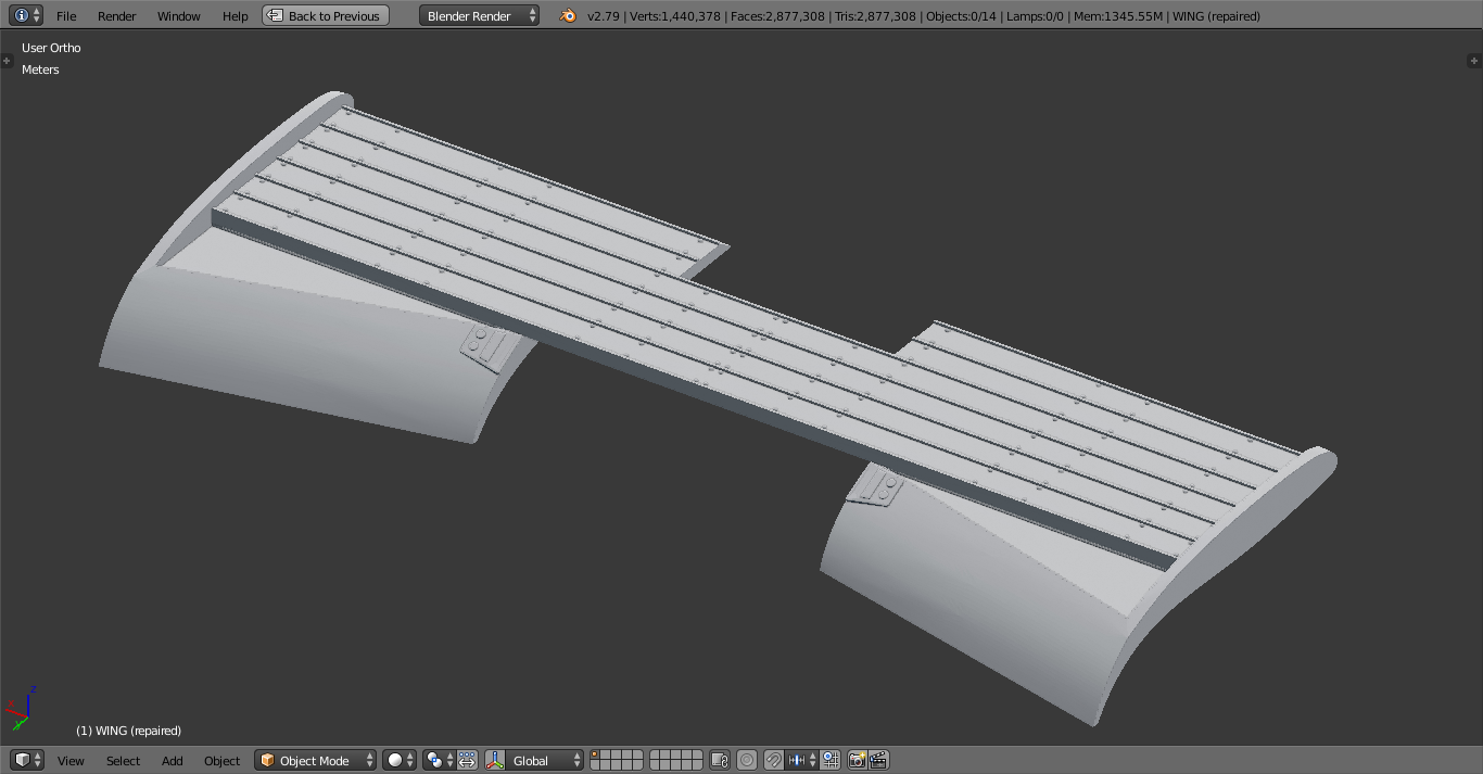

As they are the most awkward looking, I thought I'd start with the wings!
WING;

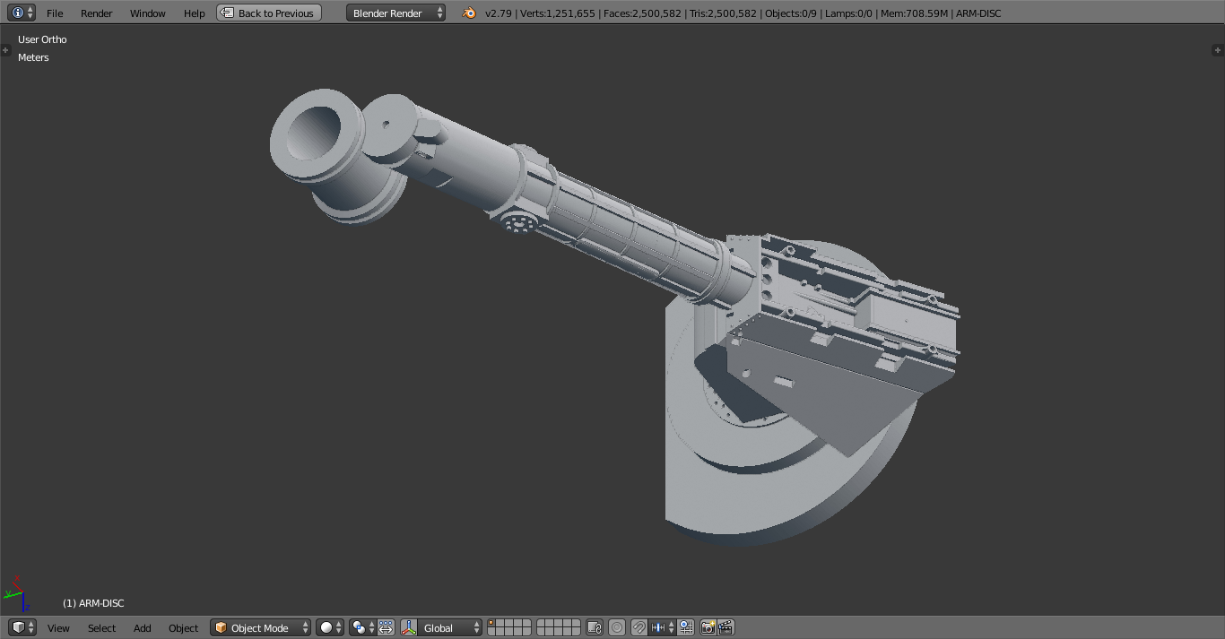

ARM; (RAD8 again!)

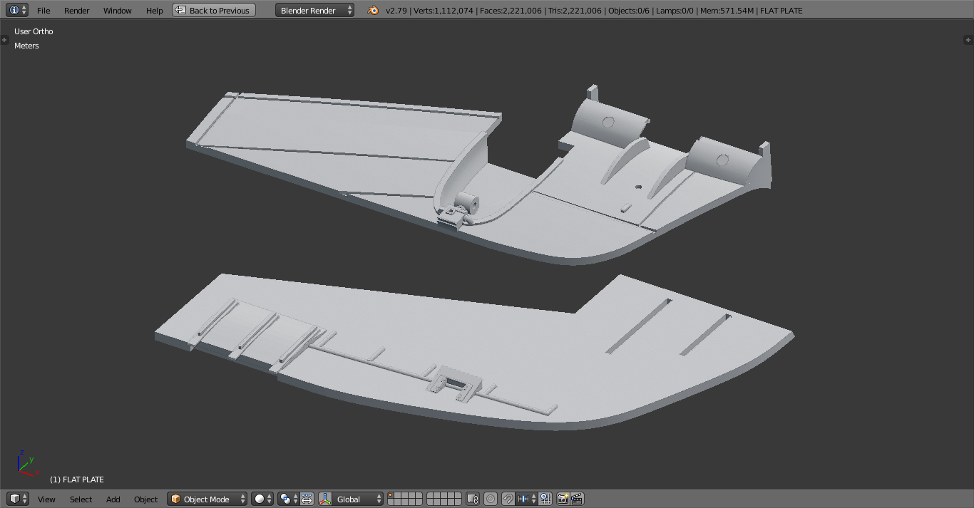

VAN DOOR;

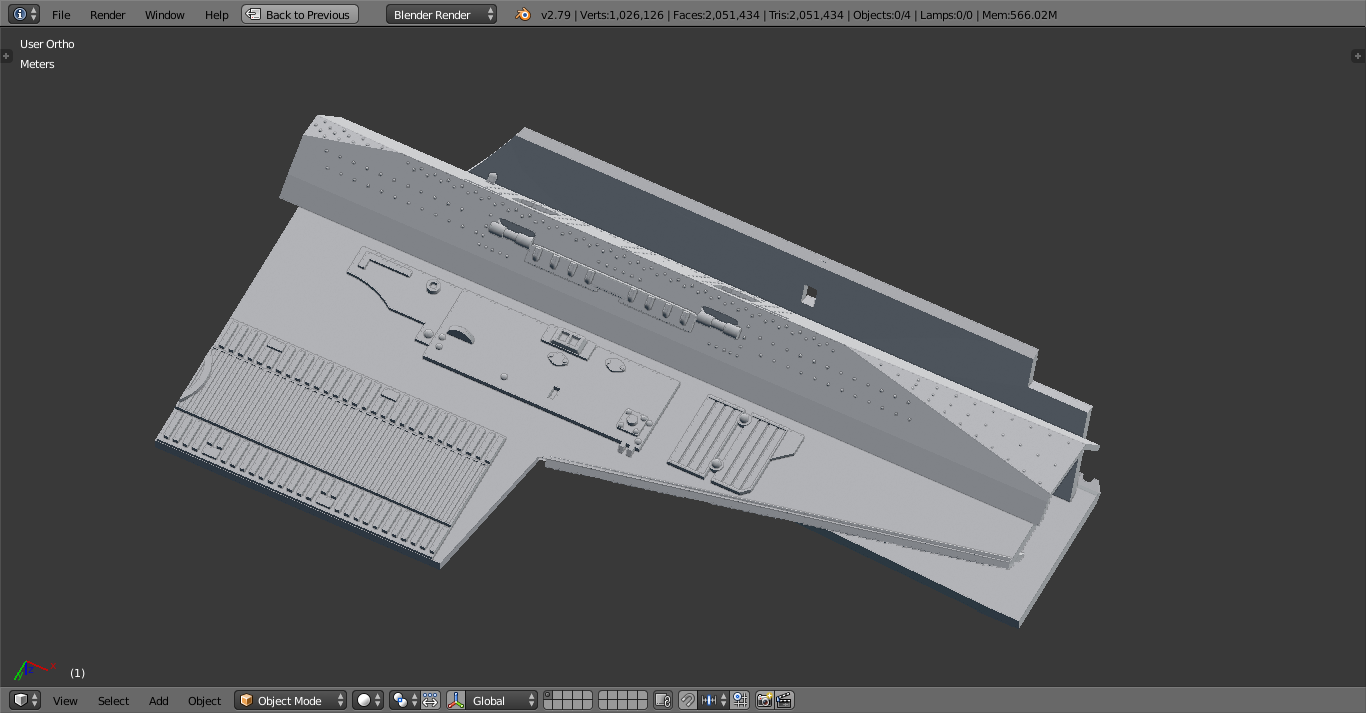

WING PLATES;
POLE HOUSING; (back)
POLE HOUSING; (front)
WING; (wip)
Still got the bits around the arm disc to do if anybody knows parts used here?
And if u spot any glaring errors or omissions, just holler
