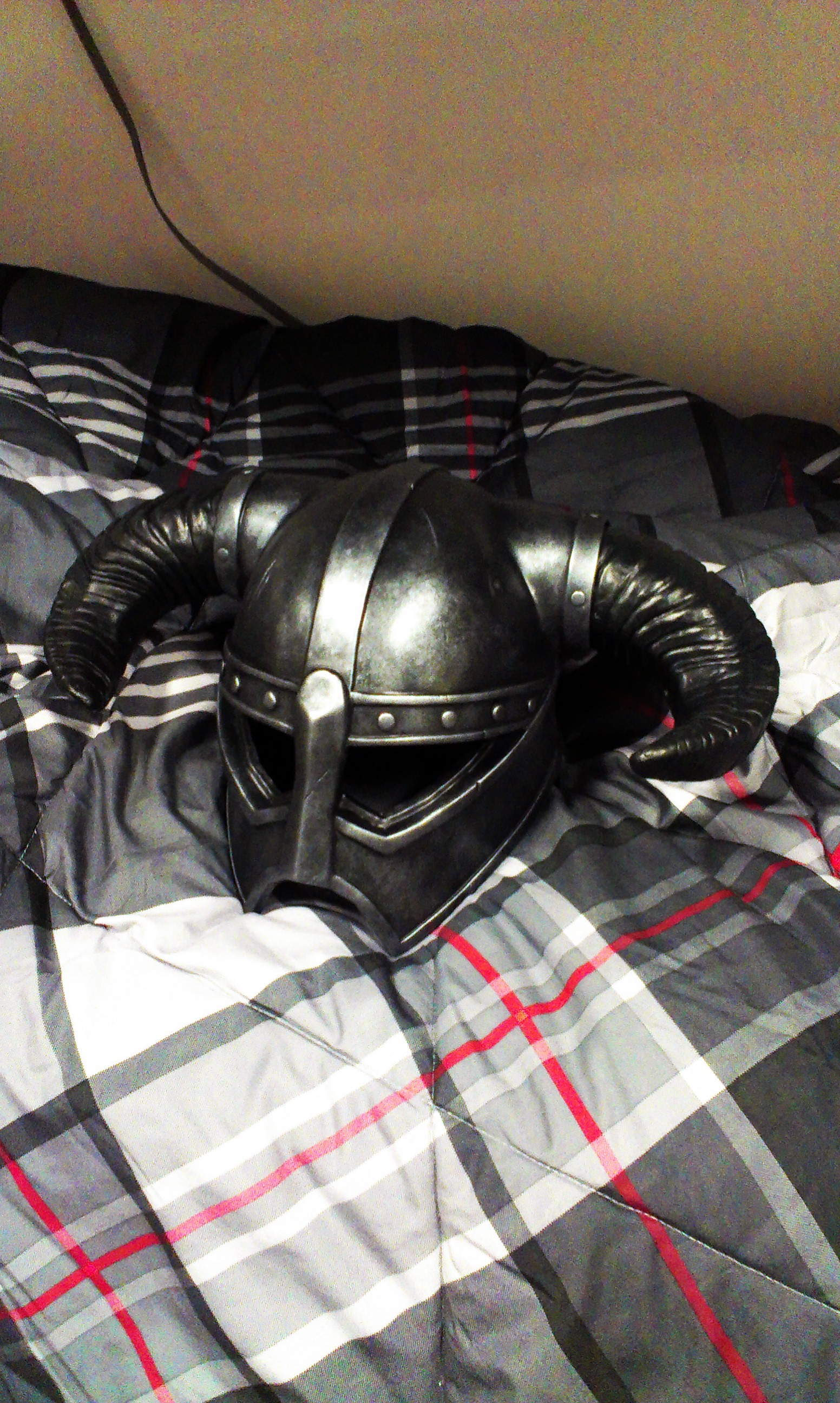

I am basically having to make everything from scratch, including the identity discs. A lot of trial and error, foam, pepakura, bondo, resin, etc... But I am hoping to have it finished within the next couple of days since Halloween parties are this weekend!

i do however have an updated photo of a better paint job, one that more resembles iron (in my opinion), so enjoy!
View attachment 244724View attachment 244725
the one with the black horns was before i painted them, but i kind of like that dark look. I might try out painting some darker toned horns to see how it goes

well i'm flattered, thanks! to be honest, the camera does half of the work, making it look even better. I followed the painting technique of another member on here, by using several different shades of silver acrylic paint that was applied using a sponge. I applied the first layer of a very dark shade of silver over the cast helmet (used onyx for the cast) followed by several lighter shades dabbed on lightly. the final layer was the lightest of the shades, and instead of being dabbed on it was "brushed" on. once that was done, i sprayed on a gloss clearcoat! for the horns i simply sprayed the entire surface a dirty brown color, then rubbed on a horn color lightly over the surface, so the parts that kept the dirty color was the areas that dirt/natural color would normally remain on a regular horn. after that, a matte clearcoat was sprayed on top of it. hope it helps!

nope, use it straight out of the tube! all i do is buy a large tube of silver, and and tube of black. that way you can make any shade you feel is right! i should clarify too, i dry dab the paint on, so same concept as dry brushing but using a sponge rather than a brush, and dabbing rather than stroking!
