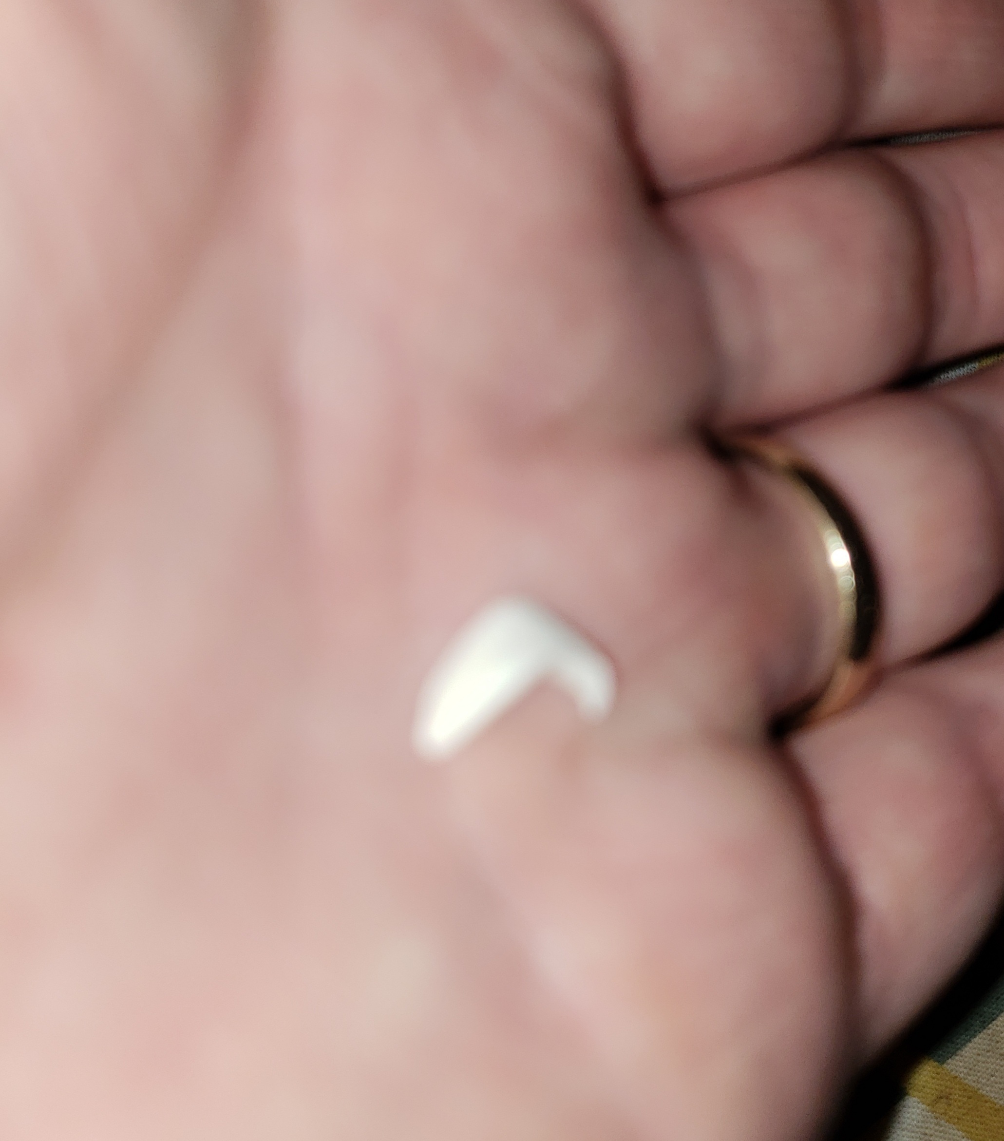

The two that I had earlier called ball are the swirls at the bottom:

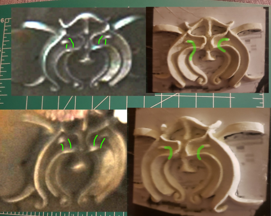

So from the side the tapering point is hard to see but from the front the taper reaches almost all the way to the edge lip (but the bottom of the lip not the top), making it look like a fully bridged line. Does this seem correct?

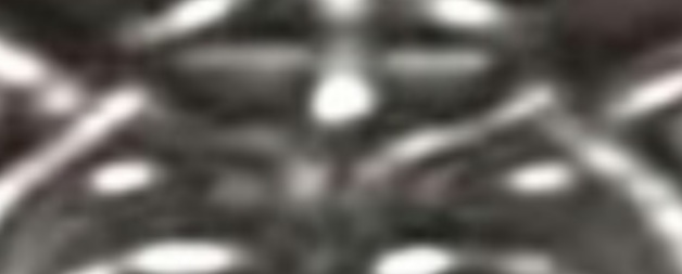

Did another search through the on screen shots and I am back to the two plates/eyes not connecting to the edge and not even having a v pattern. In these shots, the camera is looking directly into the buckle. The bottoms of these are completely straight and at all times parallel to the edge at an equidistance away, never even getting closer. The top of the plates/eyes looks mounded up but the bottom is flat. I can only suppose that all the shadows and angles that look like it curves down must be illusion due to it being a metal buckle with a lot of reflections. First pic, just a closeup. Second pic shows the bottom versus the lip edge (both inside and outside of that single lip edge) and the last includes just the mounded shape. I think that if the belt were tipped up slightly, from this view, we would see a hollow space concave upward. It would explain the mounded top AND why it looks like an inverted v from some angles. But I definitely think this frontal view shows it doesn't have the long curve down to the lip like it looks in other pics.

This one (ep5) makes me thing that the eyes are not connected to the rings at the bottom, but they are a bit more curved?

yes it totally feels like there are two buckles used onscreen and one is clearly a crescent moon and the other a very minor curve.
So that pic was actually even more straight on perpendicular to the buckle face than the previous one. The one I was looking at, in post 28, was slightly from above and that angle makes it look flatter. But the one you posted in 29 is showing it from beneath the overhanging curve so it shows the arc and the thickness I was assuming but could not prove in post 22 and 23. Should take about 20 minutes to fix that but I am zombied so sleep first. Just an example though....
