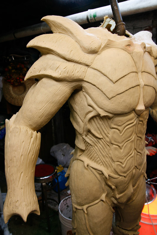

Unfortunately by the time I asked the molding questions I had already molded this using mud and fiberglass:
