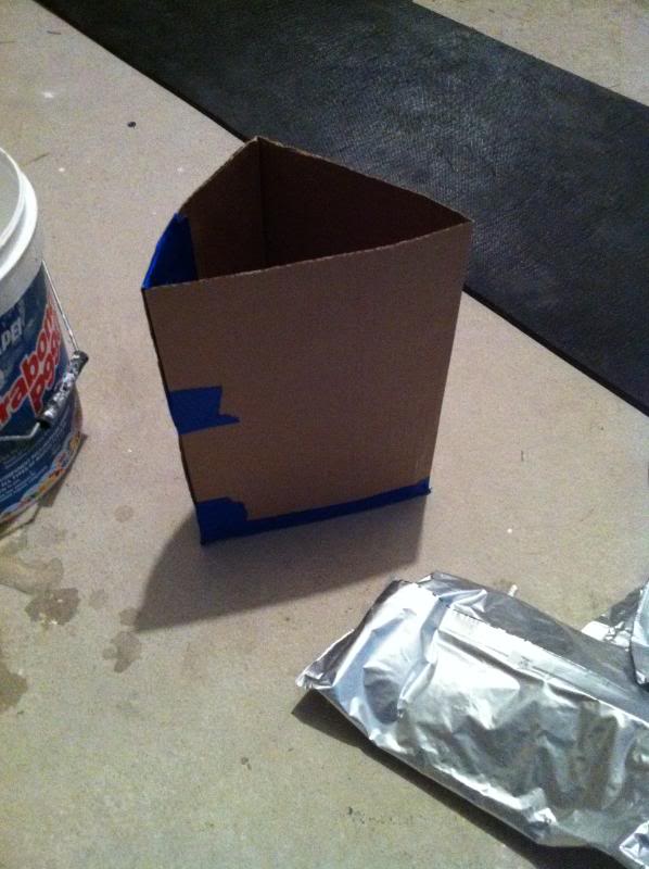

So i decided what the hell, i will take a cast of one of my hands to start sculpting ........new hands, well one anwyay. This brings me back to more doing, and less thinking, whilst being all ACTIVE with my suit stuff, i made the box, mixed the alginate and plunged in my hand. anyone spot the mistake?
forgot the VASELINE !! :eek: i decided to just suck it up and hope my hand came free, so , 10 minutes later of walking around looking like a poor mans hellboy, my hand must have started to sweat alittle and slipped out. maybe i have something oily on my hands that helped.
Yay.... one win for blind luck.
I have now poured plaster in and i am waiting to see if the alginate worked.
I did forget to give the mould a shake to get any air bubbles out, but i am sure i can fill any that are there. Also i only had enough alginate to do about 2 inches up my wrist, so i made a rough wall inside the top of the mould box with chunks of foam, hoping it has roughly extended the wrist length, even though it will be a fair bit thinner than my forearm, i can easily bulk it out with clay.

Here are a few pics, as it seemed to work ok.
Box, taped together and then duct taped over the seems to stop any leakage.
didnt take any other pics until i put the plaster in, as i was not sure this had worked. but here the box mould has been removed and you had just about see the extension inner wall made from foam.
Then the hand, you can see the rough wrist extension, which is pretty much perfect length for what it is need for.
