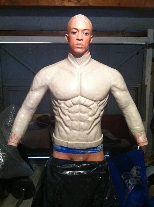

well, yesterday aftenoon i decided to start the torso sculpt, i am still not a fan of wed clay, but the speed for blocking is surpreme, now if i can get to grips with the worry of it drying out ill be golden.
1st i covered the whole mannequin in clay then blocked it out where it needed it, to get as close to my body shape and size as possible. once i had that i went over the whole sculpt with my rake smoothing it down and slightly shrinking the sculpt from my own size, then i started to roughly block out the shapes and forms, which is where i am now.
chest is 46, mine is 44 ( saves me Hitting the gym :) )
i then took measurement of width of back, every 3 inches and circumference. And i kept working so the sculpt is the same as me, down to the waist which is 35. The only thing i am alittle concerned with is the forearms, for a mannequin he has pretty beafy forearms, and mine are only 1 inch bigger, Which leaves only a very thin layer of clay on the forearms ,My guess is i will have to keep watering it to make Sure.
not Very far off it being roughed out now, i can then start to tighten up shapes and onto the detailing, i am Tempted to give it my own twist somehow, but we will see if i go through with that or not Pfft

not sure about it being informative, but ya never know, i am actually making it up as i go.
also remember the skin suit will be SILICONE, so i do not need to take shrinkage into account :)

Lee that looks superb, man! Just curious, I know Silicone is a bit (apparently alot) more expensive than Latex, how much longer will your suit last because of it being Silicone? Also, how much room do you have for errors-within-margin?
Well, i am NOOOOOOOOO expert on silicone ( not even on latex ) But silicone will last ALOT longer than latex, and obviously more flexible and life like, which are all qualities i would like in my suit.
As for error i assume you meansize wise, well in theory, i say again theory, the basic shape should fit me very close, all i need to do is slightly pad out the pecs and abs ( maybe a couple of other places )
IF it happens to be too big i can cut a section out of the back when i install the zip, but im thinking positive , so it will fit well :)
