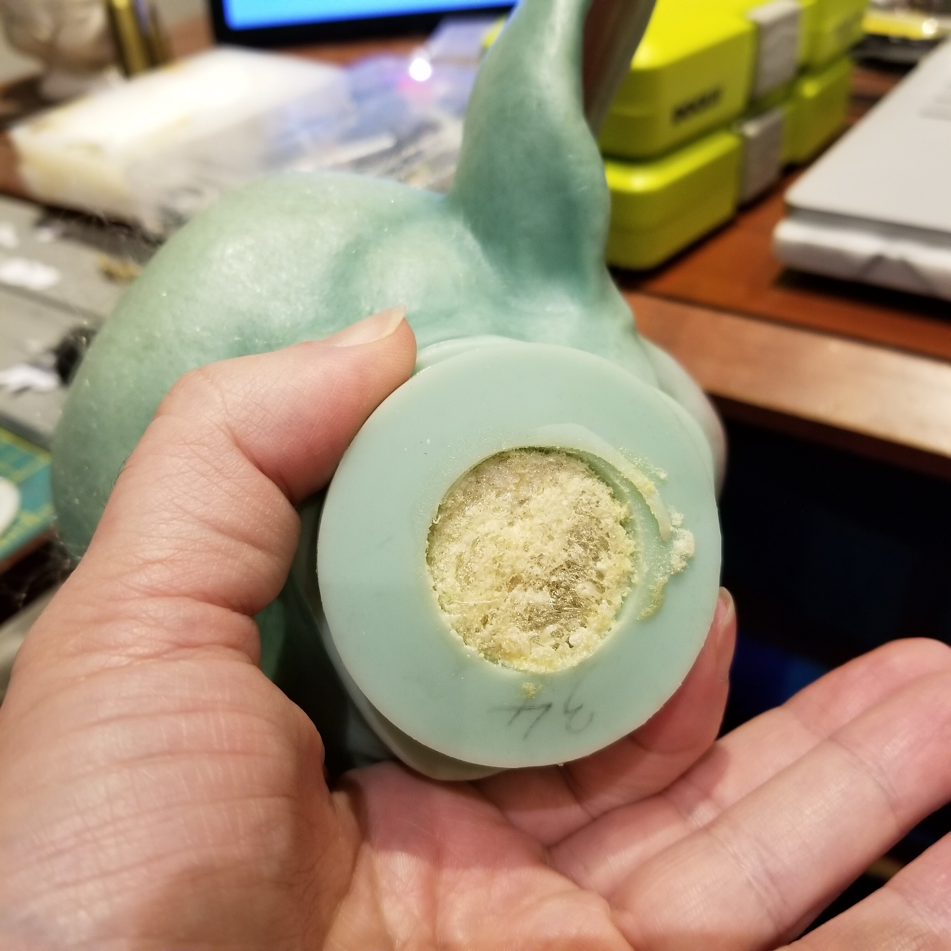

Yes, the glue used for the hands and feet is incredibly strong. The two halves of the body come together to form a nub for each of the limbs. Then the arms and legs have glue applied and slide over the nubs locking the halves in place. From what I can tell the nubs are probably a inch long making it impossible to slide the arms off. I don't think heat would do anything. Perhaps a solvent could be applied to break up the glue, but it could also eat away at the resin or plastic. Not sure how the eyes are are installed. If I had to guess I would say they are glued in place from the inside. The head is filled with foam.

It is like a semi-hard plastic, but there is some flex to it. Not at all like a solid resin.

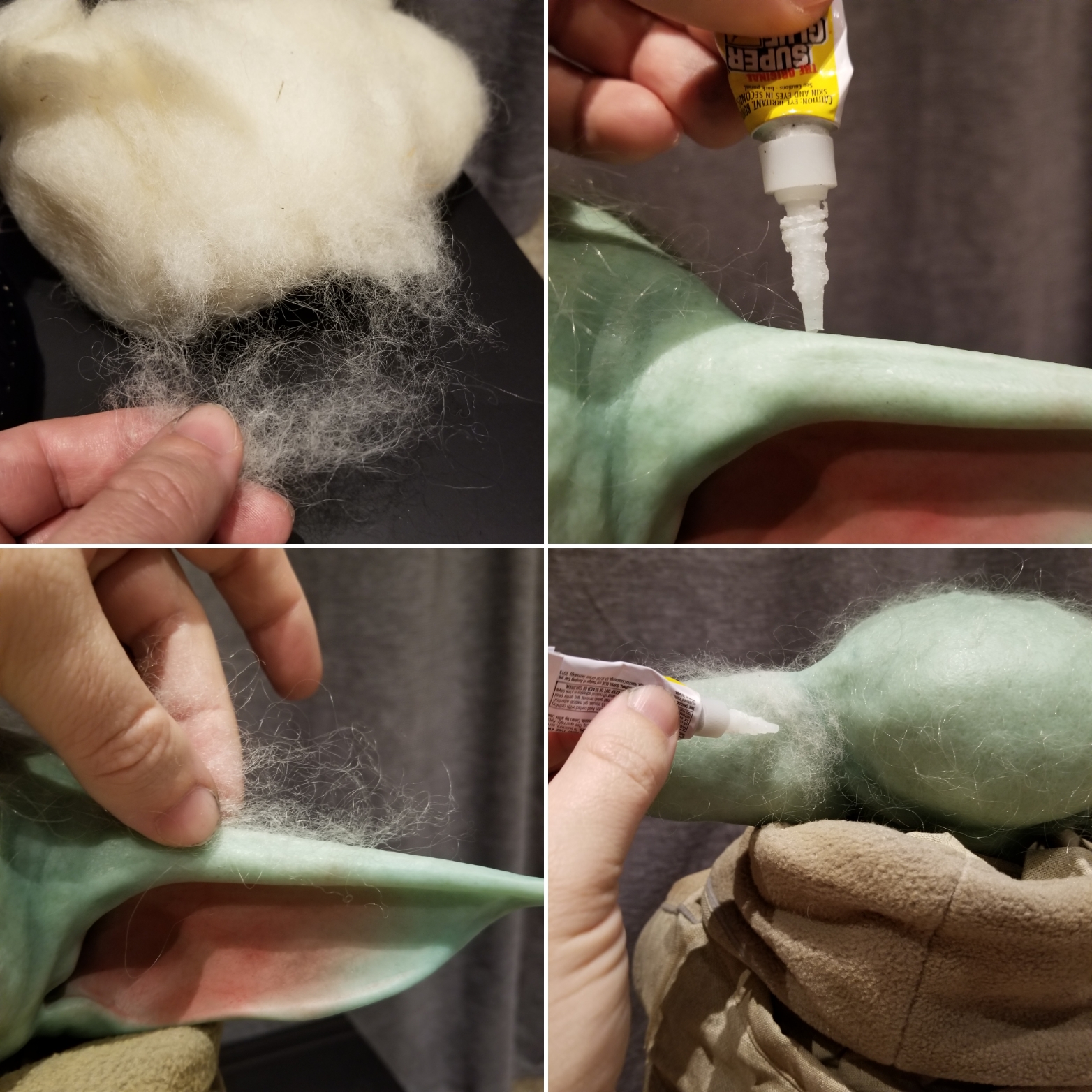

Next thing I wanted to do was add some hair to the ears. I think his head is made of resin. Too hard for punching hair. So I just glued some wool to them.
First I pulled a very small amount of wool. Then i made a few beads with superglue along the top ridge and pressed it on. Then worked my way down the back of the ear with some more glue.

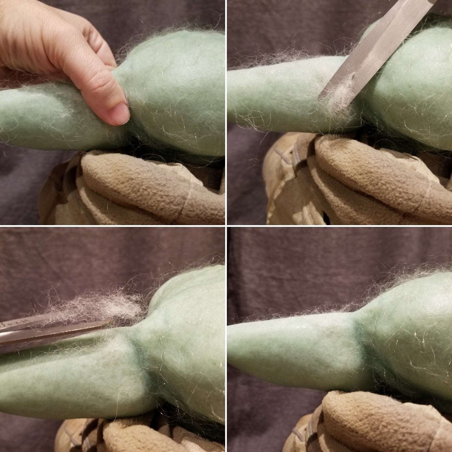

Pressed on more wool, pulling it to cover more area and then trimming the excess with a pair of scissors.
I also trimmed some of the longer fly-aways on the top of his head.

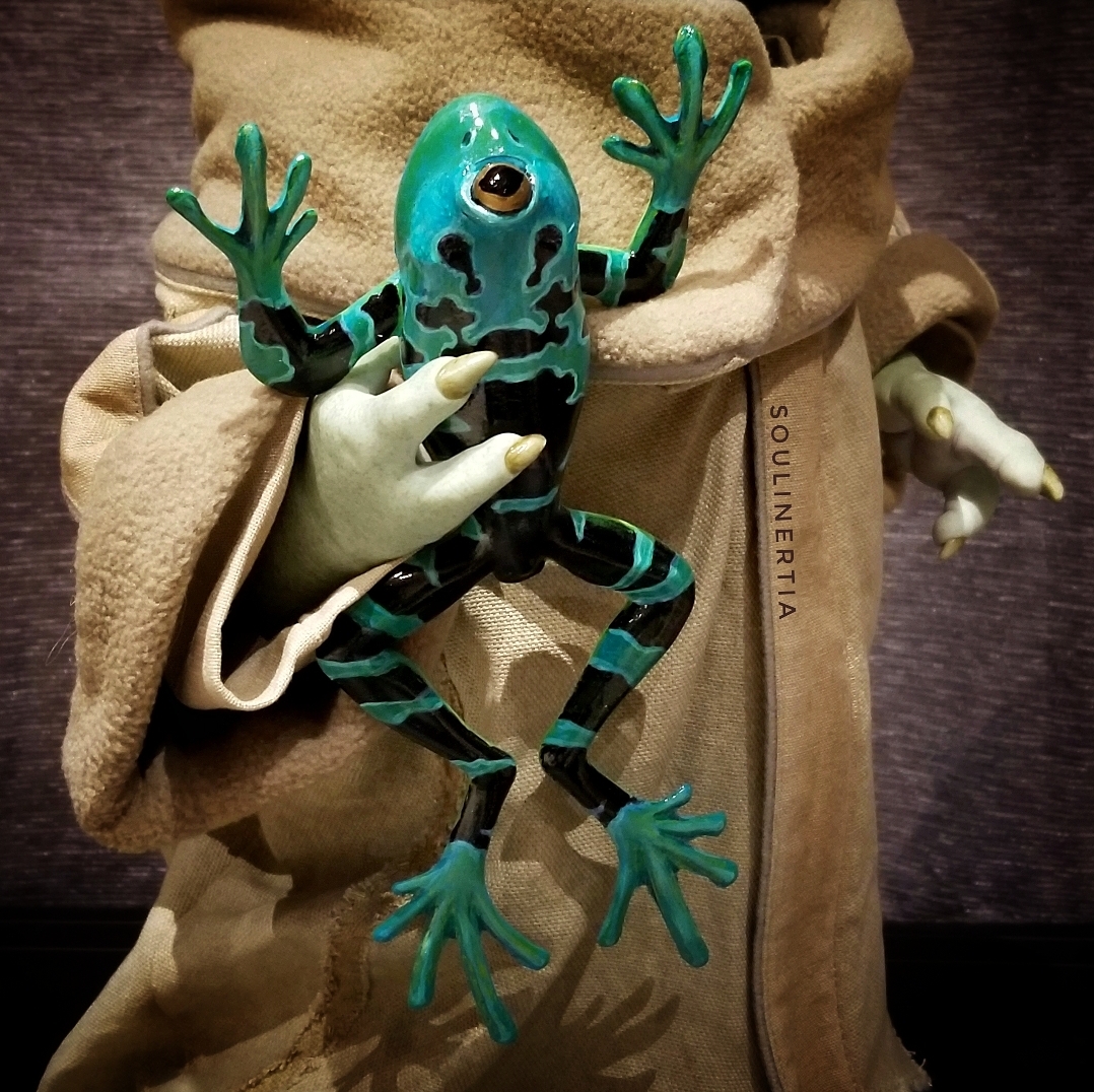

He looked hungry, so I made him a snack . . . :p

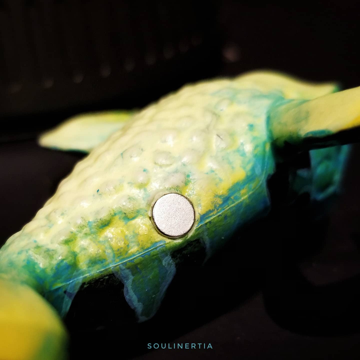

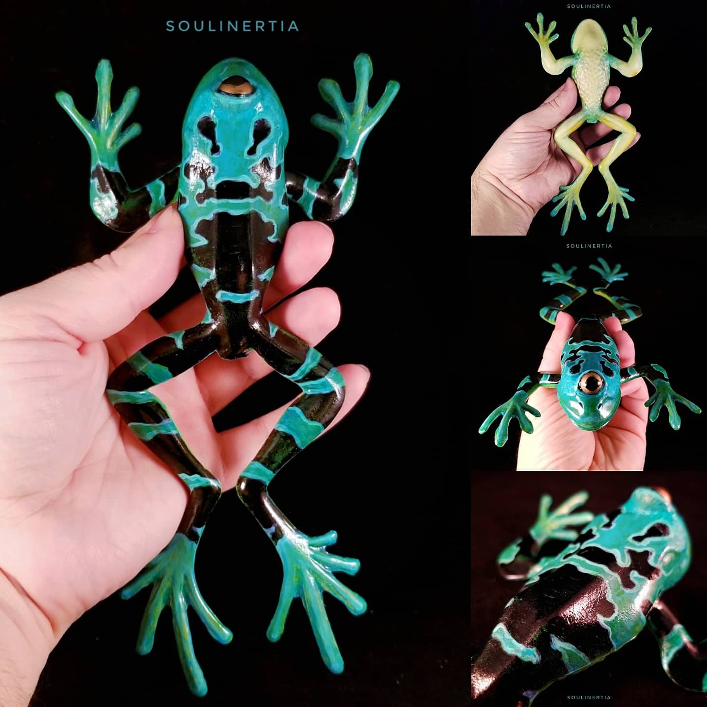

I've decided to do a limited run of custom hand painted one-eyed Sorgan frogs! These will be injection molded (not 3D printed) so they'll be very smooth and have a slight rubber-like give to them. I also embedded a magnet into the side so it can attach to his hand :cool:
I'll only be doing a limited run of these. I aim to have the first batch of 20 shipped before Christmas! Link to pre-order: INERTIA DESIGNS
