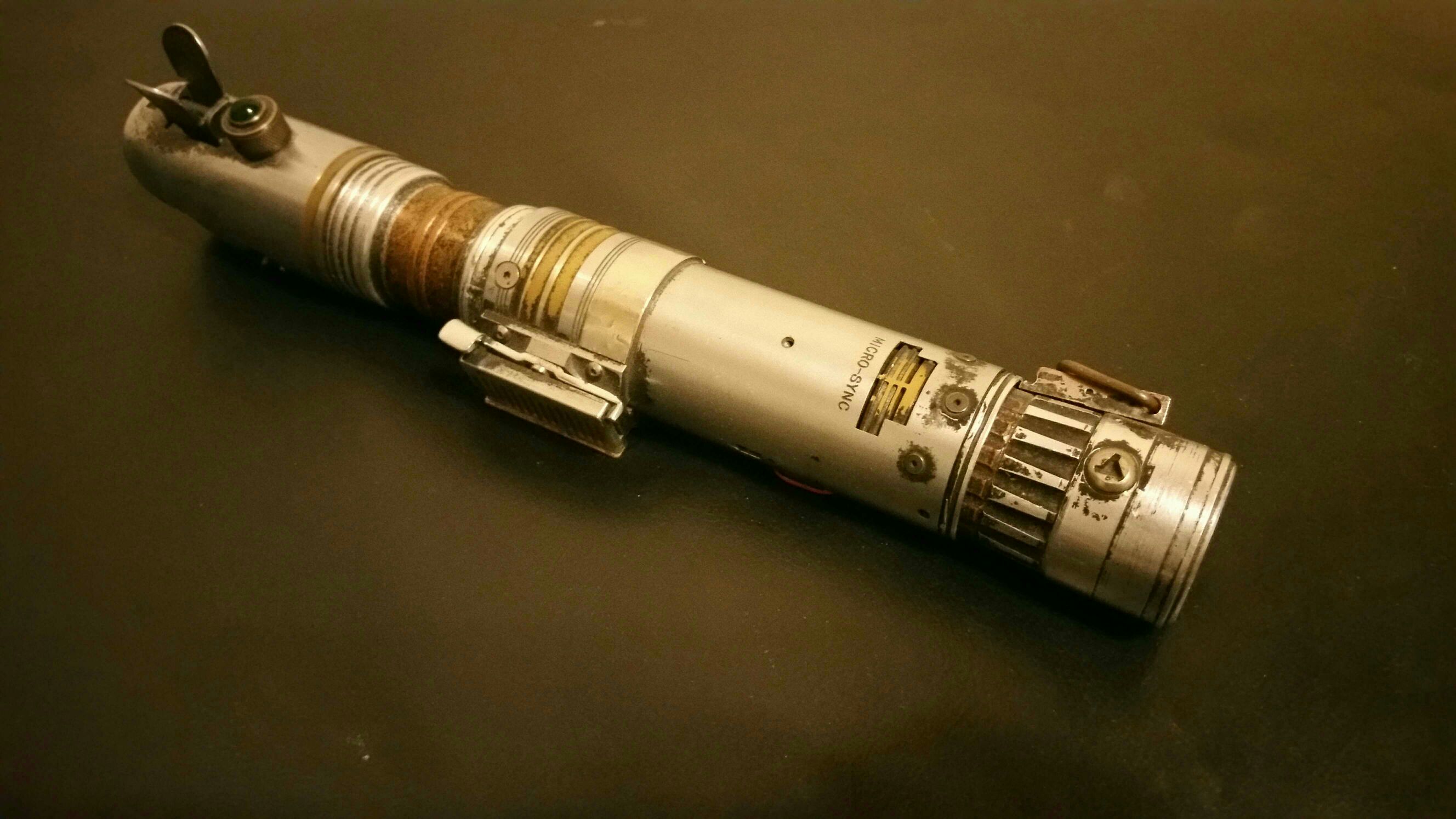

Finished a new saber a few days ago. It's another Minicam build: 3d printed grips, leather-working buckle "D-ring," 3-cell extension via the top of a Leitz flash, bunny ears taken from a Graflex slave, emitter from a champagne stopper, and a hacked-together clamp made from the Minicam clamp covered with a veneer made from the body of a Heiland synchro-special. The activator matrix is one of the LED bubble displays found in this thread.
The finish on the emitter came out too dark, but that's about the only part I'm unhappy with.
