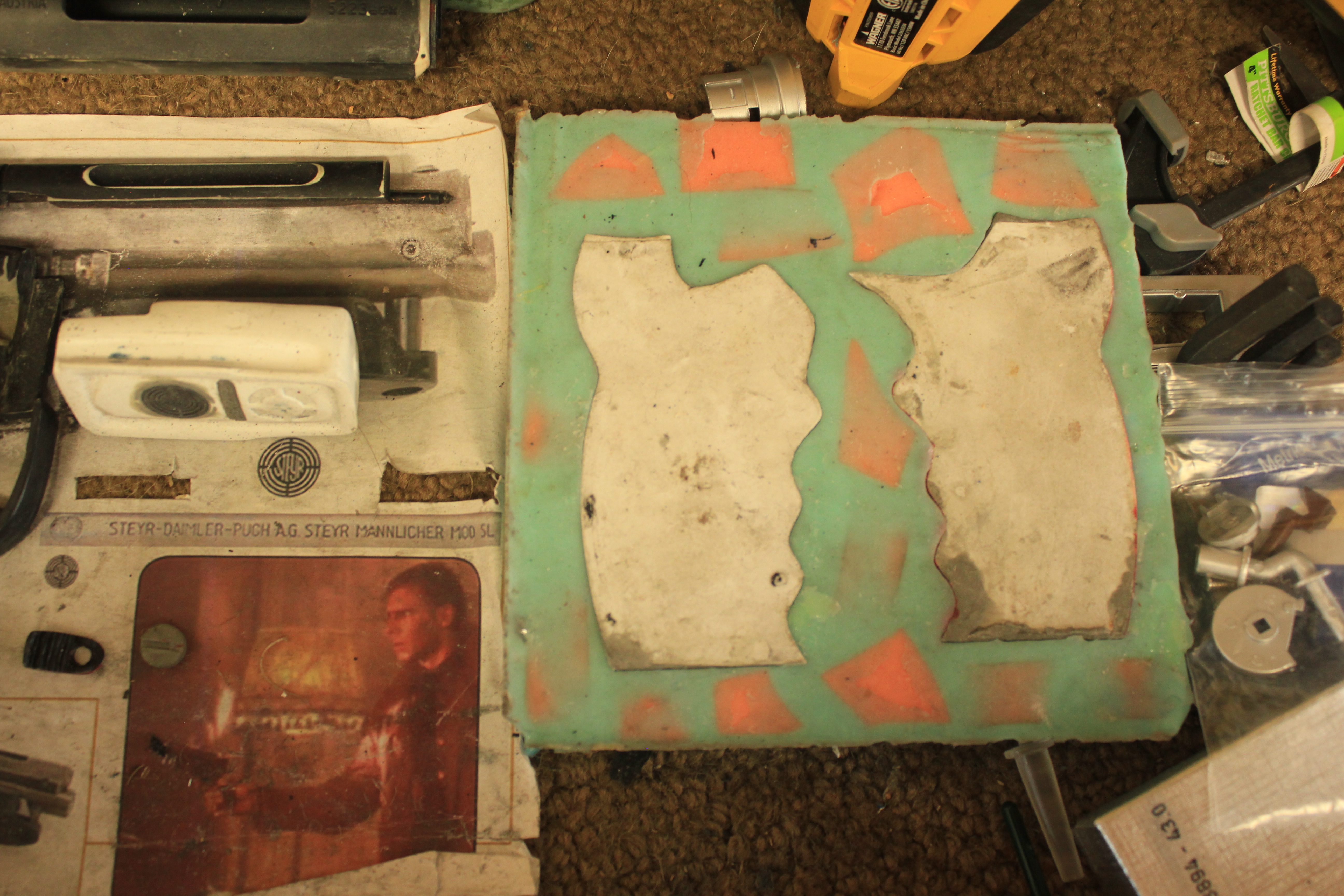

The initial pieces:

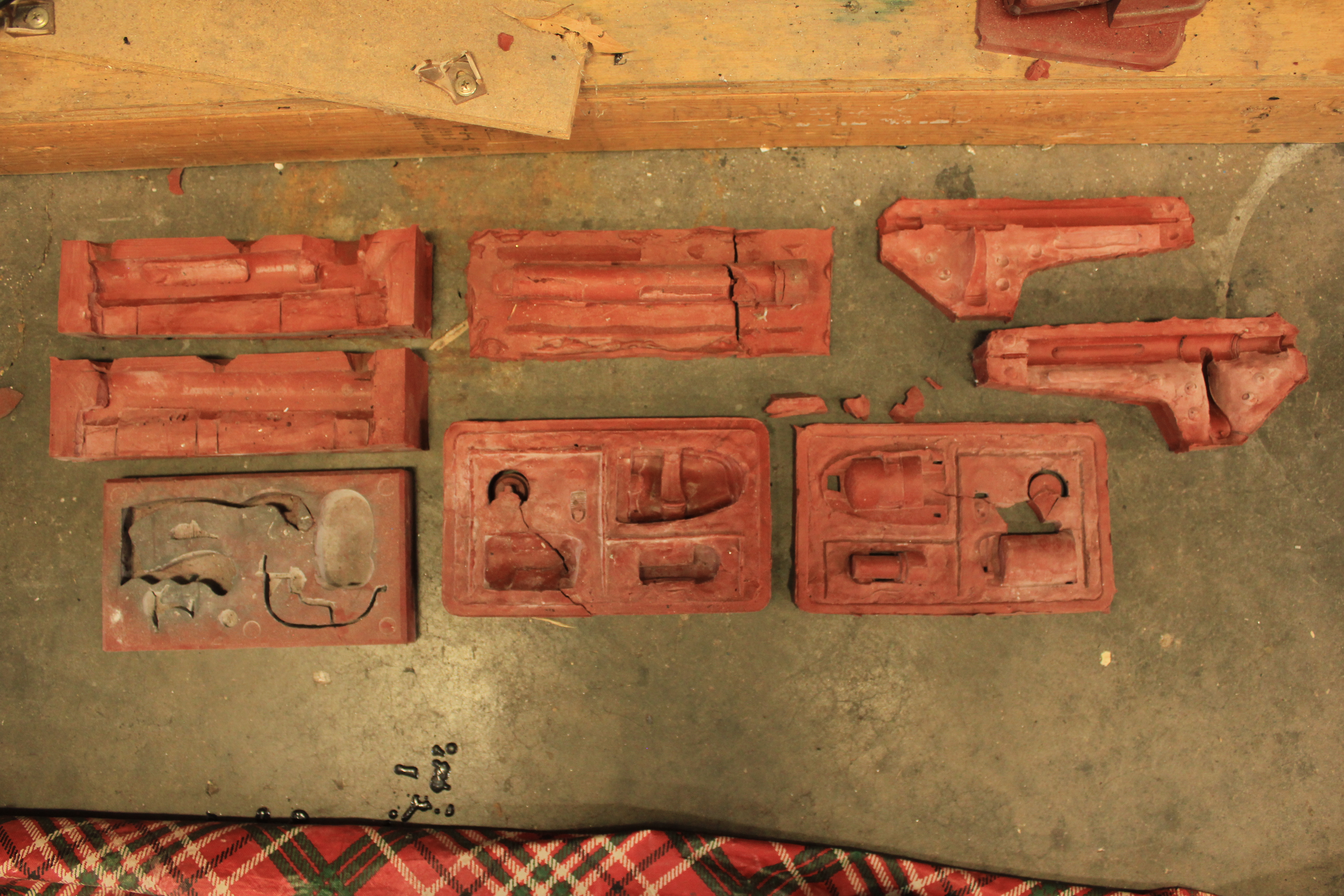

A little bit more time passes as I have to rework my existing pieces again because I'm insane. Then, from Tomen, the water gun PKD comes out and mod kits are soon offered for that. I snatch one kit up from Soulinertia and start salvaging, retro-fitting, assimilating what I need from his parts into mine. I cobble them together and finally I can get around to casting these up in pewter.
The pewter molds:
It takes a lot of effort for me to get good pewter casts (I don't know how Sidkit does it) but I managed to do it. The pewter didn't pick up the details in the mold as well as I would've like, particularly the stamped letters, but overall, I am happy. They're just fairly ugly and needed some elbow grease. But, yes, overall: I am happy...

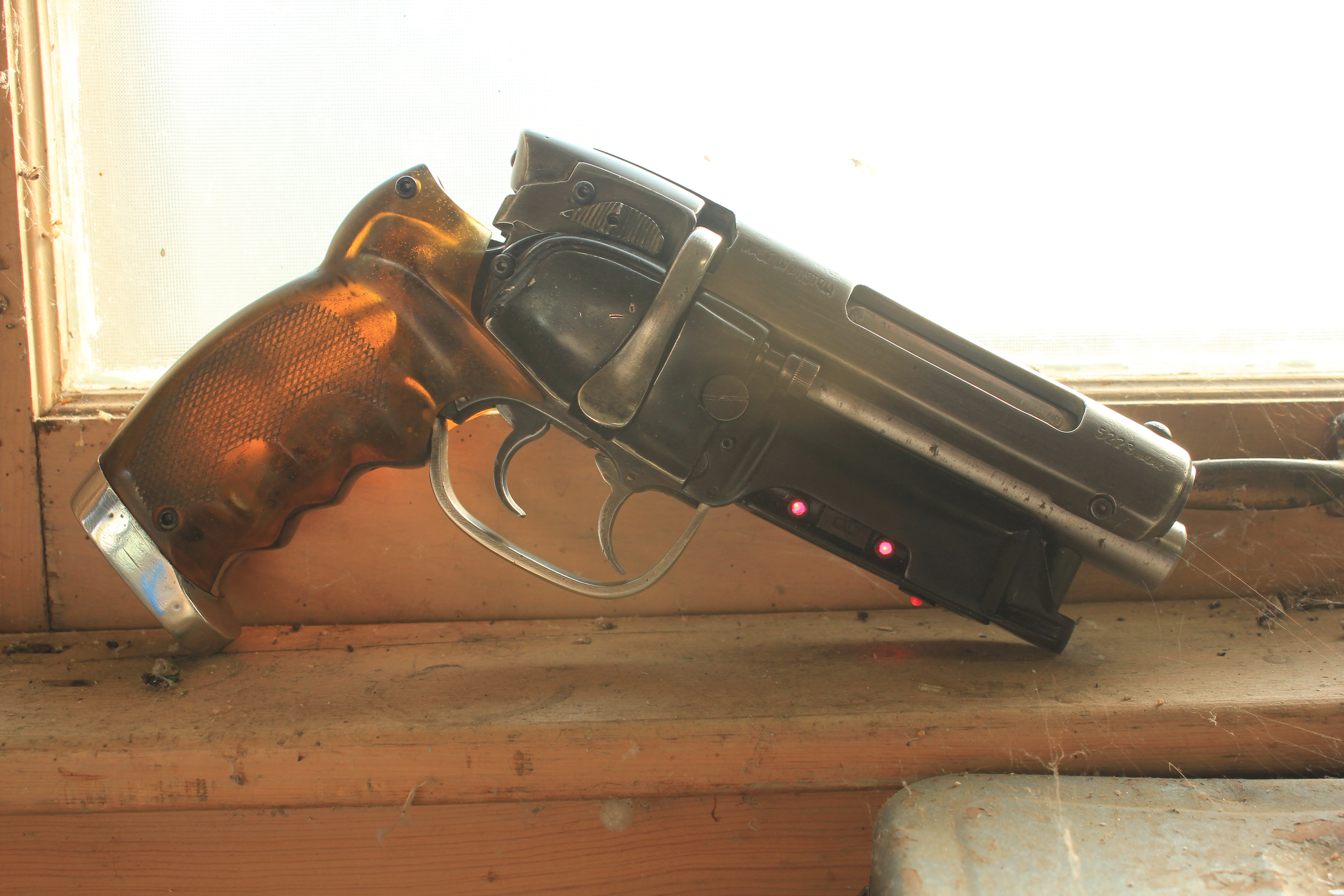

Cut to now, after messing around with some pewter black...

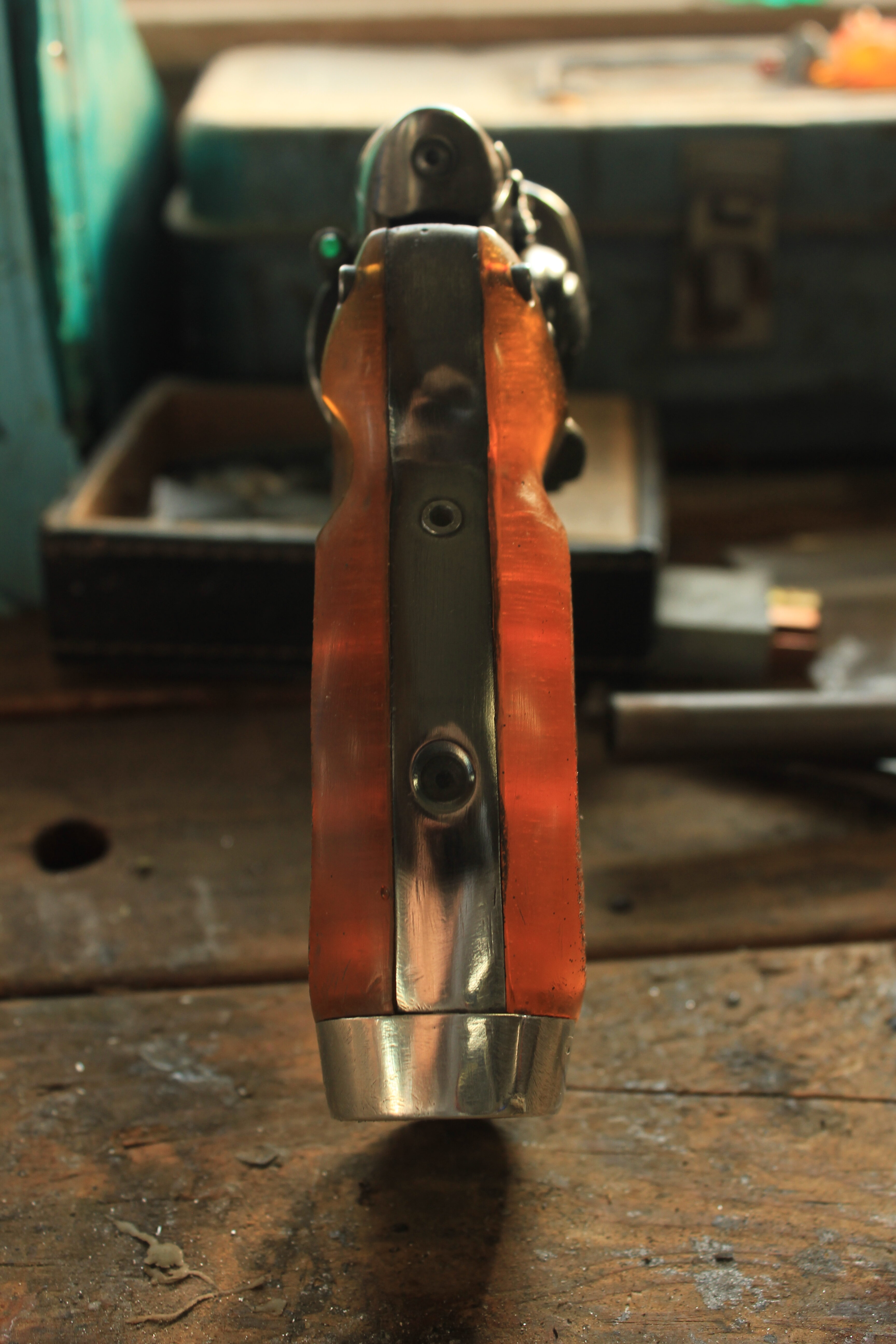

Modified parts: Cylinder covers, upper receiver, receiver cap and switch, grip frame, butt plate, bolt assembly, front trigger, and trigger guard--- All cast pewter.
Scratch-Made parts: Front barrel post, sight rod, cylinder release/safety switch--- Machined aluminium. Magazine and grips--- Resin.
Kit parts: Magazine well--- Resin.
Real-world vintage: Binding post and gun screws in the top of the upper receiver.

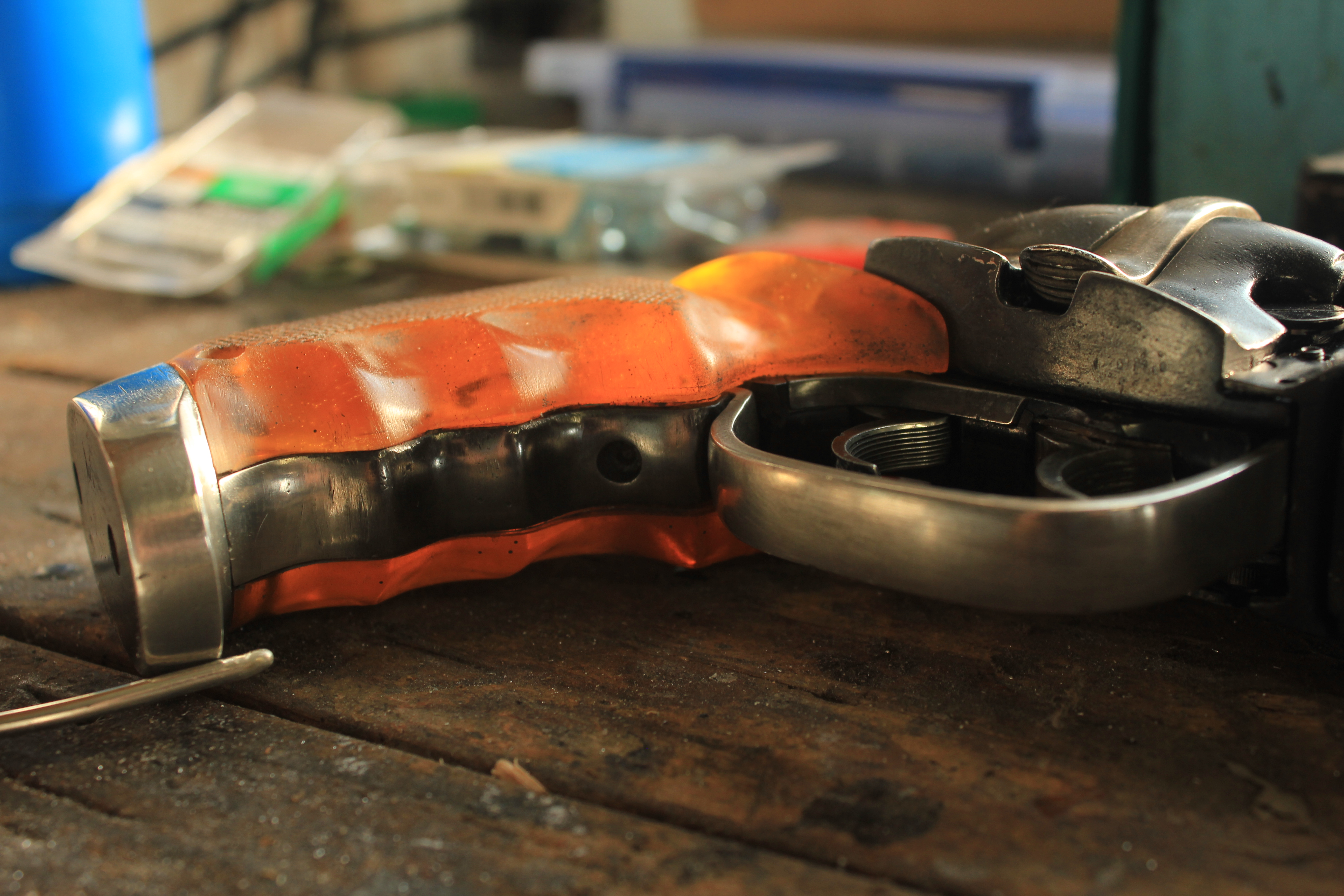

All this work and it's still not accurate. Then again, it was never going to be---probably never meant to be---but it is mine. Knowing it won't ever be fully accurate opened it up for me to add my own touches, my own flourishes, my own textures. For instance, my filthy cast grips. They were originally a set of test grips for matching the color of the real things, but I fell in love with the textures that the filth brought. This gun is packed with small alterations based on those feelings; its own filth, its own stories. Some of which I wanted to document here.
It might not be right to the real thing, but it is right for me. Despite its short-comings, this prop has become one of my most valued pieces in my collection as it is now a catalog of my personal growth and skill progression over the last decade. Looking at what I have now, compared to what it started as, I am so far removed from where I was, I have a hard time reconciling the fact I made this at all. I want to make a stand for it next, but after that, I honestly don't know what I'm going to do with myself then.

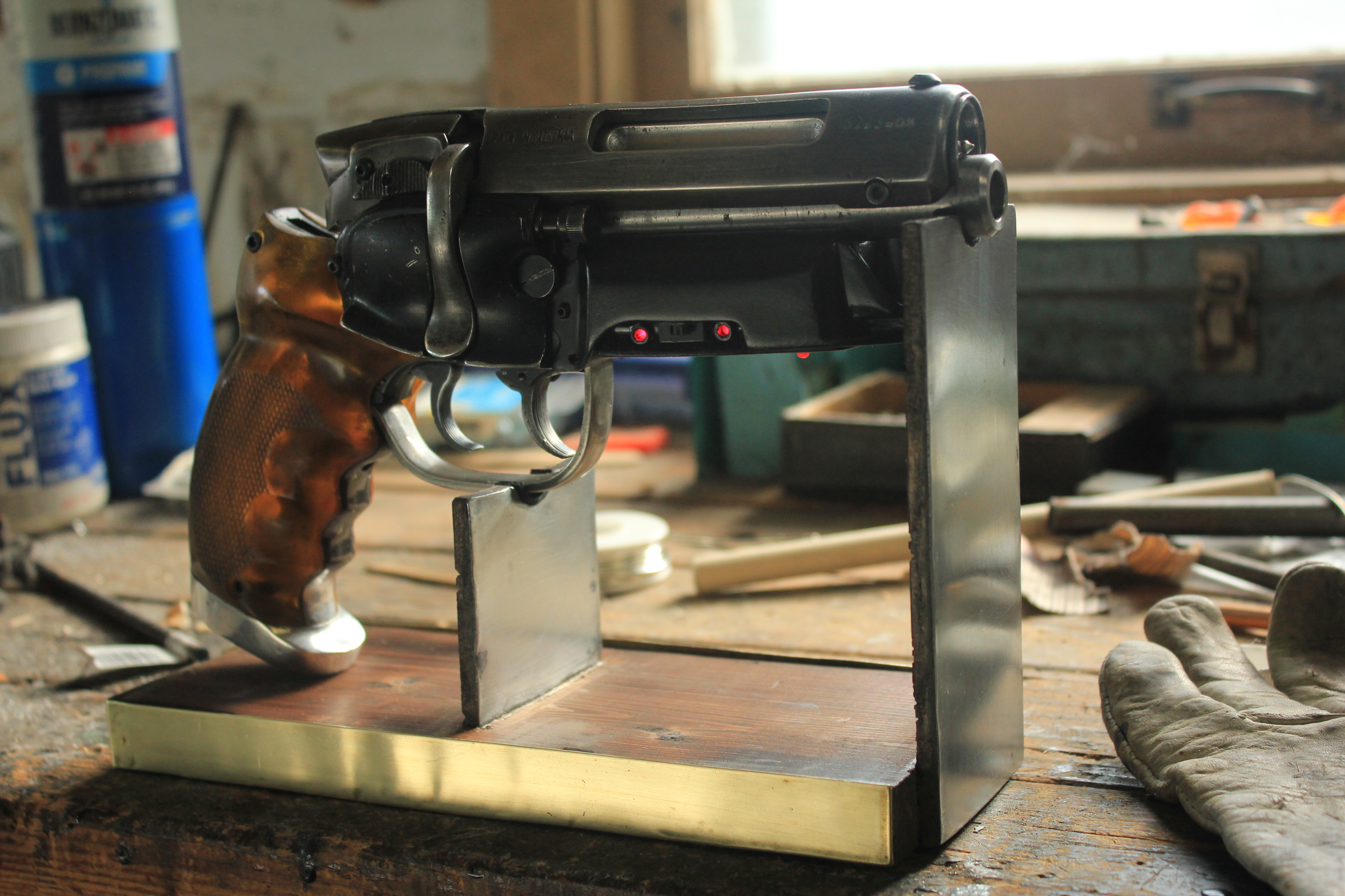

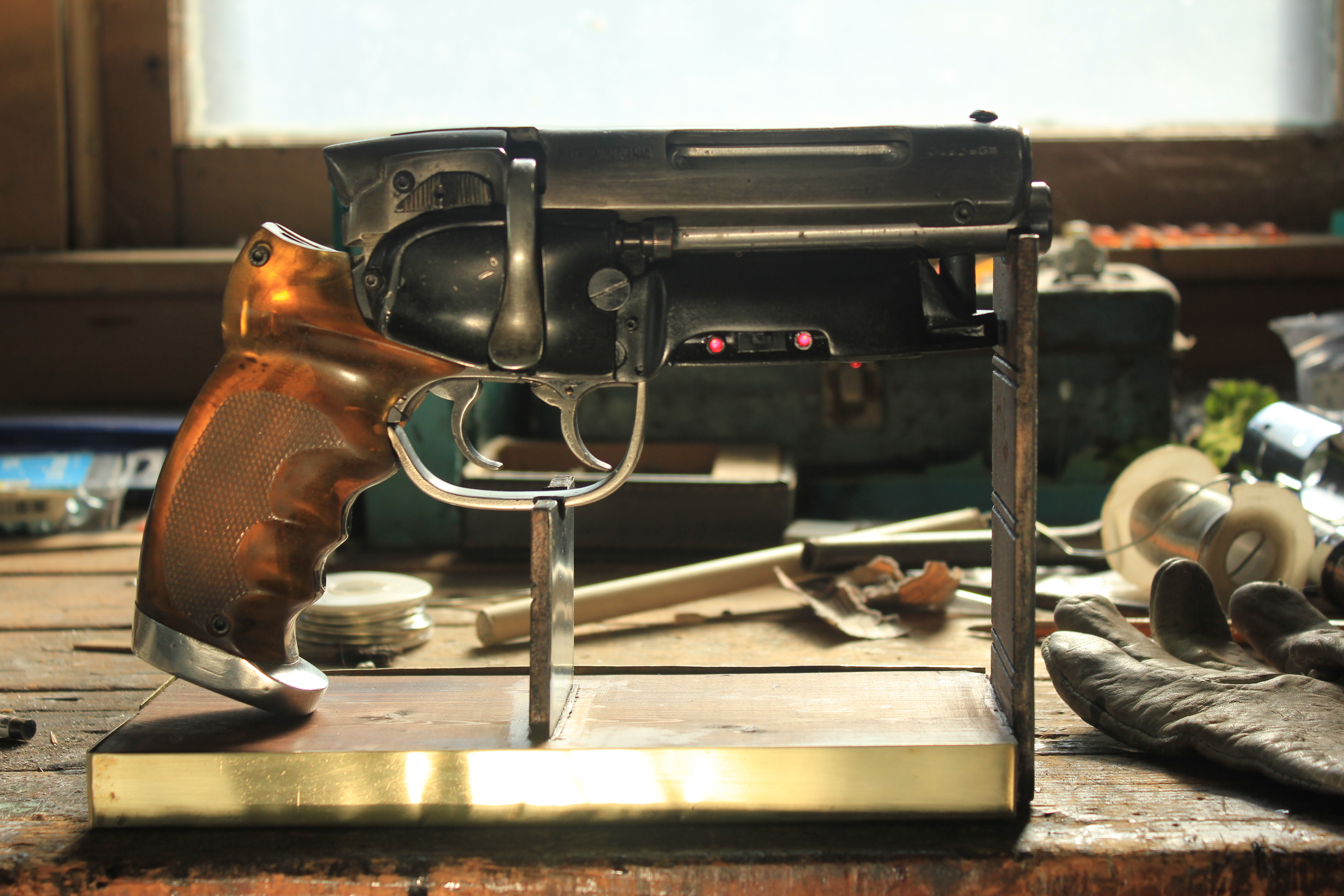

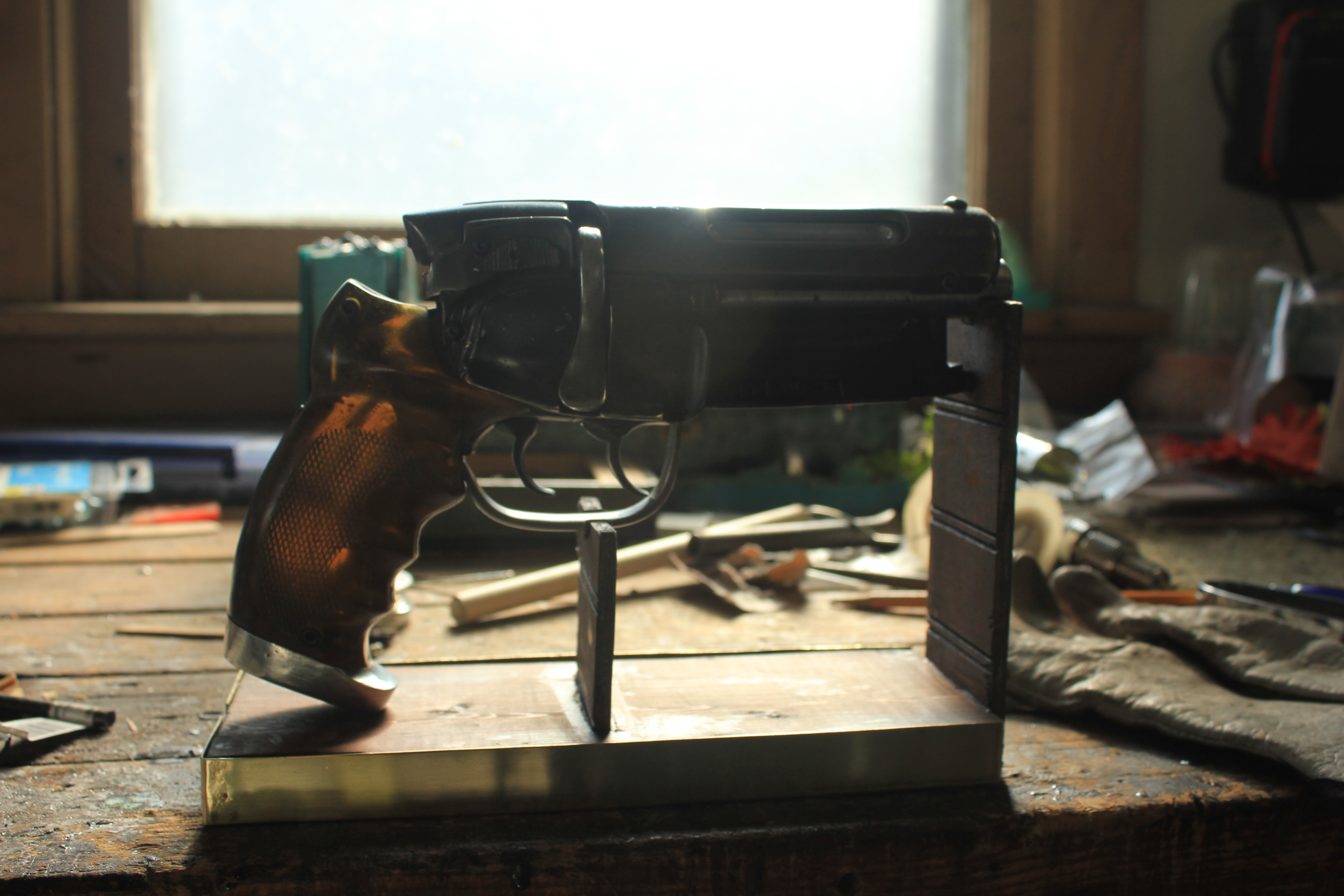

And here is the stand:
Super simple construction with just stuff I have laying around. Stained pine board with burnished aluminium and brass accents with strips of leather in the cradles to help cushion and prevent further scratching the parts. There's just something very "future-y" about metal on wood for me--- I don't know what it is about it.
