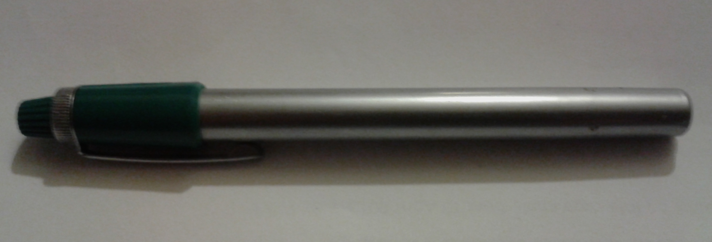

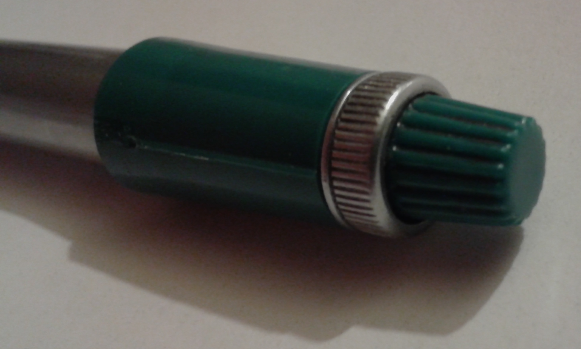

No, it is the same Ever Ready model used by Troughton. After reading this forum and finding out what model he used I did a lot of digging around the internet to try and find one. I'm not surprised nobody here seems to have managed to find one, as far as I can tell this one might have been the only one for sale on the entire internet. Found it on ebid, bought it for £2. I haven't put a battery in yet so I don't know if it works, but I will soon post more photos from different angles and measurements and stuff in case it helps any of you lot who are making your own.

Measurements would be great! Do you own a set of digital calipers?

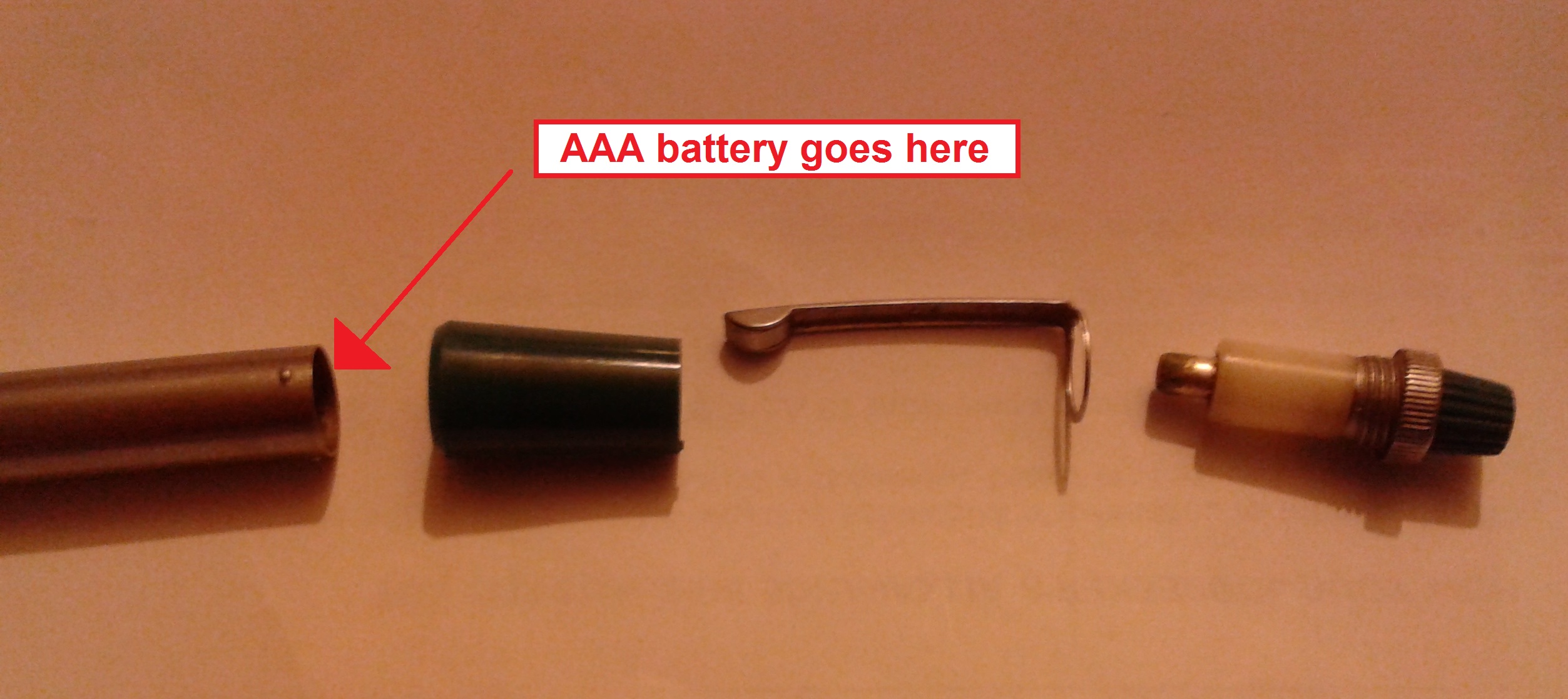

Takes 2 U16 or HP16 batteries (AAA)
Bulb is lens and type.
Cat. No. 2225 2.2v. .25 amp.
Length from tip of the button to the tip of the bulb is 144mm
Diameter of bulb is 4mm, and bulb sticks out of the tip at a length of 1mm
Diameter of the body of the penlight is 11mm at the bulb end, and 12mm at the other end
The blue bit (don't know the correct name of it) has a diameter of 14mm on the wide end and 12.5mm on the thin end and is 25mm in length
Clip is 38.5mm in length and 4mm in width (has EVER READY engraved on it)
Silver bit below the button is 4mm in length and 12.5mm in diameter
Button is 8.5mm in length, 7.5mm in diameter at tip and 9mm in diameter at base

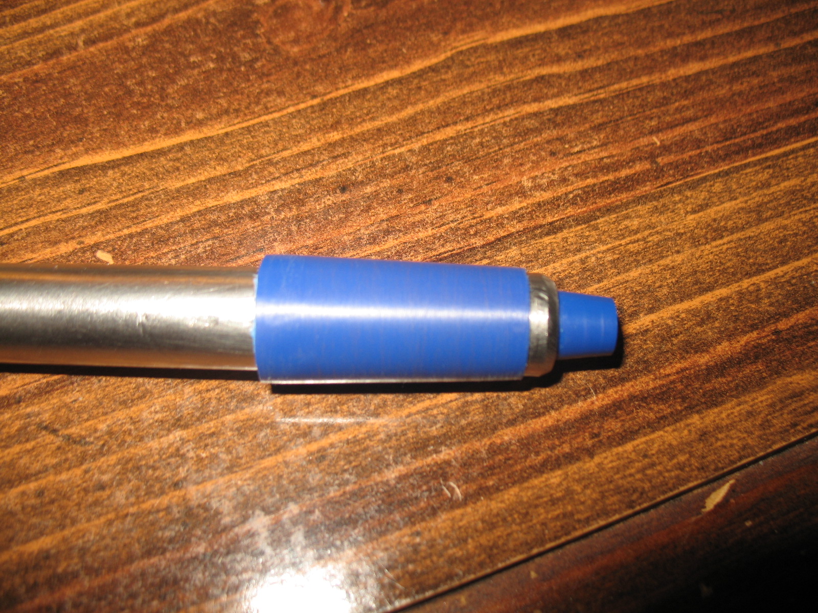

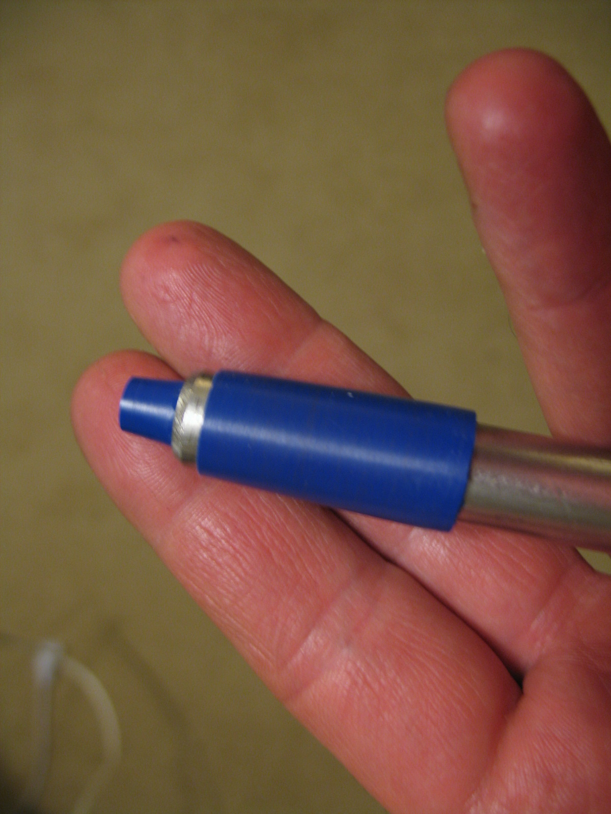

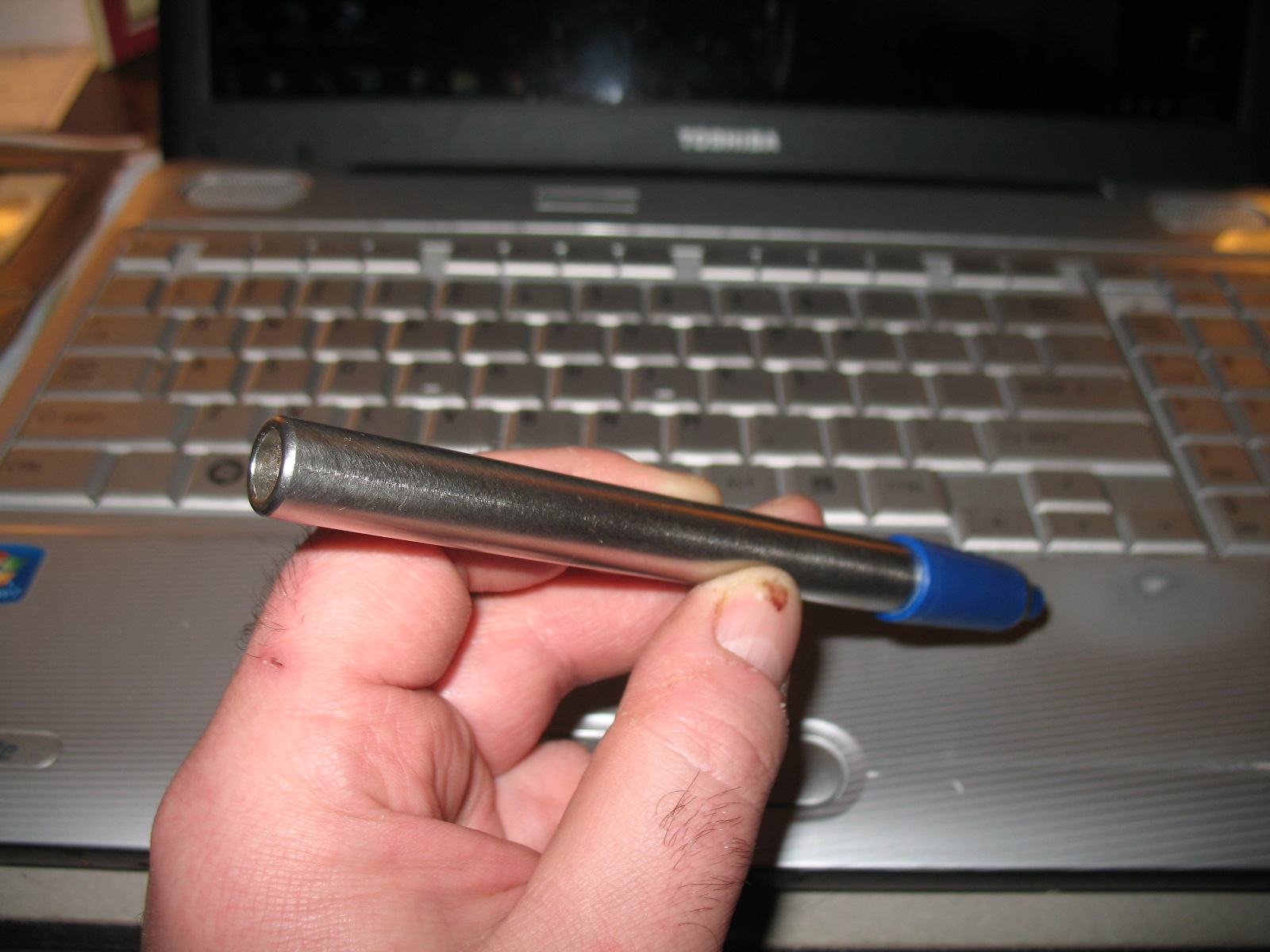

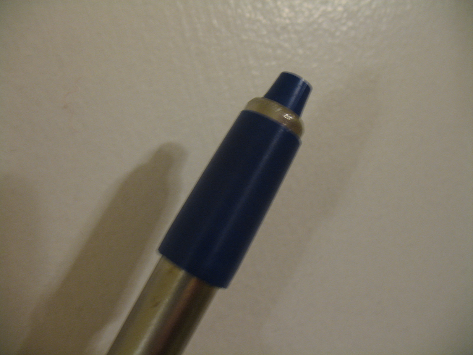

Earlier this week, I took quick measurements off the battery in the pic, and threw together a facsimile with some available materials at work. Namely, 12mm SS tubing, and some random blue Delrin. It's actually much more purple-ish than in these pics (EDIT- I managed to get a couple more accurate pics without the flash). Mine is 12mm in dia on the body, with 14-15mm at the front of the blue section. About 152mm long altogether. Not bad for a human.;)
I just need to find a good bulb to epoxy into the front. Kinda stuck with what I found.
As long as it looks good next to my CO Sonic collection, I'm happy!:lol Maybe someday I'll get lucky and find a penlite. I did a google search and STILL somehow missed that one on ebids!:lol
Not that anyone wants to see my pics after THOSE, but........

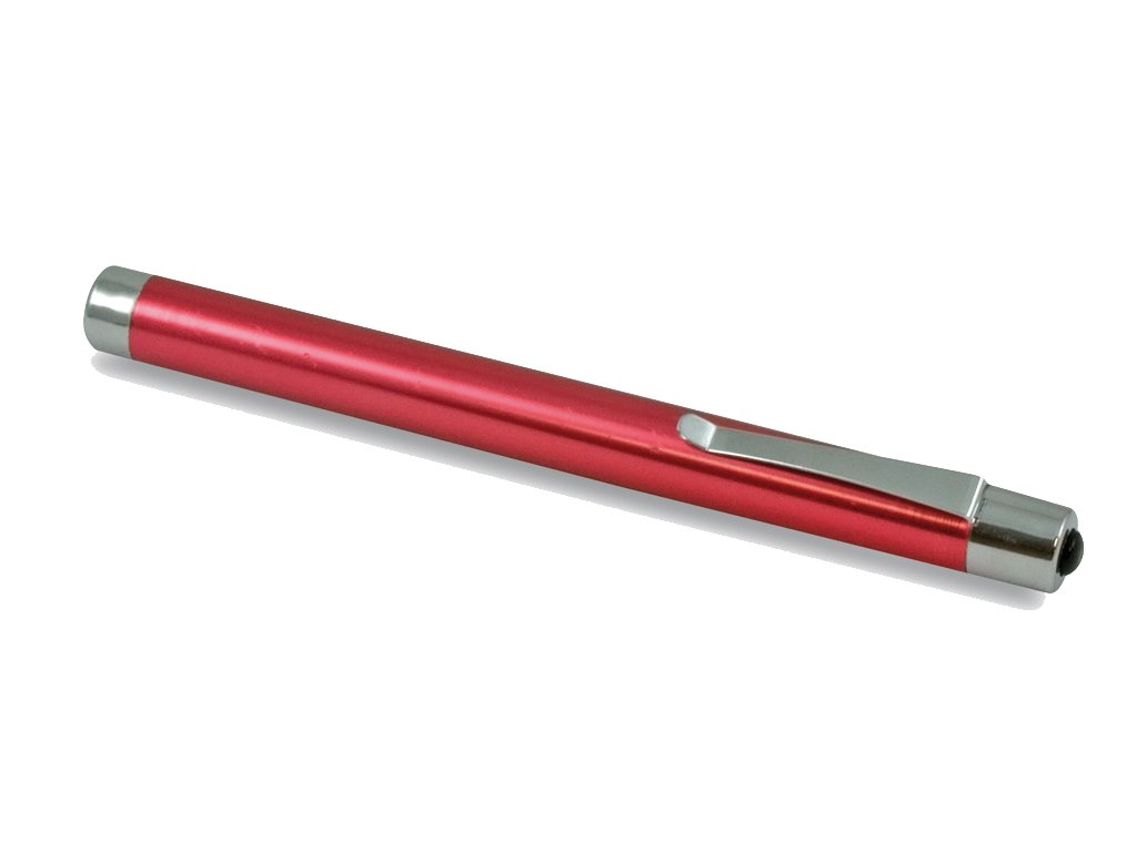

If I could use tools properly and would have experience with this stuff I would absolutely make one, but without those I'm now frustrated because I can't find a somewhat accurate looking pen light (with cheap international shipping).
My best bet is this one I think, my only problem is that I don't know if I could remove the red paint (it's aluminum) and how could I do it ? (as I said, I have basically no experience).
http://ecx.images-amazon.com/images/I/41Yoef5bgZL._SL1024_.jpg
I also tought about cutting this one's rounded tip, but I don't know if i could do something about the bulb so it wouldn't stick out (I think removing the red paint from the previous one would be much simpler)

Do you have a lathe? If so, why don't you do it on the lathe or ask someone here to do it? The penlight is a very easy object to make on the lathe. Then kill a pen (springs) and print a nice cab online (or cannibalize another pen). You should manage 20 dollar if you can drill out of a aluminium tube (or someone does it for you cheaply).

I will stick with the second option (but thanks for the advices) because currently I don't want to spend too much on a penlight (yeah, $20 for a penlight now would be a bit much). My frustration with the penlights on the internet is that they are almost good except for some minor details (like the rounded tip).
But a rounded tip is very very very easy to fix ;)

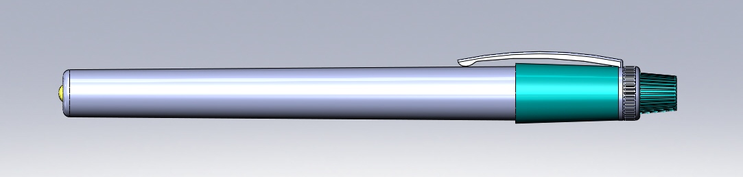

I can't thank BreadleyBear enough. It is very generous to take and share these dimensions. Now time to model it in SolidWorks. If I get it looking alright, I'll post!!
Don't laugh!!! I modelled this in SolidWorks last night. It's accurate to the numbers given in this thread. I'm pretty happy with it, but the clip is going to need some messing with. The clip has a lot of intersecting curves that are tricky, but it's a start.
At this point it's all one peice for a "stunt" version, but I am considering breaking it into peices. The stunt version could be printed in Stainless Steel at Shapeways. With a little paint it would be passable, but I really wont to break it in peices to put an LED in it (I know it was a conventional bulb, but LEDs are more rugged, last longer, and require less power).
Take a look and let me know wht you think. And a special thanks to BreadleyBear for generously providing the dimensions!!!!

You've done quite a nice job with that model!
I believe Solidworks has a sheet metal function (though I've never used said function)... Would that be appropriate to use for modeling the clip?
