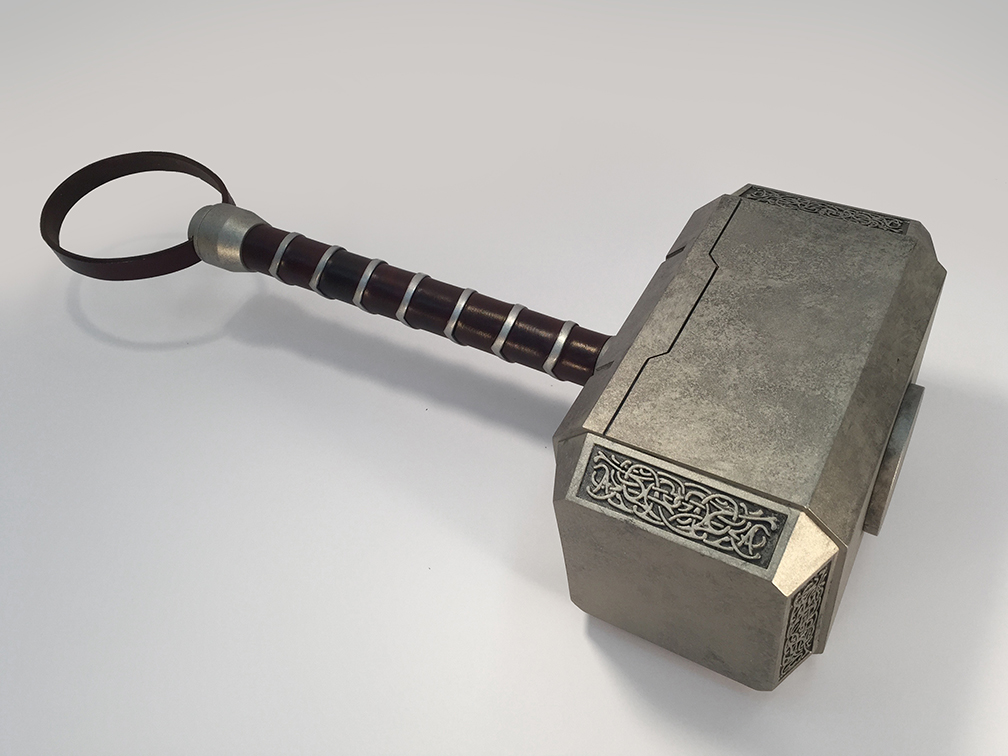

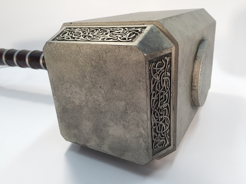

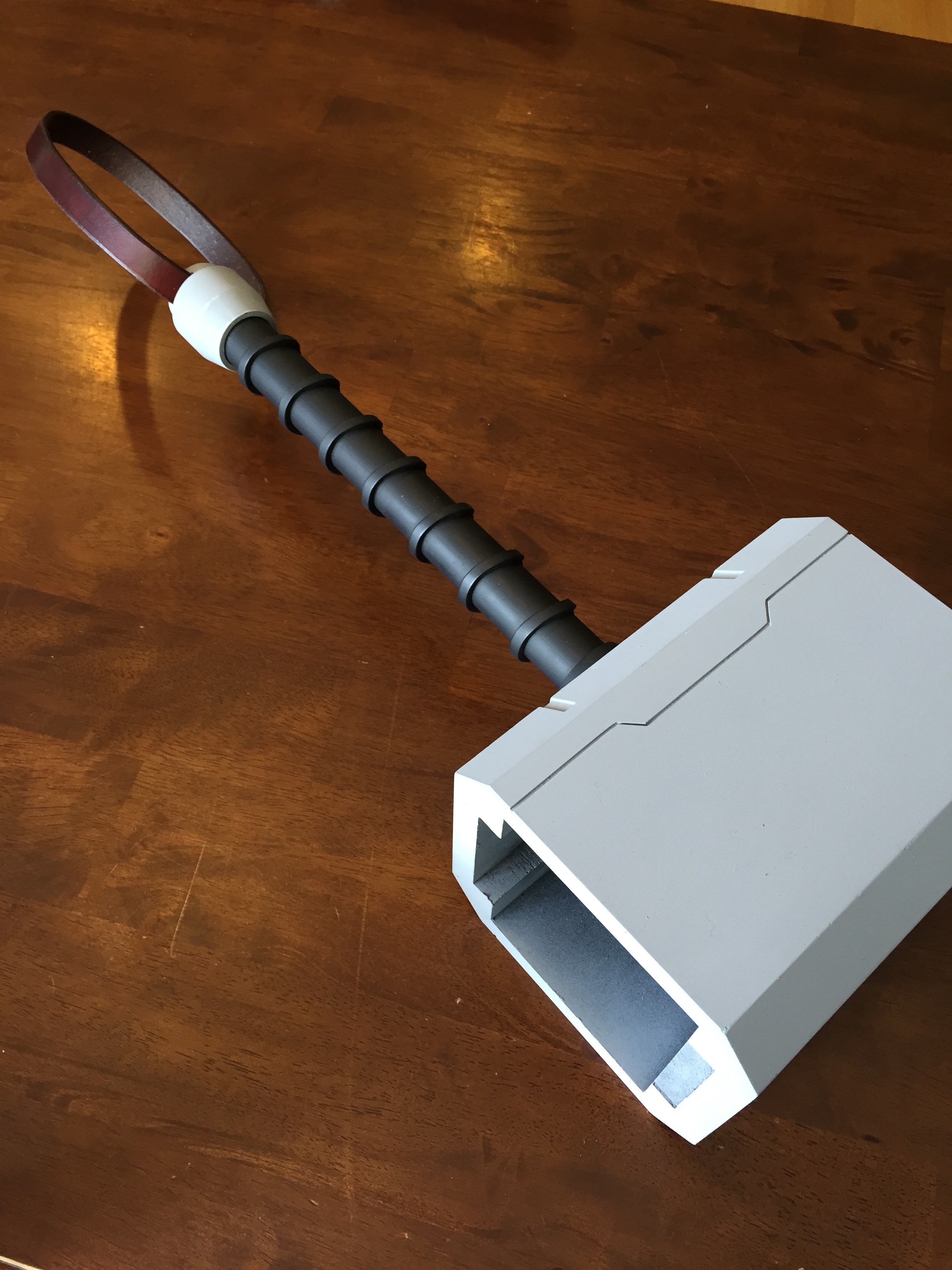

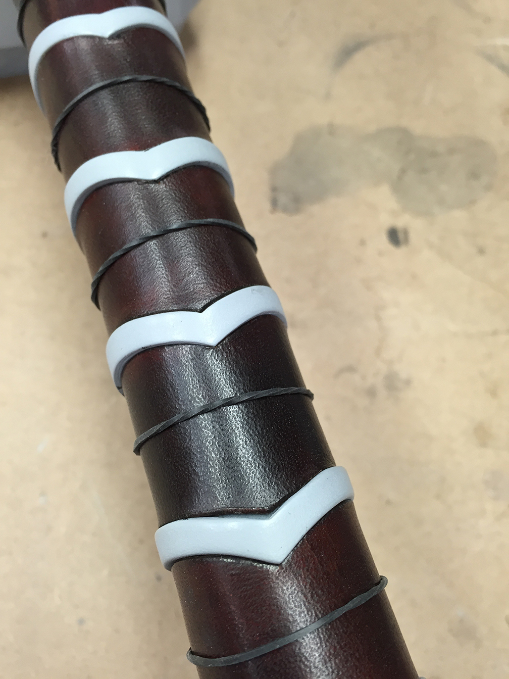

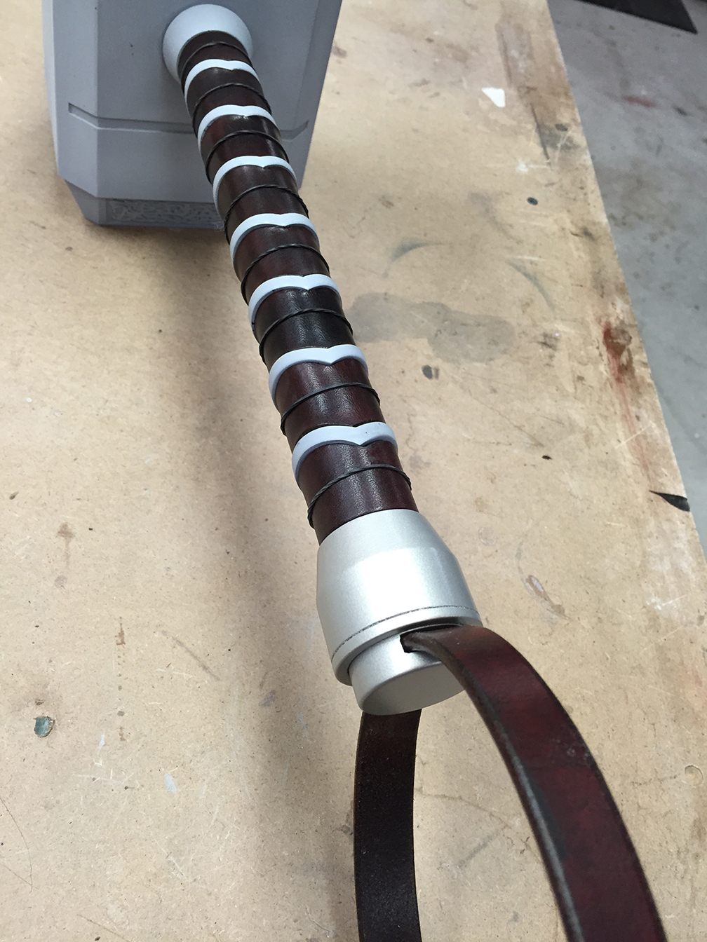

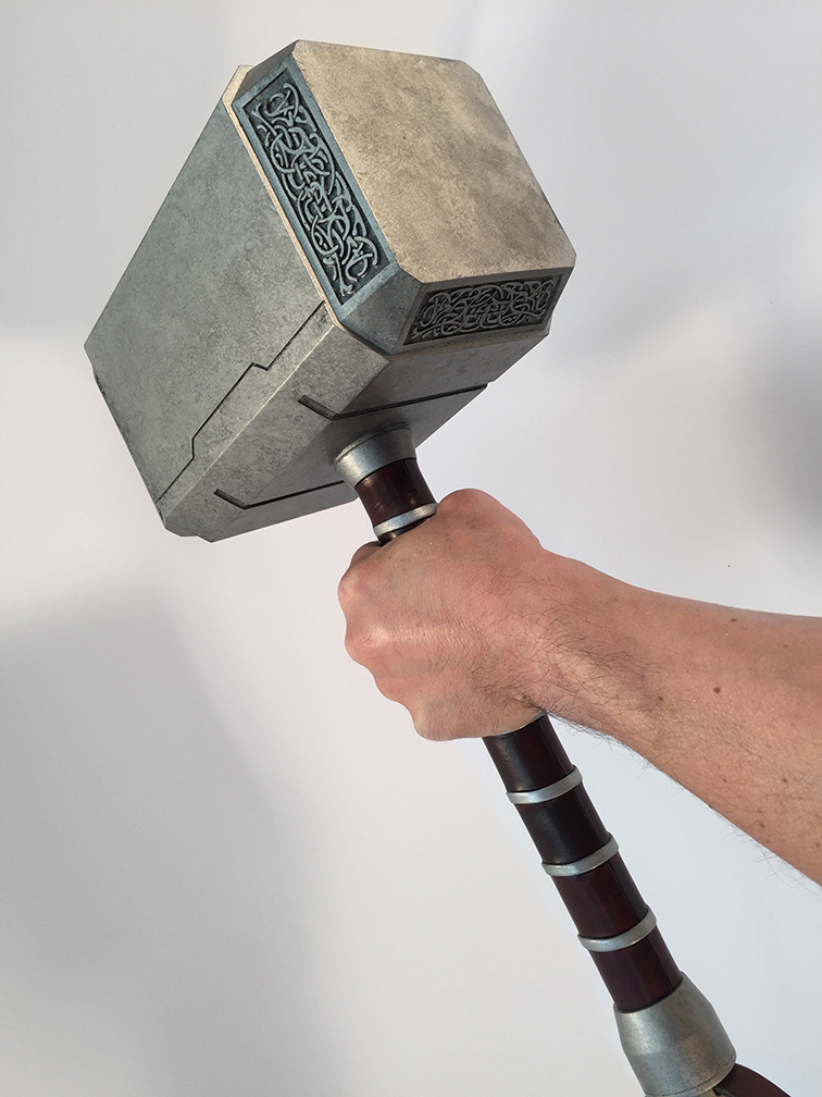

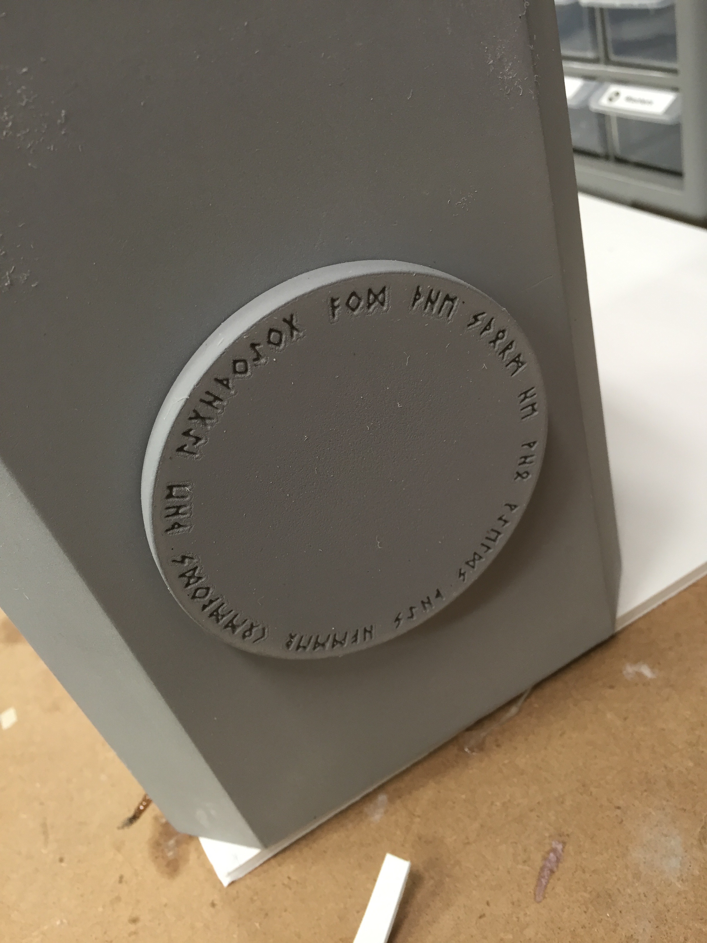

I got bit by the Mjolnir bug. Here's some progress pics so far.

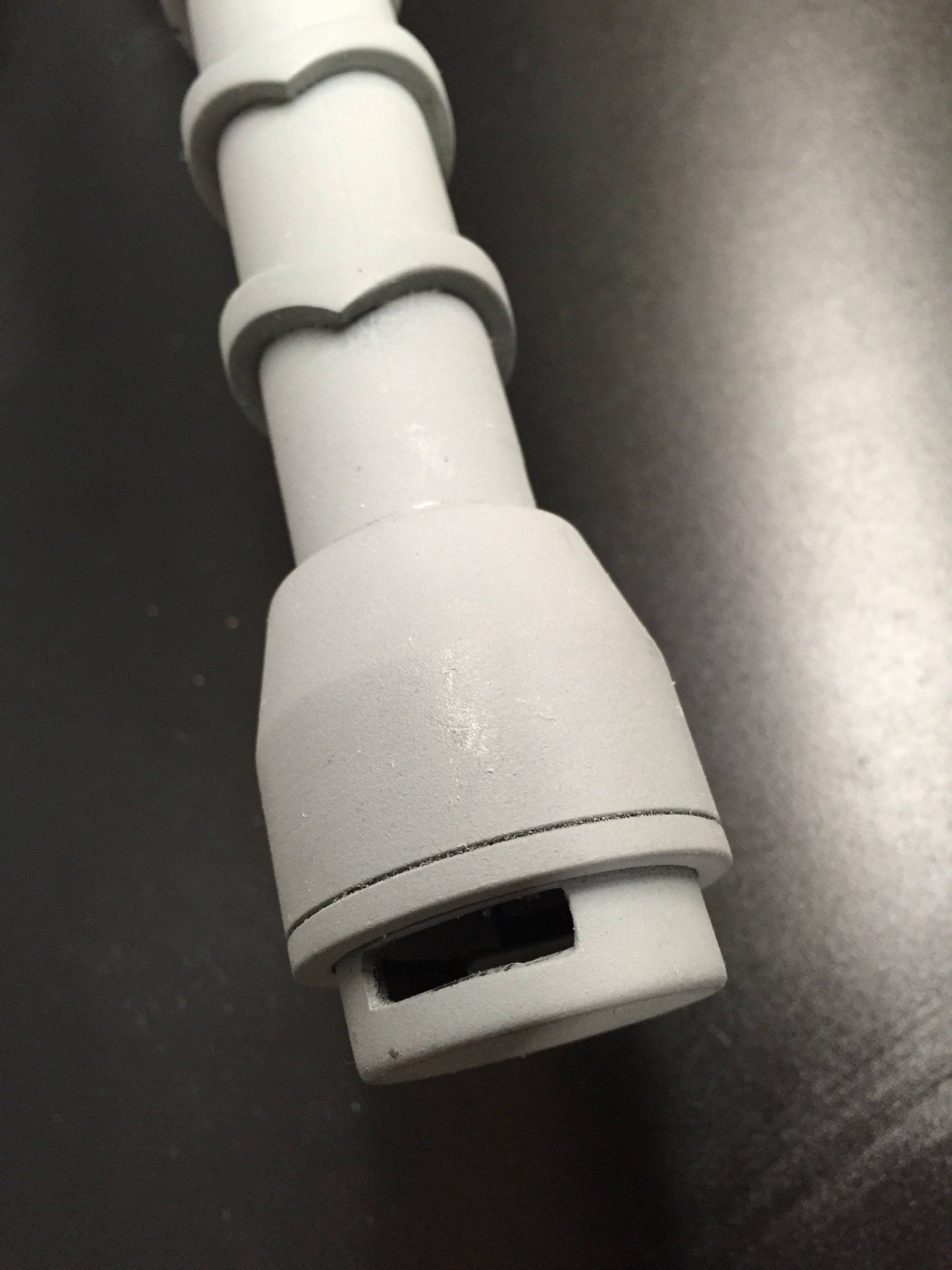

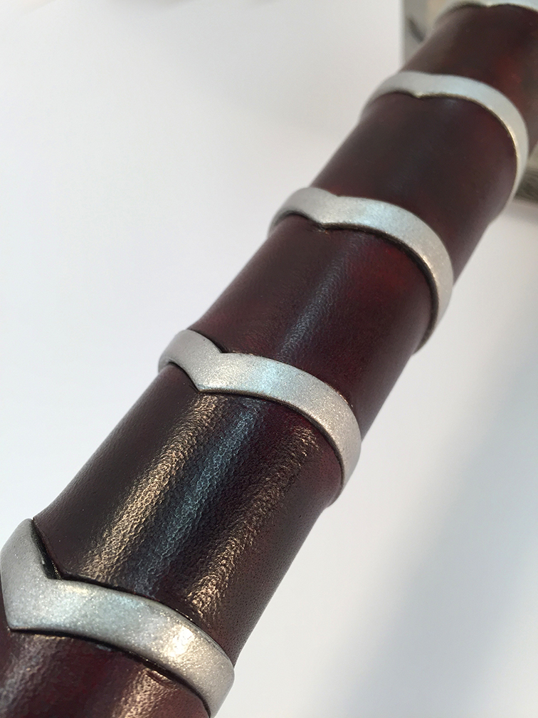

The handle is a PVC pipe. The ribs are cut from a larger diameter PVC pipe and slid onto the handle. The pommel is made from various PVC parts, joined and sanded to shape.

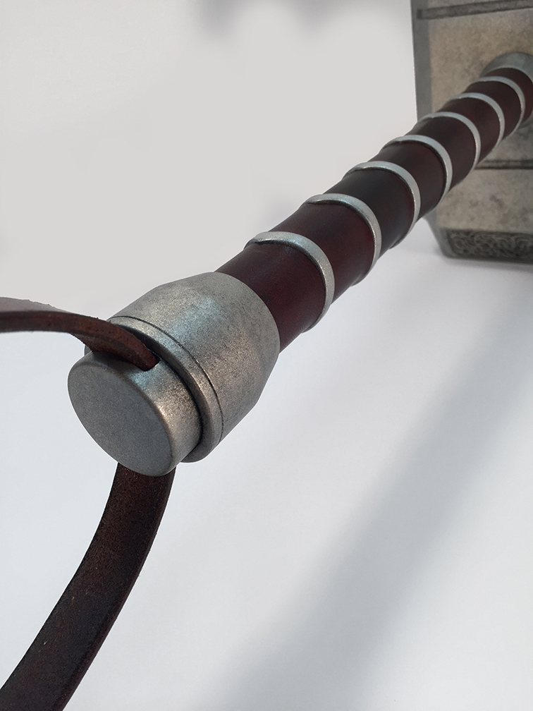

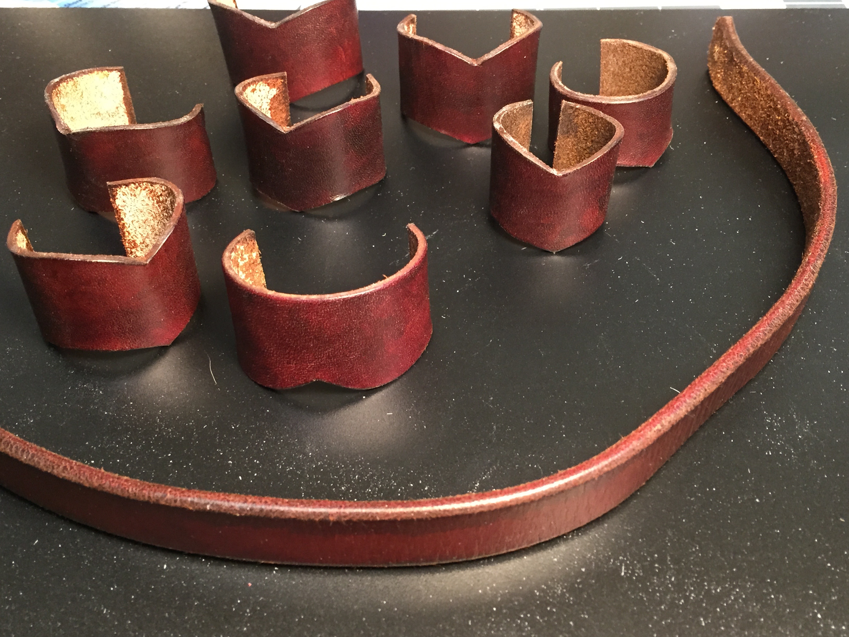

All the leather handle rings were cut and fit for each ring of the handle. Each one is a tiny bit different.

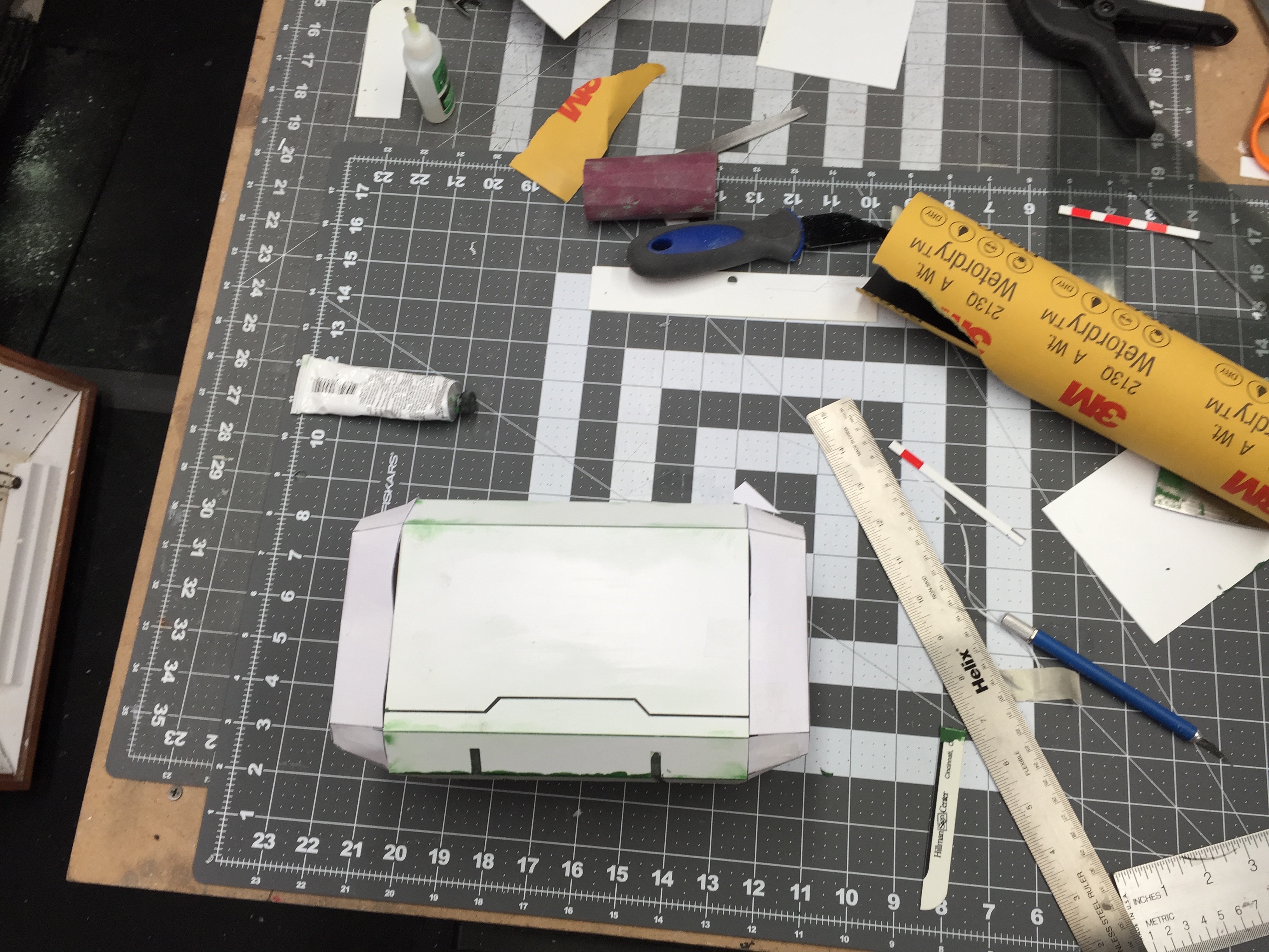

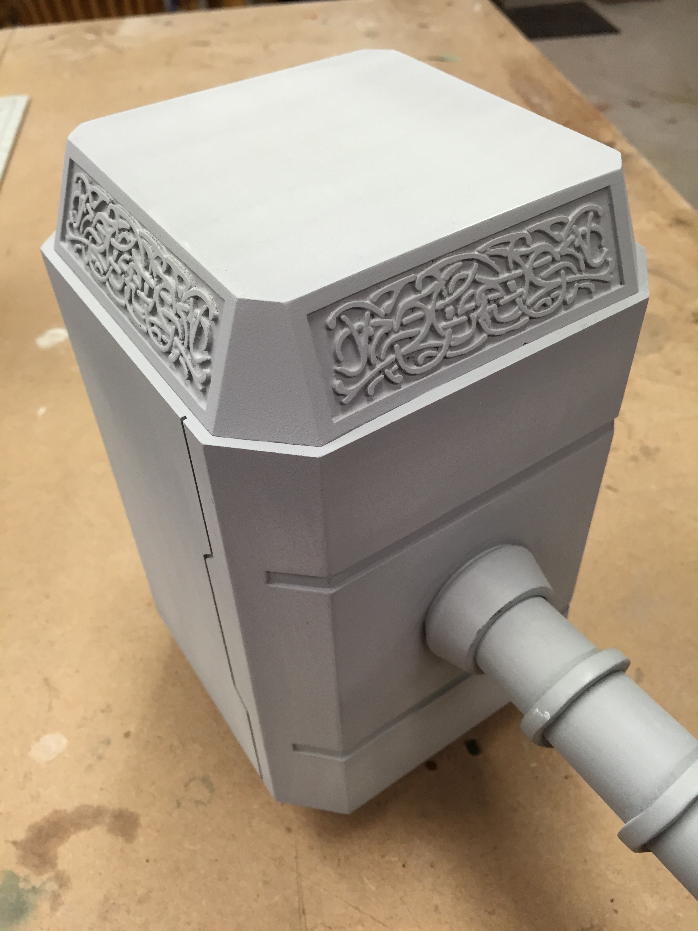

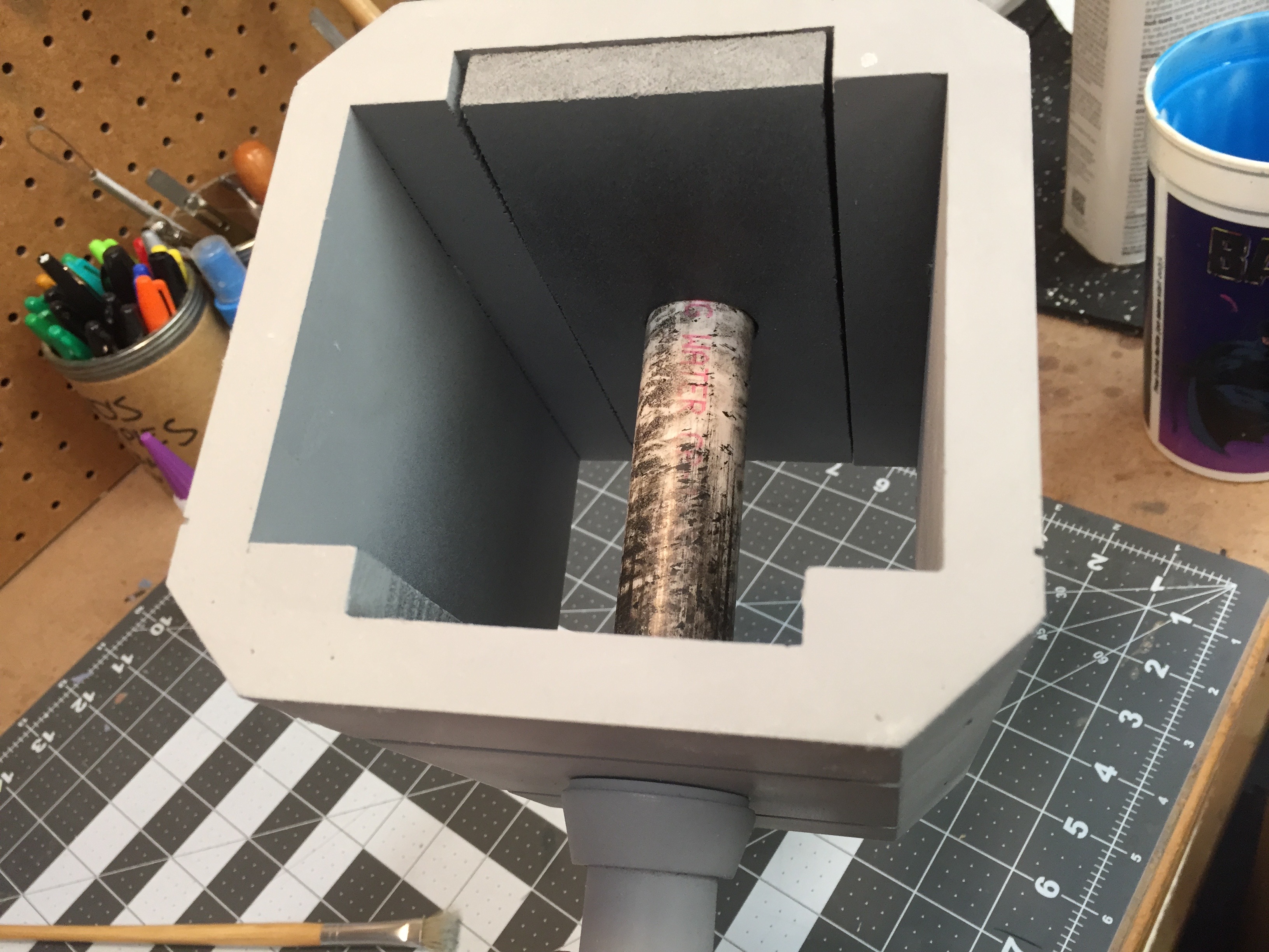

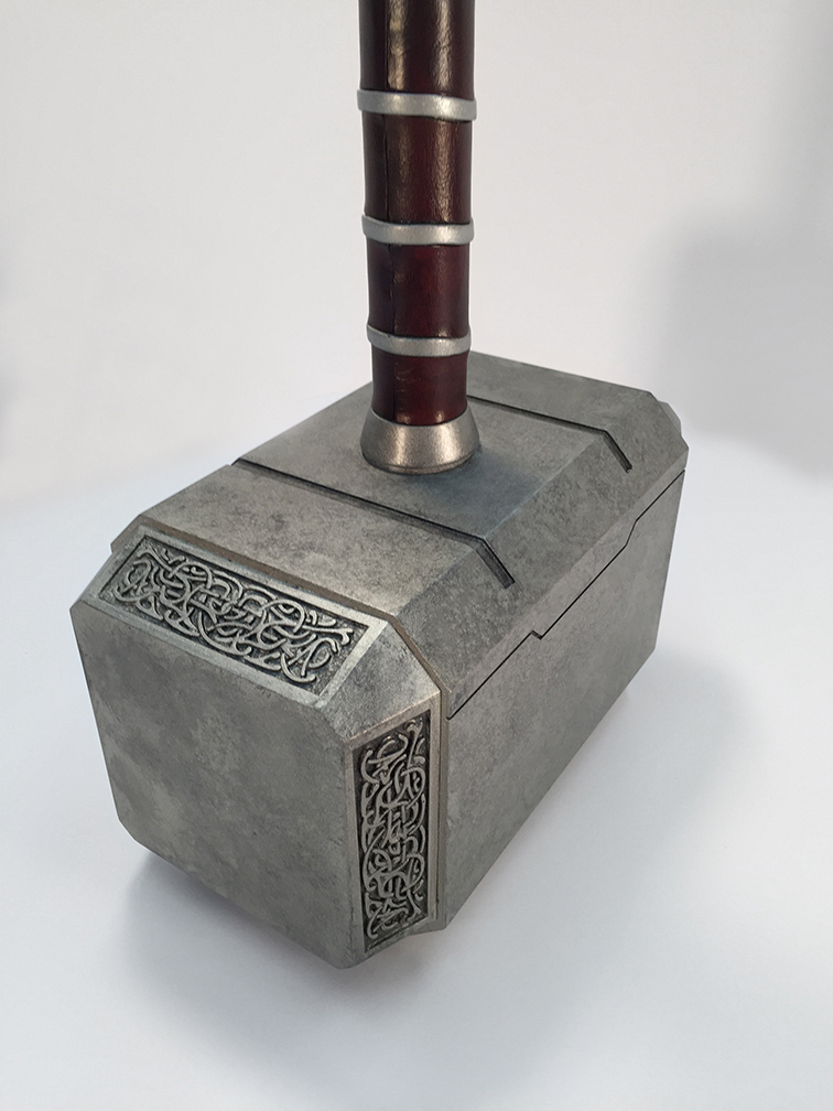

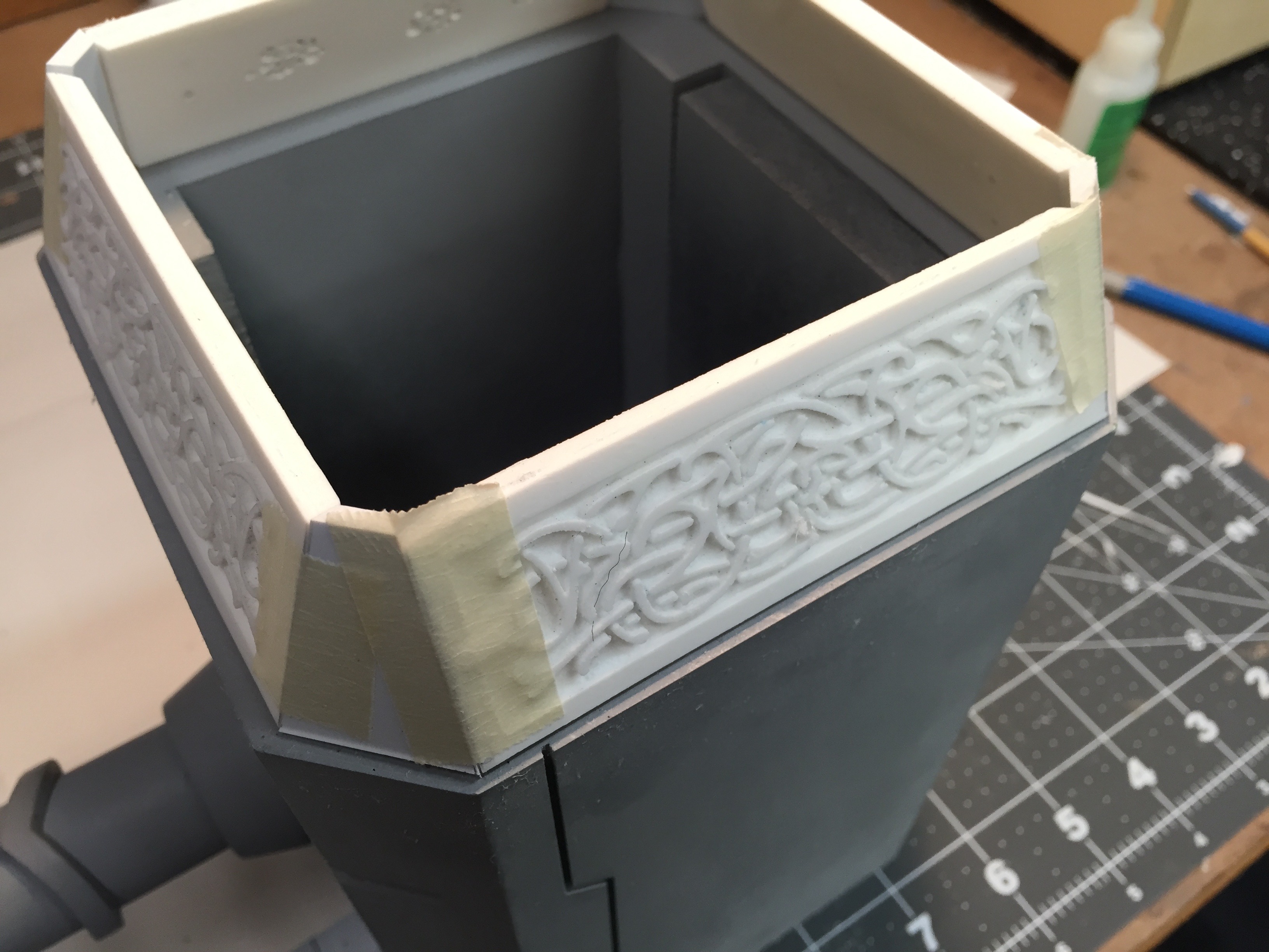

The body of the hammer is built up out of Sintra and styrene. Pretty simple build.

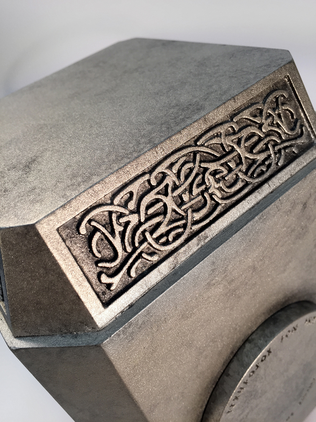

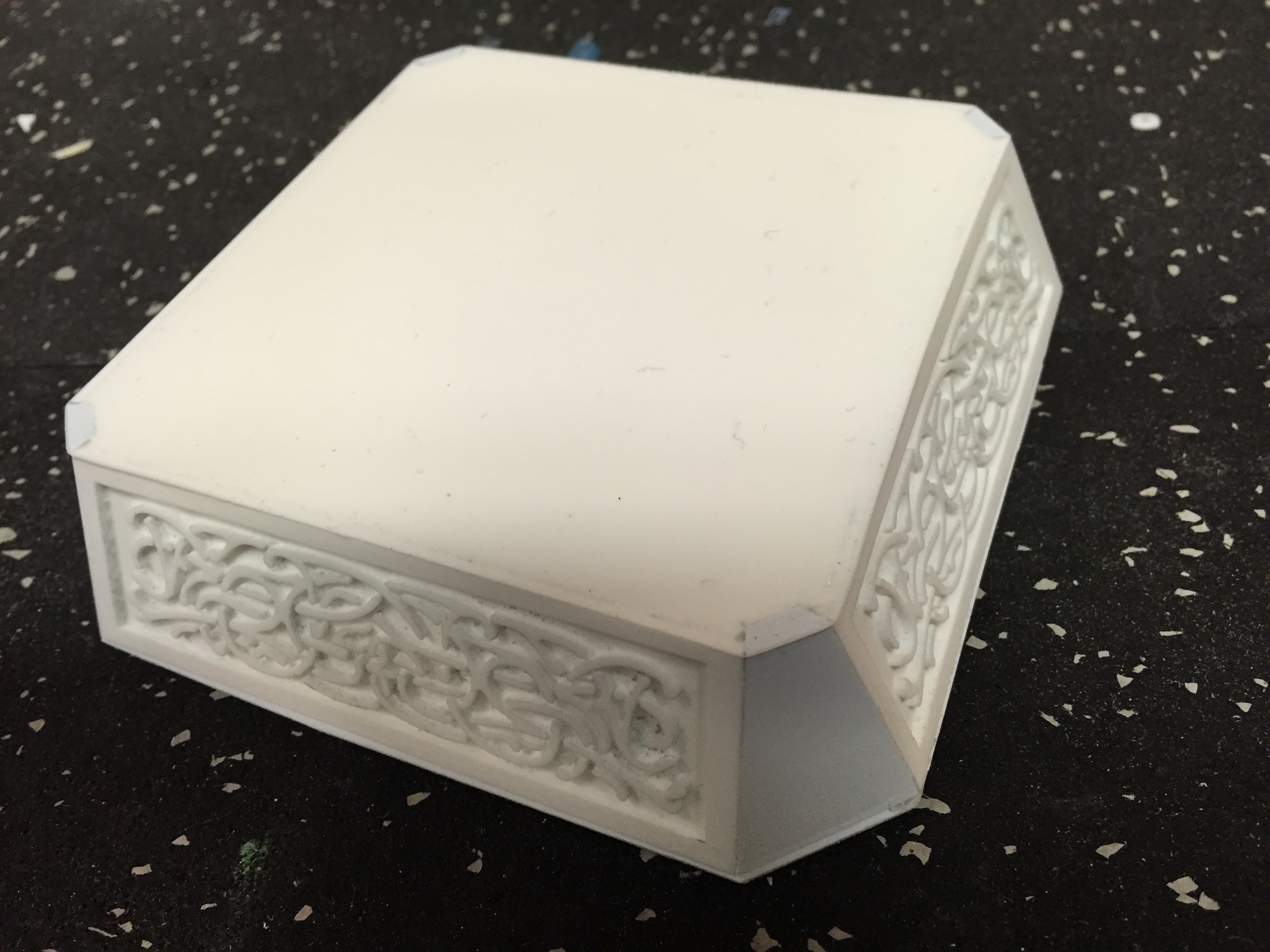

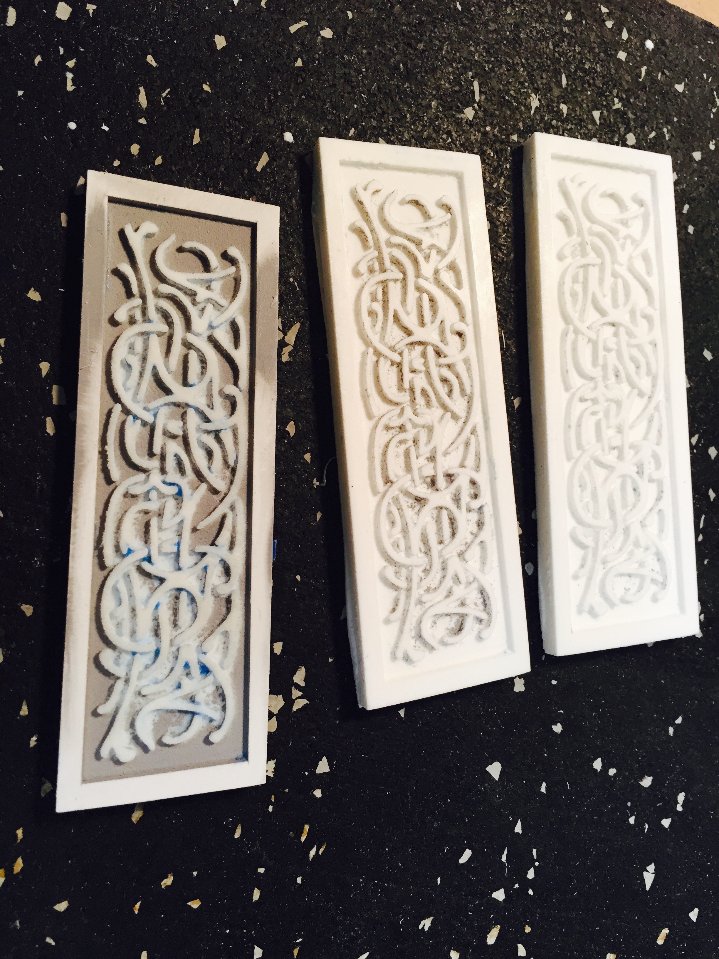

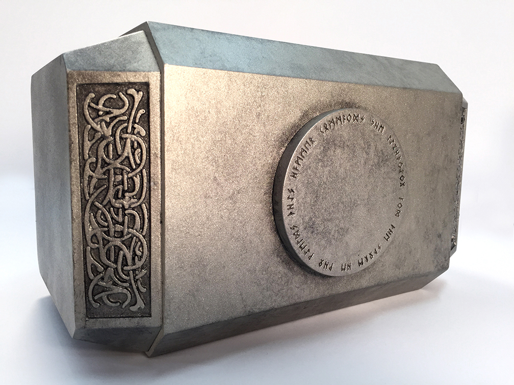

The capstone and the sidepanel with the scroll work were designed in Adobe Illustrator, uploaded to Tinkercad and extruded, then uploaded to Shapeways for printing.

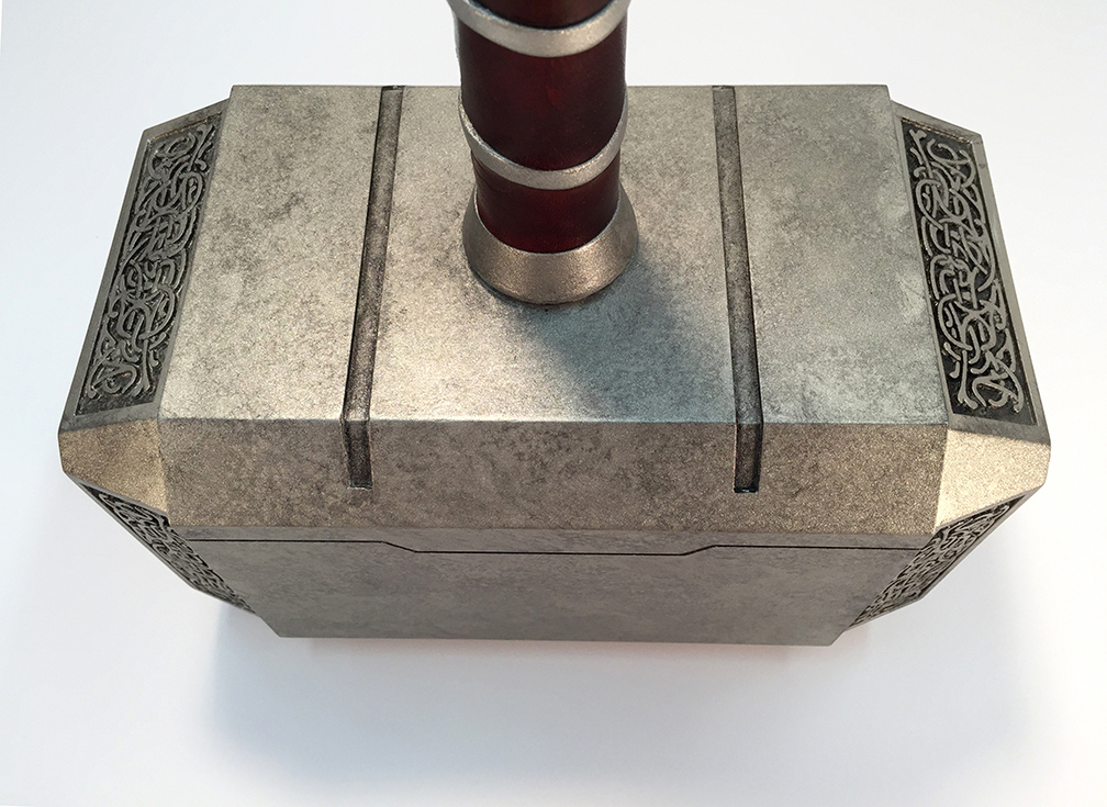

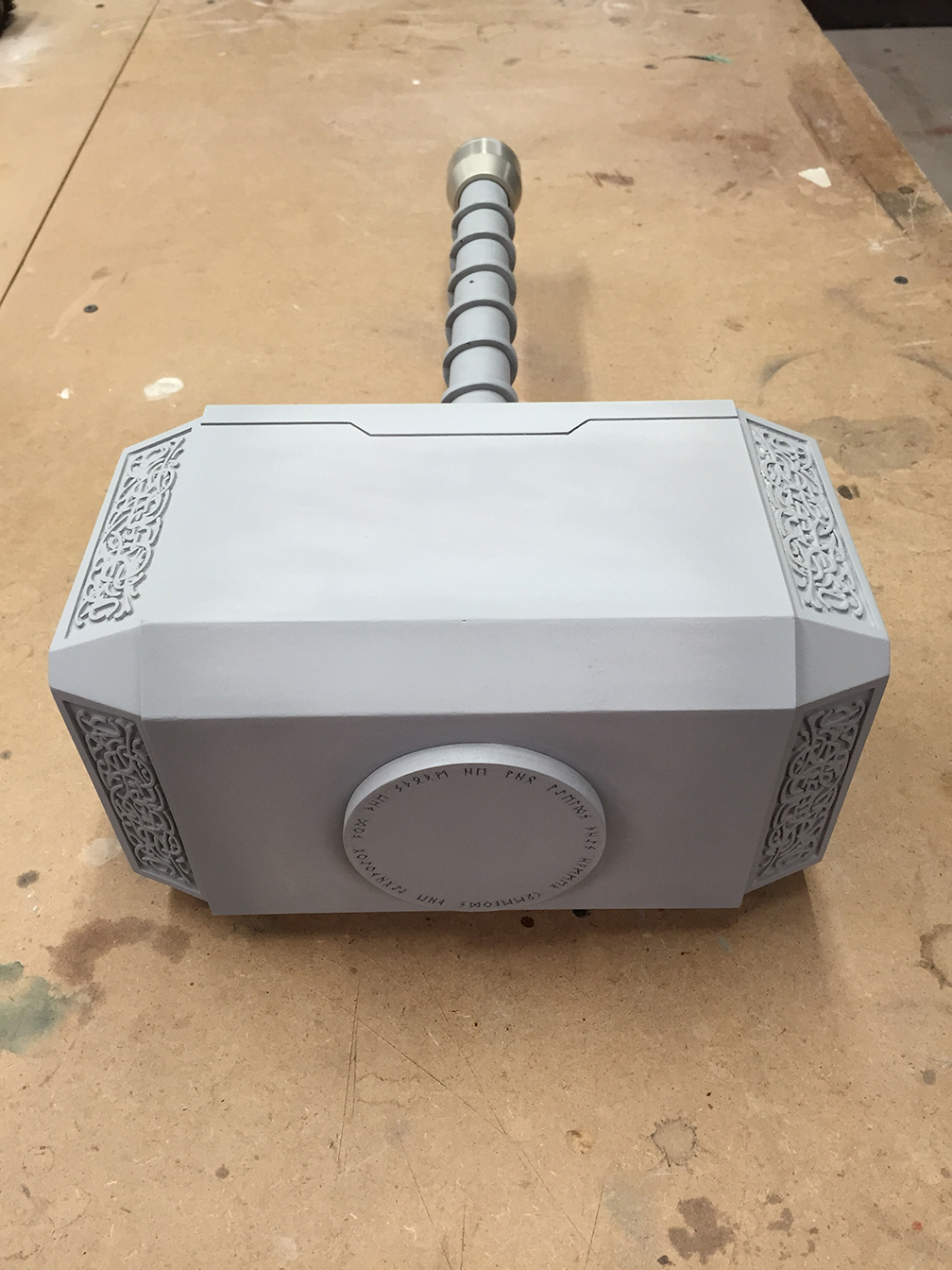

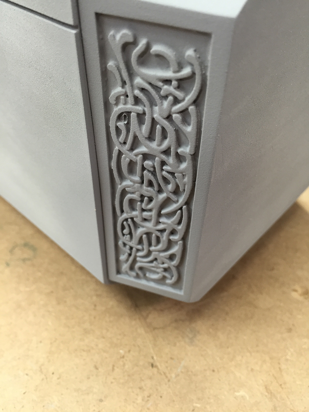

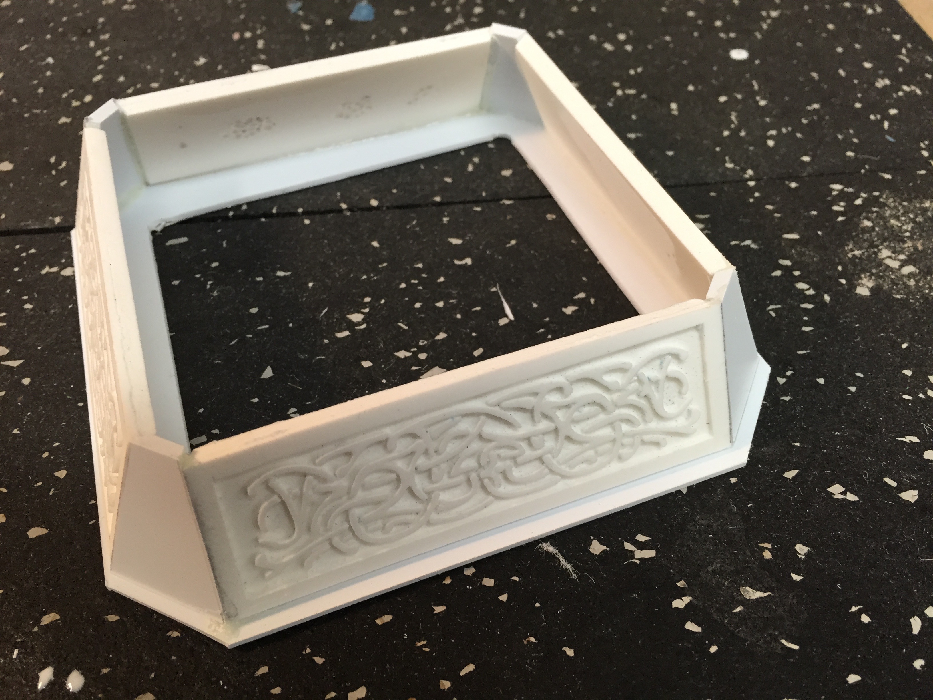

For the two "faces" of the hammer I molded and cast 4 duplicates of the side panel. These were then built into a frame and filled with liquid resin the create the face. This master is currently in a mold that is drying.
