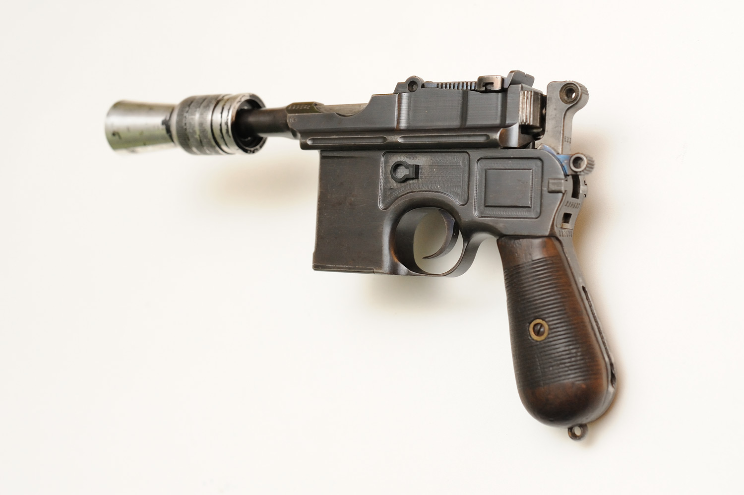

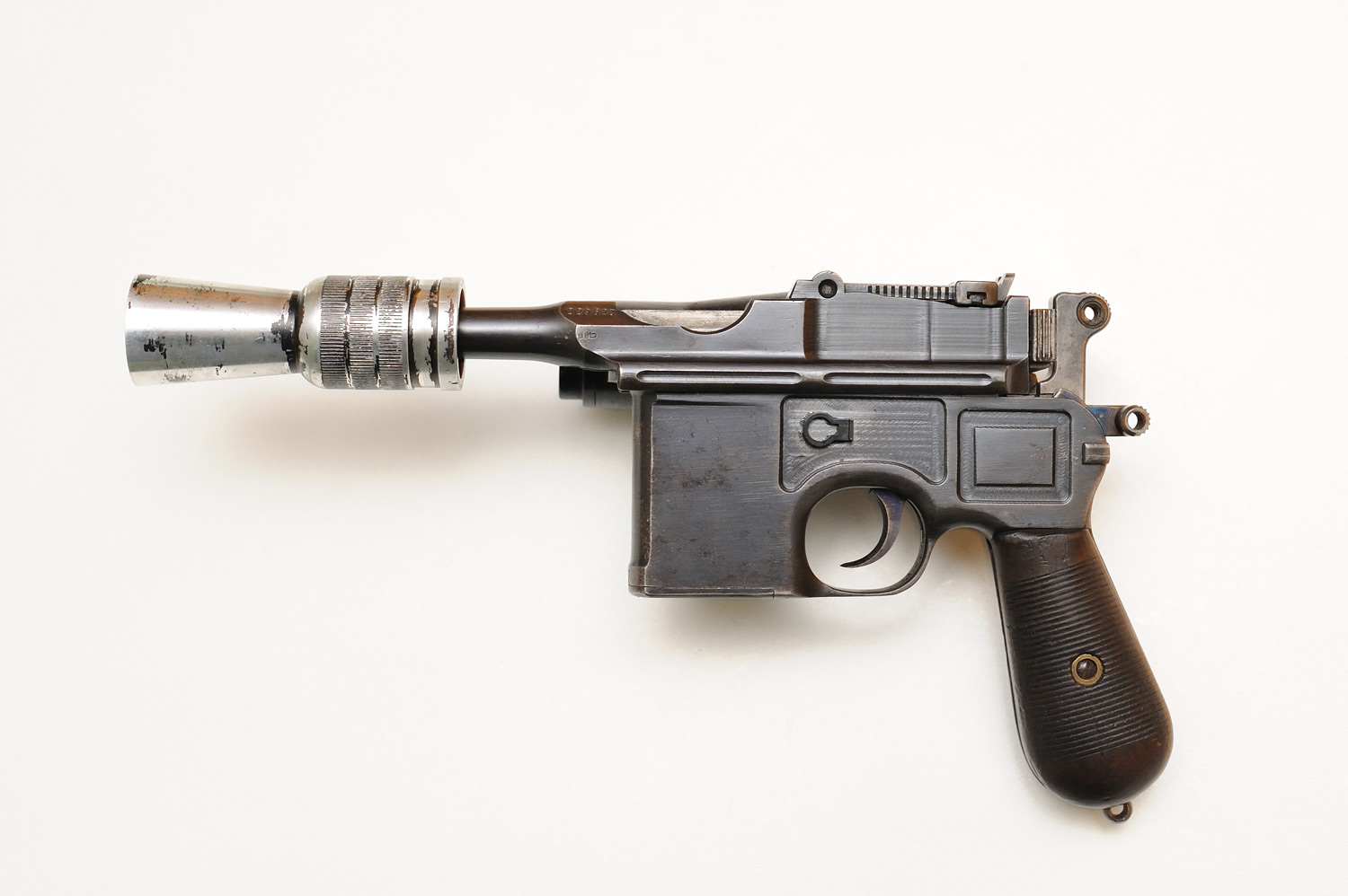

Did you have to use a LID device off a suppressor to get the Mauser to function? Also, did you go with a steel flash hider or a replica aluminum one? Thanks!
Re: My blaster builds thread: UPDATE: LIVE FIRE Han Solo ANH DL-44 Mauser C96
No on the LID.
Brock's gun works fine with a steel Flash hider, but mine is unreliable with steel I have to use an Aluminum one. Brock's did cycle BETTER with aluminum as well, as there were a few failure to eject or feeds, but the weight is the main factor. Oiling the ammo helped, which was a trick Jerry and co. passed on to me.

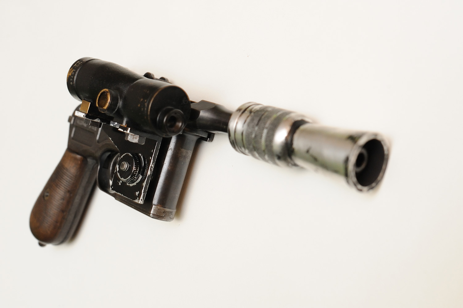

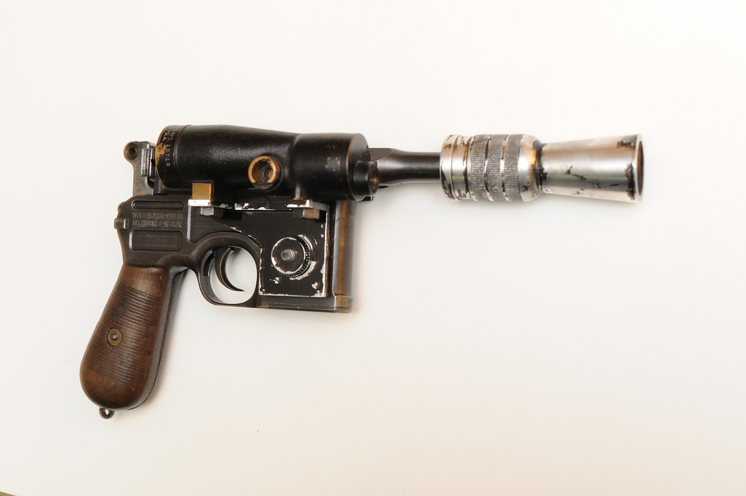

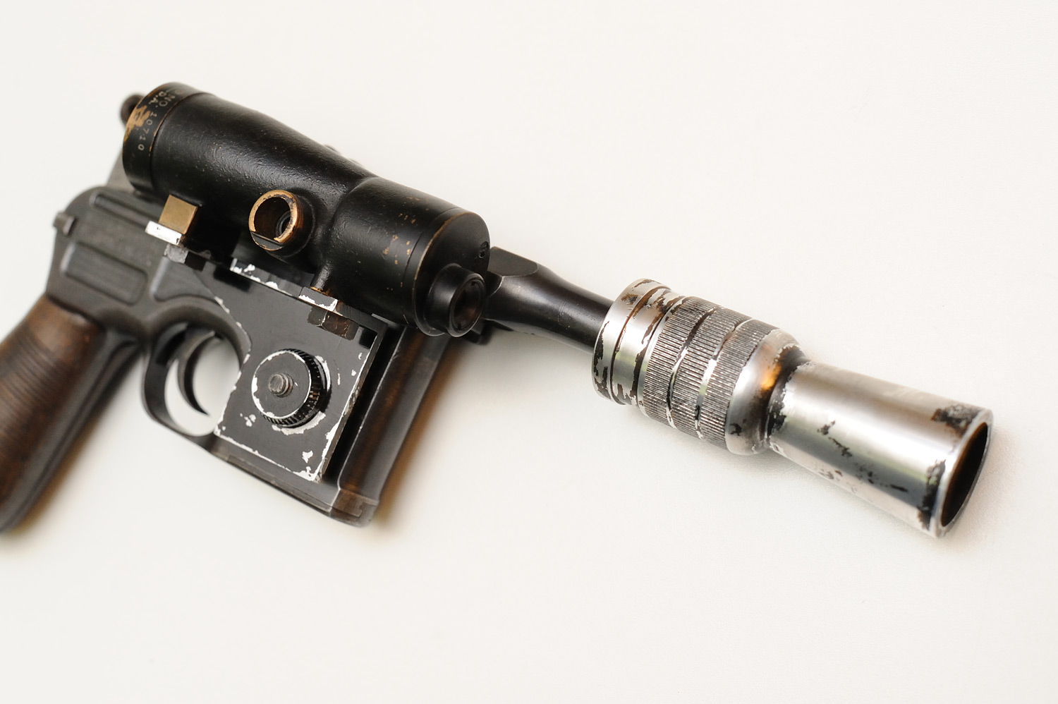

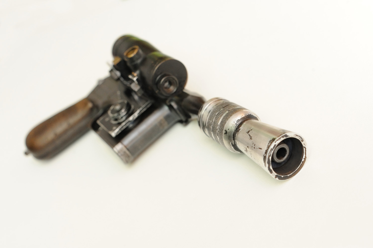

Also, I finished this a little while back and it featured in the Jerry Miculek video, but since then I re-made the scope mount bracket a couple of times, and finally took some pics of it.
It fires so beautifully, and is a very nice mauser. My Favorite ESB blaster... Luke's.

Looking at the different height of the bolts again...can it be that these ARE the same bolts, but the rear one is just sitting into a hole, that´s been drilled to large > the bolt "sunk" into it?
possible but my two are real bolts and are not trimmed they're actually two different heights.
However, they came from two scopes. And m19 and m32 or two m19s... One with round light socket and one with notched. I can't remember. One had two short heads and the other two longer heads. I just mix matched the sets to get the correct mix of real bolts.
When you look at the Han bespin his has the staggered bolts too. I THINK they just mixed them up from two different scopes like I did.

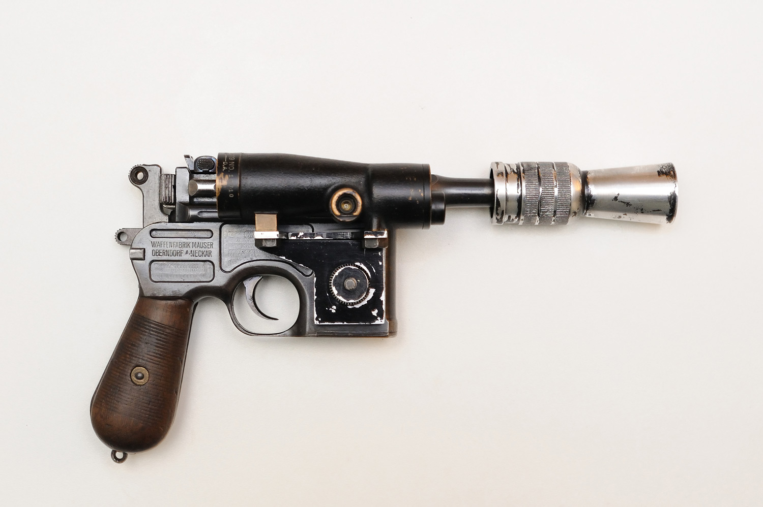

Gorgeous as always. Did you make the flash-hider for this one?
no that's a bobadebt one slightly modded to match Luke's. The Han has a slighter thick rear ring.
