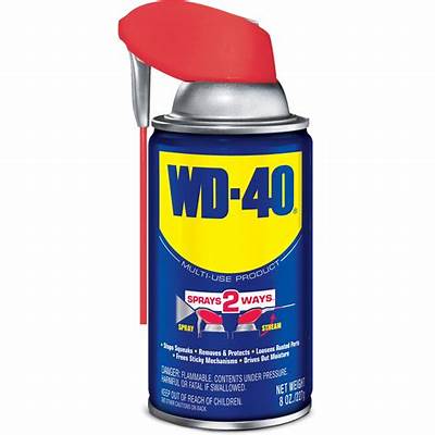

Also, I've tried the freezer and hot water method other members recommended. No dice. Maybe it'll work once I have some more leverage.

I'd also recommend not spraying any more lube or oils on it because your only making a mess of things and the inner bulb socket
will be an oily mess once you remove it.
(Once you get it apart You'll want to wash the entire thing is some good dawn de greaser dish soap until all the oil is gone otherwise
it will be an oily fingerprint mess for days)
