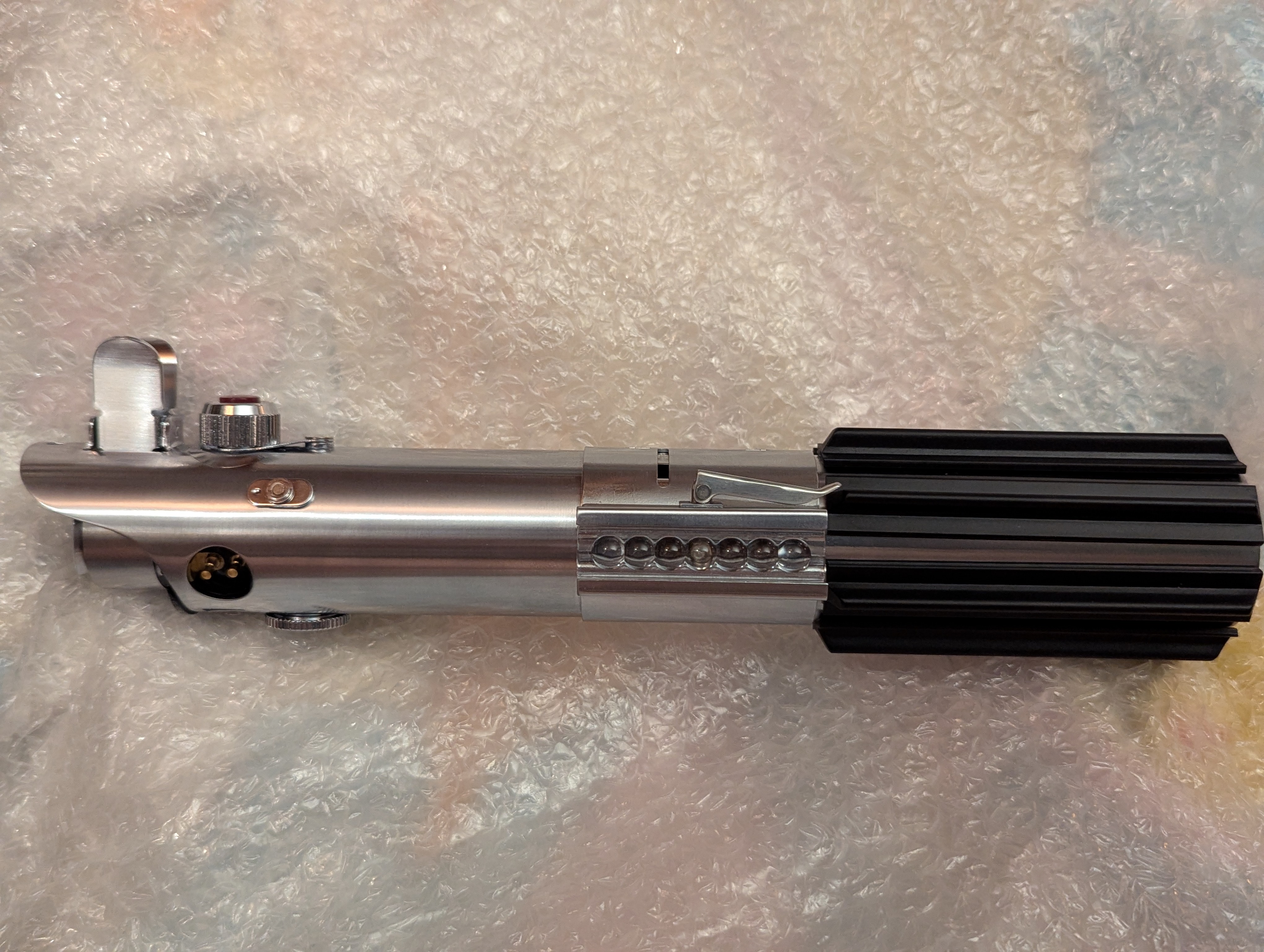

Parks Graflex disassembly. Advice needed!
I have a spare Roman’s V1 red button, which appears to be a match for the Parks red button.
You’re welcome to it, in the event you need to damage the Park’s button, in order to remove it. Just send me your address.
What about a strap wrench?
I did consider a strap wrench, but weighing it up against the soft grip pliers, it seemed that the pliers would give me more control without the handle inadvertently touching the Graflex body. Guess I'll see if I made the right choice when it arrives.
Also, I've tried the freezer and hot water method other members recommended. No dice. Maybe it'll work once I have some more leverage.

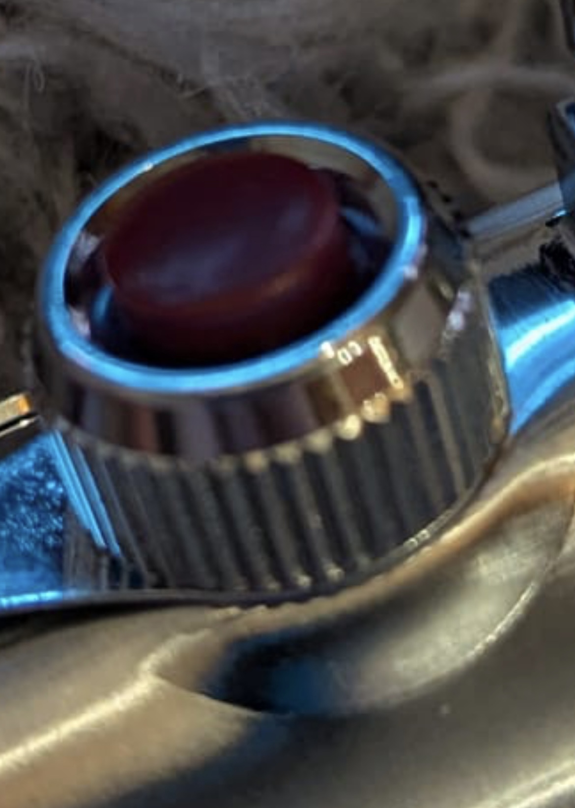

I have disassembled thousands of Graflexs over the years since 2005 especially the Earlier Parks units and I used to be in communication
with Parks quite often in the early years so I believe I know what is going on here.
One of two things is happening.
1. The Button is simply torqued down really tight and requires enough grip and force to remove it.
2. The Button is or shell one of the mis-threadded units and will require a significant amount of force to remove it.
I had issues with this many years ago and after talking to Him about it he explained why they can be so tight...
Because he built most of the sabers himself Parks used to use a custom made button socket tool to tighten down the buttons
thus making them difficult to remove but it allowed him to work faster and in the event the threading was off he could just
forcefully torque them down into place.
Either way you will need to use a pair of pliers with the inner Jaws to lock into the splines to get a proper grip on the button
so you can break it free or start the rotation.
Typically it is scenario #1
IF it is simply tightened down so far it is just stuck tight, once you get it to rotate it should then be easier to get it to come off
and it will free up.
However if it is scenario #2 and is actually the mis-threadded type then it will require torque with each turn to get it off completely.
Keep in mind if it is #2 and requires force to remove it like this it will most likely require force putting it back but you won't
know until you try to remove it and see what happens.
I recommend using masking tape over the flash and you can wrap some around the button but not so much that it will slip.
I attached an image with out masking tape so you can see how it needs to be gripped.
It is simply a matter of brute force and having a solid grip on the button with out it slipping in order to do it with out ruining it.
This can take some practice to do it consistently with out damaging the button and in all Honestly You should be prepared
that this button may get damaged a bit in order to get it off.
I think once you "feel" the engagement of the grip teeth of the pliers on the button splines you'll have a good idea as to
how much force you are comfortable applying to start the turn and you'll really need to squeeze to hold it and not let it slip.
Again cover the shell and button tab with a good few layers of masking tape to prevent from scratching the shell
put a layer or two of tape on the button, grip down and give it hell!

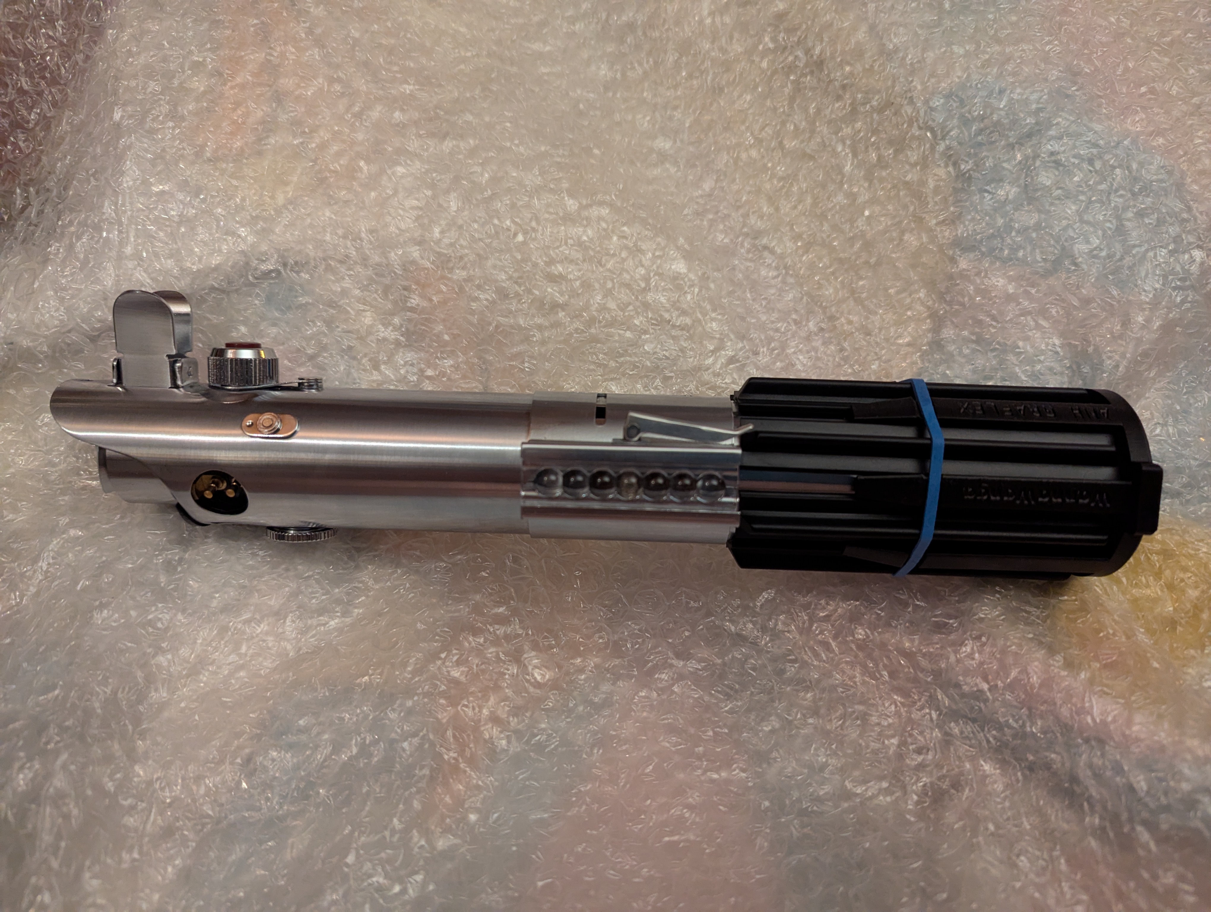

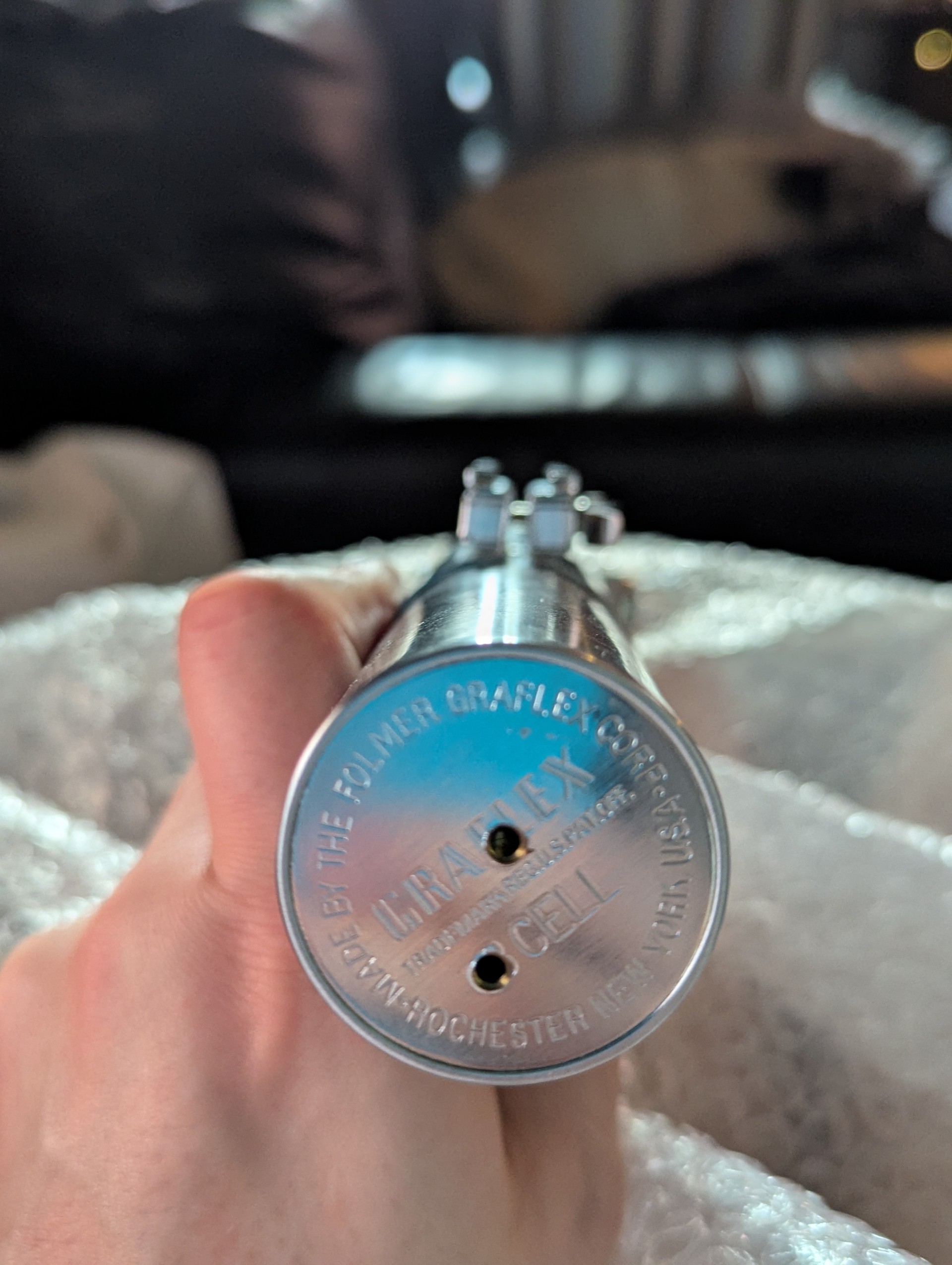

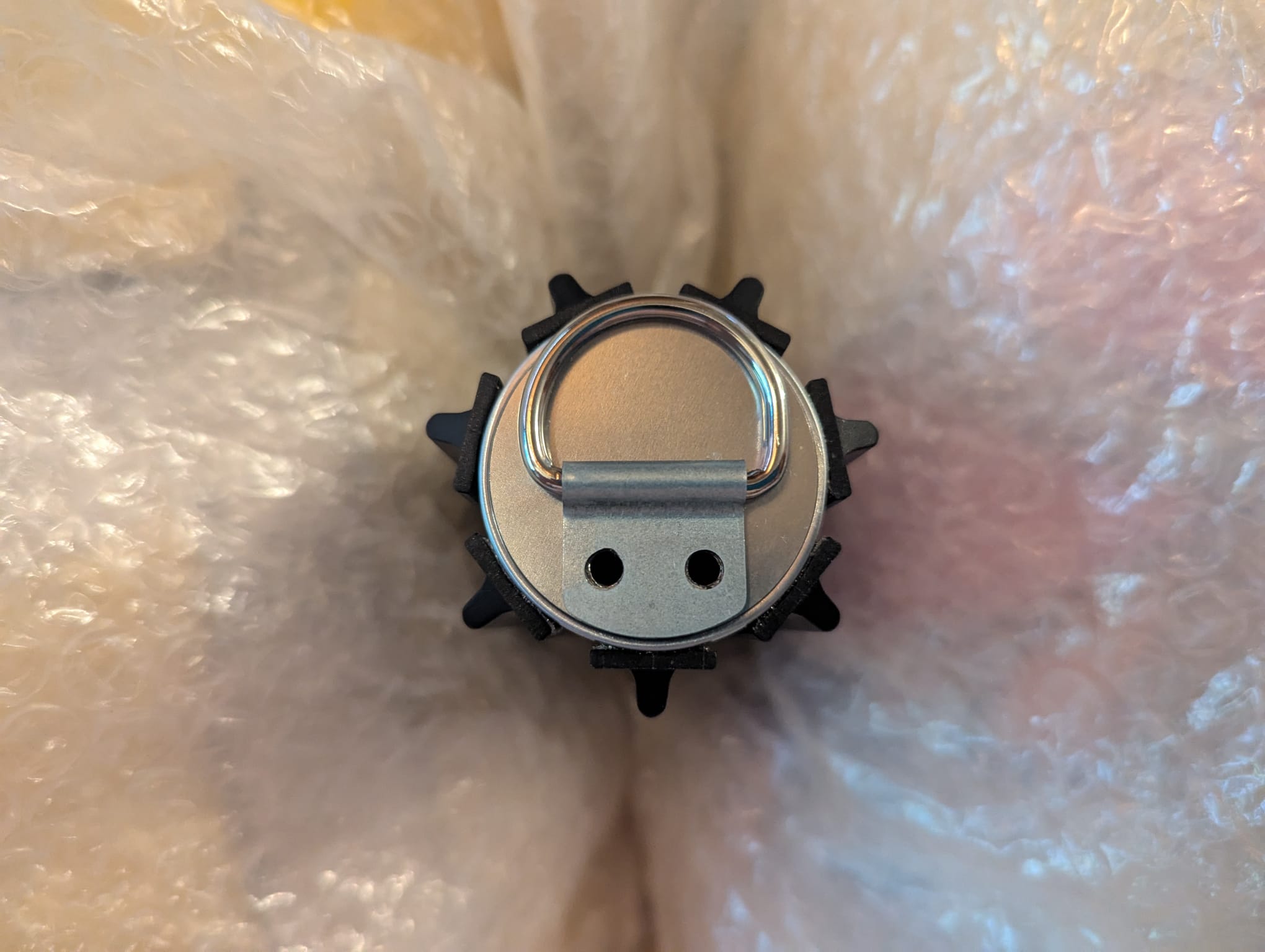

Sorry to disappoint you all, but turns out I'm more risk-averse than I thought when it comes to this saber. I would be so gutted if I damaged something. I'll be taking a more standard approach and just installing Roy's idealised ANH kit on it and calling it a day. The bottom will need to be blanked off by a round piece of stainless steel, because of the Parks having had an inaccurate 'Pseudo-Kobold' D-ring attached and the holes being in the wrong place to be covered by Roy's D Ring. So that's going to provide its own set of challenges. It's a good thing I'm going for an idealised look, because those holes would be an inaccurate eyesore otherwise.
I will have stuff to show off on the Custom Saber thread soon though. So you can cheer me on there if you like. ;)
Grips are now attached courtesy of roygilsing and his marvellous grip guide. He's been very helpful lately in getting me what I need for multiple projects. He also dealt with an issue with a previous order even though many months had since passed (and I just hadn't noticed the problem). Stellar service.
Only the D Ring left to install now, and I'm toying with the idea of ditching the rivets (which I've never installed before) for similarly sized Allen bolts. :unsure:
D Ring holes are now drilled and the ring held in place with a blob of superglue until I decide what route to go. Unfortunately, I had to reglue the metal disk when the drill bit decided to rip it off.
I'm likely going to go with the included rivets, but I don't have a rivet gun yet. Any advice on what type to get, and any pitfalls when it comes to technique?
