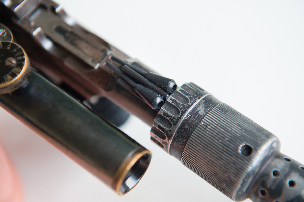

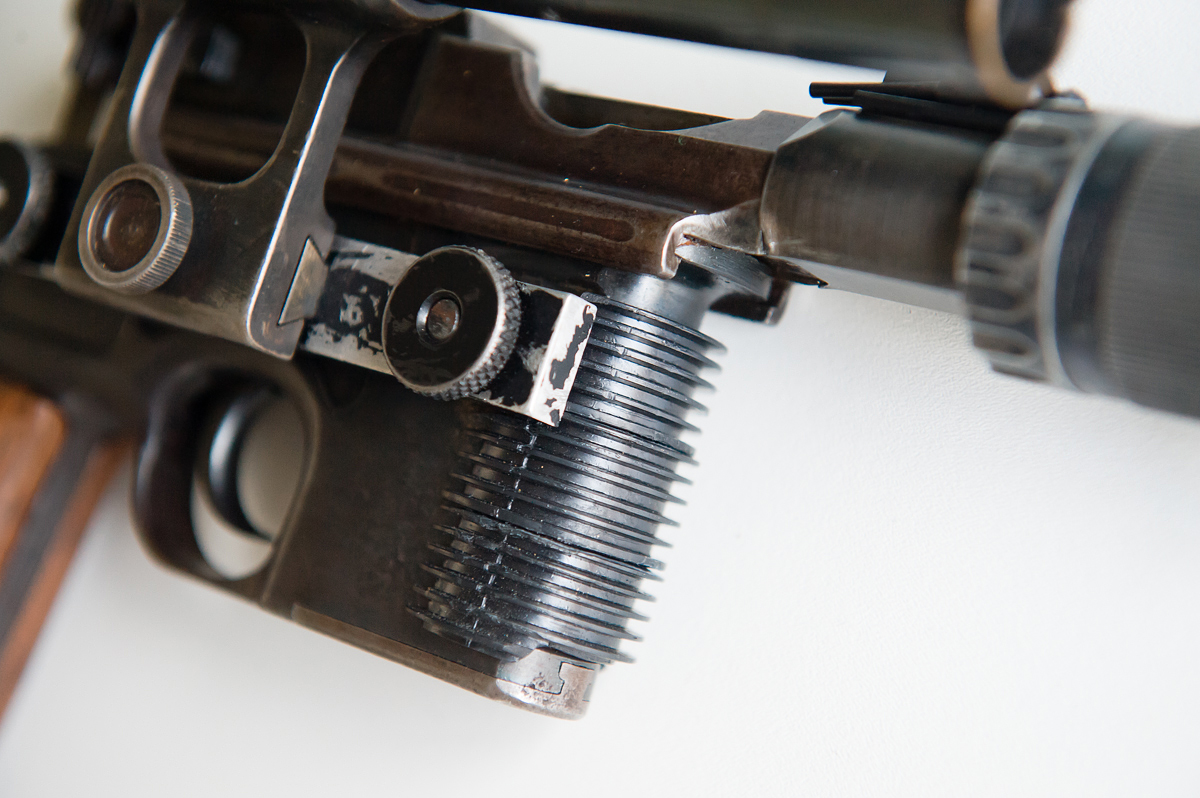

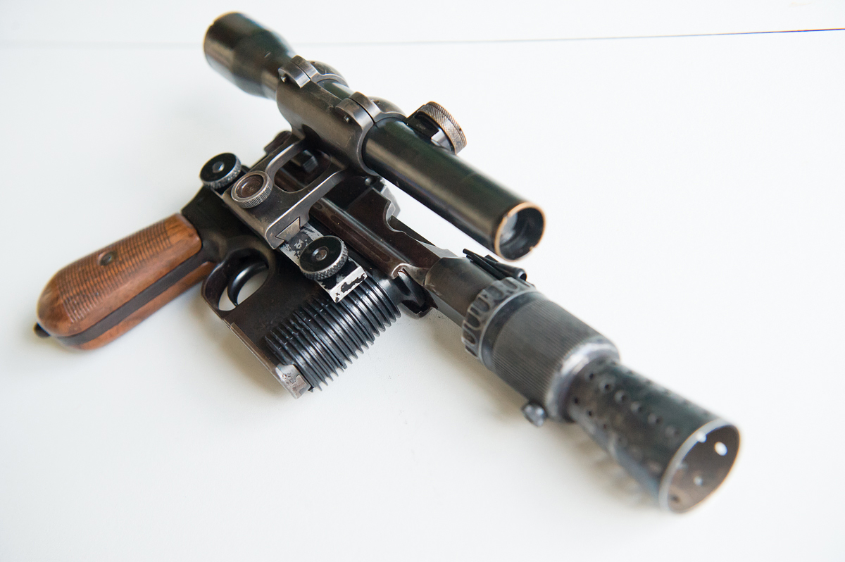

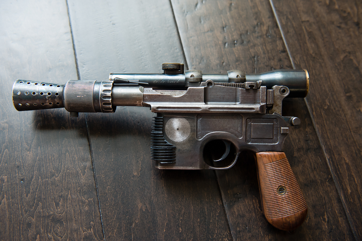

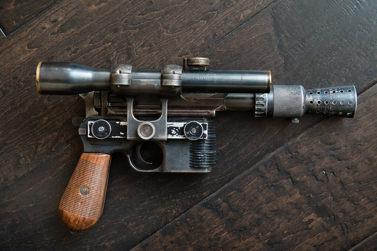

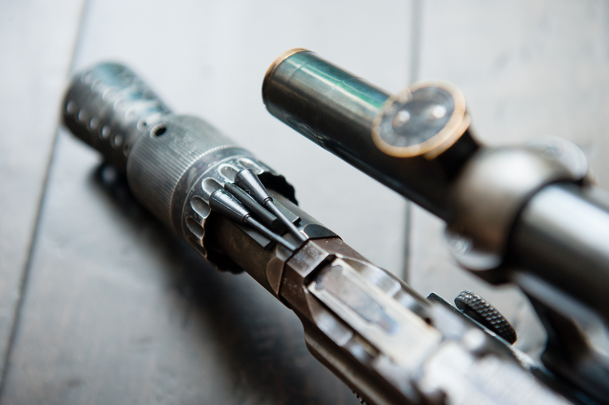

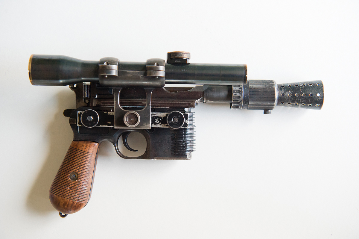

Update time.
I got my real tomtit parts in newly made from the original moulds and with VFX Freak's help (he cut his DEC radial parts to make his grill) I cut them up and make my grill. I also used a piece of Gino T Track and the tomtit push rods for my sight greeblie.
I tried to be fancy and use my mill to cut the plastic but it chewed up the side when the end mill bit the soft plastic. So the rest I used a dremel and hand files and that was more messy but much better. I'll remake the grill when I get free time, but for now it's there.
You can also see my steel bull barrel suffered some damage to the thin flanges where experimenting with the new booster I made the threads to the barrel... it got squashed. :( So I need to coax Dave to make me a new one from steel... OR if anyone has one I can buy........ hint hint.

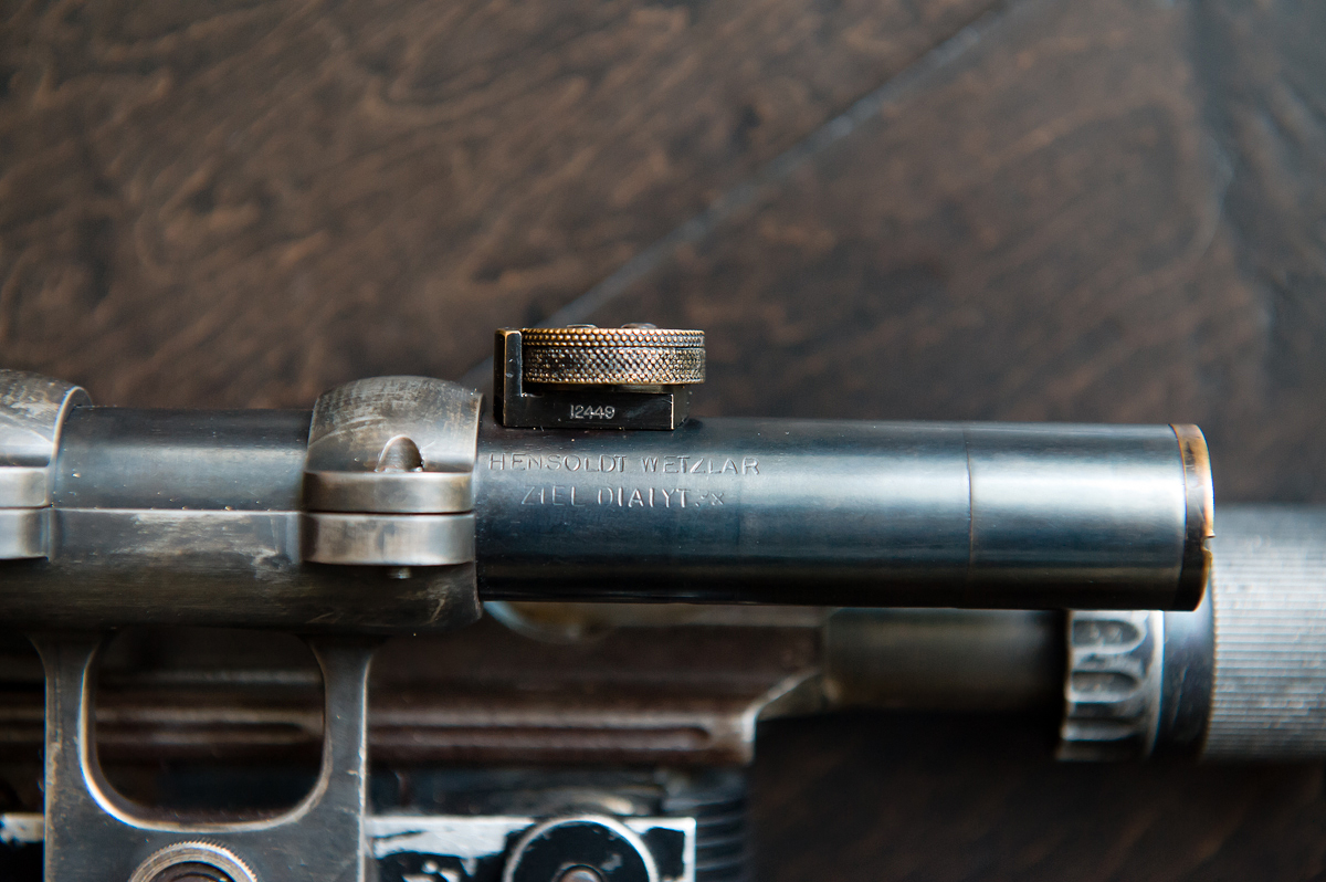

Anyway, OH... and I got ANOTHER hensoldt yesterday, and it had the best lower knob knurls to match my scope that is super accurate. So now my scope is tops along with the gun and greeblies!
