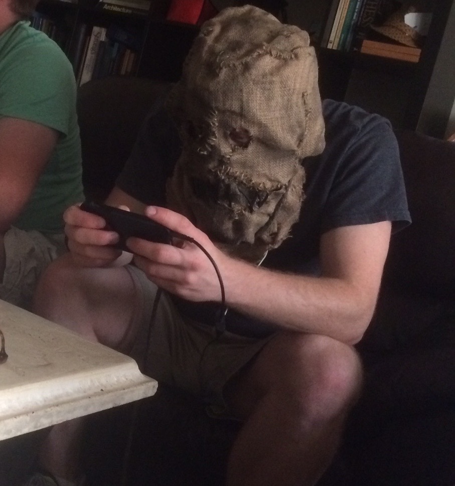

EDIT: Wanted to add a photo. This one is just a tease, but I call it "Scarecrow playing Angry Birds."
