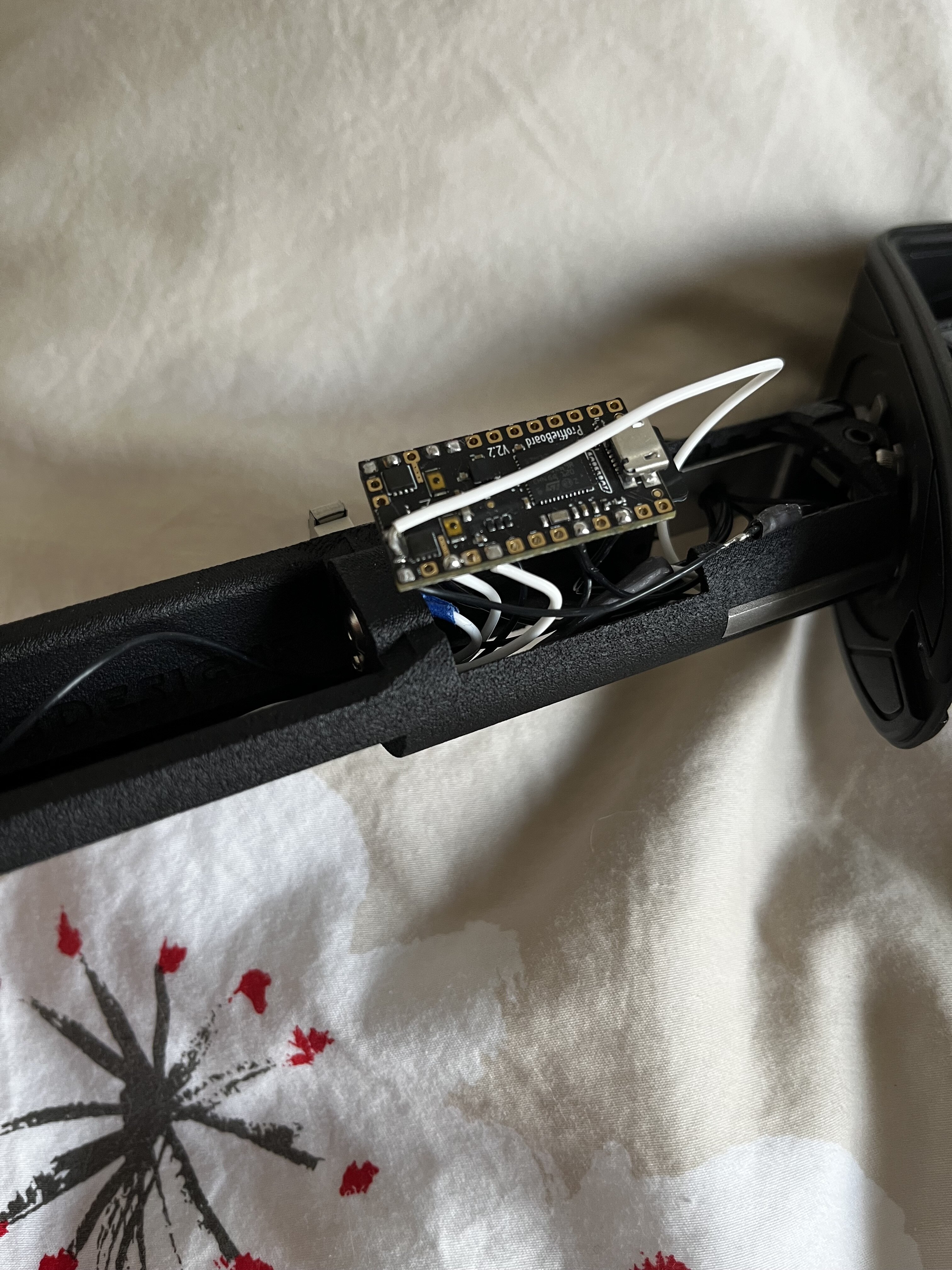

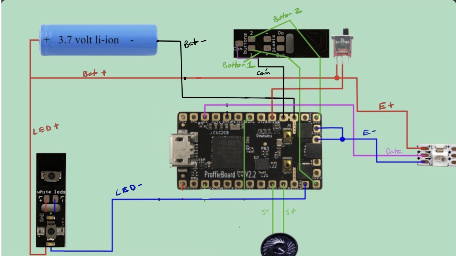

For anyone that did a self install, does this diagram appear to be correct. My saber won’t turn on after kill switch is flipped. Did I do something wrong? Any input would be appreciated. Thanks!
Sorry for the triple post, trying to get the picture to work.
You seem to have two wires that have been left with too much exposed wiring that could cause shorts potentially.
Using same colour wires is making it more difficult to know whether each is in the right place.
Any noticeable damage on the mosfet?
Agreed on both the wire color and the exposed wire. As somebody still learning, having wire colors that are easily tracked down helps a lot.
Also, how is the bridged connection on the LED2 and LED3 pads? It is a little hard to tell from the picture, but I'm worried that may have overflowed to the chips next to it. If you plug the proffie into a computer is it recognized? I actually fried the proffie on my very first build getting too close to one of those with my iron.

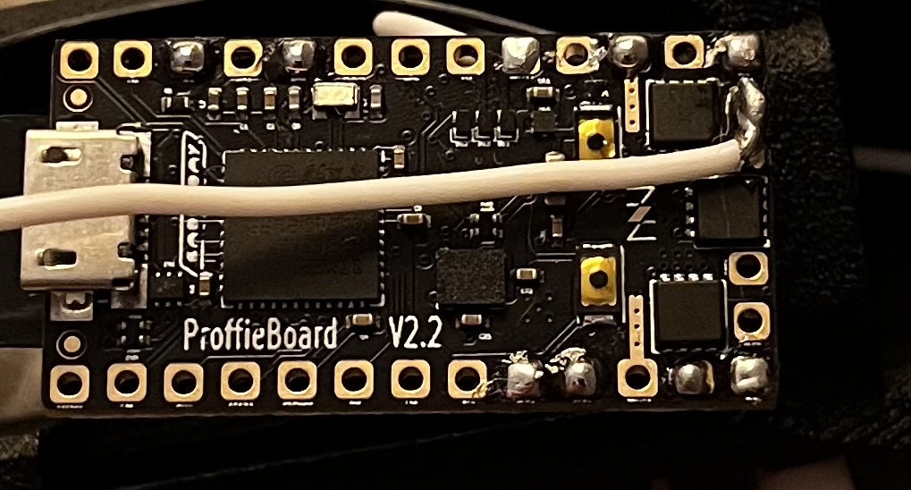

Noted on the wires. Was going for style over function, probably not the smartest thing to do but live and learn. Yeah when I plug in the board it’s recognized but the sound coming from the speaker has heavy static. Doesn’t look like any solder got on any thing though. Can exposed wires be fixed or has everything potentially been fried?

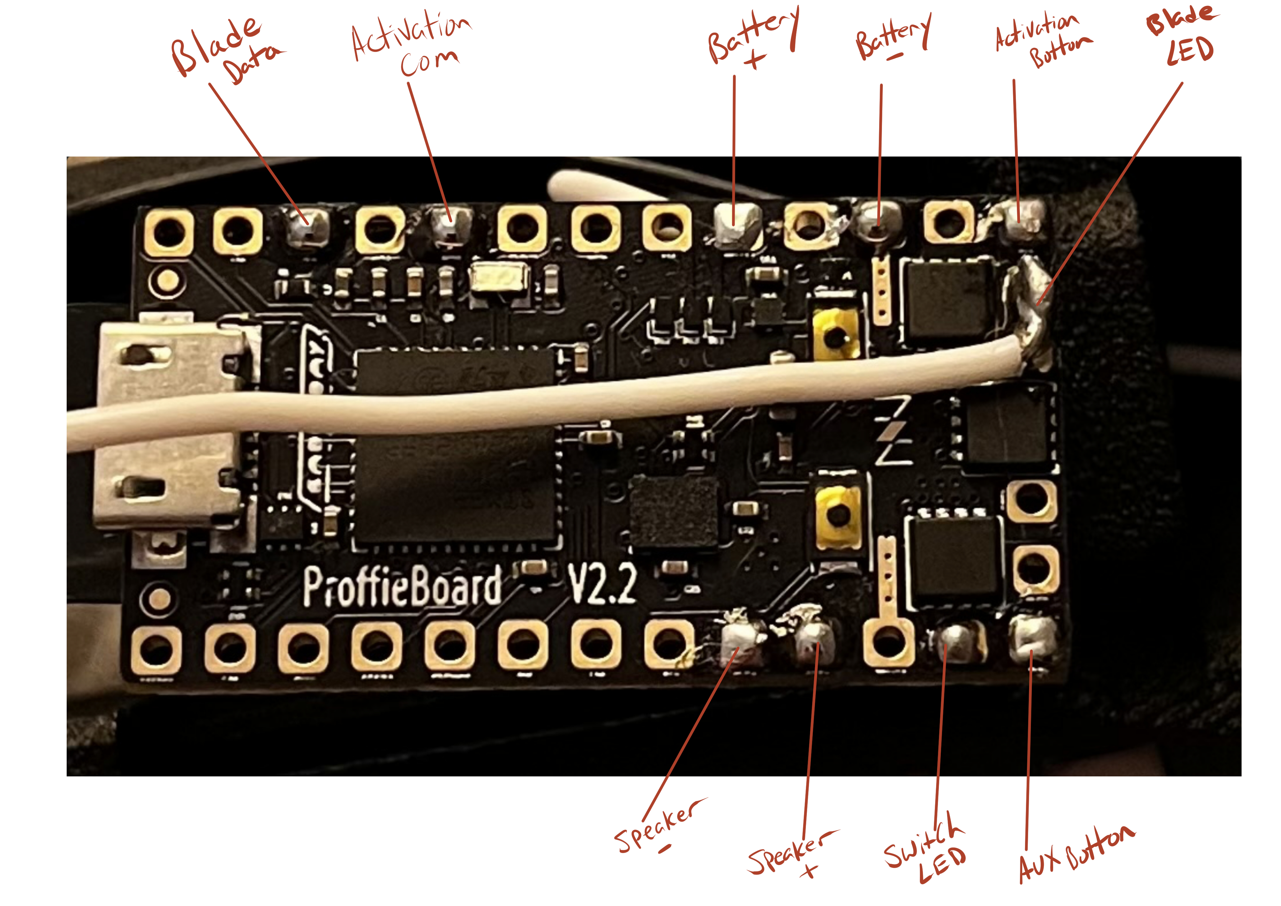

Can you list what you wired to which pads?
You’d have to desolder the pad, then push the wire through more then trim the excess, or isolate it with heatshrink or similar
The static is normal as it doesn’t power it enough to make it clear when plugged in
