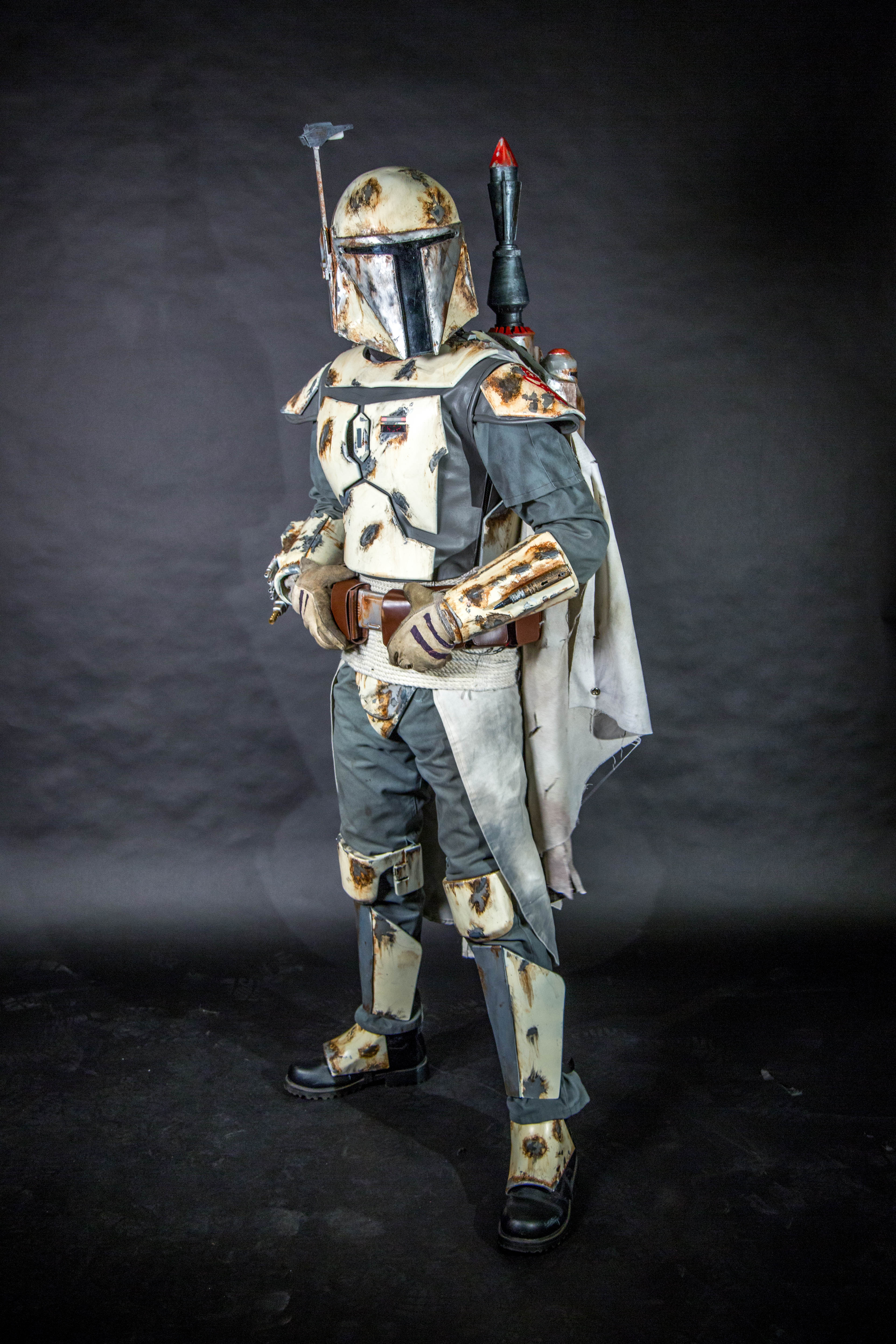

I've been uploading a lot of old portfolio work lately but here is something that I recently updated. My mandalorian costume for the mercs. Made from sintra and fiberglass
Older version is more towards the bottom, come a long way with faux patinas over the year. I repainted this and updated the soft parts to match the wear and tear or the armor.
The Proto boba helmet made by Skygunbro creatiomns, the older helmet is made by me during my second year of art school.
The armor rust is Sculpt Nouveau's Iron B Metal coating with a mix of steel powder rusted with tiffany Green patina. Best results were leaving it in the bathroom while I ran a hot shower.
The jetpack was made in 2015 and is made from scratch sintra and fiberglass along with 3d-printed parts. For that rust I used a combination of Acrylic paints and cinnamon. Originally was going to use the cinnamon just for the bright orange powder but it works great when you mix it in with the paint to give it more texture. Now that I learned the cinnamon method I recommend it over the iron coating. You'll have way more control with the paint and cinnamon and will get results quicker.
Probably one of my favorite pieces so far, next to my Dalek.
Anyone who hasn't heart of The coating i'm talking about can get it here, http://www.sculptnouveau.com/Details.cfm?ProdID=42

Pre- Metal coating

Thanks! Yea there's some tutorials on youtube on how they use the cinnamon. It works great.
very cool, love all the rust effect ( i get steel cleaning/scouring pads leave them soaking in water till the water evaporates leaving you rusty steel pads you can crush down into rust powder, i apply it with PVA glue then spray a clear flat laquer to seal and protect it )
Nice! that's a great method, I usually rust them with vinegar. Do you get a drastic color change with the laquer you use? that's the problem i tend to have.
cool never tried vinegar, as for colour change most lacquers are labled as clear but thats just means that dont have a yellowish finish and alot of them have a satin or gloss appearance. you need to find a clear lacquer that has a matt finish. im in the UK and i use this one
i tried it on a gloss object and it takes the shine off it and on the rust it just seals and protects it no shine at all
these were treated with it
Thanks for the advice. I've been experimenting with a few new sealers. The closest result to what I can find is workable fixative by krylon. I've been tole special waxes work great as well but have yet to try any, downside to those is it makes it difficult to paint over if you decide to bring in some more color. I'll see if i can find the brand you use though.

The real story behind this ( Not too creative or exciting) Is I started off just normal battle damage on the ivory white, but after a while espechaly with white you get scratches and dirt build up. So I though why not do something different than add dirt like when the same thing happens to TK armor, ( TK to Sandtrooper)
