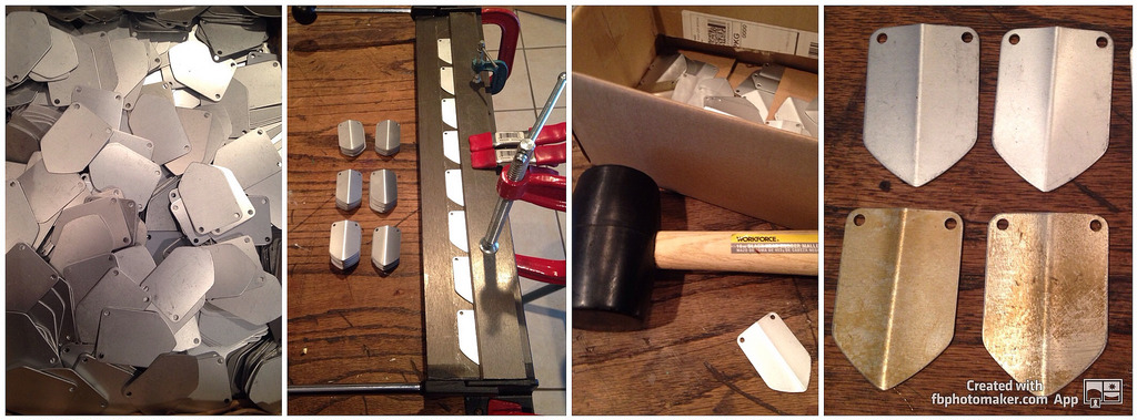

Now I have to use the bending brake to give them all the vertical bend like the screen used costume has.
im thinking it's going to take around 800 of these for me.
eventually I plan to sew all these on to a duck cloth tunic.
Definitely sew the scales on to a backing as that's how scale armor was actually made, just attaching them to each other makes it lamellar but it would need more attachment points to be like true lamellar.
Anyway, looking good so far. I don't envy the task ahead of you in making the scale armor, I don't think that I would have the patience to do that. I once considered making a set of lamellar like the ones seen on the tomb figures of the 1st Emperor of China but never went through with when I sat down and really thought about all of the plates that I would have to attach to each other.

I hope you're planning on bending as many scales at one time as you can fit on the brake...

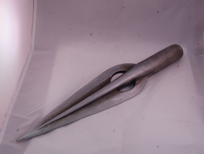

So much to do, I sourced out for the spearhead. Commissioned from InKibus of InKiWirks. The Rohirrim have a distinct spear design and it came out spot-on!
