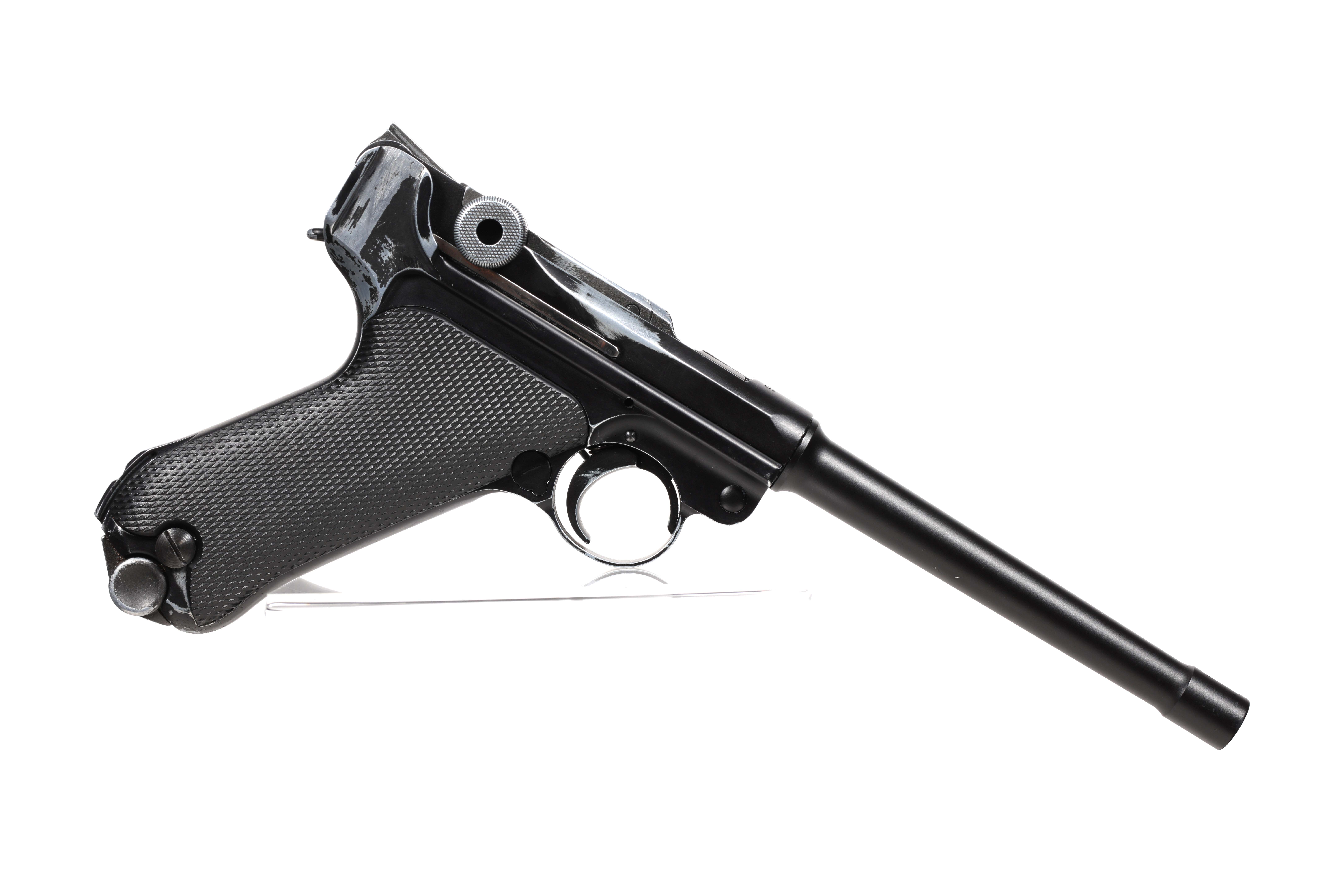

I bought a 8" Luger with the extra sight back the days, when this was believed to be the correct version for Jyn's blaster...will this work as well or do I definately need the 6" version?
Re: Rogue One Felicity Jones gun - ideas
Looking great!!
I think you could MAKE it work, but it would likely take some additional effort on your part. The 6" barrel is definitely the right size for her blaster.
