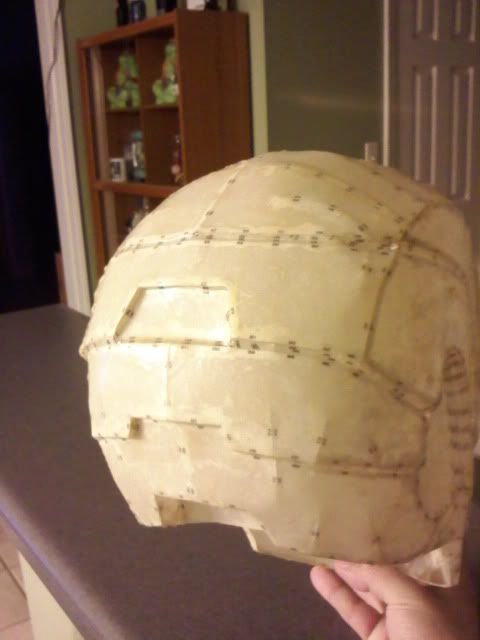

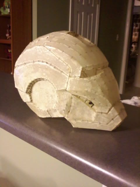

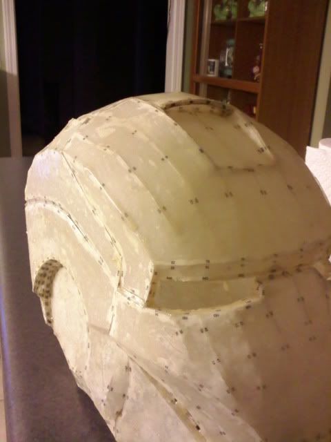

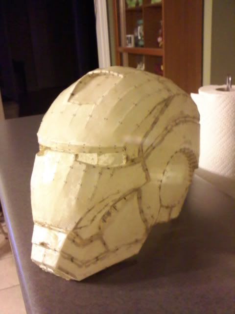

here is some more updated pics from my build Robo, here is the sharkhead hd helmet resin applied already and here is the mark vi chest, have to finish 2 little pieces on it and then it gets the resin tomorrow...working on the left arm also at the moment....
