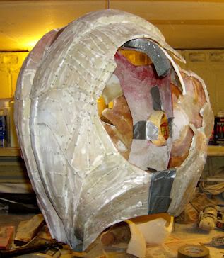

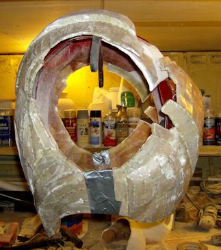

@Robo: I think you should add about 1/4" to 1/2" to the deepth of the Arc Reactor Hole. There isn't enough play after fiberglassing. It doesn't reach the brace (WIth my fiberglassing, anyway, lol). I had to hold the chest to the brace with duct tape, but I'm going to add the extra to the chest so it wll hold it's self.
I finally got the back and chest fiberglassed enough to take off the supports. Here's some photos of the back, chest, collar plates and shoulder bell (all the pieces are in various stages).

@arspec: looks like the chestpiece came out alright

MightyJohn, the chest and back pieces look awesome!
Thanks!
