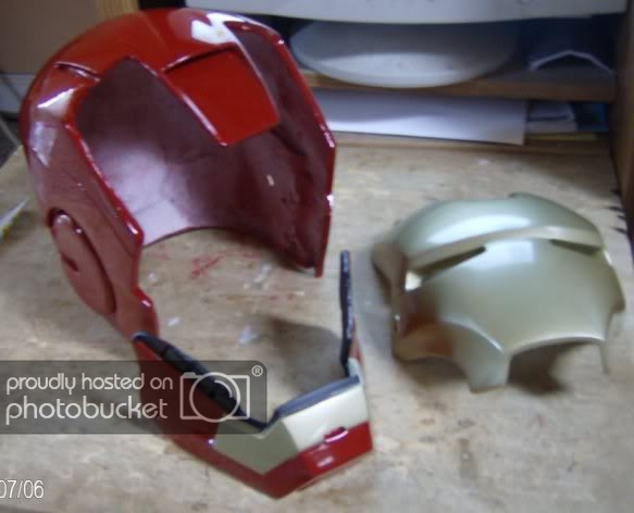

…And here are a few pictures of my helmet and new colors:
When you say that each layer needs a primer coat, do you mean after each layer of joint compound you then paint it with primer paint? Spray paint?
Re: robo3687's Iron Man 2 Pep Files - 27/6 first post rewritten, RIGHT LEG in first p
Yes. Add a thin layer of compound, let it dry, sand it down then spray it with primer...repeat. Compound is really dry, the primer absorbs into it, kind of like a resin. Using a primer that is different color then the compound is helpful for sanding too. It helps you keep an eye on your layers (don't sand past the last primer stage or you are working backwards).

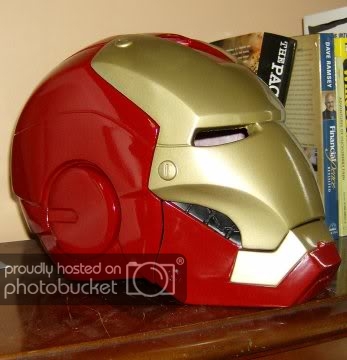

Heres my lates pic...Stupid camera! Paint still drying...

Thanks darkside501st. I use a coat of resin on the outside and 1 layer of fiberglass mat on the inside. I cut the mat into squares/rectangles no bigger than 4"x4" and make sure they overlap a minimum of 1/2".
I'm currently using Rust-oleum "Merlot" (from lowes) for the red and Rust-olem Metallic "Pure Gold" (From Home Depot) for the gold. Once the whole suit is finished, I might change it.
A little better picture with this crappy camera...
