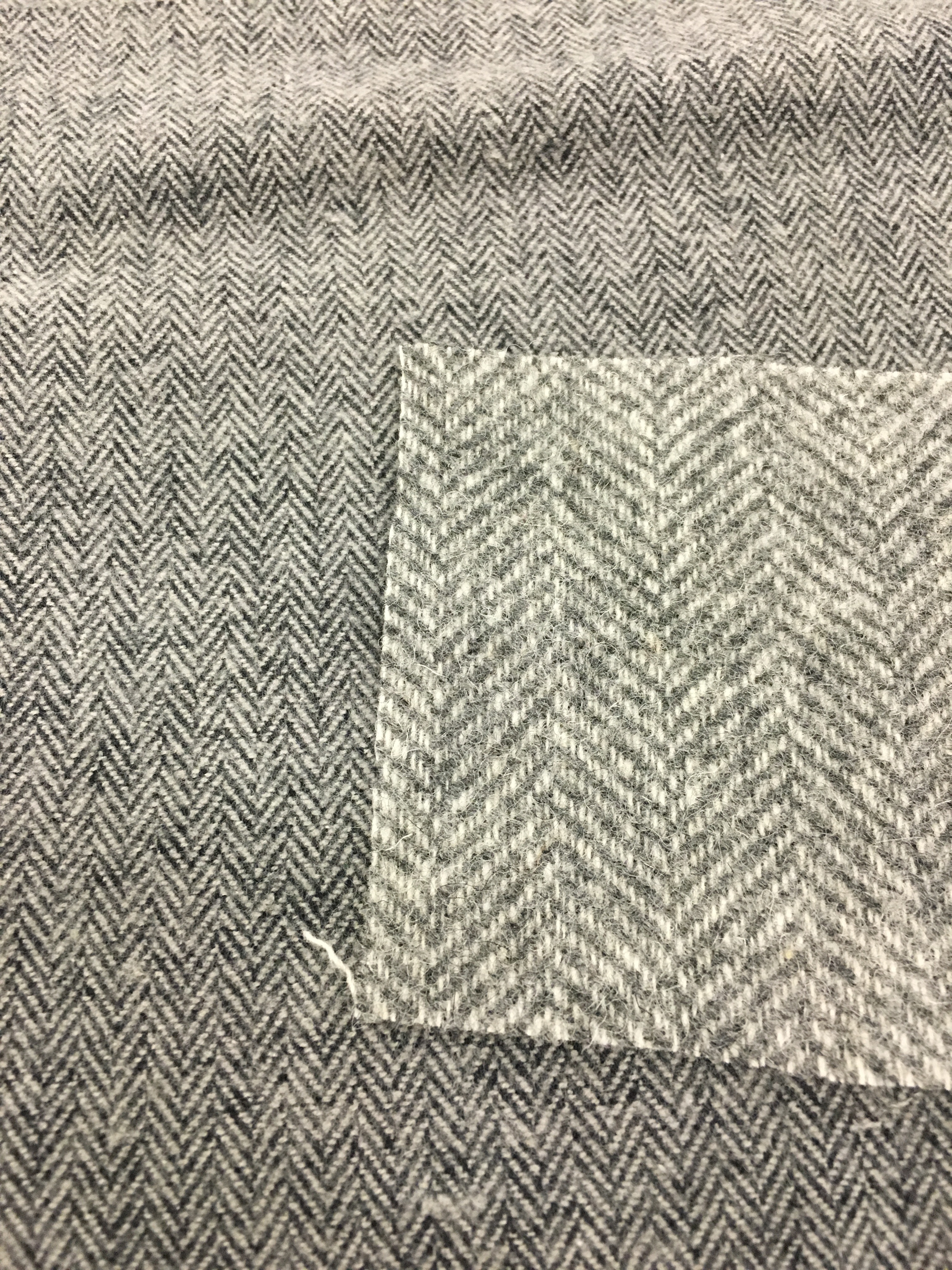

Went to Joann's first thing this morning to check out the great find http://www.joann.com/plaid-brush-cotton-herringbone-black/15010531.html
The herringbone is too small & it's a snuggle cotton blend.
Image shows the JoAnn Fabric on the left, and my wool swatch on the right.
Great for a budget build and feels more comfy than wool :)

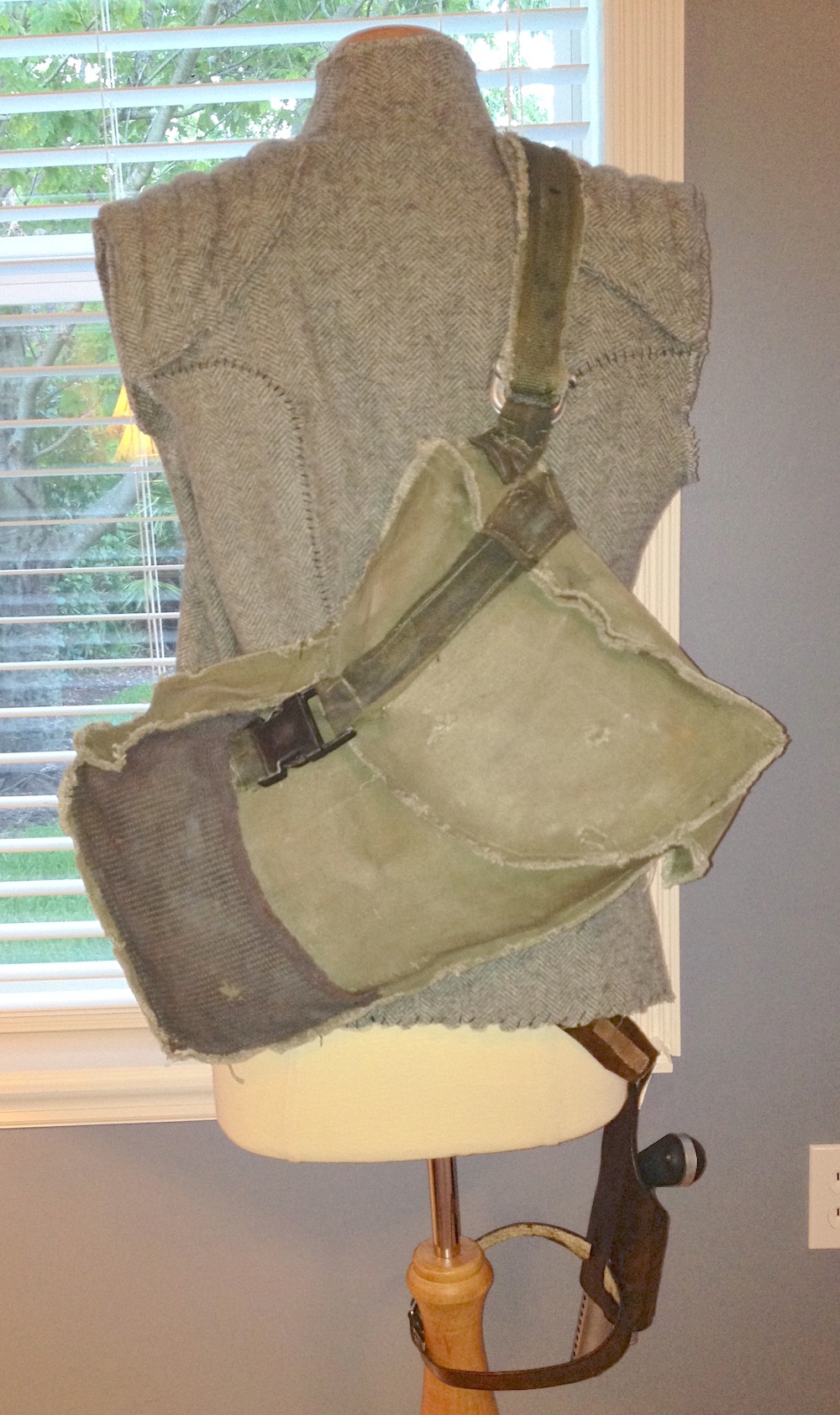

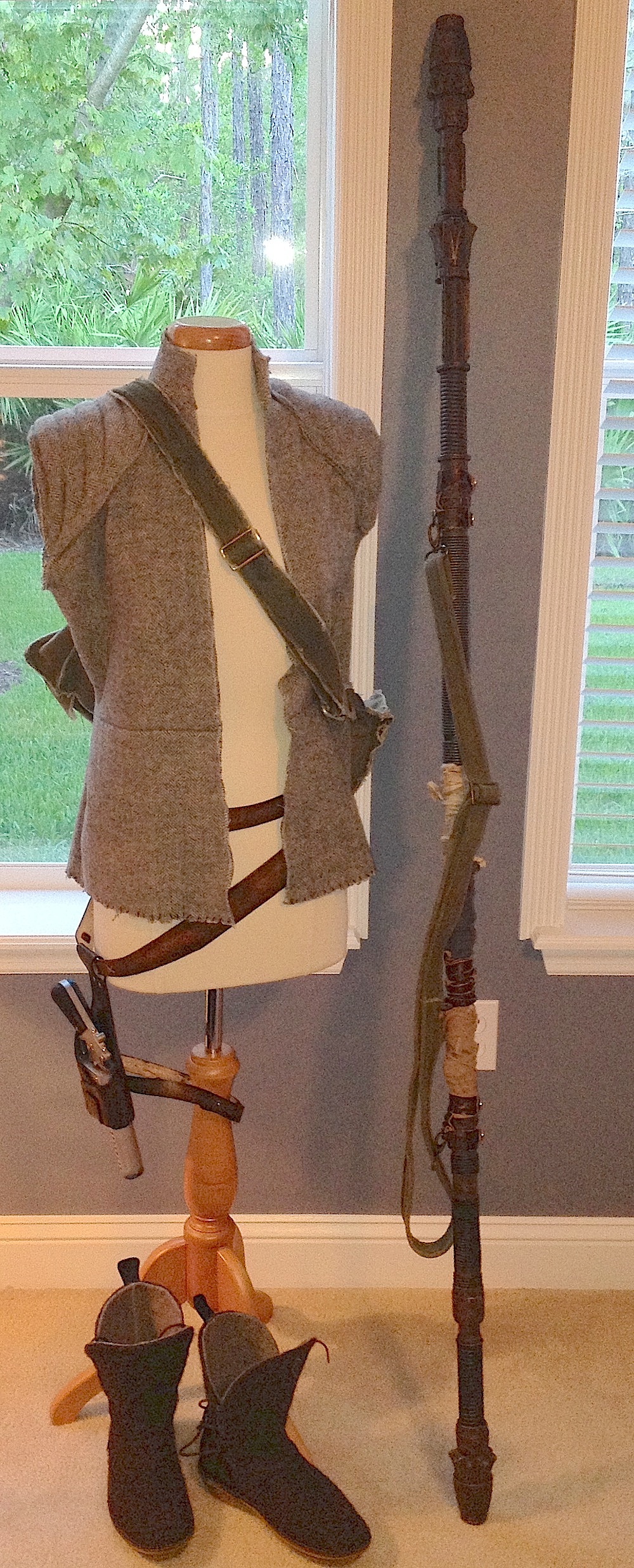

i used 4/5 oz leather half shoulder from tandy leather. It will be plenty to do both pieces. Just get one that has about 50+ inches across to give you plenty for the hip part of the belt, longer the better.
Also, the latest pics and figure show that the thigh strap may use 2 of those rings instead of just 1.

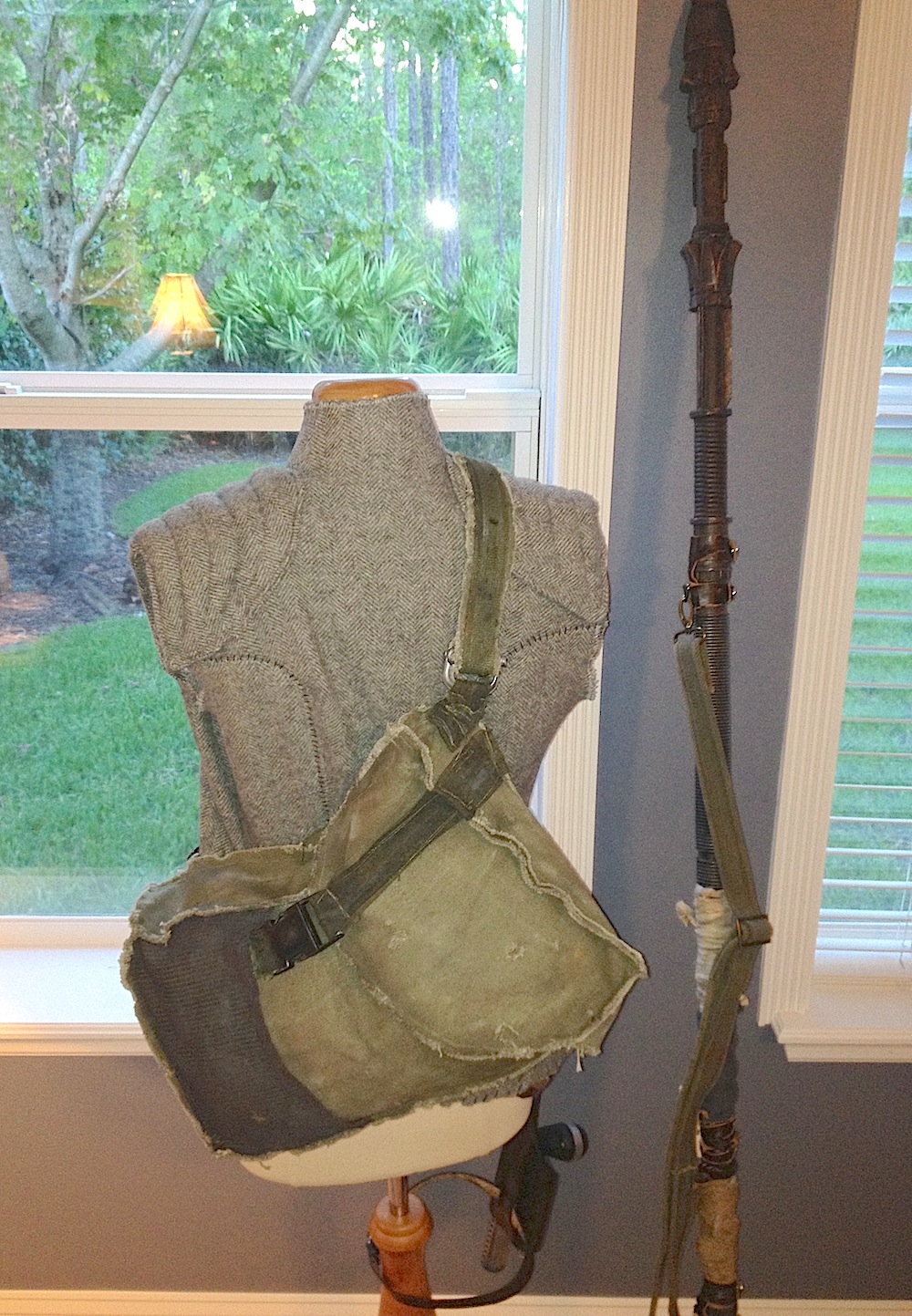

....i'm actually working on a write up about the bag which should be up in the next couple of weeks with the pieces i used to make it, in case you need some info on that too.

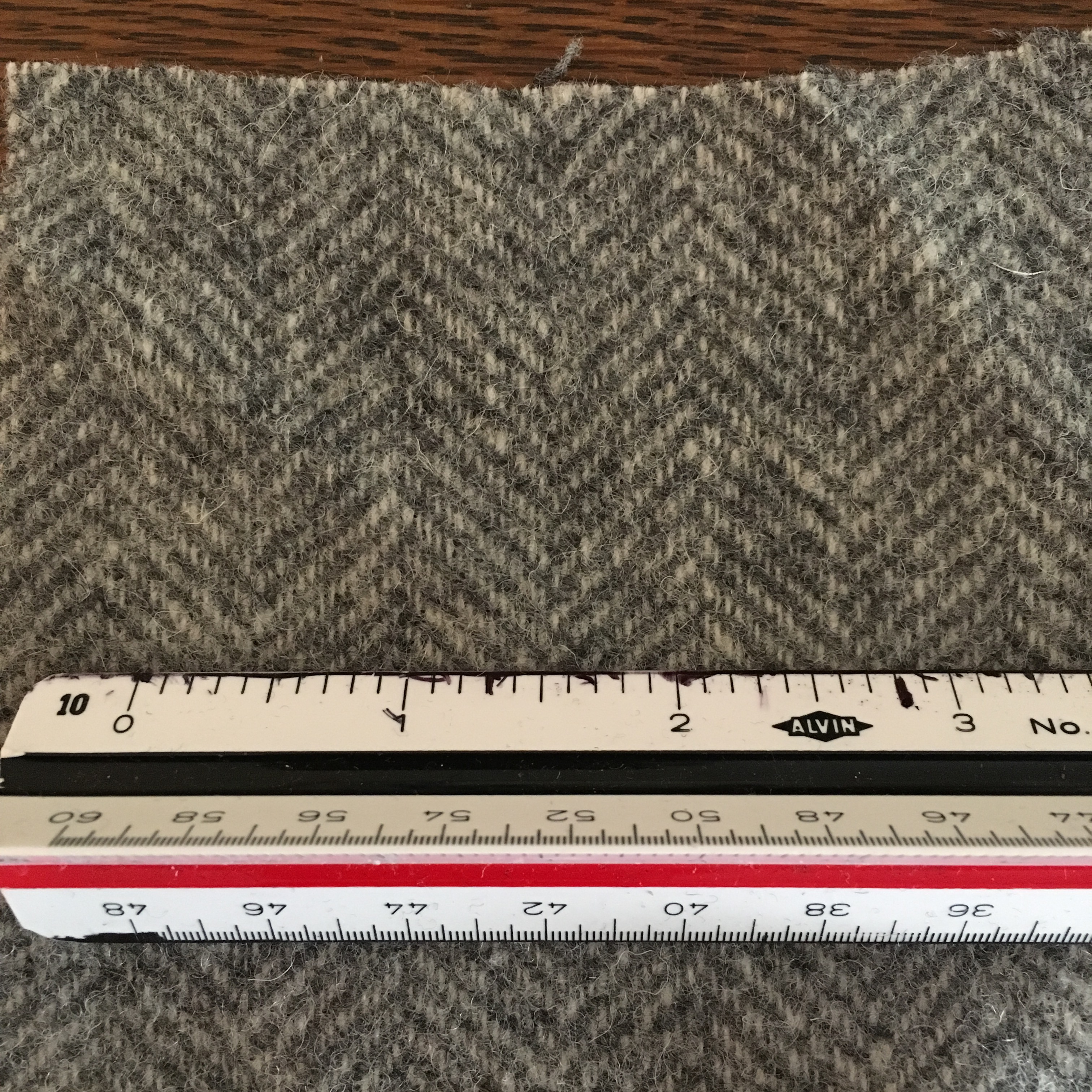

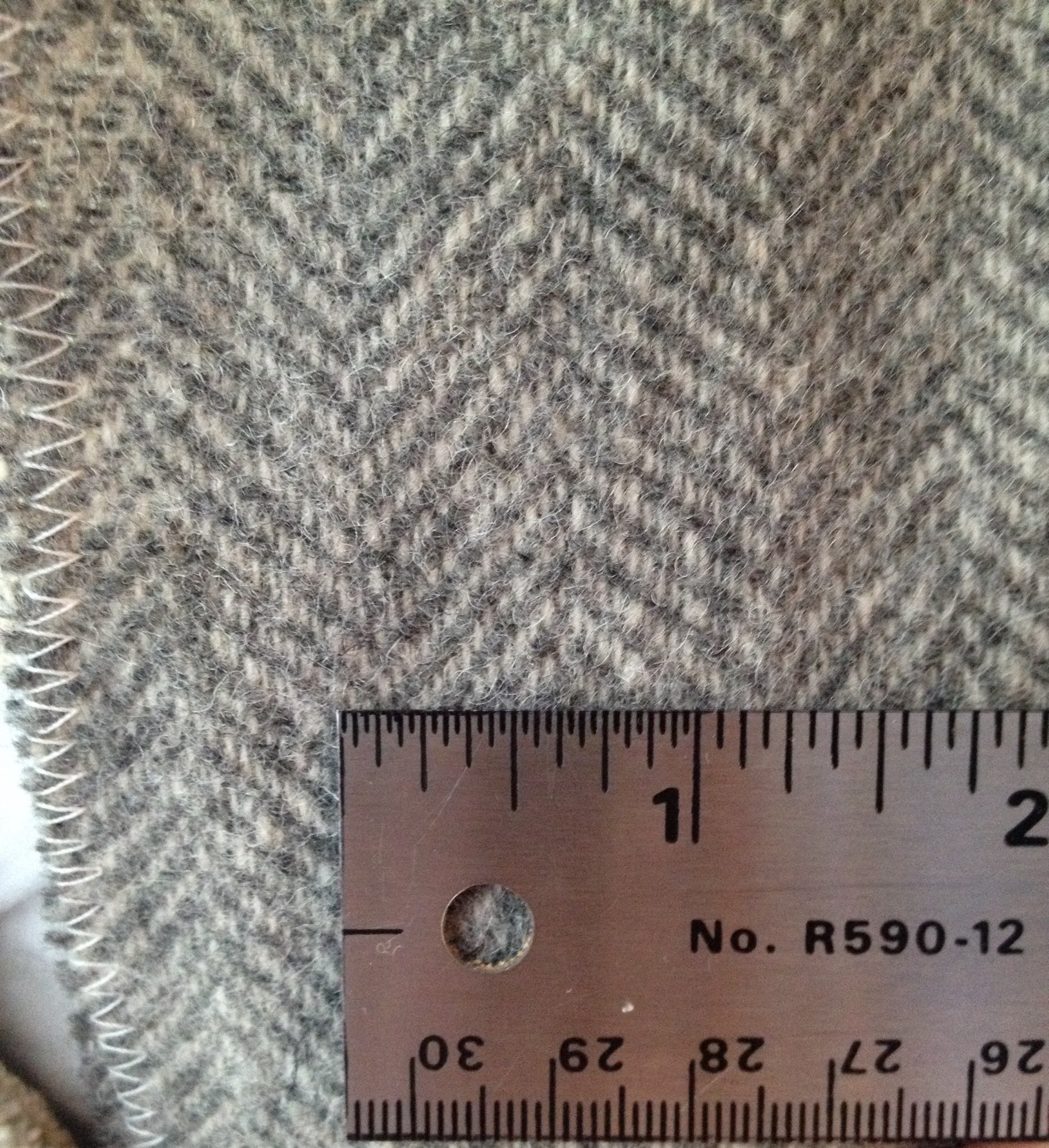

Anyone able to give me a measurement of the pattern in their herringbone fabric? 1/2 inch? Wider? Trying to get a better idea of what I should be looking for when shopping online.
Thought you were going with that steel wool fabric?
I can take a pic of a ruler on it if you need.
Personal life has kind of crept up and blocked me from actually purchasing anything for this project yet, unfortunately. So I've still been gathering options and doing lots of research since I haven't had time or space to create anything just yet.
If you have time to take a quick pic, I'd appreciate it! Thank you, Redwillow!
The picture on the right is from Prairie Woolen, and the one of the left is the #616 from the Door Mill.
Hope that helps :D
Wow, so the praire woolen is darker than the 616?...or is it just the picture?
...the entire /\ shape looks like a little over 1 1/8"

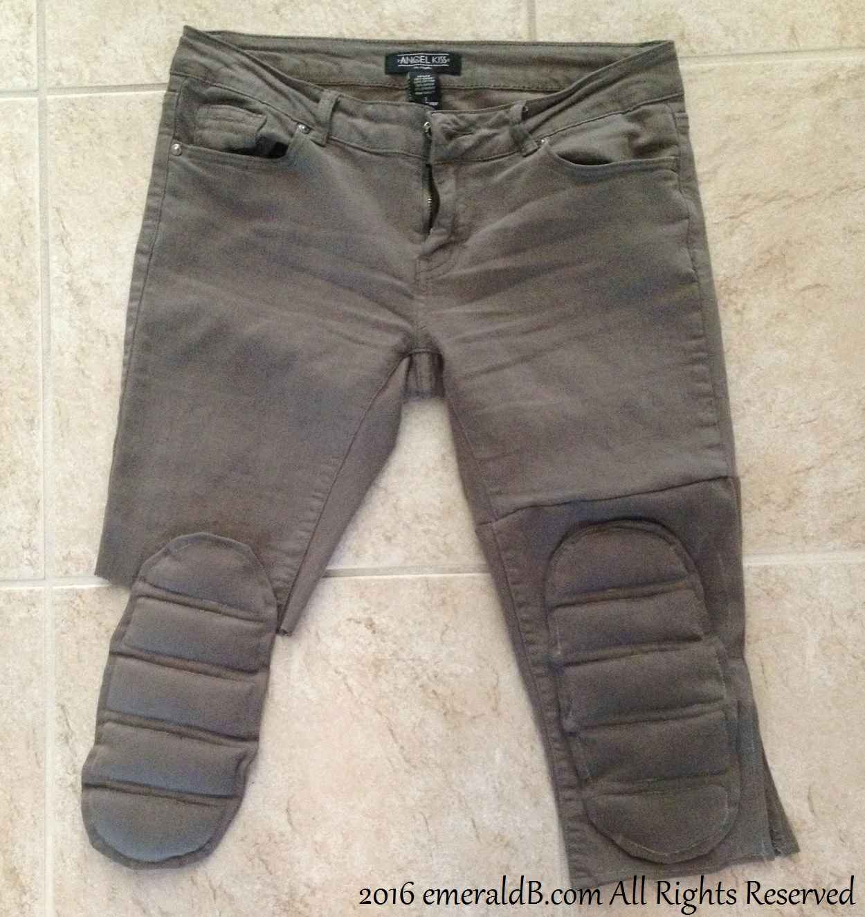

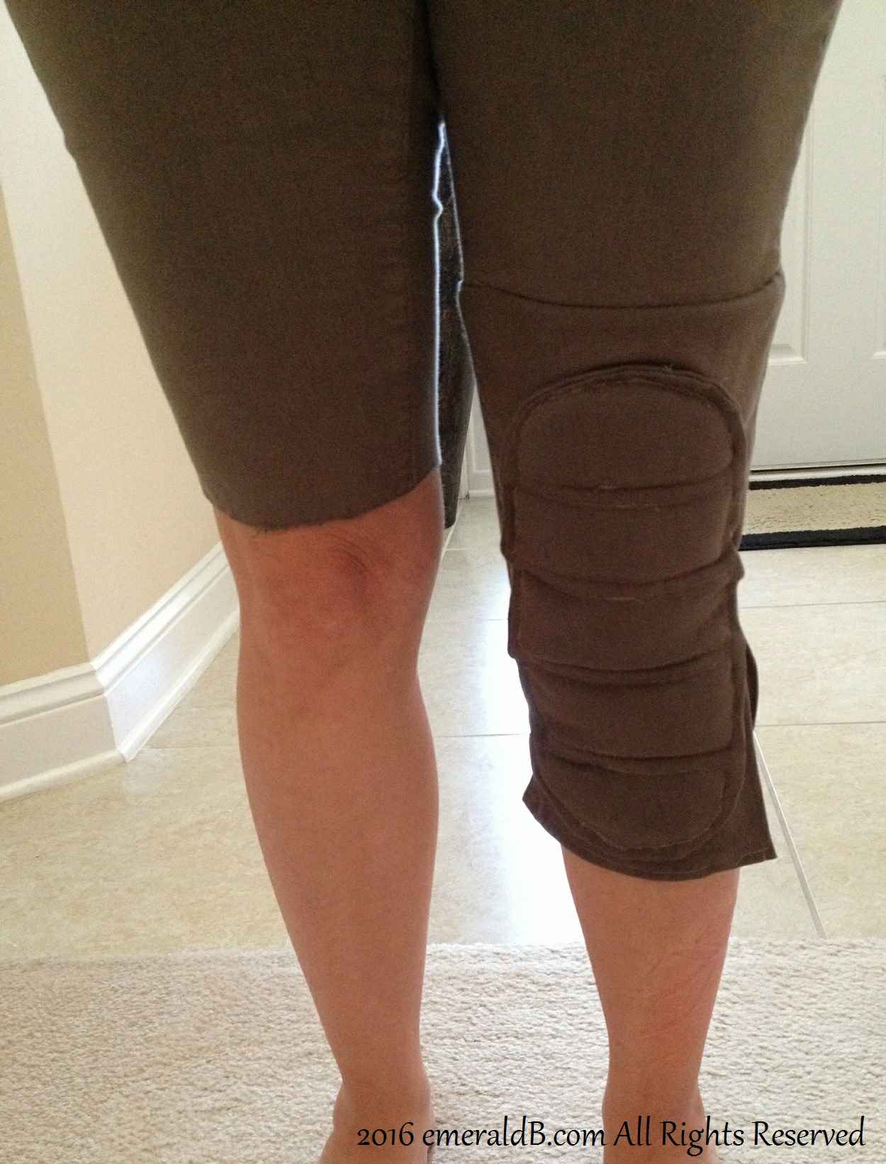

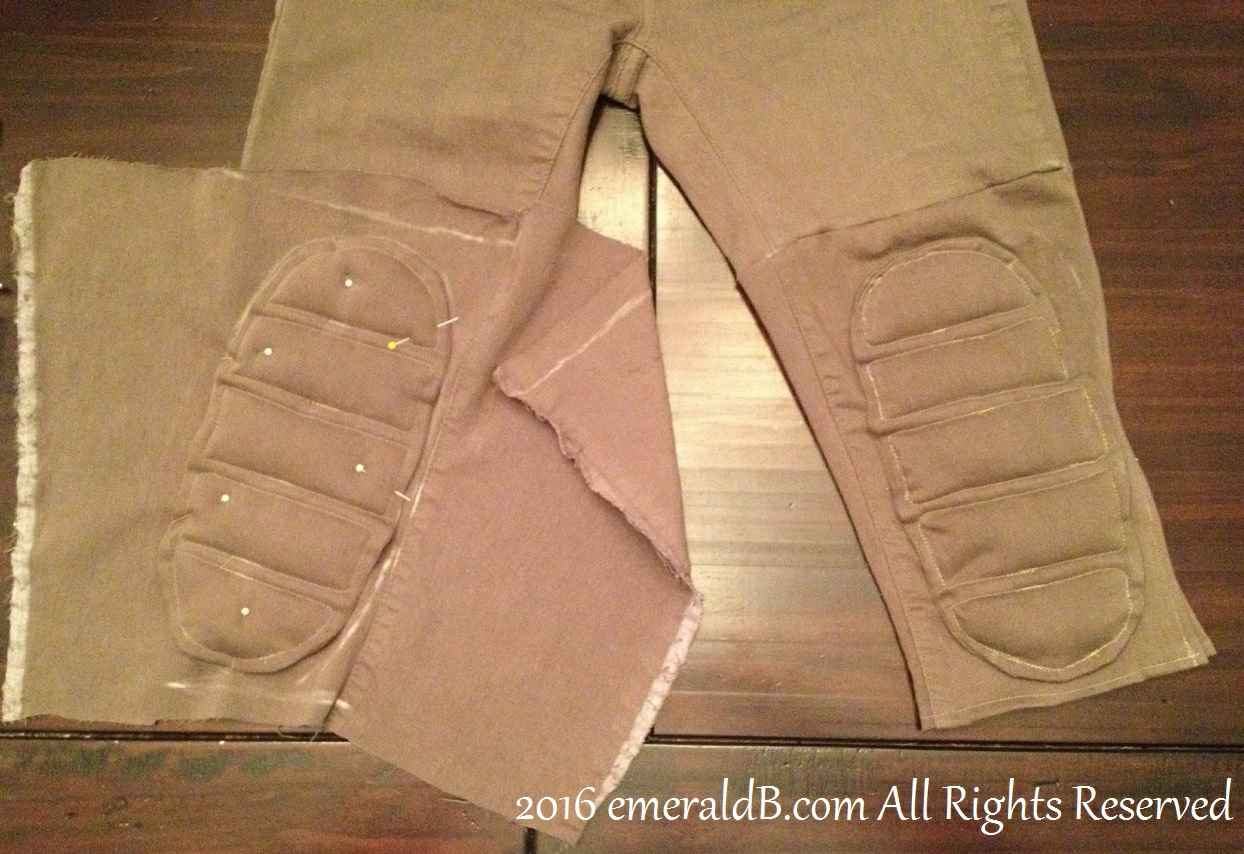

working on pants, 1 leg down, 1 to go. Made the kneepads with a separation between each section and I'm doing a seam between the lower and upper sections of the legs.
Liking this color...it's green, but can look gray or brown depending on the light.
Thank you so much, xspungerz and RedWillow! That helps me a ton, and I appreciate it.
The pants are looking great, btw. Love the color, too.
