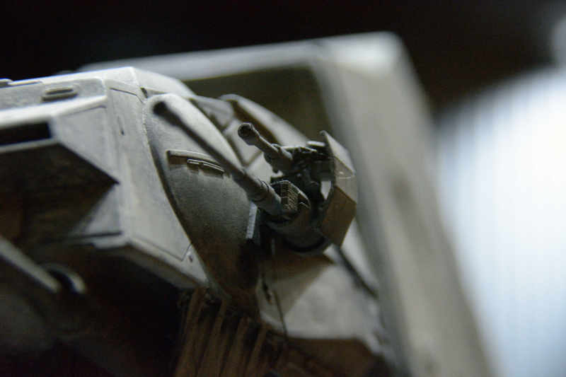

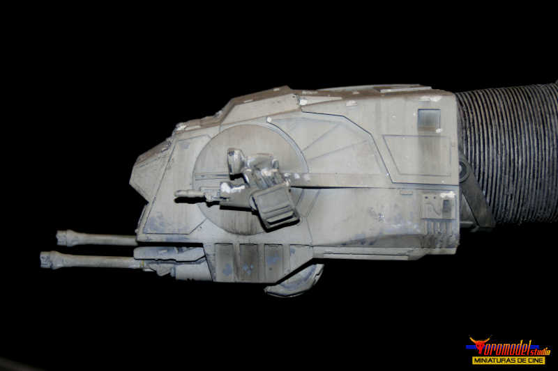

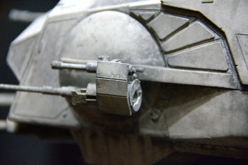

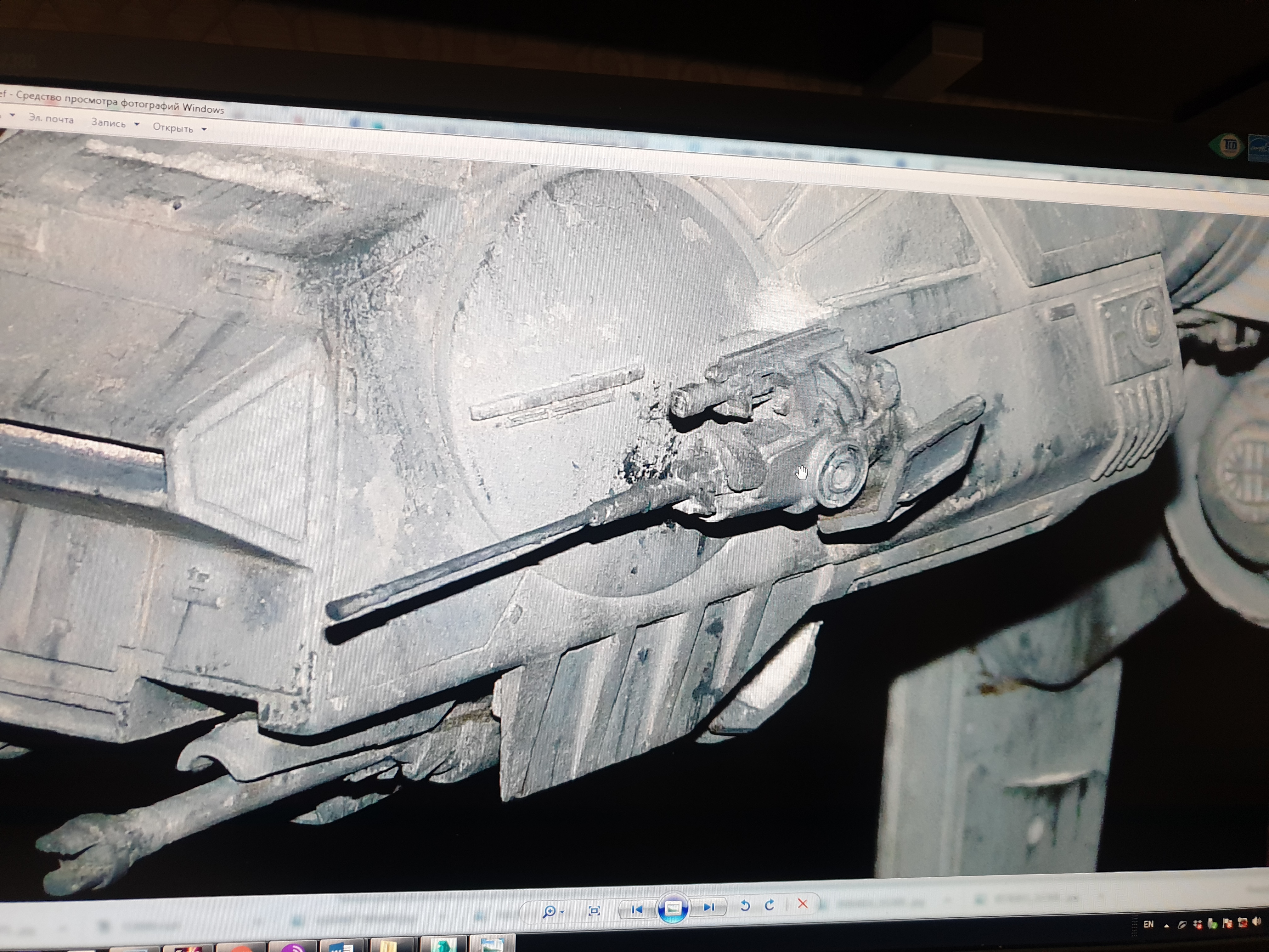

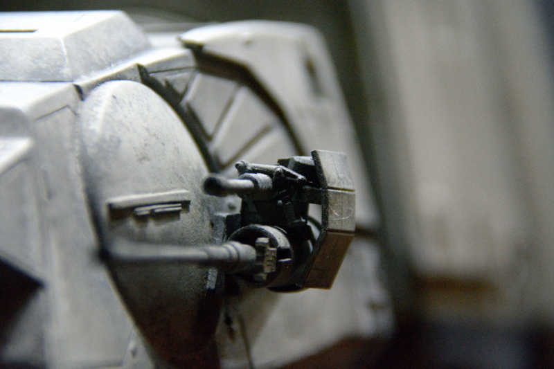

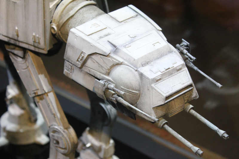

Sorry it took so long, been super busy with work, but here is pictures of the Bandai part
Let me know if you need different view or angles or if you want me to try getting a more in focus/better quality shot for any of them ( I just quickly set up, so no tripod and autofocus left some things a bit fuzzy)
View attachment 1463954View attachment 1463953
Theyre fantastic photos! I really appreciate you posting those. I was starting to work off of some renders but these help so much more.
Unfortunately all the photos taken of the studio models are not quite clear enough.
Cheers,
Josh

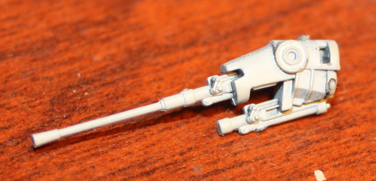

Absolutely crazy to think this thread on upgrading a few things has hit 12 pages. It's fantastic to see how many guys got involved.

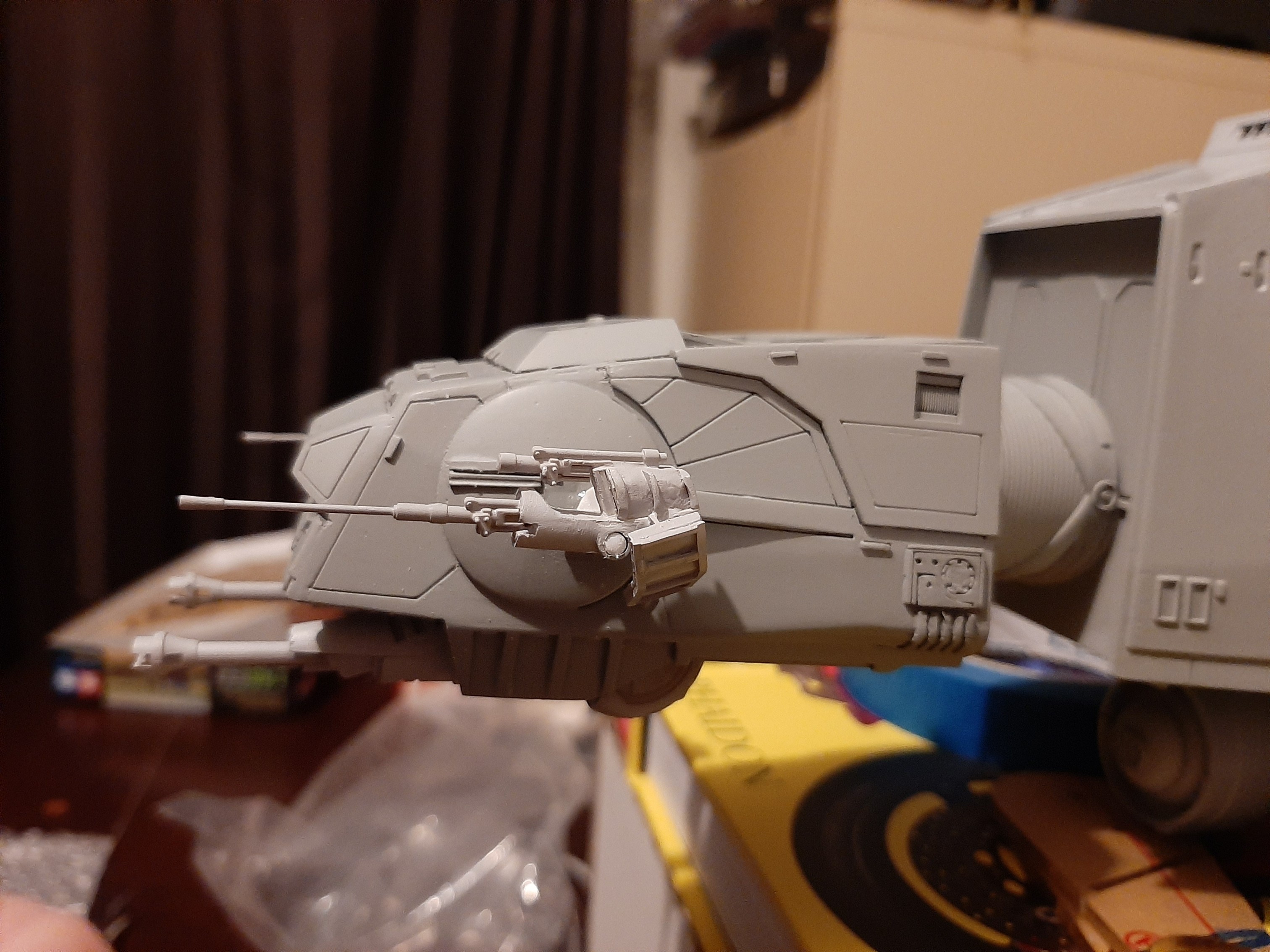

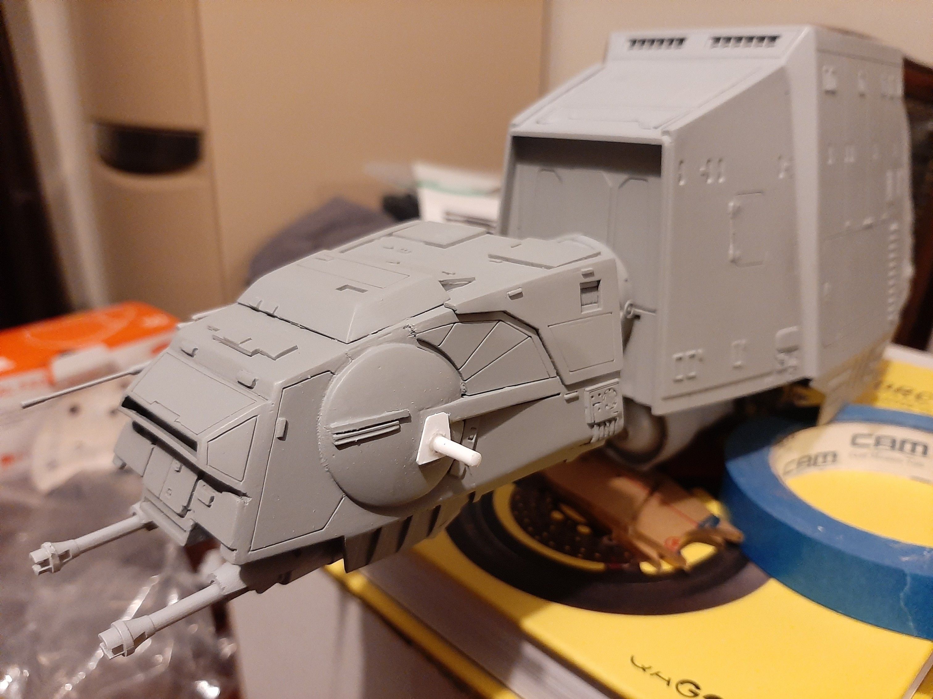

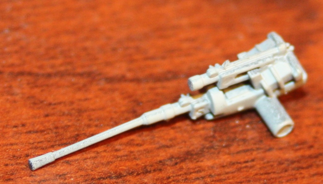

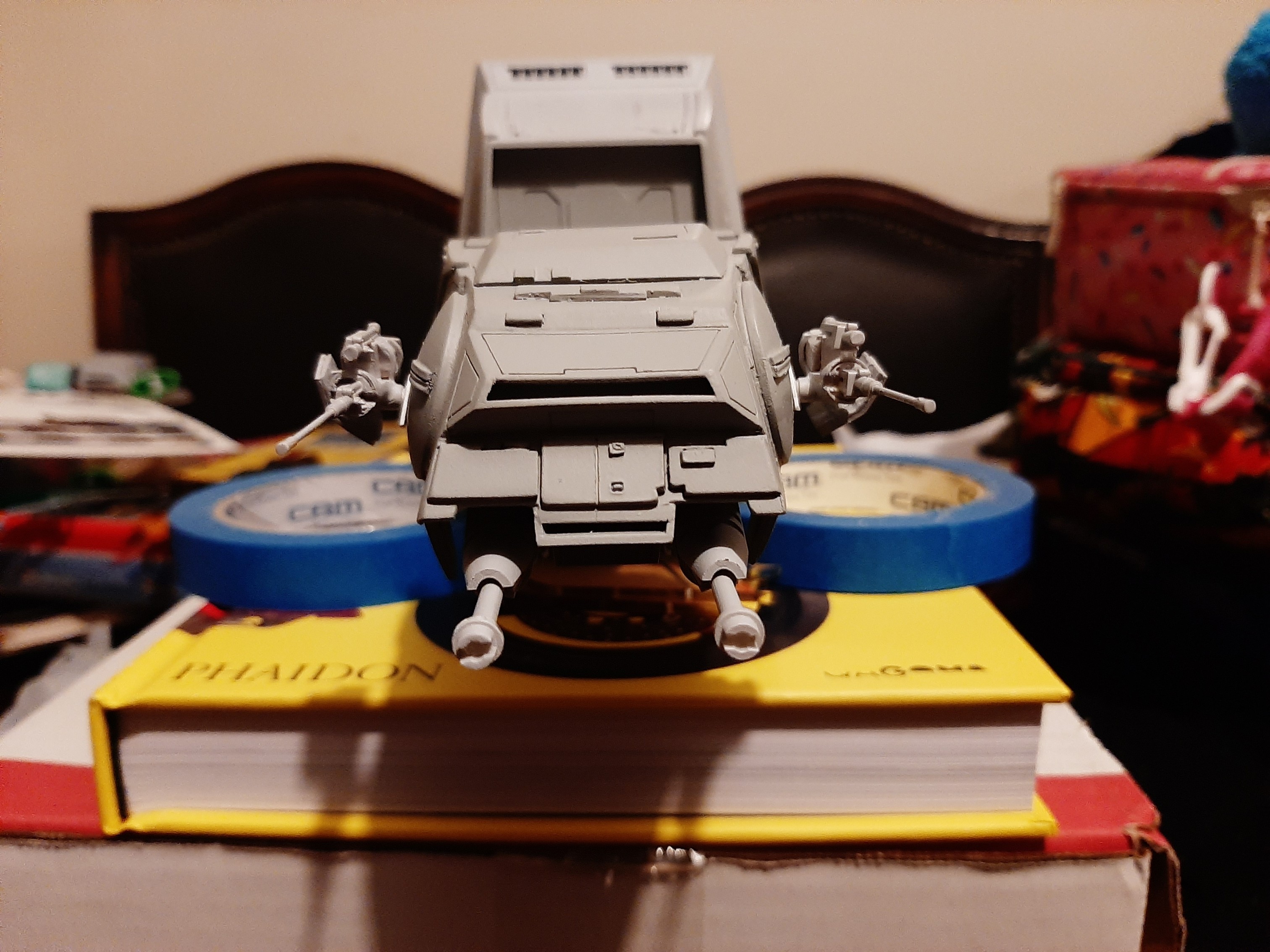

As promised here is a pic of the kit pieces from the Flakvierling that I believe are used on the feet and top of the body sides

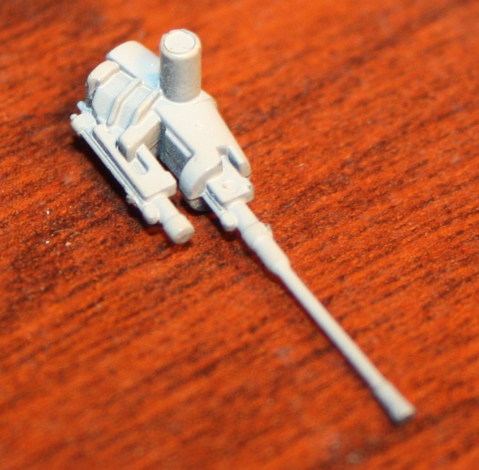

So moving forward. It has been a very challenging few days trying to create the cheek guns. Im happy enough with the results, a little rough around the edges but was no small task. I don't think I could have achieved this without the pics from Analyzer so thanks mate!
I started with the cylindrical exhaust from a 1/35 Tiger tank and trimmed into it the front angle. I then cut it in half and added some brass tube in between the 2 halves. I built the finned piece at the back from modelling clay and baked it. then I fitted the guns. The armour plates are the revell ones, trimmed out of their original fixture with new rear supports added and the frames.
Much like on the original Revell head I drilled and fitted a rod right through the head to support the cheek guns, it is fixed in place and the cheek guns slide over the rod and can be individually pivoted up and down.
And the result
I hope these look ok. They seem ok to my eyes here, the camera shows a lot I cant see however.
And the result

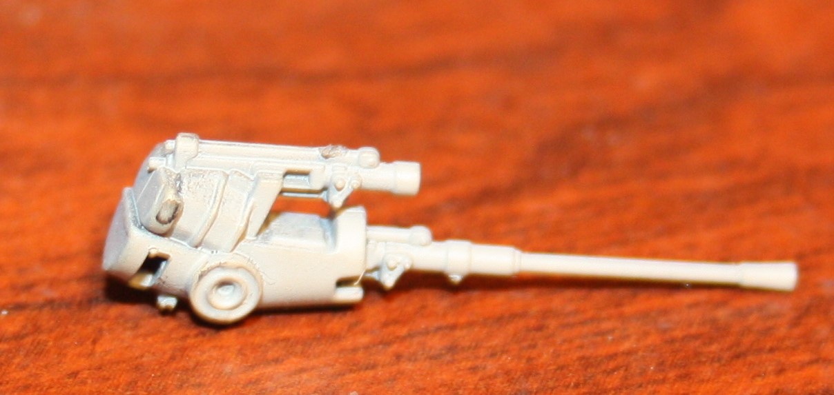

Nice! Do you have a comparison shot between the original kit guns and the ones you show here? Minus the armor plate of course. One additional detail that seems to be missing is the rectangular "action extension" piece behind the long barreled gun in the scooped out part of the mount (your finned piece from clay? Wow). It will help make the gun look like it extends through the mounting instead of just cutting off. At any rate, these look really good so far.
I dont think it's missing, the full action is there. I think I made the rear piece too long making the action appear short. If that makes sense?
Yes I had modelling clay left from another project and rummaging around looking for something like that rear piece I came across it and figured, oh well, modelling clay it is.
Unfortunately I destroyed the Revell guns chopping them up but Analyzer may be able to share pics of his? They were an open molding on the inside, no detail, wrong shape and awfully bulky.

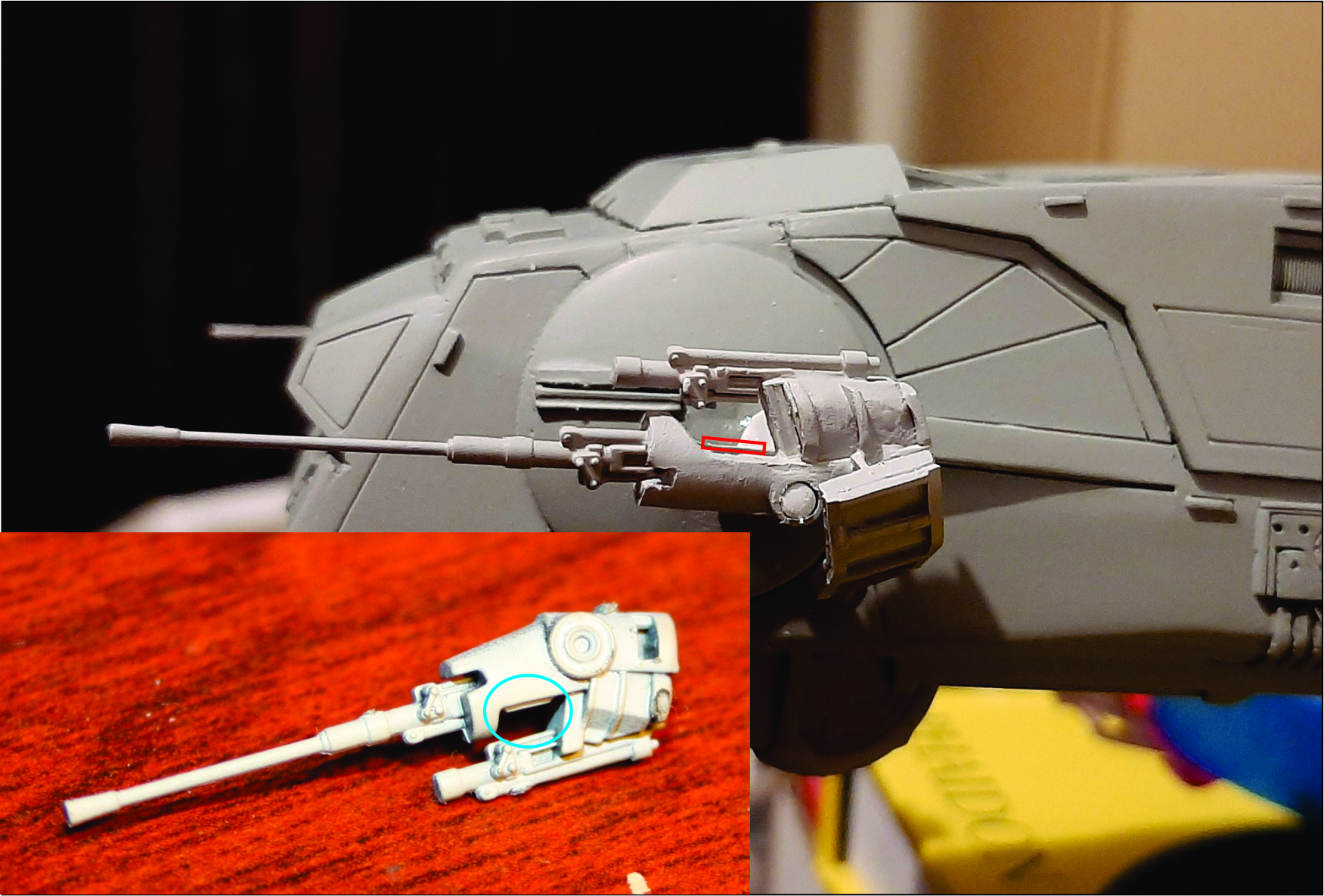

I might not have explained very well what I was looking at or maybe it is there and the lighting/shadow is messing with my eyes? Here is a picture of what I thought was missing. That small rectangular bump makes it look like the gun passes through the bracket mount going over the top.
And yes, I see what you mean by the exposed action on yours maybe being too long. The top action of the long gun is only a little in front of the end of the top gun on the Bandia and cast replicas. There is almost no rectangular slot showing. I actually like what you have better. Makes it look like there is some recoil action.
And once again I must say that your sculpting abilities are impressive.

My apologies Hagoth, I thought you were referring to the top. I had totally missed that detail behind the lower gun. I think you're correct that it is probably the action where the gun is inserted into the retainer. I missed it and cut the gun short. It's a good catch for future designs. Hopefully we establish what more of the pieces used for the cheek gun assembly are to allow a better rendition in the future. Im actually happy I managed to construct something that looks like the studio piece at all, like I said theyre a little rough... should probably wear my glasses more... but from more than 40cm away theyre fine. And paint and weathering will help this model a great deal.
Interesting the guns different on that studio model. I had thought poor photo's were deceiving me but Im quite certain there's 2 different styles of cheek guns. Like the Bandai where the retainer ramps up, and that picture you posted has what seems to be an arch around the end of the retainer instead of the ramp.
The sculpting wasn't too difficult, i was able to flatten the clay to the desired thickness and its a fairly firm product so I mostly trimmed the shapes with a blade, and trimmed the finned pieces separately and added them on before baking. It's a trick I need to keep in mind for the future.

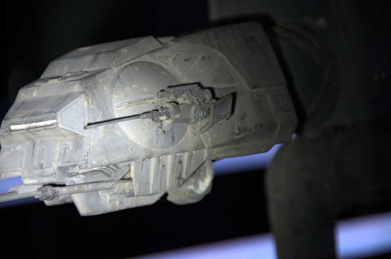

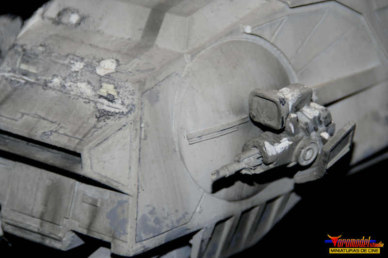

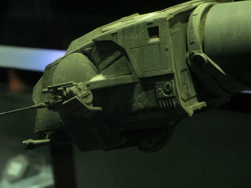

I've seen pictures of models where the cheek guns seem to be upside down. Small gun thing at the bottom like in the Revell picture. I don't remember seeing that in film. Maybe ROTJ? And I agree those original kit guns look quite clunky. But then again advertise the short comings and nobody can rightly complain once getting into it? Yeah right. The result is threads like this one! :lol: Any missing details aside your guns look awesome compared to what you had to work with out of the box. That's the comparison I wanted to capture.
I've been looking for better detail pictures of the original studio model cheek guns. From the resin casting it almost looks like the long barreled gun was set in a cradle with a bracket loop over the top to hold it in. Gives an interesting perspective of what the pieces may have started out looking like and a clue of maybe where to look in donor kits.
What I see on screen in ESB matches configuration 2. That's my favorite configuration. Do we ever see on screen versions of the other two?

Looking back at the bandai guns and my feelings, looks like the cradle is 2 pieces joined by a circular hinge, with the rear half being hinged upwards sonewhat. Whats your interpretation of this?
Thru my research, of the three studio models, I found each head had different cheek guns. It depends on which model you prefer.

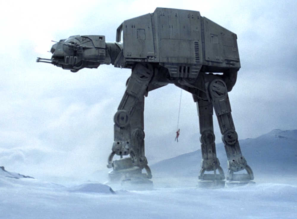

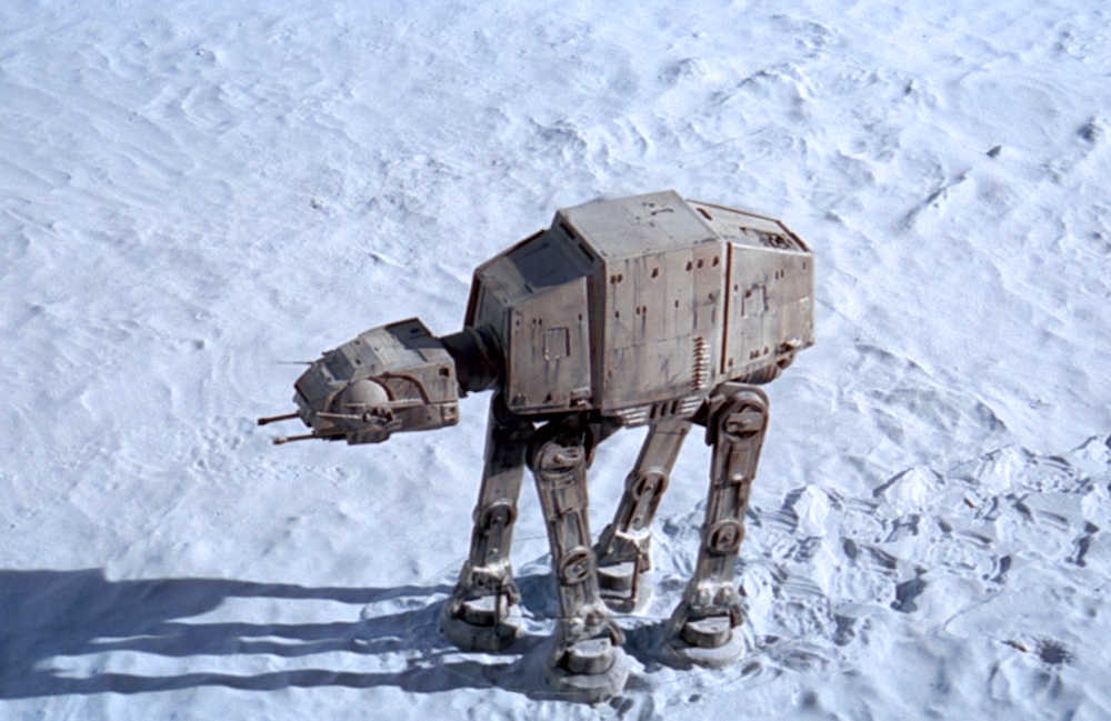

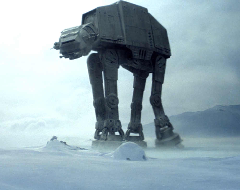

Analyzer is correct. Looks like the cheek guns are upside down in at least one walker in RofJ. See time stamp 0:33 of the surrender of Luke. With the frame full screen it looks like these are ESB configurations just turned upside down. I can clearly see the shorter second barrel on the left side. Maybe that was to position the armor plate pointing up and keep the Ewoks from dropping rocks on them from above. :p Spot lights are on the inside of the side guards for the chin guns.
Oh and in the sequence I linked earlier at the time stamp 0:59 you get about as clear a shot of teh cheek guns I have found. Top one has a hole down the center of the barrel. Based on the number of shots coming from the cheeks I think it's a secnd short barreled medium blaster.
The suspected cheek gun cradle reminds me of a double suspension arm with the pivot in the middle (maybe from a tank or tractor?) with one end cut down and some type of shock coil stuck on the top back side. You could be right that it's a two piece cradle with a hinge in the middle like a wall anchor. I can see it both ways so its really hard to tell.
AT-AT 01 was animated by Phil Tippett - closer to the camera
AT-AT 02 was animated by Doug Beswick - the model in the BG
AT-AT 03 was animated by Jon Berg - the model in the middle
