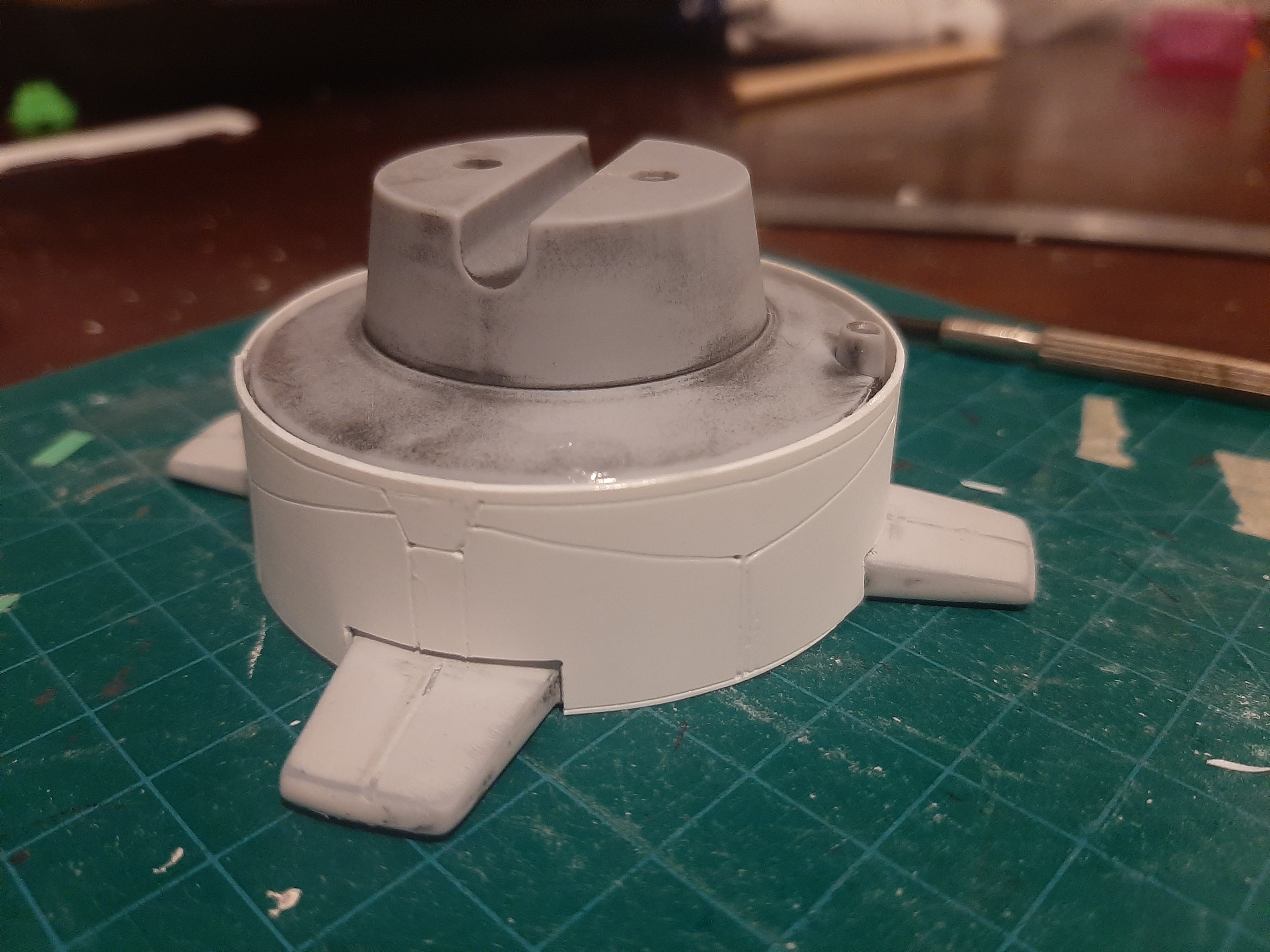

The kit feet are totally inaccurate, have raised lines instead of panel lines and are basically the wrong shape. I wont address the shape too much but am attempting the panel lines and detail. Disclaimer here, I build and paint a kit ok but when it comes to making stuff out of tiny bits of plastic... it's not my forte'.
Here they are versus the studio foot:

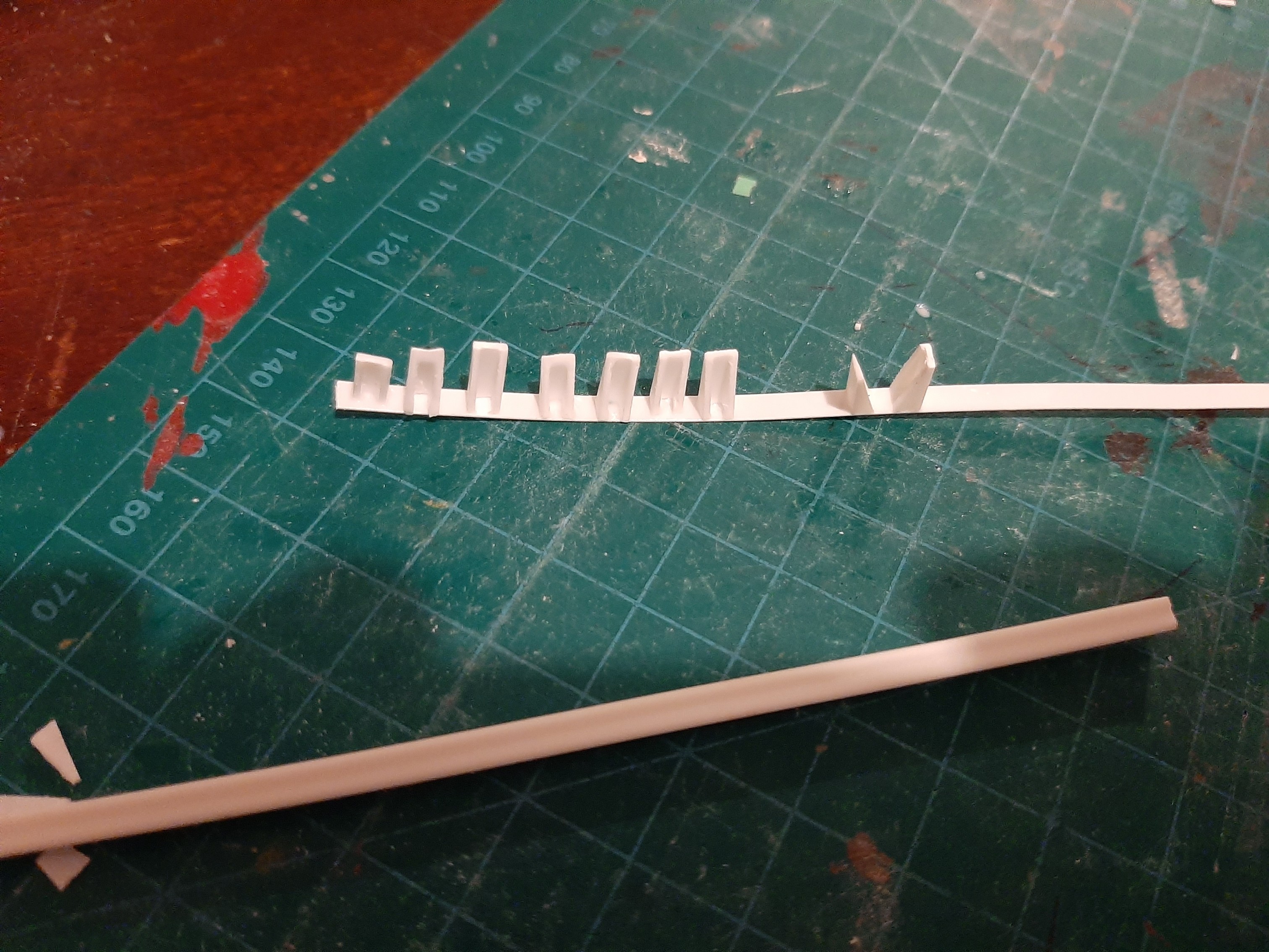

I tried scoring new panel lines but struggled too much on the curved surface. I decided to make styrene strips to glue over the top. Now the laser is not particularly good with styrene as it melts but figured maybe I could get an engave of linework. I made a carboard template and drew it in Corel and managed this. a few holes and melted edges but we can work with this. sorry it's dark... was hard to photo.
From here I scored the lines a little deeper, cut these out and glued them around the foot like so:
Made a bunch of pieces that go above the 'toes' from styrene box and strip.
I sanded off the shock absorber mount, added a new one and filled the gap between the styrene detail strip and the foot upper. and a light prime to show the looming results.
Still some finishing work to do here and work on the upper foot section but hopefully this is a strong improvement over the kit foot and I'm not embarrassing myself too much. Currently finishing up this process on the other 3 feet.

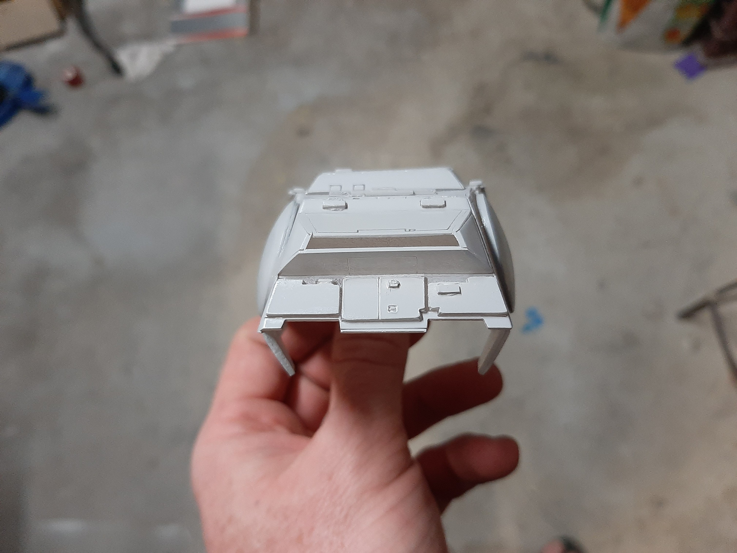

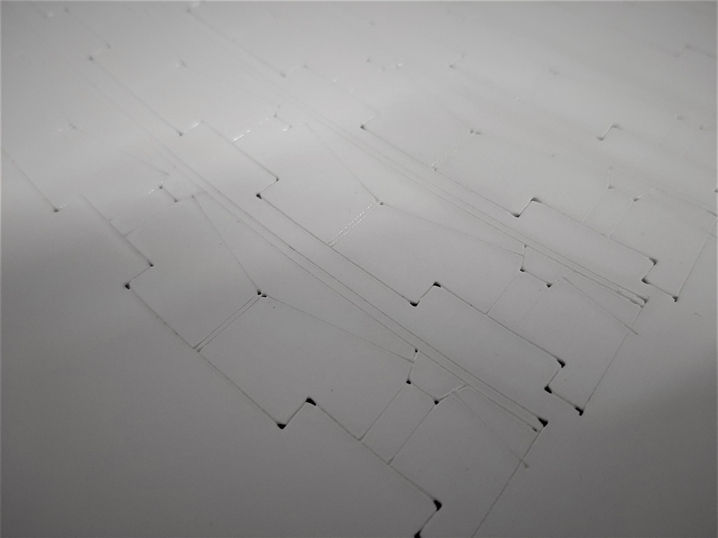

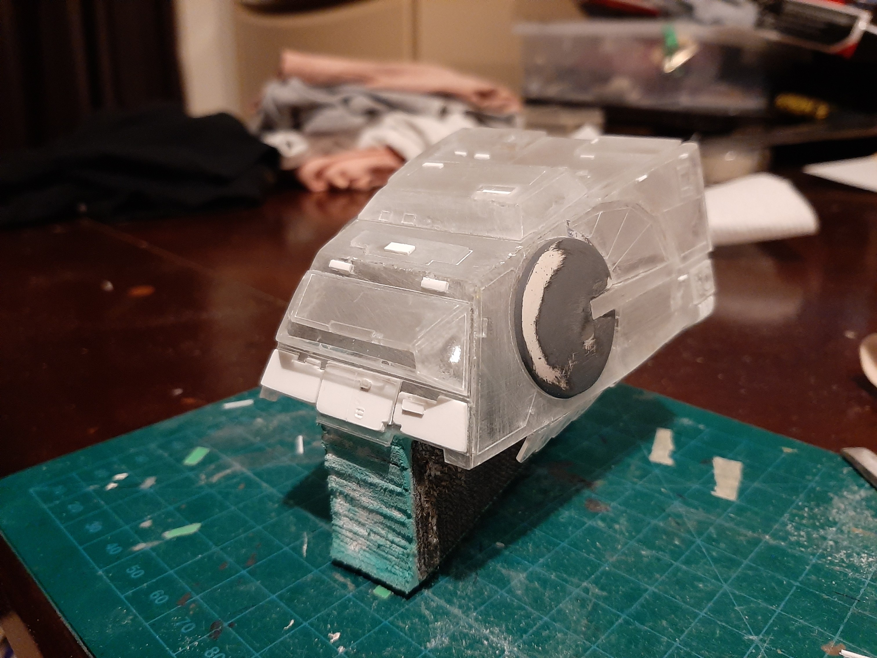

Ok, I have made some progress on the head. I said in the beginning scratch building is not my forte' so there is a fair bit of effort so far.
Using Baloo's profile shots and cross referencing his layout of pieces I drew my own in Corel that I cut out of 1mm acrylic on the laser. I moved away from Baloo's plans in a few areas to make, what I thought, construction easier. Notably the rear section of the head has the bar attached with upper and lower sections making it simpler to jigsaw together. These gave me a great starting point. Did not fall together, has required some fitting and sanding but overall a big help. I'm happy to post this file up to help anyone that might be able to use it.
Since then has just really been jigsawing everything together. Now this is not finished, still needs further construction, filling, a few more details and lines scored. I sprayed some fine surface primer on there to highlight the details and see the imperfections to rectify.
In acrylic:
and with some primer:
and next to the Revell head:
Hopefully this is headed in the right direction. I feel it is much closer to the studio model now.
Cheers,
Josh

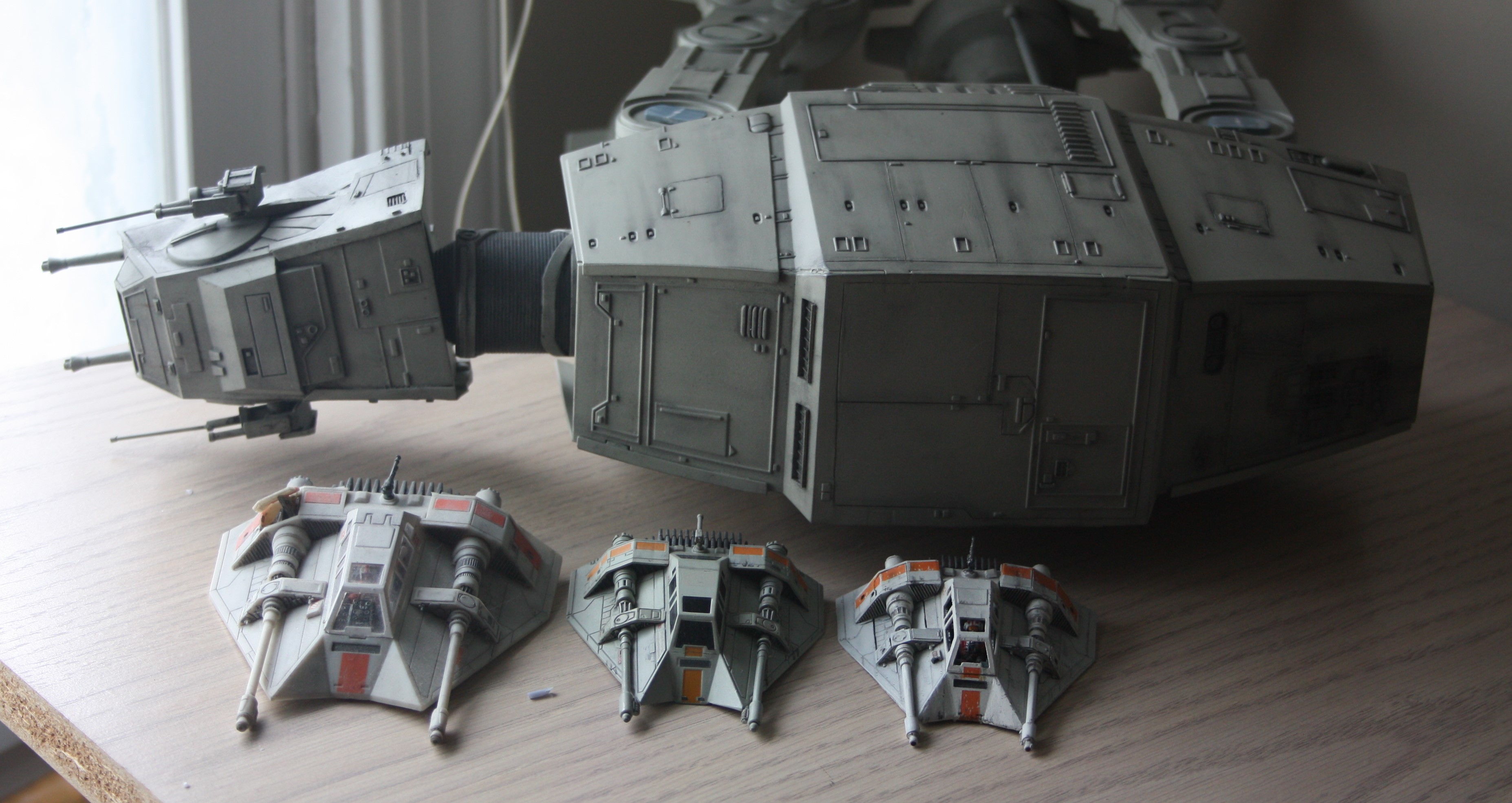

The Revell AT-AT is definitely closer to if not spot on for 1/72 based on height if upscaling from the Bandai 1/144 AT-AT size. although some claim is as 1/53.
That being said, there is the Revell pocket Snowspeeder which is around 1/53 or so, maybe as small as 1/57.
There is also a DiAgostini diecast Snowspeeder from their vehicle collection that is something like 1/70 scale. It is a great match size wise
However, it has no interior as the canopy is solid and the glass just painted black
There is also the RetroSF snowspeeder

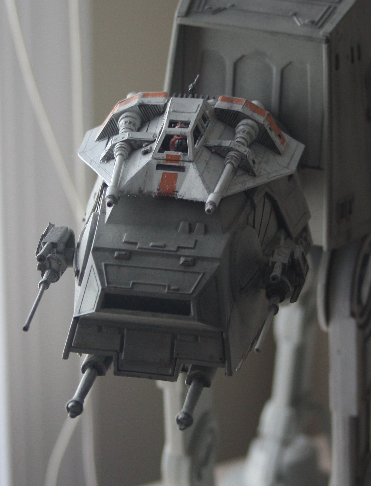

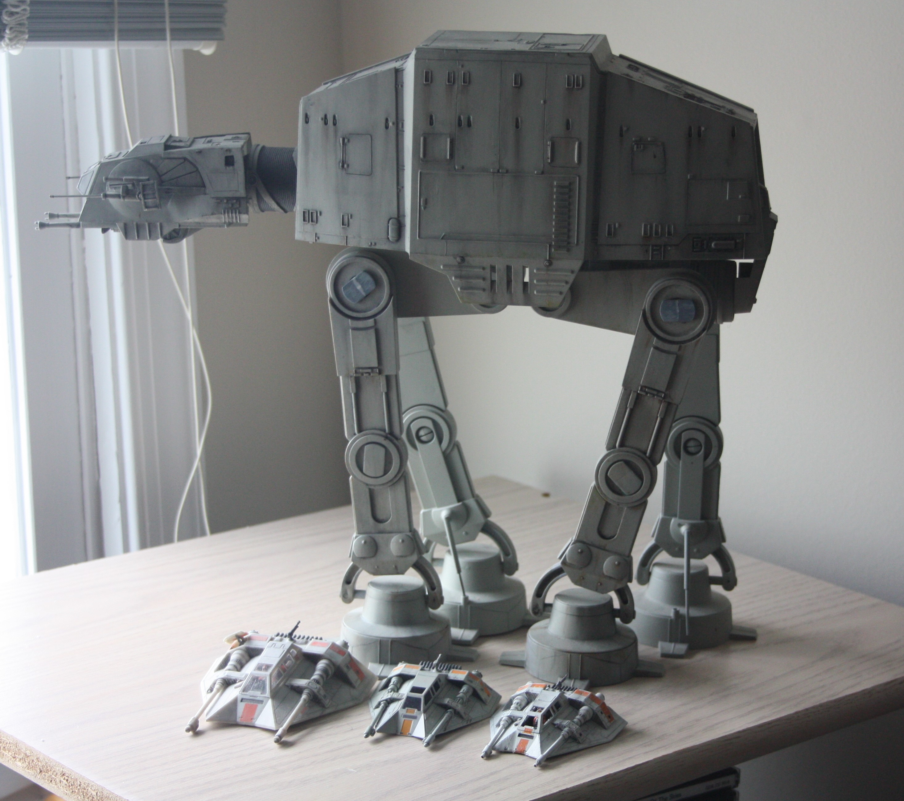

Analyzer

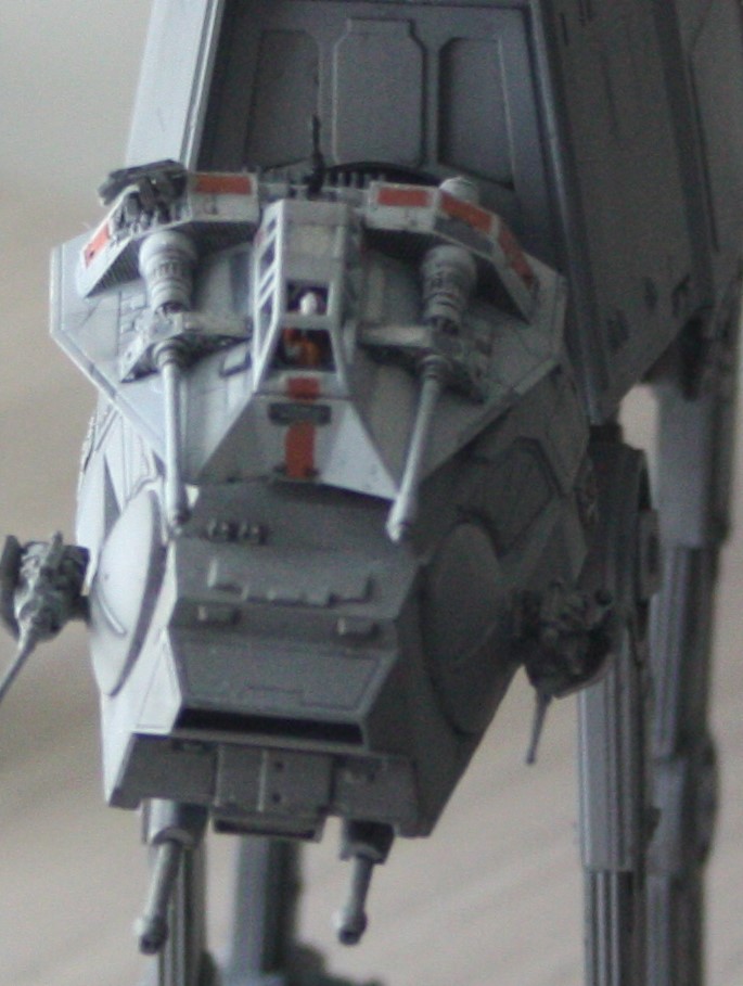

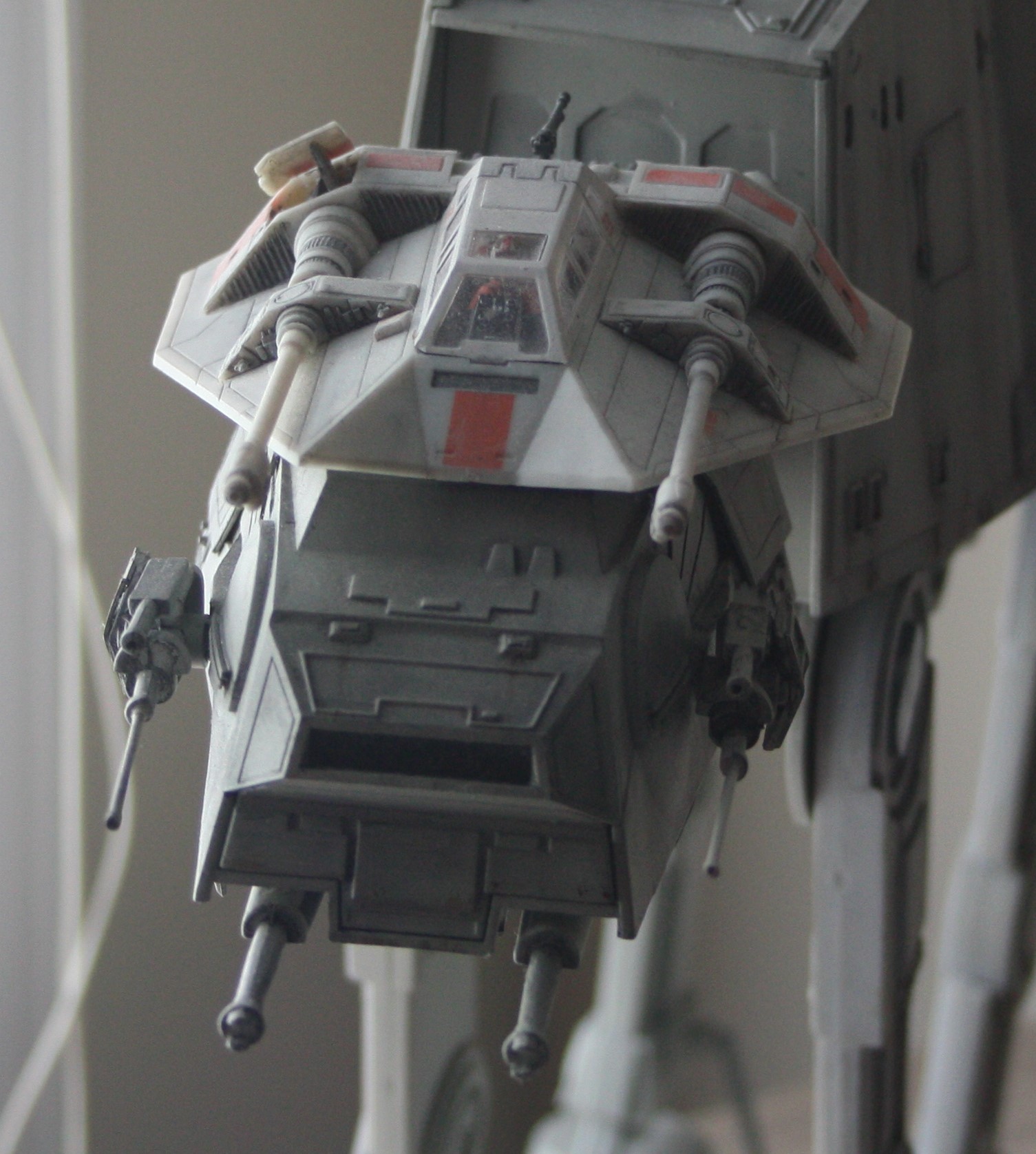

Forgetting about scales and using a more visual comparison of relative sizes
here is what we would consider the "standard candle" of a Bandai 1/144 AT-AT head to snowspeeder ratio
Here is the ratio between the Revell AT-AT and the RetroSF 1/72 Snowspeeder
And here is the Revell AT-AT with the Revell pocket kit snowspeeder
And here the Revell Snowspeeder on the left with 1/72 REtroSF Snowspeeder to the right of it compared to relative sizes of the Bandai 1/144
From left to right Revell, DiAgostini, RetroSF
starks
analyzer
Fantastic comparison shots!
You confirmed my feelings about the scale so thats good to know. I cant see a 1/53 person standing inside that head very well.
I'm thinking the Retro speeder may be the way to go. That deago one is nice also but given an option would prefer to see a cockpit.

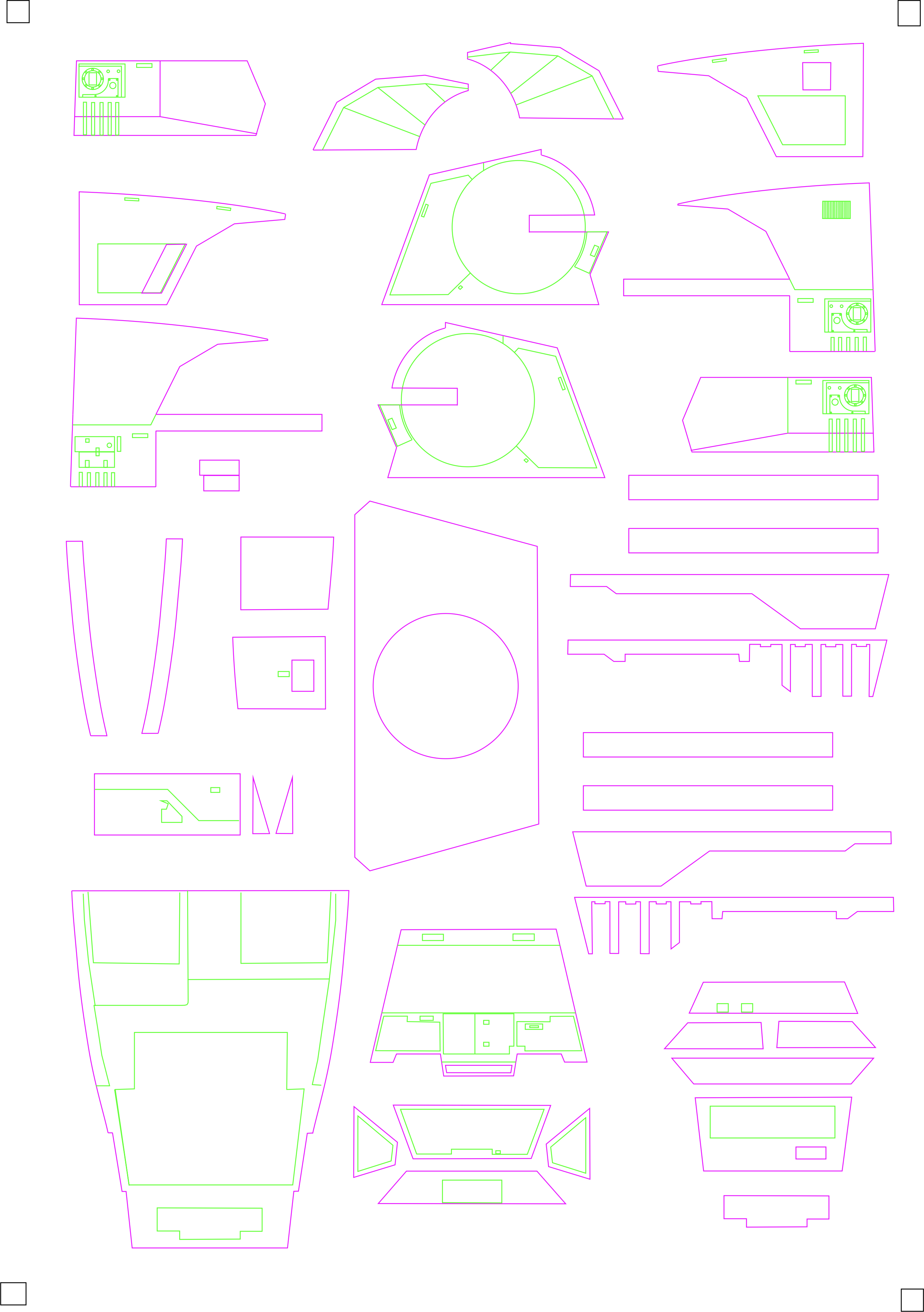

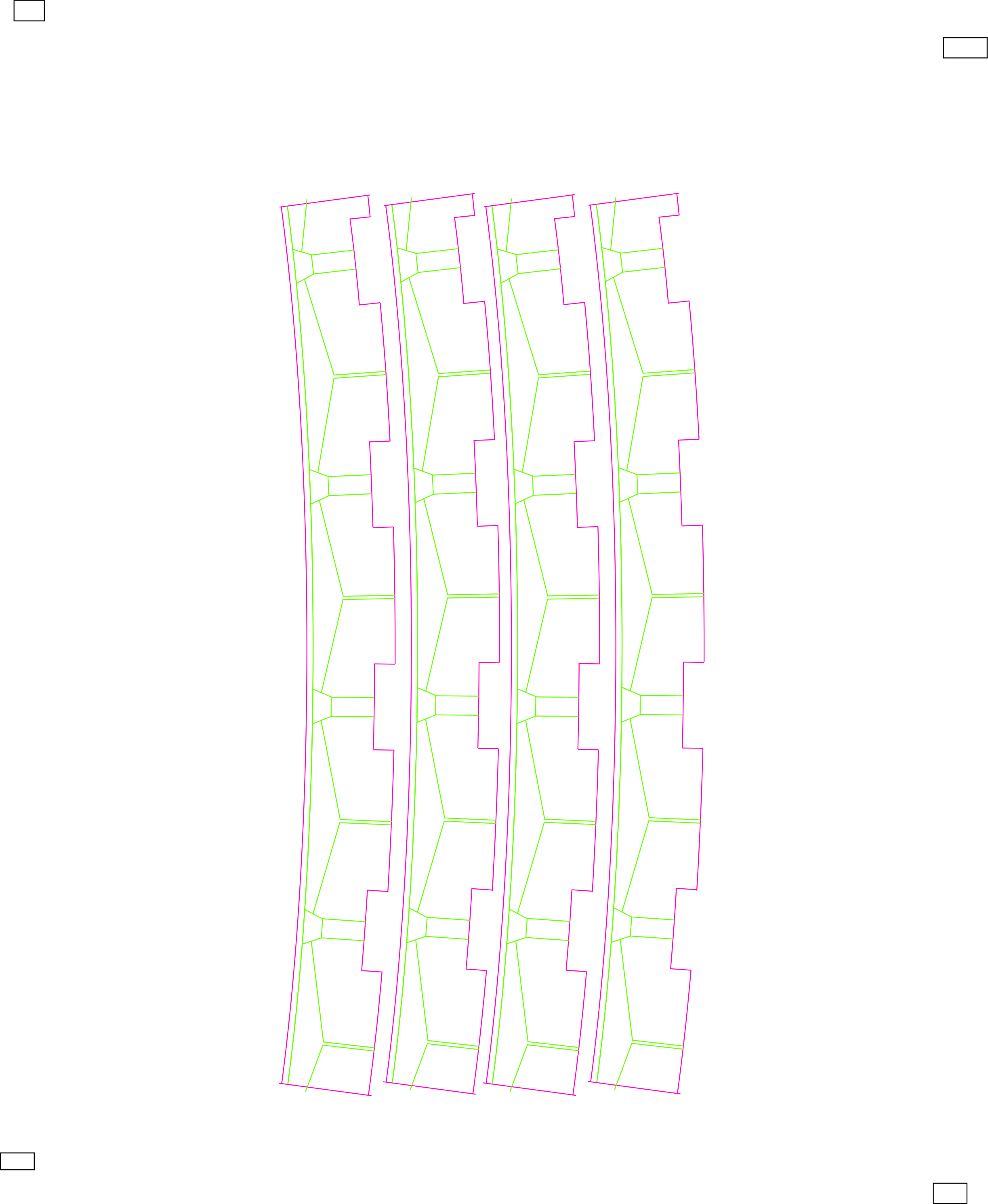

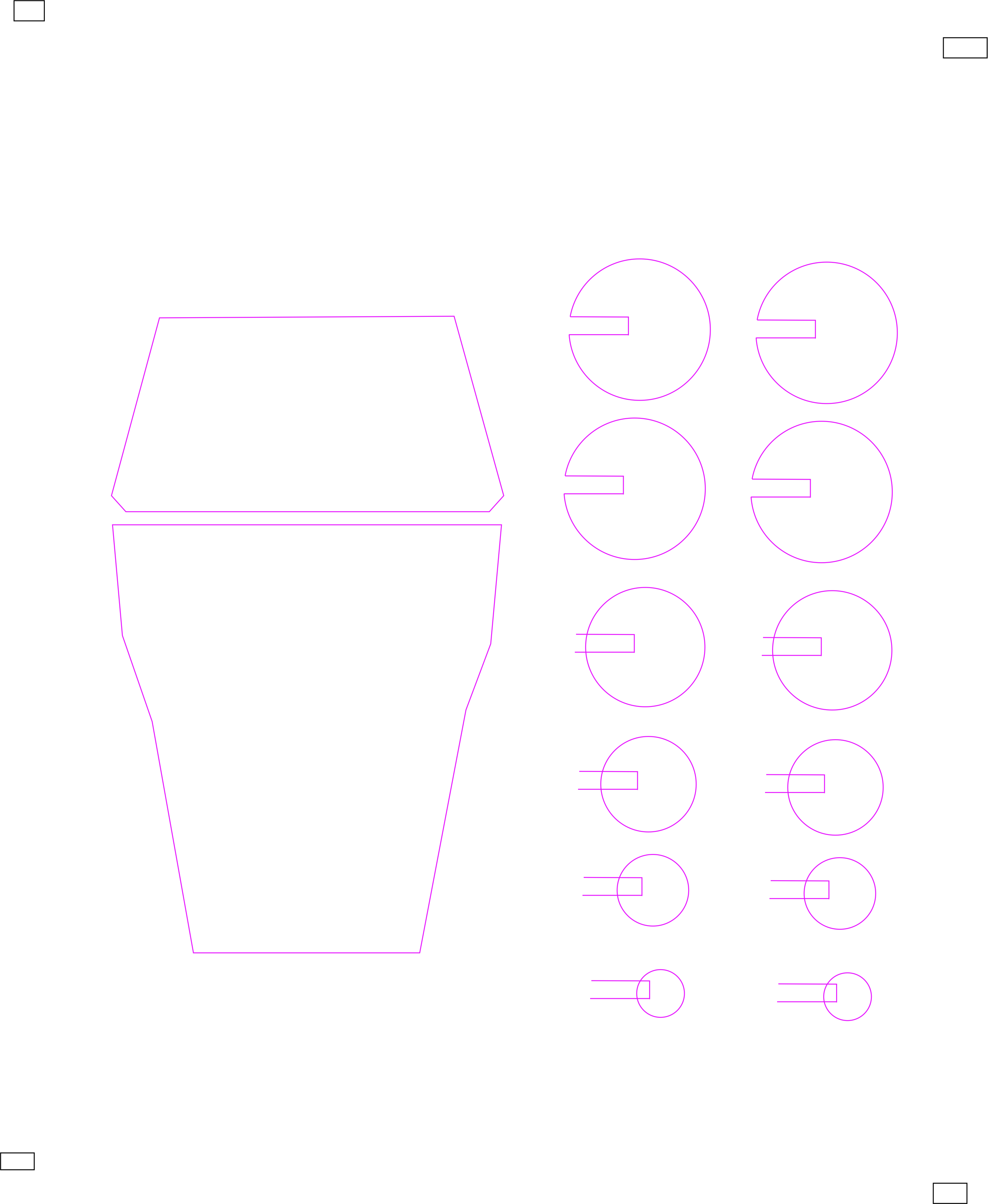

ok hopefully these work. I've exported them to JPEGs. If another file type is required I may need to email it to those who need it.
Some of these pieces will be a little oversized and require sanding after gluing together. These will definetily allow you to create the upper portion of the head...as you can see I achieved, but as I only initially drew these for myself some parts need a tickle :)
If there's a better way to upload the files and someone can let me know how I'm happy to do it.

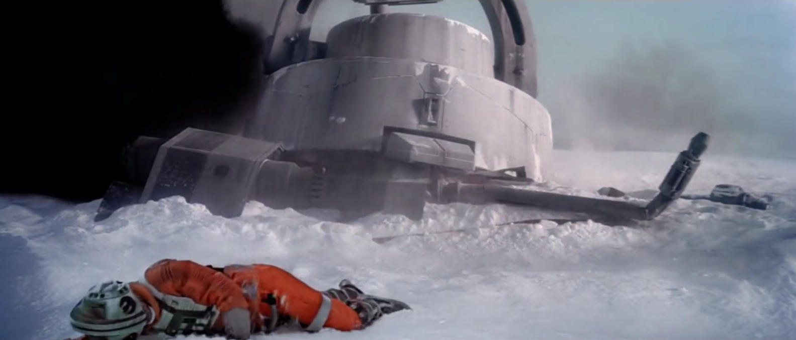

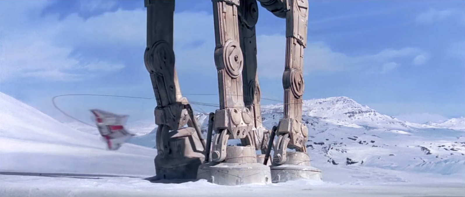

Sym-Cha
So I took some screen grabs from youtube of the Hoth Battle scene ... and it feels to me ... the snow speeder is quite small in comparison ... perhaps even a tidbit smaller than the RetroSF suggestion made by Analyzer ???

Nice upgrades sofar Josh :)
Chaïm
Thanks Chaïm ! And thank you for the kind words. These pictures are a great help. And I like information added to the thread to help others in the future. The big thing that actually just stood out to me was the detail on the front edge of the legs in that second photo.... that's not on the Revell model.
That first picture is exactly what I envisioned building as a diorama so thats great! All feet on the ground so don't have to do undersides... and one rear left foot covered in snow even better so I can hide my one foot that just wasn't quite right haha.
On topic of snowspeeder scale. I see a continuity error here. You're correct even the retro does look too big in those shots of the speeder whipping around the legs. But not so much when under the foot... I would say it is actually quite reasonable. Back to the old chestnut of a film was not meant to be analysed this intently.
By the way am I seeing this incorrectly or does that speeder have grey markings on top and red on the bottom?
I dont have the ability to 3d print so am a little stuck to what I can buy and I feel the retroSF kit should be close enough.

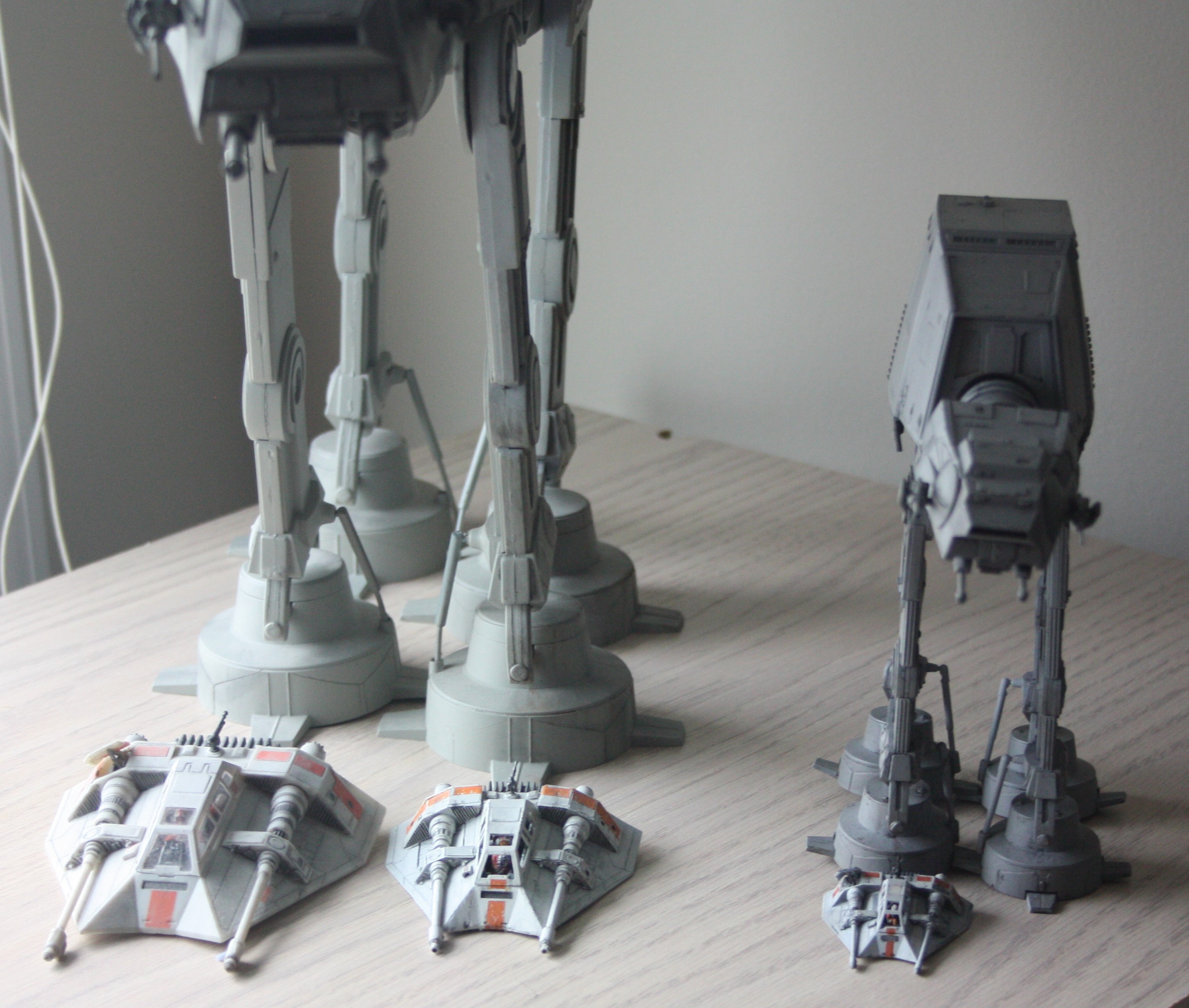

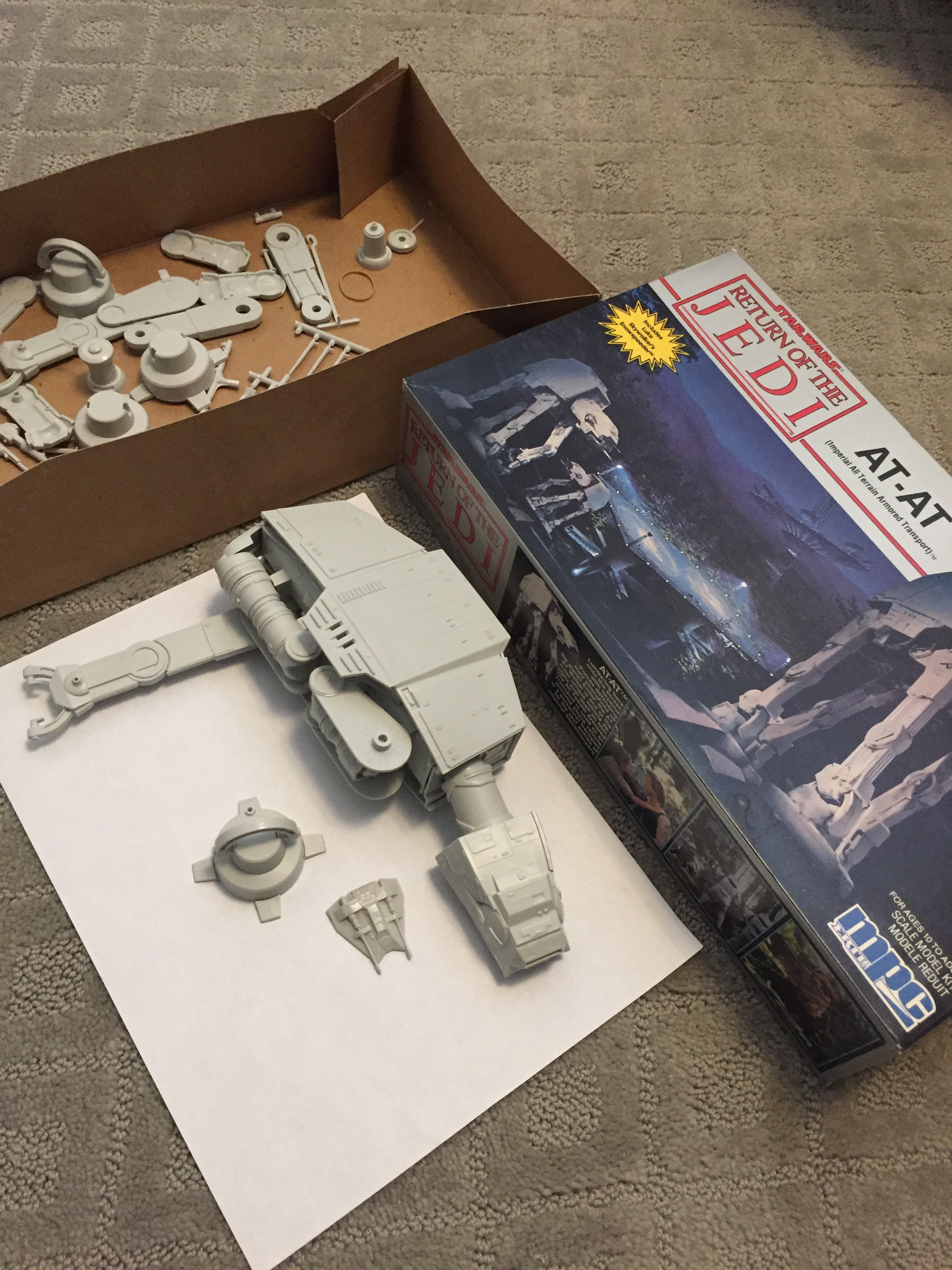

Not Analyzer of course but I do know the kit you are talking about. I have two of them. It was the Return of the Jedi MPC kit. Here are pictures for scale to a piece of paper. Snow Speeder seems too small per the foot picture above but about right for he head shot. Seems I have misplaced one of the speeders. :unsure:
Analyzer
Yep, that is the one
And that snowspeeder is almost the same size of the Bandai 1/144 Snowspeeders, just a tiny bit smaller despite the AT-AT being larger than the Bandai one
I guess since the 80's when that kit came out, it has always been my frame of reference for the relative size of the AT_AT vs Snowspeeder
It may be technically flawed, but it is not far off. For a long time the AT-AT was undersized and that why the 1/144 F-Toys AT-AT wound up so small
