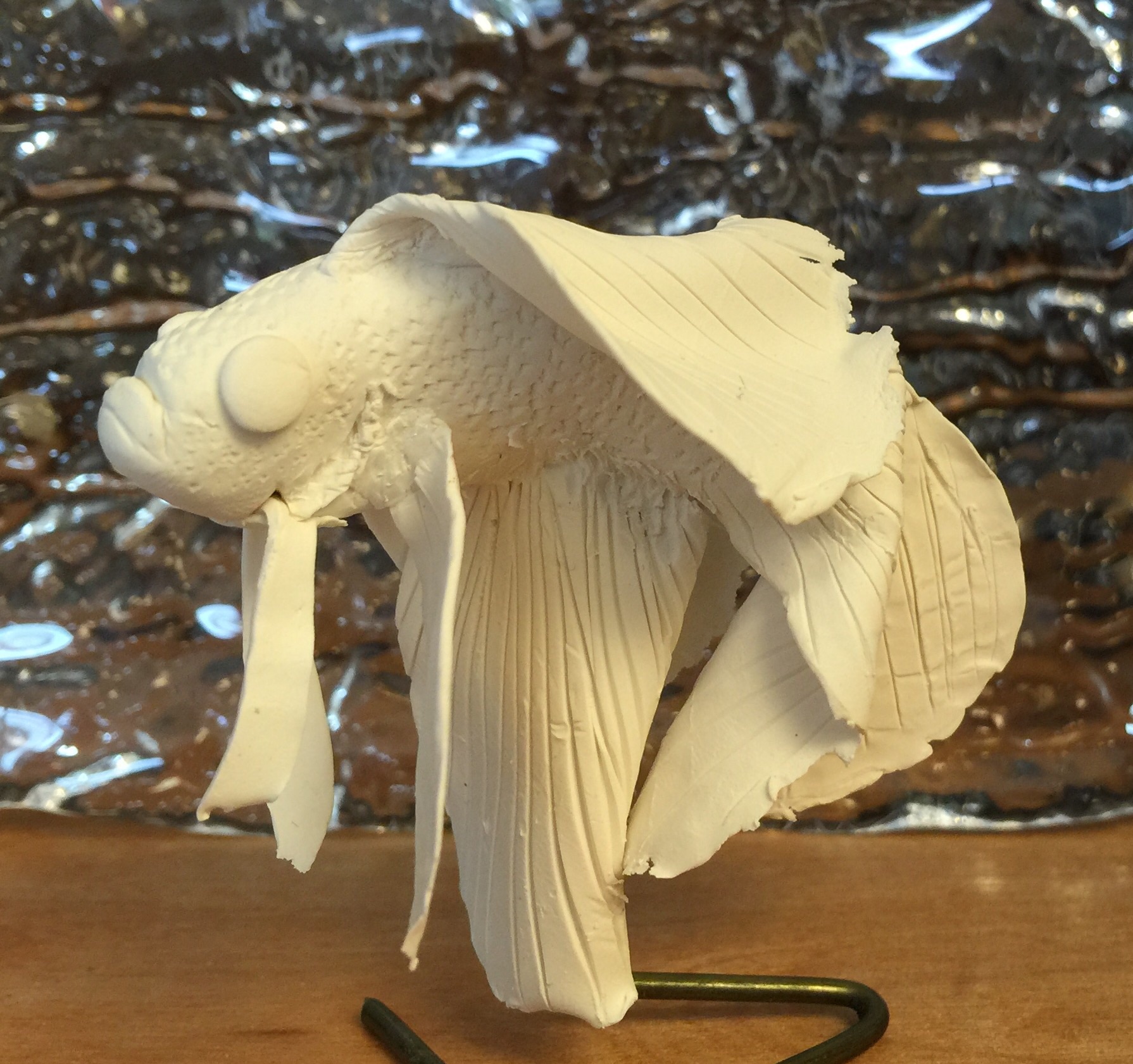

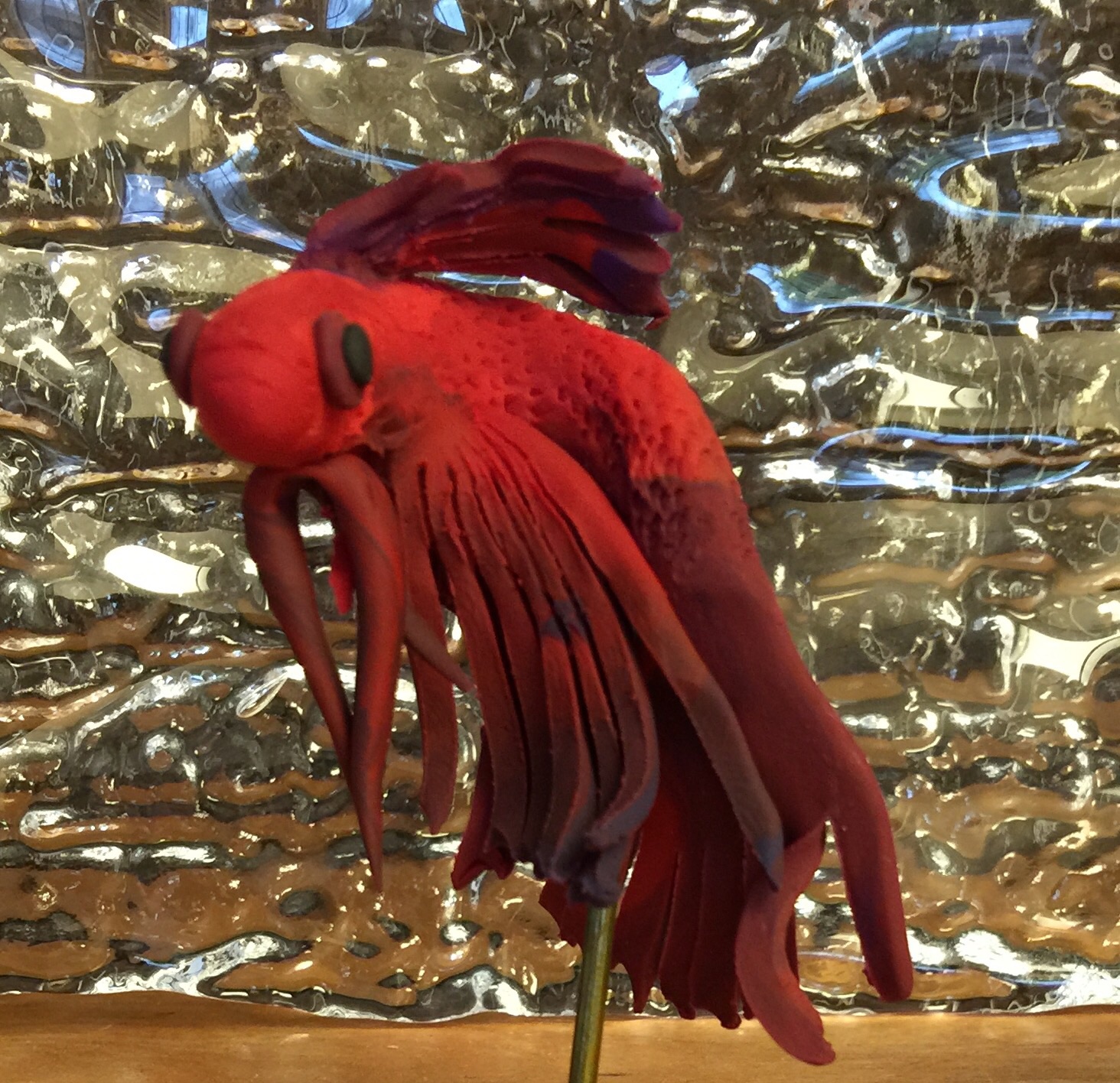

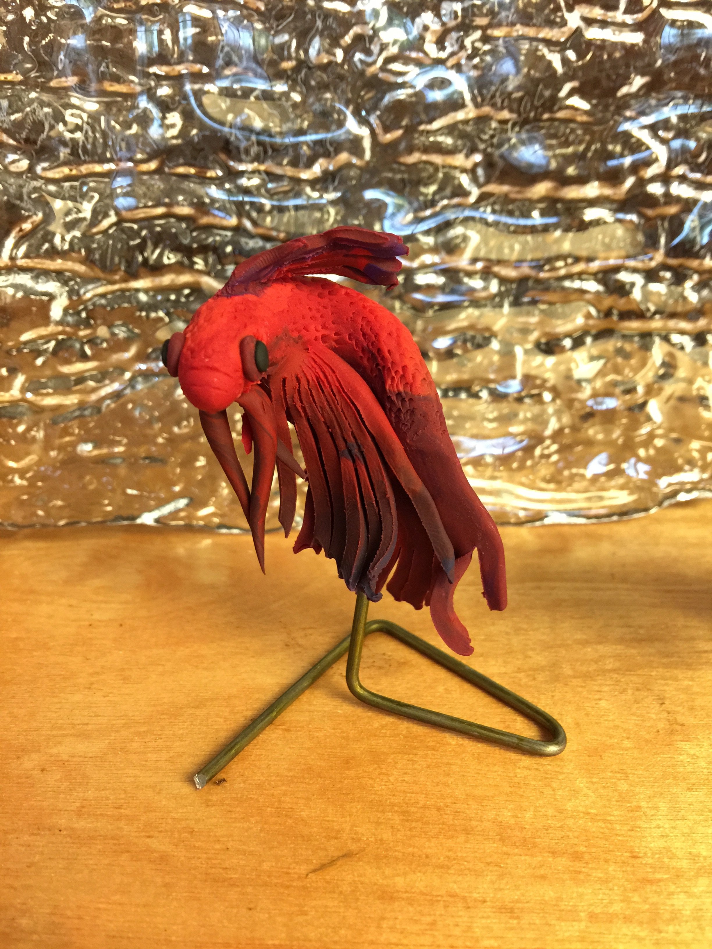

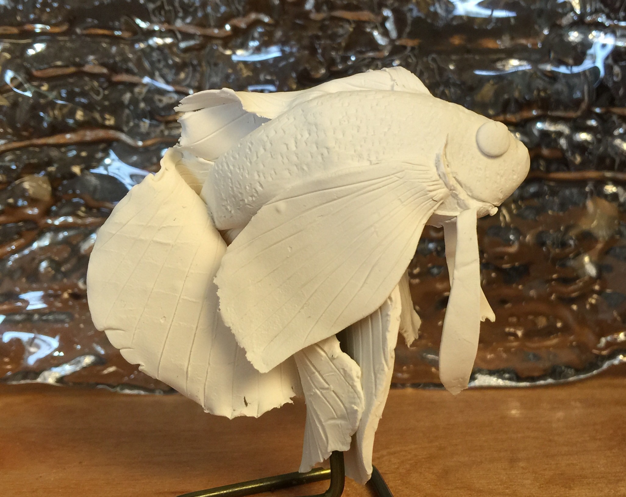

Tigerpounce
Thank you both for the wonderful advice.
I am going to start small. I'm thinking betta in a wine glass. I have two very rough ones made up. One fell and shattered his back fins, so a good lesson in fragility.
