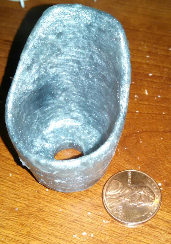

After some trial and error I have finally successfully made my first cast. Though i am noticing that due to its thickness, when i squeeze it feels like it will break, and I know if i pinched hard enough I will crack it. This is a shape i cast for a muzzle brake for a blaster i am making. Now is there a way to avoid this concern of flexibility/potential cracking?
I am pretty sure it is probably due to the type of resin I used, which is this Castin' Craft Liquid Plastic Casting Resin I found at Blicks.
http://www.ebay.com/itm/like/151548096356?lpid=82&chn=ps
Any resin suggestions?

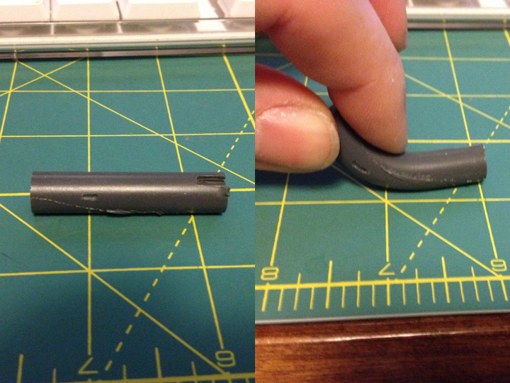

Here's one result of a bad mix. A two part, 1 to 1 resin, and I messed up the mix by not having enough part A. The cast is about 3 weeks old and is like a piece of rubber. I've kept it just to see if it's properties will change over time.
LOL - not yet!
