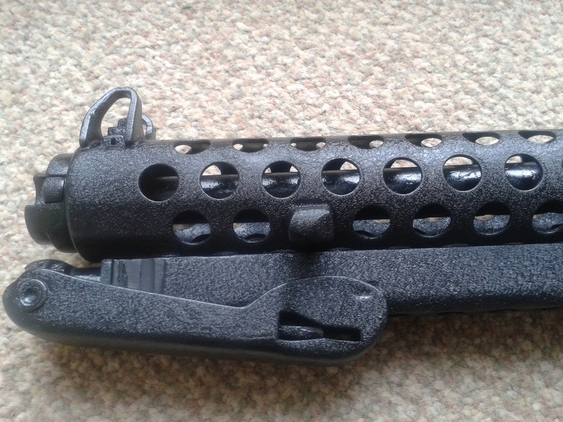

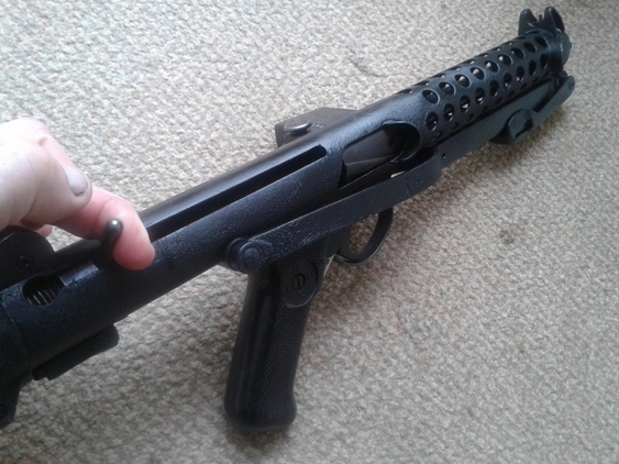

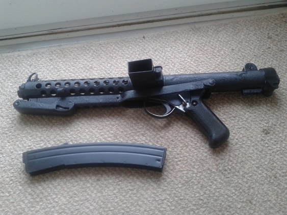

Hi Guys,
Im going go for it, this is the one I can get:
809441_-_photo_16_1463837666_img.jpg809441_-_photo_17_1463837667_img.jpg809441_-_photo_19_1463837668_img.jpg
Its deactivated 9mm,new spec, trigger moves, mag releases,stock folds and cocking handle pulls back . It has the deactivation certs. Im assuming that with its deactivation cert that its legal to own!
Im going to go for it :)
Lee
