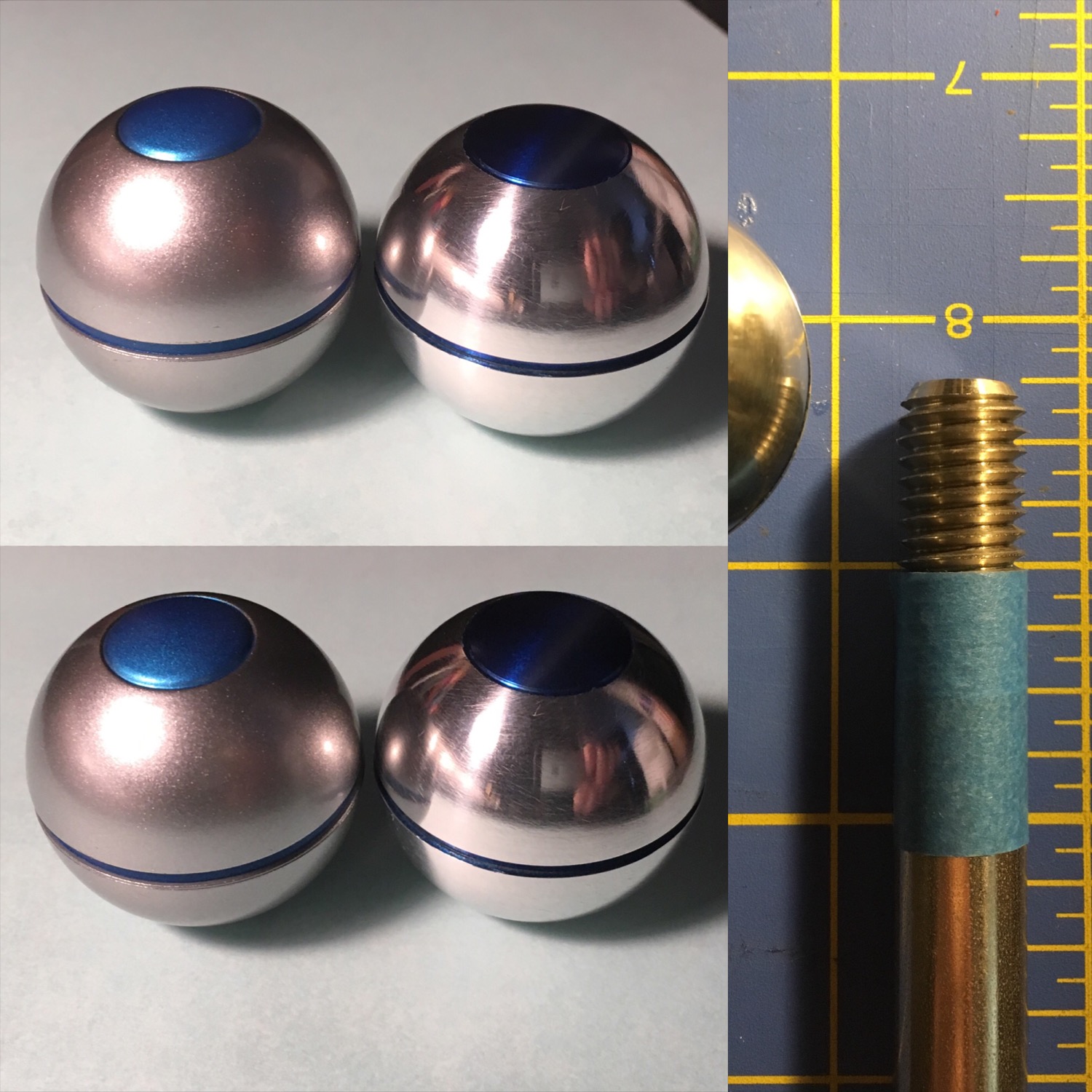

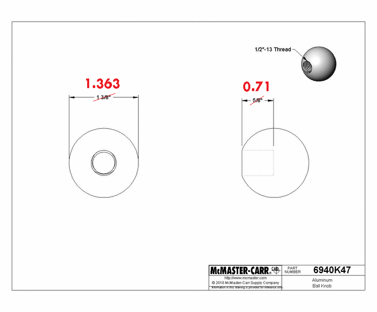

I continue to be blown away by your design revisions! I have only two comments: when I did some scaling of my own, I did get 3" for the housing length/diameter, but the threaded stud seemed more correct at the 5.5" over-all length stud from McMaster (link). Note that the threads on the stud extend internally past the "equator" of the ball. (though perhaps the thread adapter you're using will change this). The ball also scaled out closer to 1.35-1.375" in my estimation; I see some space left between your 1.45" circle and the actual edges of the ball in the screencap... Totally agreed on the room for some idealization here, though.
My Sideshow Grogu arrived a couple of days ago so I wanted to mention that the diameter of their shifter ball is exactly that of the 1-3/8" McMaster-Carr ball knob (link) (measured 1.36" Ss vs 1.362" M-C). In the photos below, the Sideshow one looks a little taller, only because the "south pole" has less cut off due to it having a magnet rather than a large threaded hole; diameters measured on the silver portion match within two thou.
Also, the McMaster dimensioned drawing is not entirely correct. Here it is with the actual dimensions of the ball and depth of functional threading. The tape in the photo above shows how much of the threaded stud is within the ball when fully tightened down (0.71").
One final note -- five full threads of the 4" partially threaded stud remain visible when the ball is tightened down, which matches the screencap. However, the McMaster drawing for the 5" and 5.5" threaded stud list the threaded length as 1.25" vs the 1" threaded length on the 4" threaded stud. So that detail may not work out as well.

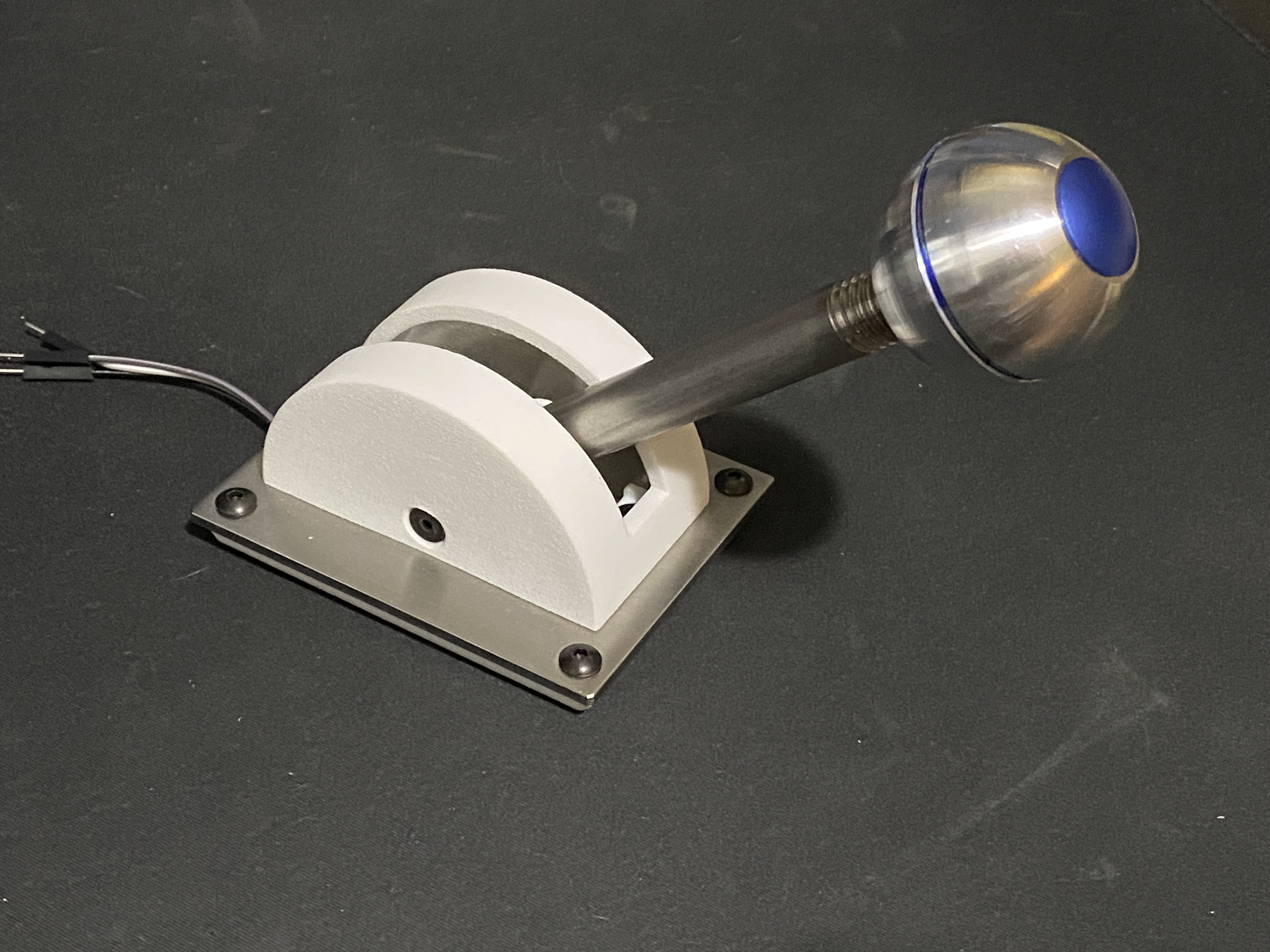

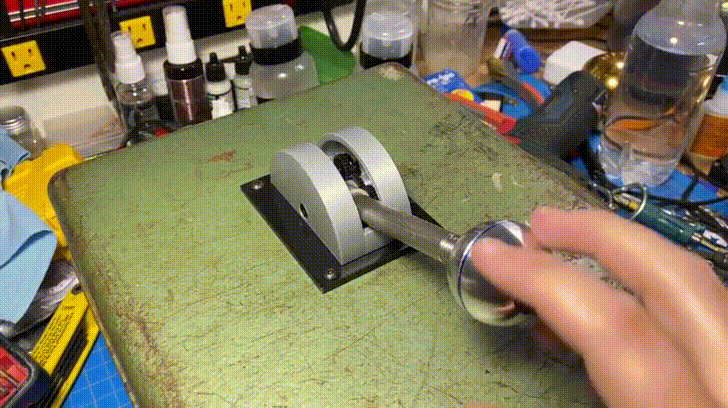

I received the hardware today and 3D printed and laser cut the parts. I realized the layer lines would look better it if were printed on its side, so I will tweak the design to work better in that orientation.
The gearing inside works great. However, the speed limiter is not needed. The lever arm is strong enough that you simply don't get any extra resistance from the limiter, and you can also alter the overall resistance by tightening the axial screws. It is also a pain to install, so I will drop that from the design. The potentiometer fits nicely, but needs to use super-glue and so I am going to see what I can do to make it fit more reliably.
The detent sort of works, part of the issue is the inaccuracy of FDM 3D printing, combined with the layer lines. I think if I want a middle detent that it will have to be some much larger mechanism. I got an idea for that using laser-cut delrin that will be easier to tweak and dial in to the right feel.
The ball and steel rod are so heavy that you have to have it screwed down or magnetically attached to something to move the lever. So as a desk toy it won't work unless the base is made heavier. I may make the final baseplate using 3/16" steel from sendcutsend.com.

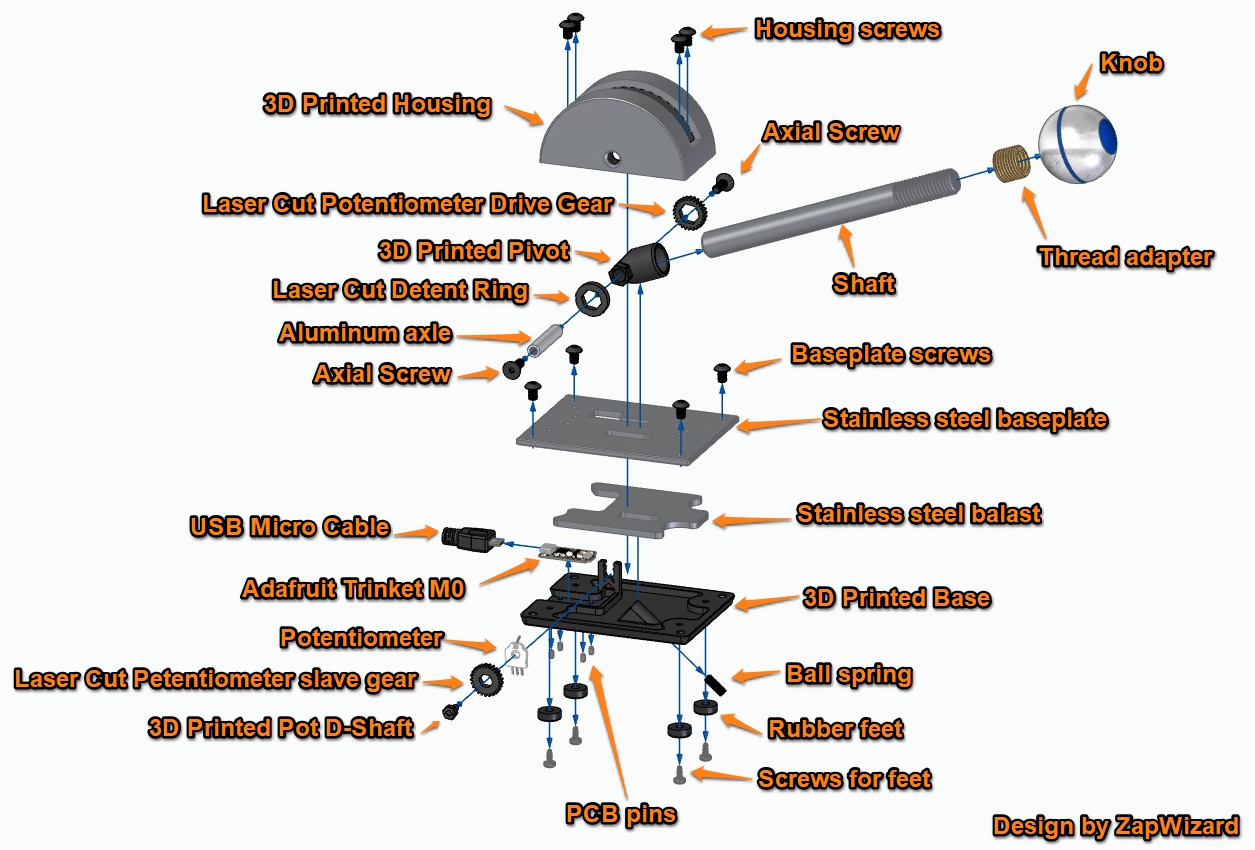

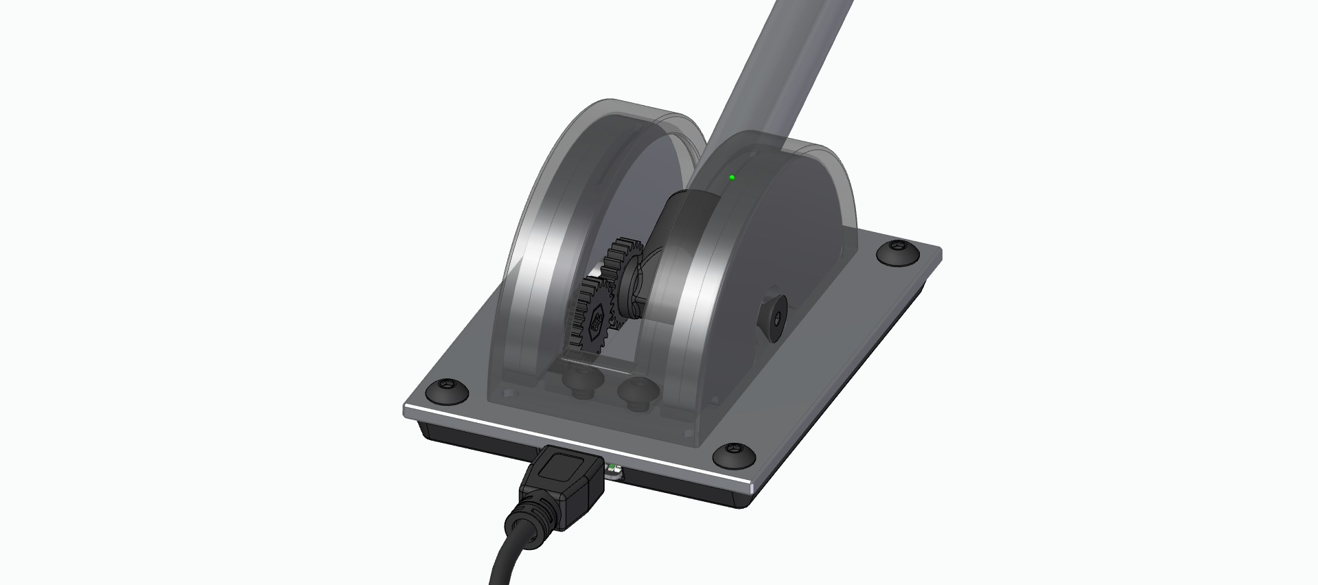

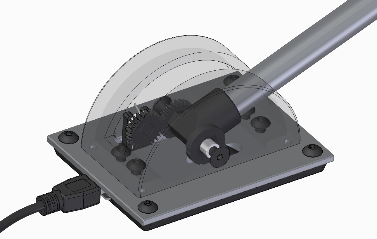

I also re-designed almost every aspect of the device.
I added a 3D printed base which will house the PCB, as well as the potentiometer and a sheet of steel to add weight. The plan is to order the ballast and baseplate in stainless steel from sendcutsend.com. Both cause real materials are better, and this things needs the weight.
Screw on rubber feet will prevent it from moving around too much. I have simulated the center of mass, and it shouldn't over tip on it's own. It can still be screwed down if needed. I did look at using lead shot, but it actually didn't change the center of mass by more than 1/8".

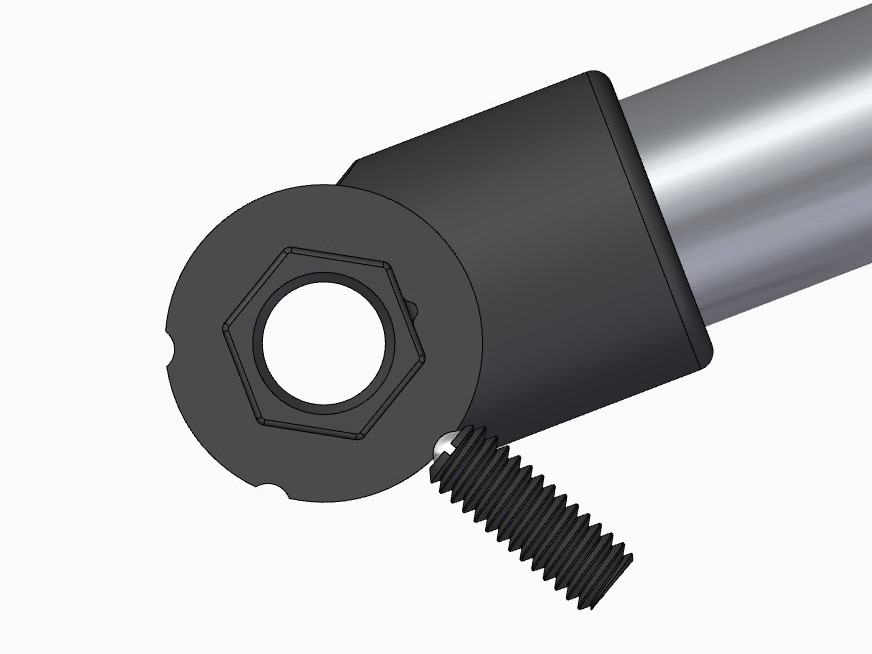

For the detent, I decided to laser-cut a ring which will go on the opposite side from the gear. By laser cutting it I can tweak the detent depth to get just the right feel. I could also even add things like small bumps that make the lever feel like it is ratcheting up/down.

One thing that was still bothering me was the center of mass sitting right over the feet, meaning almost any extra force on the lever will cause it to top over. So I added mass wherever possible in the way of four 1/8" steel ballast plates. These will sit on the inside of the housing. That way it is far less likely to tip over even in use. Plus it still has the magnets to provide a few pounds of force if placed on a steel surface.

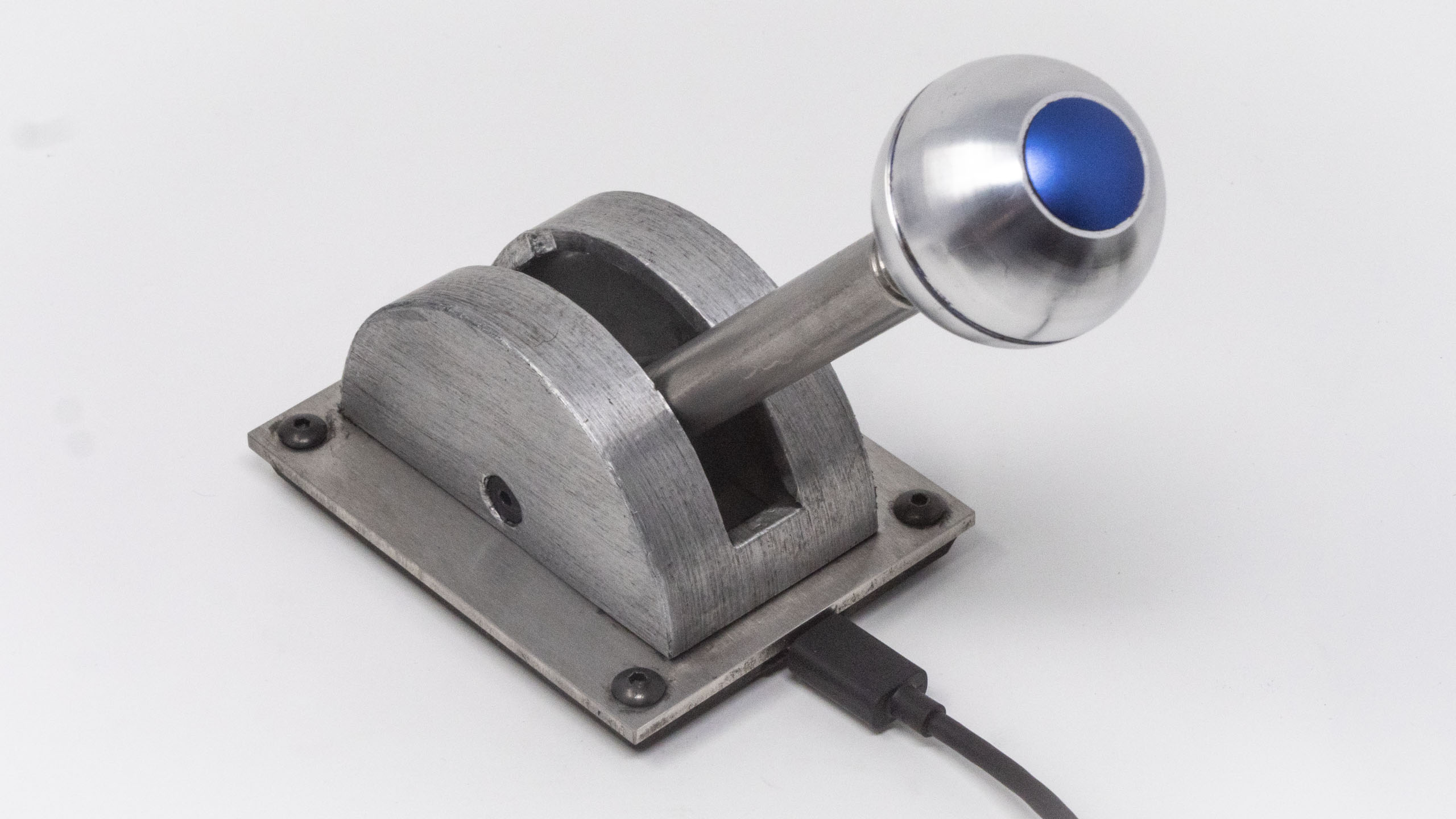

It took a month, but Shapeways finally delivered my 3D printed parts. There were delays due to both Texas being an ice cube for a week, and Shapeways using the slowest postal method known to man.

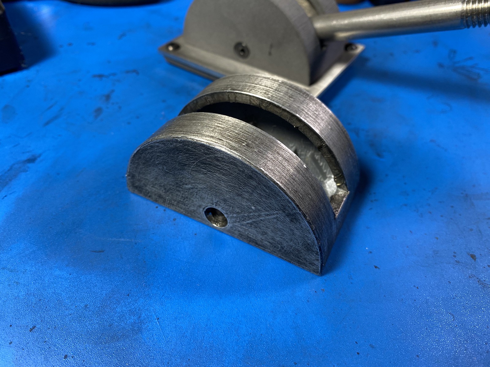

I had to grind away a bit of metal on two of the internal plates, but everything otherwise fit perfectly.
The sides have to be pretty tight to get the heavy lever arm to not fall on its own, but it does work. The unit doesn't tip over either, but if I were to use it on a game system I would use the magnets or bolt it down anyways.
I plan on dying all the nylon parts black, and then facing the outside with aluminum tape and polishing that to get a real metal finish.
