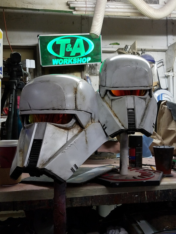

Finally painted a couple of these guys:

Just received mine, fantastic, clean mold! Cant wait to work on it. I had a question from this picture, 1. Did you paint over the white if so what shade of white or did you just weather it? 2. Are the scratches painted or actully ecthed in? Thanks again and great work![emoji16][emoji106]
I started by trimming out the eyes and neck hole, sanding down any visible mold seam line, then scratching the scuff marks and damage into the surface with a rasp, a knife, and some coarse sandpaper. Then the whole thing was washed, primed, and painted with a couple coats of Rustoleum satin Blossom White. The chin greeblies were painted with the darkest gunmetal metallic I had handy before being glued on. The weathering was a heavy blackwash with a few spots picked out in some shade of dirty yellow I had handy.

Hey watched your weathering video last night it was fantastic! What liquid were you using to remove the acrylic black? Was that rubbing alcohol or water? Thanks man

I use a splash of rubbing alcohol to break surface tension and make things flow better. Then I use wet cloth to start ragging off the black acrylic paint. I gradually use drier and drier rags until I'm basically just buffing down the parts that I want to look cleaner.
